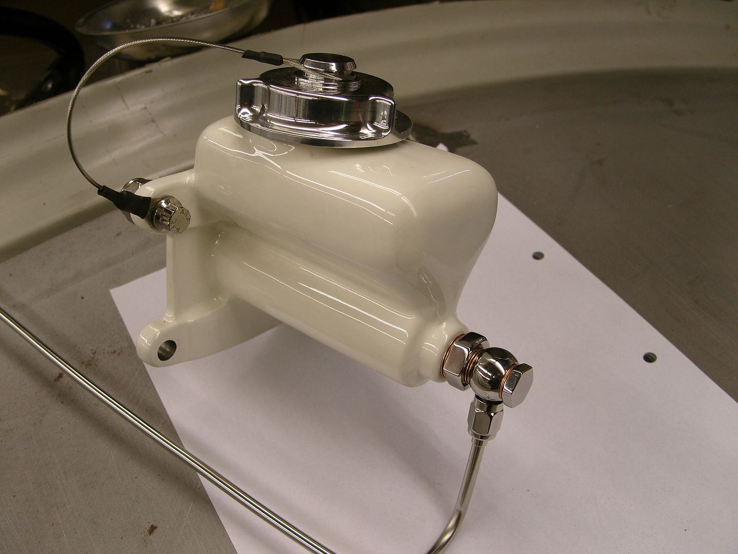

    Not much to show as most of it is the boring stuff at the moment and this detail stuff can eat up a fair bit of time but i did get around to making the master cylinder look a bit better, I was originally going to chrome the body but after 1/2 way through polishing i decided to paint it.
    Master cylinder is new Raybestos unit from a 1955 F100 truck
    First off got all the roughness off it and ground off the lettering and sticky out bits and put on 3 coats of epoxy primer, next 2 coats of Green TI hibuild, then it was all rubbed down and 3 coats of my special mix 2k white applied, its matches the firewall.
    The cap was made on a CNC mill by Steve (rusty coupe) and is fashioned after a aircraft cap, this was hollowed out and glued to the original cap with 2 pack epoxy glue. Once set it was given a nice shine on my polisher.
    The outlet of the cylinder was 1/2" UNF and you can't get a stainless fitting to 3AN so i spun one up on the lathe and drilled and tapped the centre to take a 3/8" stainless banjo fitting & bolt.
    I wanted to add a lanyard to the cap and found some stainless bicycle brake cable, I'm well pleased how it came out :D

    I predict that you get very sick of cleaning this piece of art before long. It's beautiful, but man do i see hour upon hour of polishing and upkeep in the future. Good luck in the future and keep up the outstanding work. My fingertips get sore just looking at this.

    Got lucky today and found a stainless banjo & bolt

    A few people asked about the copper washers so here's what they look like before compressing.
