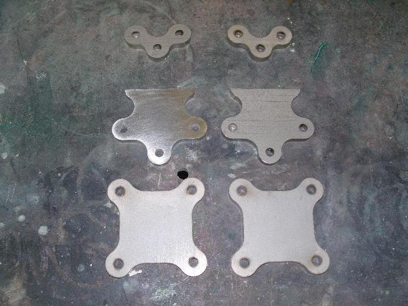

    These are the other half of the engine mounts and the Trans mounts, And the engine steady bar.
    This is how the engine mounts go together, They will be TIG welded through the holes and then dummy rivets put in to cover the holes and give the look that they are rivetted in place.

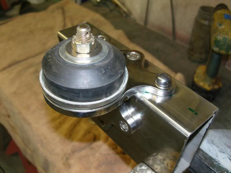

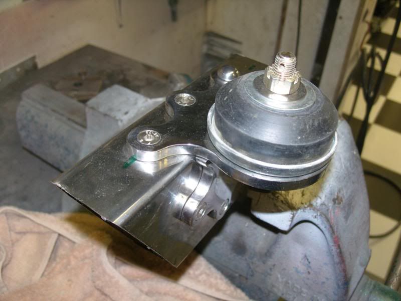

    Had to make a slight modification to the engine mounts, The original method of fixing was to weld down through the holes and cap off with a rivet, this turned out to be a pain so instead the holes have been counterbored and they will now bolt into threaded inserts welded into the frame and then capped off with rivets to complete the look, well off to weld them up now. I'm afraid progress is going to be a bit slow on this project as i'm in the middle of painting my 32 roadster, just working on this when i'm waiting for paint to dry :)

    Engine mounts now welded
