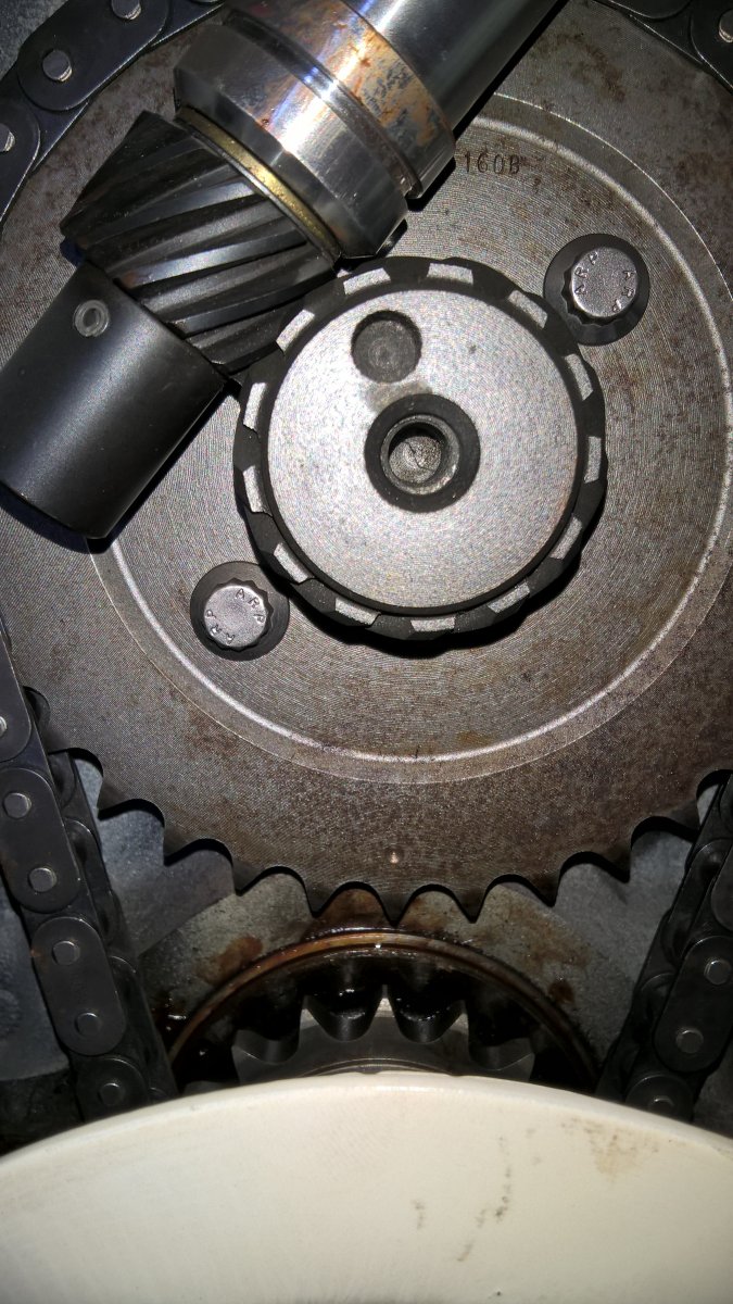

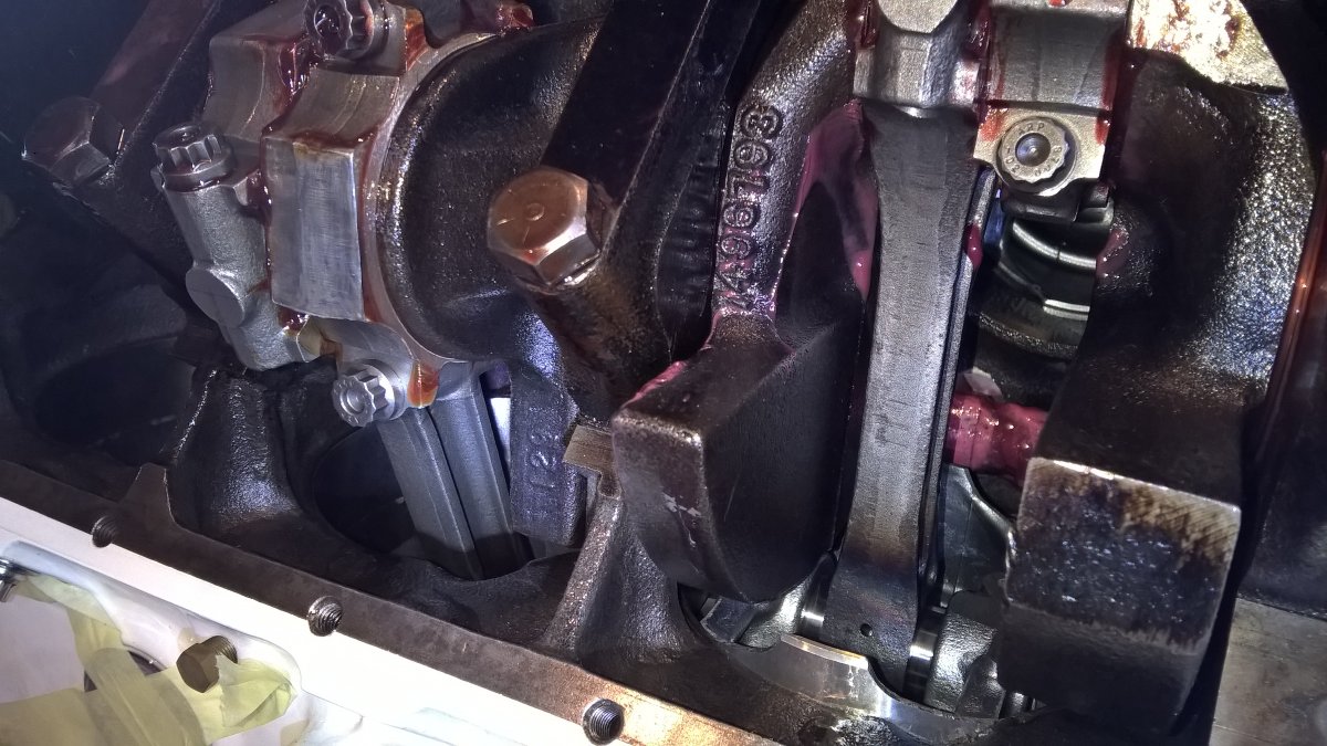

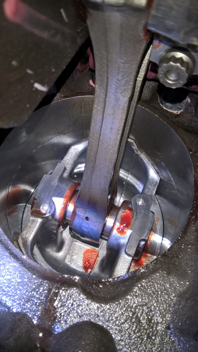

    I've had chance to fully investigate the engine now and it's all disappointment... Stock crank, stock rods, cast pistons, stock timing gear ( who the hell fits stock timing gear?) I'm staggered that someone of Langy's talents would spend so much time and effort on the outside of this motor and not bother with the internals. In fact he gives the specs for this motor in this very thread that it has highly upgraded internals, so would he really remove it all to replace it with stock?
    The only thing I've not yet been able to I.d. is the cam. Any ideas?

    Those are not stock parts ... I have been building these engine's for 30 years ..... pistons are Keith black ... rods are forged stock are cast so I would guess they are pep ..timing chain is coyes with are bolts ... I can figure out the cam from the photo ... 112 lobe center ground by comp cams ... I just read this thread and the loss of such a builder is so very sad

    Cam is comp cams ... intake lobe 5441 is 256 advertised 212 at .050 .298 lobe lift.... exhaust lobe looks like 5204 advertised is 292 at .050 is 244 lobe lift is .3235 ....but it could be lobe 5209 that is 296 / 246 .340 lobe lift ...ground on a 112 lobe center
