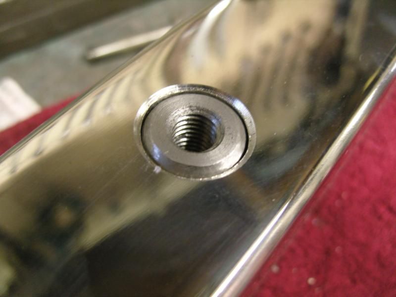

    Well made a bit of headway but its taking longer than i thought :( Its a real pain working with polished stainless as even your fingers leave marks if your not careful and after each stage it needs to be repolished :(

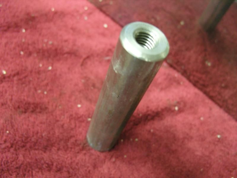

    Well i got the body mounts all in the frame while its not welded together as its easier to handle, they go right through the frame rails and are welded top & plug welded at the bottom. They are tapped 10mm x 1.25

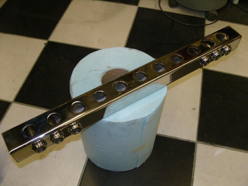

    Got the rear x member made up with 3 positions for rear coilovers for adjustability.
    This was the worse bit of stainless i've had so far, real grainy and a pig to polish. Maybe i should of used round tube as that always seems to have a really good finish which means less polishing :)
    Its a bolt in jobbie so end caps will be welded on when in the jig.

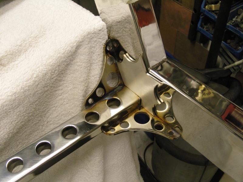

    Well took a day off today as I needed a hand with the frame and my good mate Des (Tiki Des) came over to help, He was quickly dispatched on polishing duty while i welded some bits up.
    The ch***is is made in 2 halves as it needs repolishing after each bout of welding with a hand held polisher.
    Another good mate Ian (Bigbossman) got me some low tack vinyl stuff to protect the polished surface as its very easy to mark :( so the rails were covered up.
    The postman came this morning with some bits i've been waiting for, They are the fishplates for the inside and outside of the kick up and also the firewall joint in the main side rails, The fit a treat but need polishing before being welded in place. thanks Paul.
    Kickup fishplates
    Firewall joint fishplates
    The main rear section rails are now fully welded so needed to add the rear crossmember to tie them together, also added a kickup spreader and weld in some gussets I had laser cut.
