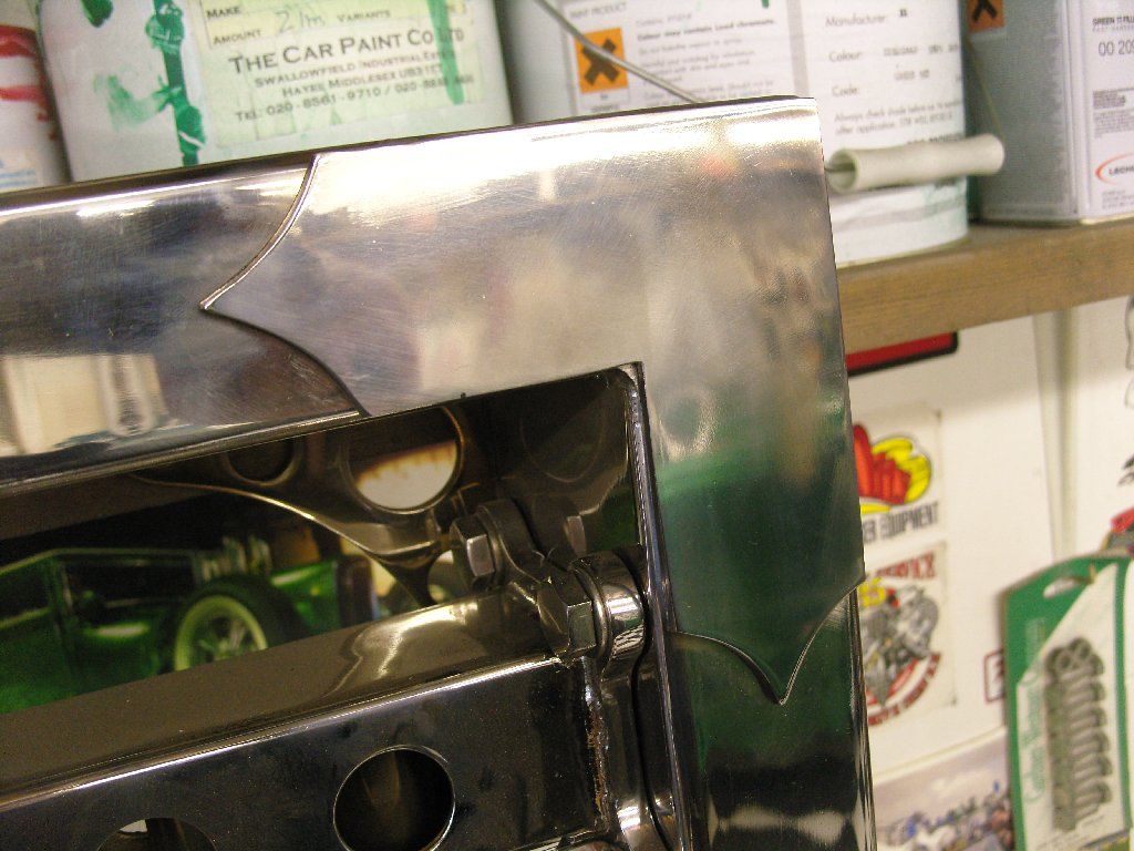

    Well sometimes things in hotrodding world don't go smoothly :(
    I had welded up the rear corner fishplates and were polishing out the welds amd daydreaming and the next thing i knew i had made an undercut in the main rail :( It looked terrible and i couldn't believe i had done such a stupid thing, My trusty helper Gomez said it wouldn't show but i just wasn't happy with them, anyways i had to carefully cut off the plates and make 2 more which were slightly longer to cover the c0ckup :(
    They probably don't show in the pic but they are quite deep.
    At least i think i got away with it :) I'm off to finish weld now.

    Thanks for the comments, An undercut is where i was taking the weld down and took it to far, therefore creating an undercut.
