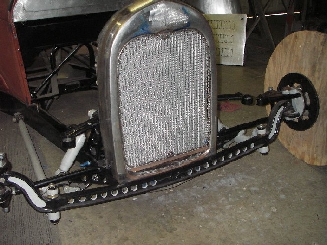

    Jeem, from you that is a honor. you have a great eye for style...
    saucerhead, you know your ride is the reason I started down this journey. I was planing to build a Model A PU when you car came out in Streetrodder.. It was all i thought about and then Marshall posted his fore sale ad.. as I type this, the issue is sitting just to my right. (I have it where I can reference it for build ideas..).
    would love to know the width of your grill and radiator..

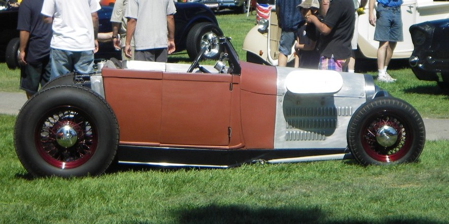

    Great start to what looks to be a great modified. I did a 28/29 rpu into a modified and narrowed the cowl 3 inches, and the grill shell 5 inches, pics attached. If you are going to go with the narrow A grill shell try to find the "Street Rodder" in which Ron Covel narrows a 28/29 grill, 5 inches but he does 5 inches at the top and 6 at the bottom and it really looks great.
    Rex

    Rex this car is sweet! The narrowed grill with those lights looks amazing, do you have an more photos or a build thread?
    Keep up the good work Boones, I'm hangin out for another update.

    Rex, thanks for the tip on the grill shell. Now if I only had Ron's talent..
