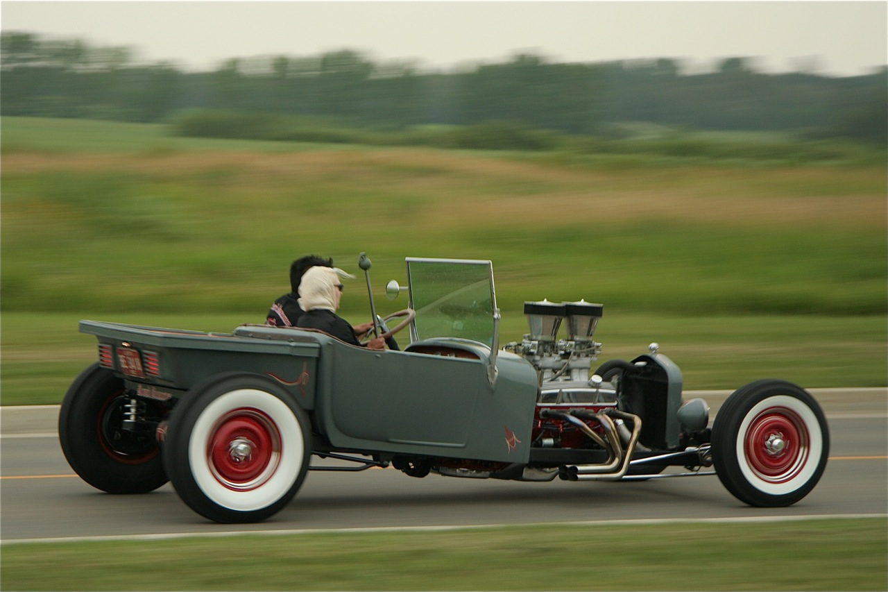

    Everything is lookin' great but I'd seriously reconsider the front tires. Bike tires usually don't carry much of a load rating and ARE NOT designed to handle the side loads that they will be subjected to.:eek: Would hate to see an "after" picture of the accident when one or both fail. Something to think about.

    i read up on it for days on here before i bought them to be sure. everyone says there fine.(do a search youll see) tons guys did it back in the 40s and 50s with no problem. this car is a model A frame and fibergl*** body and a shortened bed. the entire car cant weigh more than a full dressed harley up front! ill be lucky if its 1500 pounds entirely.
    this car from the yakkity yaks? sold me on them.

    yeah, we will see it will be perfectly fine! sheesh tires are rated at 750 pounds each thats 1500 pounds. so unless i get the car up on just one tire, its going to be just fine.

    The problem is side loads in a turn that they're NOT designed to handle. How 'bout pulling your head out of your "alternete point of contact" before you get yourself or someone else killed!:mad:

    what you think im gonna take a corner at 45 mph in this thing???? dude, you dont know what youre talking about. people have been doing this since the 40s! and people STILL do it now!

    Wow, does this mean ,if I had a Harley trike,I need to put car ties on it, because the tires will act like car tires.
    I don't think so.

    yeah ok buddy.... me and hundreds of other people, we all must me *****s.:rolleyes: you do also realize these are innertube tires too right... ah whats the use youre a lost cause. do a search its been discussed a bunch of times.

    To lugnutz..... Just because you spent 50 bucks to be an alliance member doesnt mean youre Gods gift to hot rodding.....do your research. Guys have been running em for quite awhile now....
  24. I run my Morgan style FWD on WW Avon Gangsters meant for a Harley. I have no end of people telling me that the walls will collapse and the treads will shear off etc etc. I've done 60,000 miles on these type of tires with no problems of any sort - no strange wear patterns or splits.
