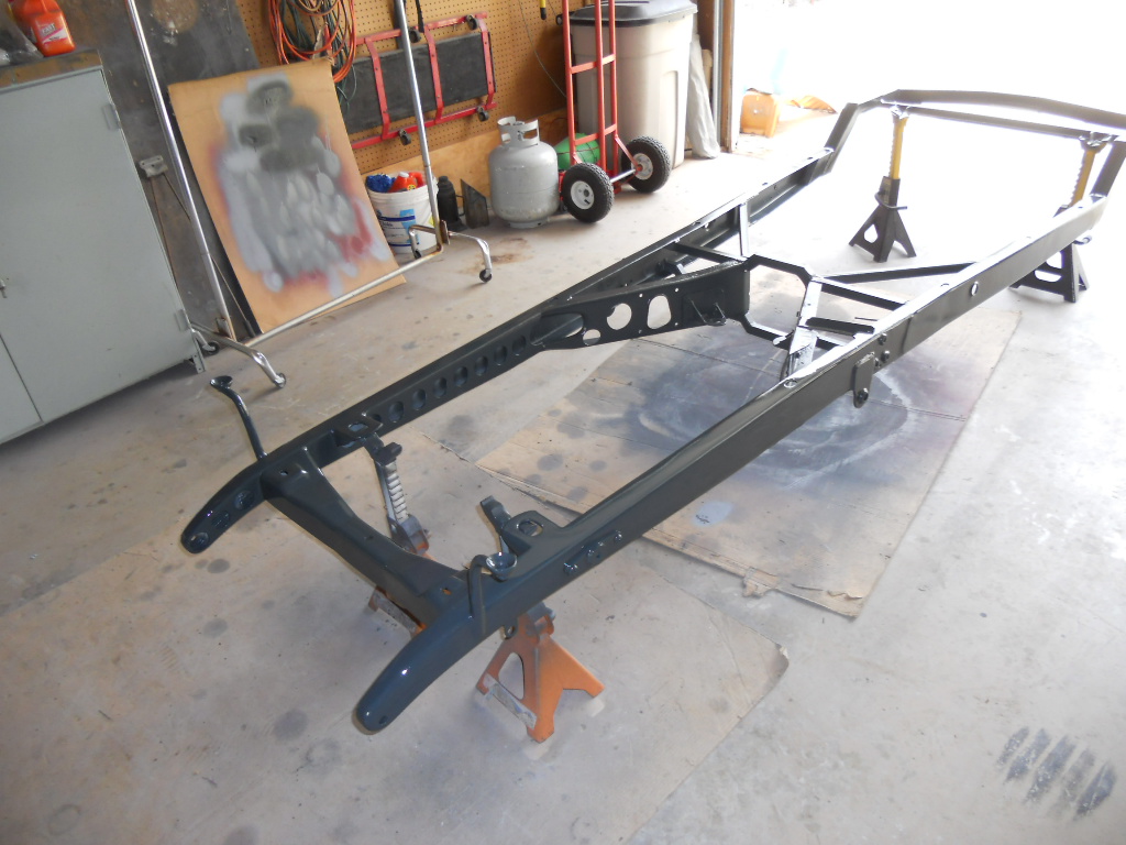

    For 4Speed: Tire sizes are 4.50/4.75 X 16's on the front and 6:50 X 16's on the rear ... from Coker. As for the ch***is, I'm throwing in a couple of pictures of the ch***is so you can see how it's set up. I did use portions of the K-member out of a `37 - `38 frame; that resulted in ready-made bracketry for clutch and brake pedals, master cylinder, and the unsplit set of bones on the rear.

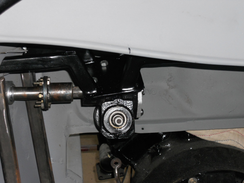

    Oops ... wrong picture. The first one is of a Corvair box from Flaming River I started to use for the cowl steering. It got ****-canned in favor of a `32 box and very different bracketry.
    Let me see if I can't find the frame picture I intended to post for 4Spd.
