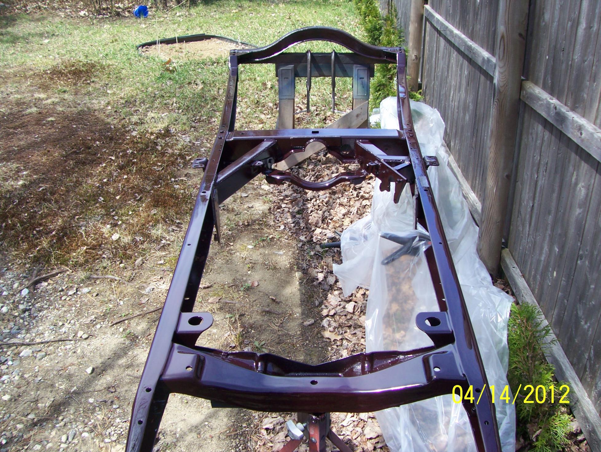

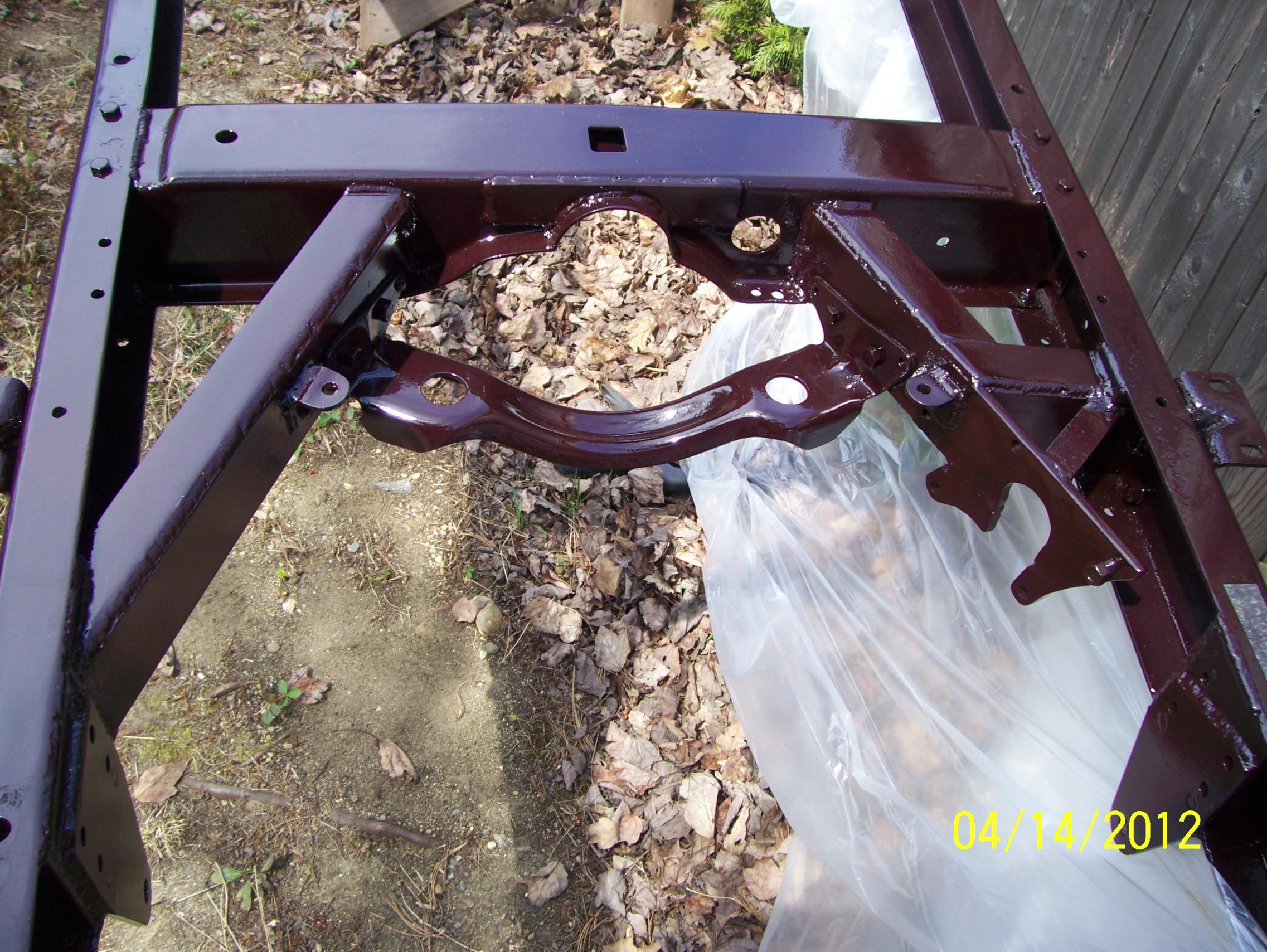

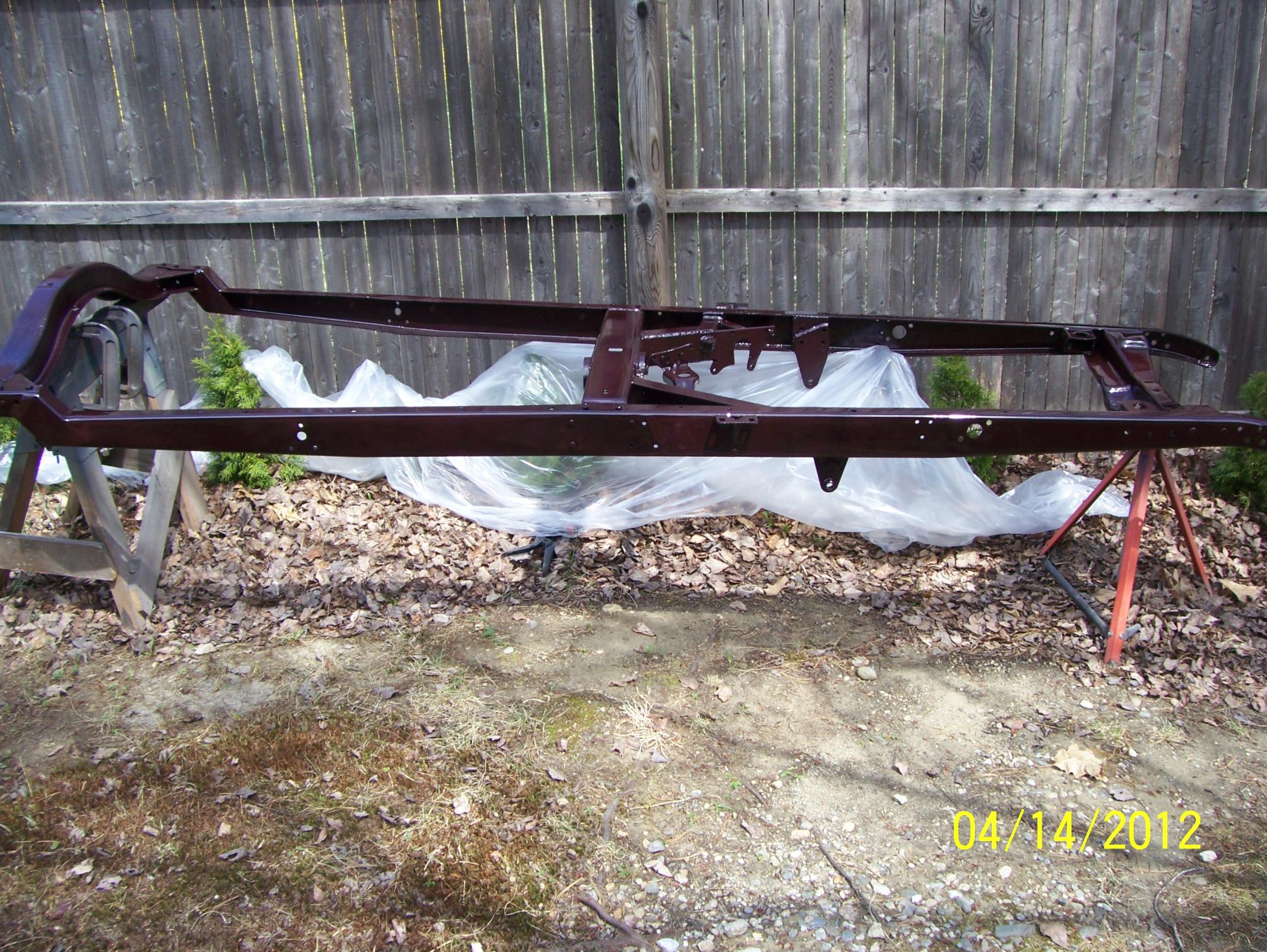

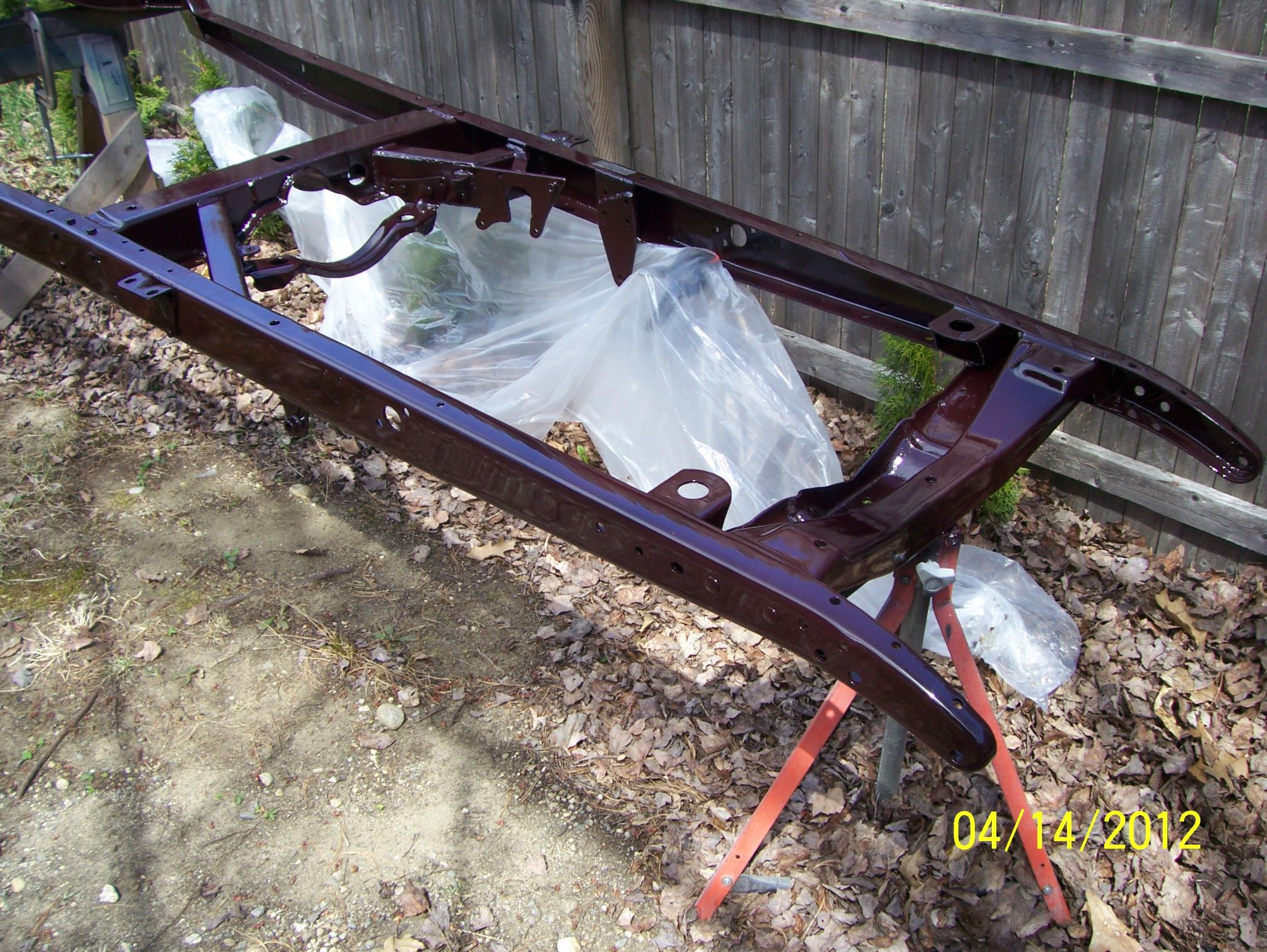

    haven't posted in a while.the car is apart. i have finish welded everything and painted the frame in deep maroon with a $12 harbor freight iwata copy spray gun.i can't believe how nice these things lay paint i'm gonna buy a couple more. all the suspension in sem mat black paint.hope to begin the re***embly in a couple days then get the motor together.here are a couple pics of the frame.3"z in rear,38 ford ****** cross member,homemade motor mounts and k member.

  16. That frame looks great! I love the color. Go! Go! Go!

    Man, I love where you have gone with car but there is once GREAT improvement to you car that will be easy.
    Please, please, please reshape those horrible barn door front spring shackle bars.
    Make 'em dog-bone, make 'em just lots thinner, but not those wind-catching mileage-eating license plate sized monsters!

    boy,how do you really feel.i think i can make that change for an old school hamber.
    wind catching ,mileage-eating licen plate sized monsters -thats hilarious

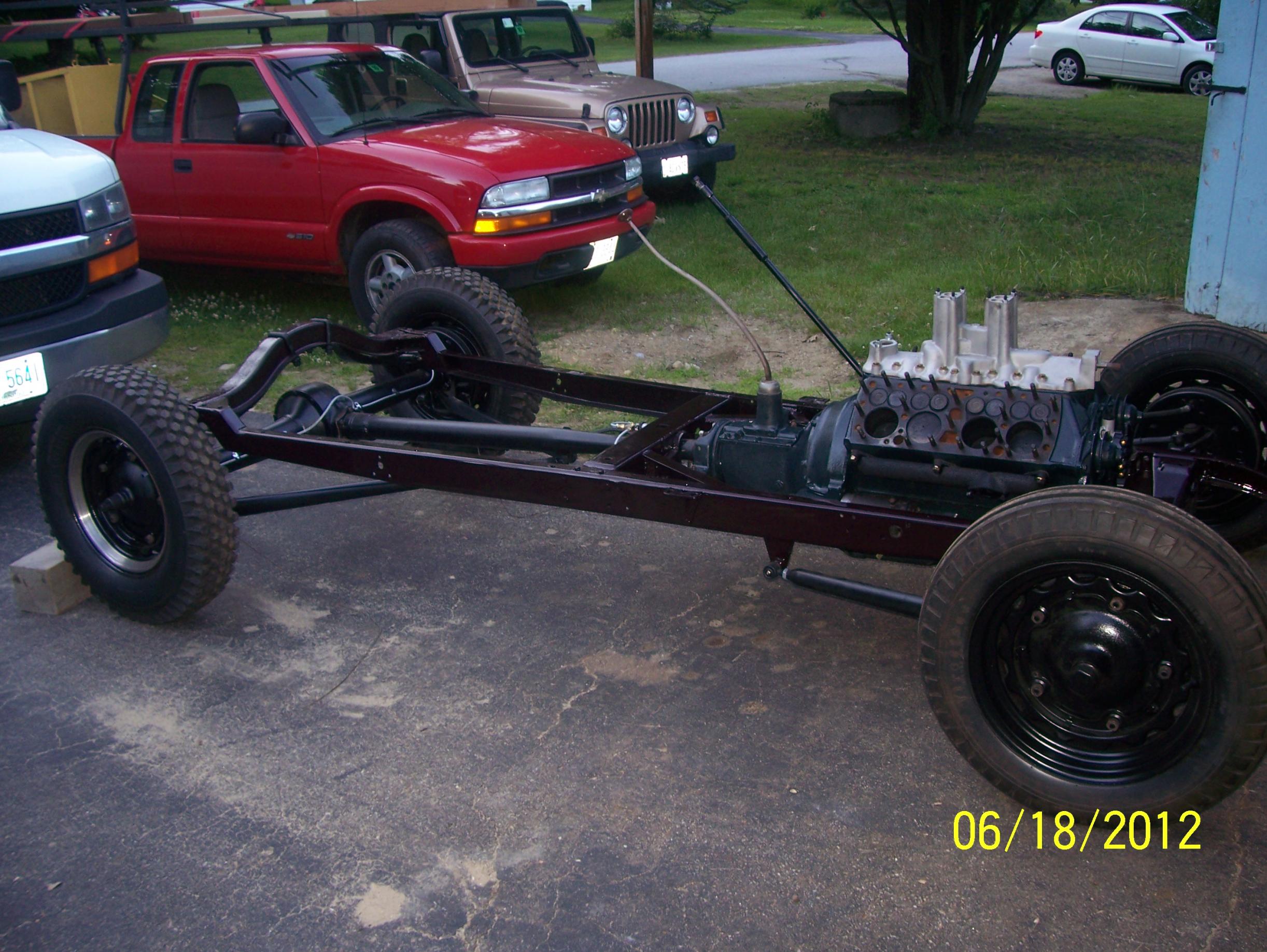

    update:ch***is painted and ***embled.brakes rebuilt.tires mounted(thanks dad).installed an n.o.s weber f-6 cam,adjustable tappets,41 timing cover and rebuilt dizzy and thickstun pm-7 intake.
