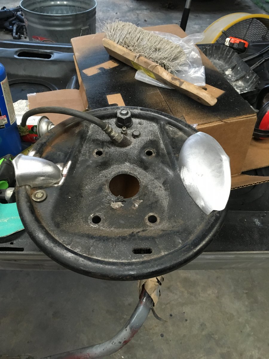

    With all this crazy stuff going on with the virus and now riots and all, ive decided to hole up in my garage and work. Most of my time lately has been spent on a customers off topic car but ive been making slow steady progress.
    So Ive always liked the look of cast aluminum brake scoops on the lincoln setups. So i figured who says they cant be adapted to gm brakes. So i ordered a set from obriens truckers that are for repop lincoln backing plates and began moding them to fit. Quite a bit of grinding but the end result i think is worth it.
