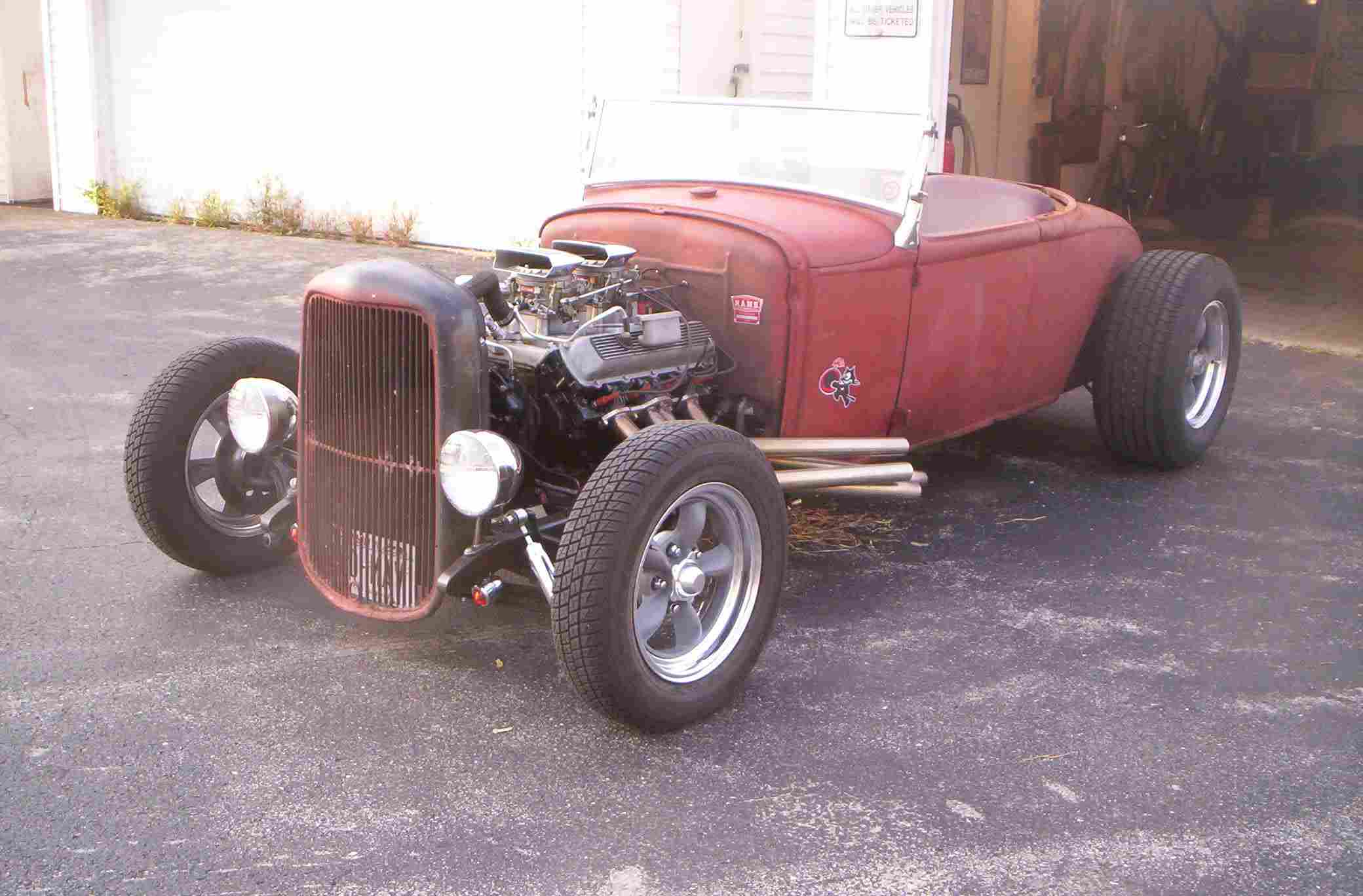

    What I want to do with my roadster is achieving a stance close yo this red roadster bellow on the pics.
    Could anyone tell by staring at this pics how that stance was achieved ? someone might know the owner and the car..., what about frame,suspension, links, steering, etc

    wingnutz owns that car

    Please, be patient...I am getting anxiety reading these two posts about your '29! Take a deep breath, you will get this figured out. If you send Wingnutz a private message, I am sure he will get back to you when he signs on. As for the stance, my old roadster had a similar profile...except not so low in the back. Looks like he used a Model A frame with a 4" dropped front axle with hairpins, channeled the car the width of the frame, and z'd(or stepped) it in the back with the spring behind(maybe, speculation.) Steering looks like cross-steer as there is no visible pitman arm or drag link.

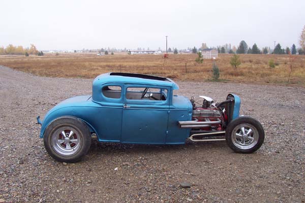

    Somehow out off topic but Ive been wondering for some time who owns this coupe ? anybody knows ?
    Thanks
    D.

    merc joe i think that was sold on ebay a couple of months ago.

    hey mercjoe, jim sibley probably knows he built the car, he's on the hamb.

    I want an even stance, slighlty lower in the front but not too much.
    just like the blue coupe
  19. http://www.roadsters.com/wheels/
    I'm an idiot. Funny quote-"Fenton wheels have as much prestige as a Spark-O-Matic shifter, and about as much class as your daughter's boyfriend."
    P.S. The blue coupe has it nailed.

  24. hodaddyo
    Joined: Aug 8, 2006
    Posts: 279
    hodaddyo
    jim built the blue coupe. i think his screen name is jimsibley as one word, check the members section an pm him. he is a good guy. i'm sure he'll give you some info on the build. good luck
  25. Sorry for the delay...been to busy driving the roadster...!
    As for the stance it was achieved by a flat frame with a kick-up in the rear and then channeling the body the width of the frame.
    Basically Bobbleed built a flat frame based on the stock set of rails... channelled the body.... mocked it up so that it had the right stance with the tires and wheel combo... and designed the rear kick-up to fit the Quickchange and triagulated 4-bar within the trunk confines!
    It's a lot simpler than the double Z'd or Bleed Sweep frame and with a simple 4" dropped front axle I was able to stabilize the front end and get the stance I wanted using the adjustments on the Coil over mounts in the rear.
    Bob offers an adjustable spring perch for traverse mounted springs that'l give you stance tuneability as well.
    Contact Bobbleed for his chassis help and parts!
    The frame is longer than a Stock Model A as well as the wheelbase... the main thing is to mock it up with the engine, wheels and tires until you get the proportions and the stance the way you like it.
    p.s. I'm really "diggen" on that coupes pipes...!
    Good luck.

  26. mercjoe
    Joined: Aug 17, 2006
    Posts: 1,432
    mercjoe
    Do you remember how many inches were finally added to the lenght of the frame ? how much drop on the kick up ? did you use the spring over the axle ?
    Thanks !!!
    Diego
  27. I have no idea how much longer my frame is compared to "stock" but my radiator is mounted in front of the spring perch so that the radiator shell is at the right height with the front of the cowel (very important).
    Don't forget to leave enough room for your waterpump, Fan, and some room to play around with the distributor.
    Always build with the mindset that if something breaks (as they all do!) you can take it appart and repair it quickly without having to remove the whole body or other major components...!

  28. bobbleed
    Joined: May 11, 2001
    Posts: 3,118
    bobbleed
    from Awesome
    It is a 106 inch wheel base if i remember right.......
  29. mercjoe
    Posts: 1,432
    mercjoe
    Just 106" ??! it looks like it was extended 5" to 6" . Doesnt it ?
  30. It's 106" and accomondates the 455 Olds engine beautifully.
    Mock your car up with jackstands wheels, tires and motor for the desired stance.
    This should give you a pretty good Idea how you should lay out the rails.
