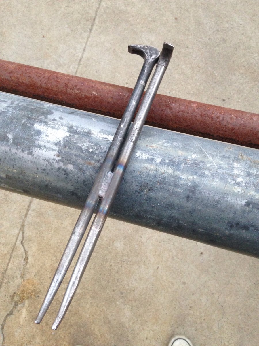

    Working on my rear roll pan I ran into an issue. I rolled the roll pan over pipe and put a wide break where it will attach to the body. image.jpeg The back of the body has a slight curve towards the edges. image.jpeg I don't have a deep throat Shrinker so I had to tuck shrink. Two small pry bars welded together. Twist then hammer and dolly flat again. Took a couple of rounds to get the curve. image.jpeg image.jpeg I hammered it flat and got a good fit. Not the easiest way to do it. But it works! image.jpeg

    Love it man, got a shot of your tucking fork where we can see the whole thing? I always enjoy seeing tools made in the shop for the job at hand

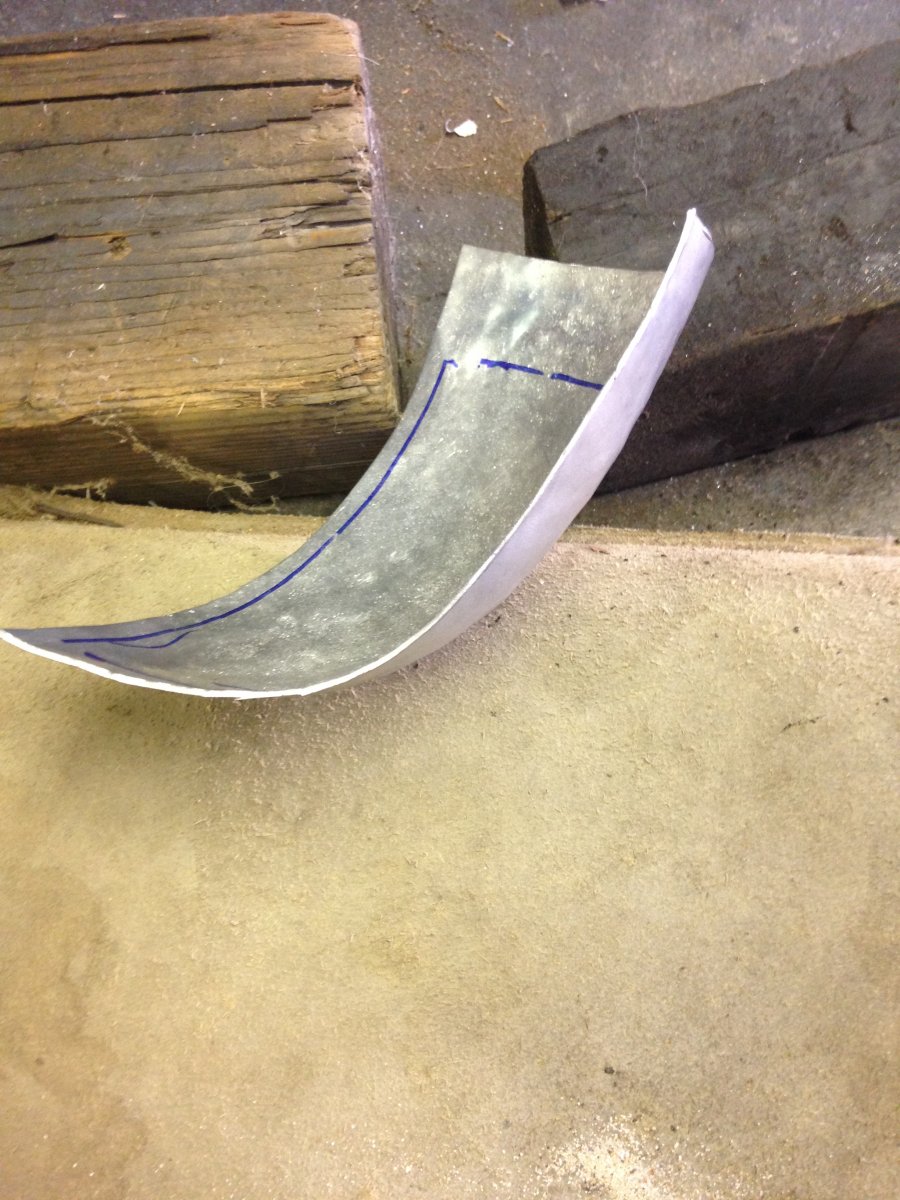

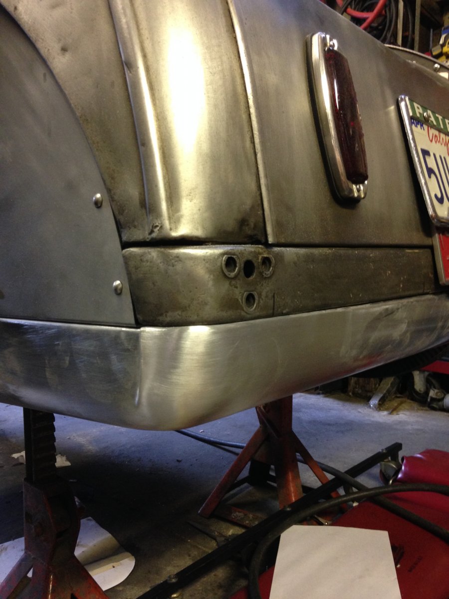

    image.jpeg Time for a update. So I get to race at TROG! I'm pretty stoked on that! Got a corner of the rear bellypan done today. image.jpeg pounded with the teardrop mallet in the middle then move to the wood block with a flat mallet to hammer flat the edges. image.jpeg still a ways to go. image.jpeg image.jpeg image.jpeg The logical way to make this would have been to use paper template to see where to shrink the edges and pound out the center on the sandbag. For some reason I just stretched it completely by doming the whole thing. As a result I had to use this shrinking hammer a little to knock down some pregnant areas. image.jpeg i didn't notice it until after I welded it together that there's a step between the wheel well and the corner. I cut a curve in the pan and welded in a stepped piece. image.jpeg

    Love the quick and dirty vise grip tucking tool!:D That's a cool idea!

    Made some progress over the past 2 weeks. Finished the bellypan. Finished enough until paint time anyway! Starting on my new shortblock that I hope to have swapped before TROG. I don't want the flathead V-8s too beat me too bad! image.jpeg image.jpeg image.jpeg image.jpeg New .080 over Ross Pistons. Small pop up and recess for my 2.02 intake valves. .990 pins. image.jpeg I drilled the crank for a balancer bolt before I get it polished. image.jpeg I have to borrow my buddies lathe this week to narrow my GMC rods. My South Bend has a 13" swing and rod is 7" center to center so no go.

  23. Hi Pat,
    bellypan looks great in the photo's, by chance do you have a 'side profile' shot at all, with all the car in view?

    Not yet. But I'll pull it outside and get a 20 footer. The pan is pretty level until the rear area when it tapers up just before the rear axle.
