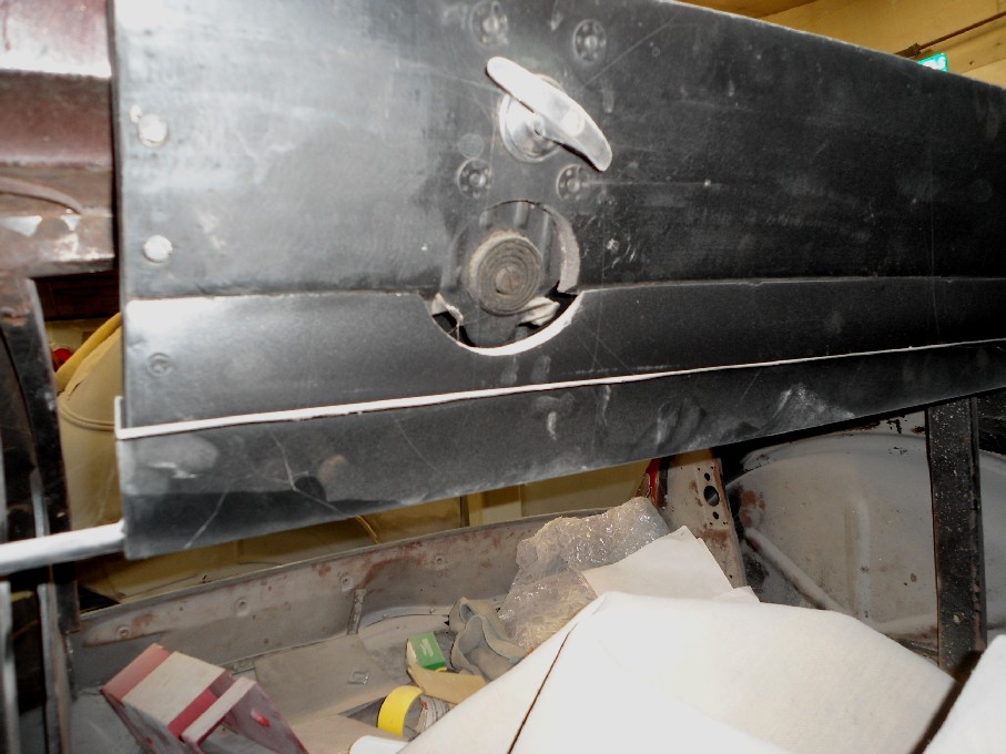

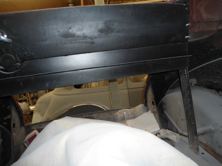

  6. Rocky
    Posts: 17,641
    Rocky
    Classified Editor
    I'm going over to my buddy's body shop in about 1/2 hour. I can get some photos of another customer's original 34 five window with it's original hinges, mounts and rain tray.
    Mine is kinda a morphadite with shop-made hinge mounts and a '36 back gl*** five window regulator [and regulator bracket] and a completely shop-made rain tray...loosly copied from original 34 coupe parts.
    The 34 back gl*** regulator "bracket" was made from wood....36s' were made from steel.

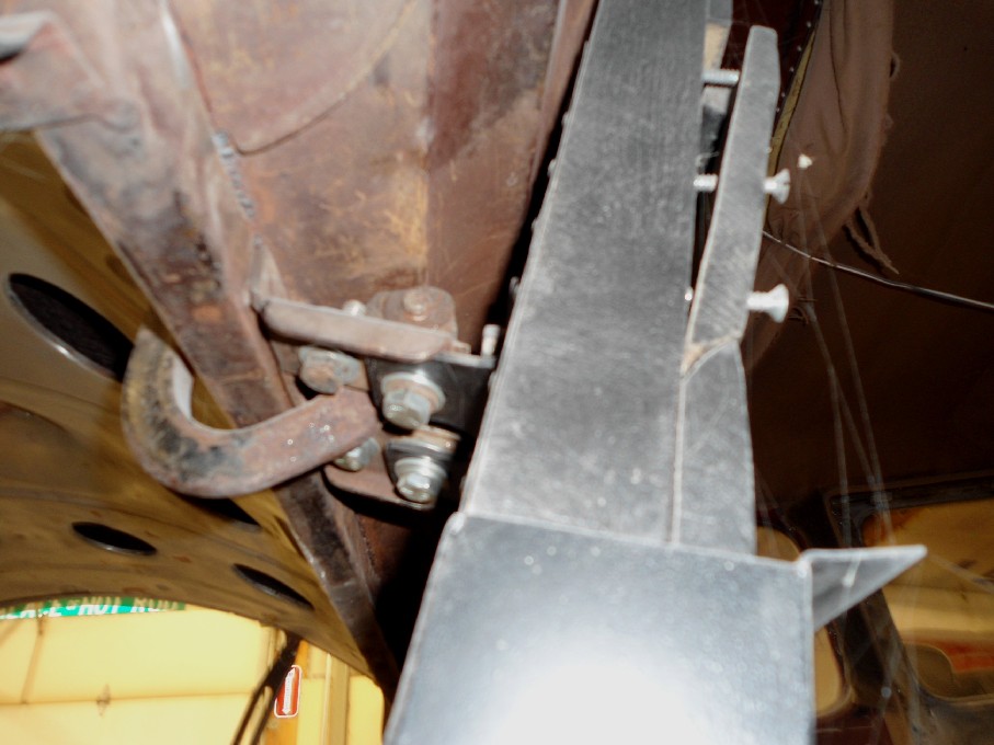

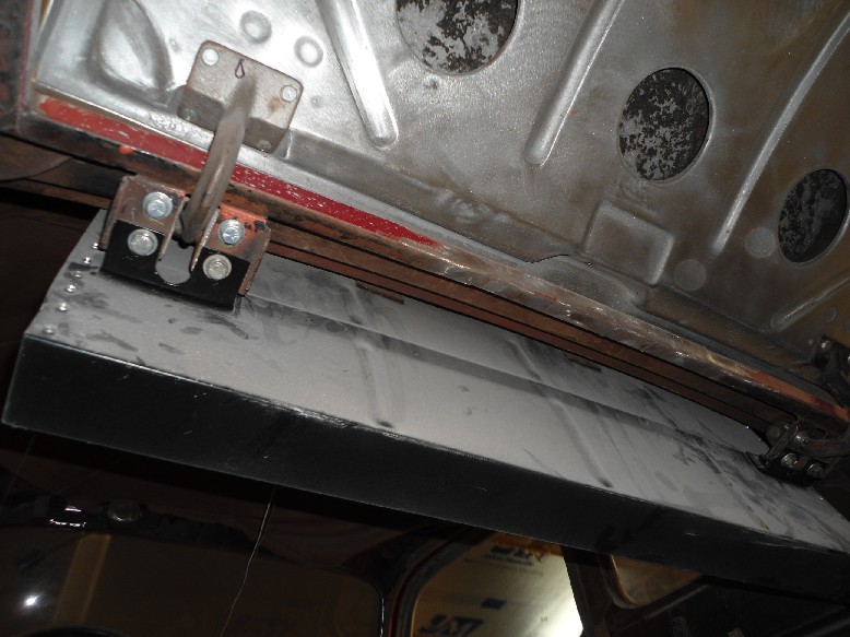

  7. ff1930
    Joined: Jun 8, 2008
    Posts: 97
    ff1930
    from lapeer
    The deck lid hinge brackets that are on body near rain gutter are available from Tom Bay.
    I just ordered a set.
    My 5 window is suffering from same hinge bracket problem.
    Tom said a lot of the brackets were easily broken.
  8. Rocky
    Posts: 17,641
    Rocky
    Classified Editor
    Photos...remember, this is a 5 window.
