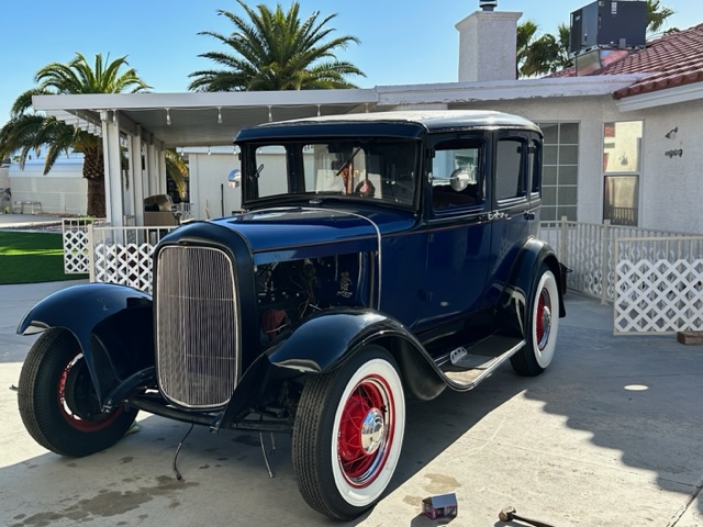

    before the fire... white rat...

    now it's grey with a little patina touch...fried rat

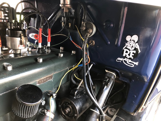

    from what it looks like to me is, ford just mated two of there 2 clys motors together... heres my thought... when #1 fires, # 2 fires 90 degrees later... seems like it would up the torque?????
    also I'm gonna run 2 lake pipes....

    looks to me like they took 2 2 bangers, and turned the other around to make it a 4 banger... with # 4 firing 180 from # 1 bet they did that to tone down vibration???

    Couple of fallacies in your reasoning. Since a 4 cyl. has uses a flat plane crank, with its throws paired 180* from each other, it's going to be a neat trick to get #2 to fire 90* after #1. Since #1 and #4 are paired and come to the top together, they can't fire at at 180* interval. They have to fire either together or at a 360* interval (most common). 720* in a four stroke cycle, divided by 4 equals 180* apart. Possible firing orders 1-3-4-2 (Most common and probably with less vibration and stress on the crank.) or 1-2-4-3. As Outback said a 1-4/2-3 pairing evens out the exhaust pulses in the pipes.

    thanks for the reply,... the model A/B is a weird bird,..cam profile is gonna tell the firing order..
    but, being a have to know, and love to learn guy,.. but here's my finding on the motor,.. it's fact that the firing order is 1243... correct??? here's where I based my header design...off cam rotation... and I verified from the crank.... put #1 tdc , turn the crank 90* and #2 fires.. turn 90* more and #4 fires, 90* more and #3 fires...correct???? ....no doubt I'm missing something, and gotta go out a re check my line of thought.. but at the same time, every pic of a race type banger with split exhaust manifold is 1/2 & 3/4 ... I own a fab/ muffler shop in vegas ,so I can have it my way... and even do it over... but like I said,... I wanna at least know what I'm doing... so the crank turns 2 to 1 on the cam??? correct???? and dist. turns same rotation as the cam??? so 90* of cam rotation is 180 degrees of crank rotation...???? correct??? firing order is based off cam profile???? correct... and not off crank, and though the crank turns 720* the cam only 360*.. the motor fires every 90* of dist. rotation.... the way I was taught about exhaust is this... when the first fires, the suction in the pipe pulls the air out of the next... and with a long enough collector/ tail pipe that not too big there is allways the drafting effect..
    too big of pipe and exhaust is allways pushing .....mateing 1&4 and 2&3 going to a one pipe collector would probley work fine.... but splitting the manifold is gonna be total different?????

    I think you are counting degrees of distributer rotation as degrees of crank rotation. Firing each cylinder at 90* intervals would complete the 4 stroke cycle in one crank rotation instead two. Ninety degrees of crank rotation from TDC puts all the pistons half way down the cylinder.
    Again like Outback said, a 1-4/2-3 split gives you 360* intervals between exhaust pulses. A 1-2/3-4 split gives you a 180*/540* intervals.
