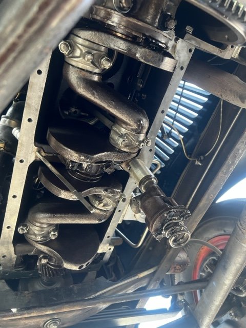

    sooo. I got another oil pump question... my motor seems to leak alot out of the rear main.. with the pan off,... I noticed that the little drip tube on the rear main was missing,.. I was told that with that missing it will make the rear main leak more?????? true or false?????
  11. ALLDONE
    Joined: May 16, 2023
    Posts: 3,812
    ALLDONE
    also, the little thumb screw on the top of the filter looks like a pressure setting???
    maybe the oil pressure is set too high????
    sure wish I could find someone that knows this system....

    also,.... have you ever seen a oil pump set up like the one on my motor???

    Your oil pump is an early V-8 modified to fit your banger motor...there are various ways to do this and I haven't seen one like yours before...but I can see that it would work. The V-8 gears are taller than the A/B oil pumps....so more volume out of the V-8 pump.
    The oil discharges out the top of the pump and the fitting in the side of the block where the fitting is, that is piped to the filter housing, for a full flow filter. The outlet is piped to an external relief valve...that dumps excess pressure in the timing gear cover. The rest of the oil goes into a galley under the valve cover to oil the mains and cam journals. The place to put an oil pressure gauge would be in this line. Stiner tractor has some good gauges for this with install kits too. You want the oil pressure not to exceed 35psig.
    Your rear main will leak with the drain tube missing. The drain tube is meant to be under the oil level in the pan....otherwise the crank case pressure can blow oil out the main cap..and the back of the engine.
    You need the B drain tube installed first before you get carried away trying to make it leak free.
    Also look at your valve cover....it can leak when pressurized like this.
    I use Loc***e 5699 sealant both sides of the gasket...make sure you add an opening in the gasket for the oil inlet...also the bolts need to be sealed.
    This is getting long Good luck and don't have any more fires...get you a fire extinguisher in the car...pronto
    Larry
    As for exhaust scavenging on a Model B banger....not much will happen and the siamese intake ports are also a limiting factor for performance...but there are tricks
    You have a really cool ride and in the banger world, that engine is really nice...inserted and pressure oiled.
    Don't know about the rods, if the crank is drilled
  20. ALLDONE
    Posts: 3,812
    ALLDONE
    Damn buddy, thanks a million,...
    when i bought the car,.. the guy said it was A motor and the way to tell was the skinny oil filler tube,
    didn't want to argue with him till I got the ***le......
    I got the B motor tube, just have to drop the pan again... I'm gonna plastic gauge the bearing also to see where it's at.... also on the pump it squirts oil on the cam gear...
    thanks again, if you're in vegas hit me up... cold ones on me...
    they ran the oil pressure gauge line in the bottom of the lifter cover...seems to work.. I had to do 2 cut outs on the gasket... never had leaks there,.. but she runs 45 on the gauge cold.... and 25 once warmed..

  21. winduptoy
    Joined: Feb 19, 2013
    Posts: 4,156
    winduptoy
    45 PSI is a little high...adjust the pressure regulator and 10 at idle is fine.
    The A engine has a drain tube on the valve cover side and the B does not. Easiest way to tell at a glance.
    You got quite a score in my mind...looking again it looks like the crank has been drilled for pressure rods because the dippers are plugged as best I can tell. Confirm that when you pull rod caps. If so, I drill the dipper tray so the oil returns to the pan faster to keep the level up on the drain tube and to the oil pump.
    Also, looking at your engine, you have a stock B head. The compression ratio is about 4.5:1 with a stocker.
    It also has an adapter for a V8 water pump form the B head.
    The fastest way to build horsepower is a higher compression head. There are some ropops out there reasonable but with your inserted engine 7:1 would be no problem.
    As for the exhaust....a stock manifold is good up to about 75 HP or double what the stock engine was...cool factor is another thing.... and you have the technology...
