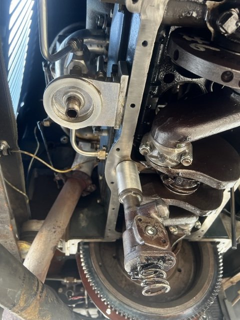

  2. I'm not a banger guy, but that oil pump is a 1949-53 flathead V8 oil pump that has been reworked/converted to fit your engine. On the distributor, might as well find one that has a mechanical advance mechanism inside of it . . . no reason to run a locked down system.

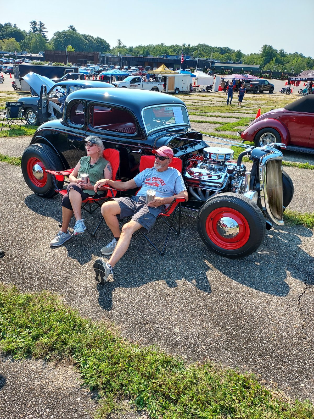

    Hey @2FORCEFULL, your 34 looks awfully familiar. . . . Did it go to M***achusetts by chance? 20220910_104733.jpg
    I'm pretty sure it did
    Rawrench likes this.

    Without the drain back tube the rear main will leak alot.

  11. wheeldog57
    Joined: Dec 6, 2013
    Posts: 3,849
    wheeldog57
    Bob and Linda are very happy with the 34, and they have quite a few trophies too!
