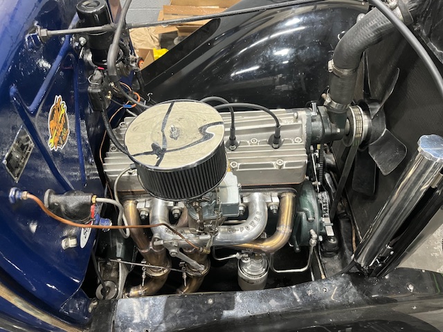

    up date...got her running, drove across town and home on it's own power...it was running way fat and would ping/knock on a hard load... I did fill it up with prem. gas...took a couple deg. of timing out..and that quit.. one question I have is reading the plug strap for timing... would the 1/16'' burn line still apply with running low 20's advance..I think the rec. timing for the head is 26/28 degrees...
    she runs real strong for being fat....I put the stock size jets(45's) but when I index'd them (china) they were closer to 49's.. I got some real stromberg jets 41's and 43's from so-cal speed in vegas... they are true to index size...
    I figured it a waist of time to do a chop off plug test when I could look out the window and see black soot coming out the lake pipes... the plugs now have no burn line on the porcelain

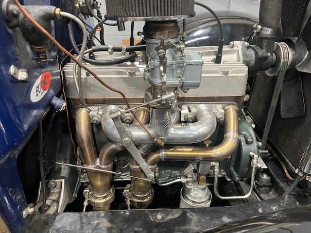

    well... the carb jet deal turnned out to be a problem,.. ended up having to get another Carb.... so now,... ready to tune tomorrow... running true to index 45's... starts and runs good as is,... but wannasee where it's at....exhaust is now cleaned up with just a hint of black with the accelerator pump...sounds good starts easy and runs smooth...and no ping...
