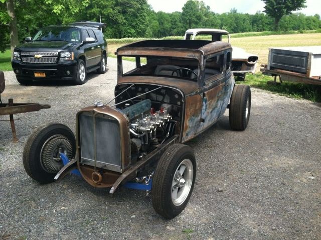

    Some new pics of the headers and exhaust
    ImageUploadedByH.A.M.B.1372296277.388066.jpg ImageUploadedByH.A.M.B.1372296295.019927.jpg ImageUploadedByH.A.M.B.1372296312.119858.jpg ImageUploadedByH.A.M.B.1372296326.070251.jpg ImageUploadedByH.A.M.B.1372296343.620410.jpg
  6. gtowagon
    Joined: Mar 23, 2011
    Posts: 406
    gtowagon
    just curious if this is traditional enuf

  10. Nice work on the headers and exhaust! Perfect engine for the car.

    How did I miss this update?! Looks killer! Can't wait to see a video of it running ;). Whose manifold did you use for the webers?

    The intake is from Clifford performance

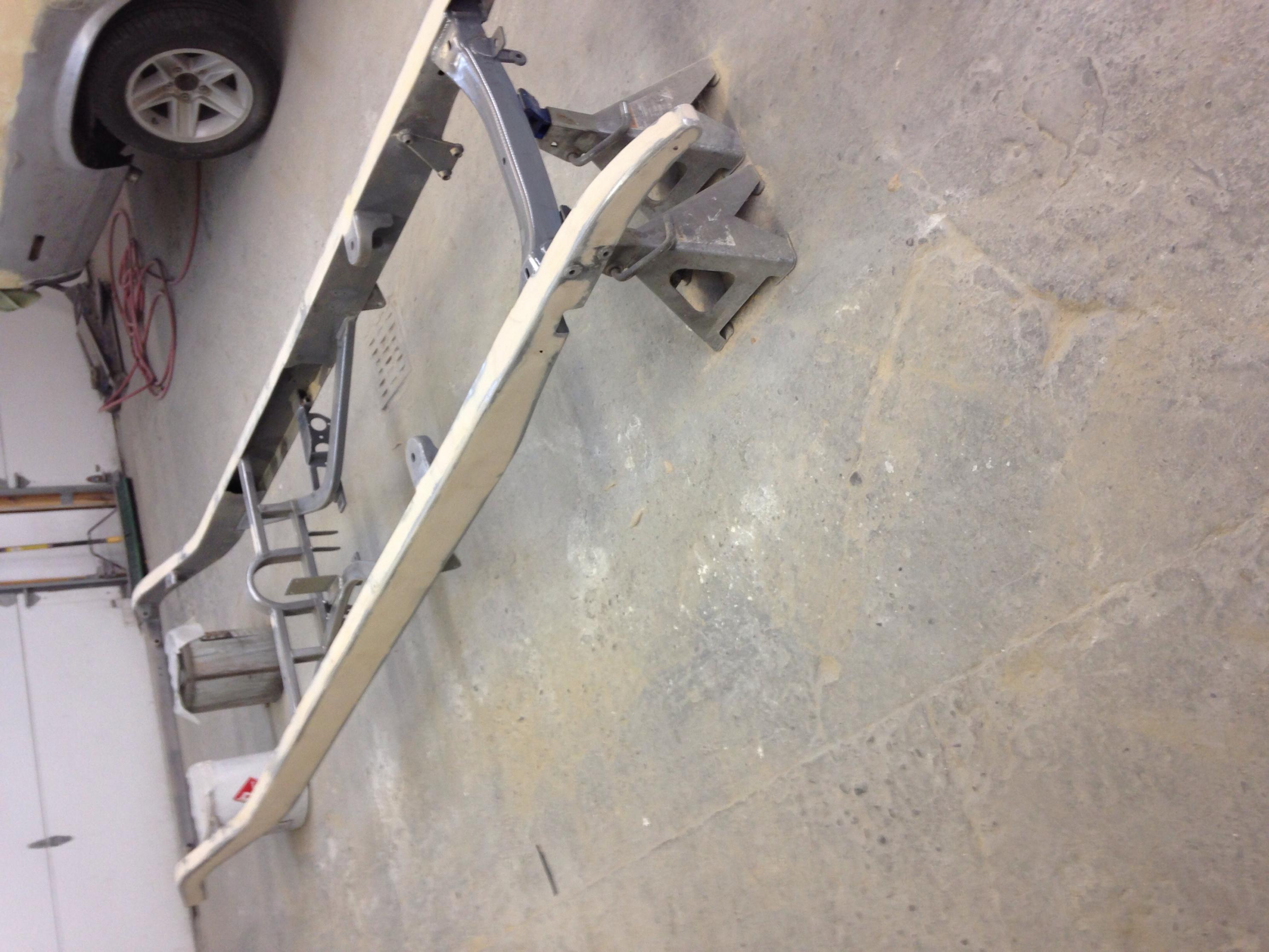

    well today I have reached a point that I wasn't sure would happen the frame is off to paint

  24. loudbang
    Posts: 40,342
    Are you going to be running any sort of plate or insulation between the top of the header pipes and the carbs? The way it "looks" now you will be boiling the fuel out of the carbs from header heat rising.
  25. gtowagon
    Posts: 406
    gtowagon
    I have heat shields for the bottom of the carbs and will be ceramic coating the headers so that should cut down the heat transfer. The carbs are actually out past the headers so that helps too I have talked to other people running this setup on this type engine and they haven't had any issues so I think I will be ok after all in the factory setup the intake and exhaust manifold are bolted together with an exhaust riser under the carb
  26. gtowagon
    Posts: 406
    gtowagon
    Well with the frame at the painters I got the m20 rebuilt and fitted with the mcleod hyd throwout bearing and got a driveshaft made
  27. gtowagon
    Posts: 406
    gtowagon
    Frame ready to prime tomorrow
