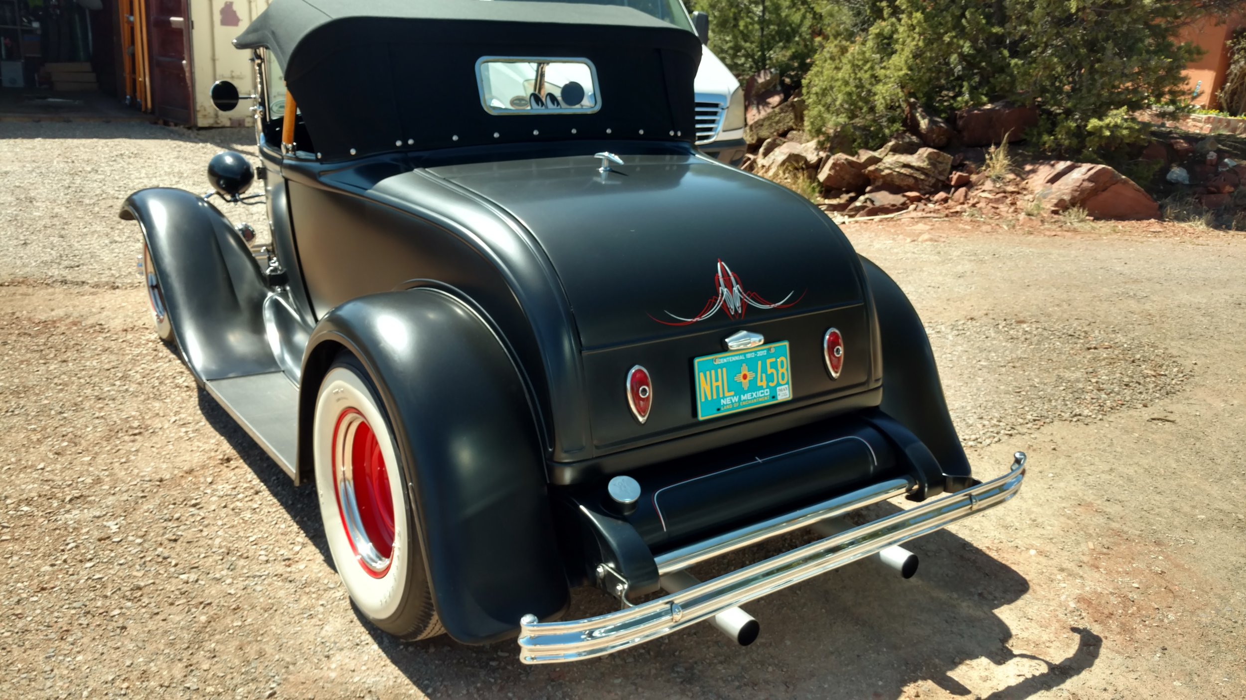

    IMG_4023.png When I did this one , I made my own
    Kit from 32 cut off's . Tank under father
    Higher , & little tilt for rake .

    Not for sure ,
    Your 31 rear shape @ bottom of body looks to be made different
    Then mine ,,,
    Yours looks more of a curve lower portion , Maybe looks that way because shinny pair , & silver reflecting making in a optical illusion..
    I do not know enough about that part of rear body panel same ...
    My tank I made EFI before they where made , I was unable to stick father under , there was a body brace , & I did not want to modify to clear pump & I was using # 10 high flow smooth feed with # 8 high flow smooth return.
    Also I made fuel pick up inside towards rear so pump did not starve for fuel on hard accelerations .
