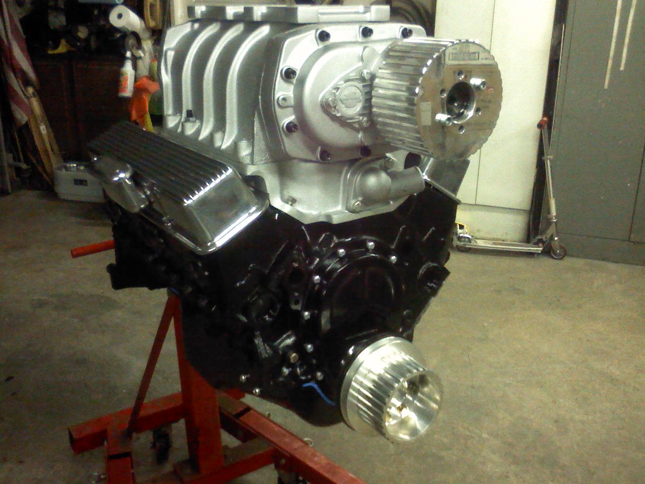

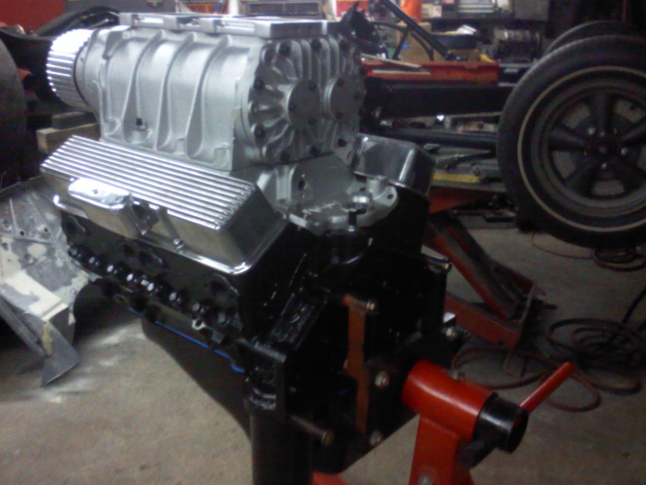

    A bit of an update..
    331.
    For those of ya that just hate the sight of a small block chevy, sorry..ok, not really :D
    Although i love the early Fords, i'm a Chevy guy to the core..and i love the early 327's..
    I did try and keep it all in the 60's era though because i'm strange like that.
    63 block, 65 heads, 67 GMC blower, Mickey Thompson valve covers with Offy breathers..the insides, that's a whole different story.
    Picked up the heads tonight from Big Chief. A mutual friend does my machining and brainstorming with motors.
    The long block is just about together, just have to get the valve train finished up and lash the valves but i couldn't resist putting the air pump on it!
    I have to machine down the upper pulley yet as i'm running a 2" drive set up on it.
    Big Chief, these were well before midnight. :D:D
    Tony

    Sweet looking mill to go in a sweet looking car.

    Man such a mean looking car, sorry to see you kinda puss out on the engine. Hahahah!!! Holy shit! Awesome!

    Hey Tony. Glad to see you are putting those valve covers to good use. They look much better on your engine than on my wall!!!!!! Keep it up man! Looks fantastic!

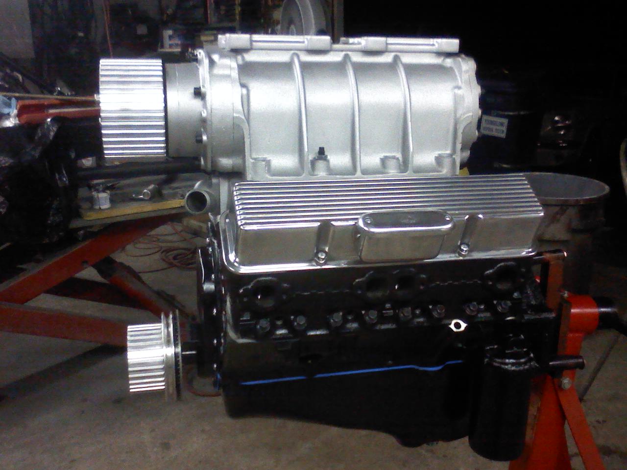

    Gettin' closer..
    finished up fab'n the idler stuff and ordered the belt today too..
    VROOM VROOM! hahaha

    Is that blower satin finished, or does it have a coat of paint on it, or maybe glass beaded? Thanks, looking good.

    It's an original as cast case i glass beaded, then dusted with aluminum high temp paint that matched the intake. The intake is new, and raw aluminum and it was just about a perfect match.
    After beading it it was clean, but not at all uniform so i had to do something to make it match the intake. It's brighter in the pics than in person.

    Thanks, I have seen a similar process done on the Web, looks good. They say it's MUCH easier to keep clean from has stains than the raw satin.
