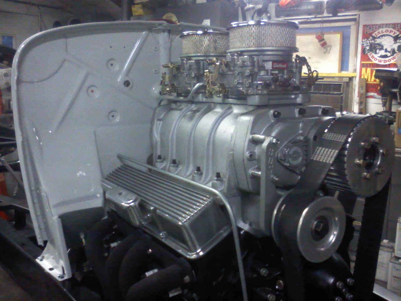

    These are 500's. As of now there are no mods done to them, but i havn't fired it up yet either.
    I ran the same set up on my old 32 with a 6-71, and didn't do any blower mods to them, just tuned them to run good. Took about a week and a half to get them dialed in, but once i did it was perfect. That car started and ran as if it had a 2 barrel on it.
    I KNOW i fattened them up a lot from the base line factory settings, i just can't remember what i ended up at in jet and rod sizes.
    It ran so good i'd check the plugs from time to time, but ran the same set for 3 years or so..
    I ended up changing them just to get new ones in it.
    I'm going to try and do the same with these with hopes of the same result.
    I'll let ya know how it works out once i can drive it.
    Tony

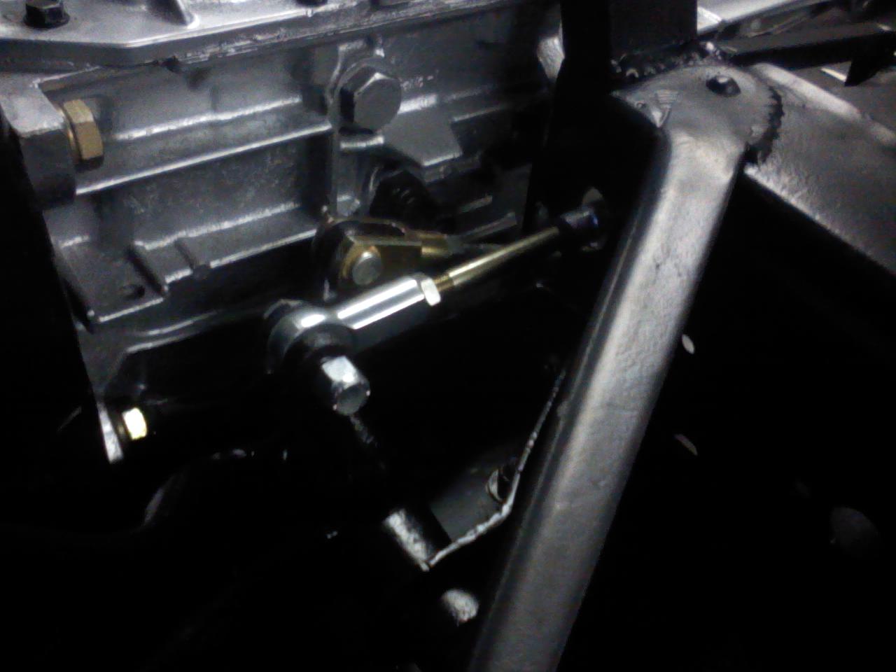

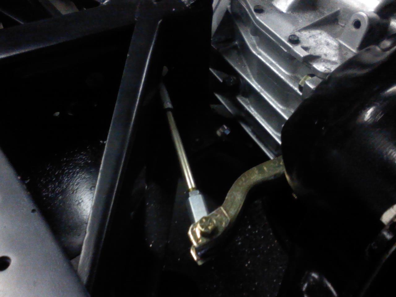

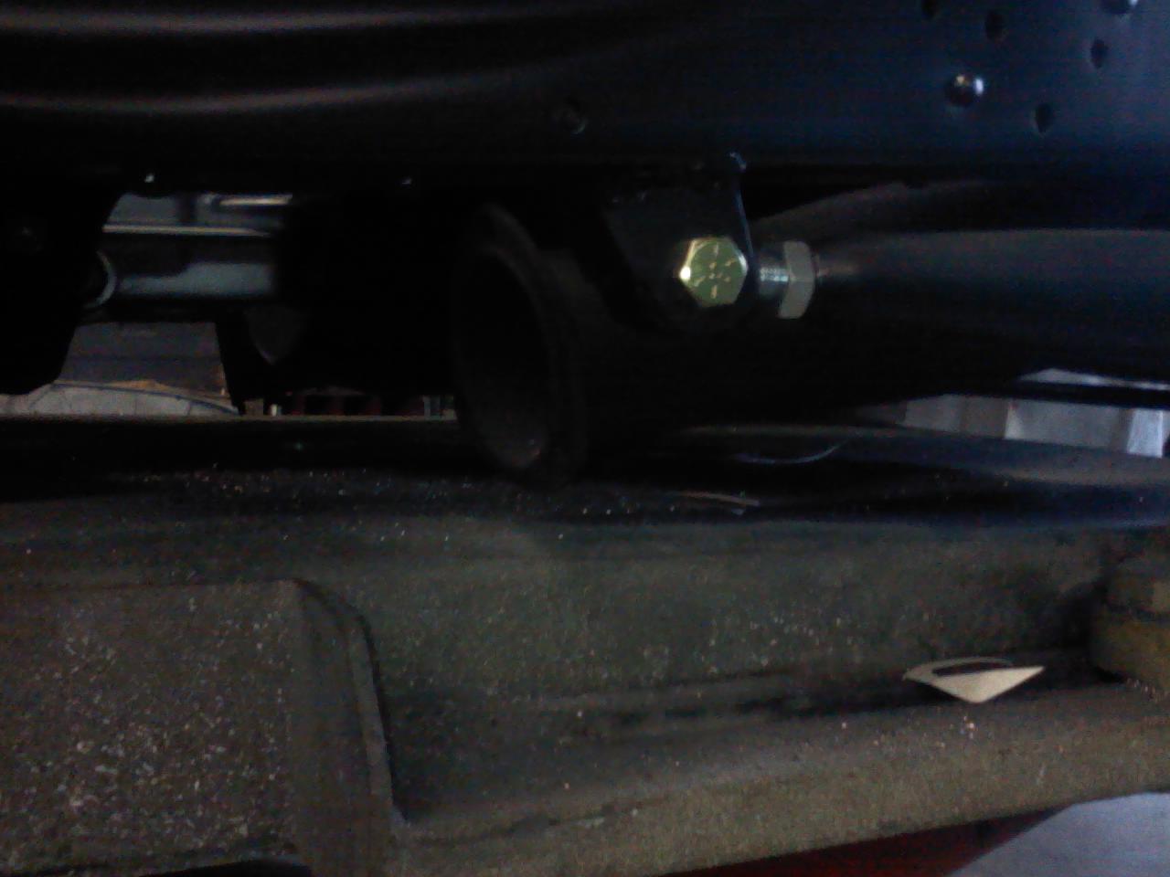

    I finally have a actual working clutch!
    As some of you may know, i switched the clutch fork to the p*** side for clearance..and decided to make it a cable actuated set up.
    After a ton of thinking about how the hell i was going to do this...I finally came up with the final idea.
    I ordered a push-pull cable from Orscheln to the specs i came up with. Not cheap, but well worth the money and an extremely nice piece.
    As i normally do, it's freakin' way overkill but i never have to worry about it breaking!
    Had to cut and move one of the eyelets on the clutch pedal to fit the rod end, and make some adjustments to my trans crossmember, but it's all in and works. Just need to final adjust it once i can drive it.
    The rod ends are 3/8ths and the cable dia is .260..plenty heavy duty. hahaha

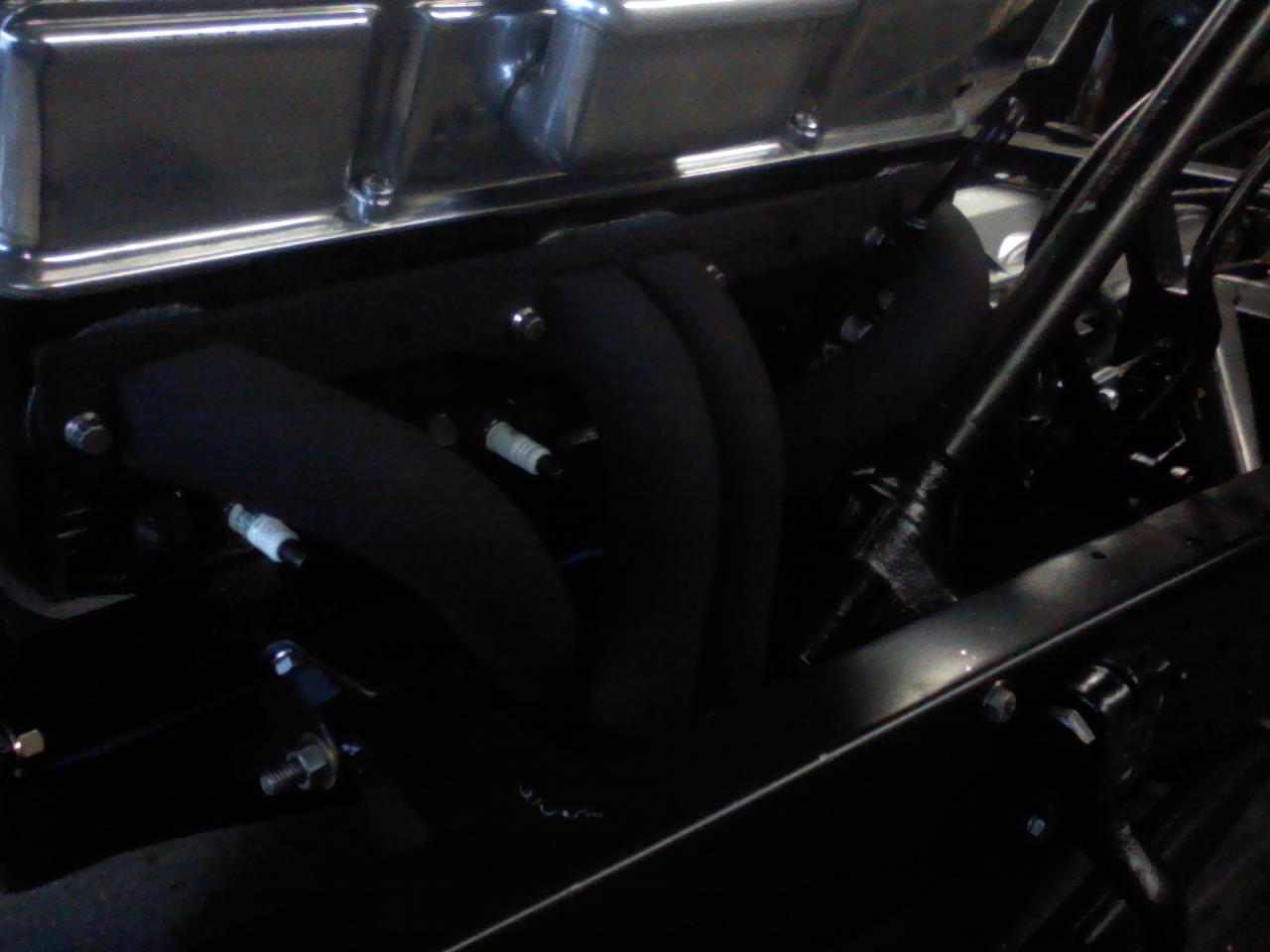

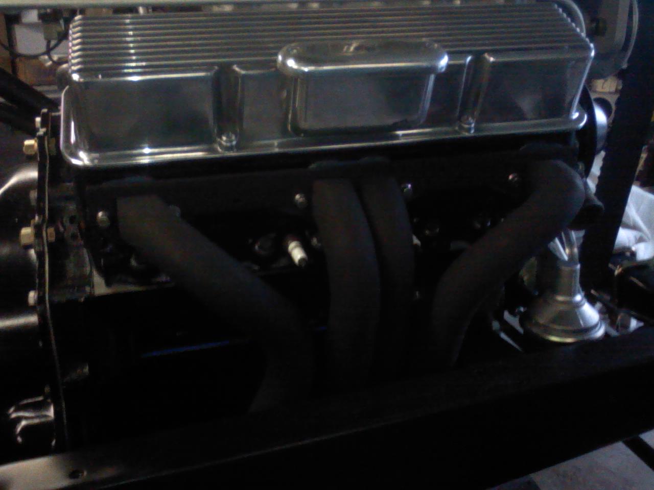

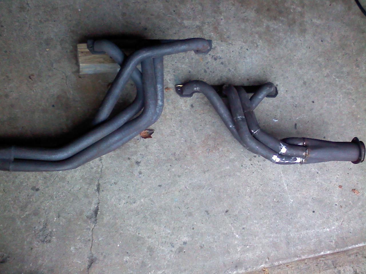

    Also hacked up some old headers i had on my 57 years ago. They are 1 3/4 tube which is what i needed for this. Finding a pair that would actually fit this car would have been just about impossible..
    The ones i had were smashed pretty good on the lower tubes 'cause i had the 57 real low at one point.
    So, i cut em up and ***embled them to fit on this. The one pic is the original p*** header, and the "new" drivers side together.
    It's on the lift in the pics, so the collectors look real close, but they are actually even with the ****ter shield..and about 4+ inches off the ground and above scrub line.
    Sorry for the poor quality pics as usual. cell phone cam.
    Tony.

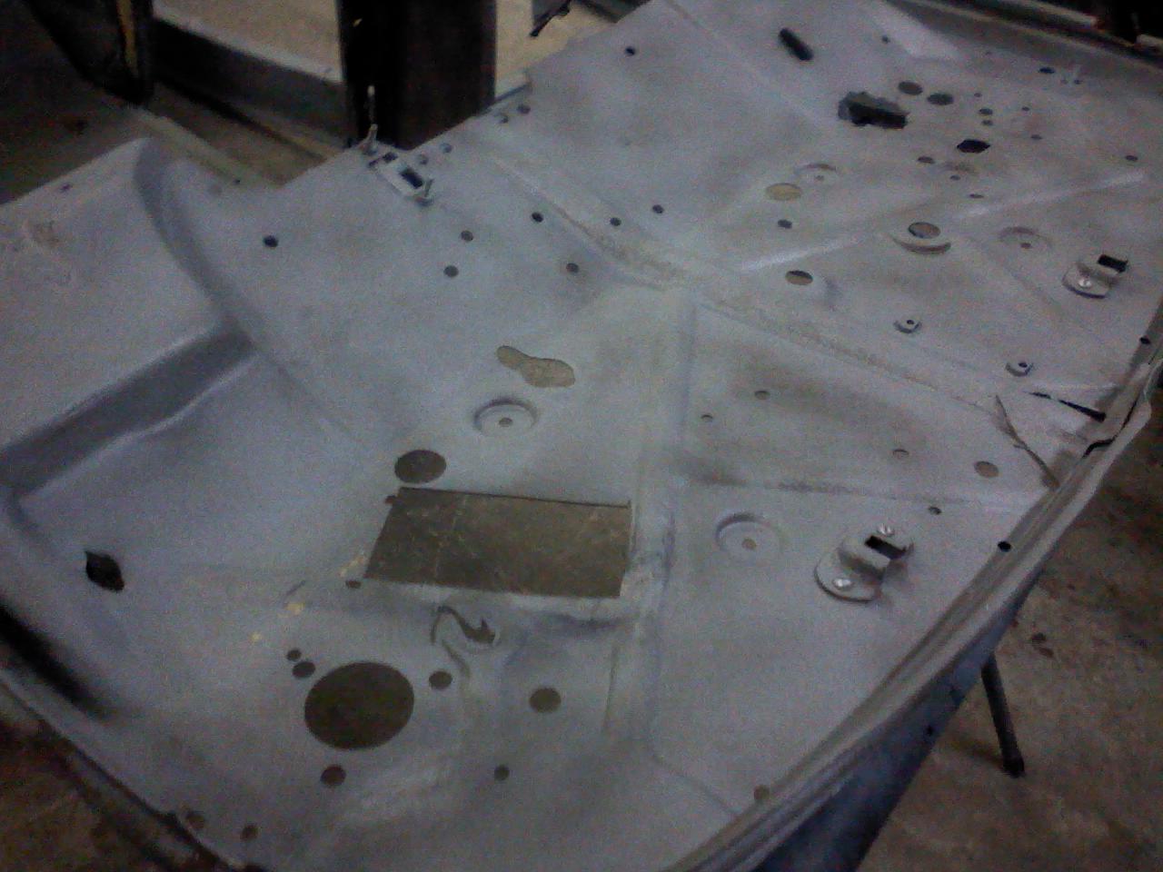

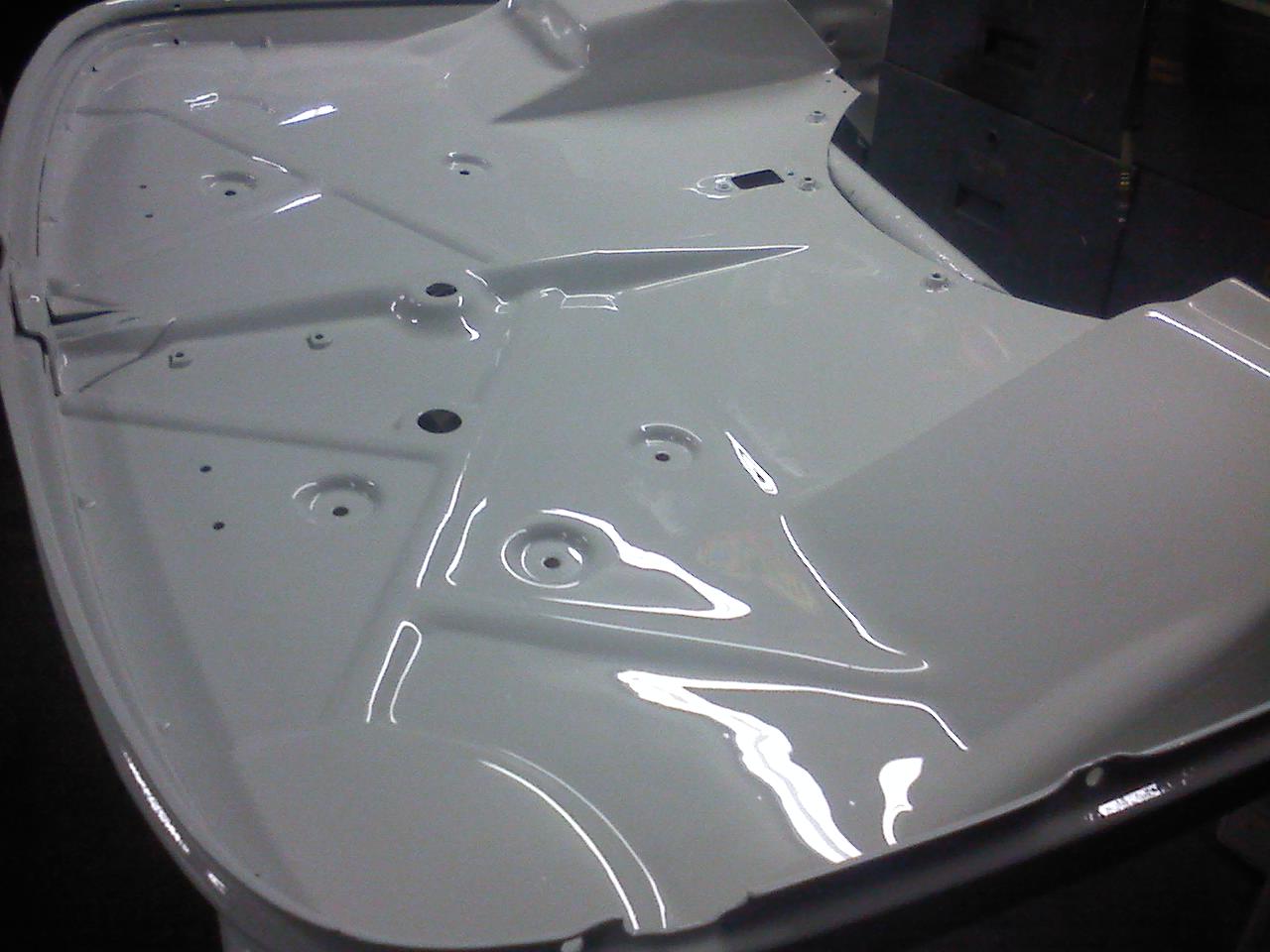

    The patchwork firewall is smooth and shiny....couple small thing's to do to the ch***is over the weekend, then it's on to finishing the body so i can put this damn thing together.
    Tony
