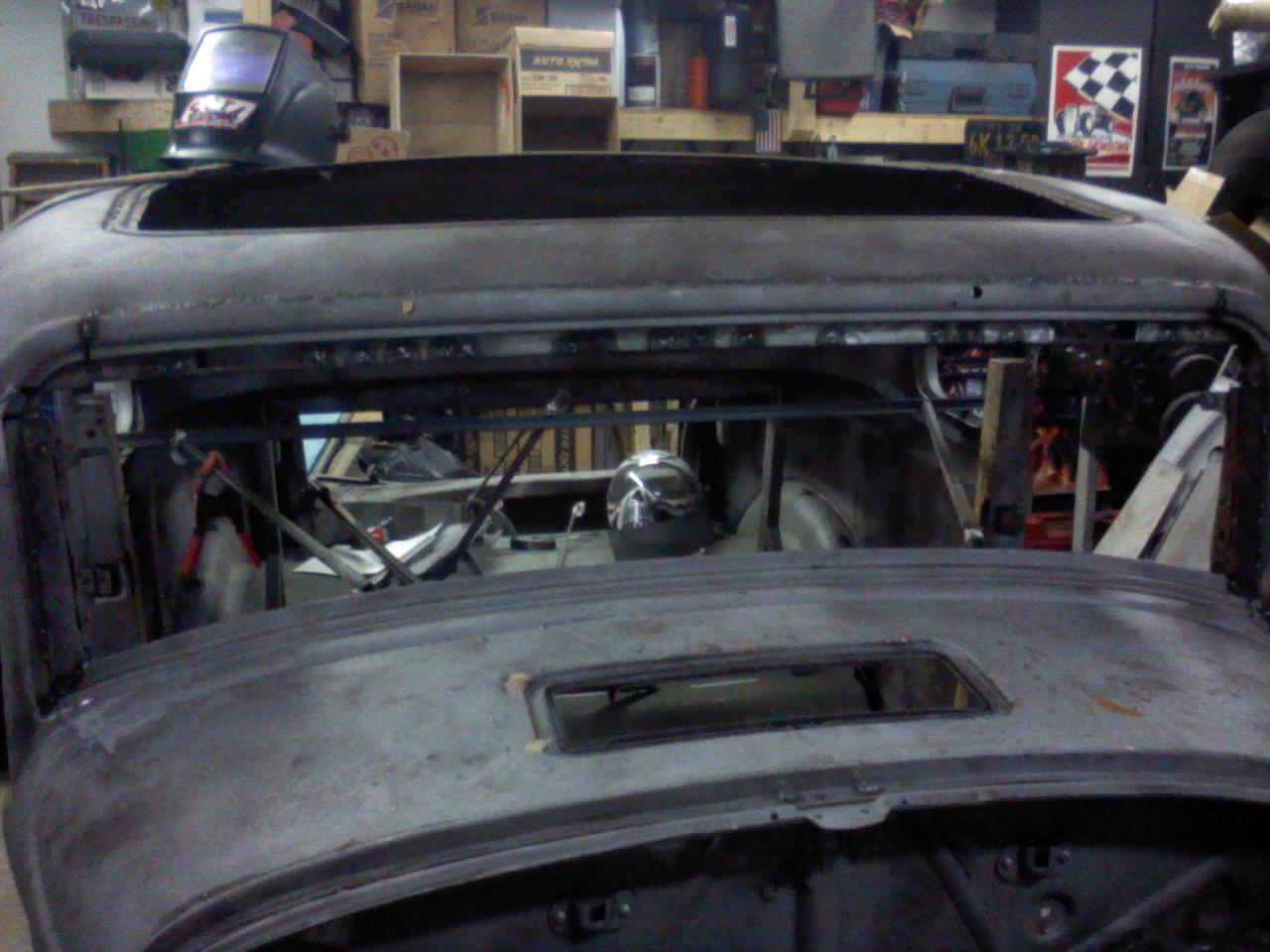

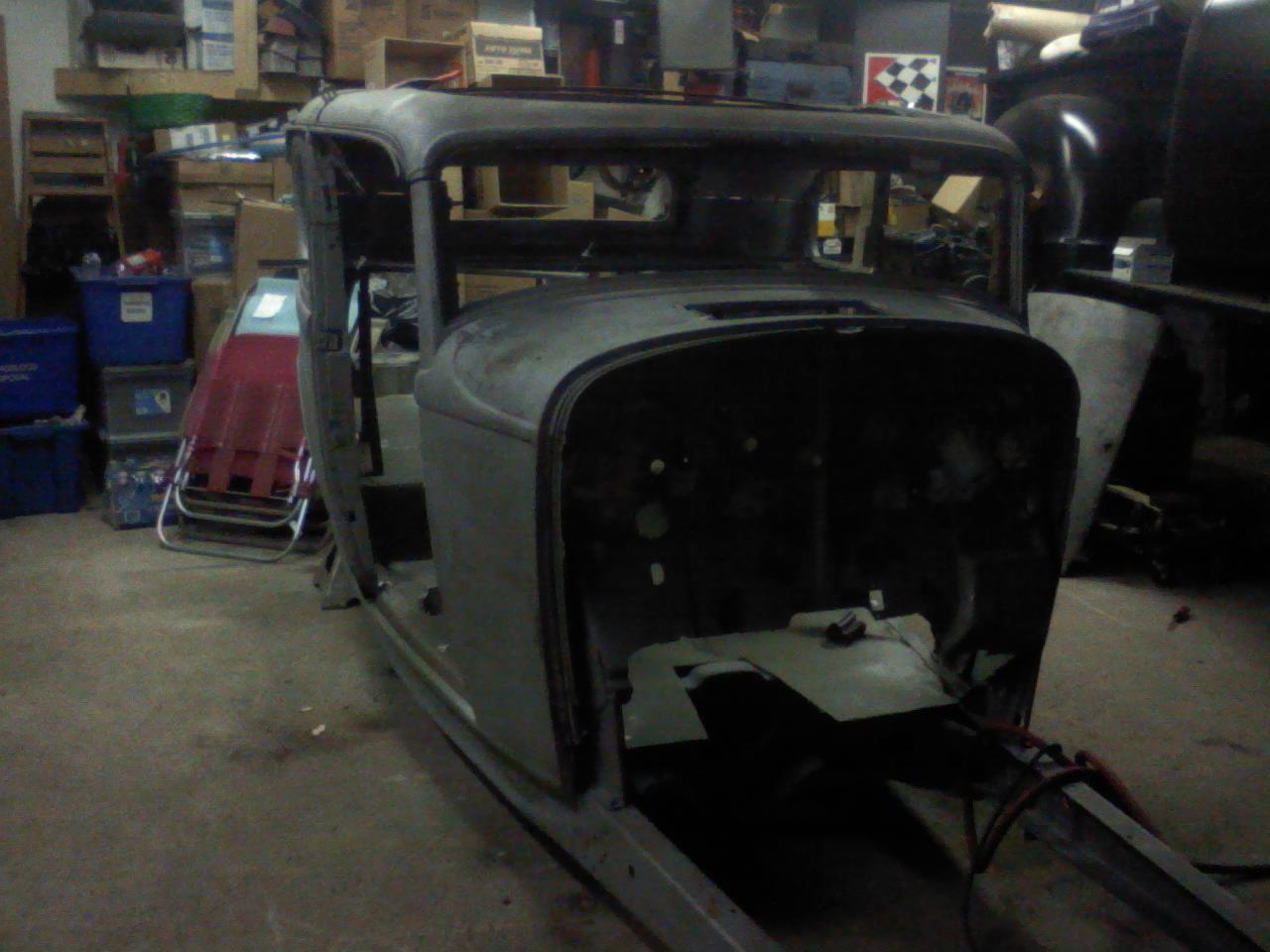

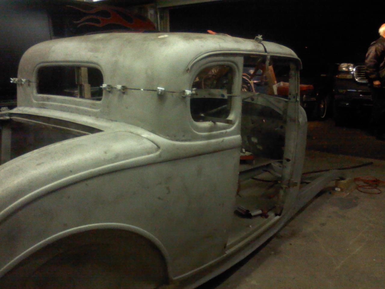

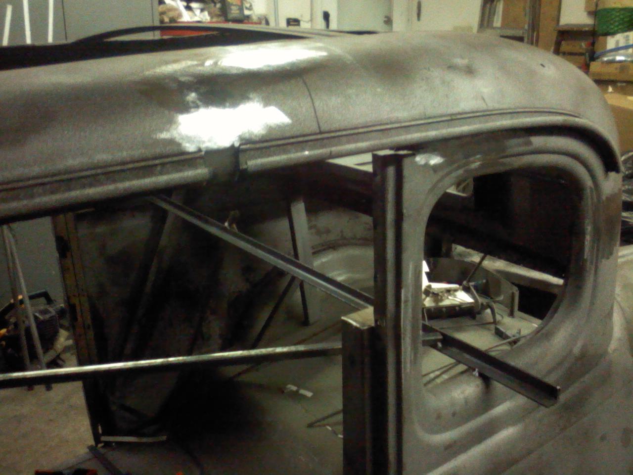

    I've decided to turn this thread into a single build thread like a lot of guy's are doing instead of multiple. At least for now until it actually looks like something.
    Sooo..
    I'm at a standstill with the ch***is til i get the rest of the parts delivered, and rather than waiting figured i'd get back to the tin.
    Tonight, it got a hair cut.
    I love the look of both chopped and unchopped 32's, but if i'm going to own and drive it, it's got to be chopped. Simple as that.
    So, i bolted the body to the frame with the firewall in place, hung the doors and ran some bracing.
    My original thought was 4", but for some reason that changed when i started to mark it off.
    I went with 3.5" straight across. I like it so it's just staying there.
    Pretty typical chop really.
    Tomorrow i have to fine tune the fitment, and start tacking til it's together and everything is "right". then weld it up.
    It's just set back on basically in these pics.
    I should have the chop done by Monday night.
    Thats about it for now.......back to your regular schedules program.
    Tony

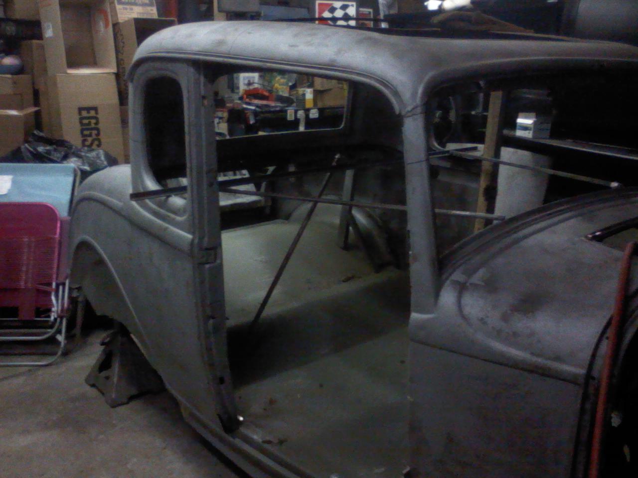

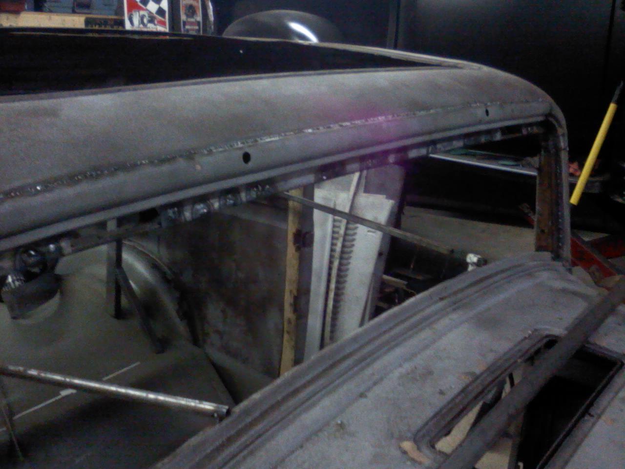

    Thanks guys. I got it all tacked in place.
    The header face was rusted so bad i just split it from the inner brace then put them on separately. I have another header section i'll be grafting into mine so it just made more sense doing it that way. Plus, i was able to get some real good welds on the inner, heavier metal before attaching the outer skin...and replaced the cage nuts for the windshield hinges too.
    Heading back in a few hours to keep going. Should have most of it welded together tonight.
    Then tomorrow i'll do the doors and grind what needs to be cleaned up.
    No pics yet......
    As for the stance, i understand exactly what you mean JJ. The car will be lower than the typical one simply because of the Z out back, but it'll still have a rake to it.
    As much as i hate the thought i may have to remove the K member once i get the suspension set up. I have a feeling it's going to be 3" or so off the ground at it's lowest point. Not good that low int he center of the car. It'll hit everything. lol
    Time will tell though.

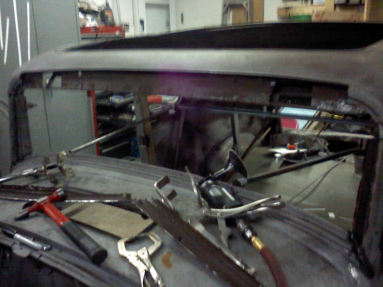

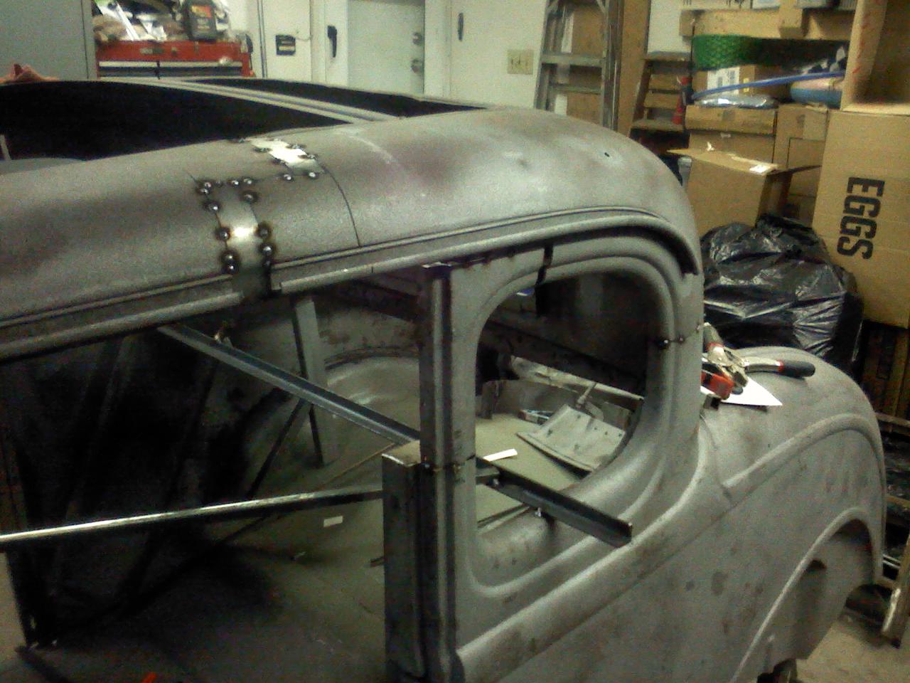

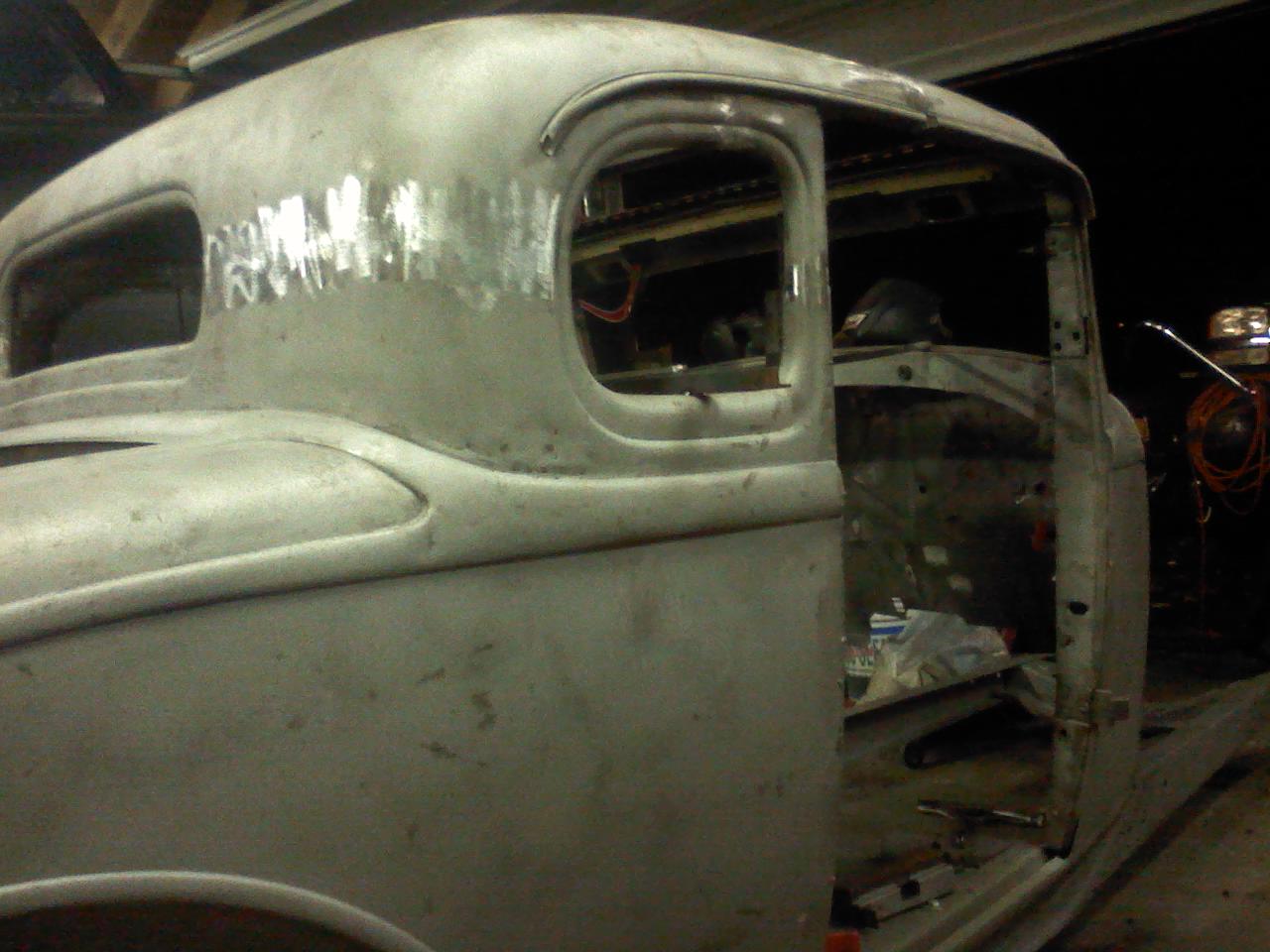

    I really thought i'd be further along by now but i had a bday party to go to so had to stop on the car.
    Anyway, here's some pics from today's progress.
    Tomorrow i'll finish up the small fillers needed in the quarter window area's, final weld everything and grind..
    Then do the doors.
    Please pay no mind to the booger welds at the top of the A pillars. They are from a poor attempt at a previous repair from past owners. I'll get to them when i do the header.
    Tony

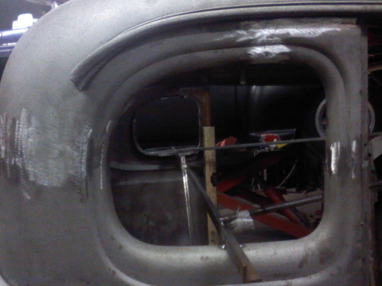

    Well, i slid it forward and made filler's for it. Not a big fan of 5 windows with leaned A's. If i'd only known before i welded it back together! :D:D
    Seriously though, thanks Slepe :)
    Jeff, thanks a lot man. Your's in coming along super nice! I'm really diggin' it!
    I read you wanted to run a blower but with V belts..I'm with ya.
    I have a GMC 6-71 with a 3" Gilmer that i'm really considering for this, but like you would much rather have a V drive on it instead.
    Back at it shortly. I won't bother posting more chop pics til it's done. It's not like this is anything new so no need to bore anyone. It's just another typical 32 chop.

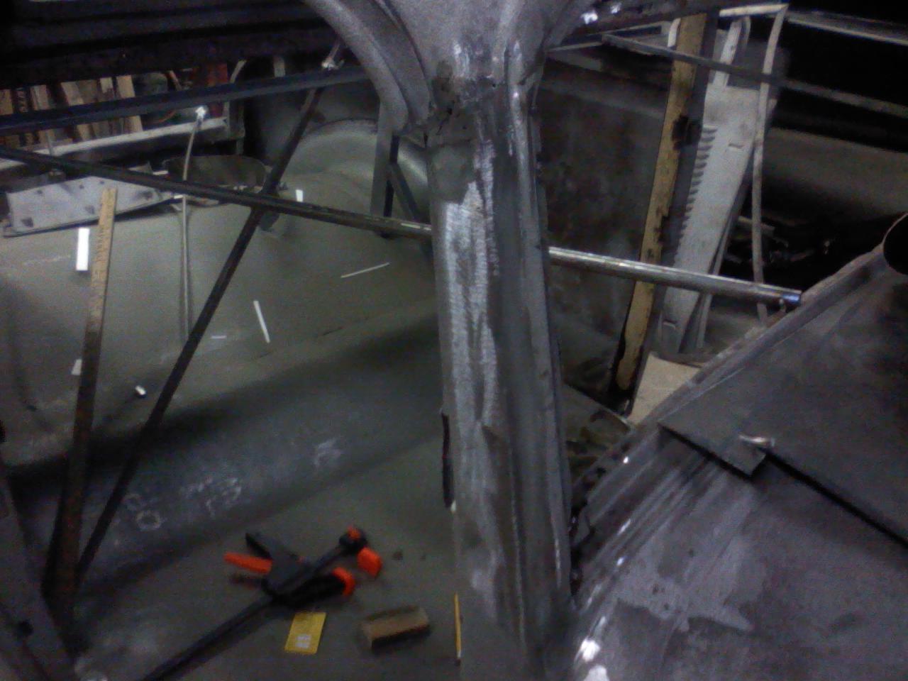

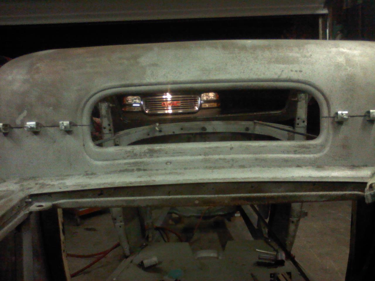

    Well, aside from the doors and drip rails, this part is done.
    Guess i didn't expect to be this far so soon which is why i said i wasn't going to post the pics til it was done. huh....suppose that's good. haha

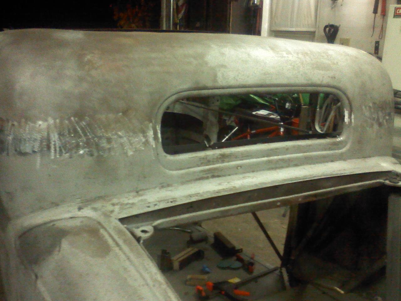

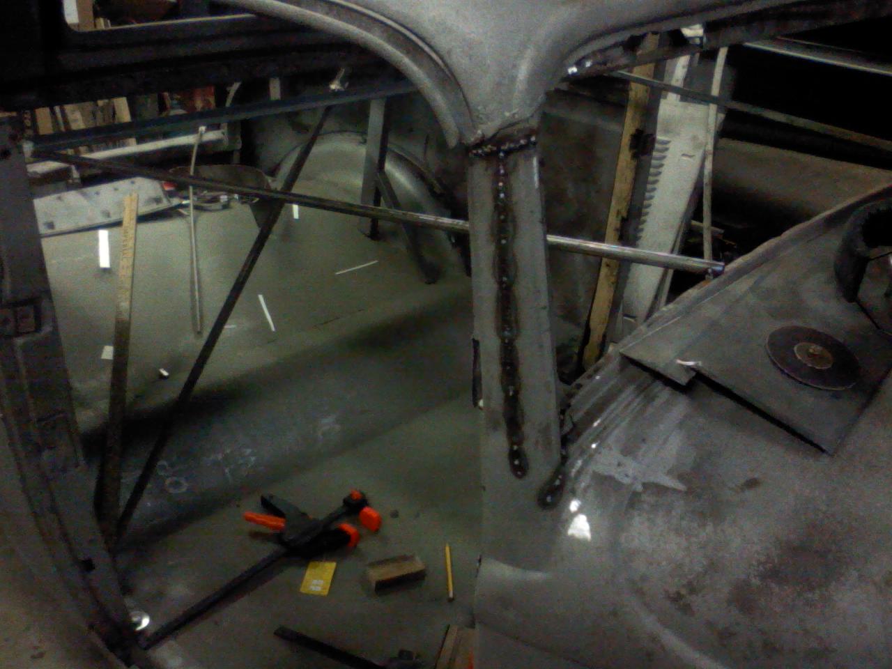

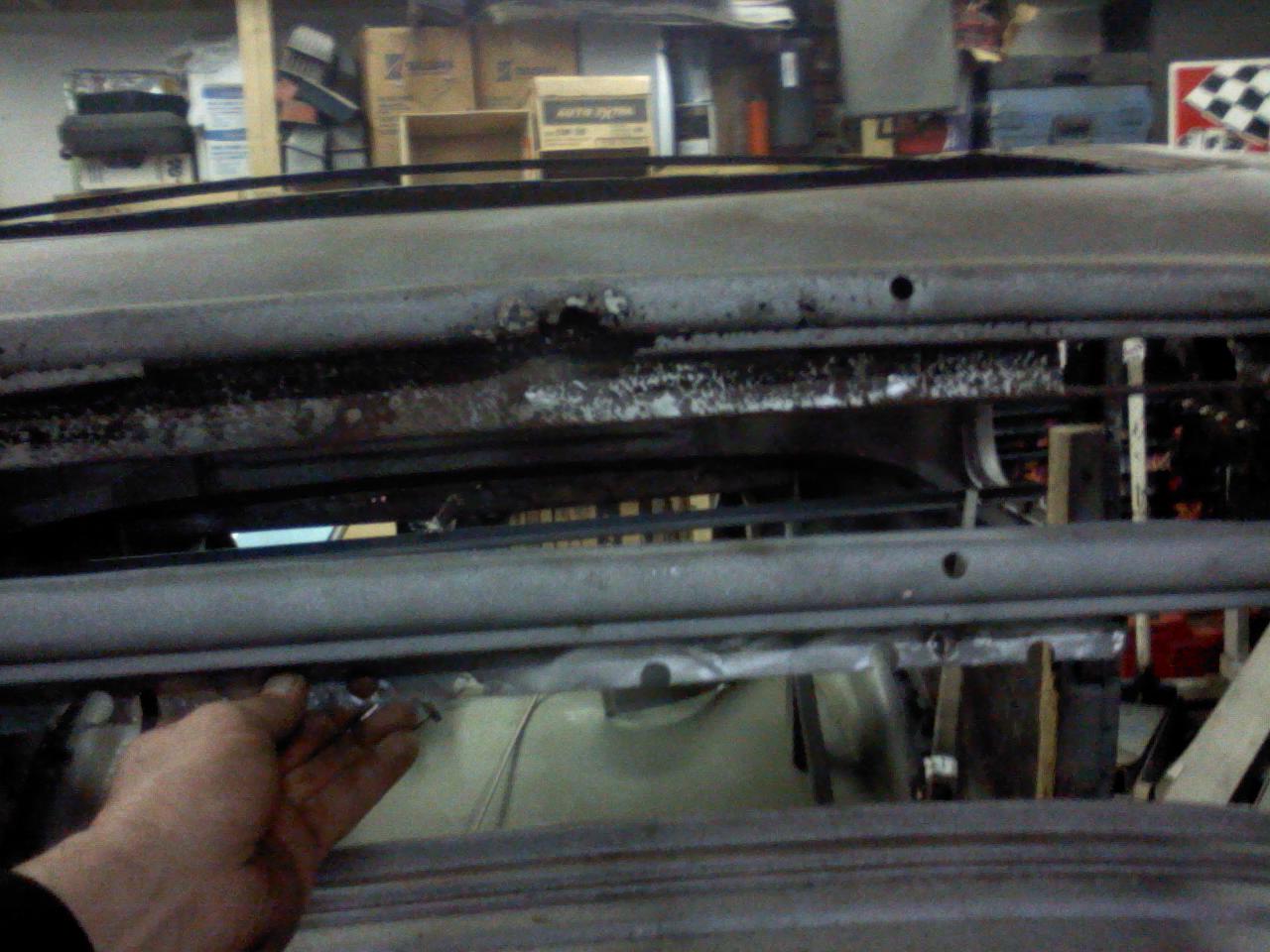

    tonight i got around to the rotted outer header panel.
    I was LUCKY to get a section of an original 32 header off another HAMBer a couple weeks ago that was just about exactly what i needed.
    The outer section of mine was wasted below, and a little into the reveal area.
    It was probably the biggest headache for me with this body simply because of how complicated that area is and not having any luck finding a repair section....til last week anyway.
    Just need to finish up the corners around the window frame, grind, then it's done.
    I cut the window frame already to check fit while i was putting it back together, but need to finish that up yet.
