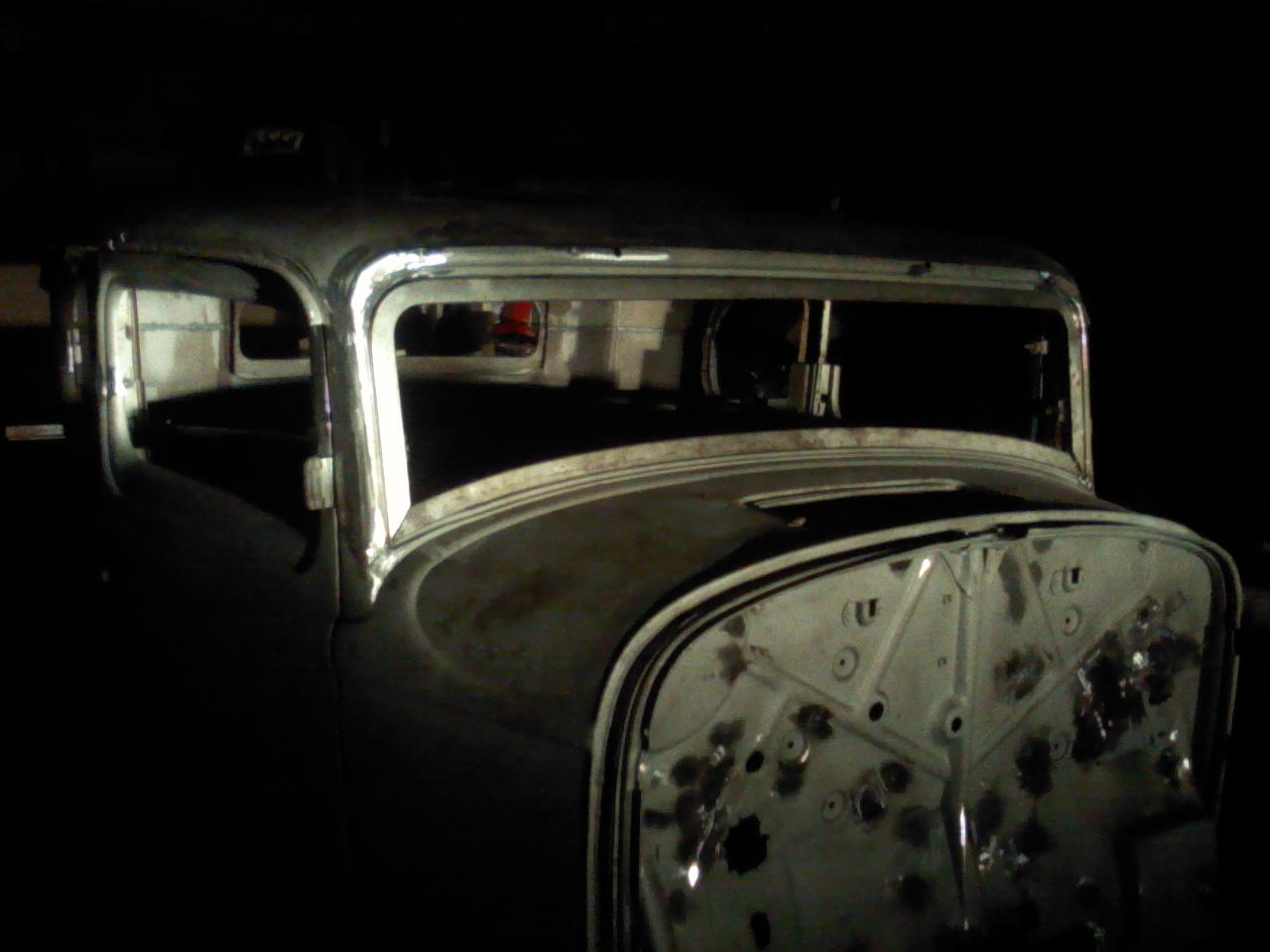

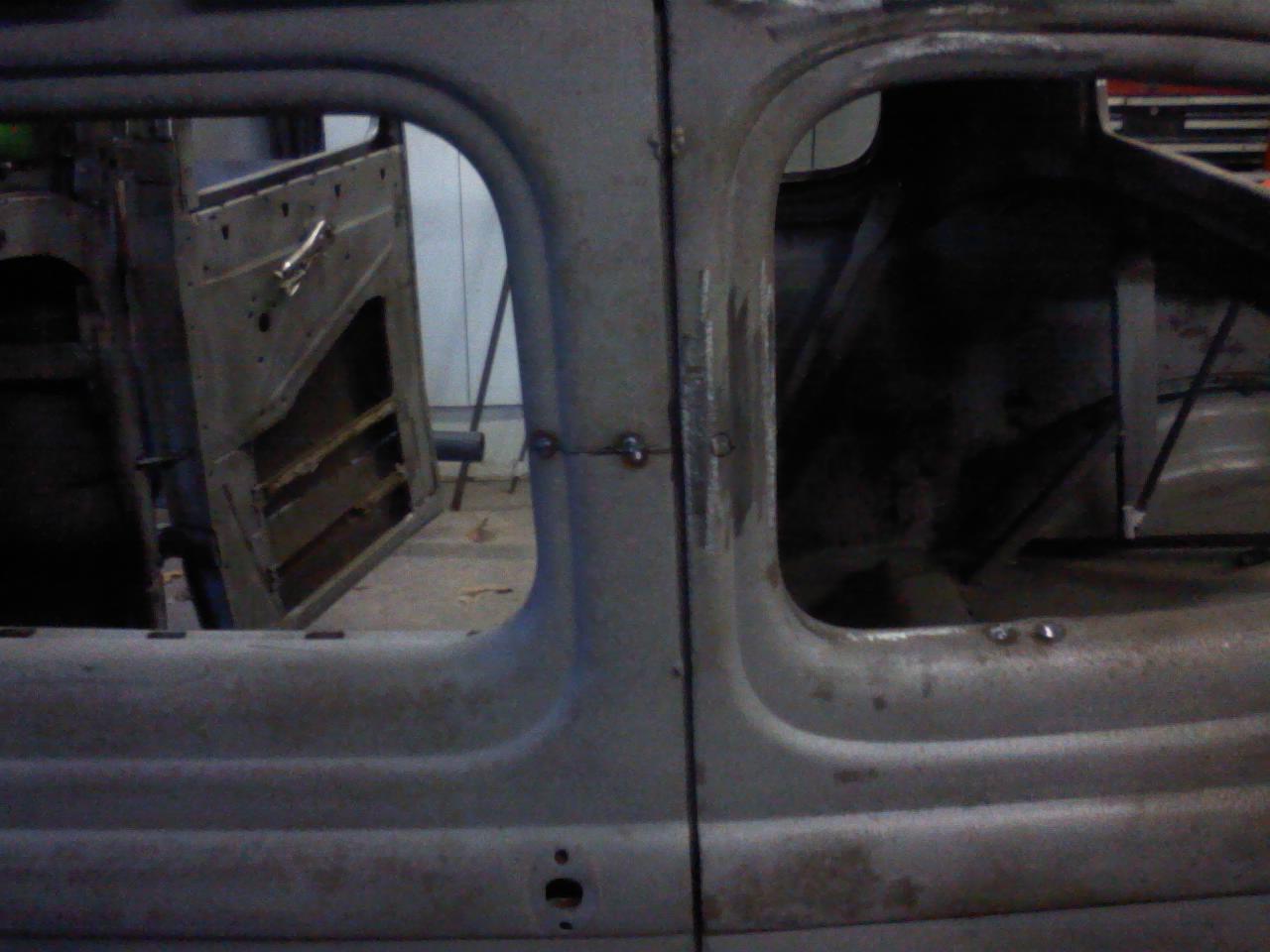

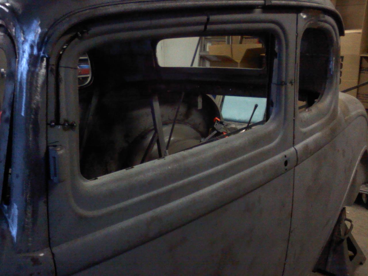

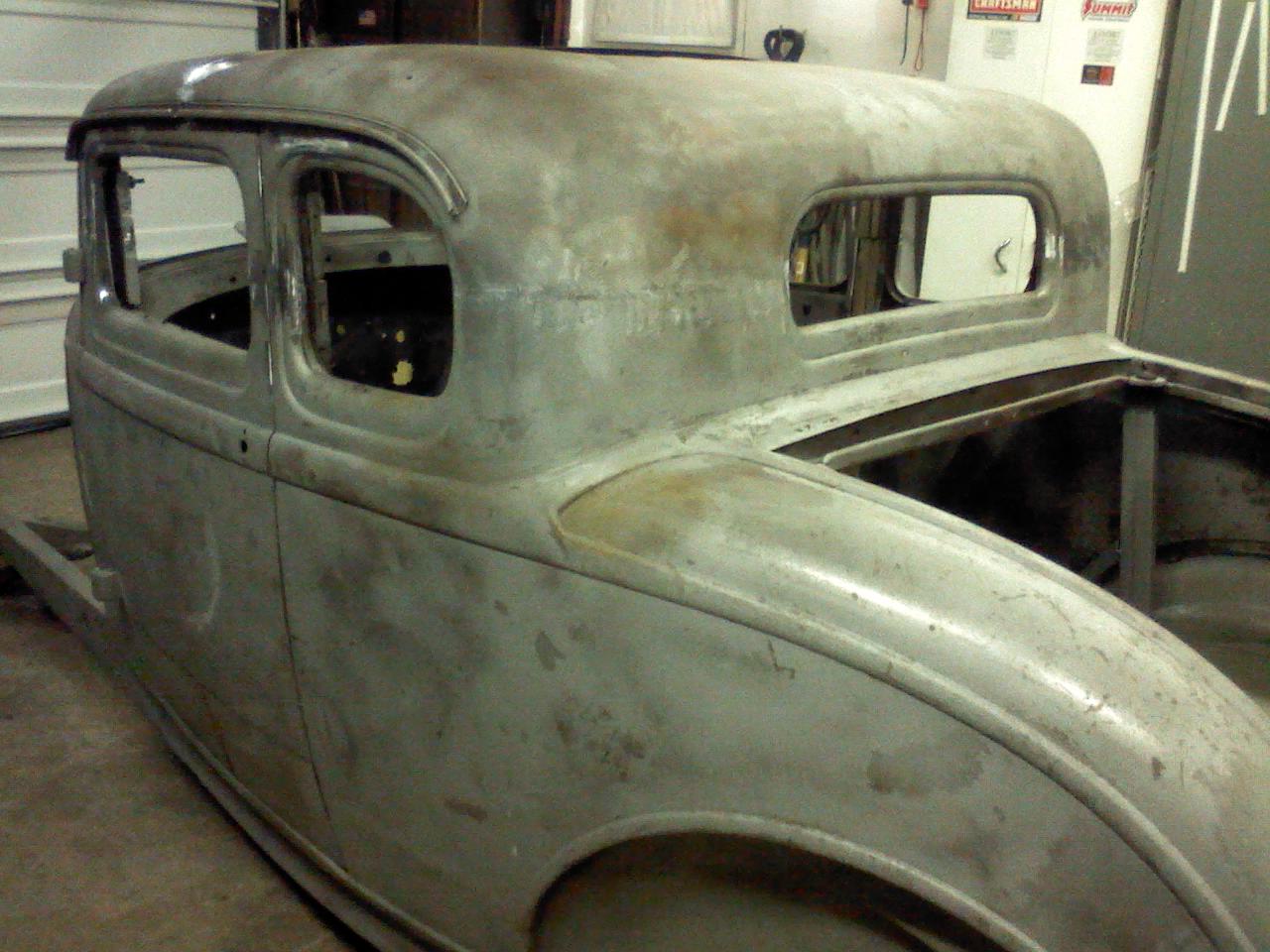

    Started the p*** door last night.......
    Just about done now, but i gotta say it's the pain in the *** of the chop.
    The main roof, simple...The front upper part of the door, not so simple.
    Had to do a lot of work to match the upper and lower section of the door's A pillar and reshape the forward curve to fit the new roof. Easiest way i could think of was to break down the whole A pillar and build it one piece at a time.
    Actually worked well because i was able to weld each piece fully before putting the outer sheet metal back on. Super strong.
    I'll finish cleaning up the welds tomorrow, and hopefully get the drivers door done too. I cut that up before i left tonight.
    Also cut the windshield frame to fit. a whole 6.5" of gl*** in the center. :)
    You can also see the **** LOAD of holes i filled in the firewall too. Still have some left to do..some troll went nuts with a damn drill on this thing.

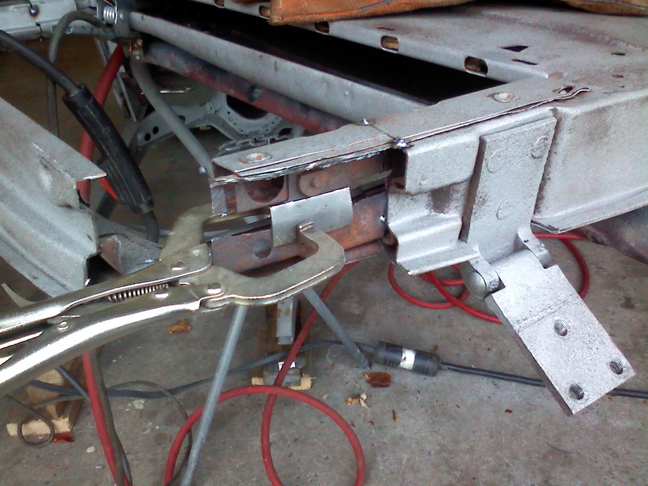

    Jeff, i had no lower outer skin, or lower inner panel on either doors. Luckily the jam area of both doors were real good though for some odd reason. so i just had to replace the inner and outer but was able to retain the jam area's on both doors.
    Incidentally, both my doors had galvanized panels riveted on as lower outer skins too..:D

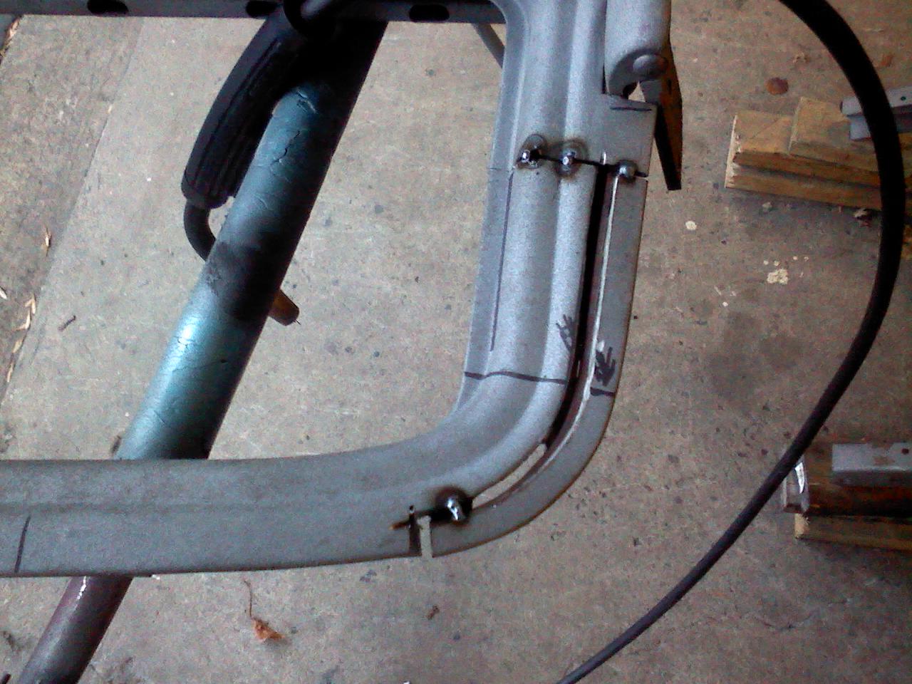

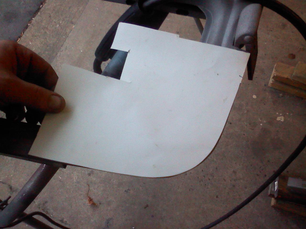

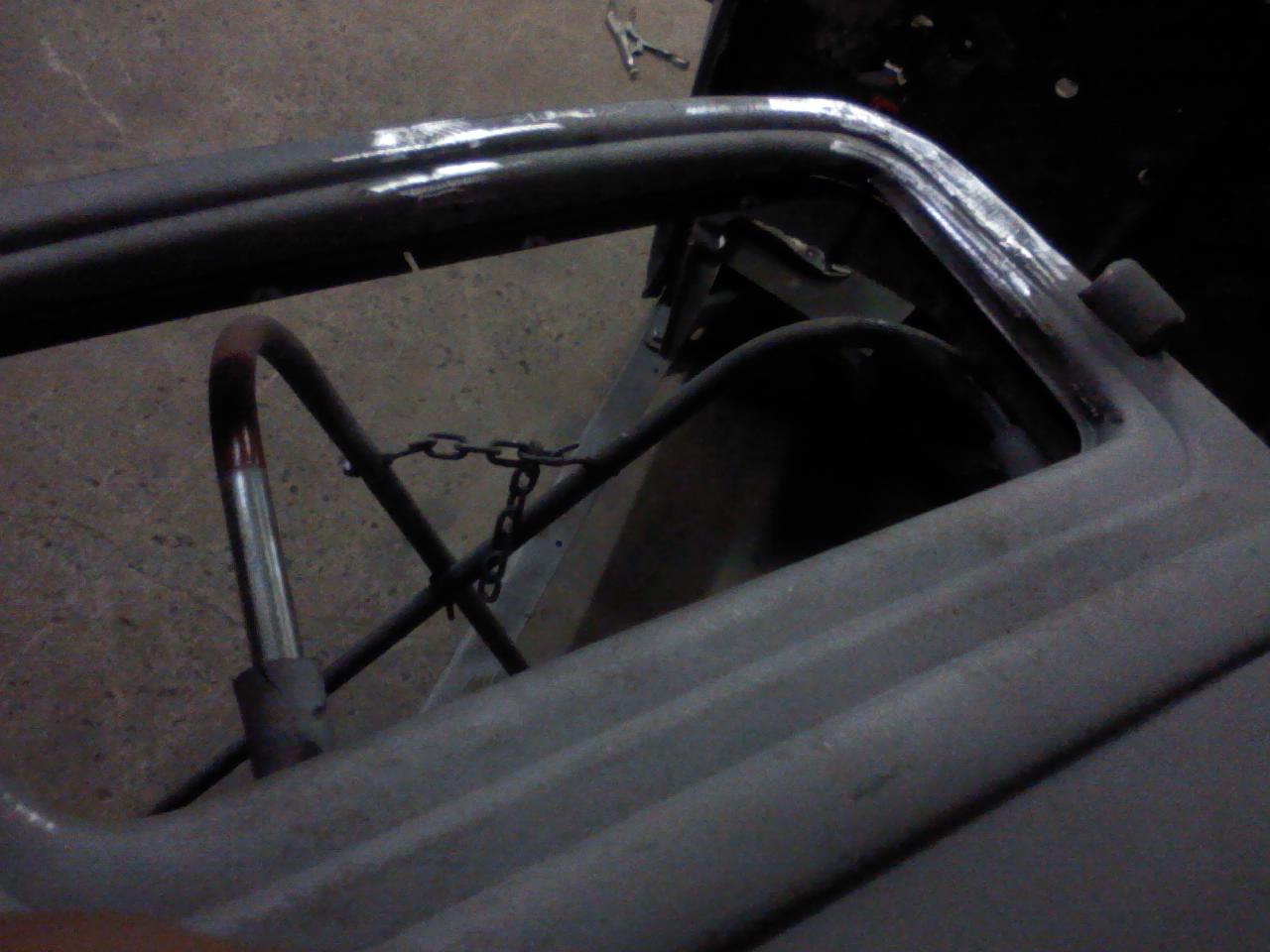

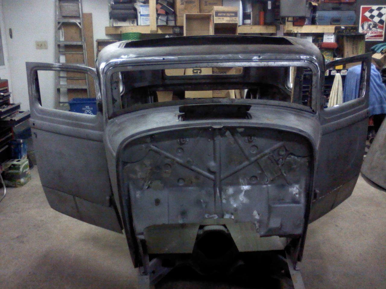

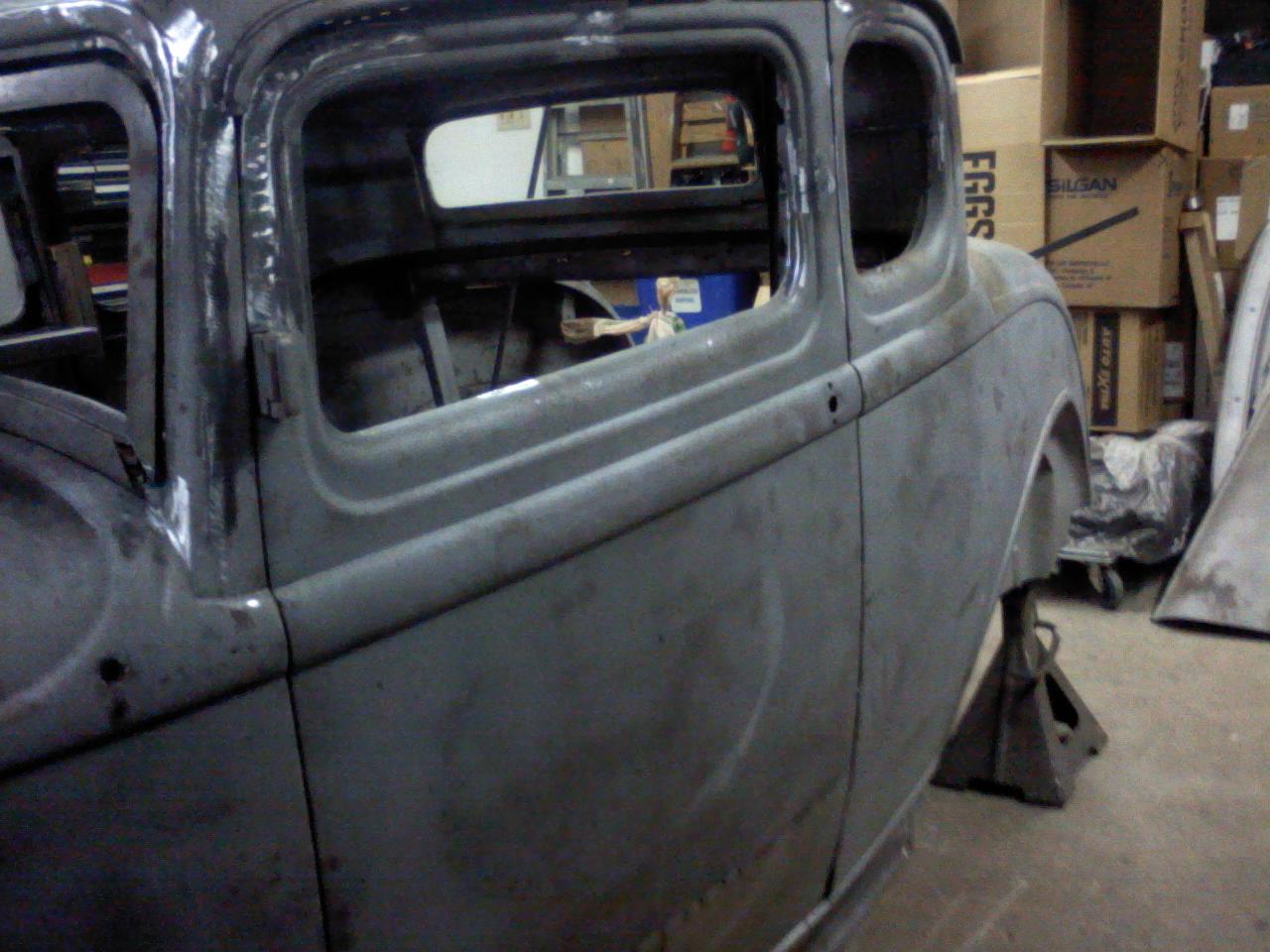

    So, today i finished up the p*** door and got to the driver's side. I'd have that done too but i ran out of gas for the welder. ****s, i'd rather run out of gas in my truck than my welder.....haha
    Anyway, this time i took a few pic's of what i did to the front upper curve of the door. I had made a template of what it had to be when i did the other side, and obviously used it when i did this one too.
    I have to make the filler strips for everything yet, it's just crudely tacked in place to make sure fitment is right. Must have had the doors on and off this car 100 times with with rebuilding the floors/rockers, and now this..
    Also got on of the door gap. i'm **** with **** like that so it's gotta be right. lol
    progress pics of the day.
    Thanks again for the kind words and encouragement.
    Tony

    Yeah there really is. I forgot about some of the thing's that are involved since the first one. Like in each window opening, aside from the rear, the sides needed to be cut and realigned with each other. The lower's are wider than the top because of the original taper stamped into them.
    Probably be more forgiving on a light chop like 2", but that extra 1.5 left me with about 1/8" difference between the upper and lower parts where they mate up.
    It's not only important for the visual, but also for the gl***.
    fun fun fun :)
    Thanks guys. Tomorrow i have to take off from it but Tuesday i should have the chop DONE! about a week and a half's worth of work and it's got a whole new at***ude. i love it! :D:D

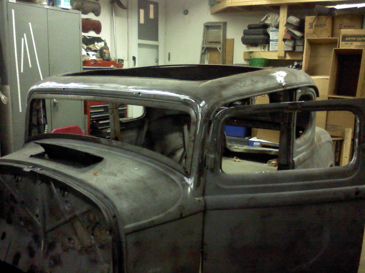

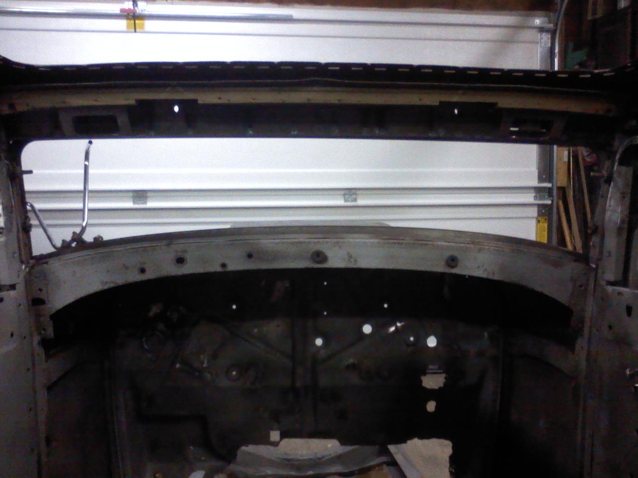

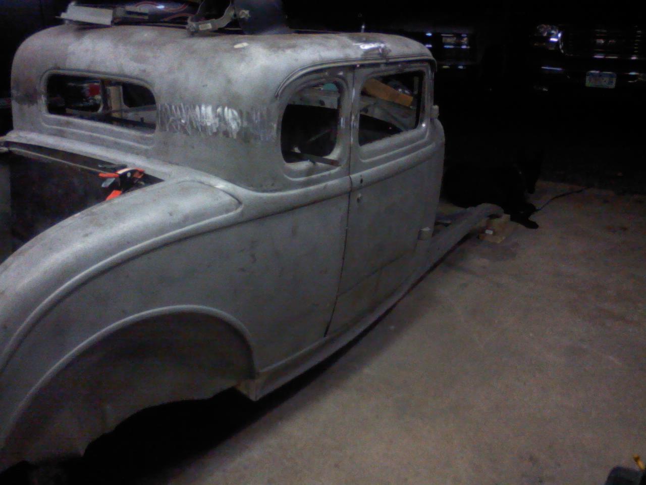

    Aside from the 2 little pieces of drip rail i have to make and weld in, this part is done.....
    so, here's the ten day chop..
    Tony

    What a perfectly proportionate chop. It's sinister and evil but looks very balanced. That's what I would like mine to look like.

    That is how mine was done many years ago...they also added to the gutter. Looks very nice.
