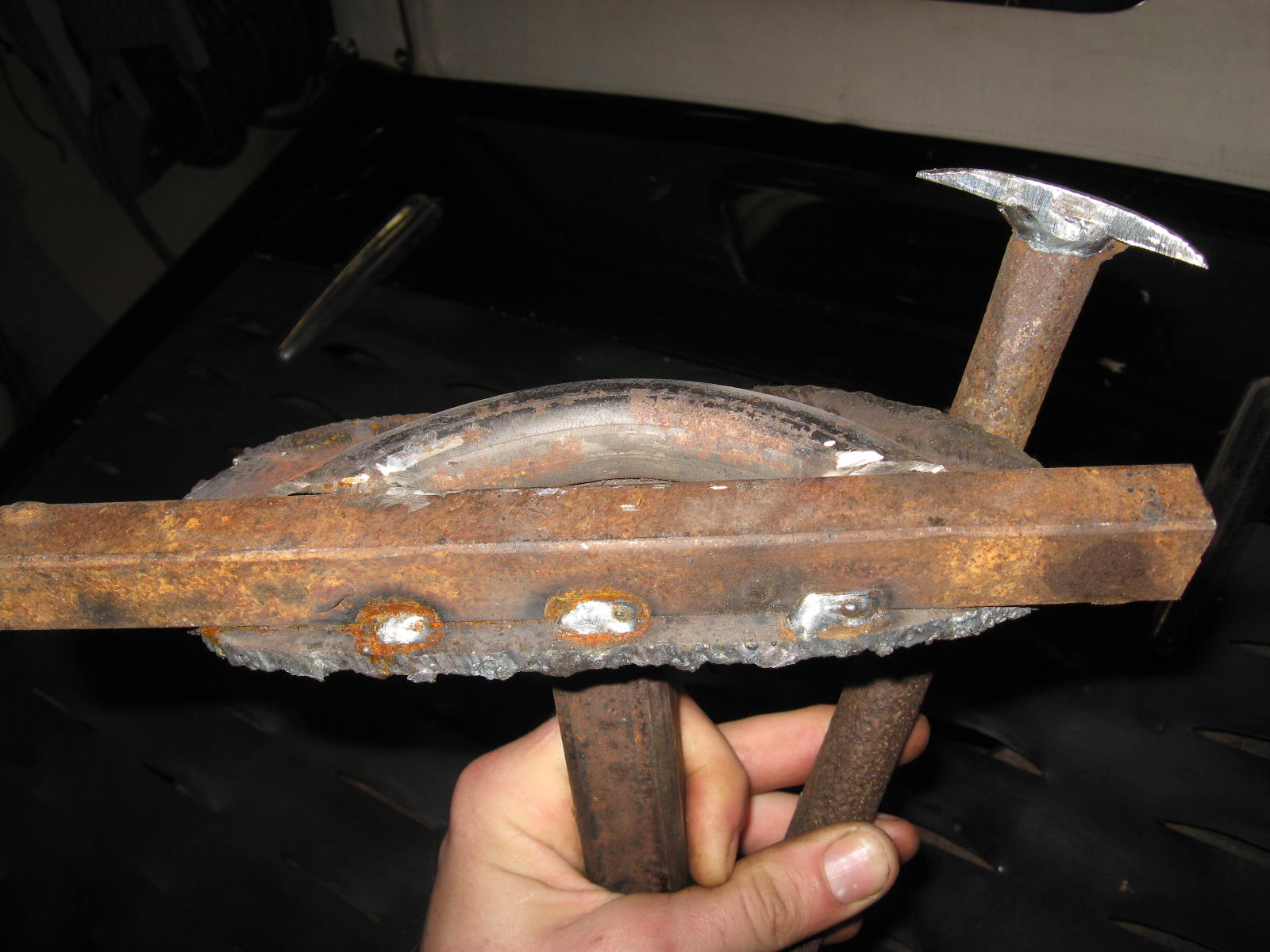

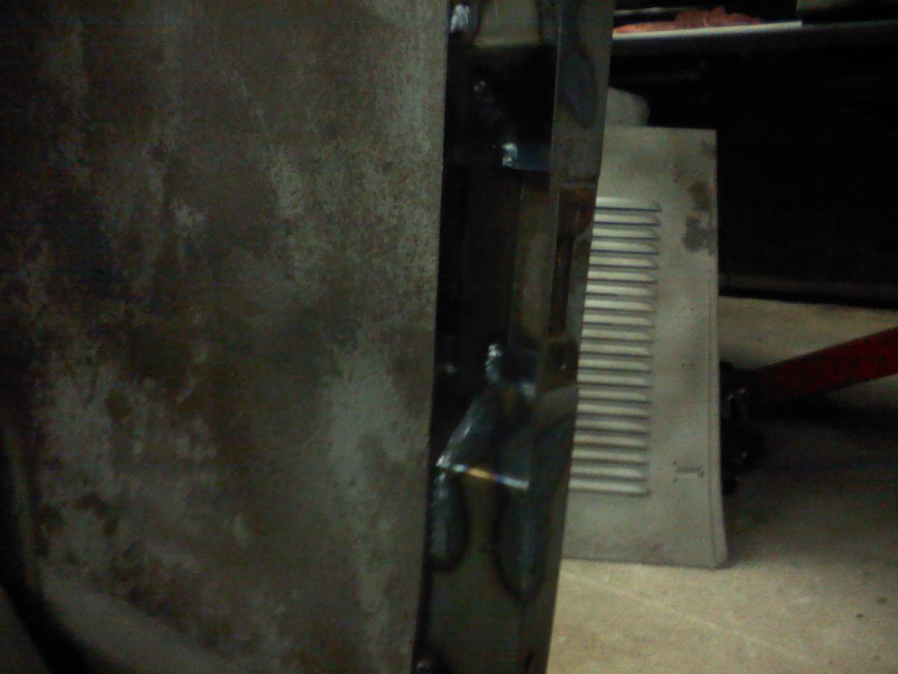

    Here's a shot of those "dies", cut the slots first, line em up and knock em out! Note: I left the edges nice and sharp to slice my fingers every time I use them.

    Ya know, for some reason I kinda expected you to be using something like that. I bet that doubles as 3 other tools too huh? :D
    What ever gets that job done!

    Andy, thanks man. Thats about as basic as it get's, which is perfect for my small mind..Now i can go about trying to ruin my deck lid! :D:D

    Andy, quick question. Do you have a general measurement for the early curved louvers for the die set? Like width and height at the center?
    Or anyone for that matter? I want to make the dies, but i'd like them to be as close to the early style as i can get.
    Thanks..
    Tony
  12. thunderbirdesq
    Joined: Feb 15, 2006
    Posts: 7,091
    thunderbirdesq
    Tony, I cut the slots 3" wide, the male die is just barely shy of 3". The female die should be made to that the male one is a bit sloppy. The male die does the forming, the female side just keeps the outer perimiter in place. As far as depth goes, you'll have to experiment on a piece of scrap before stamping the lid to get the feel for it. I tried using shims in the bottom of the female die to set the depth, but found it just works better to eyeball it as you're punching them. Good luck, let us know how you make out.

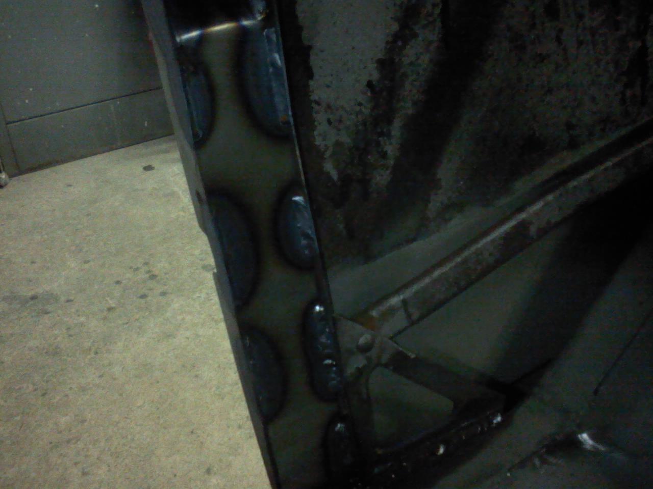

    The wood in my B pillars was wasted, and rather than spend 400 bux on new one's only to have to cut them for the chop, i decided to use metal instead.
    I will still use wood everywhere else it's supposed to be though.
    Took some 16ga tin and made filler pieces that slid just inside the original pillar. (where the wood originally was)
    Basically, just did a "step box" thing with it for lack of a better way to describe.
    I left the dove tail area open, and will make a panel to screw in place to make it flat all the way up. Did that because i didn't want to make cage nuts for them, plus the added bends made it real strong rather than a straight piece from top to bottom...
    The outer skin that was normally tacked through the A pillar steel to the wood, is now welded.
    Also, the step box thing will also give me a place to put tack strips for interior to attach to...if i ever get around to it. Just glue the strips in the recess.
    Also attacked the perforated panel between the deck lid opening and roof.
    Again, nothing exciting, just cut out the shitty stuff, and weld in new.
    Aside from doing the same to the pass side, and a couple small items, the body is about ready for etch primer...finally.
    See, like i said, boring. :)

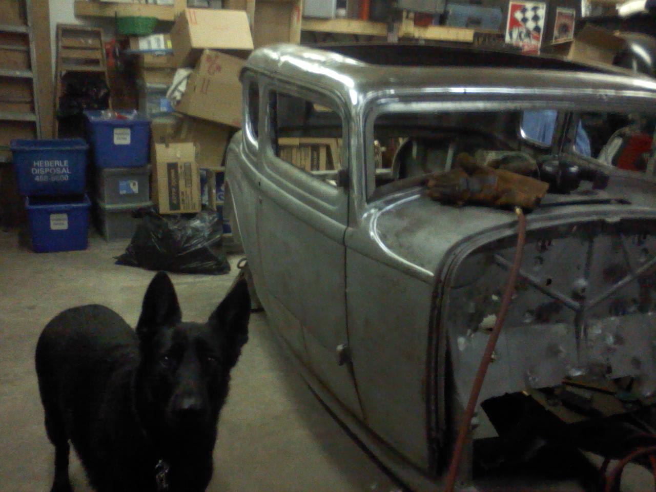

    Actually it should be ready for primer in a couple days. IAs much as i love seeing it in bare tin 'cause my last one was glass, i WANT to get it sealed up asap. I did take a pic of one area i cleaned up for primer.

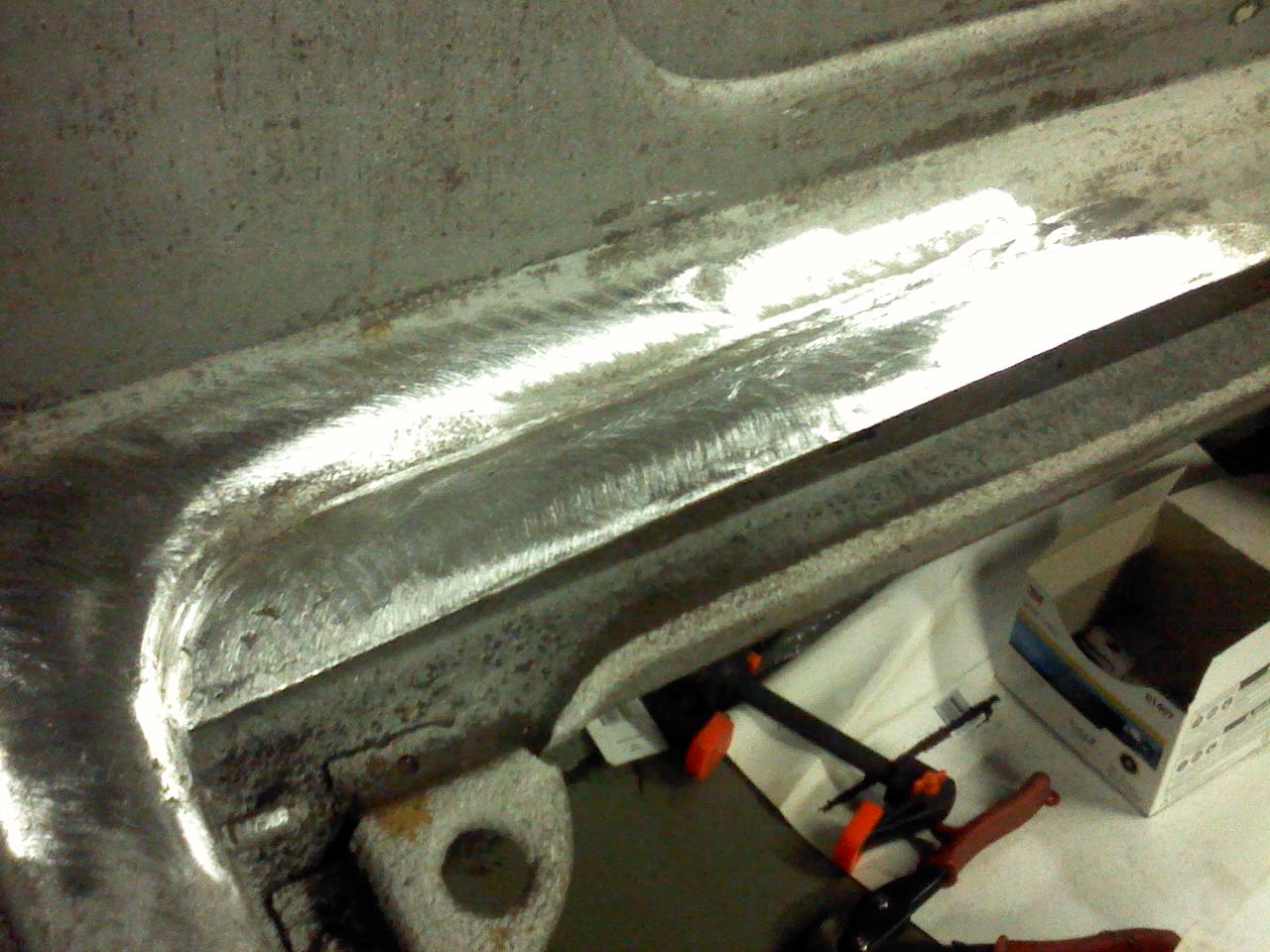

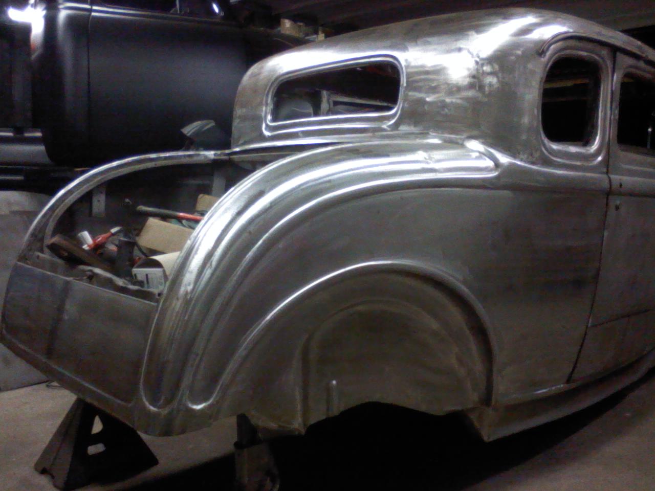

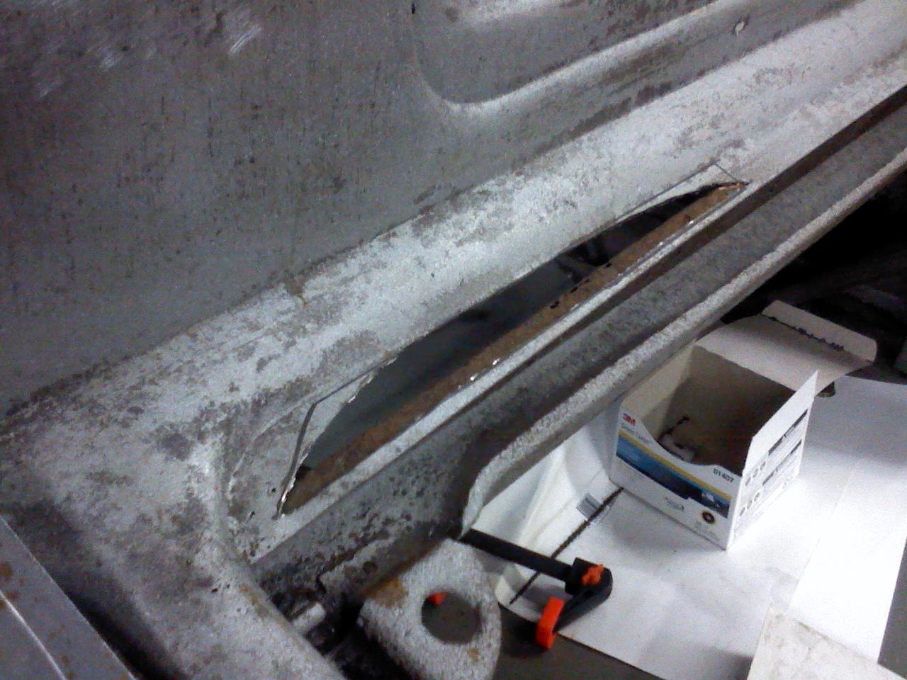

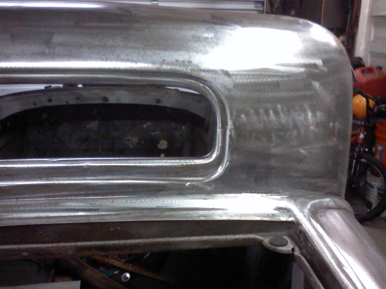

    Got the rest of the main body cleaned up and ready to prime, and knocked out most of the small dings and dents so i have less finish work later.
    Still gotta dress the welds on the lower doors, then i can clean them up too.
    I get a kick outta comparing the pics as i go along. It's easy to forget where we started with at times..
    No more rot! WOO HOO! lol
