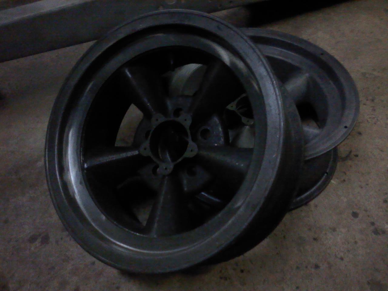

    Here's my "new" front wheels for it. original 15x6 magnesium Americans. They match the mag 15x10s i have for the rear. Now i gots me a full set! :)

  13. 1927 Death Trap
    Joined: Jan 19, 2008
    Posts: 355
    1927 Death Trap
    from CT
    Bad *** man, I'm diggin the wheels.

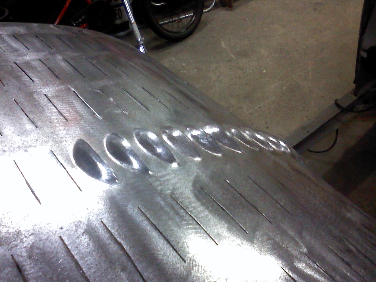

    The main body's done and ready for body work.....later.

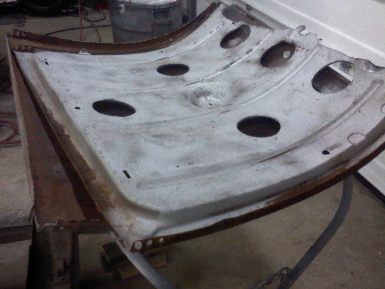

    I started on the deck lid today. Figured that's basically the only thing left on the body itself that really "needs" anything.
    Split the skin from the structure first. I need to rebuild the structure at the lower section, along with small repairs to the skin in the same area, but, i plan to louver it so it had to come apart anyway.

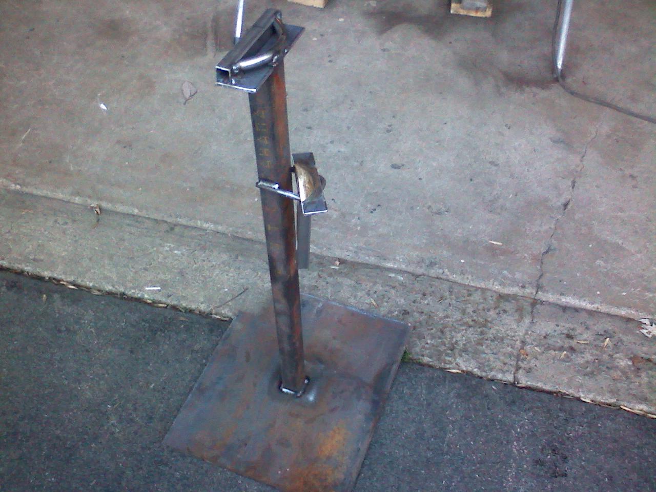

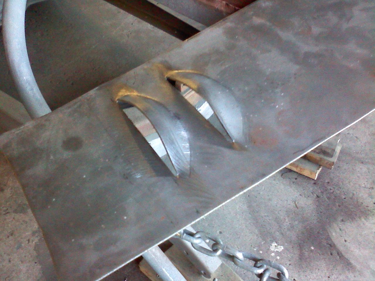

    Taking thunderbirdesq's idea, i made a louver punch die set and a half ***ed stand so i can ruin my deck lid.
    The male part is br*** and threaded on..Didn't have a chunk of solid steel so just made it from that and threaded it on.
    I dig the early round style louvers, so i carved it up til i got the shape i was after. These are 3" wide.
    Made a couple test punches and they came out nice but the tin i was using was a bit thicker than the deck lid so i'm thinking the deck will come out better. I plan to punch a few more in some 18 and 20ga before i go at the lid.
    Here's some shots of the goofy ***ed punch set up..
    I spent a couple hours marking out the lid already. There's 139 of 'em to be punched..
    Tony

    Looooovers!

    yea baby!! That's WNY style ventilation right there hahaha!
