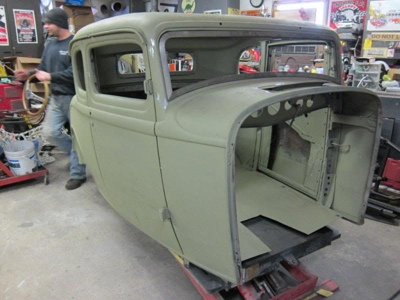

    So today i moved my truck out for more room, blew the body apart and set the frame up on my "table" to get started.
    All trued, level and locked down tight.
    Started fitting the boxing plates once all that **** was done..pretty typical stuff so not very interesting.
    I did get a much better profile pic though before i took it all apart. I like it with the hood a LOT more once i could step back and get a better view.
    Tony

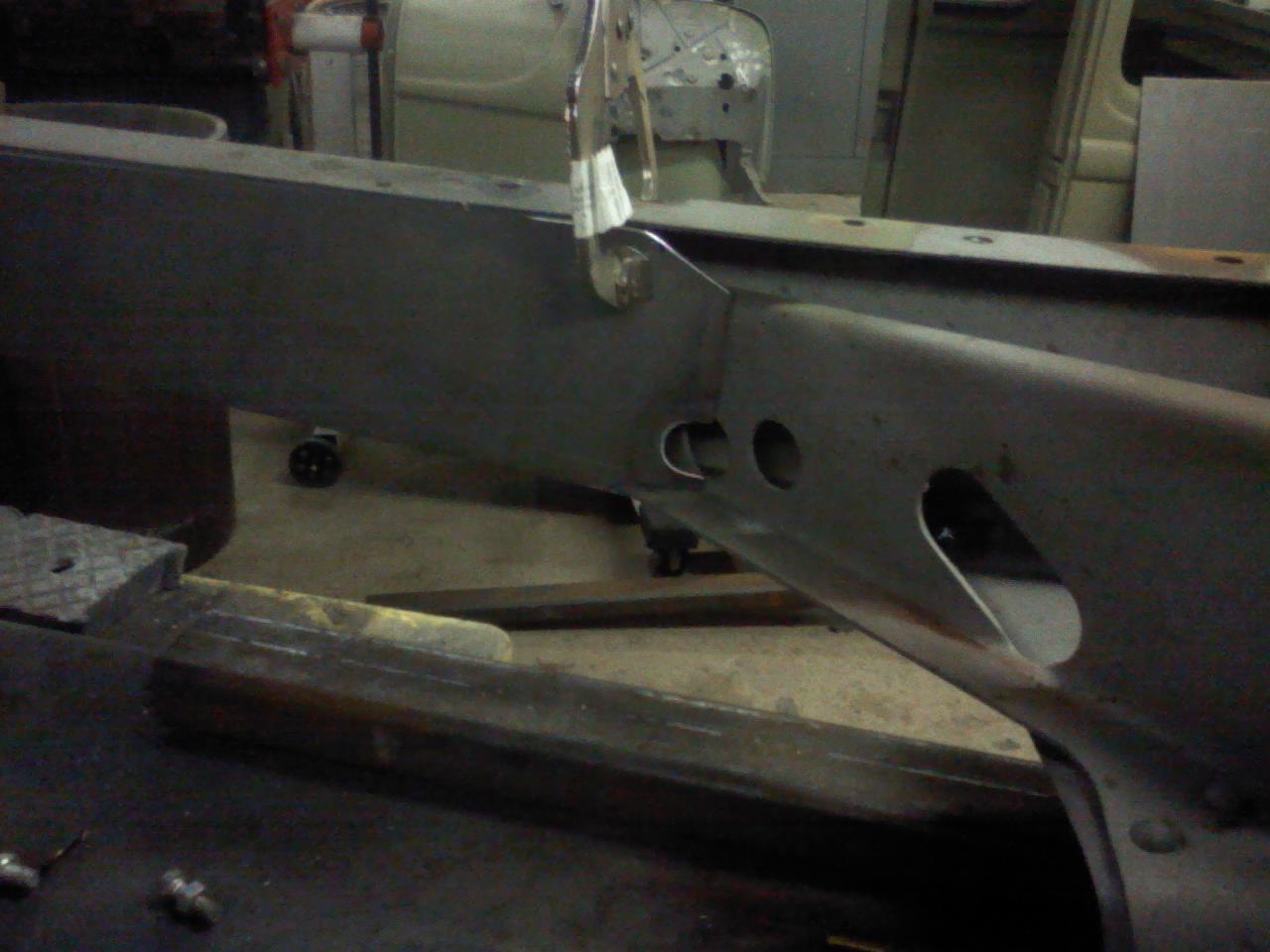

    So, after fiddling around with the rear plates, i decided to actually start in front and work back.
    Aside from the Z, my frame is bone stock with original crossmembers and K member in tact. Keeping the K member was a debate in my head for a while.
    I REALLY didn't want to take it out, so, i'm not.
    I know i'll have to trim it here and there, but i'll build off of it instead of losing it all together.
    The front og crossmember was messed up pretty good, and i have an A cross member for it anyway (thanks JJ!) so out it went and in with the "new" one.
    Then i welded the K member to the frame because i'm strange like that. Left the rivets in place, just locked it in place for good..
    Then started t******* and fitting up the front boxing plates.
    They will tie into the K member as you can see.
    I have 1x2 rec tubing for behind the K that i'll be using..along with boxing plates as usual. I've got it all sketched but wont be starting that til the front section is all tacked in place.
    Guess that's it for now....back to your regular scheduled program.

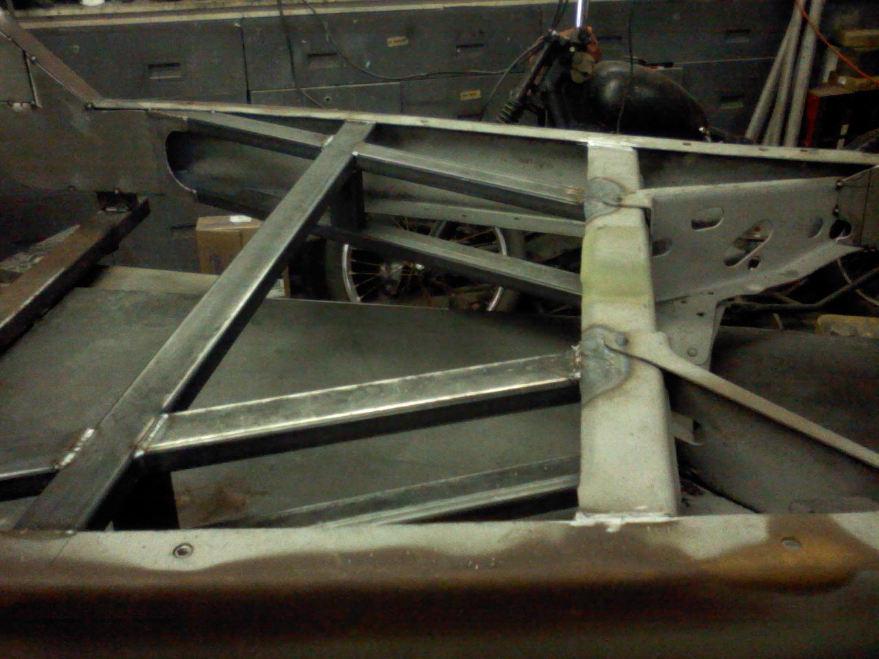

    The frame work behind the K is all tacked in. Still have another crossmember i want to add at the top of the Z and some gussets here and there.
    I used 1x2 11ga tubing so it's plenty strong...
    Tomorrow i'll finish up the fab work and start welding it solid.
    not much else to add i guess....for now anyway.

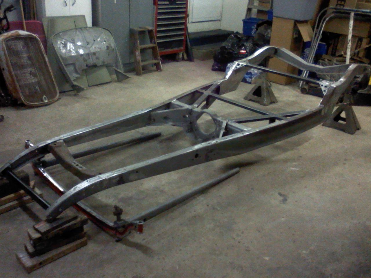

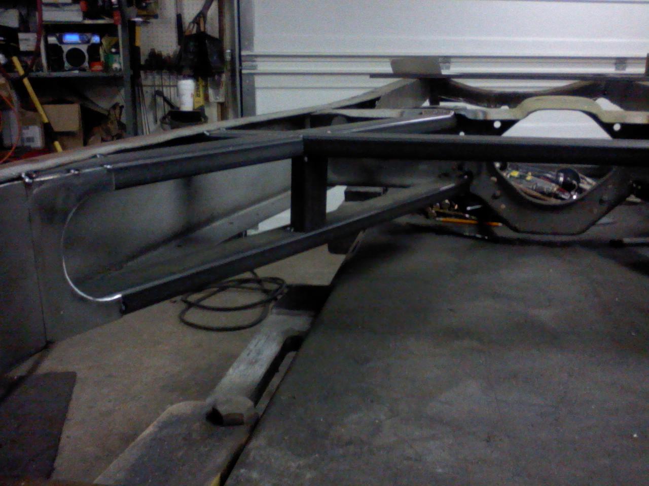

    Well, been a little bit since i've updated anything, and since i've really done much to it due to health issues with my dad. It's a scary story that i'm not interested in writing about, i'm just THANKFUL to still have him!!!!
    On to the **** box.
    The boxing and X member are done. It's not off my makeshift table/jig and ready to start the suspension once i get right height established.
    Here's a few pics from this morning.
    Tony

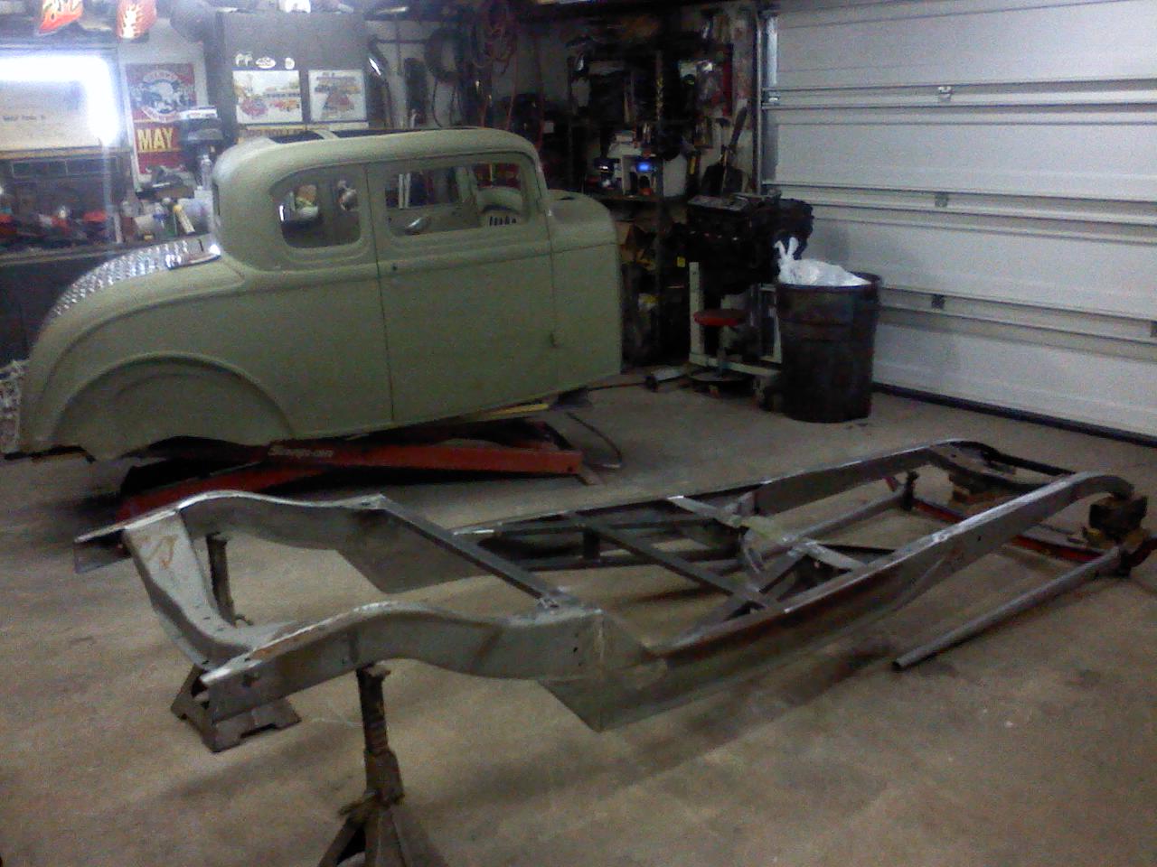

    A buddy stopped by today with an actual camera and took some pics..
    Thought i'd share some instead of the ****ty cell phone stuff i always post.
    Tony

    I love the stacked rear frame rails...just like some old time builds I have seen.
    The rear legs of center X looks rock solid too.

    Yeah, the Z was started on this a LONG time ago, just never finished. I had to leave it and finish it. It was originally stick welded.
