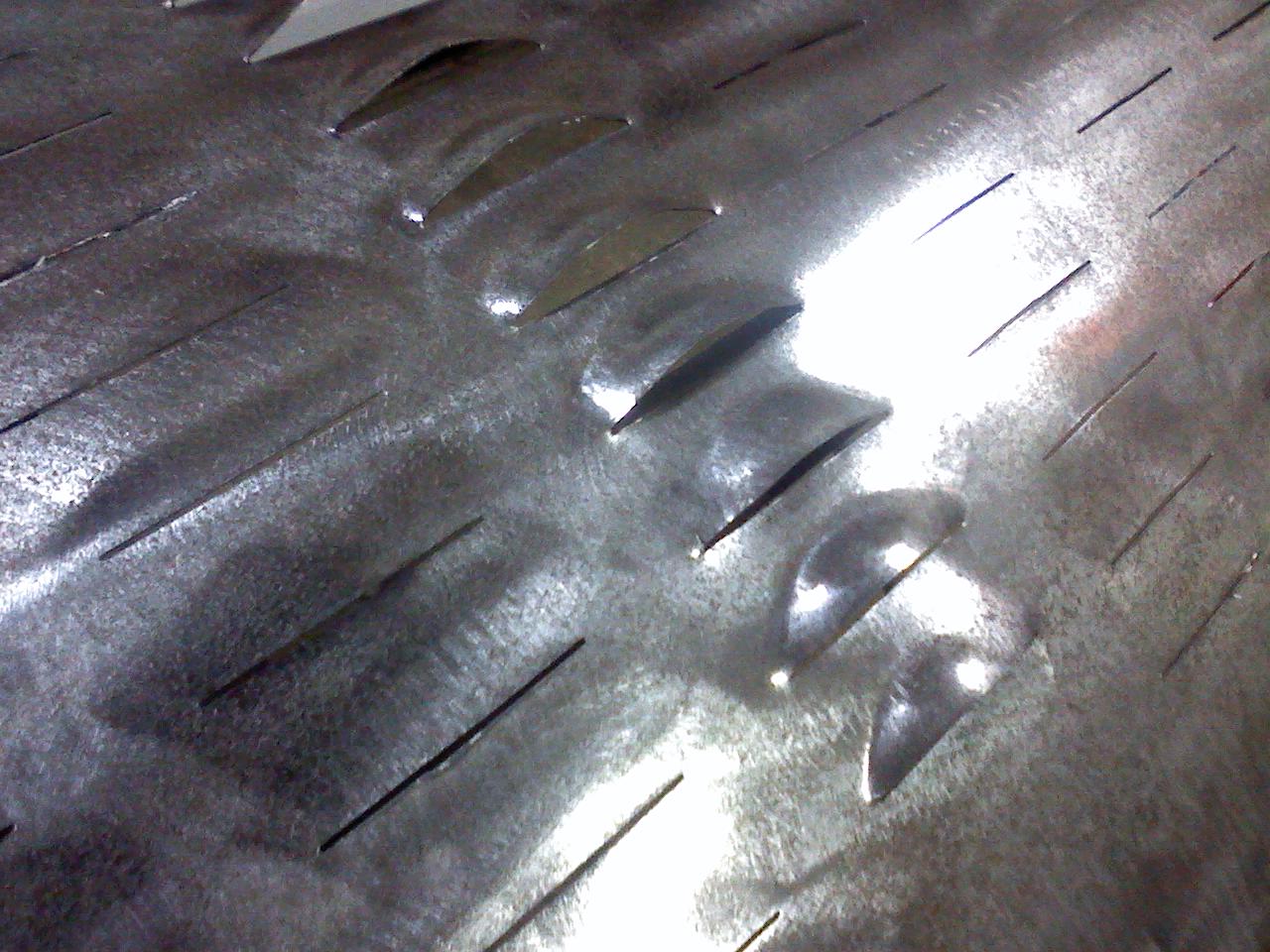

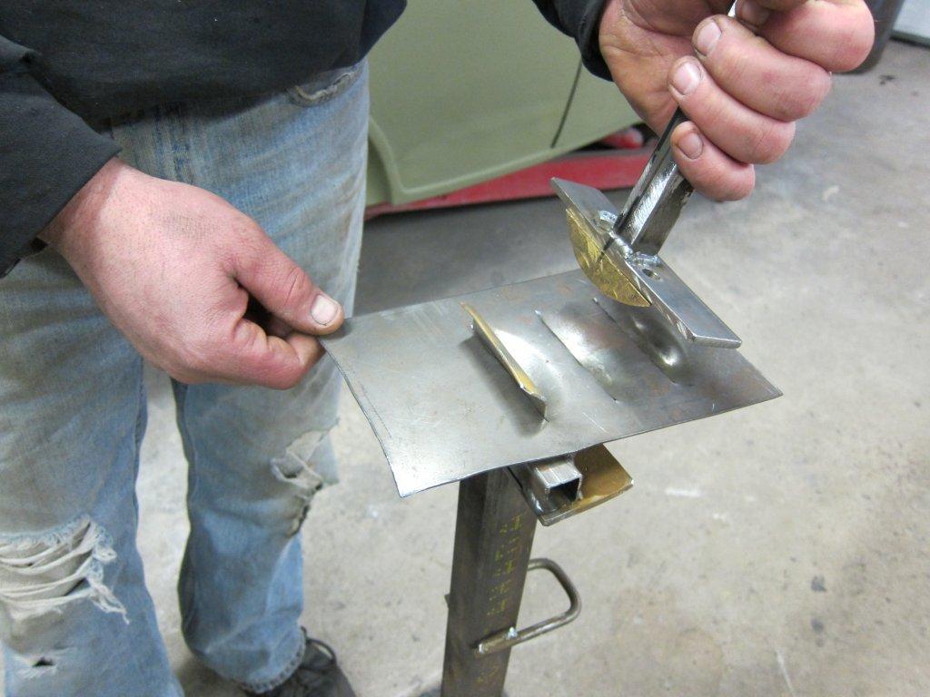

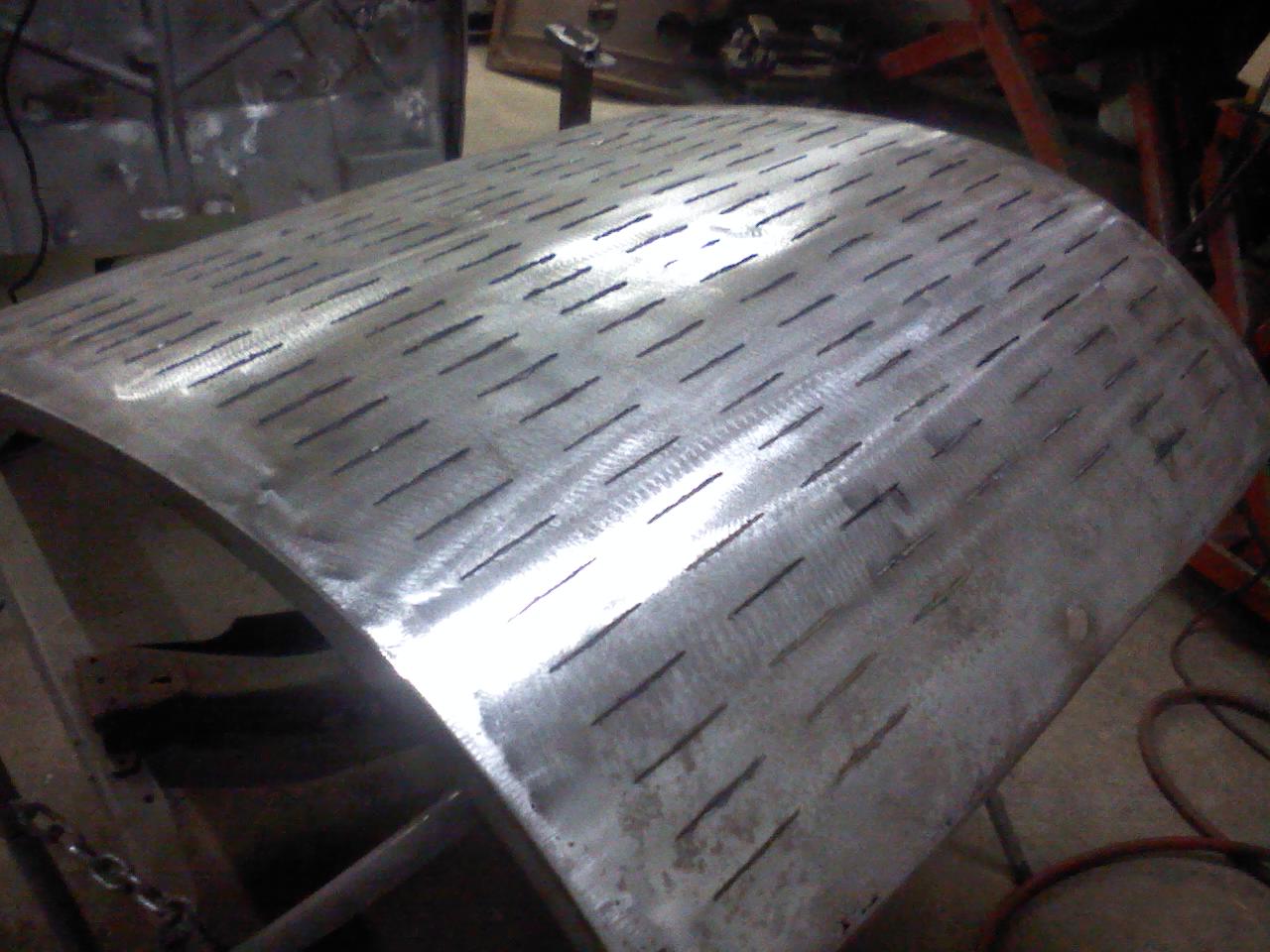

    You are doing a fantastic job - the car is just right and I'm enjoying following along. I'm interested in how you did the louvers. Is there any chance you have a bit more detail and pics of the process?
  5. Tony
    Joined: Dec 3, 2002
    Posts: 7,351
    Tony
    Thank you.
    Well, i think i have another pic or two of how i did it. I'll try and explain but i'm not the best at doing that so.....
    I laid out the placement of the louvers on the back side of the skin. When it was all done, it looked like a grid basically, with each louver having a center line.
    Once fully marked, i then cut a slot for each louver with a thin cut off wheel, following along my "grid" and to exactly 3".
    Once they were cut, i then laid the skin over the female die. I made a stand so it was waist high for me.
    Another thing i did to keep them all starting from the same place was to make a 3" wide 16ga guide that slid into the slot in the lid i cut, and also into the female die. Once it was slid in, i just gave a slight pull to bring the lid flush against the guide, and also against the lower die.
    Then, i squared up the male die using a center line i marked on it, to the center line of the louver. Then swung a big hammer and smashed a louver into it.
    Here's the other pics. One i took with the test panel to show the guide. There's no center line on the louvers on that one cause i was just messing around to see if it was going to work.
    They are kinda crude, and not perfect like a machine would do....but, i doubt many back in the day were perfect anyway and these cost me nothing to do.. i can't complain :)
    Thats how i perforated an original 32 deck lid..haha
    Hope that kinda made sense..:)

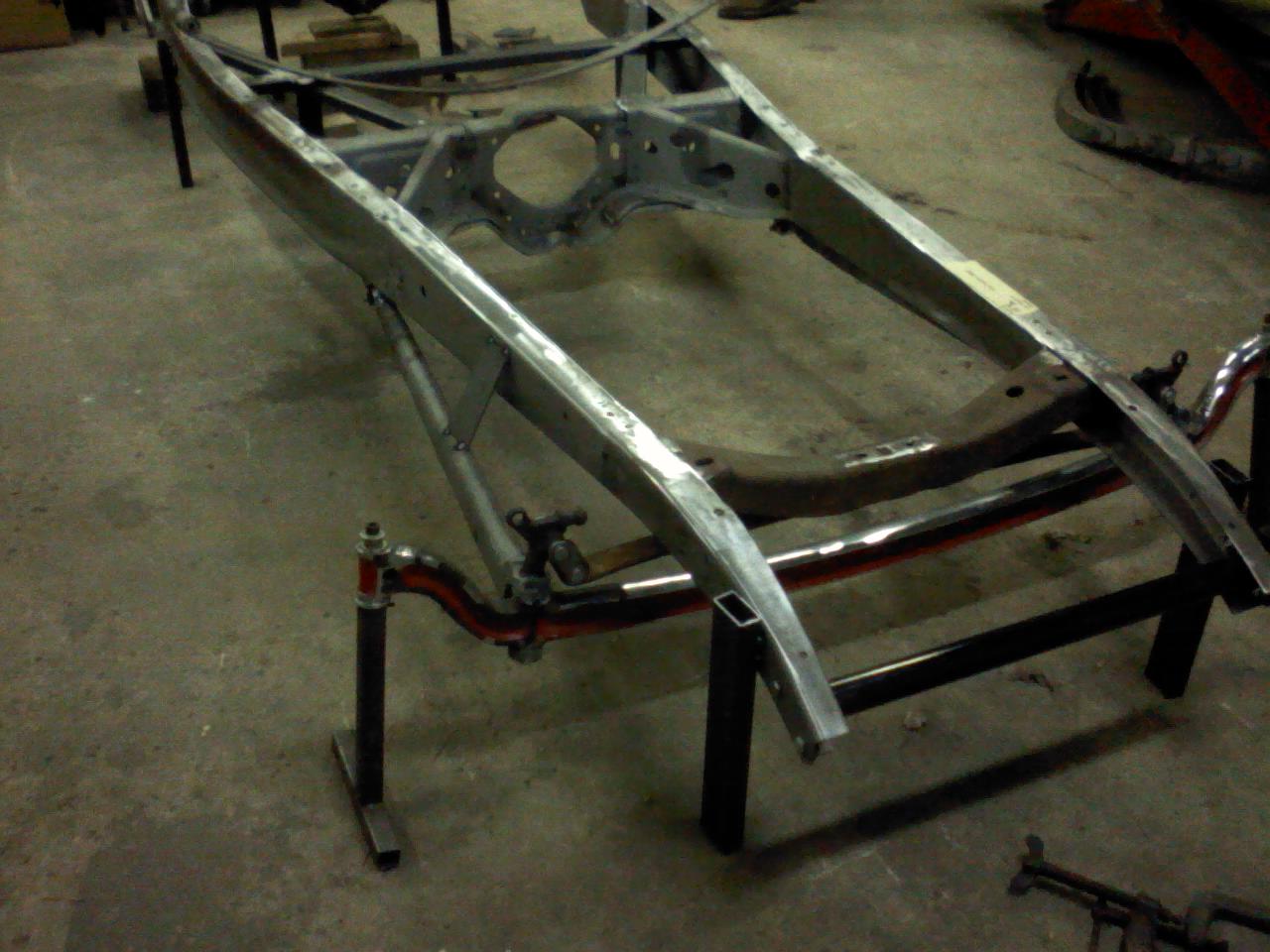

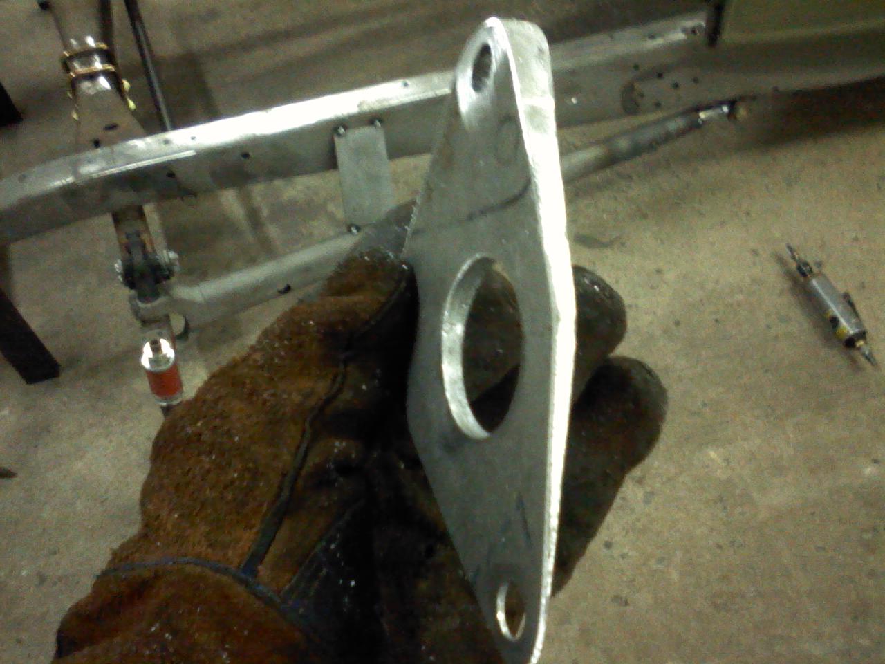

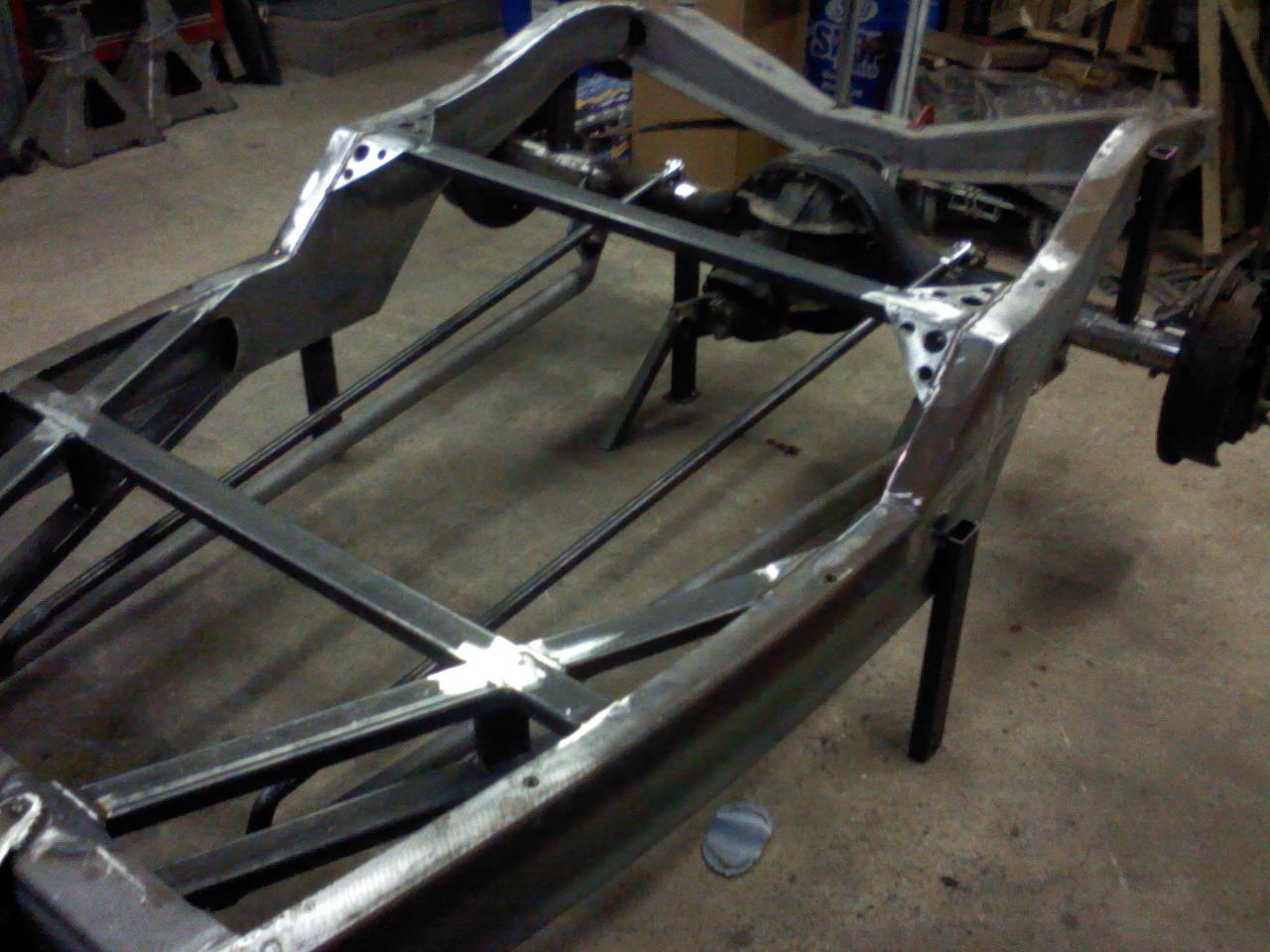

    Well i didn't get as far as i hoped today. I made all the mounting plates for the suspension probably 5 years ago off of templates we have, and they were for a non Z'd frame.
    Until this past year i planned to put my frame back to stock, obviously i didn't, so now the rear spring bracket i made for the rear end won't work.
    Made a new template earlier and just have to carve it out of 3/8ths stock..
    Then i can hook the spring to the rear end.
    The rear end is set though, and the bones are now all tacked in place. Still need to make the upper tubes for the bones yet..basically they will be ladder bars when i'm done.
    Got a busy week ahead but i'm hoping to get everything done and tacked in before the weekend. time will tell.

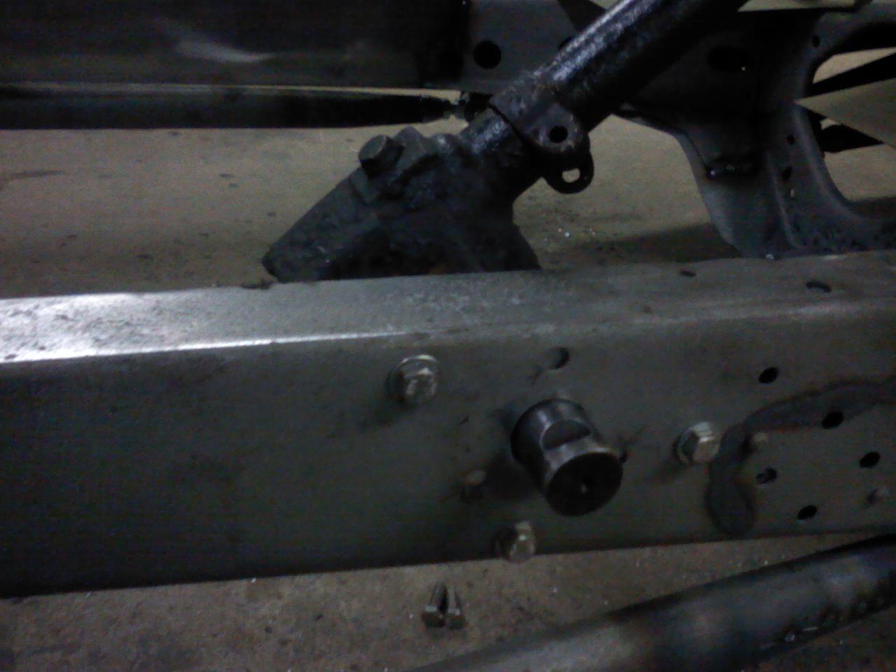

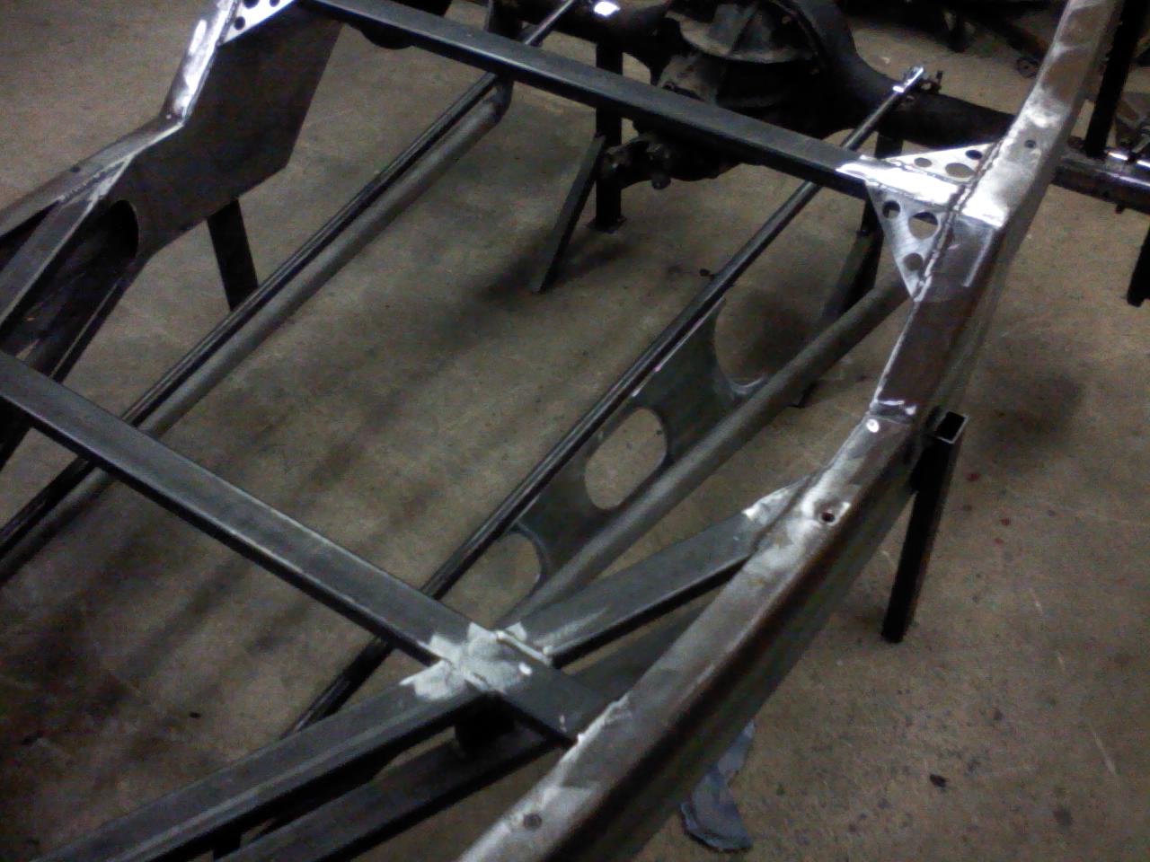

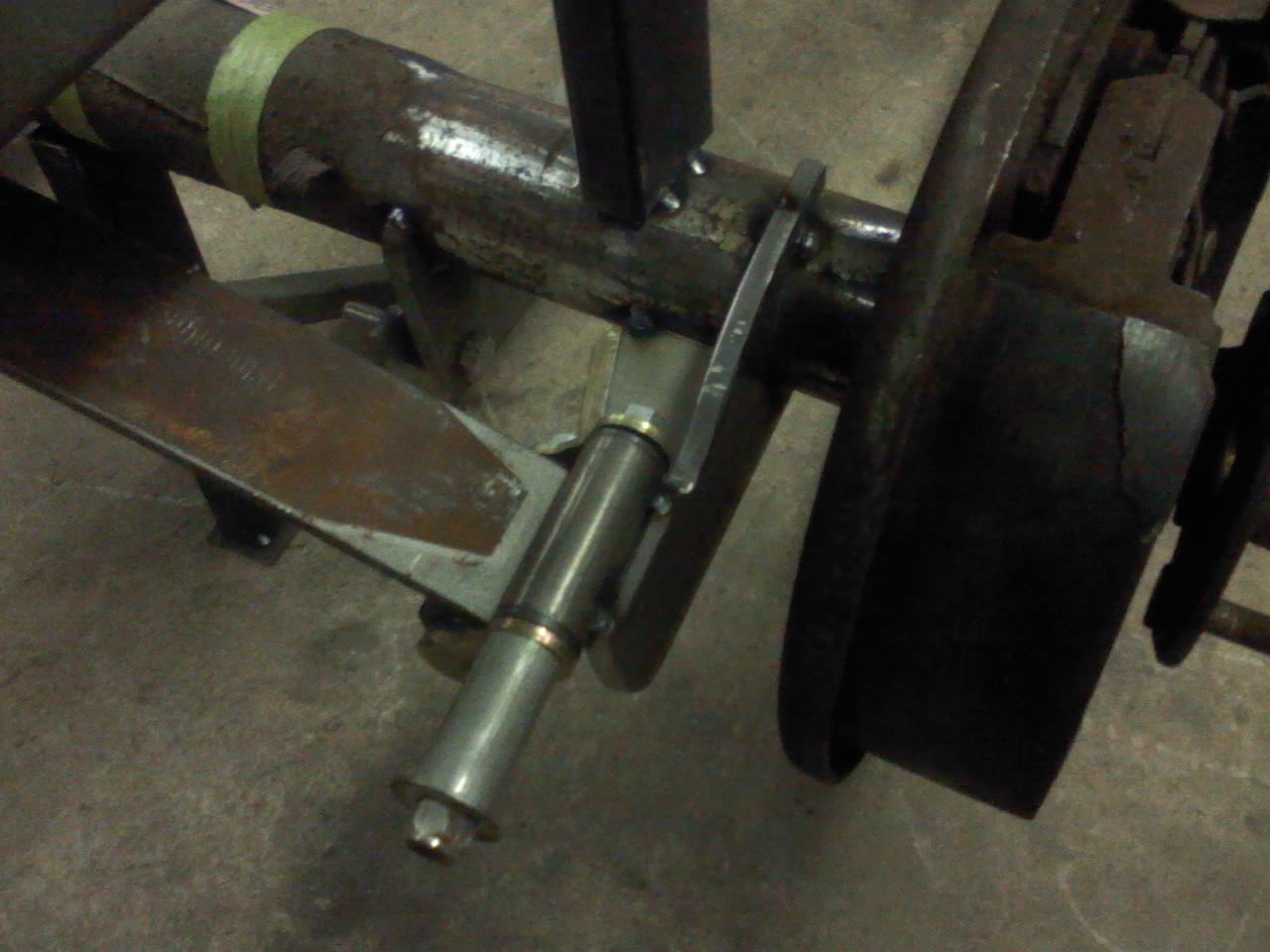

    The rear suspension is finished aside from final welding.
    Set the body back on to get the steering lined up, also bolted my buddy's wheels on it..
    NO reason aside from it's the first time i actually bolted a wheel to this damn thing!

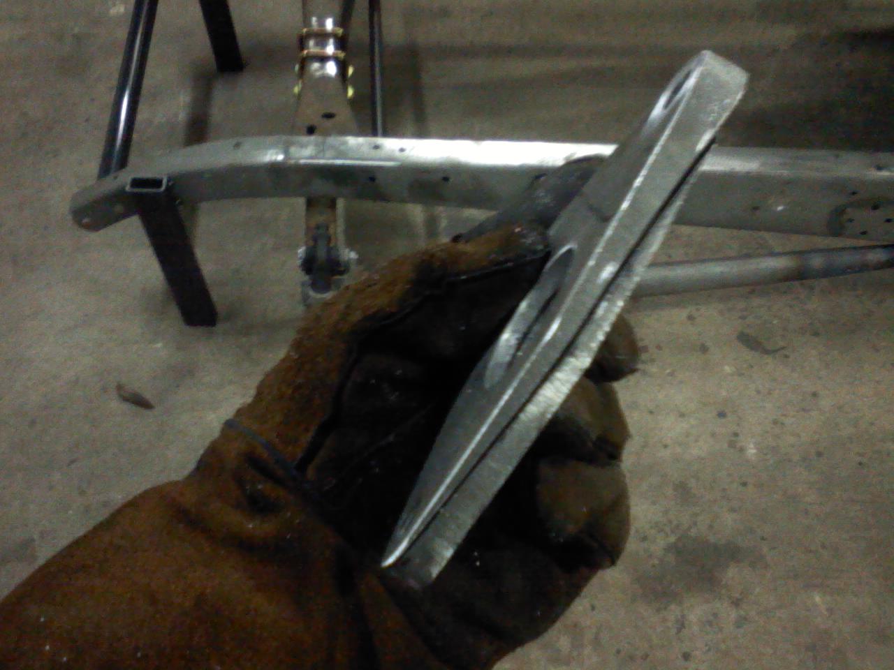

    Modified the F1 shocks mounts in typical hot rod style, and started mocking up the steering.

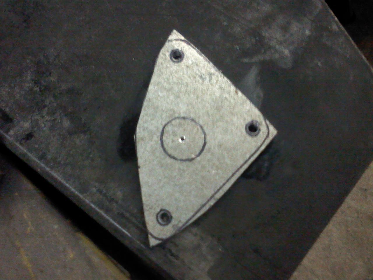

    I'm using an F100 box, and decided to make a wedge for it rather than cutting/welding a new flange..or buying a wedge...the thing's are around 60.00 and that's better spent elsewhere on this.
    Biggest hangup i have is lack of equipment, so this was done kinda by hand..
    well, sawzall.
    Worked like a charm though. Once i redrill the mounting holes i can make the drag link and tie rod.
    Then on to motor and trans mount...
    Pull it all apart and final weld it all.

    Wait... you cut a steering box shim with a sawzall?!! Hahahaha You ARE a ninja aren't you! Wow, looks awesome Tony.
  26. Tony
    Joined: Dec 3, 2002
    Posts: 7,351
    Tony
    No ninja, just *****. hahahaha
    I did...and don't think i'd do it again. :D:eek:
