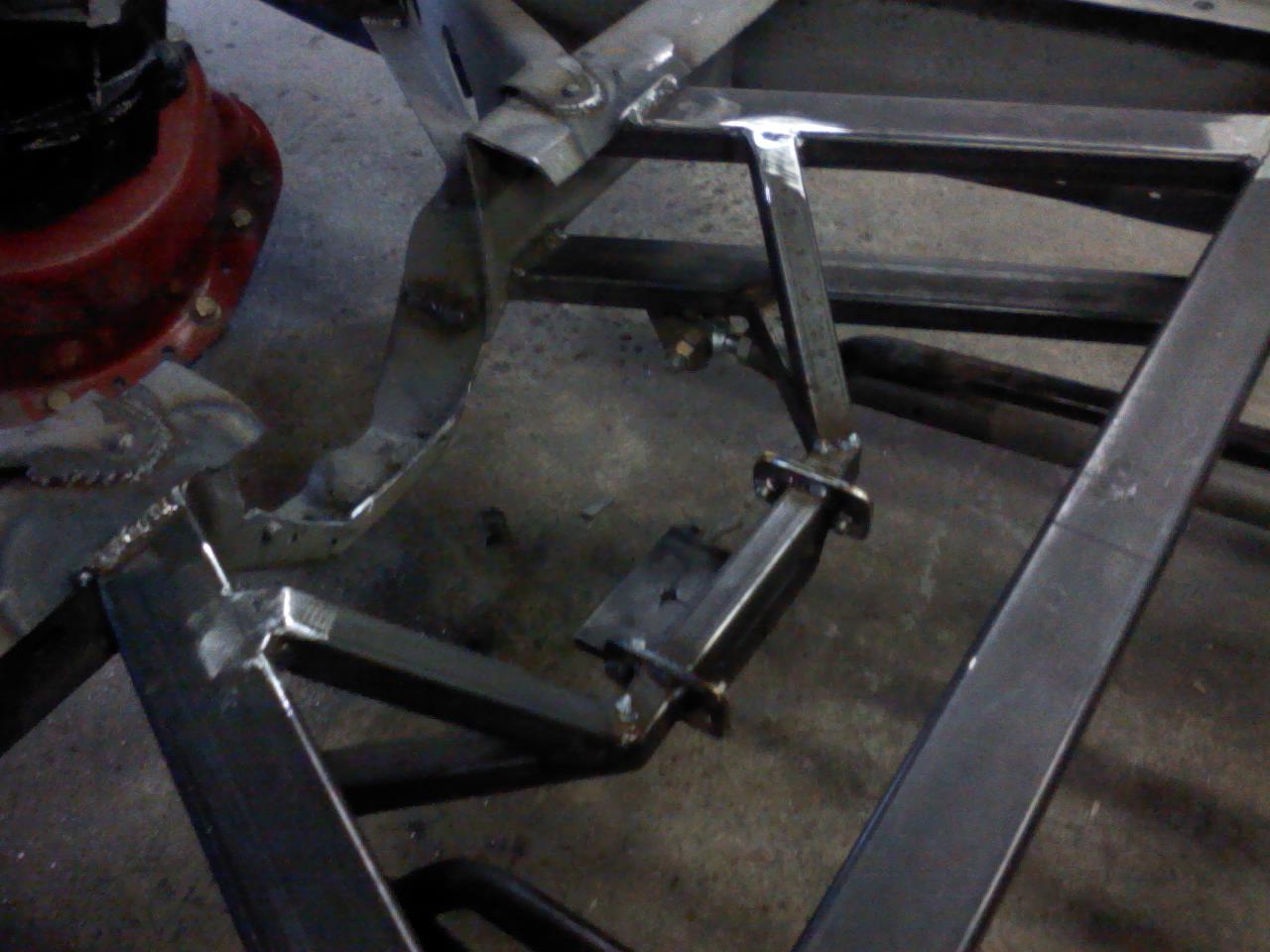

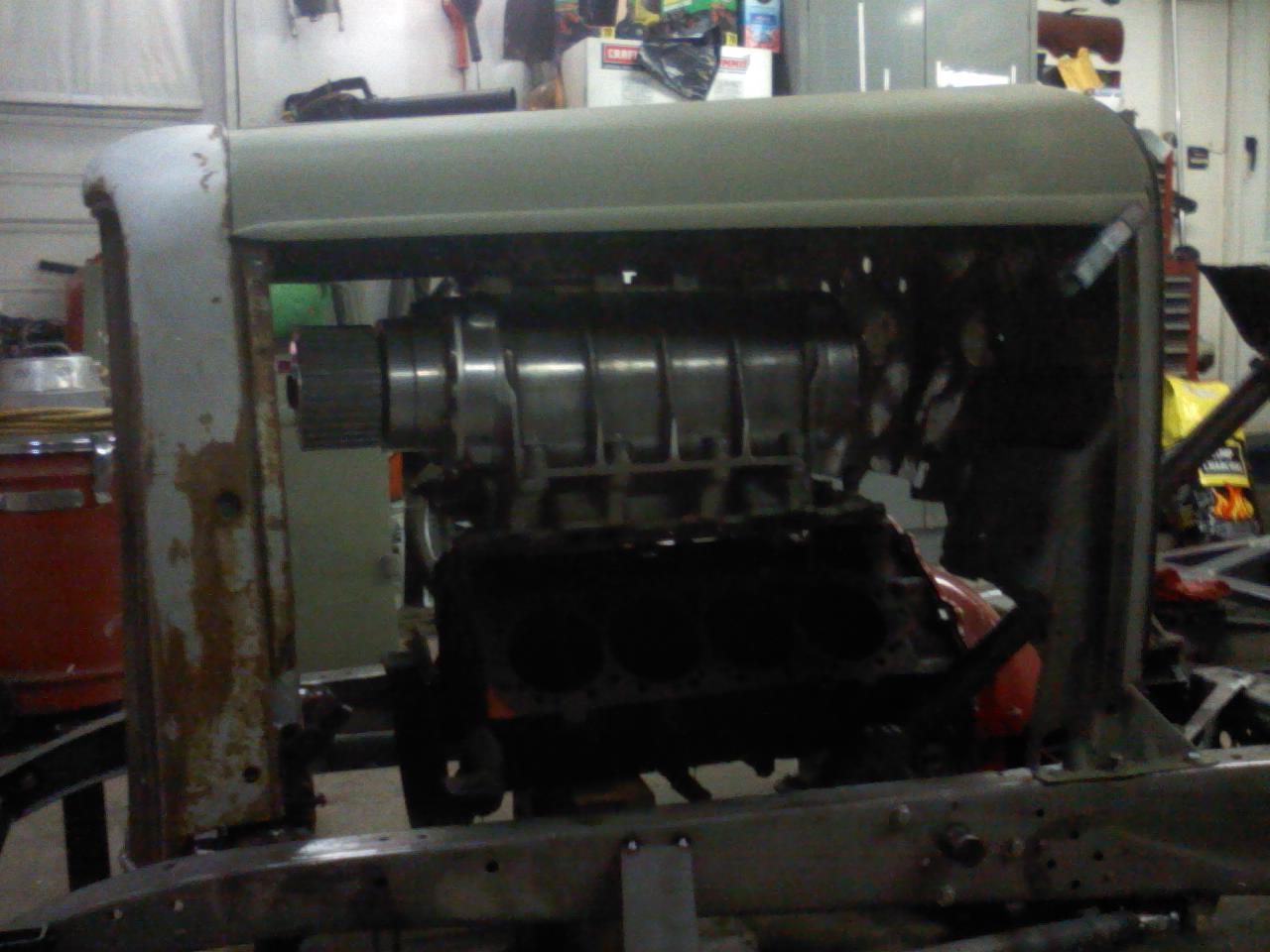

    It might be a bit of a sleeper...well, as much as a chopped fenderless 32 can be with cheater slicks out back :)

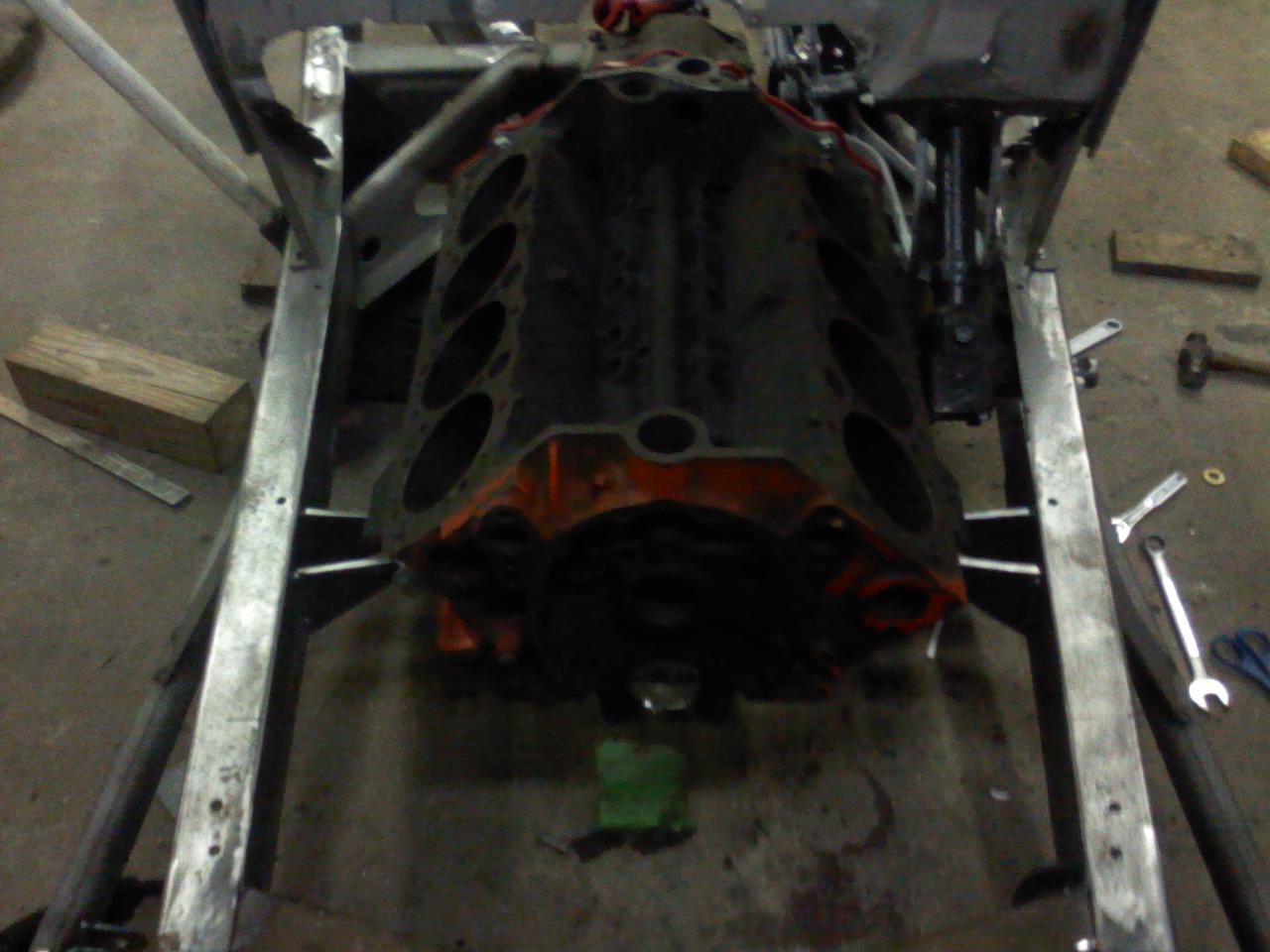

    After a lot of moving, t*******, cussing, adjusting, and more cussing, i managed to get the whole shebang under the hood with plenty of clearance between the lower blower pulley and crossmember, and about 3/4" between the scoops and hood.
    Planned to use an original Hurst front cradle, but that interfered with the mechanical fuel pump, so just going to use side mounts.
    Got them fab'd up, and just about done with the trans crossmember too. Pretty cool to finally see a block and trans actually bolted between the rails.
    The front mounts are not finished in the pics..

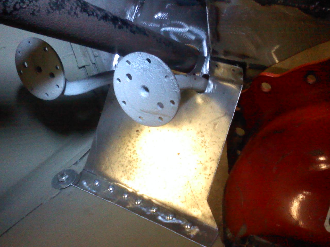

    Well the pedals and clutch idea was not as straight forward as i thought it would be.
    Got the pedals mounted (they are 33-34) and there was NO way the clutch fork would pull back far enough to disengage the clutch. It would hit the pedals due to where i have placed everything to clear the blower...

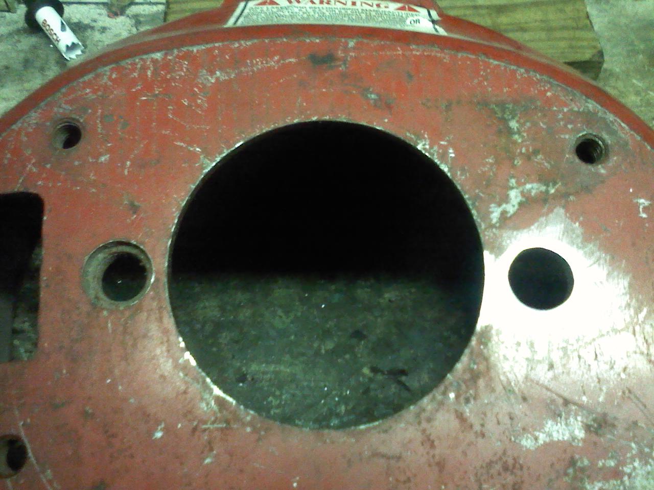

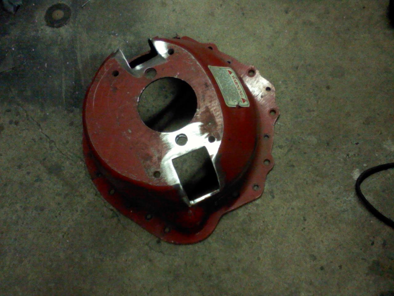

    Switch to a p*** side clutch release!
    Took the ****ter shield off and got to business (doing exactly what the "warning" label above in pic 1 said not to do....alter the bell) :).

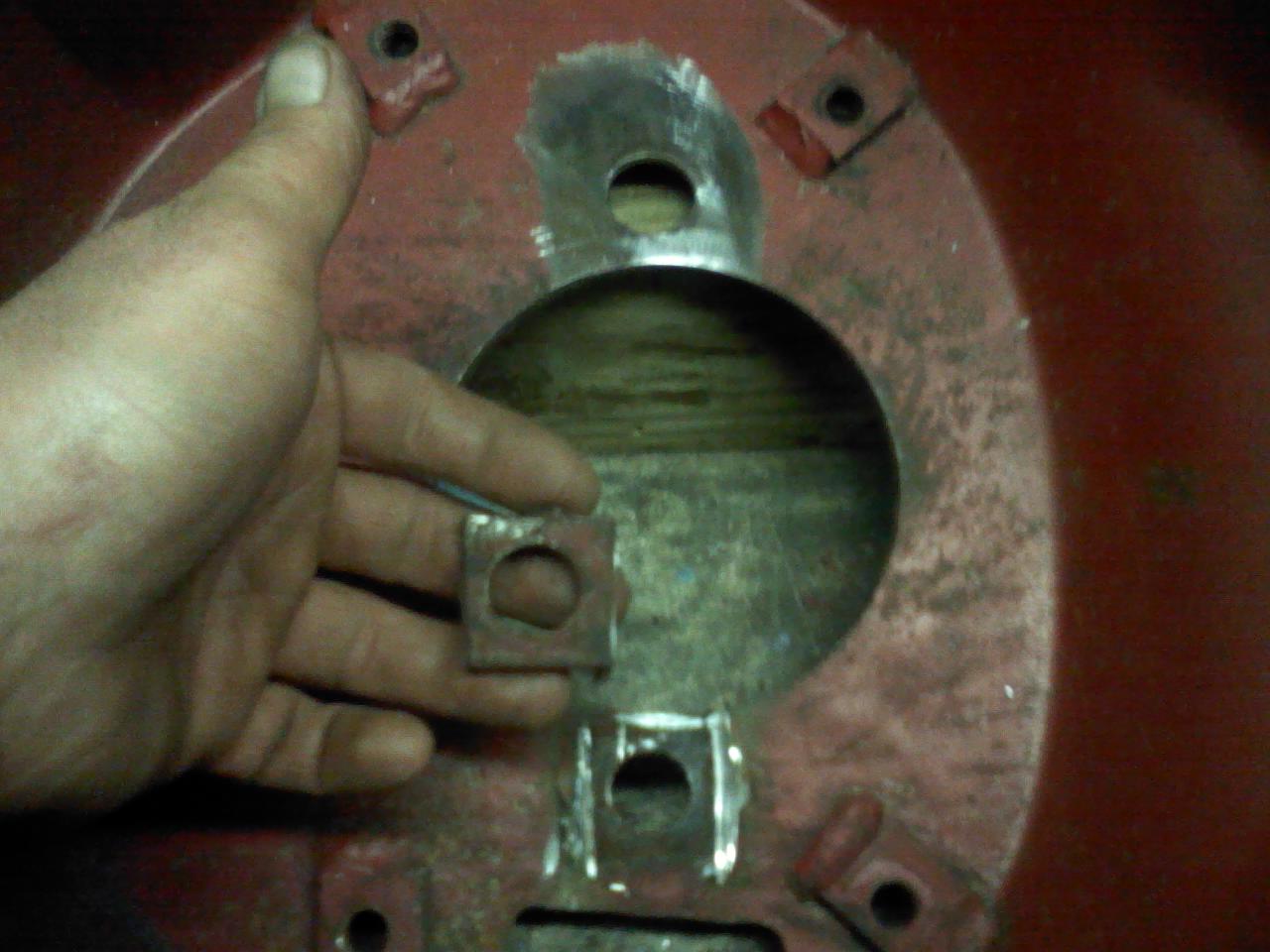

    After taking many measurements, i had the pivot ball and opening marked off.

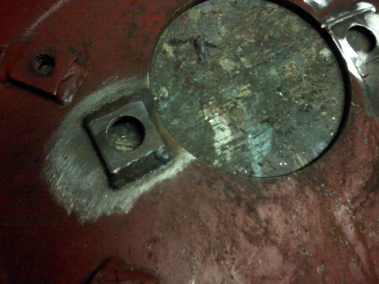

    Lakewood uses a threaded block welded to the inside of the bell to thread the pivot into...i just cut their welds and moved it over to the p*** side rather than making a new one. I'm going to block off the old hole anyway, along with the old drivers side fork opening.
    Then welded it in place.
    After that, just cut a new opening for the clutch fork....
    Done.

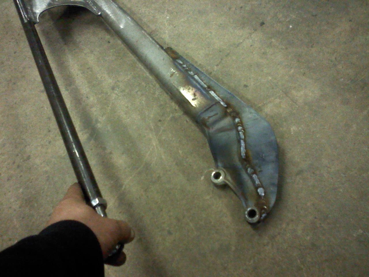

    Ok..update.
    Well, the suspension is all finished, and welded up.
    I'm not using the nice and strong 35-36 bones out back cause i just couldn't find them when i started, so i beefed up the later ones with some 1/4 gussets to added strength.
    The trans crossmember is done too. I do have to make a drop out section on the lower part of the original K so i can get the transmission out when it blows up..and it will...Thats all thats left.
    I decided to butcher up a set of 34 pedals i had to make them work nicely on the 32 K member too.

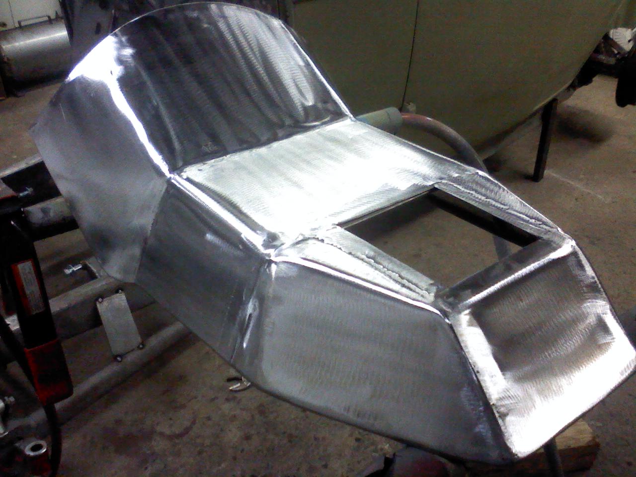

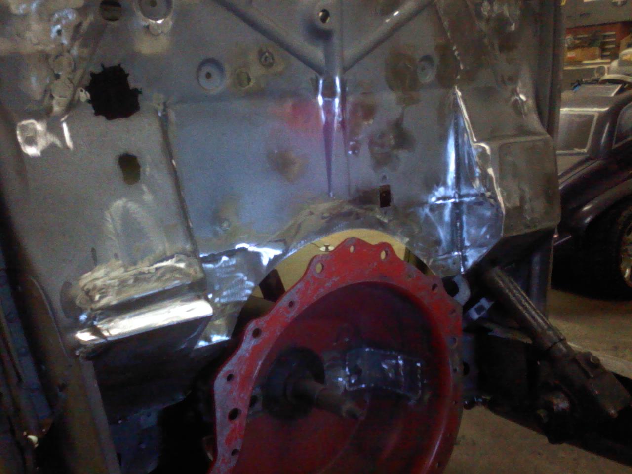

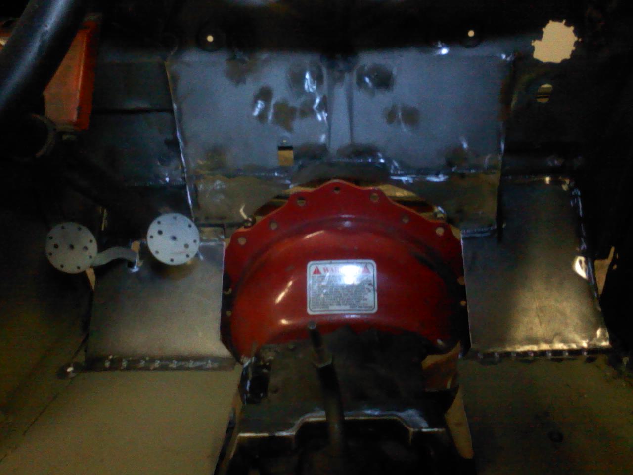

    Figured it was time to finish the firewall..
    I had to move the center back a bit to clear where i put the motor, so i cut the center loose and straightened it out then added filler panels to the sides making it recessed but keeping some originality to it.
    The lower section was gone from the start, so i made up all that too.
    The p*** toe board is crewed to a plate wended under the floor with some 10x32 screw's, and the whole panel around the pedals and column is removable being fastened the same way.
    The tunnel is next, and that too will be fully removable to access the bell housing bolts and trans if needed.
    Thats all for now..sorry nothing very exciting..yet. haha
    Tony

    Firewall looks good with the lower sides still bumped forward.
    See the holes through to the outside in pic #1, out at the lower cowl edges. What went in there when new? I did not know so I made flat plates.

    I'm not exactly sure what was there originally. I know there are brackets (for lack of a better word) that attach to the cowl and bolt to the frame which pull the cowl tight to the firewall..but that's all'z i know.
    I'm going to make plates like you did.

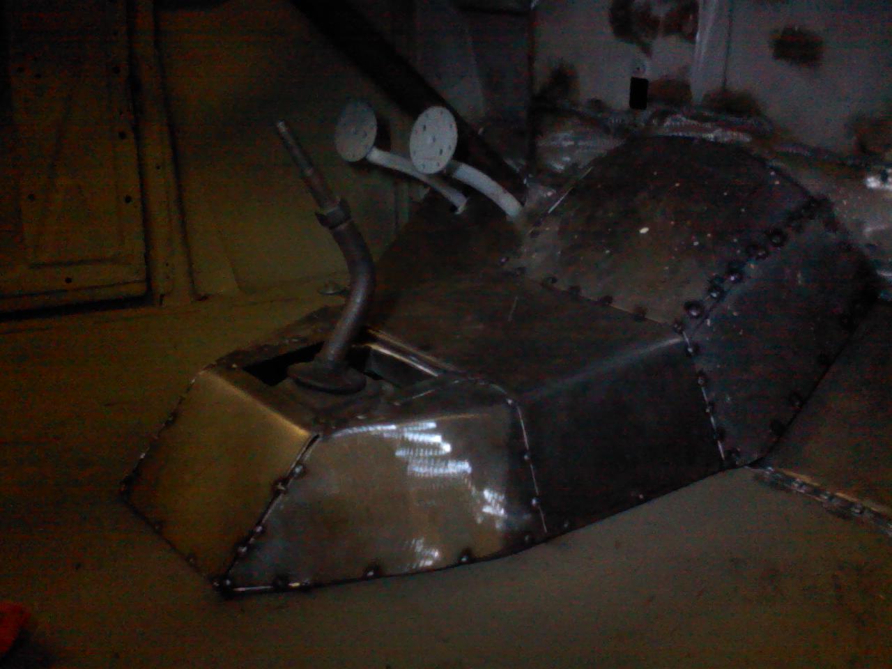

    Built framework for the tunnel tonight. Normally i don't do that, i'd just bend up the tin and call it a day. But, i wanted it to be sturdy which it will be like this, and it will also give me a nice place for mounts to bolt it to the floor rather than using the tin.
    Should be able to skin it tomorrow..
    just havn't decided if i'm going to just use tin, or aluminum..if i go aluminum, i'd use stainless ****on head machine screws to put it all together and polish everything...it'll probably never get much of an interior knowing how i am...lol
    Tony

    Nice "transmission cage"...;) Dig that firewall man, stellar job!

    I must be living under a rock...I don't recall ever seeing a rod type skeleton for a tunnel before. That brings up so many possibiltes for mounting it to be removable, as well as being so easy to skin it. Nice.
    That should have been a tech week thing :)
  13. Tony
    Joined: Dec 3, 2002
    Posts: 7,351
    Tony
    I've seen stuff fabbed up using a skeleton before but never done it myself.
    Wherever i've had to build a tunnel it's always been welded in so simple tin bending works perfect.
    Being i wanted this one to be removable, i figured i'd give it a shot.
    For THIS particular thing it worked perfectly, and it's nice and sturdy.
    Well, i ended up skinning it in tin rather than aluminum. It would have taken too many pieces for me to do it in aluminum and i'm not very proficient in welding that stuff yet...so..
    And the only tin i had on hand was 16ga, so it's probably a bit stronger than needed. :D
    Now just have to make a nice flange to mate it to the floor, weld it all up and it's done.
    Thanks guys.
    Tony

    Now that the tunnel is done in 16ga, do you really need the inner framework, can you just pull it out and be strong enough?

    I could. It'd be plenty strong and certainly wouldn't move. I thought about it honestly, but the saved weight isn't going to make any difference so i'm gonna just leave it as it is.

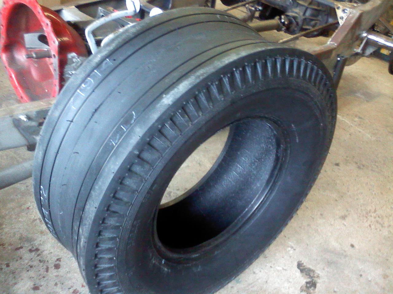

    So today i got the rear rubber...I'M STOKED!
    Radir Cheater's!!
    I want to say thanks for the crew at Hot Rod Ch***is and Cycle. Great service, excellent communication AND an Alliance discount.
    Thanks guys, it was a pleasure!

    Very nice, those rears will be hard not to use. How much shorter are the 15 inch cheaters ?

    Glad it worked out for you........cant believe he came off them. As always-nice score!

    Oh good LORD that looks great Tony!!! LOVE the rubber combo!!

    Both 16's and my new cheaters are 30" tall. The only difference is the 16's are 11" wide vs the 10 of the cheaters....
    BUT, the big problem is the dia cause i just spent a **** load on the cheaters.
    Honestly, the 15x10s i have will look the same as these, only they are the straight spoke design and not as nice, but they are still original magnesium..
    They are the ones i've had on the back of my truck for the past 2 years.
    Thanks a lot guys!
