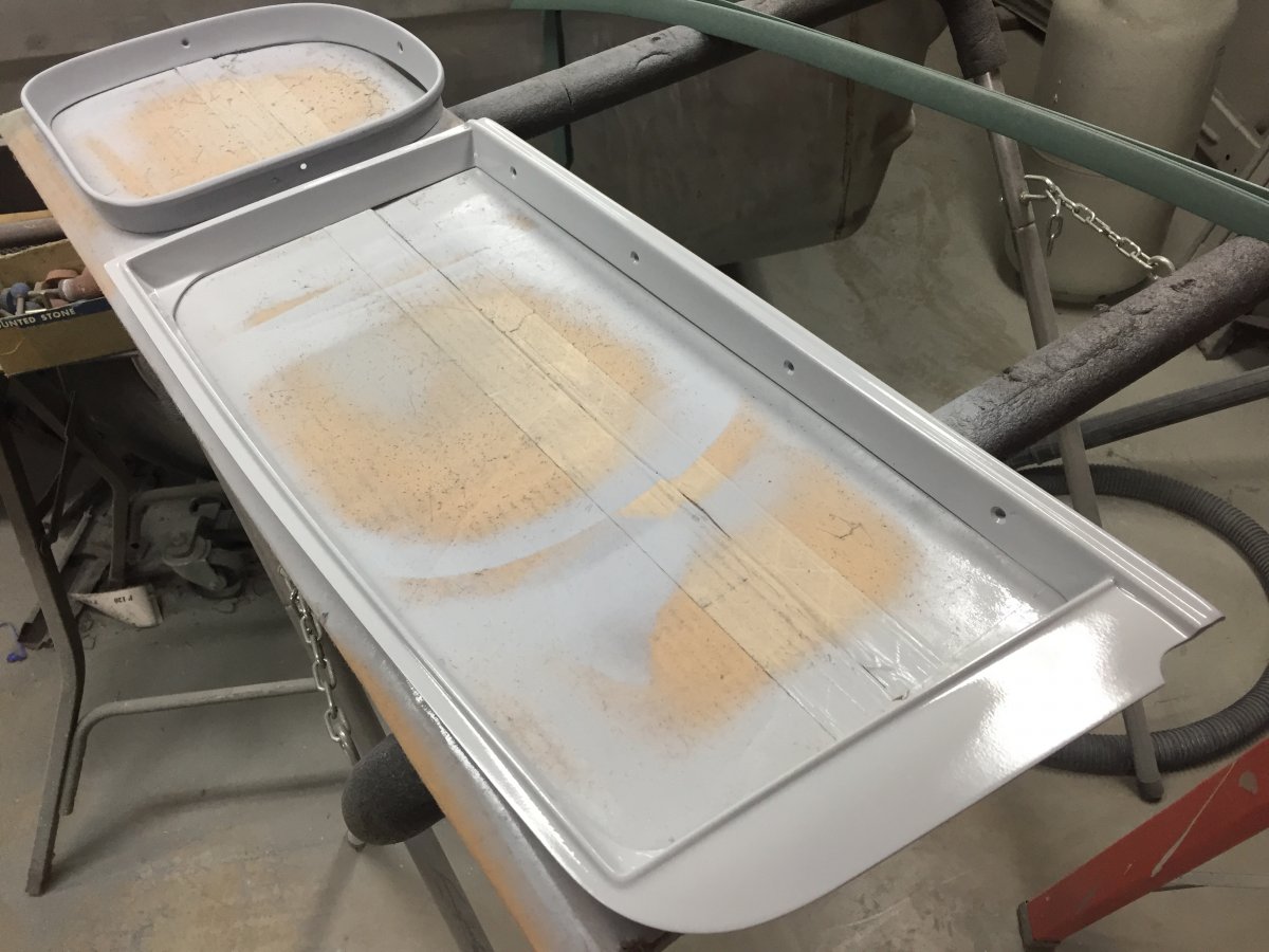

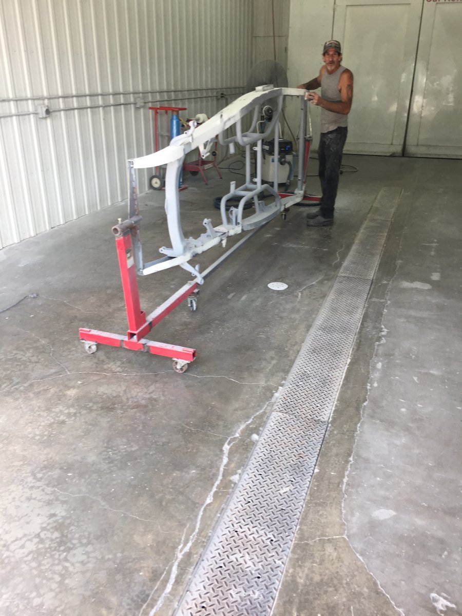

    Haven’t decided on windlace yet. What I found doesn’t impact the door to door jamb clearance a bit. It was just interference with a small area of the garnish molding. Just enough to keep it from closing.

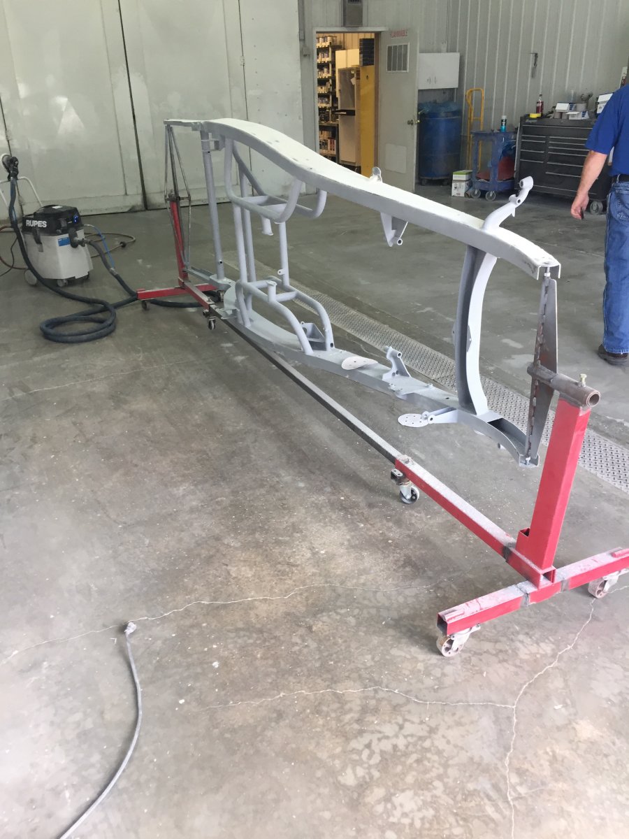

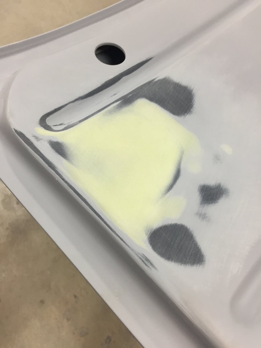

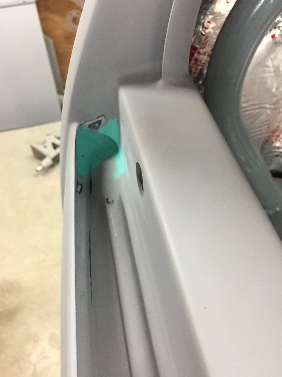

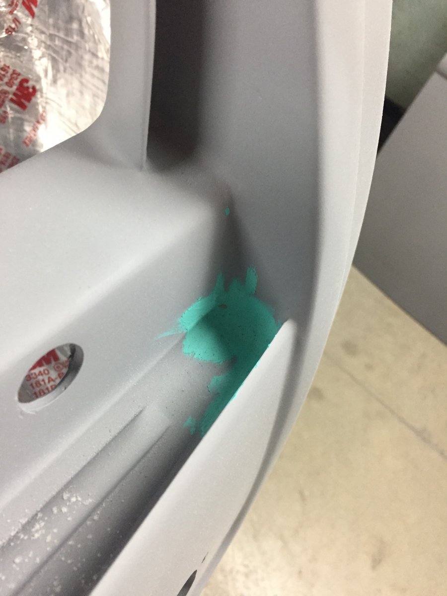

    Dropped the dash back off at the painter’s and caught them working on my stuff! One rail is completely done and the other will be today. He’s hoping to get it in all in primer yet today. Sounds like I’ll be working down there some next week sanding hi build.
    SPark
    F1BA1F77-8E70-44A7-9615-6E25CFD9912F.jpeg D9346BF4-F955-470C-AFF1-748A61EF70D6.jpeg

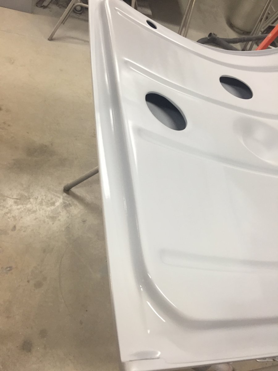

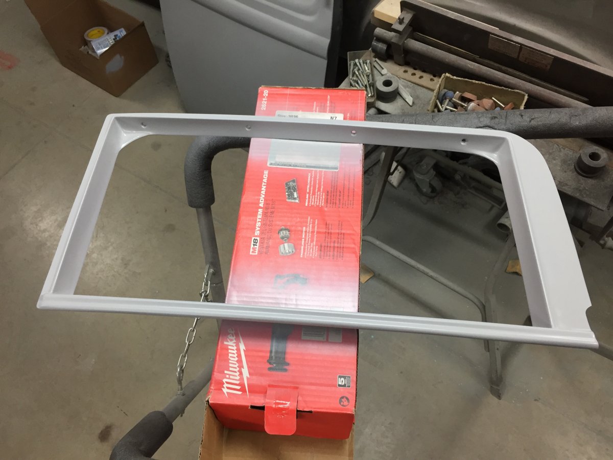

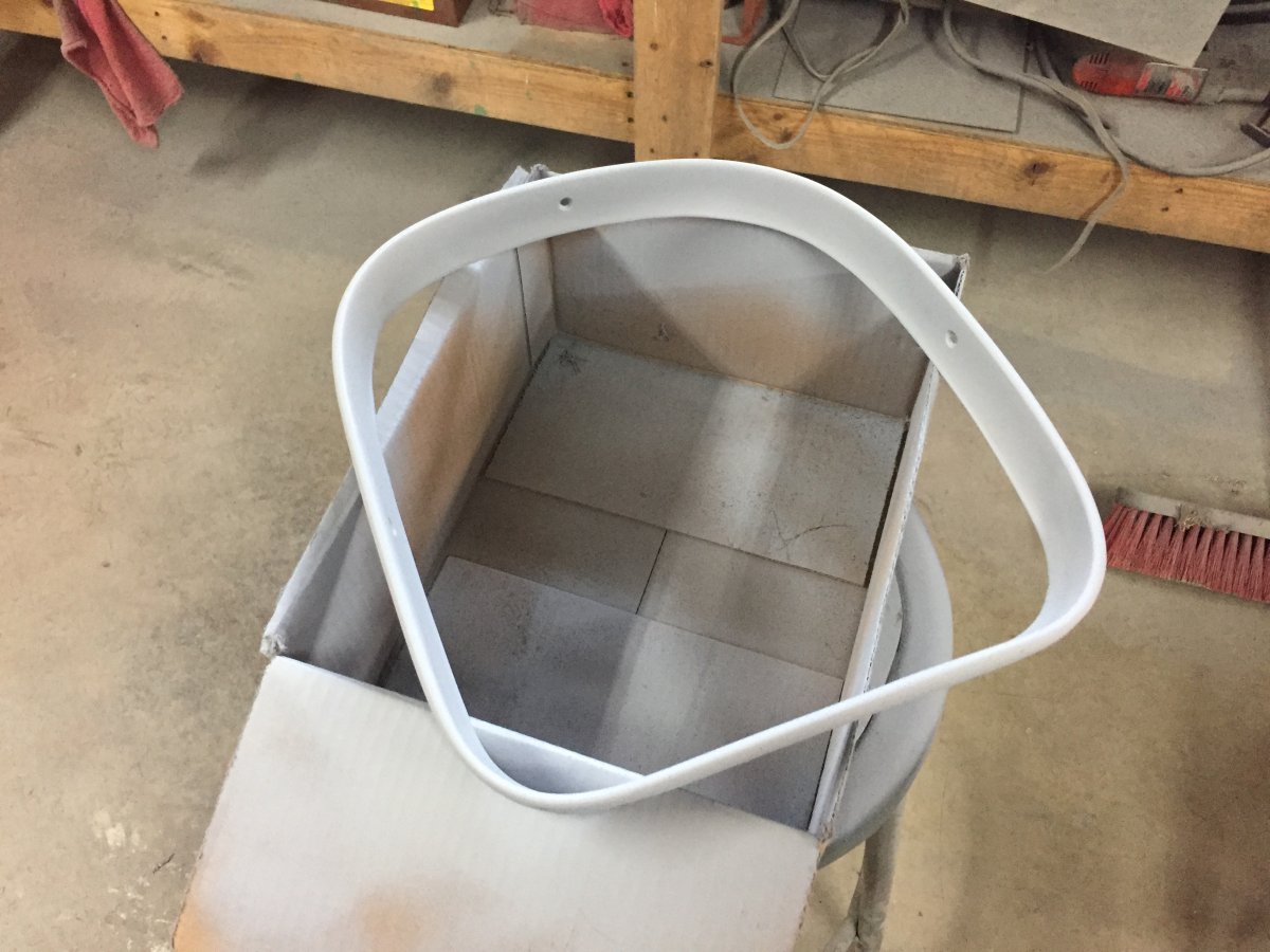

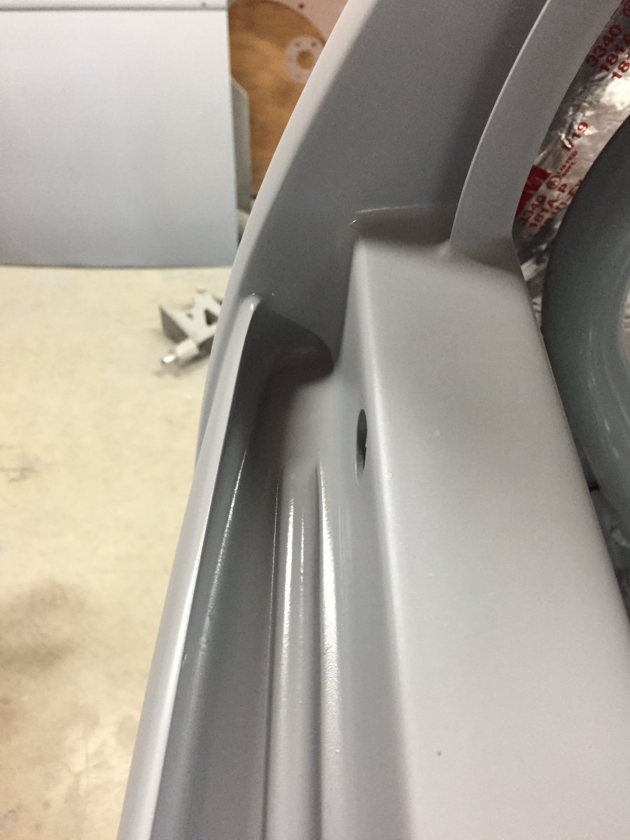

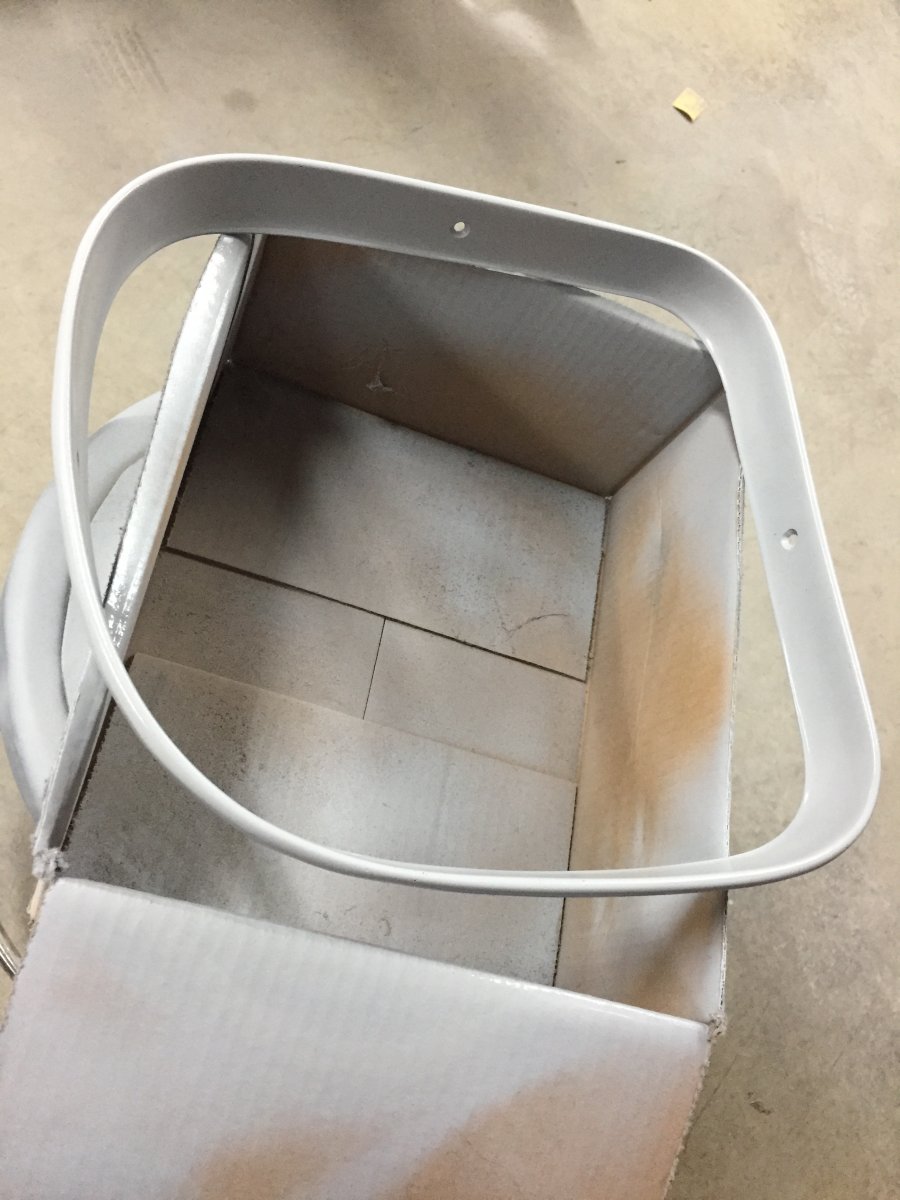

    Closer. At least now it’s in the booth and ready for primer! Got these from the painter last night.
    SPark
    E68333B3-33AA-4BFE-BF17-D88D4F36EBBB.jpeg 049EDDDF-834D-412F-B73D-2345E7AC13F8.jpeg

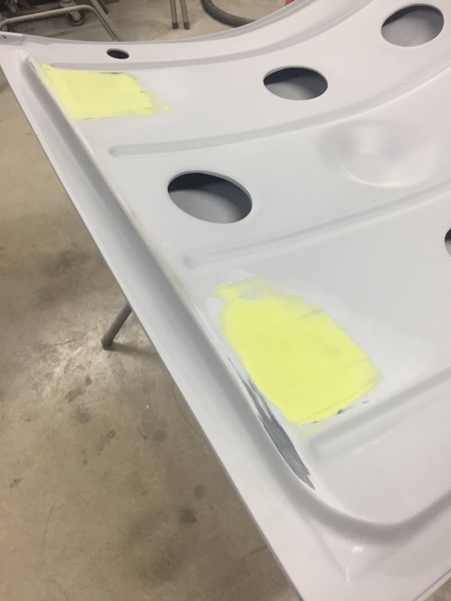

    It’s all in the details. That’s what bugs me the most.

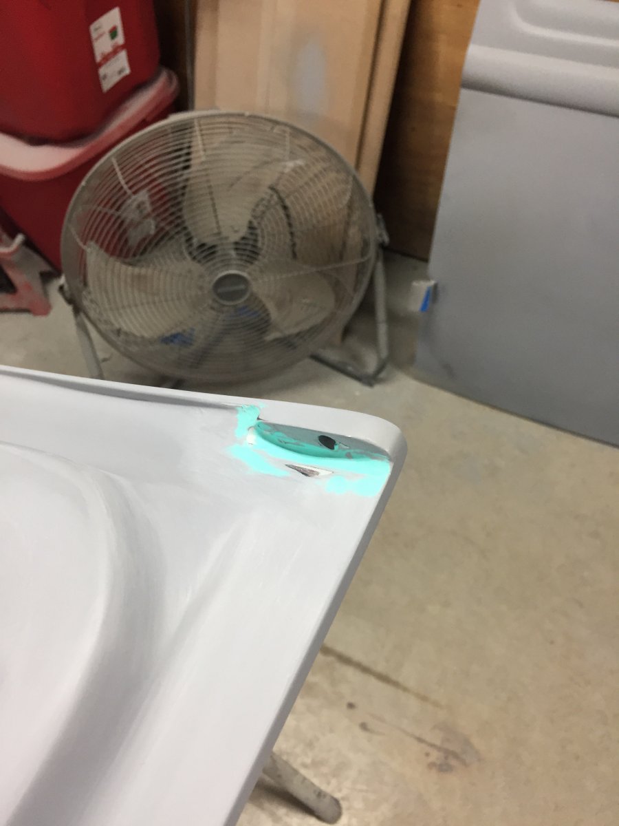

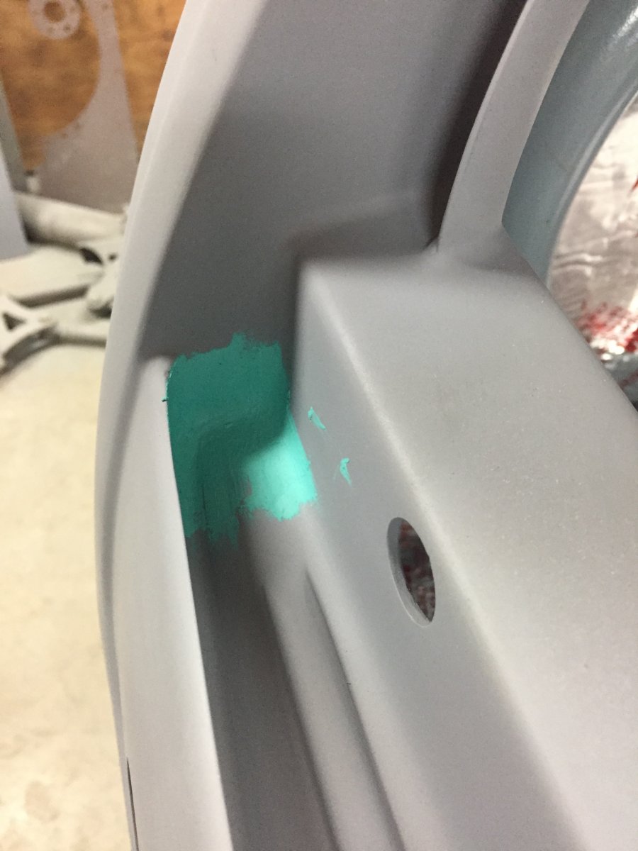

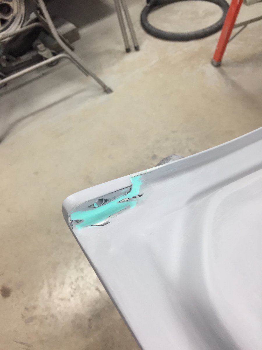

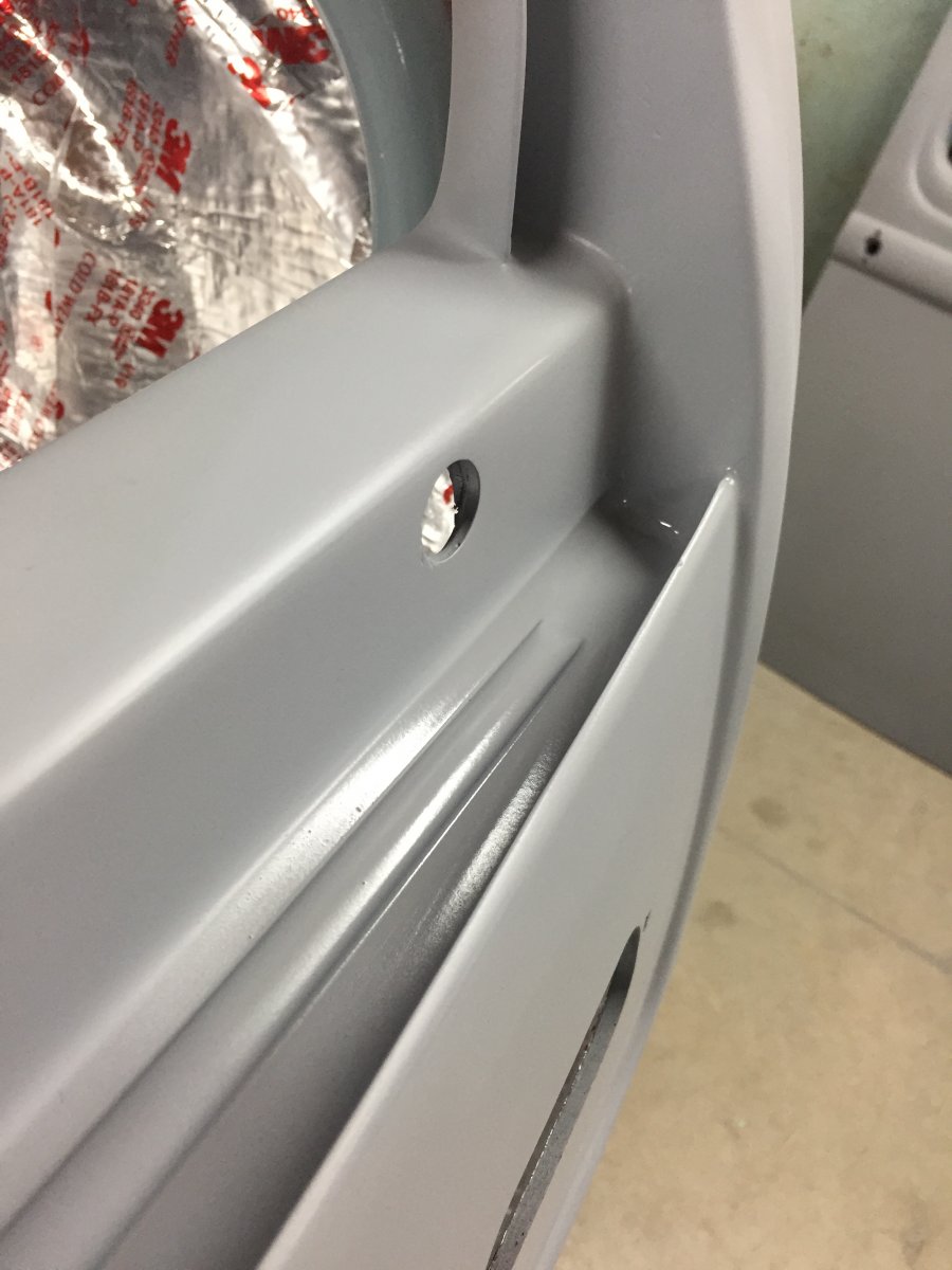

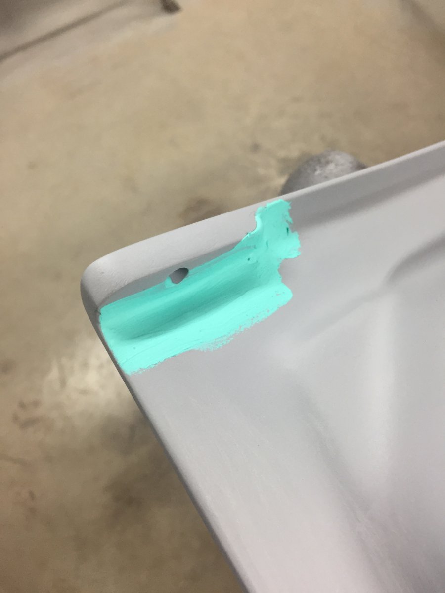

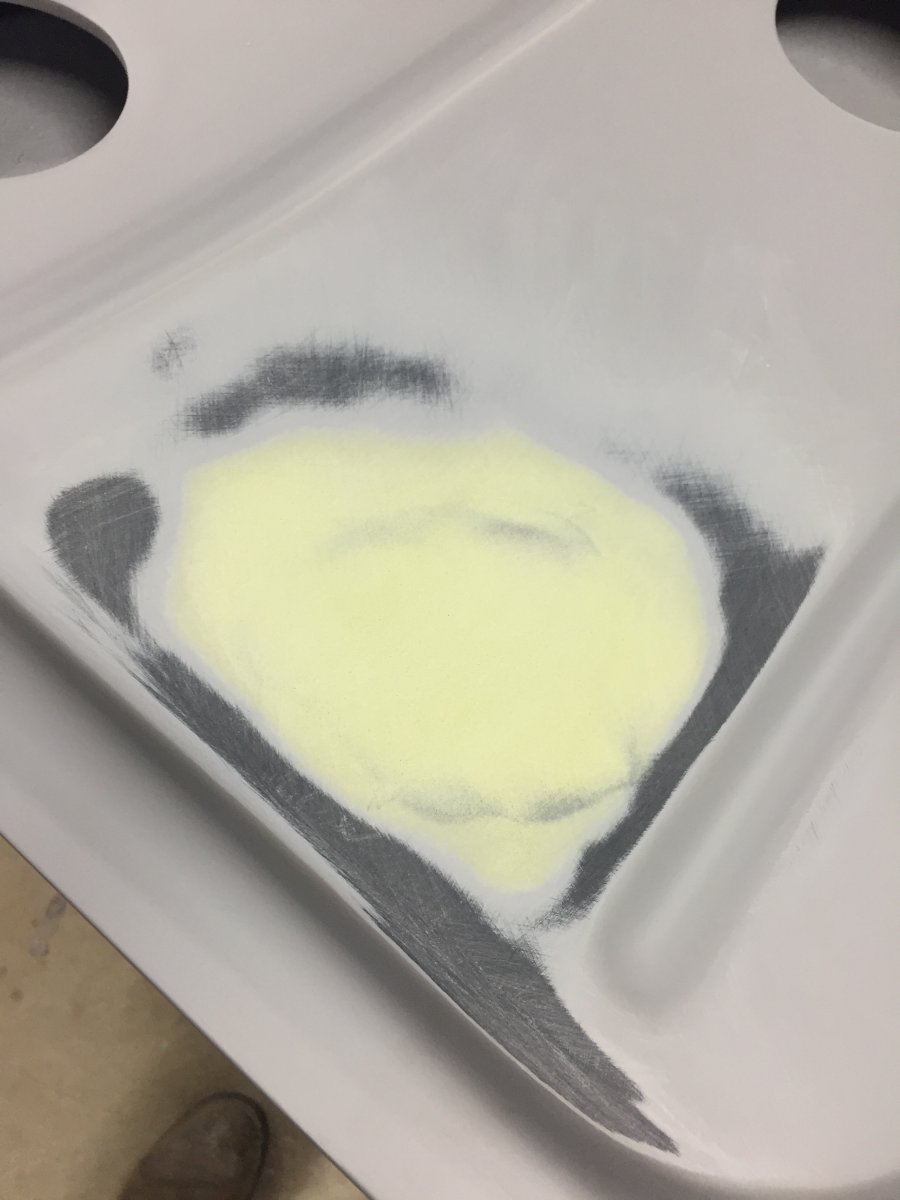

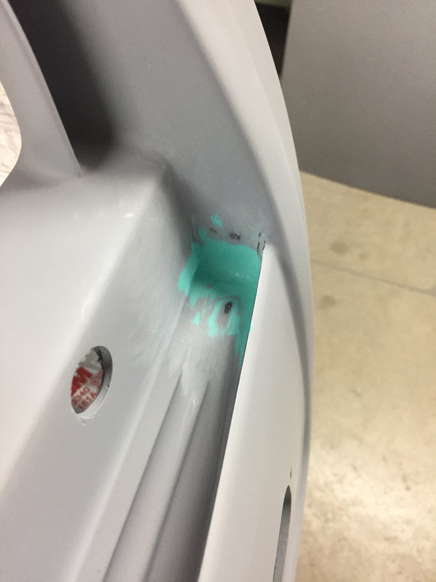

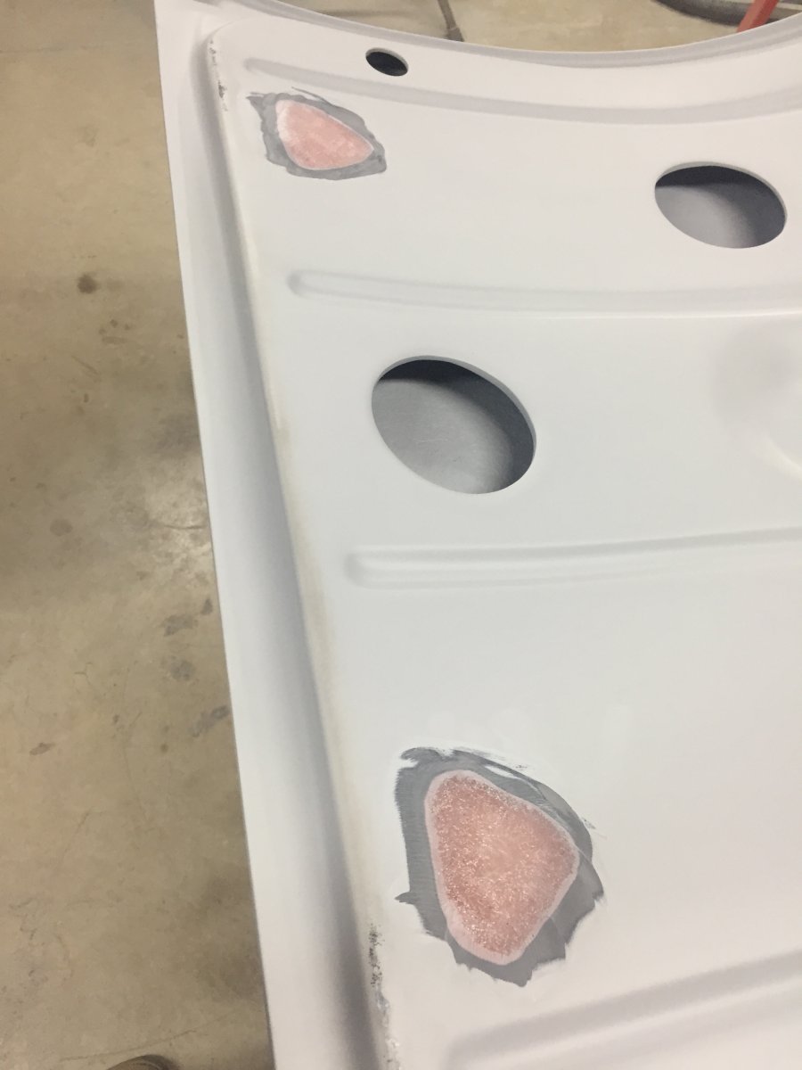

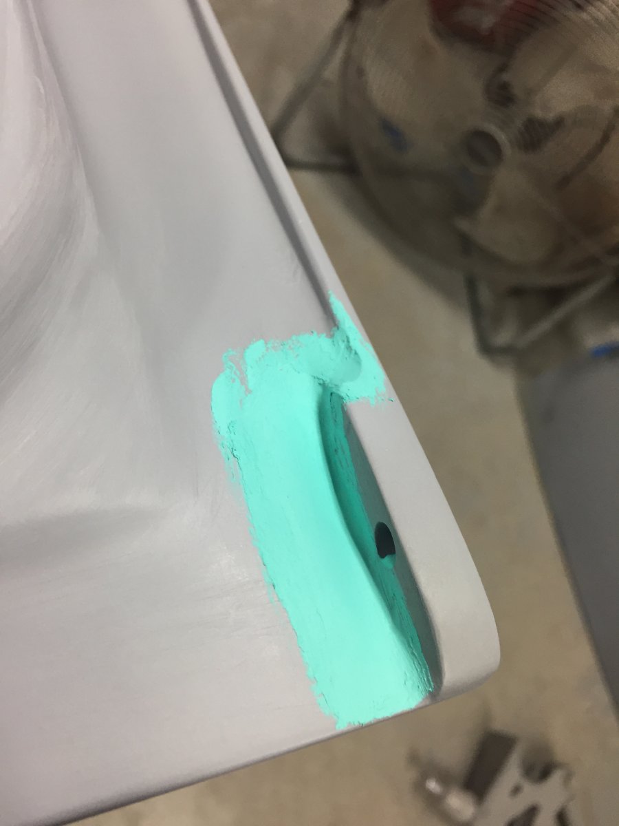

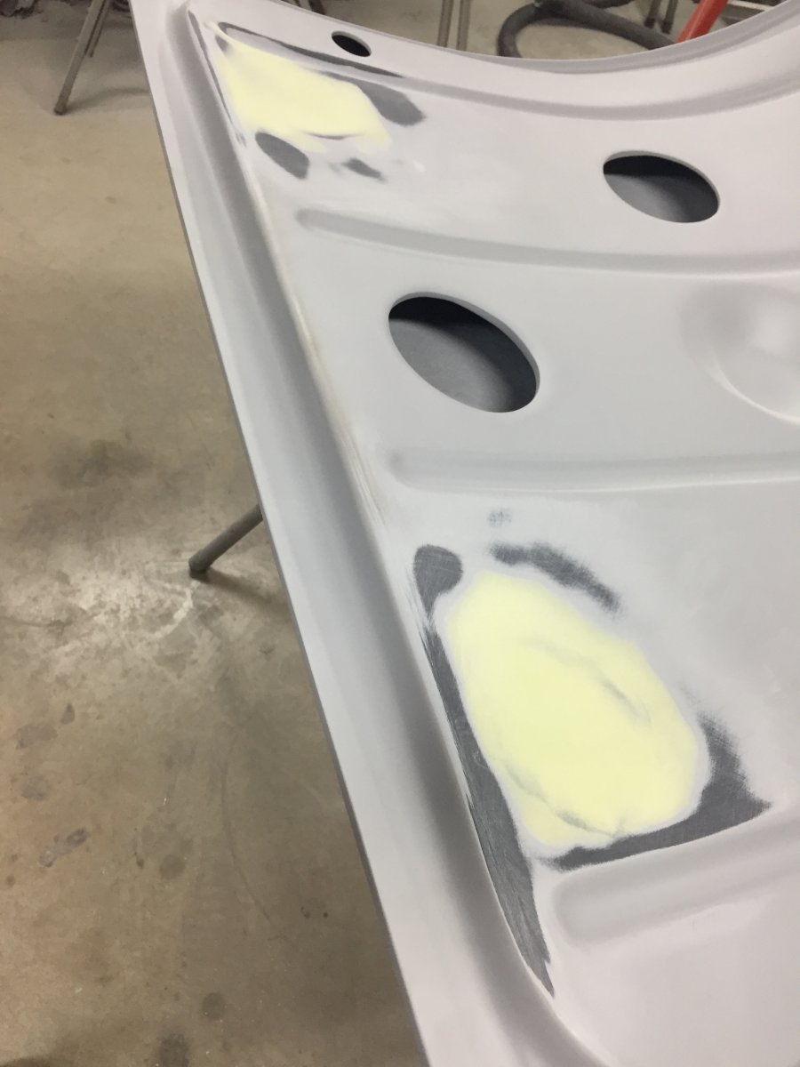

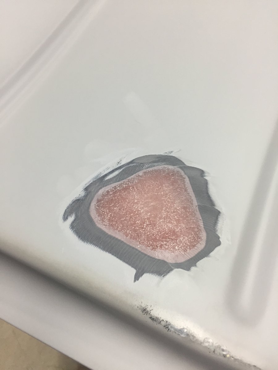

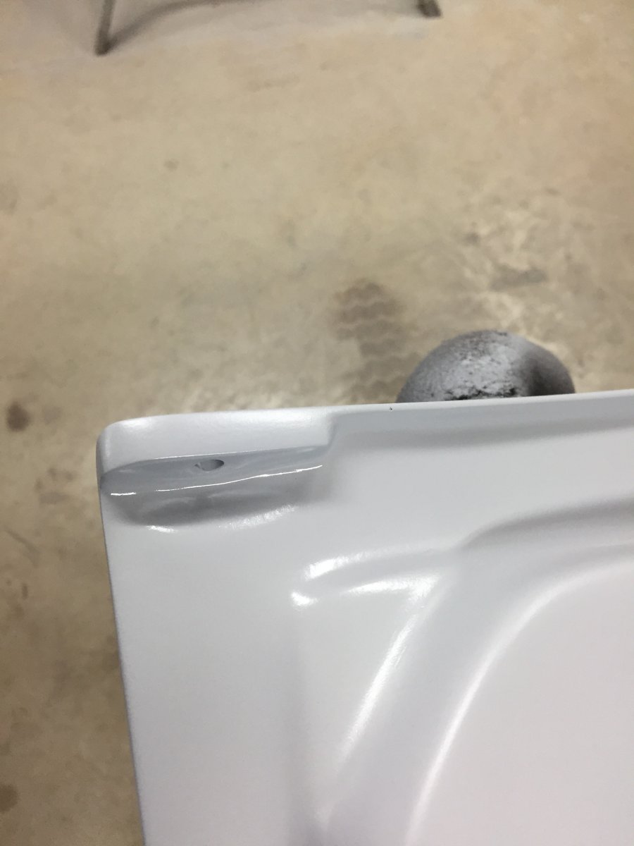

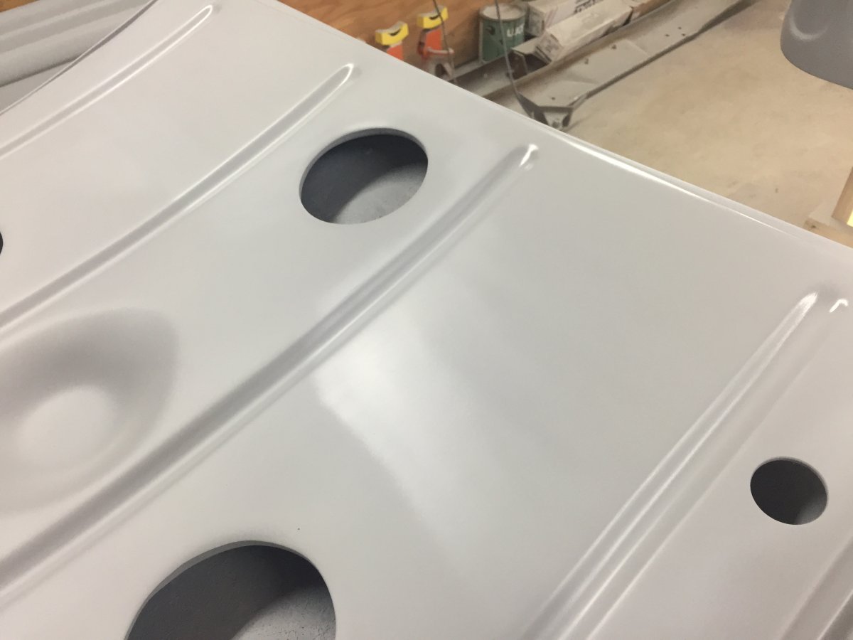

    Example: the trunk lid uses hinge pins that come in thru the sides. The inside of the lid also has 2 triangular pads molded in for another style of hinge. I know upholstery would cover them up but I was afraid it would keep it from sitting flush with the surrounding area.
    Solution? A few quick p***es with 60 grit on the 3” angle grinder, a thin skim of Rage Gold and a bit of filler primer.
    I think it looks a lot nicer. Now I have a clean looking trunk lid underside until upholstery is in and it will sit flat. My mind is happier.

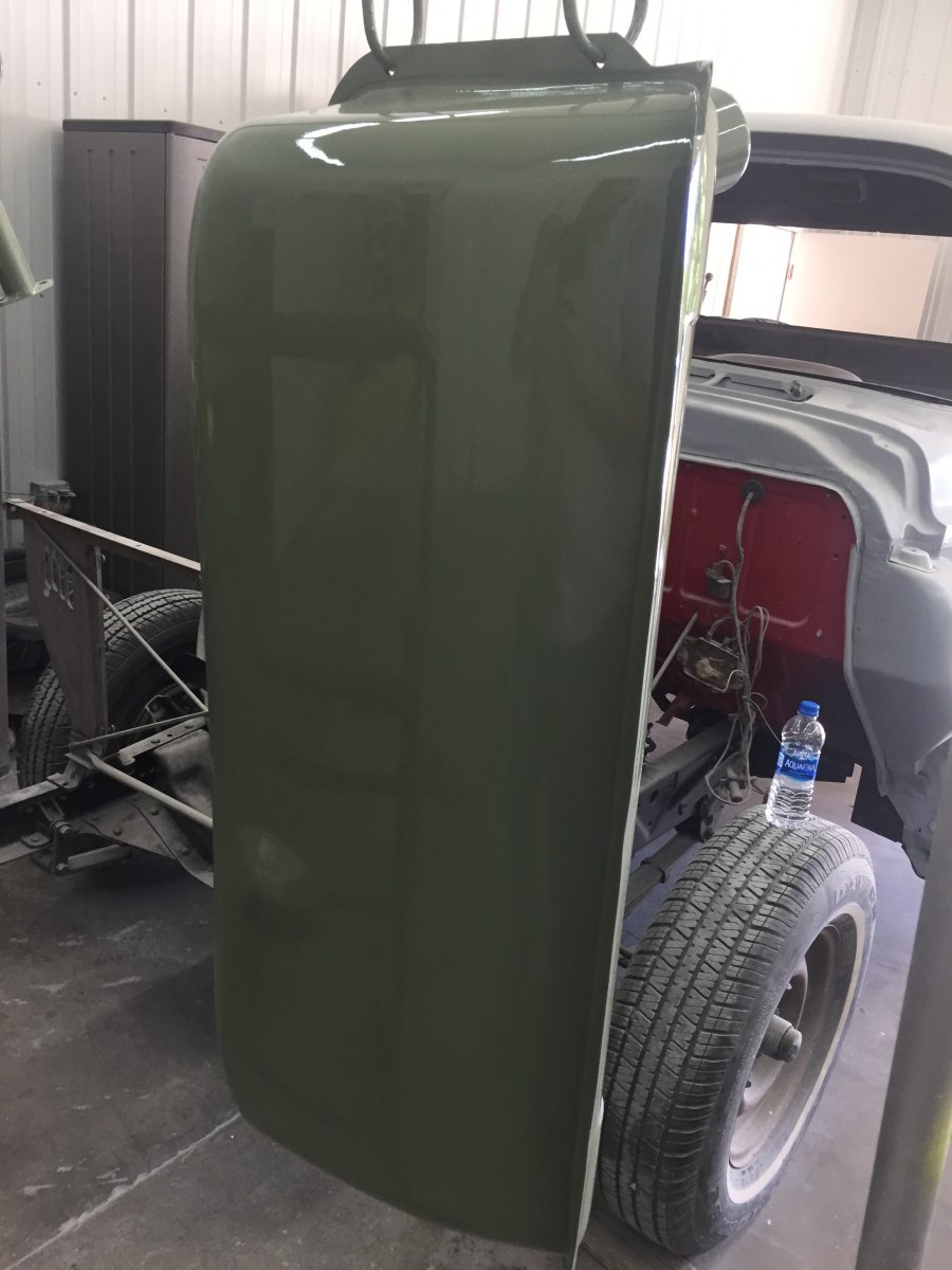

    Stopped by the painter’s shop on the way home from my latest ‘55 shopping trip Friday. Took them the grille shell insert so they could see how it sits in the shell. They plan to shoot some green this coming week. Also been working on the frame sanding. A few spots need a little more high build but we’re making progress.
    SPark
    76C02EDA-6EAC-4D16-9C9D-2990310D8182.jpeg 4E9CDFEB-8F55-49E9-A911-CA3192ADDA01.jpeg E2690368-90FB-4E3D-8A47-44FF933C131B.jpeg B715707F-41D0-4D58-9CD9-C4AB9D569499.jpeg 17C4614F-886B-4061-91A8-B5A39AE3F600.jpeg 3075B9B8-1A65-49B8-A9AF-12A5F61A8AF9.jpeg C8780F17-B79C-4C88-B686-5891E6F7836F.jpeg 9896BA0C-DE99-4861-9065-0B1E2375F203.jpeg 7331B710-67DE-4E05-9E60-C01061CCD8F2.jpeg 49EBAB3F-2AC8-461C-B35C-94460FB4CDA7.jpeg 42D38DB3-6176-4D7B-A0F6-4BD121D89233.jpeg DD4C83D6-1573-4F0F-9023-A6D0C5D00486.jpeg 2F1F6C94-E325-48DA-95E2-B4AA7D2AC808.jpeg

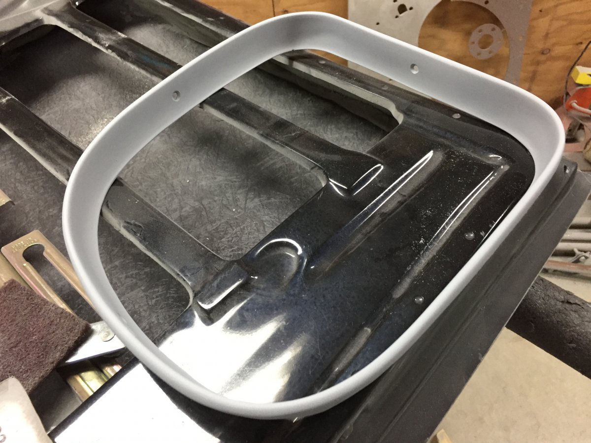

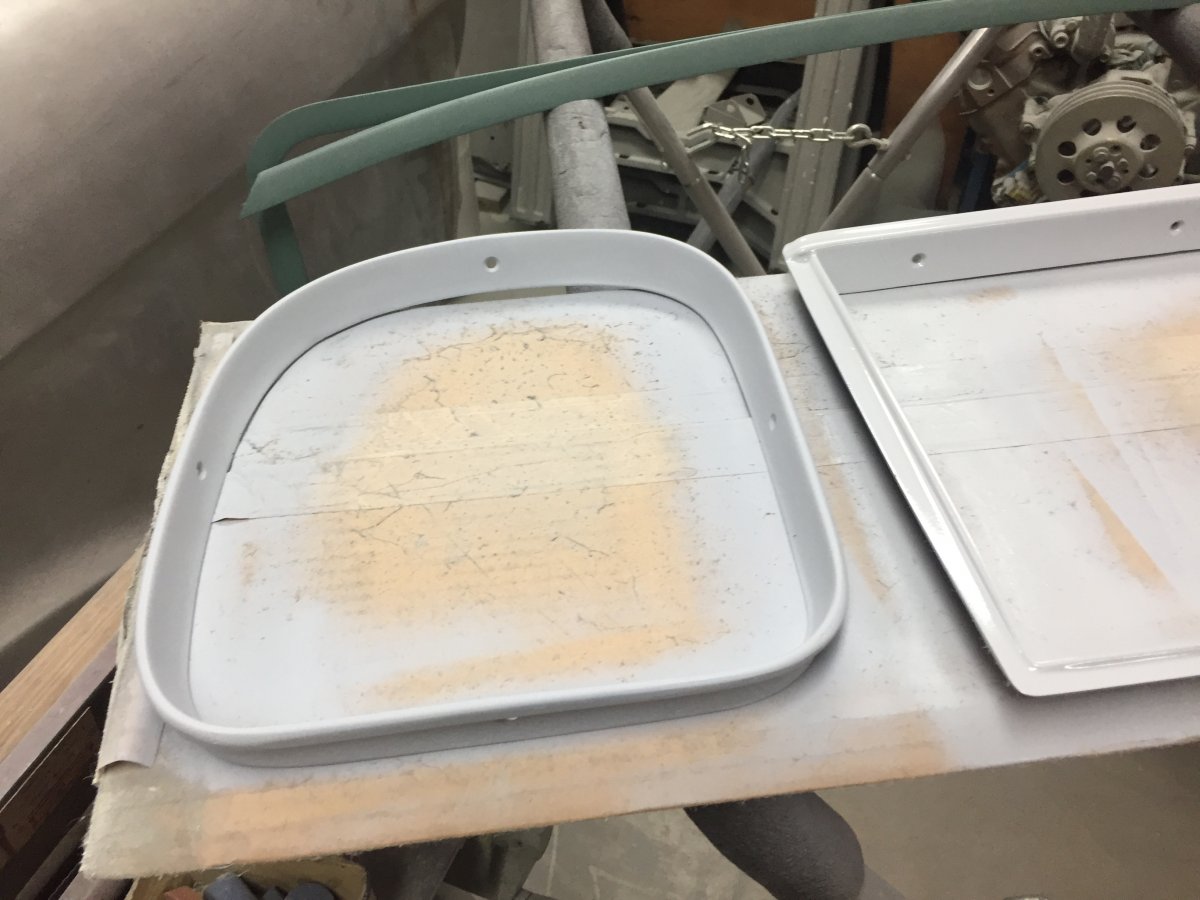

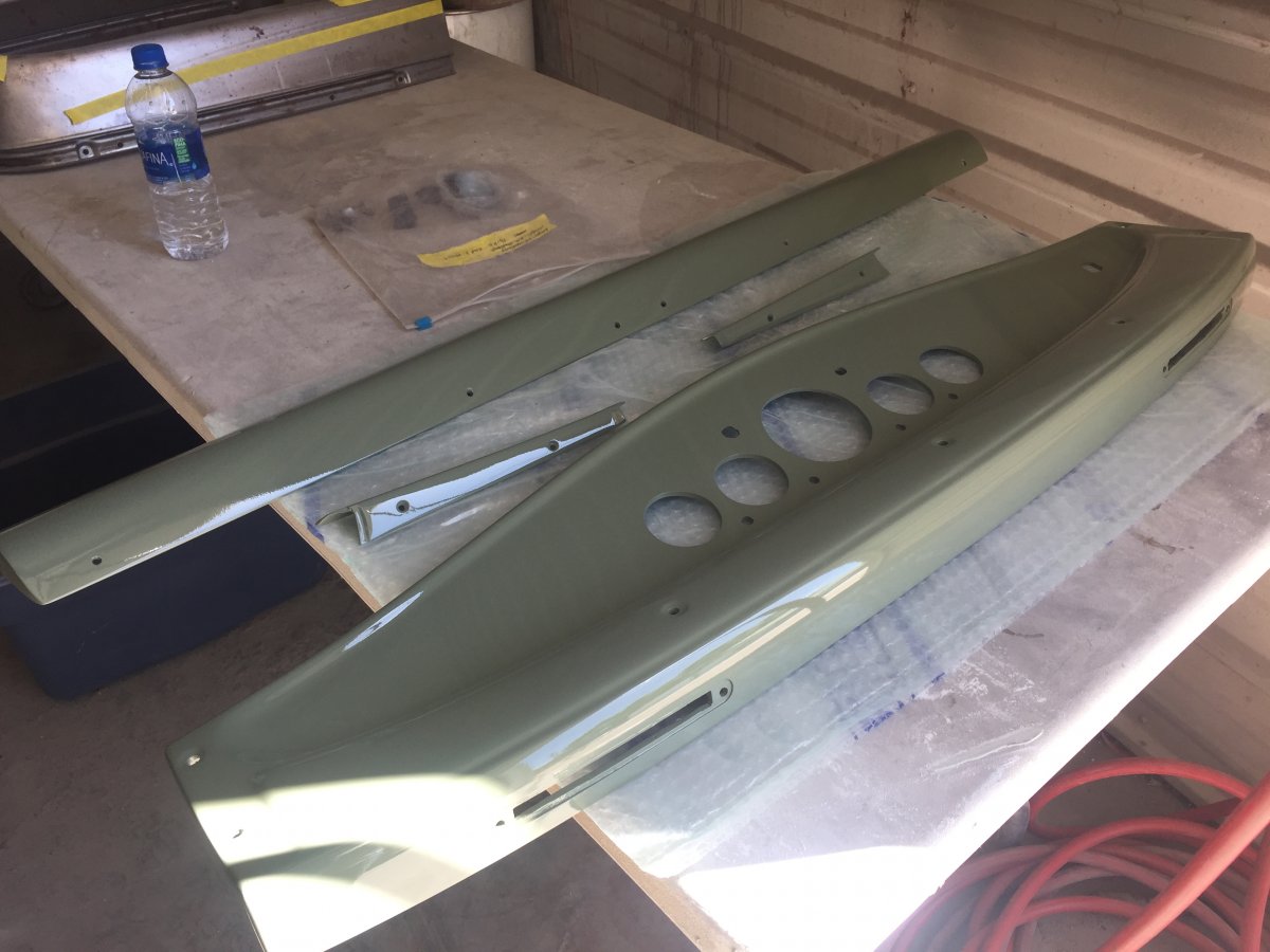

    Started on the garnish molding today. Left door and both quarter window pieces are getting close. Still a few pinholes and a couple gouges to deal with but the basic shape is now there. Not very exciting but it has to be done. Any progress is good.

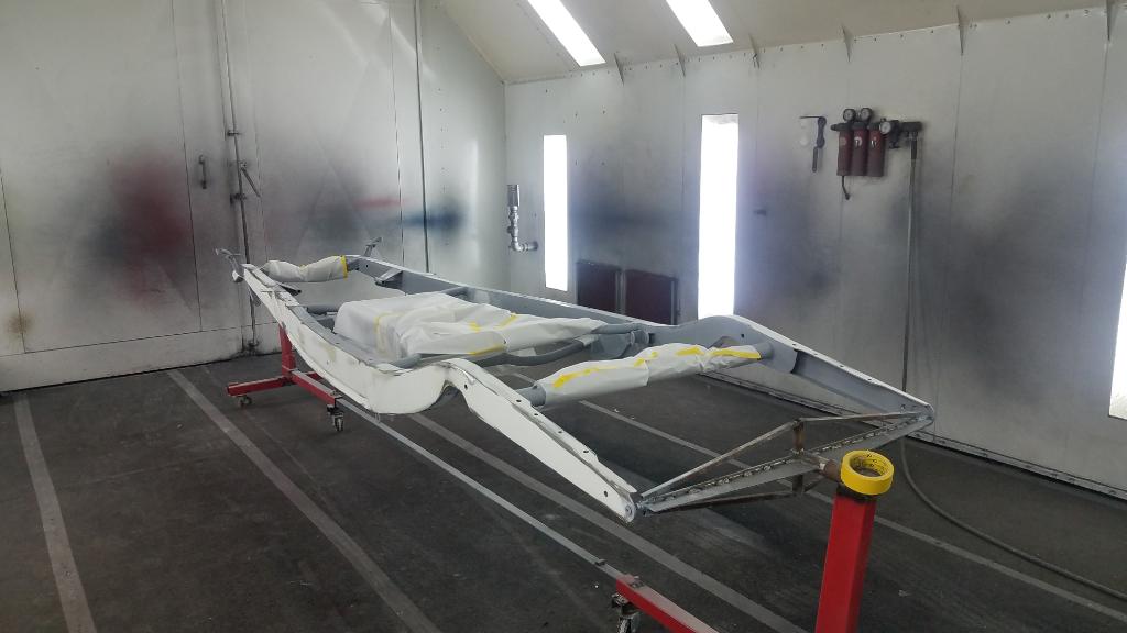

    Spent part of the afternoon today reviewing the frame work and approving it for paint. Tomorrow they do a little final sanding and detail work around Pete and Jake's ch***is numbers (that match the MSO and I have to show the DOT on inspection day, we've had them taped off since starting the project to preserve them), do a bit of sanding on the gas tank (body work on it is all done, just need to scuff the other areas) and hit everything else with 500 grit and get it cleaned up and ready to shoot the sealer and final color.
    They will be painting the frame, gas tank, dash, header panel and inside trim pieces for the A pillars all at once. The plan is to pick everything up next week and drop off the main body.

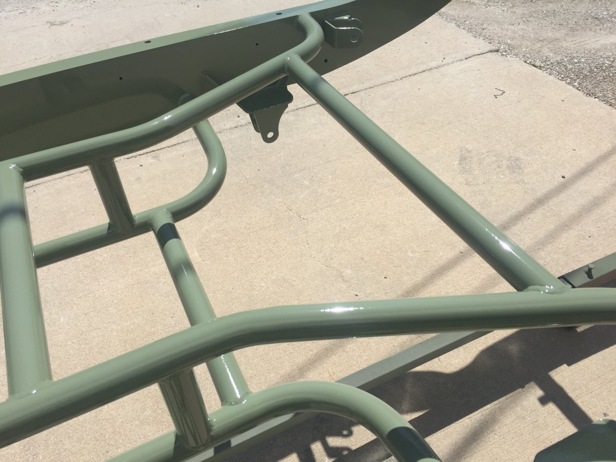

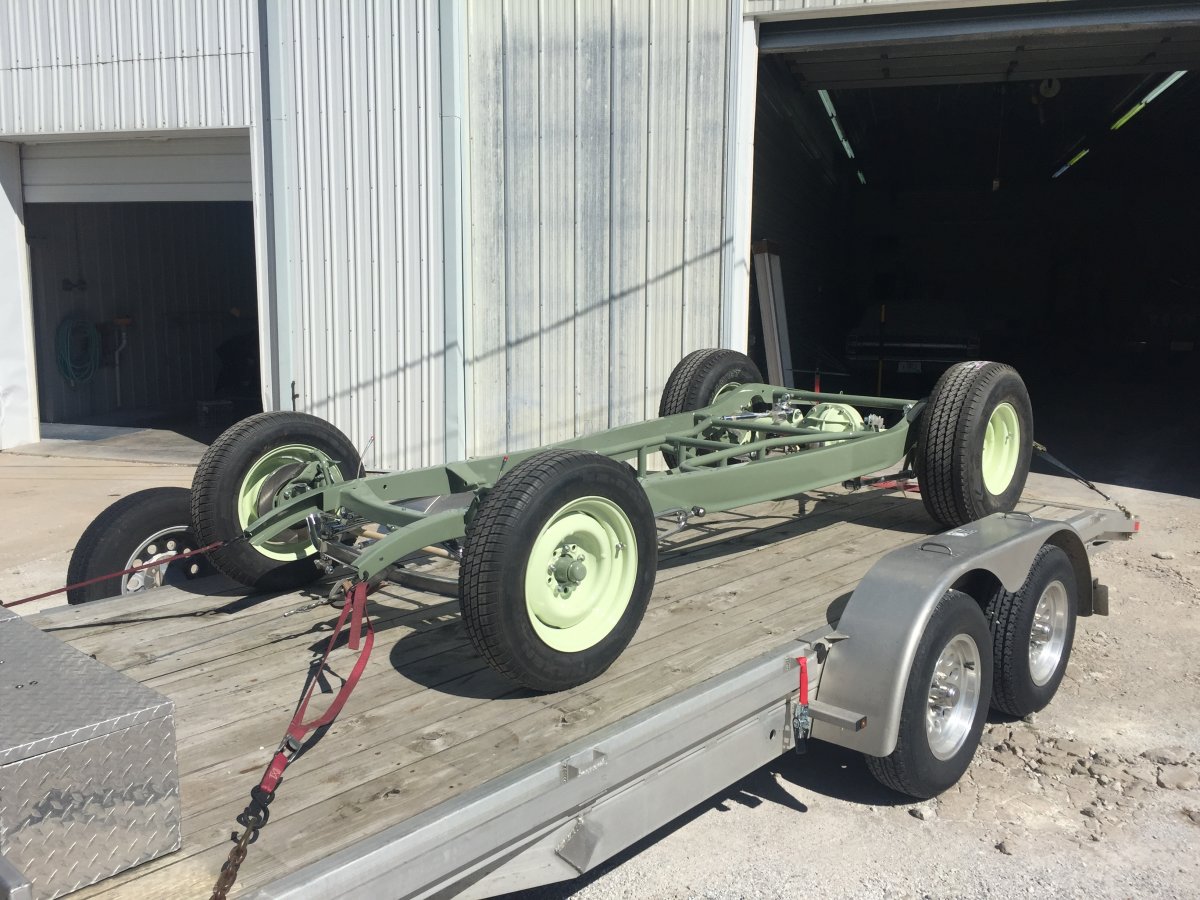

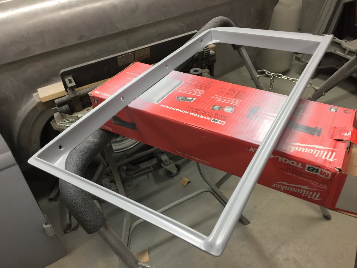

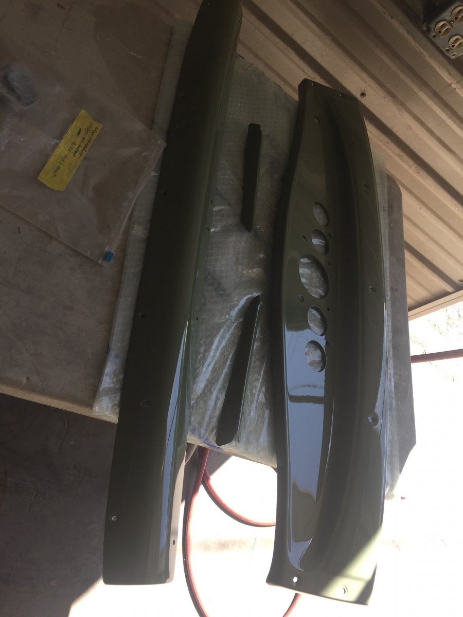

    Another week gone! Had some family issues to deal with on the in-law side the first part of the week and had another infusion on Wednesday afternoon so not much accomplished.

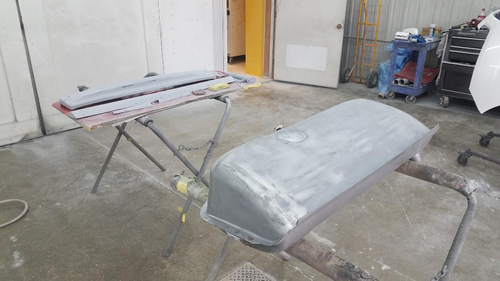

    I was at the painter’s shop Thursday. The frame, gas tank, dash, header panel and a pillar trim is all ready for sealer and paint. We have progressed but not as fast as I would like (and need).
    Needed another toy to play with. Found a 2007 Mustang GT with only 8,780 miles on it last week and bought it. Plan to put miles on it. Cold air intake, fatter tires, strut tower brace, axle back Shelby 500 exhaust and a Hurst short throw shifter so far. Should be around 310-320 HP at the wheels. I can’t see how people work on these things with all the hoses and all the wiring. Frustrating to me but it is a hot rod. Runs and sounds like one. They run hard for what they are. It’s fun but it’s not the ‘32!!!!

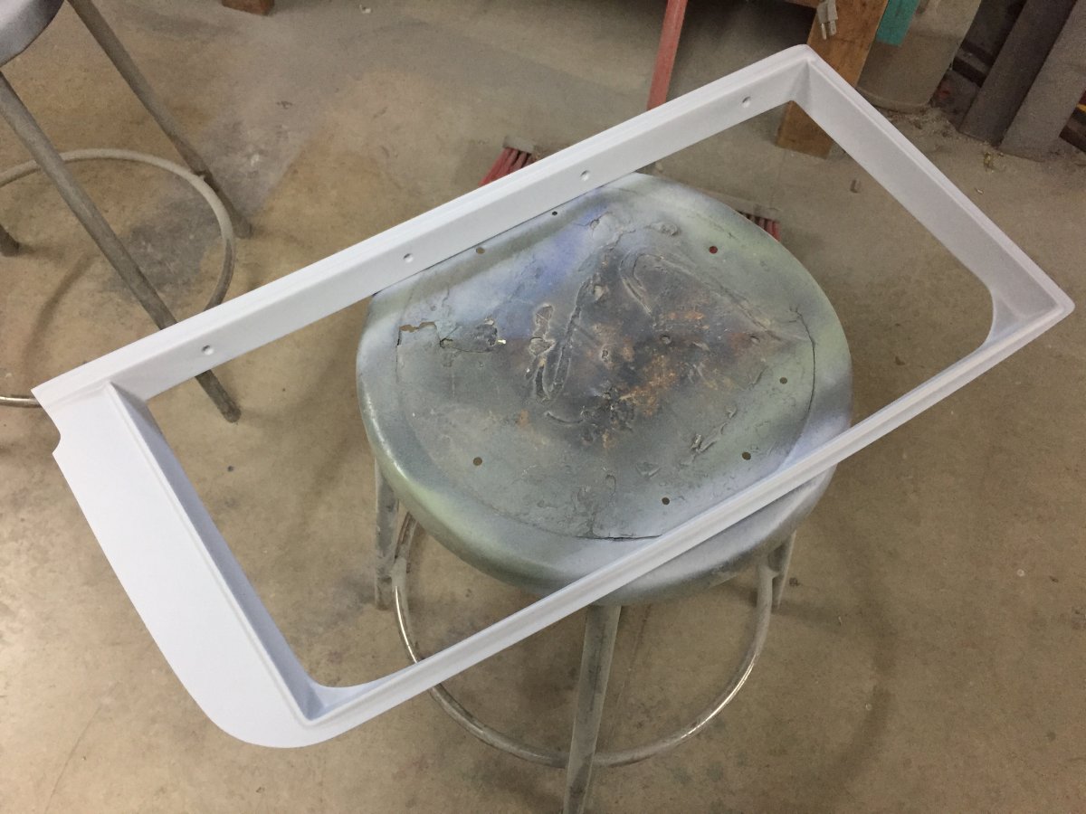

    Still working on garnish moldings for the ‘32. All are sanded and trimmed to final shape. Filling pin holes and detailing them. Another day or so and they should be ready for hi build primer. Feels good to be back working on it instead of messing with all the other distractions of life.
    SPark
    8A80B88B-84F2-465F-802D-F89458C2E767.jpeg 73159A2D-DF75-406C-ADEA-0FBEE58933C2.jpeg 837BFB21-A883-4A08-9789-C8AB7669A758.jpeg 1279B3FA-597E-4AD8-A7AA-AC4B270B7573.jpeg 4E51E348-C0C9-4C51-B668-6B967A4A1A03.jpeg

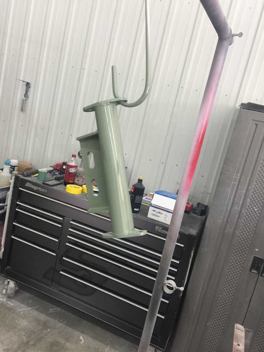

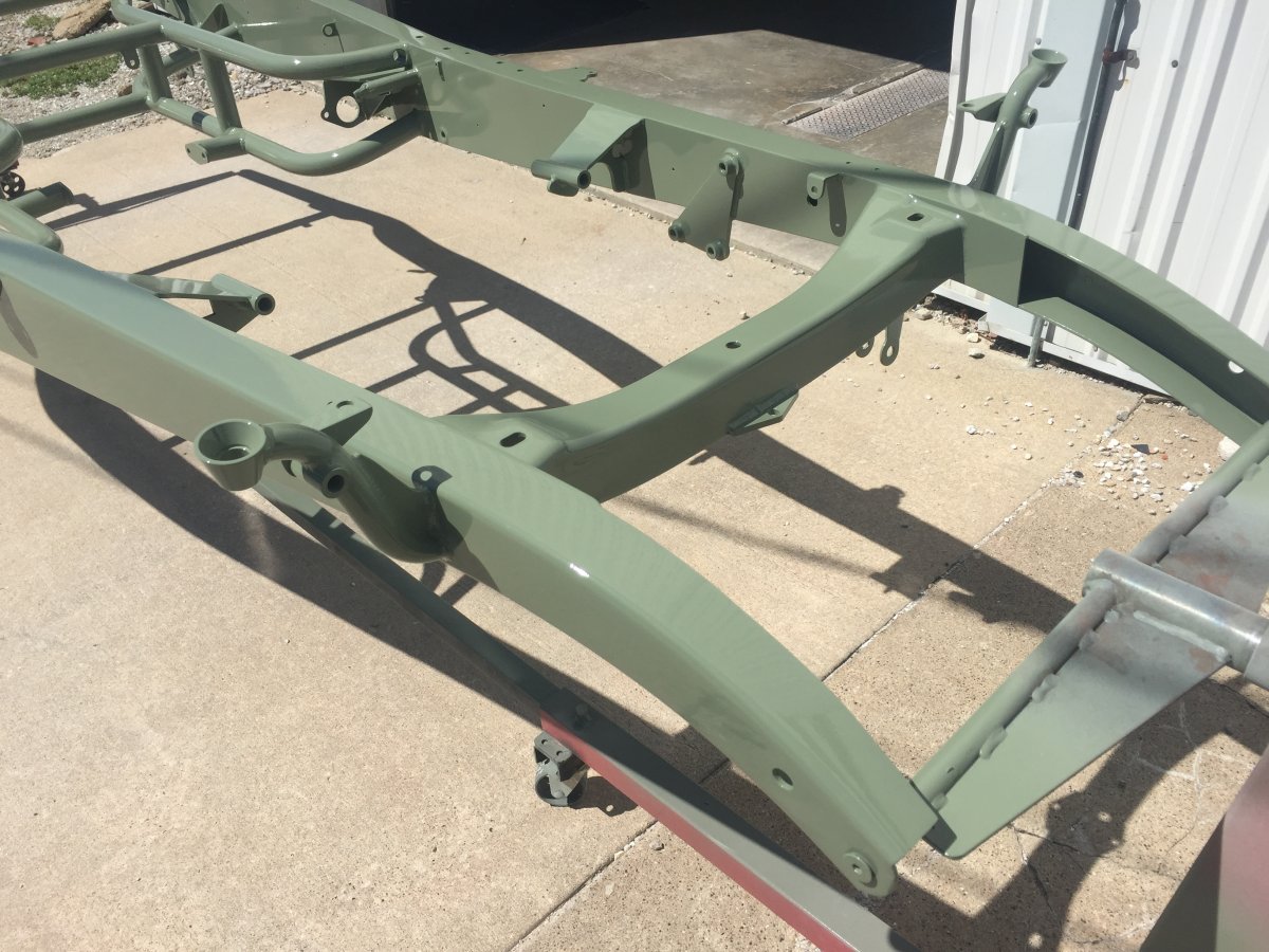

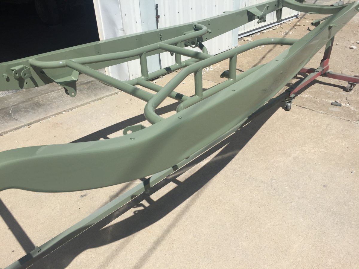

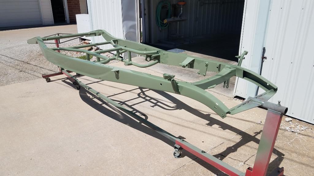

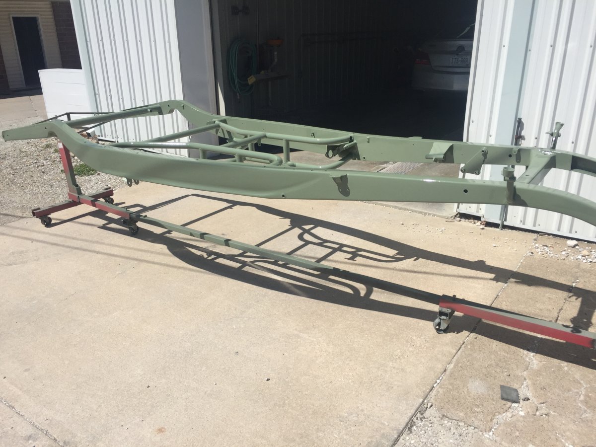

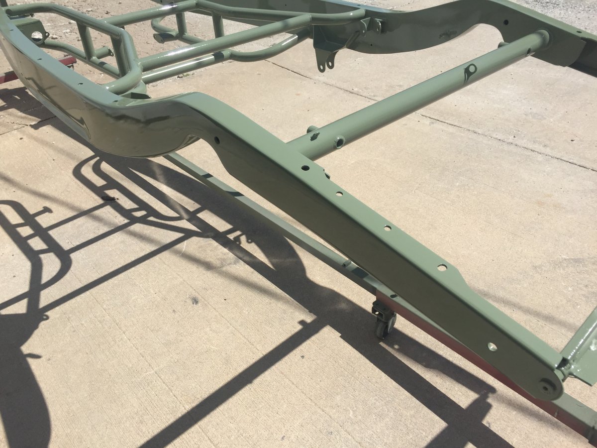

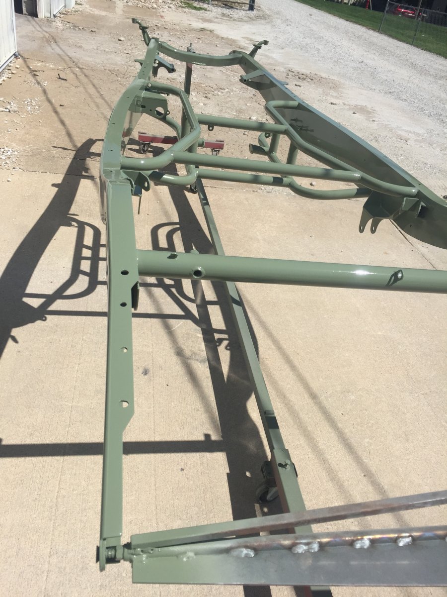

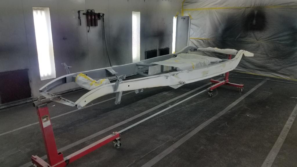

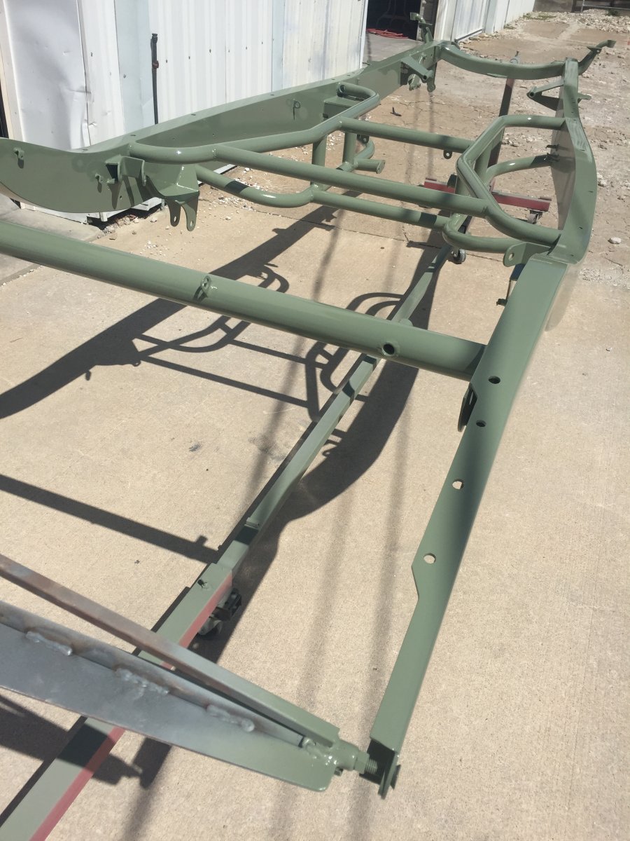

    Frame was painted this morning! Think they also did all the other little pieces they had (Dash, Header panel, A Pillar Trim and Gas Tank). Plan now is to cook it the rest of the day, let it cool slowly tomorrow and pick everything up on Wednesday and leave the main body with them.
    I stopped by around 10:30 this morning to check on things and the painter came walking into the office about 10 minutes after I got there, still wearing his coveralls. He was done and wanted to know if I wanted to see everything. The shop owner stopped that. Didn't want me seeing it until they cooked it and had a chance to inspect for flaws or issues, plus he wanted to torture me a little. No pics, they wouldn't let me in the paint booth! I did get one tiny pic from him later this afternoon but it's so small you can't really see anything. He's messing with me, now. He did say it came out really nice. Guess we'll see Wednesday morning!
    Good progress, finally!

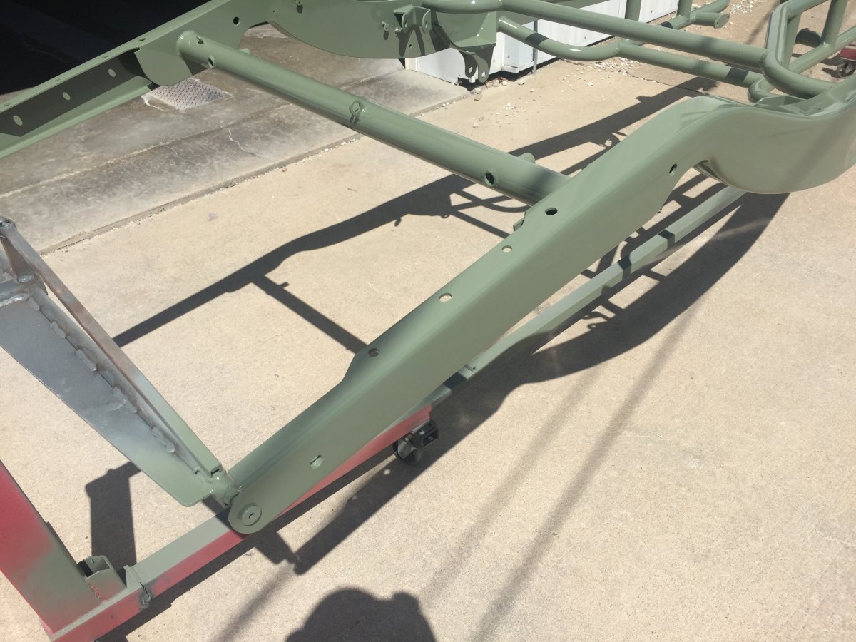

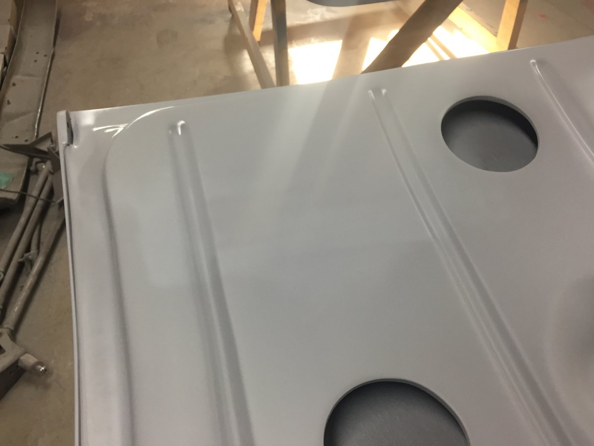

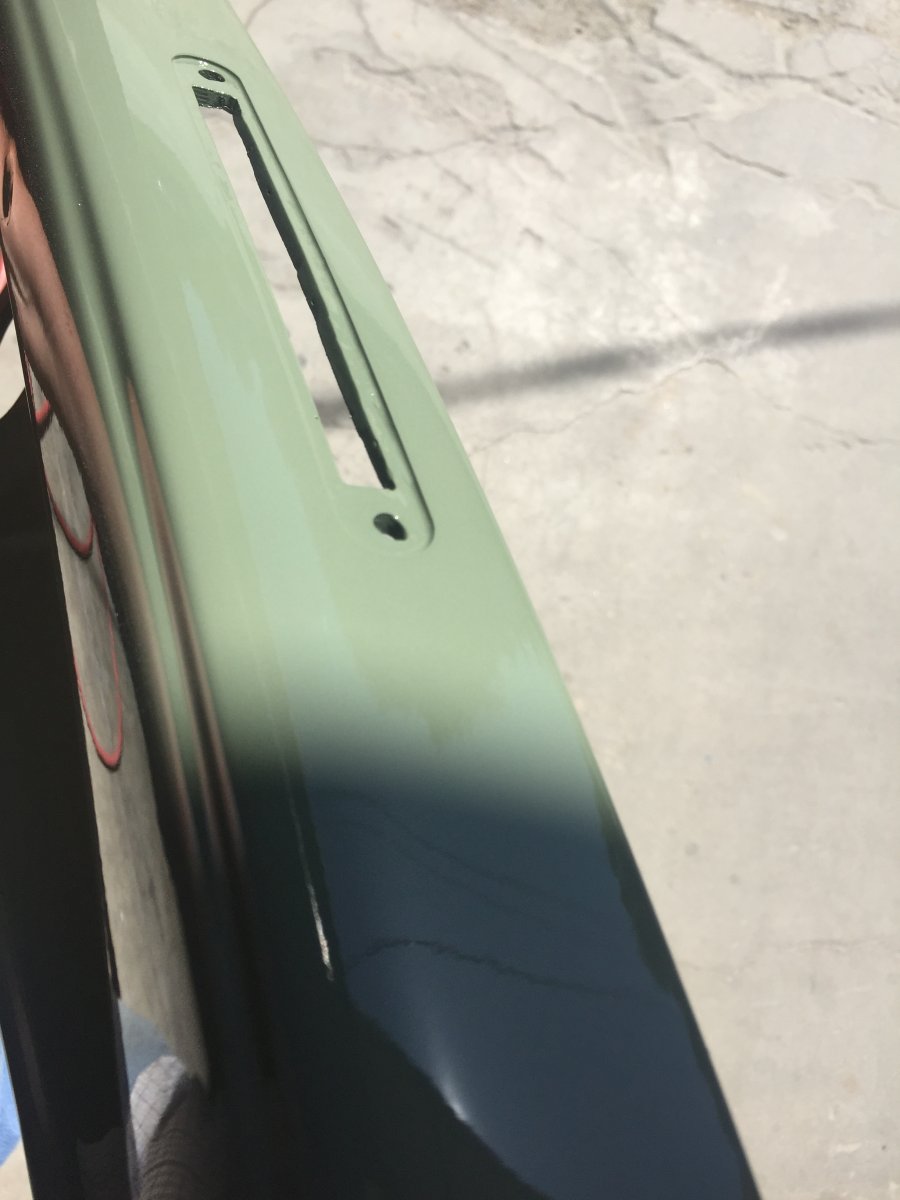

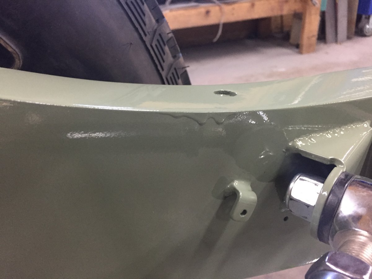

    Paint looks great! 1 run where you will never see it unless the body is back off. Perfect spot to put the run. Dash and all the other pieces look perfect.
    Couldn’t be happier with it. Got the look of old Skool paint without all the surface shine of a base/clear paint. Think single stage was the way to go on this one.

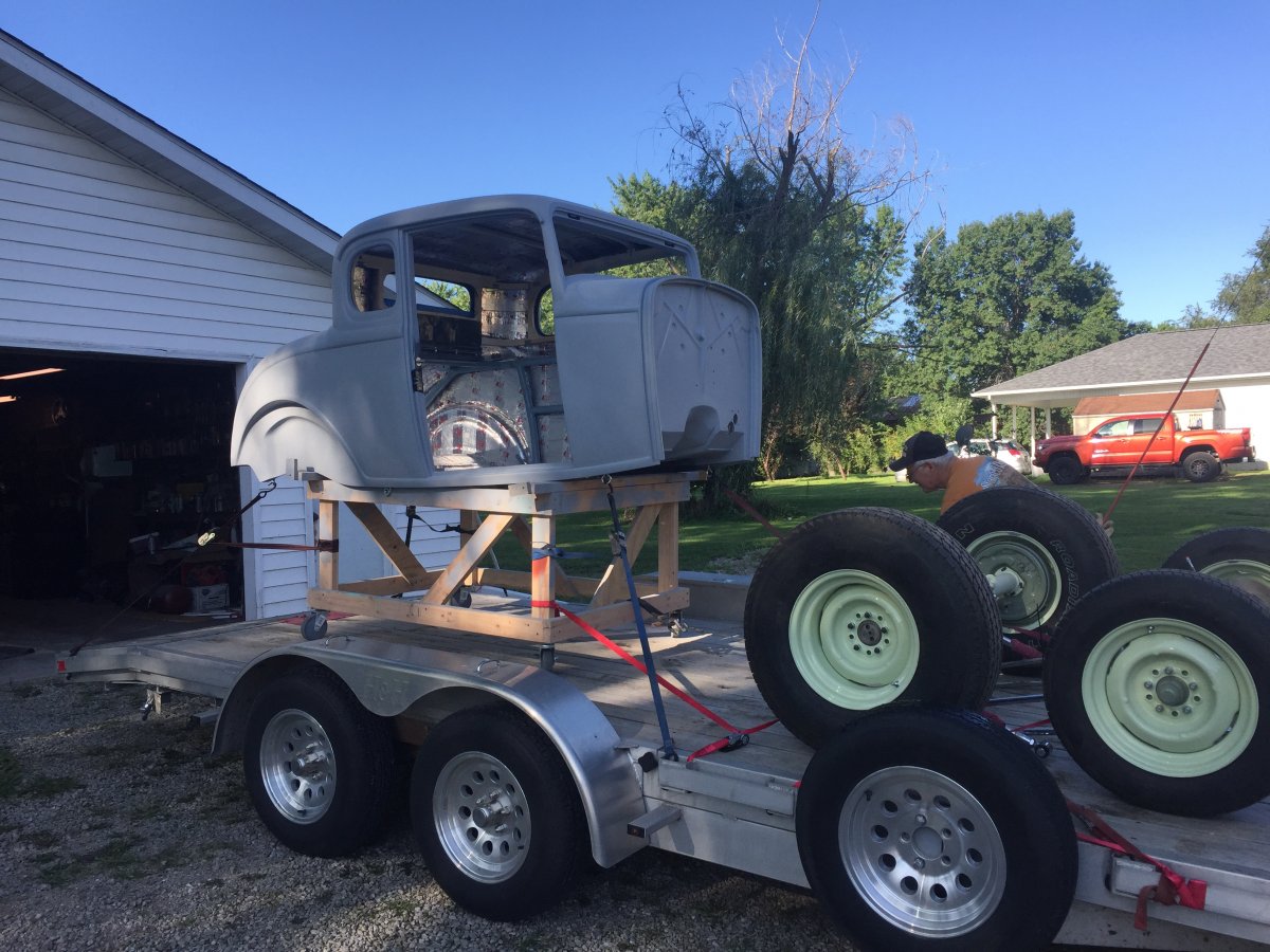

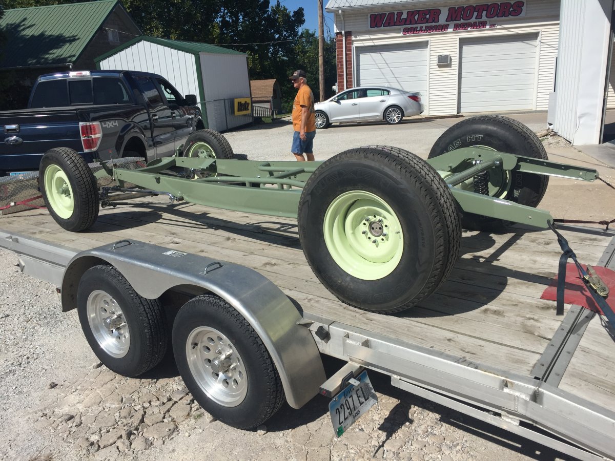

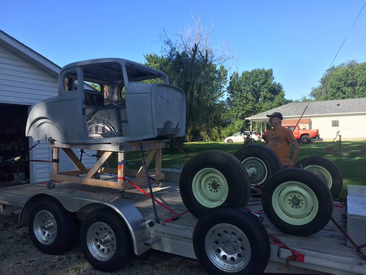

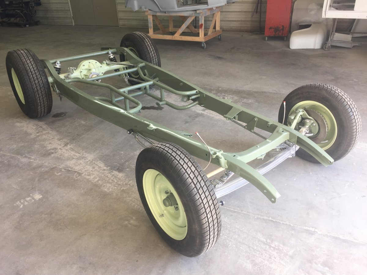

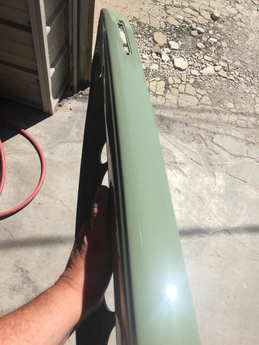

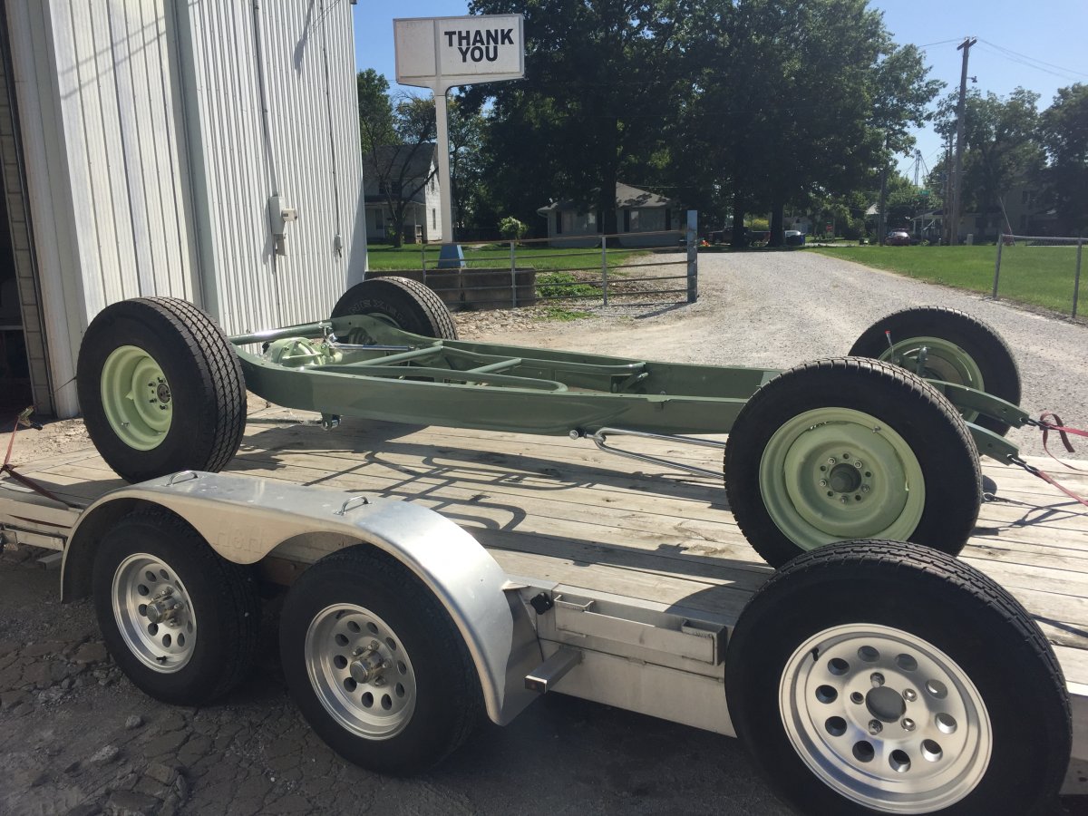

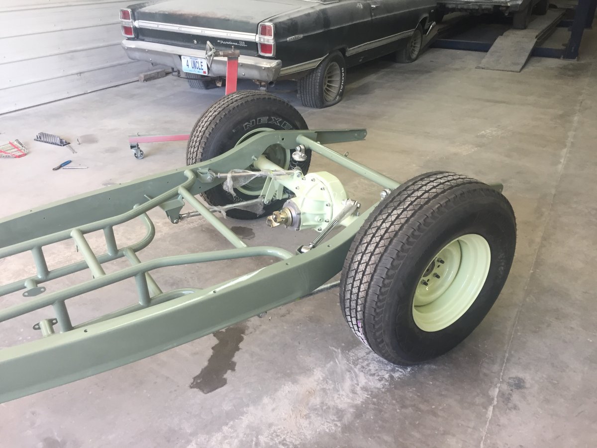

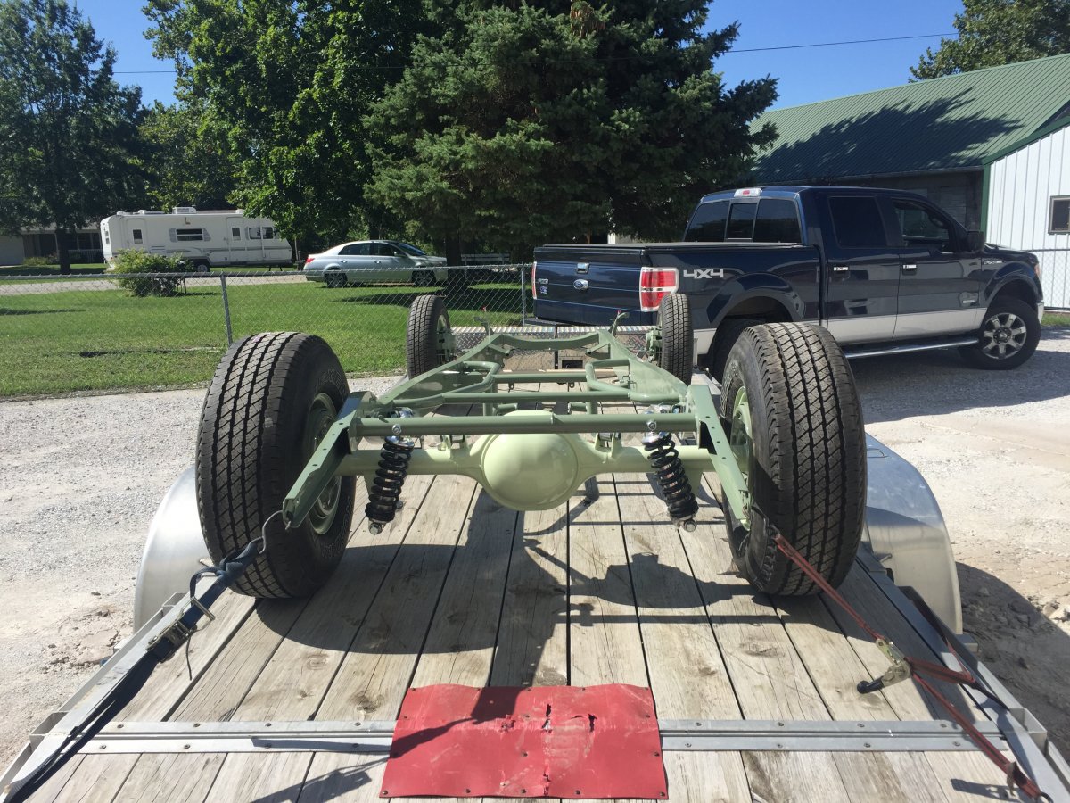

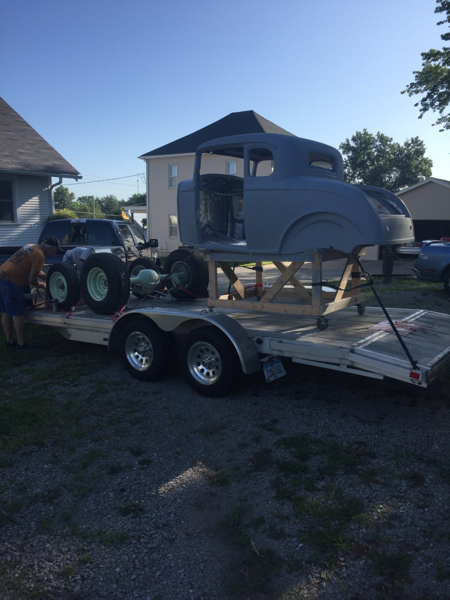

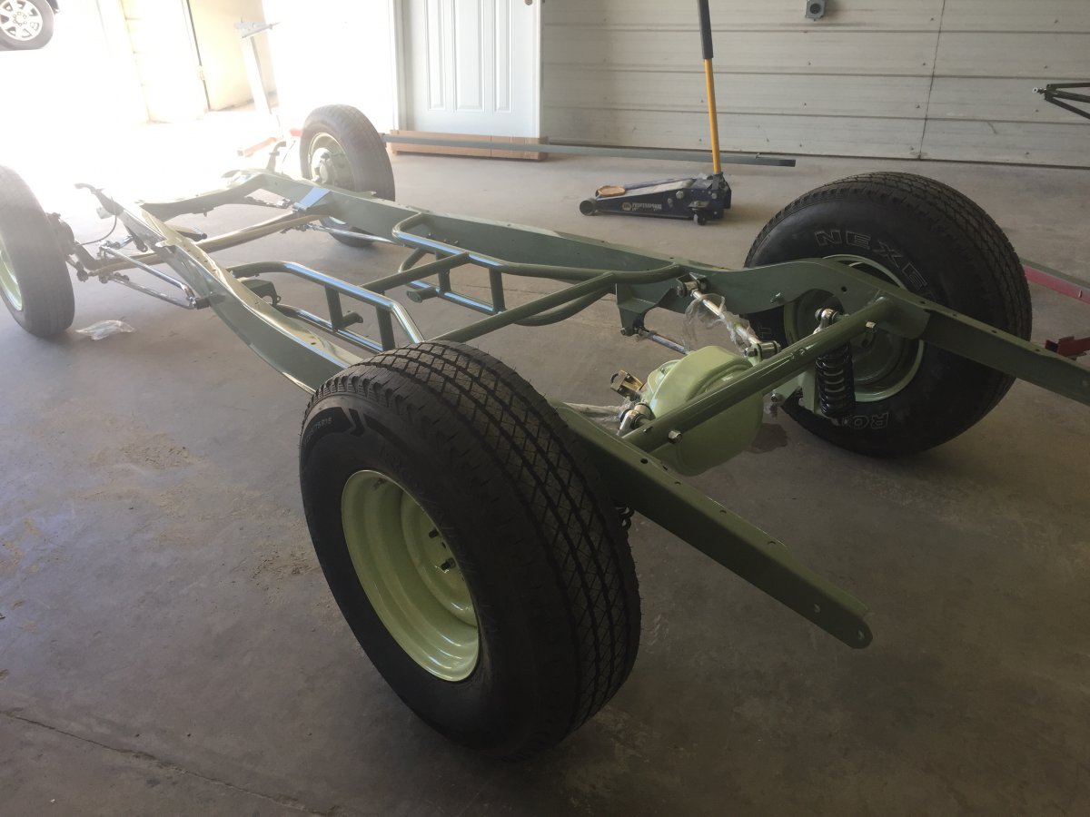

    Hauled the body down and brought the frame home this morning. Took the axles down, rolled them under the frame and stuck a few bolts it. Back in my shop now. Time to start chasing bolt holes and ***embling everything for good!
    Last pic is the run they had in the paint. We’ll work that down a bit and the body covers most of it.

    Sorry, but you need to get past the drip. Keep focused on the big picture. You rounding the bend to completion.
    Everything looks great!

    Drip doesn't really bother me. You won't be able to see it with the body on. I was picking on the painter yesterday about it. Get a couple other things taken care of today and hit it hard tomorrow. Wife will be gone all weekend so my plan is to live in the garage for a few days!
