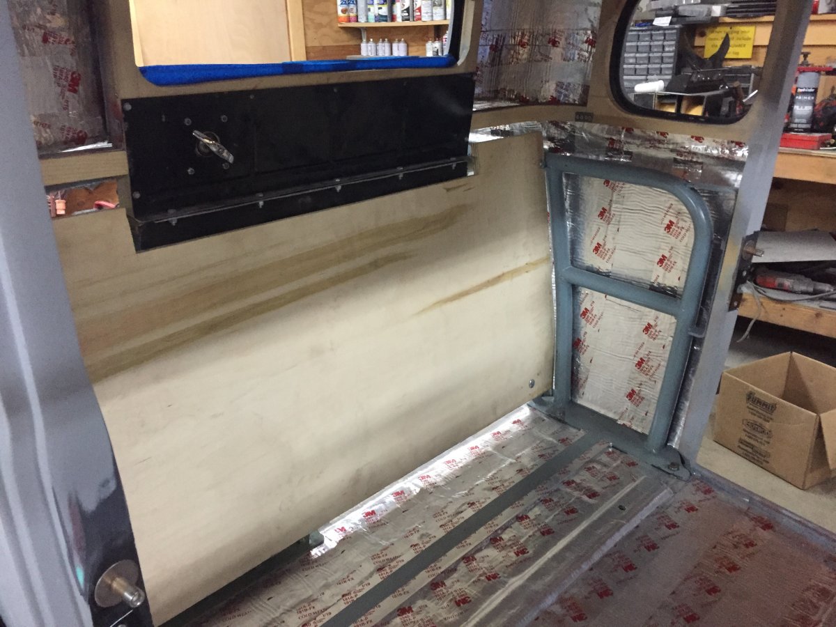

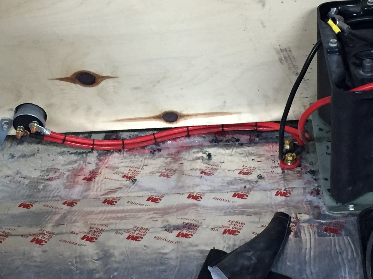

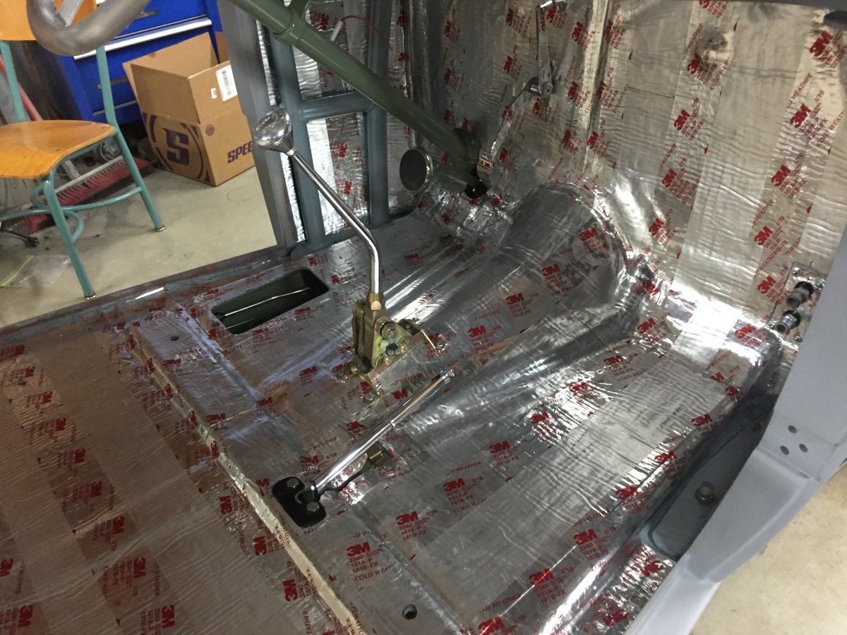

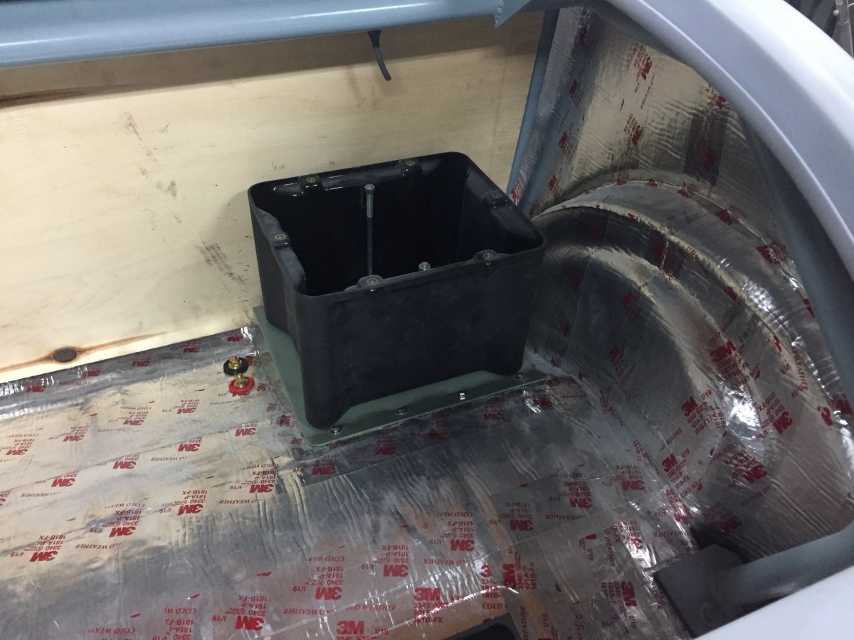

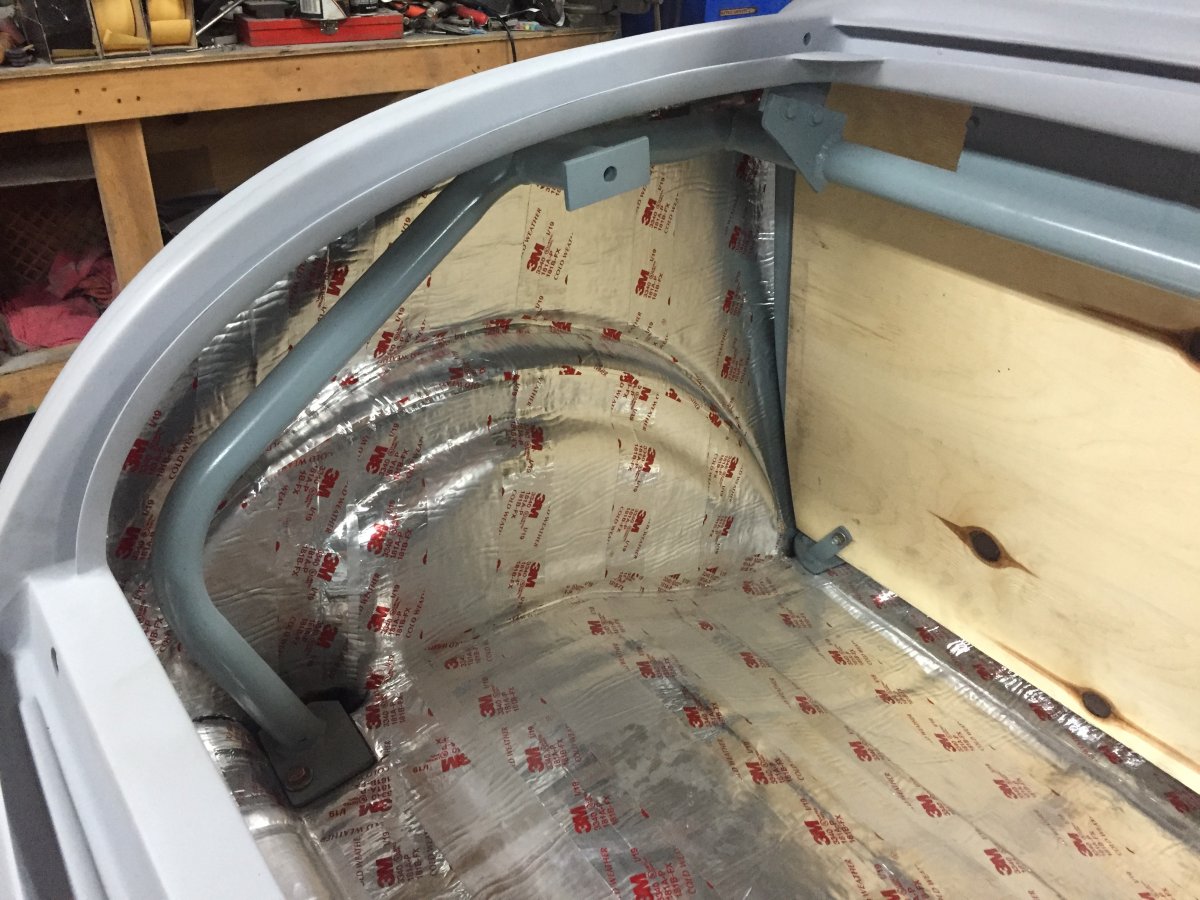

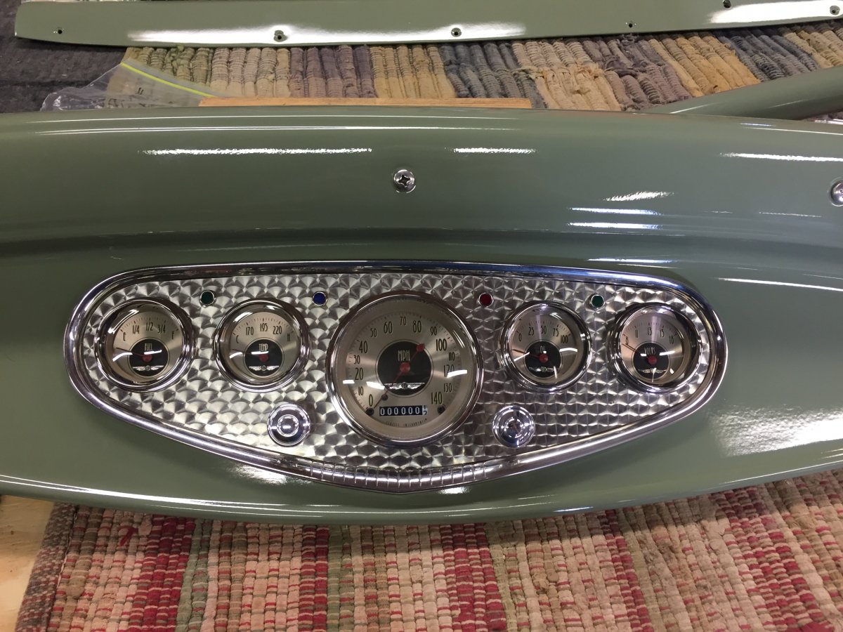

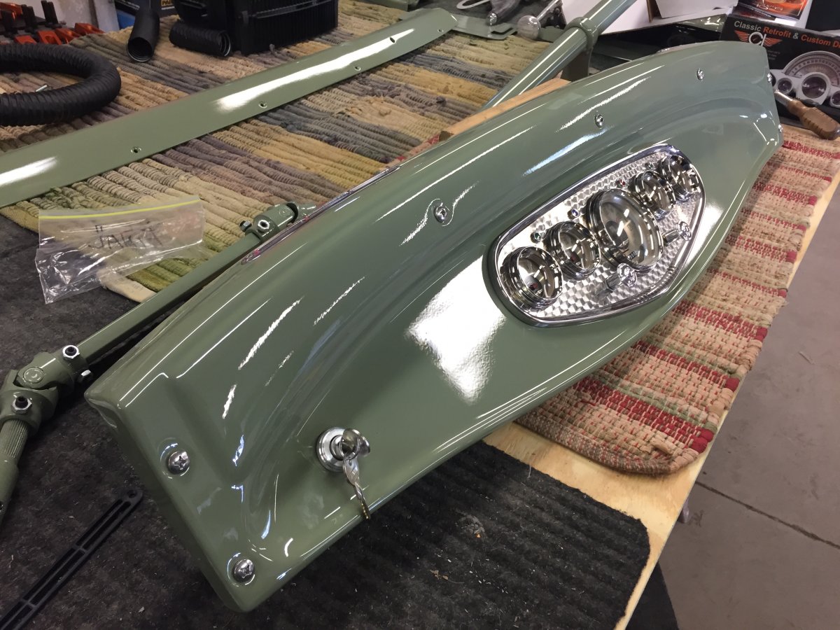

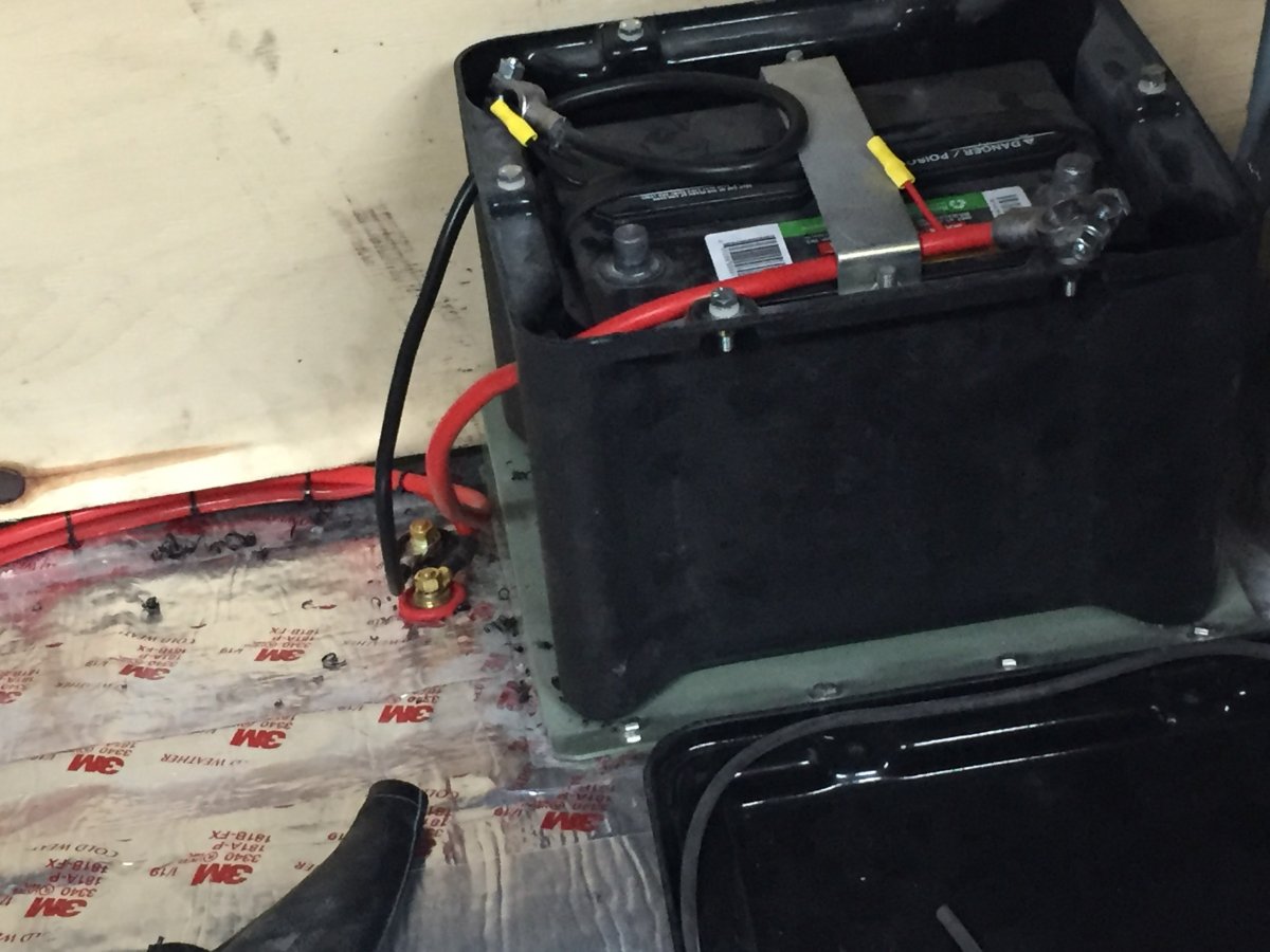

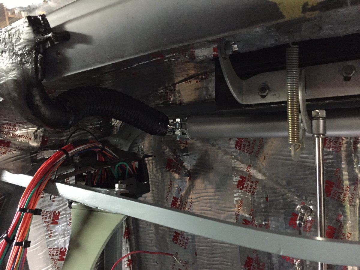

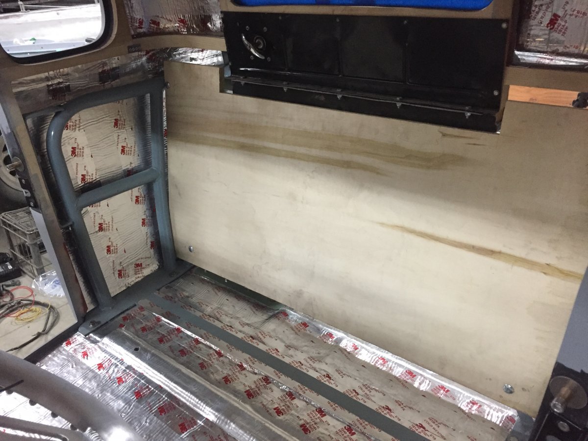

    Battery box in, interior/trunk divider in. Also got the shifter and emergency brake in. Making some progress. Tackle the shifter cable tomorrow. Have to get under there and grind off a boss on the side of the tranny for bolt clearance.

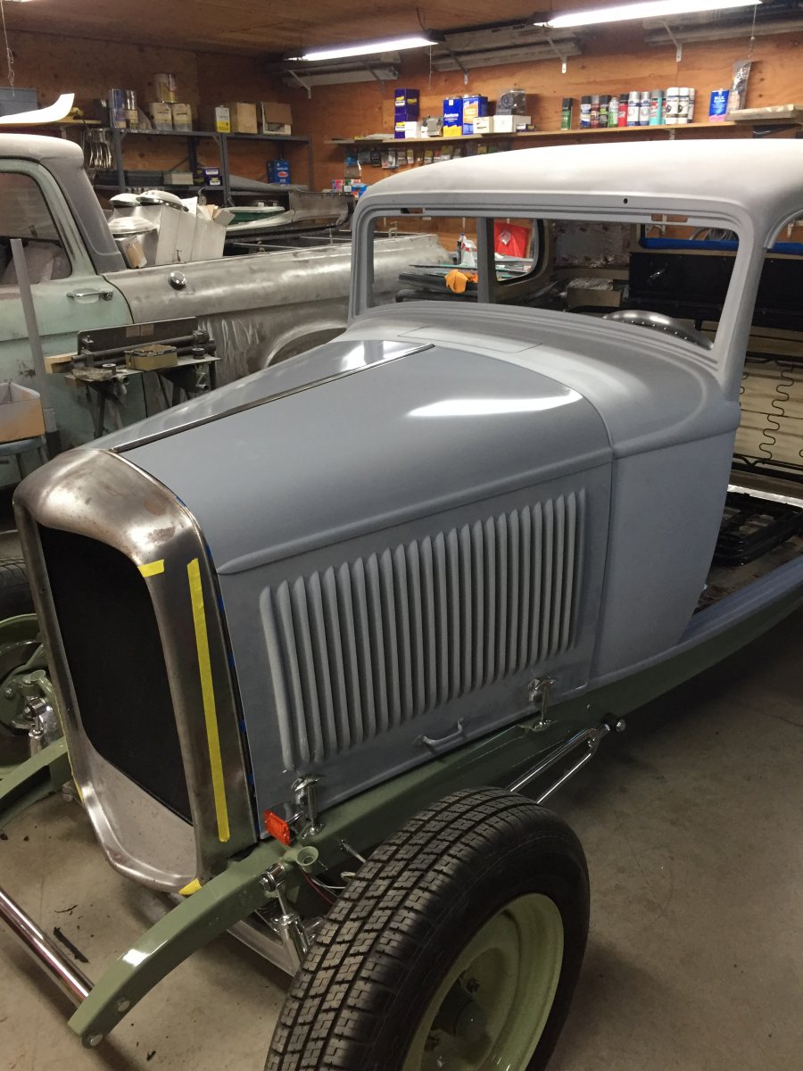

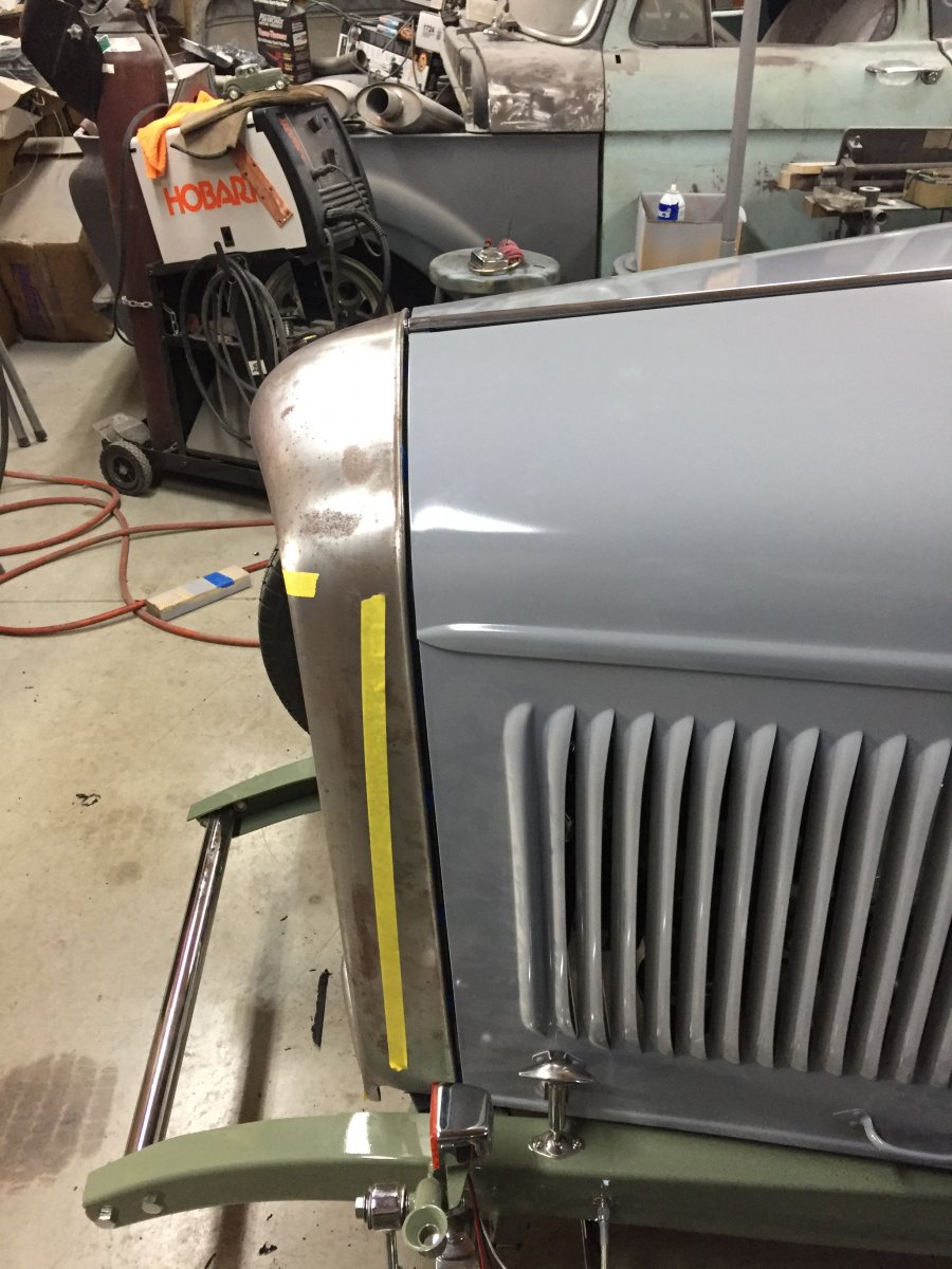

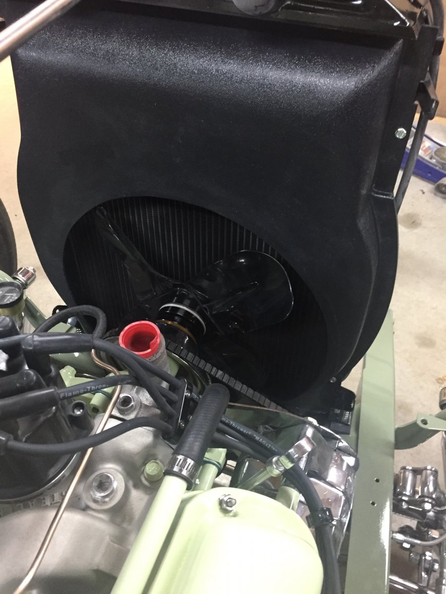

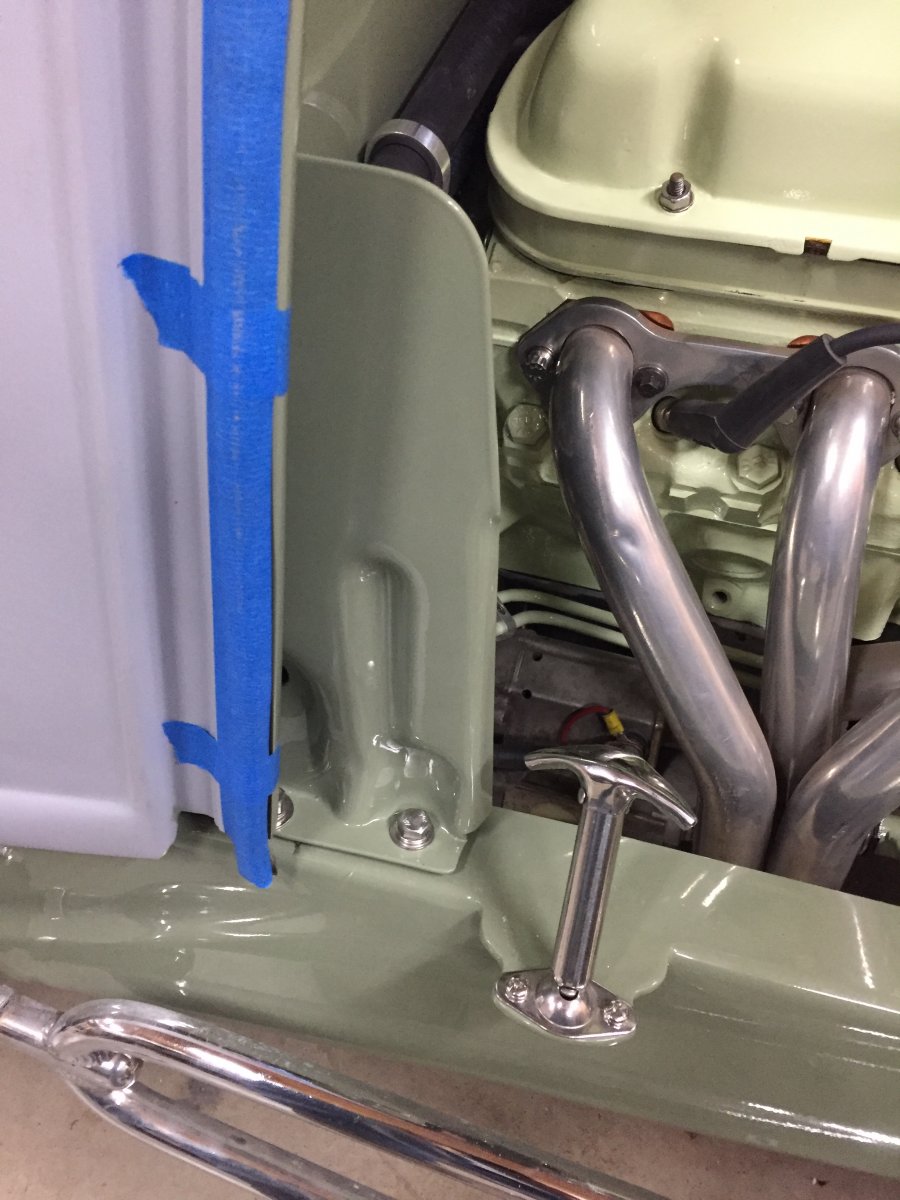

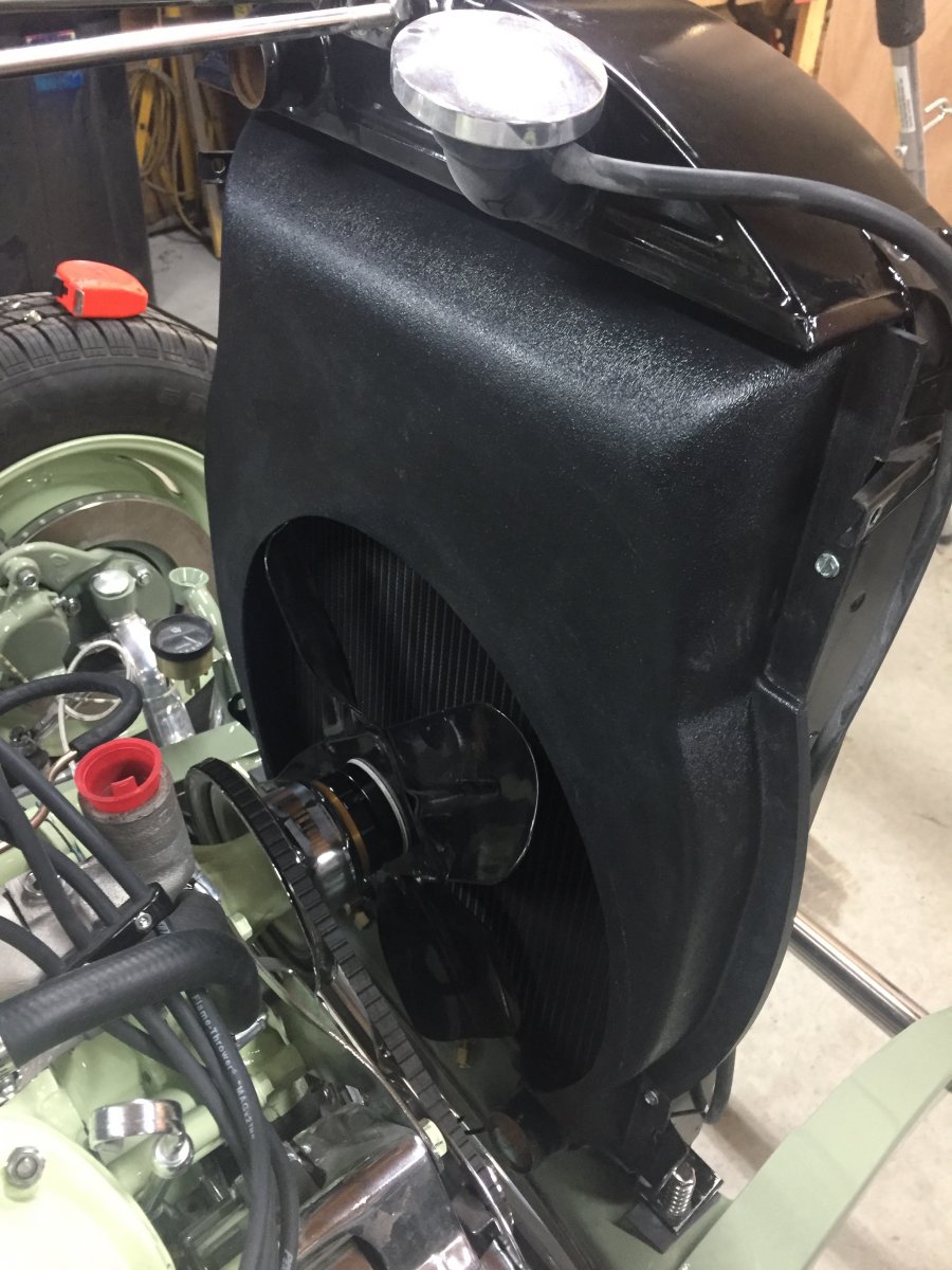

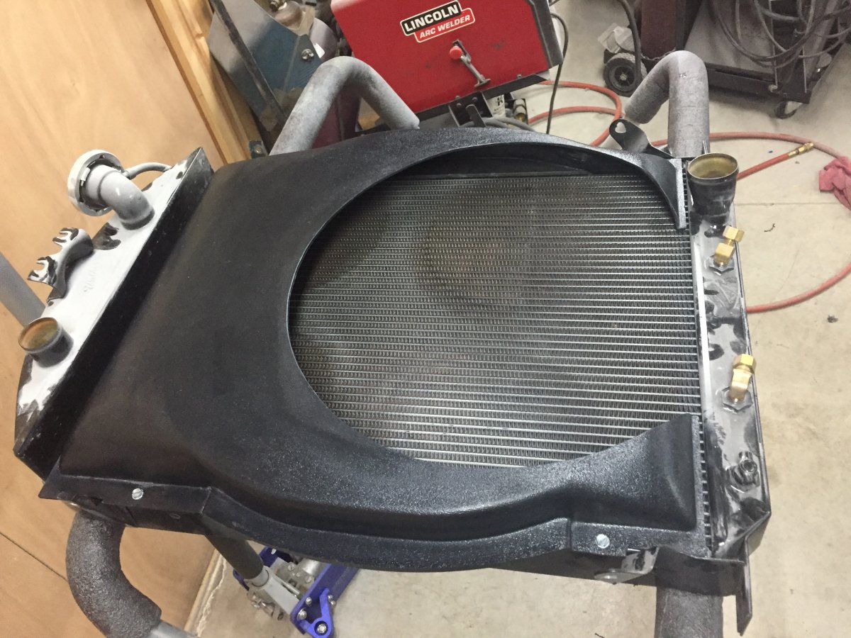

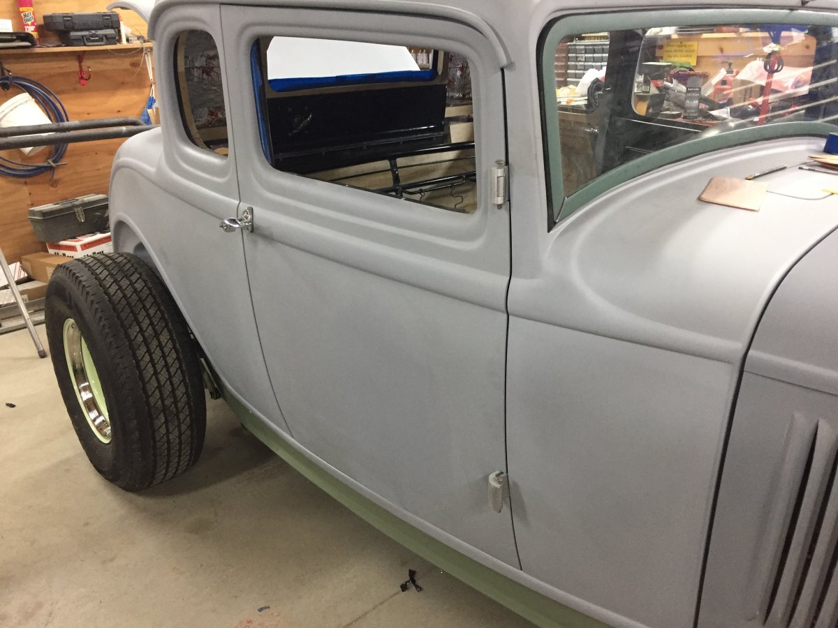

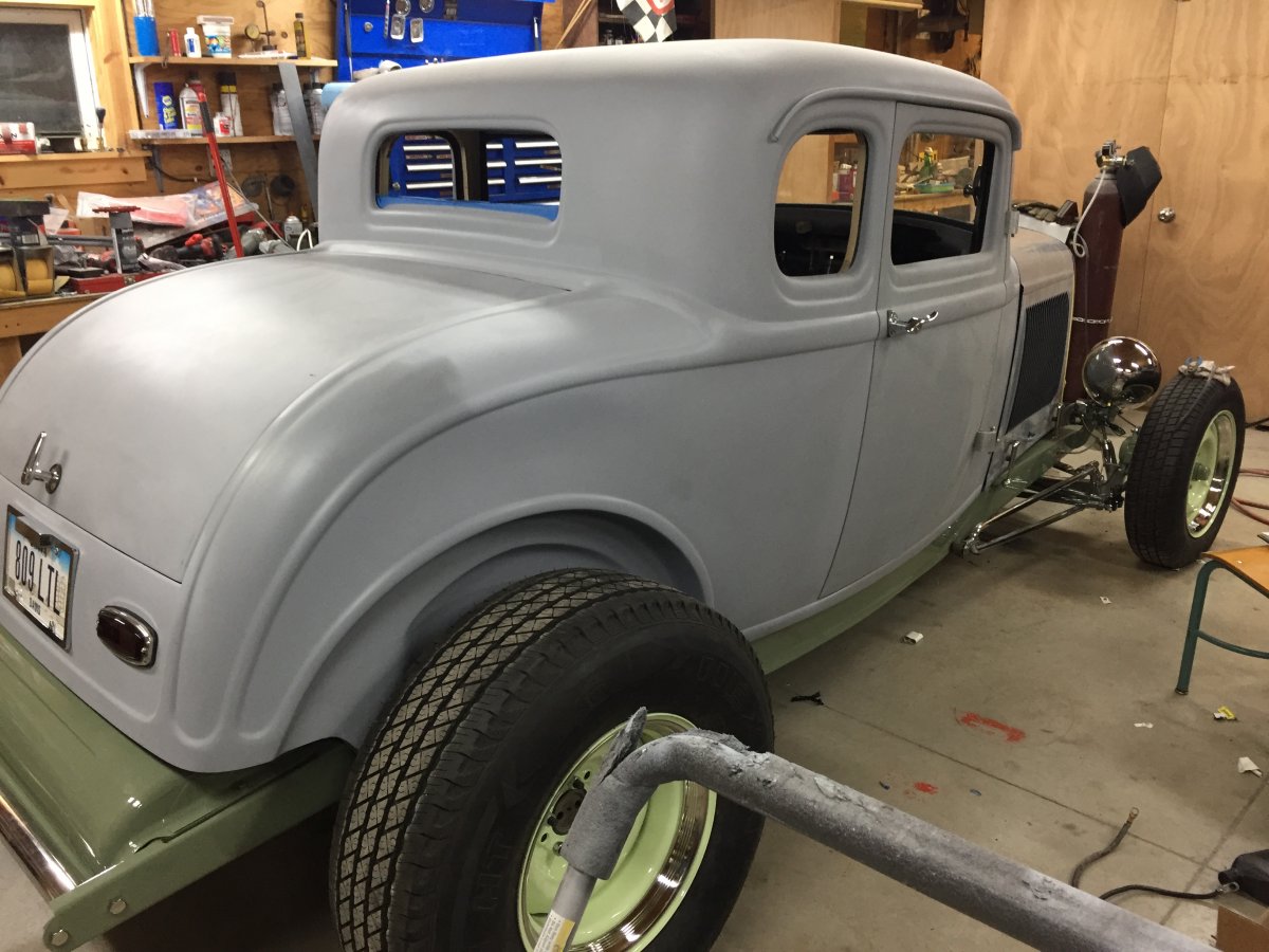

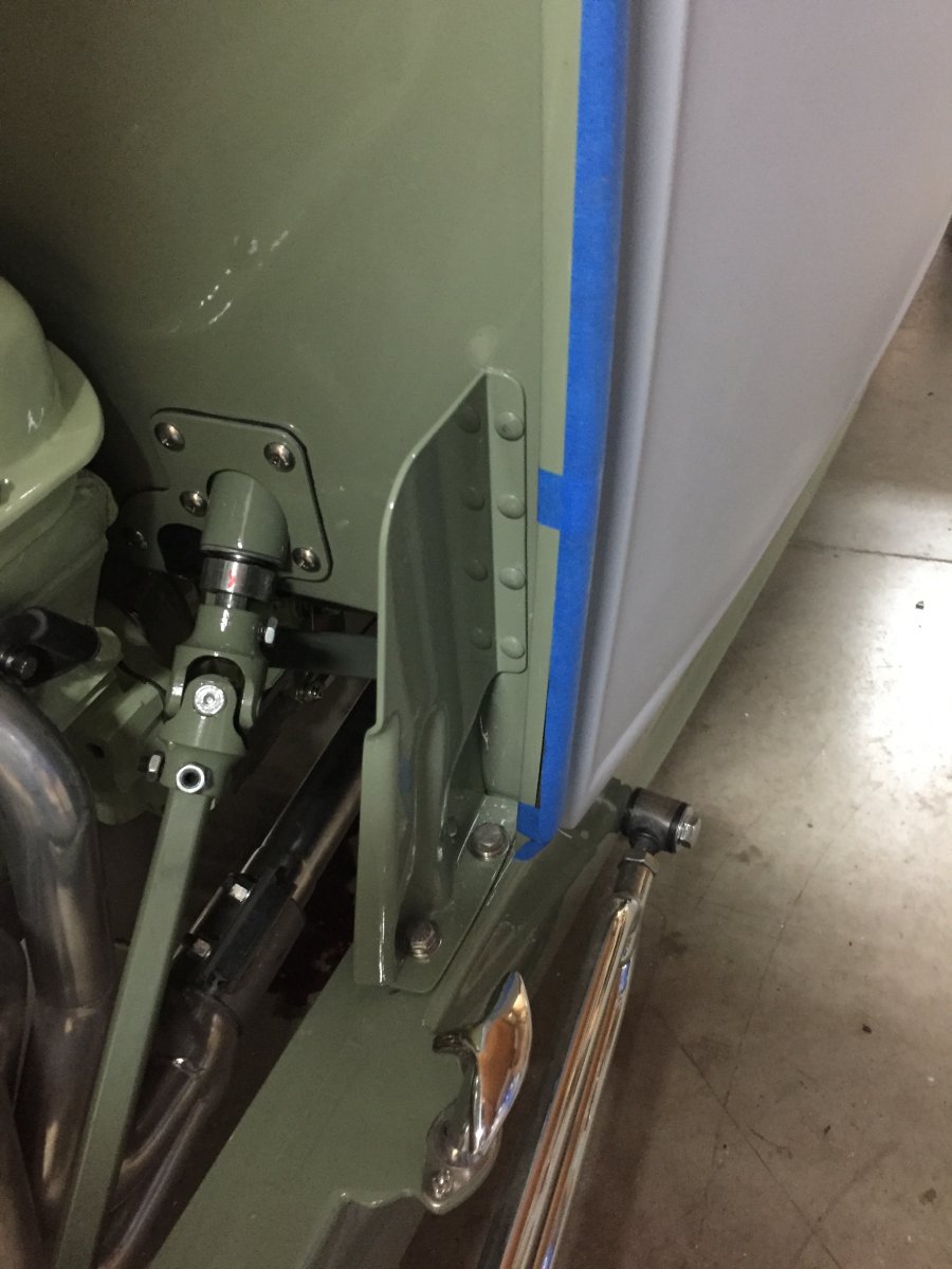

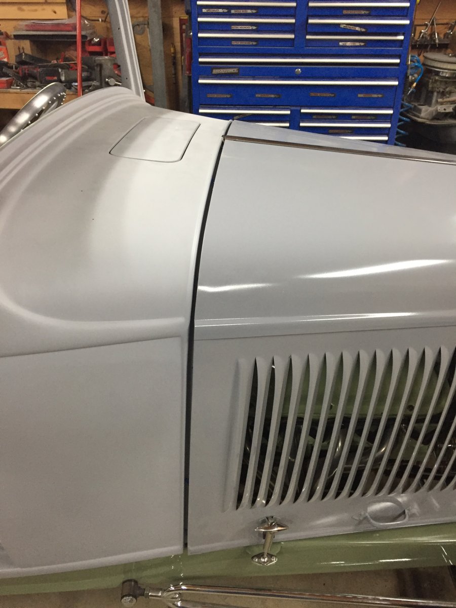

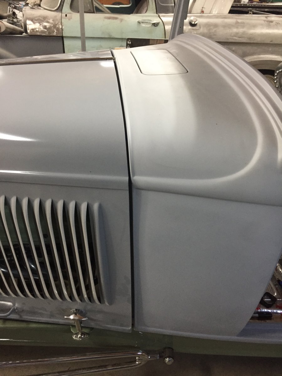

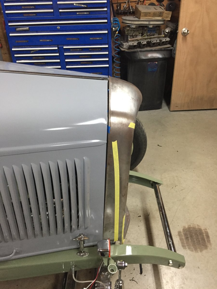

    Got the hood back on today. Really happy with all the gaps except the bottom right front corner. Little grinding on the hood edge and a little welding and it should work as nice as the rest of it. Think I have the radiator shimmed to where it needs to be so time to make some permanent shims instead of the stack of spacers under it now.

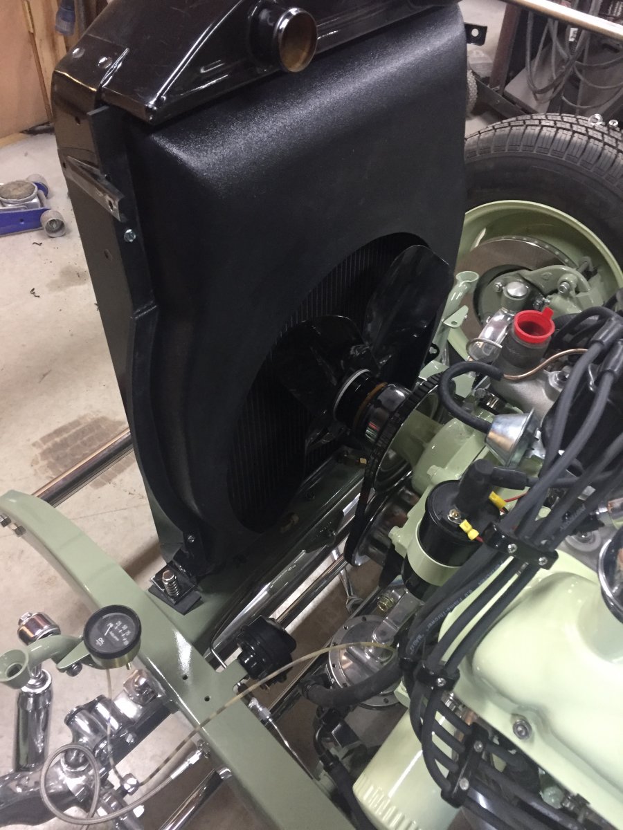

    That lets me fit the fan shroud. Still playing with spacers to get the fan exactly where I want it. It’s always a bit of a compromise.
    Also started laying out wiring locations and routes this morning.

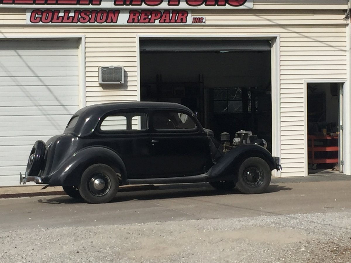

    Last pic was another project the painter had going while doing my work. ‘36 sedan they have been doing some repairs to. It’s a parade car for one of the locals.

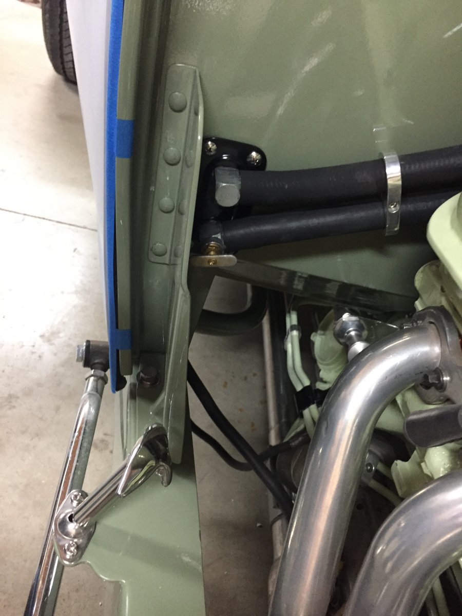

    Did get the firewall feet in place and finished up. At least I got something done today.

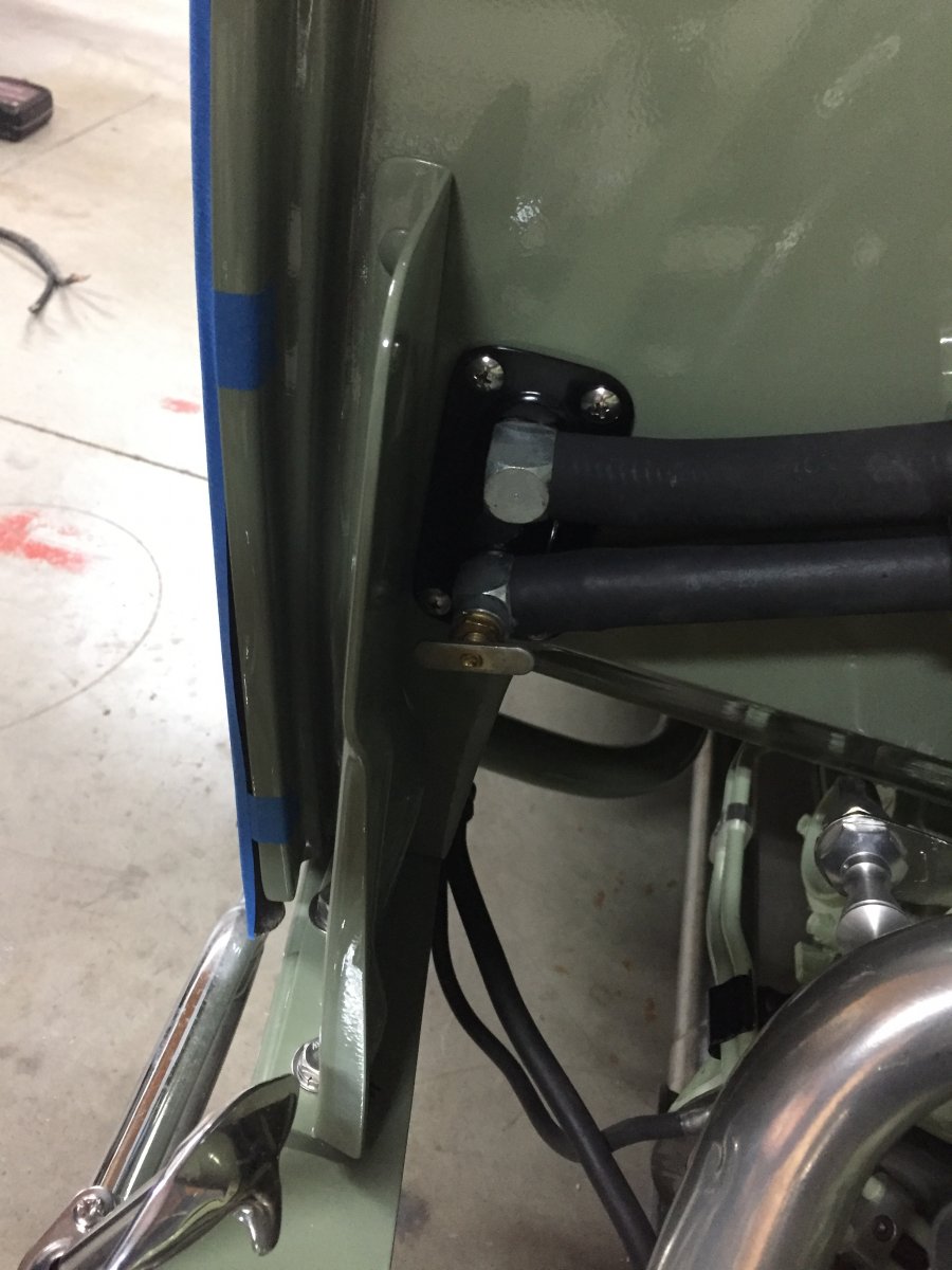

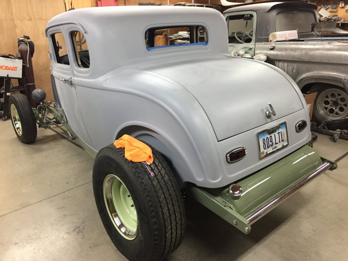

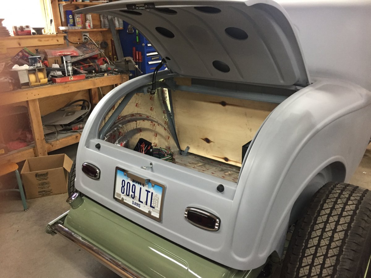

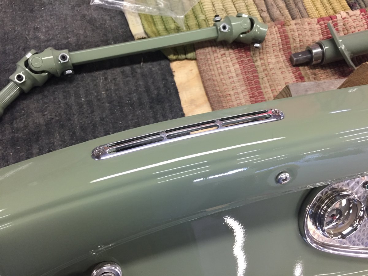

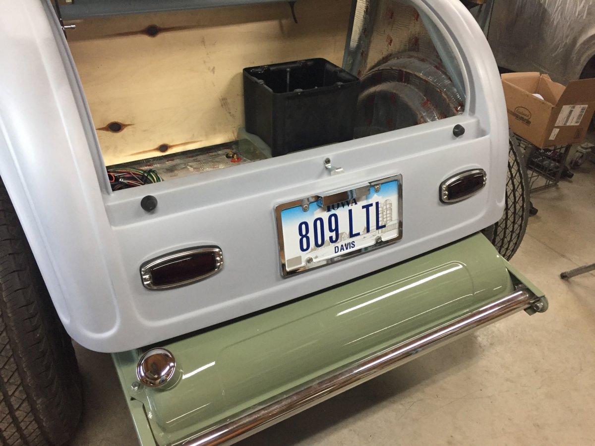

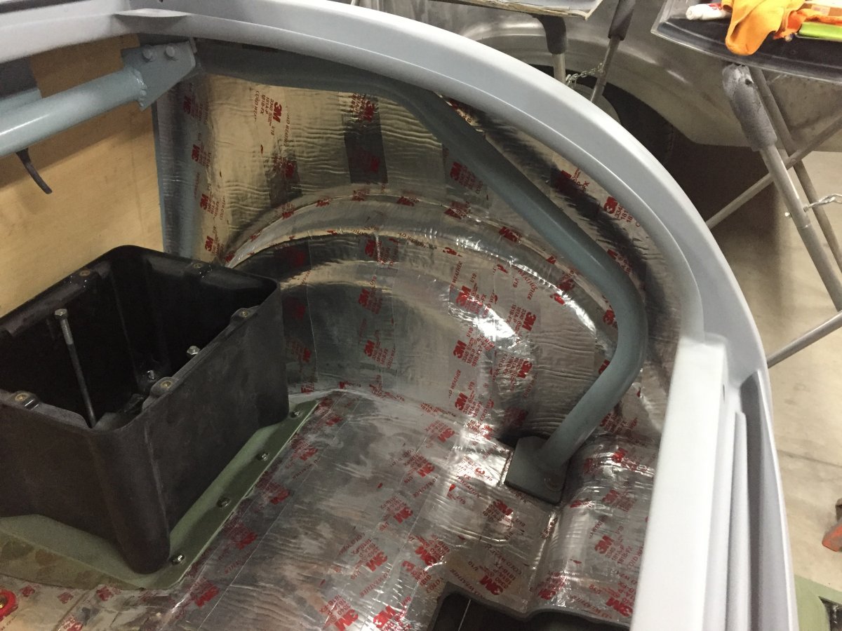

    The tail is all back together and adjusted. Trunk hinges together, catch, latch, taillights and license plate frame. Ready to wire this end of the car.
    Starting on assembly of the heater/defroster system tomorrow.
    Feels like I’m moving in slow motion. Wouldn’t think 4 days of zero activity would be so hard on a guy.

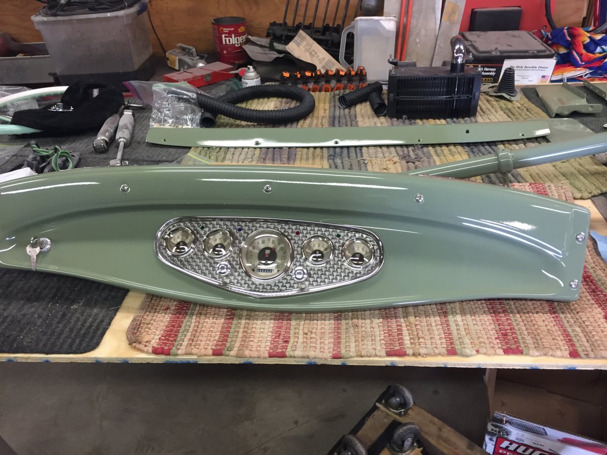

    5C07F6D5-30F9-475F-B0DA-F1363776FACF.jpeg FBBE3619-B504-4877-AEBF-BBF6DA824D51.jpeg A520EA9B-DCDB-4C2A-B577-141A82C8917F.jpeg 89EDE15C-0DD9-49A0-BAAA-85B60D934E52.jpeg DC0D78E3-F4F4-4AF2-A85B-DF7FB0A8B102.jpeg

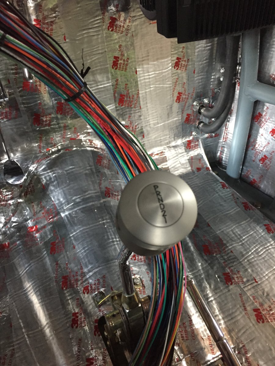

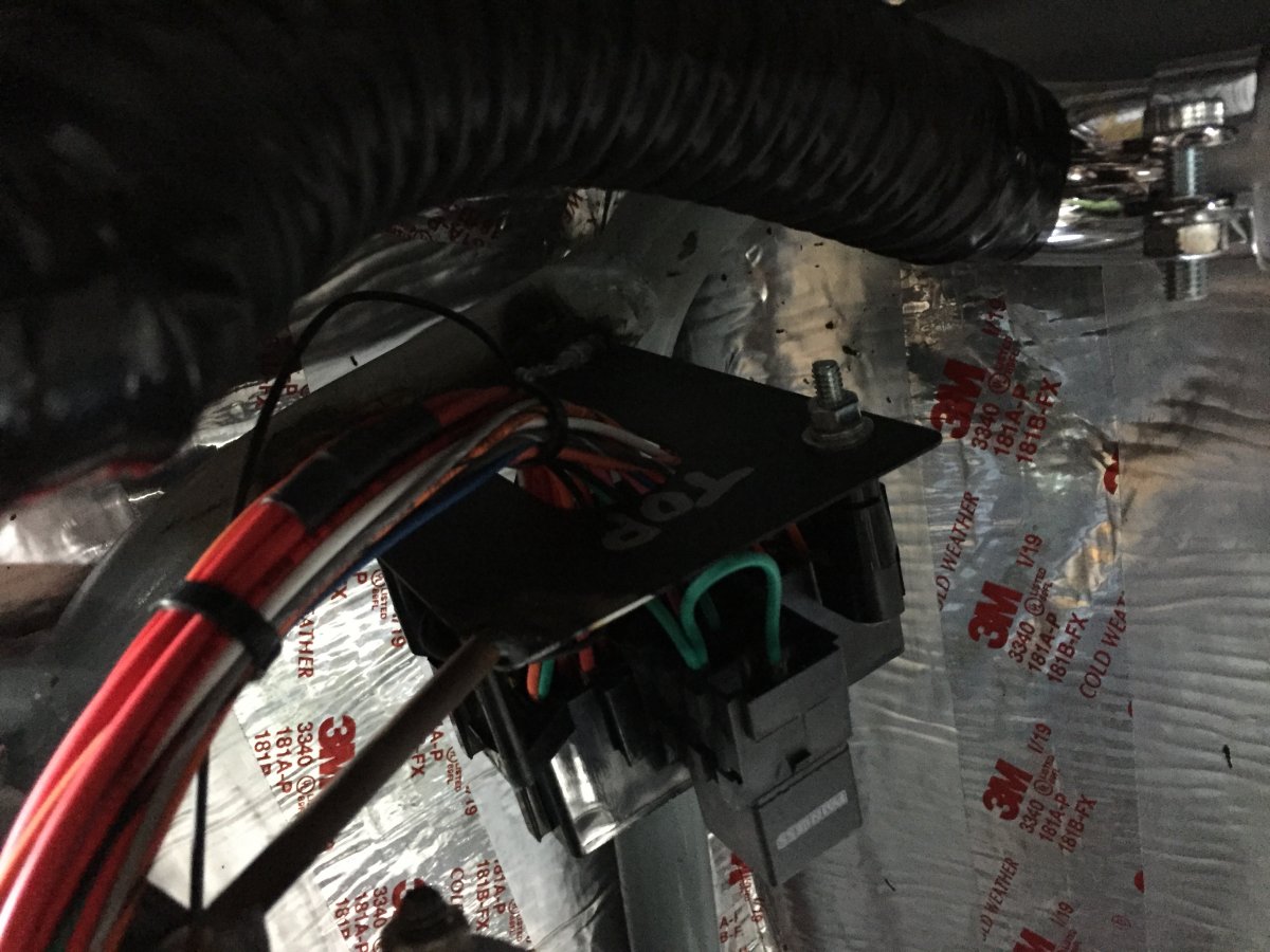

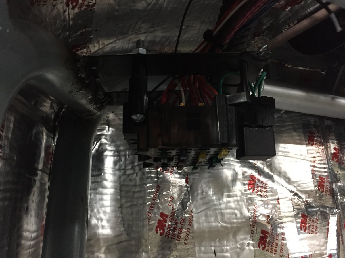

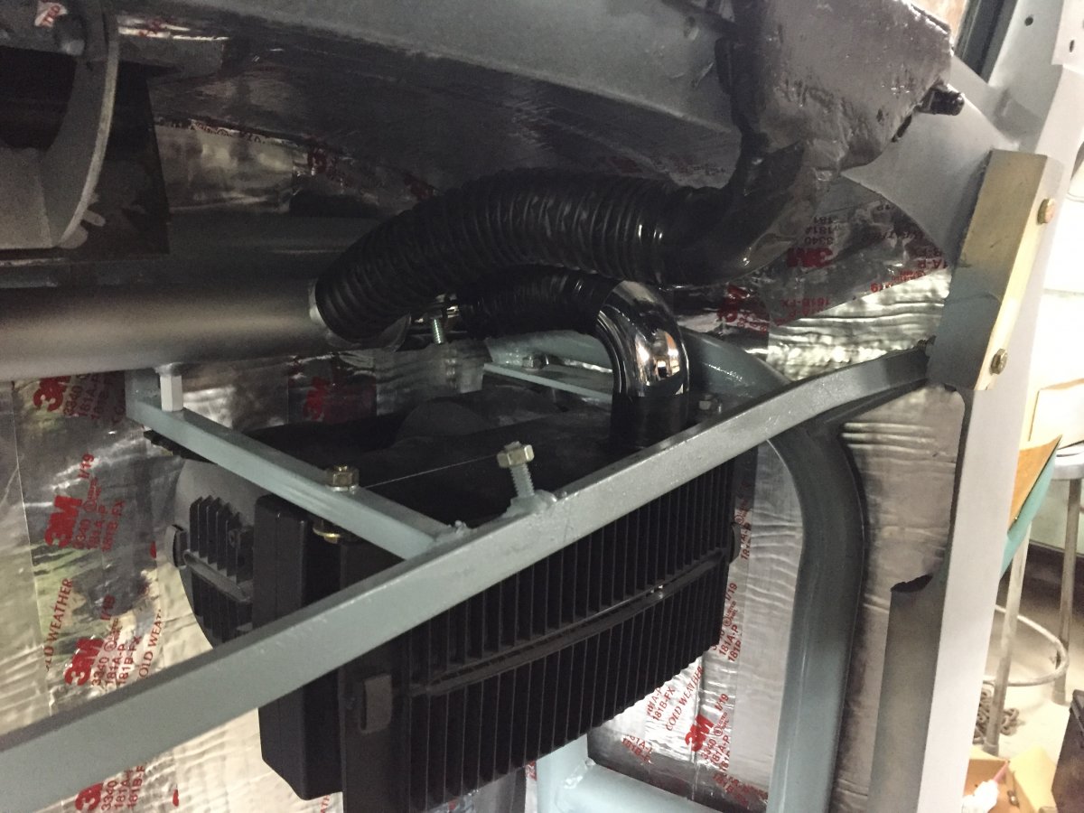

    Got the entire heater/defroster system installed for the final time. It’s going to work. All the heater hoses are connected and clamped except 2. Bought the parts store out of that size until Monday freight comes in. Joys of small town living. Everything fits great so far.
    Welded in a mounting plate for the fuse box. Started stringing wires to the appropriate places.

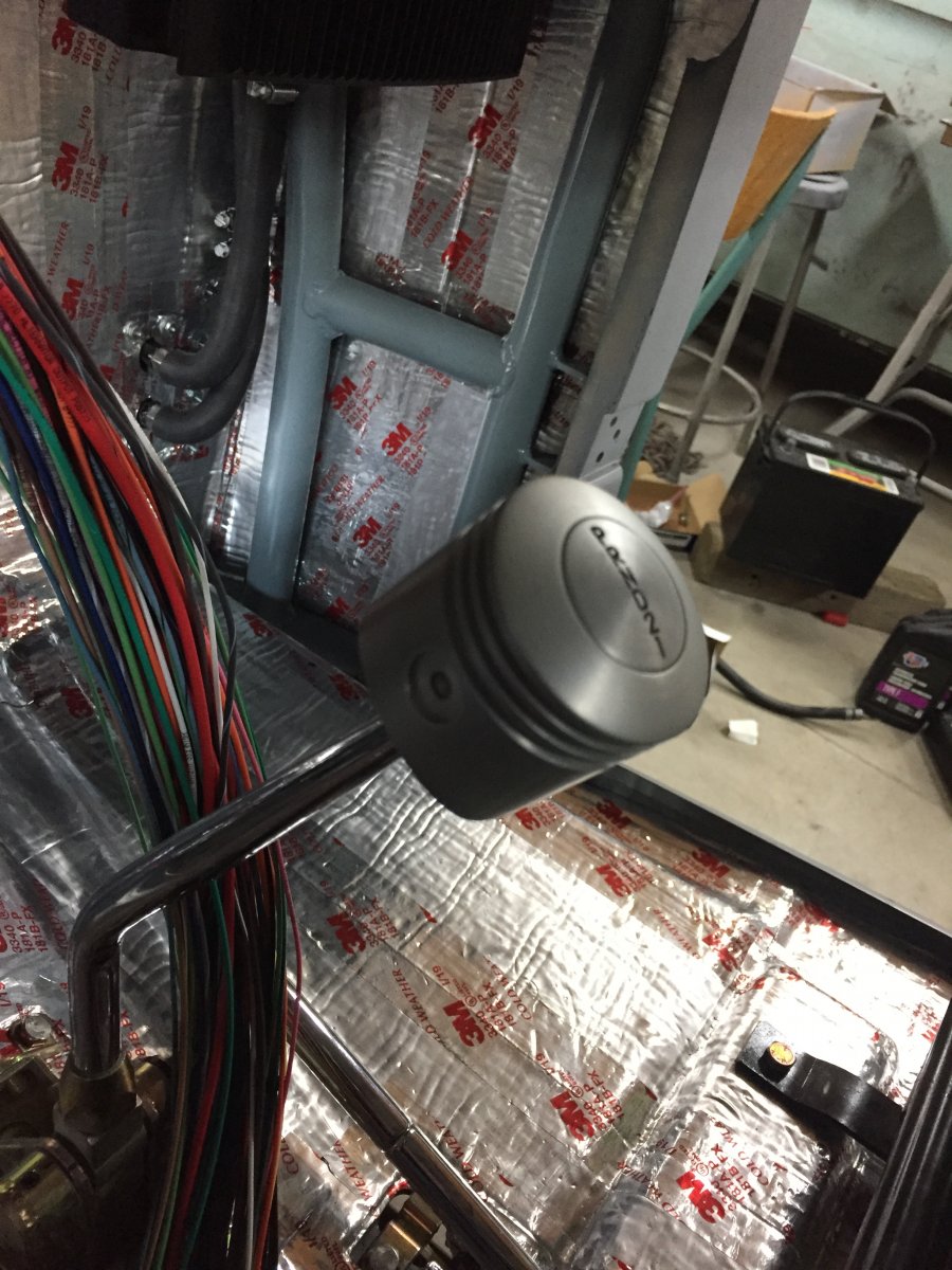

    Got the nod to John Milner put on the shifter today, too.
    The fun of working on old cars, getting infusions every 2 weeks and being on 3 blood thinners at once. Any little bump or using my arms as levers makes for great bruises. Arms looking a little rough. Been telling everyone the wife is a pincher.

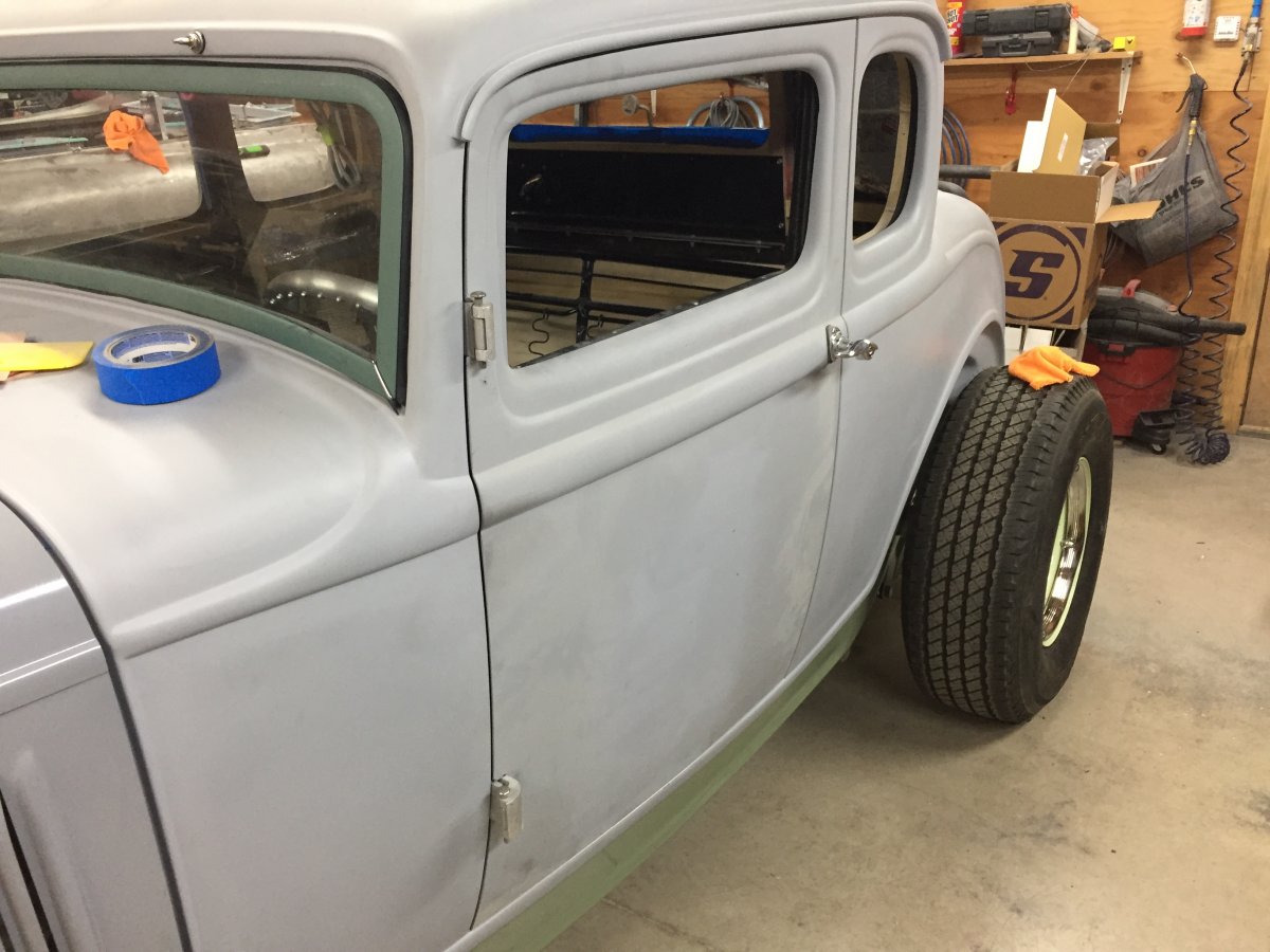

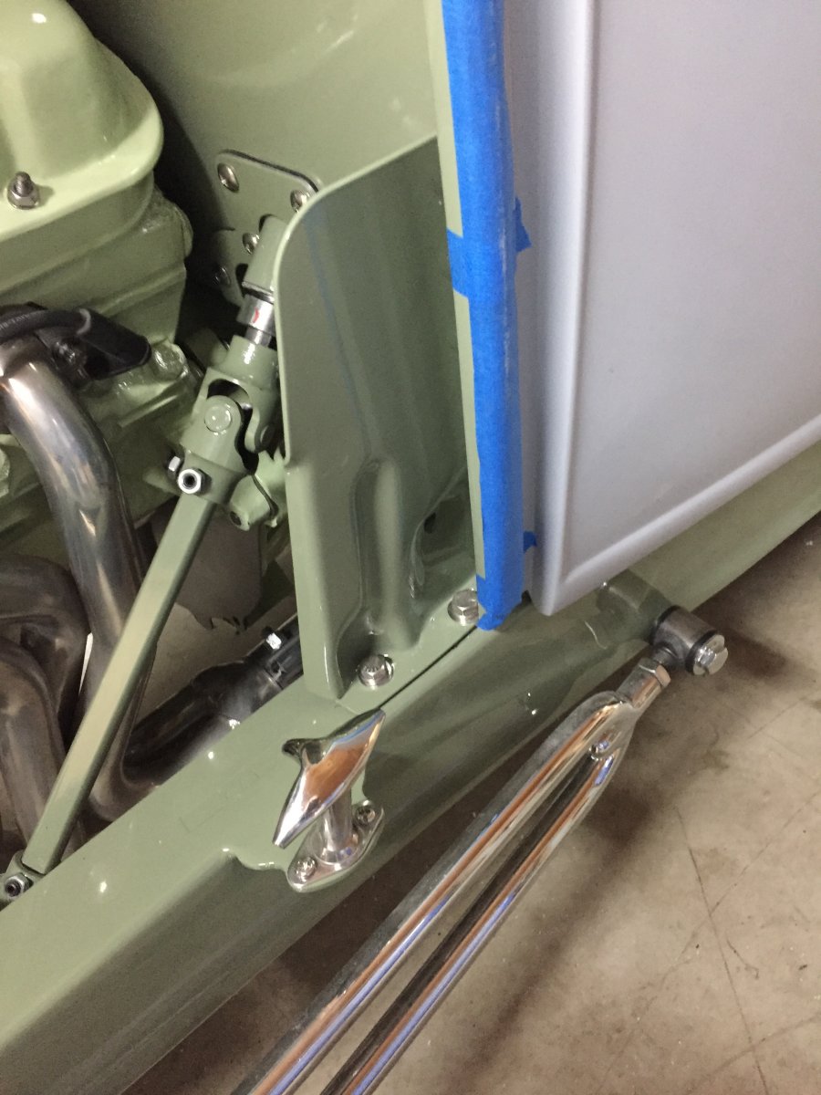

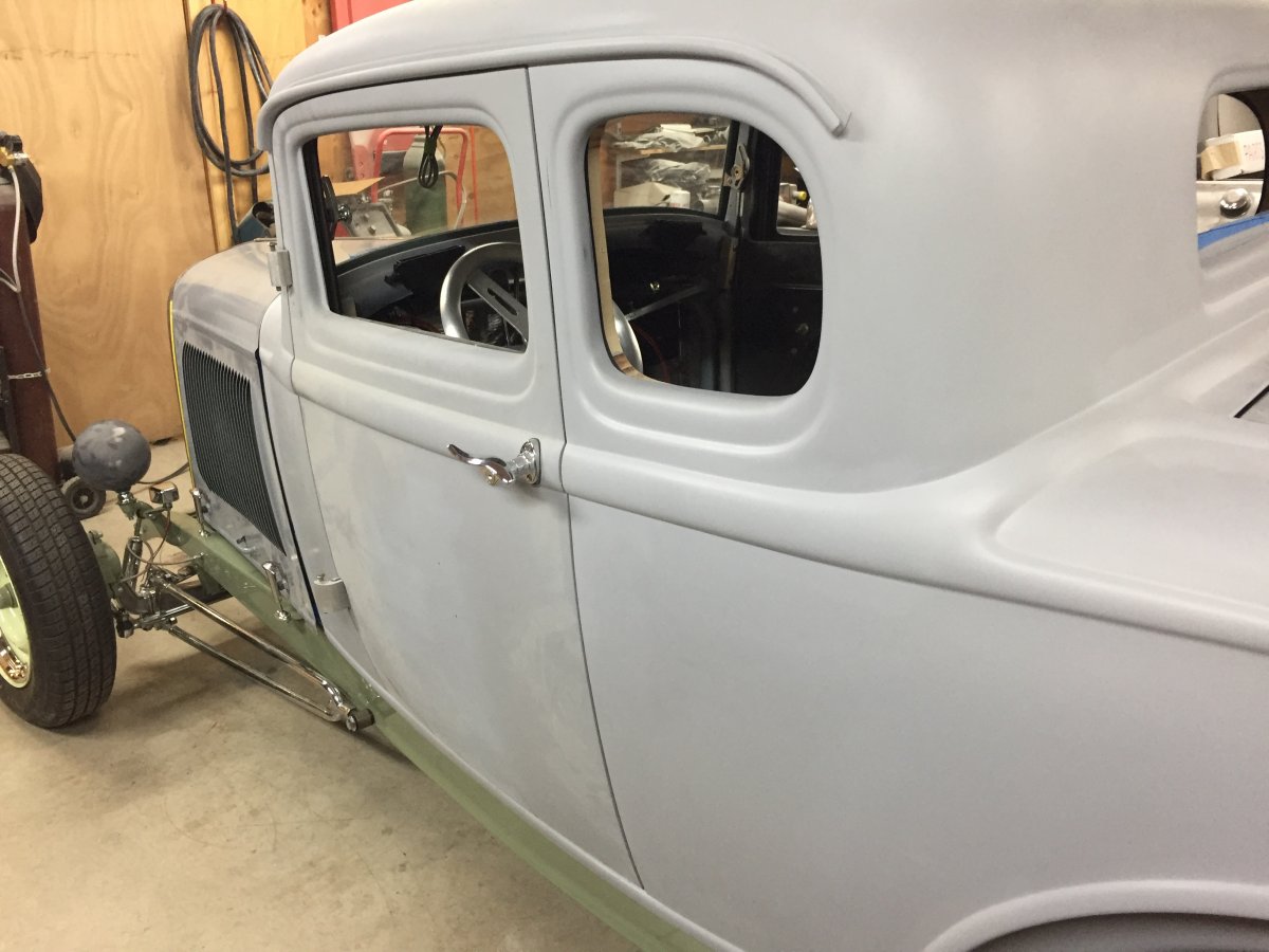

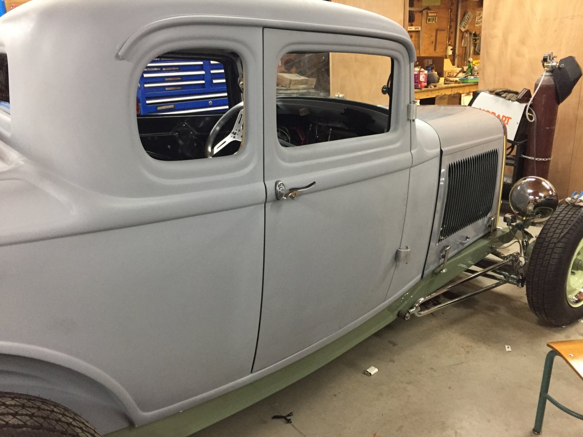

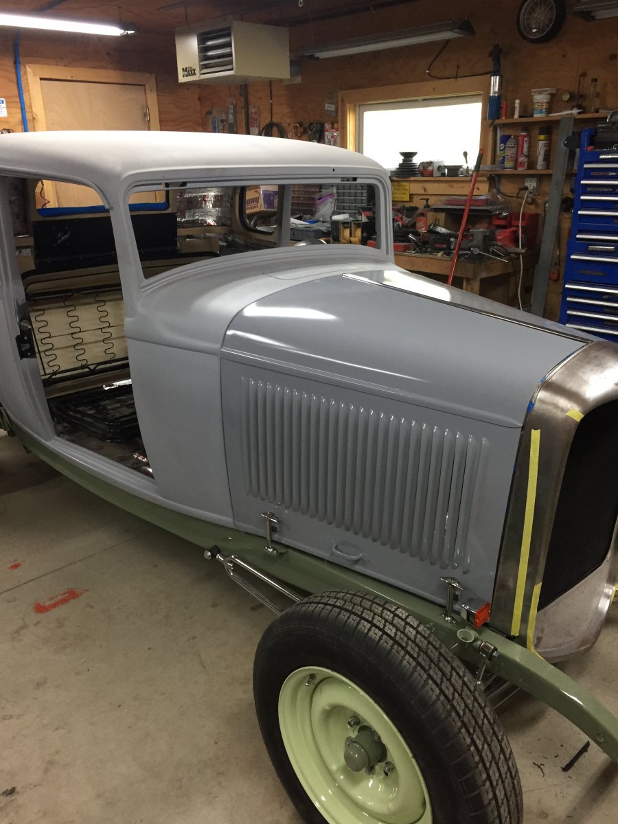

    Doors are back on and fit great. These bodies are really stiff and maintained it’s shape all the time it was off the frame. Everything went right together and it all lined up just like it had never been apart.
    Milled 0.125 off the top of each inner door hinge pivot point so a stainless AN washer fits on top of the pillar side of the hinge and underneath the door side of the hinge. That gives me a stainless pivot point/wear surface instead of aluminum riding on aluminum. Was suggested by a couple different guys with these bodies and it worked great. Thanks!

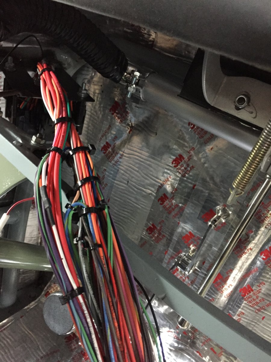

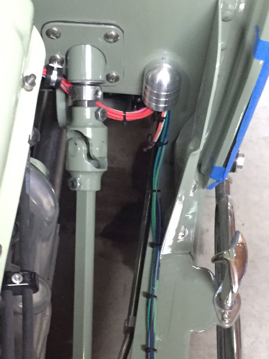

    Got all the wiring separated and ran to appropriate areas of the chassis. I hate wiring.
    More work on garnish moldings and they are about done.
    All the plumbing is finished....almost. Have a leak around the tranny dipstick tube. Have to drain it down a bit, pull that back out and see what's going on there. Thought it went in too easy. Maybe a slightly thicker O-ring will fix the issue. Hate using silicone on tranny parts.
    Hauling it to the upholstery shop Tuesday so they can do some preliminary measurements and get the skins ordered. Taking paint samples so he can mail them to his supplier and get a match on the colors I want to use. Wants to have everything on hand when I take it down in January for upholstery.
    Still trying to decide on the Dietz style headlights or the bigger ‘32 style. Need to decide so I can put the conduit holes in the buckets and grille shell.

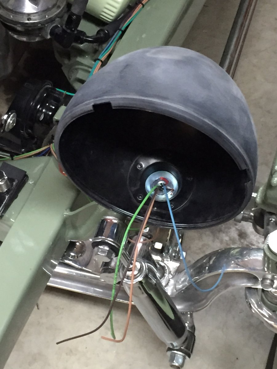

    Think I have the solution to my headlight dilemma. Going to run the Deitz lights with a spacer under them to get close to the required height and put the slightly taller tires from my '62 short bed unibody project on the front for the DOT inspection. Should get me the height I need.
    Spent the day dragging the car from shop to shop. First off was the painter. We discussed a few alternatives to some repairs and details on the Rootlieb hood. The bottom flange is pretty rough at each end and needs a bit of work to line up with the lower character line. He confirmed my plan so will start that soon. He checked the fit of the doors and decided high build would take care of any remaining low spots so not much left in the way of body work. Couple areas but nothing drastic.
    From him I ran by a glass shop. My driver's side door window is cracked. Came out of a track and hit the door latch inside the door. The track had come loose and moved. Been looking for somebody that was comfortable working on it and this guy will custom cut the replacement safety glass, install it and adjust everything. He seemed excited to do the project while everyone else was pretty wishy washy when talking to me about it. He's been doing auto glass for 38 years so he's been there, done that. Finally someone to do the glass work that knows what is going on.
    My last stop for the day was the upholstery shop. Picked out the white and green leather for the interior and a nice deeper olive green for the carpet. Discussed a lot of options and they had a whole page of notes by the time I left. Scheduled to take it down in January but if I get paint done before that they will take it. I'm their next major project they are taking in. The 2 in front of me are farther from being ready to upholster than I am.
    Tomorrow I start the actual wiring. Hoping to get it done in the next week. Taking my time, making things look nice and easy to work on. Have a couple pieces that will need to be removed for upholstery and reconnected after the upholstery is in. May have to put a conduit in for the third brake light. Wife had to have one so I haven't spent much time thinking about it yet.

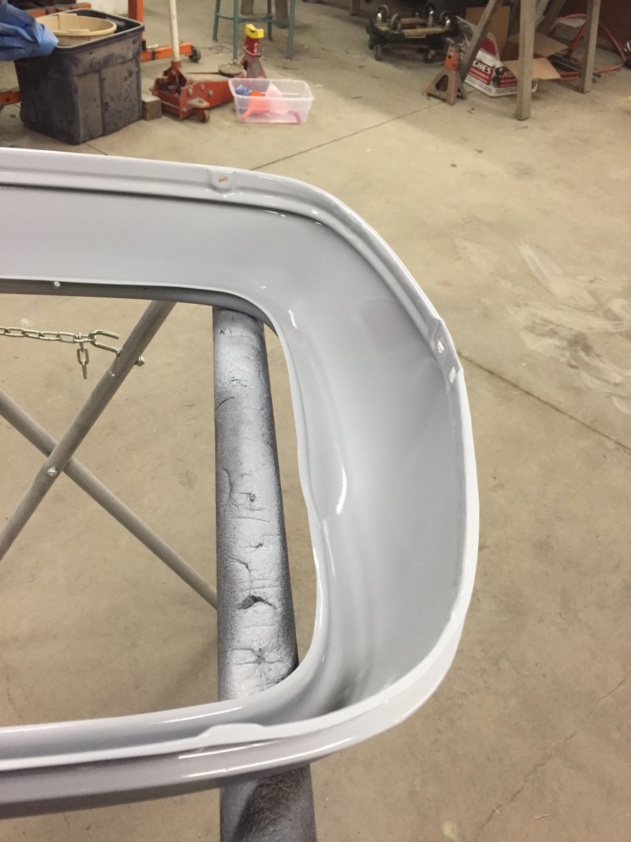

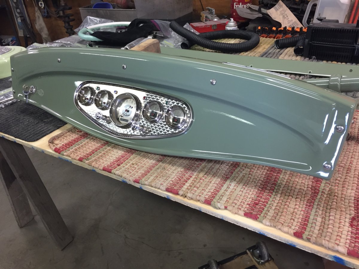

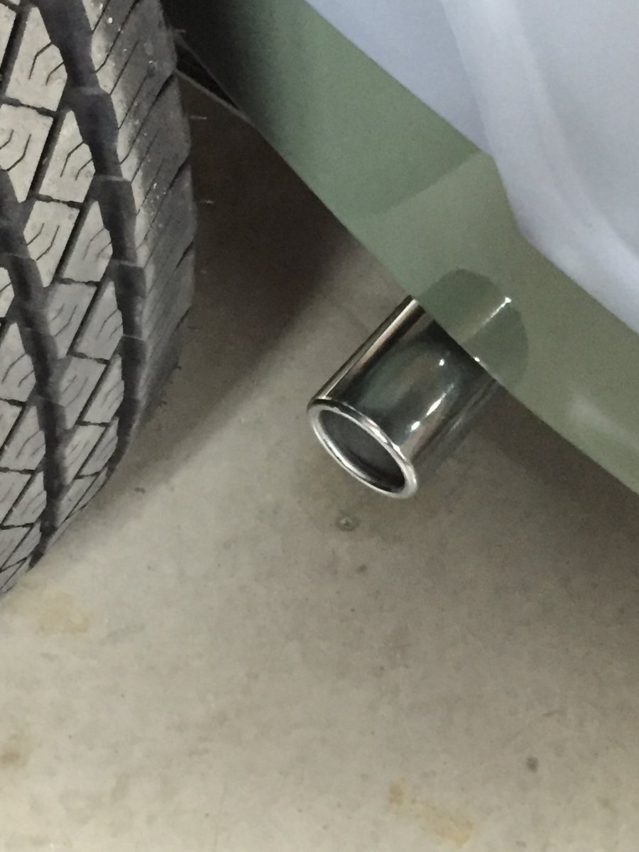

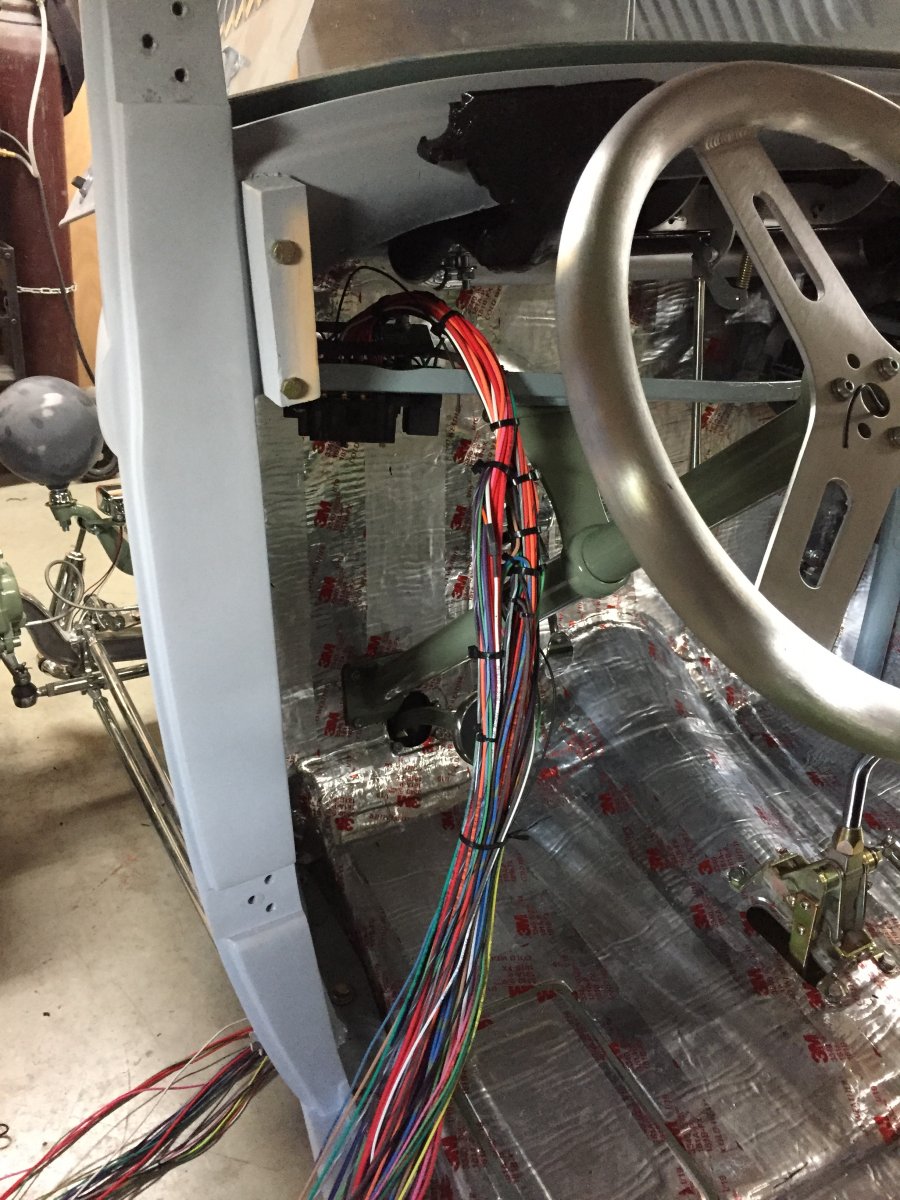

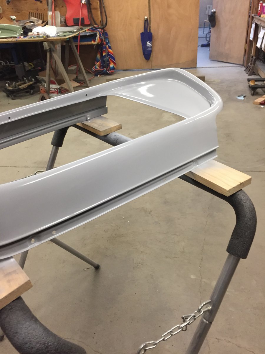

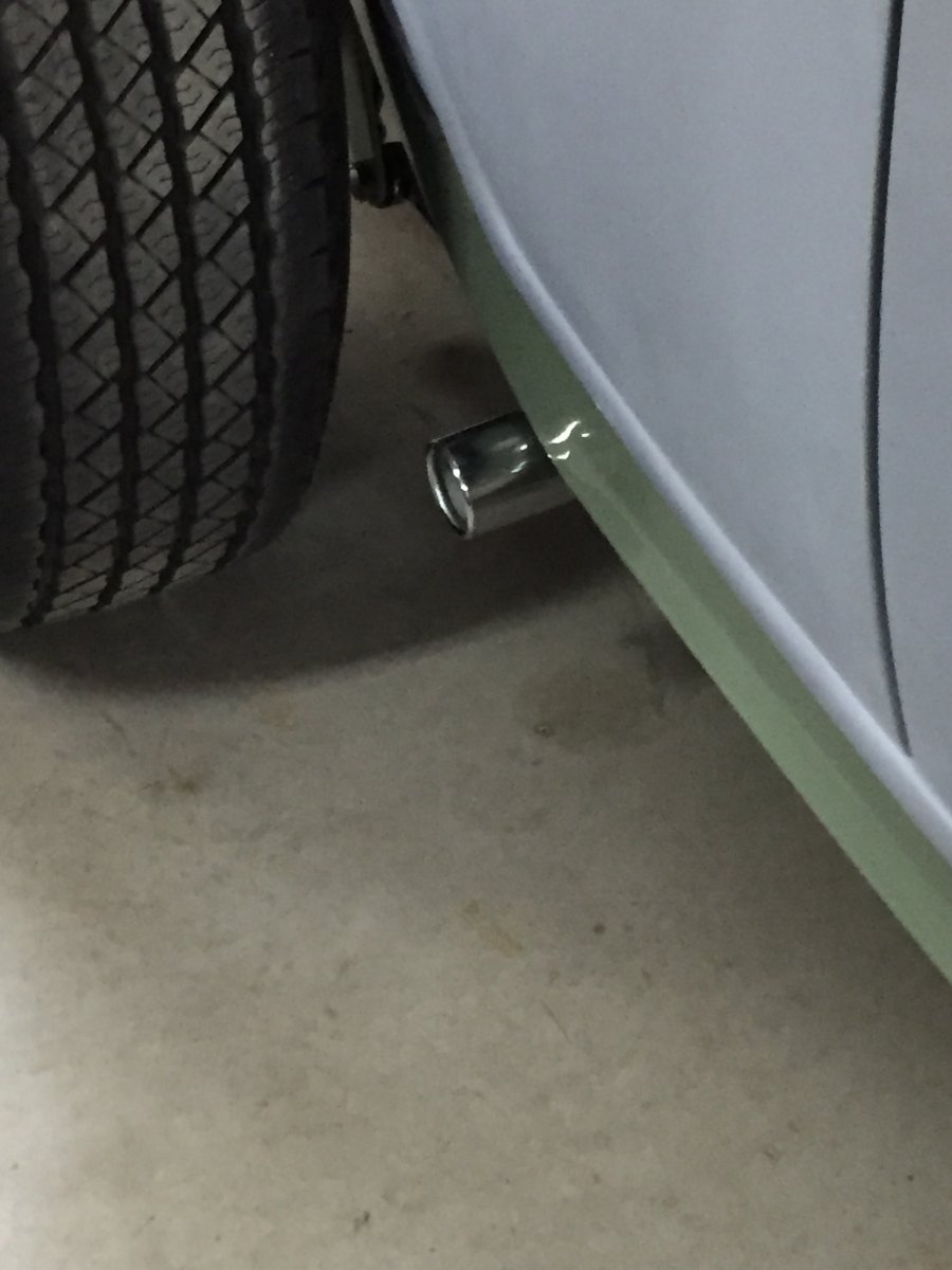

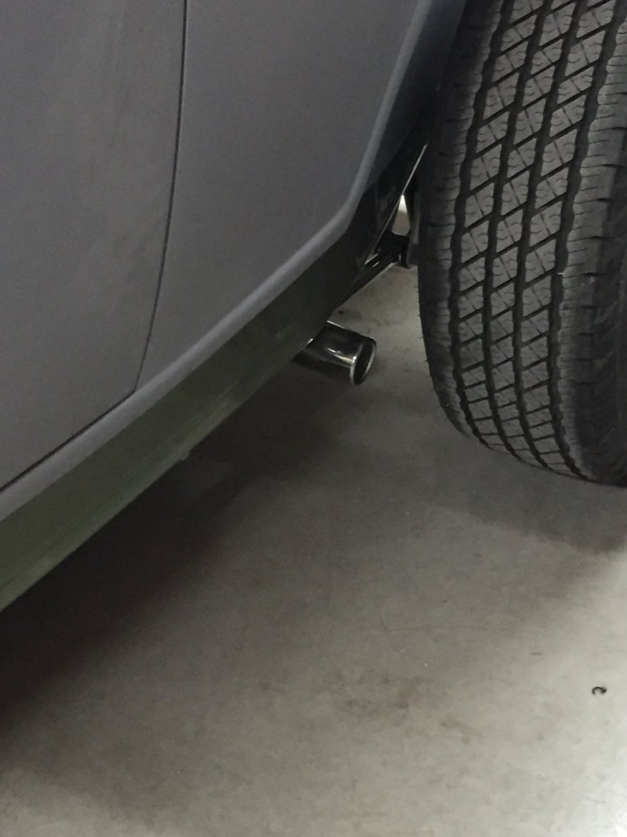

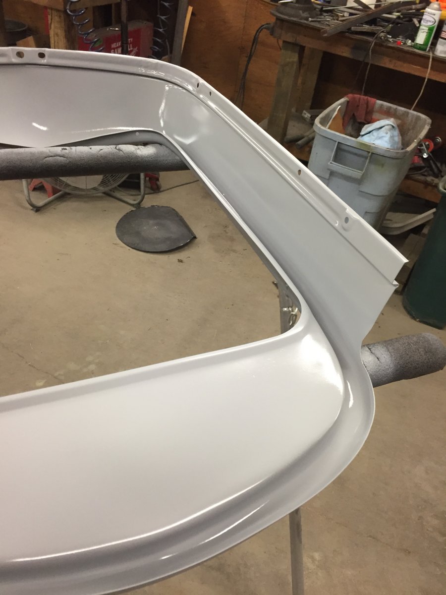

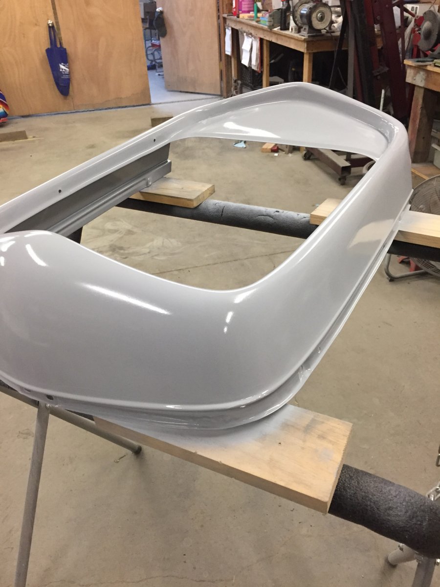

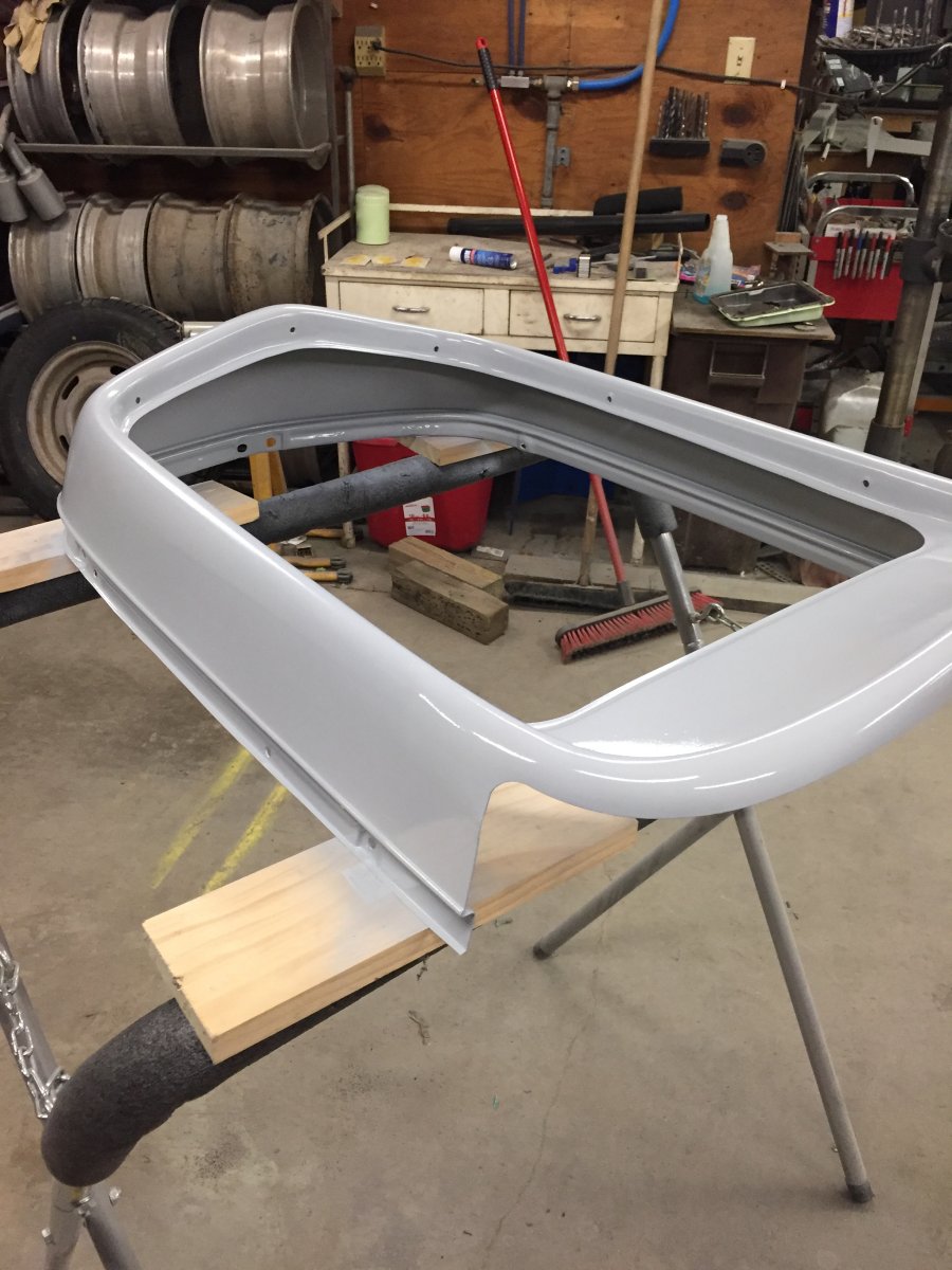

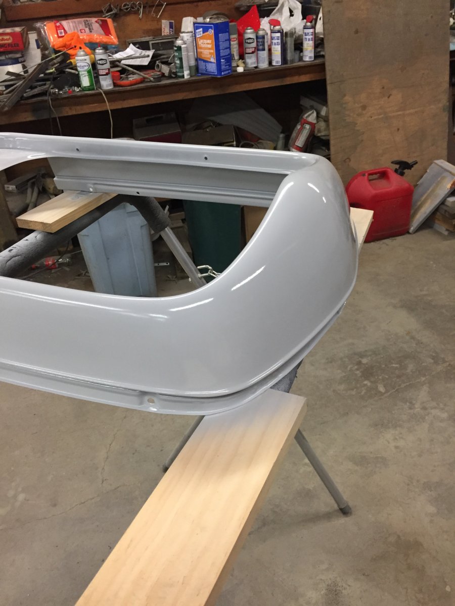

    Wiring is about 3/4 done. All battery cables run, engine compartment wired, rear lights done and the dash is complete. Starting on the switches Thursday (infusion ties up most of tomorrow). Still have a few wires to anchor down. When it’s all done and I get through inspection and everything works, I’ll cut all the zip ties off and put Painless braid over all the wires. That’s what is on the distributor to coil wires in the picture. That’s what winter is for.

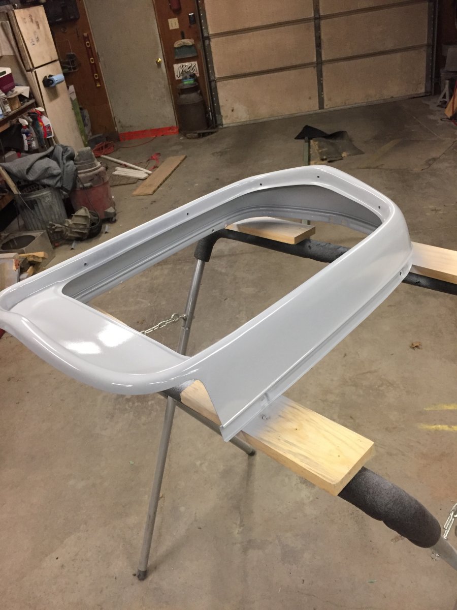

    Cleaned up the grille shell and primed it.

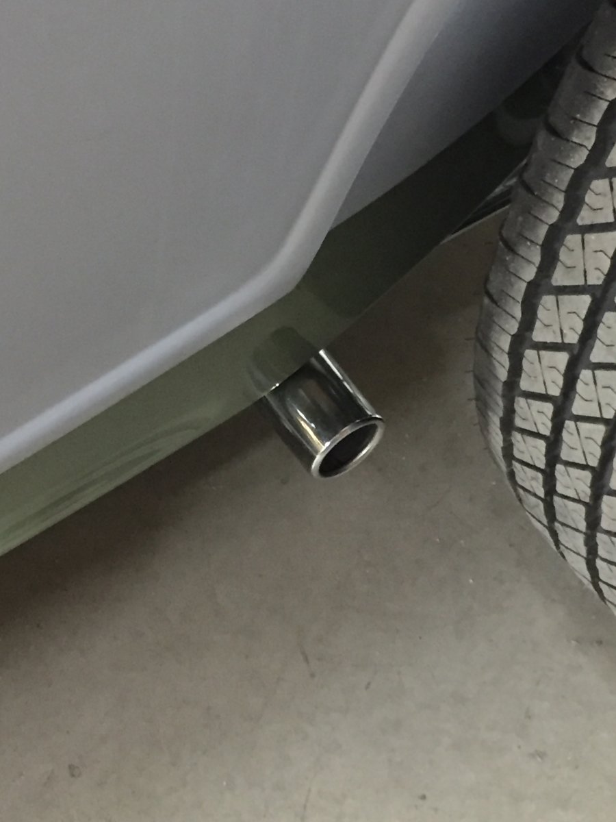

    Stainless pencil tips for the exhaust finally showed up so got them installed too.
    SPark

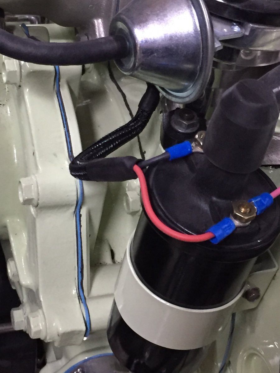

    How do u keep braided stainless clean when over all electric wires. I split rubber hose & wipe off. Tie wraps need little more work but has to be easier then braided or all the corrugated junk on factory cars which just catches & holds all dirt
  30. LM14
    Joined: Dec 18, 2009
    Posts: 1,936
    LM14
    from Iowa
    It's not stainless, it's Painless Power Braid. It's a nylon covering made for wiring. Wash it off and go on about your life.
    https://www.speedwaymotors.com/Pain...47334435&utm_content=All Products (Oct4_2019)
    Comes in several sizes for a good fit.
