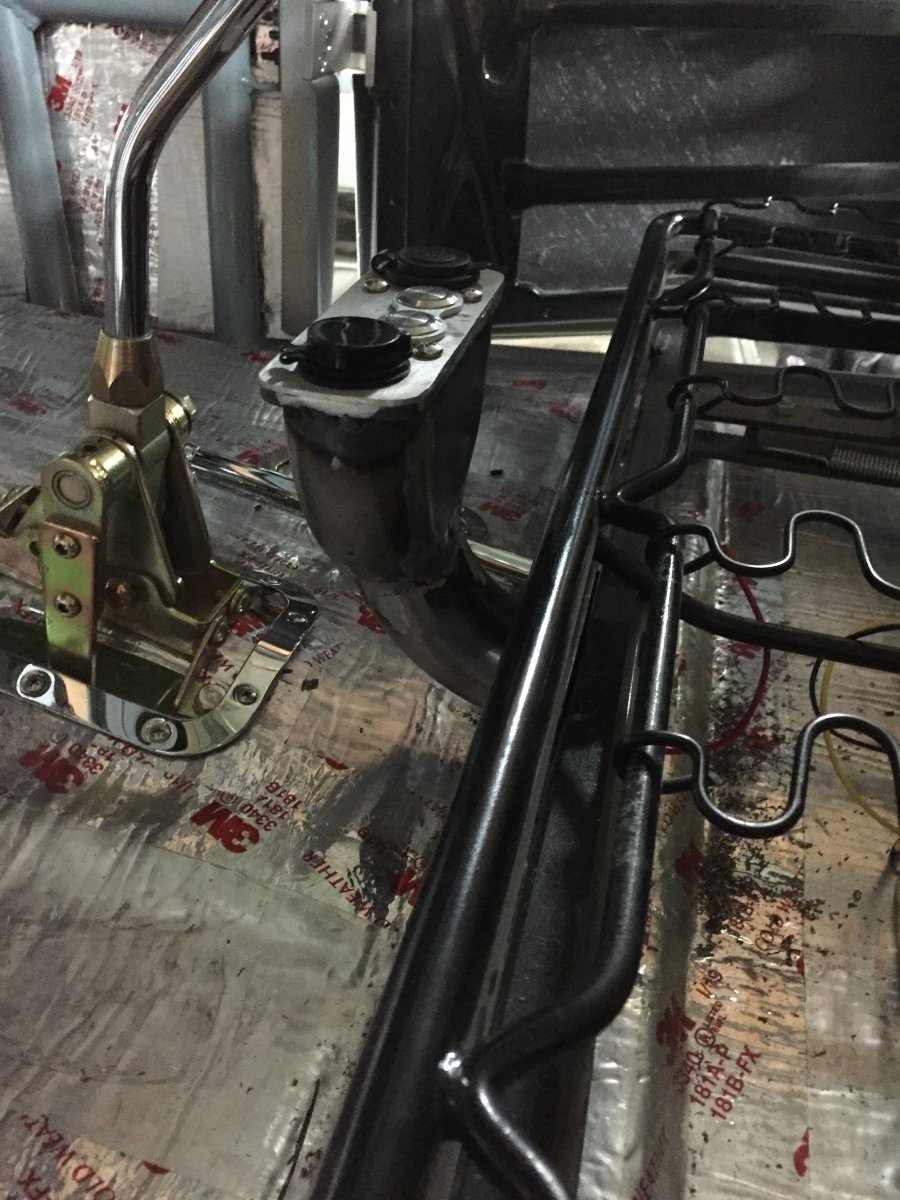

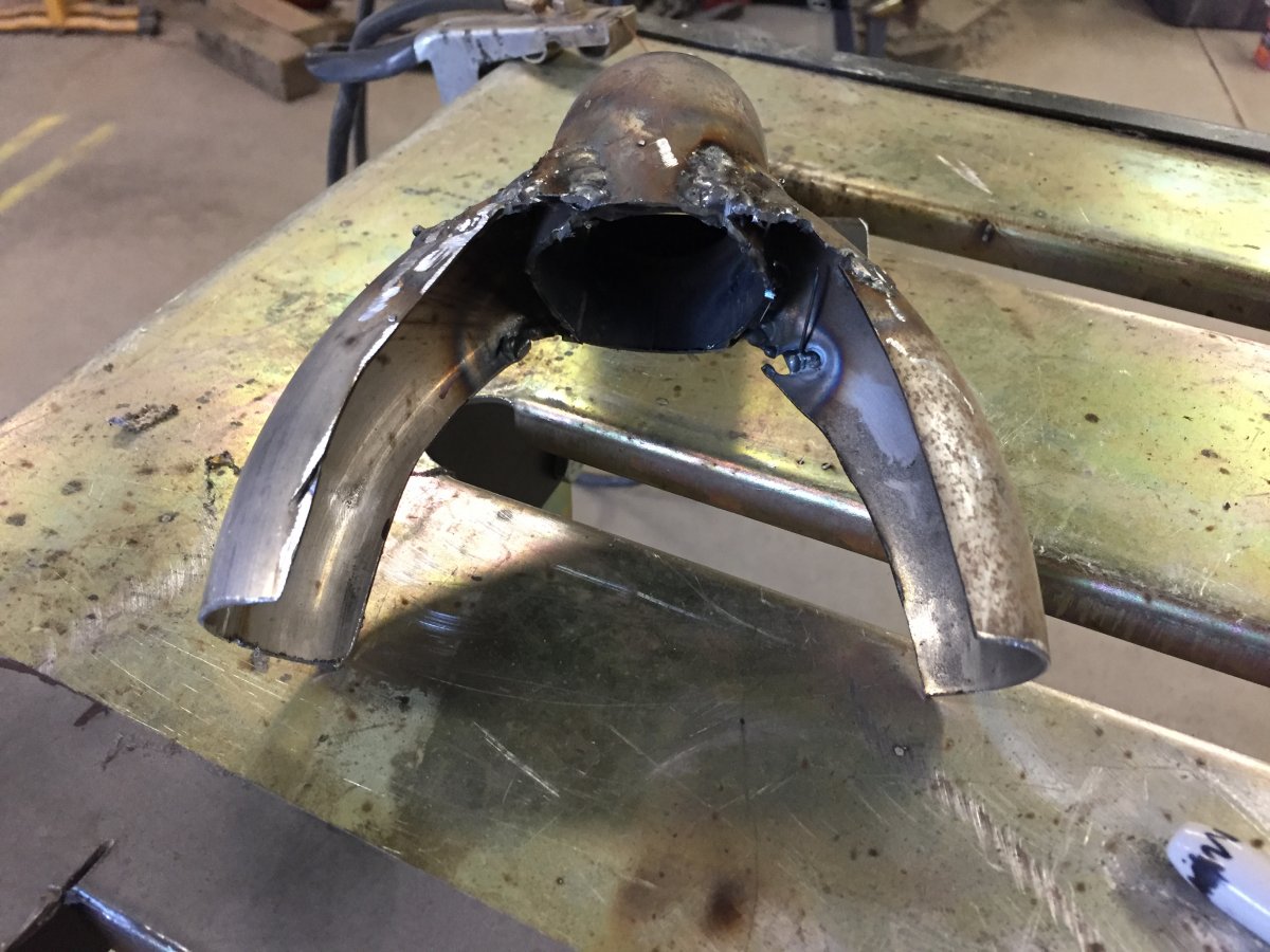

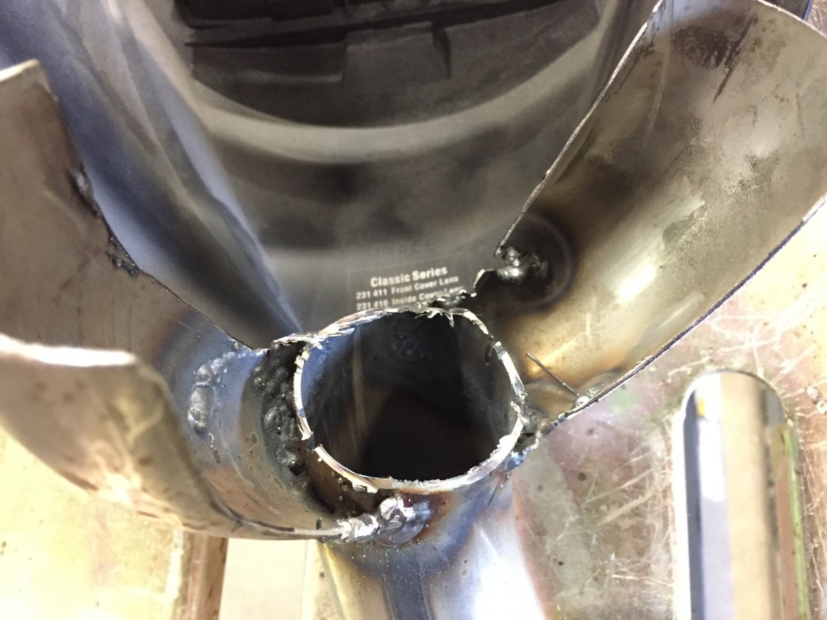

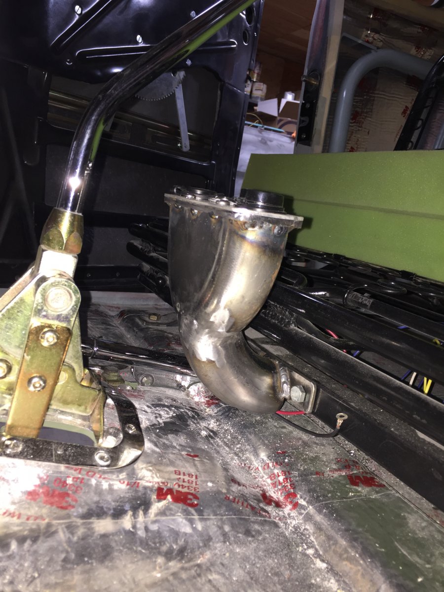

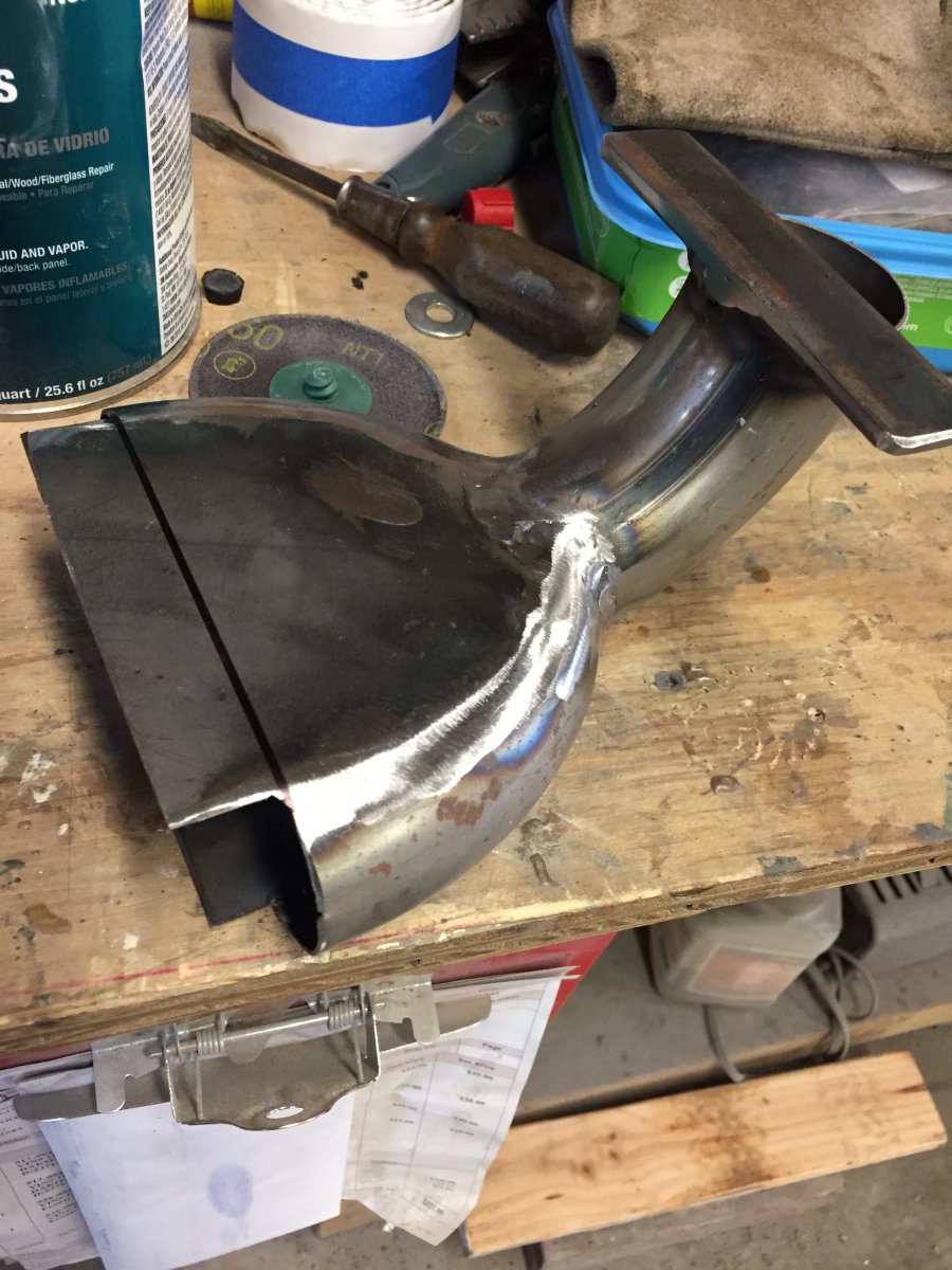

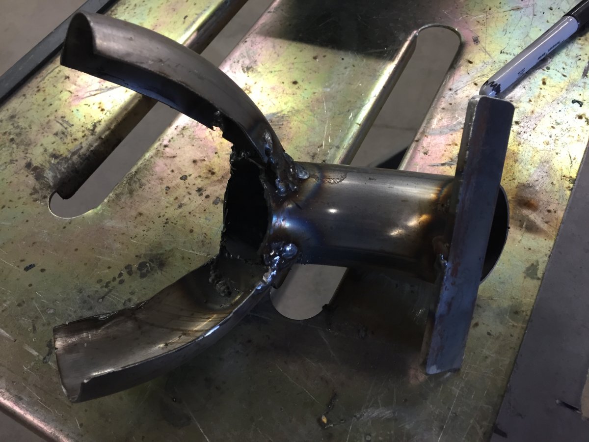

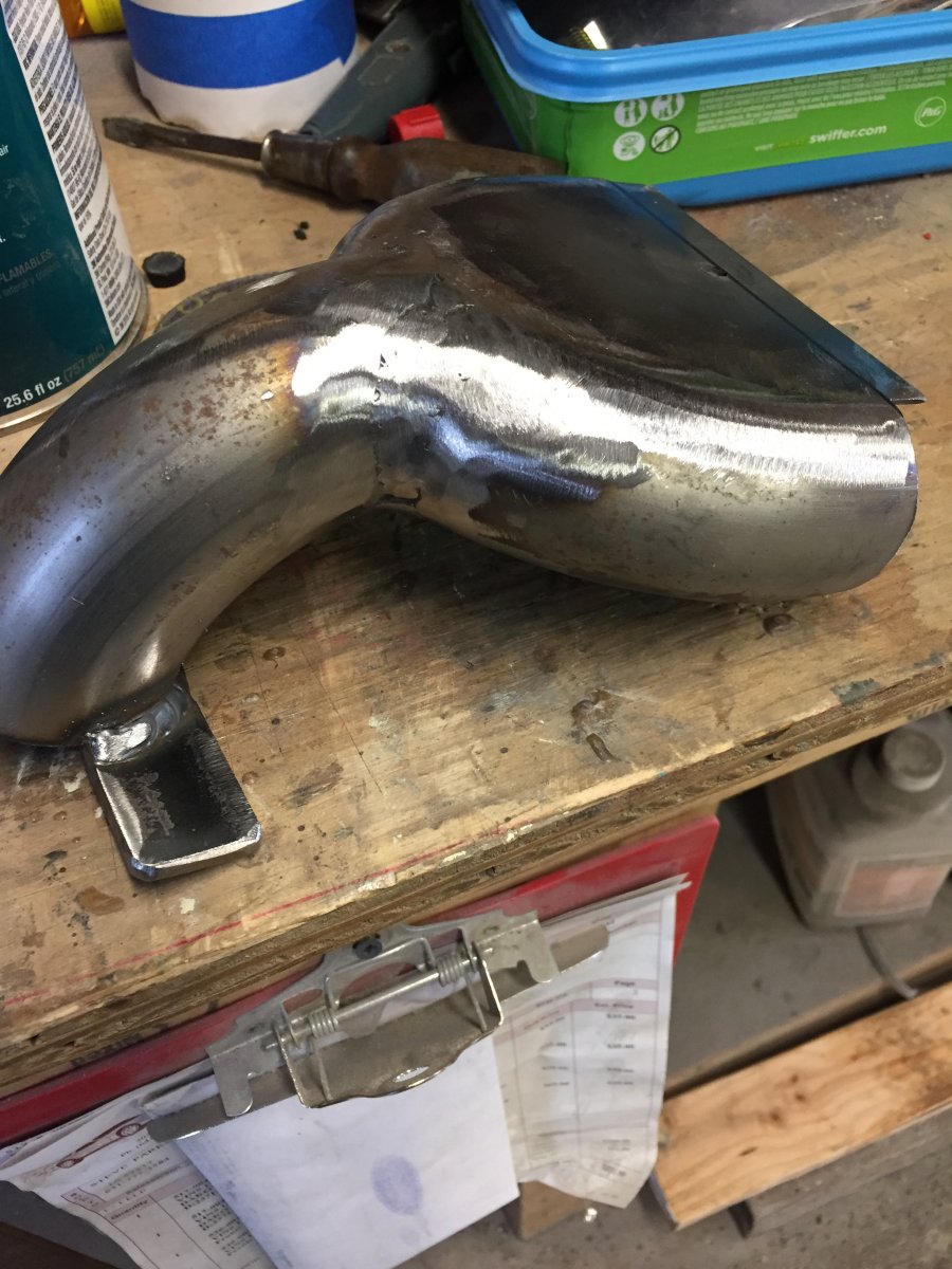

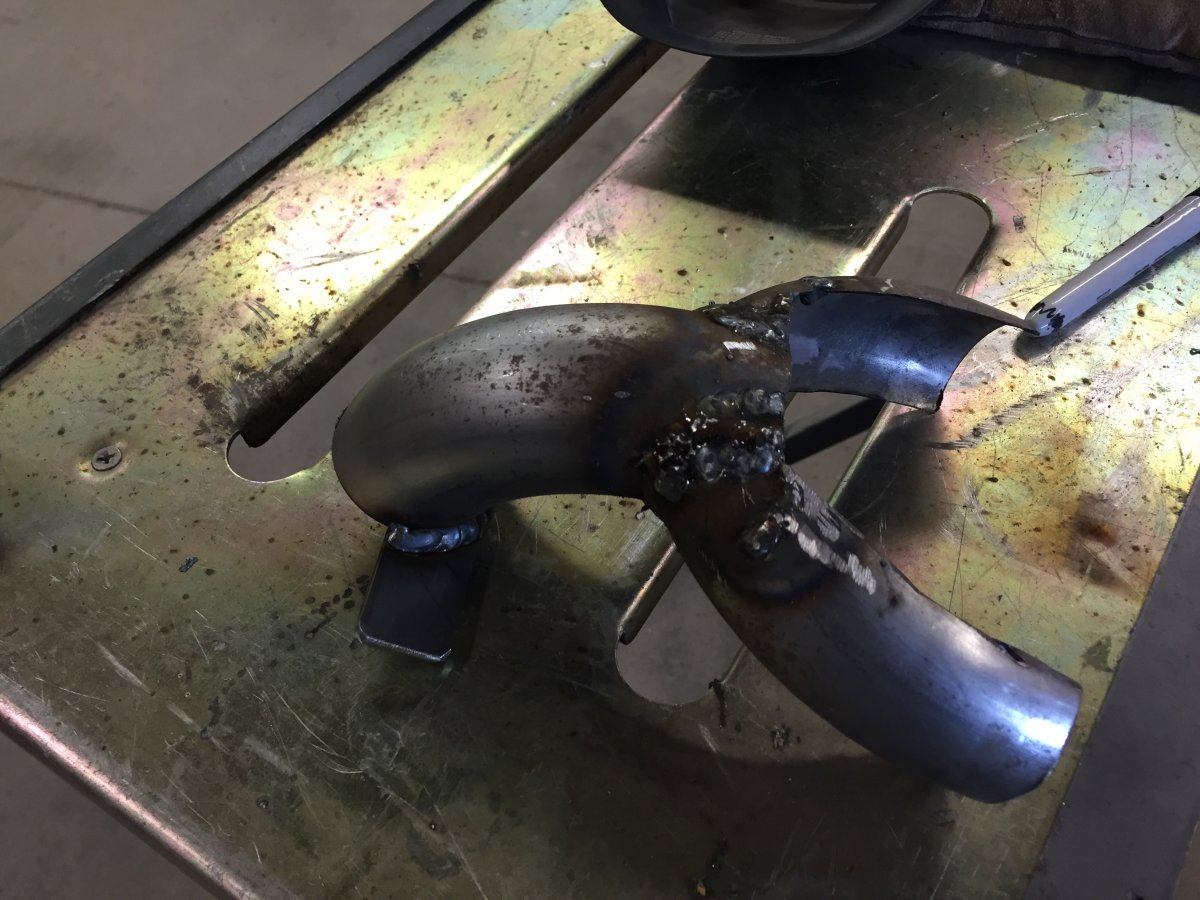

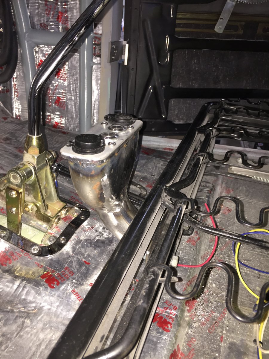

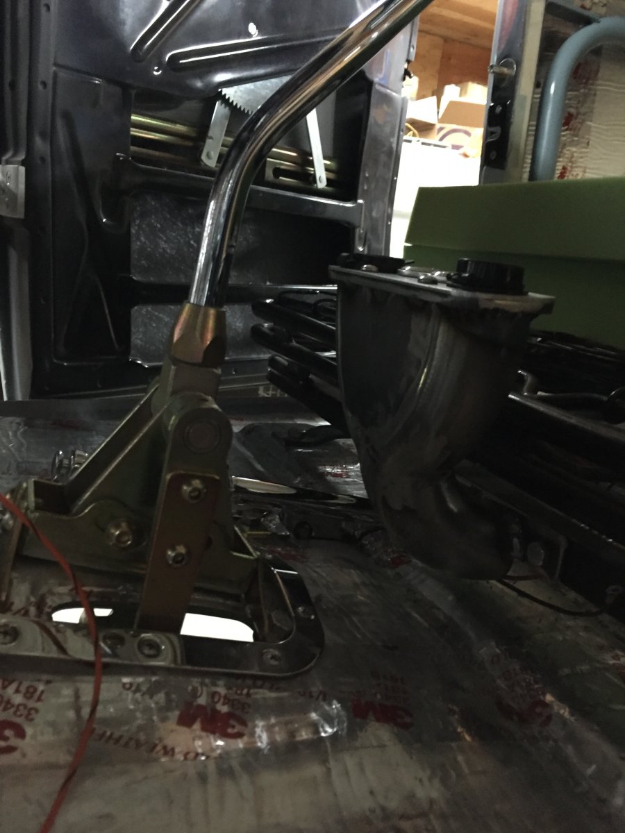

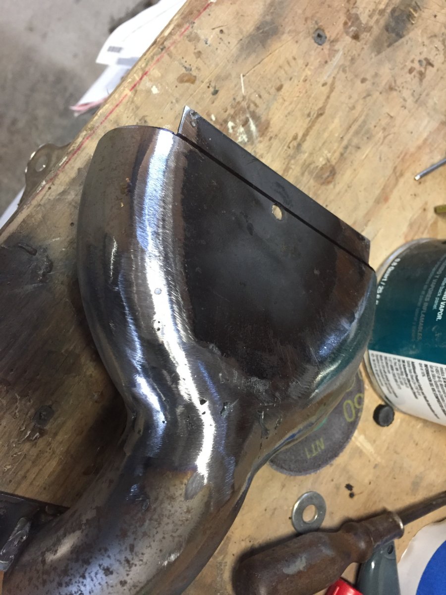

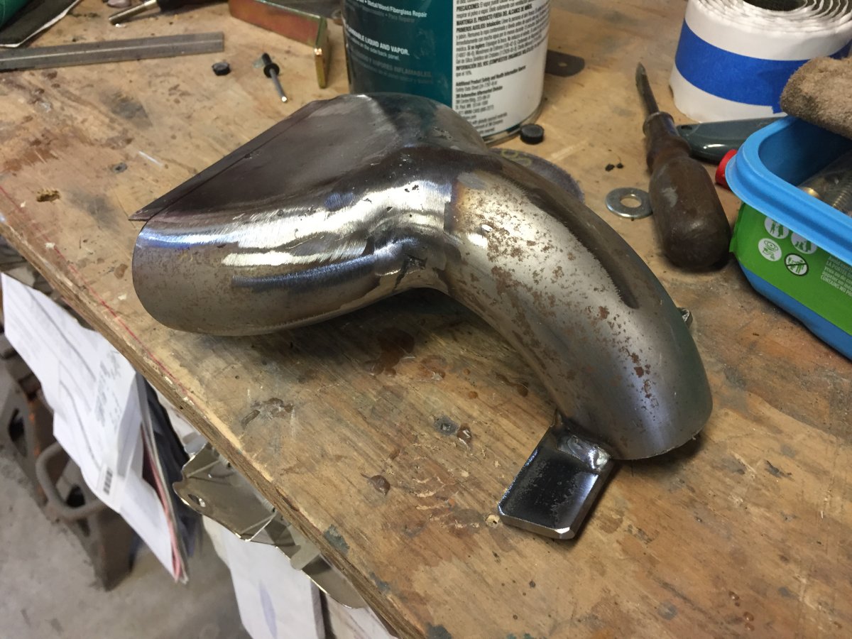

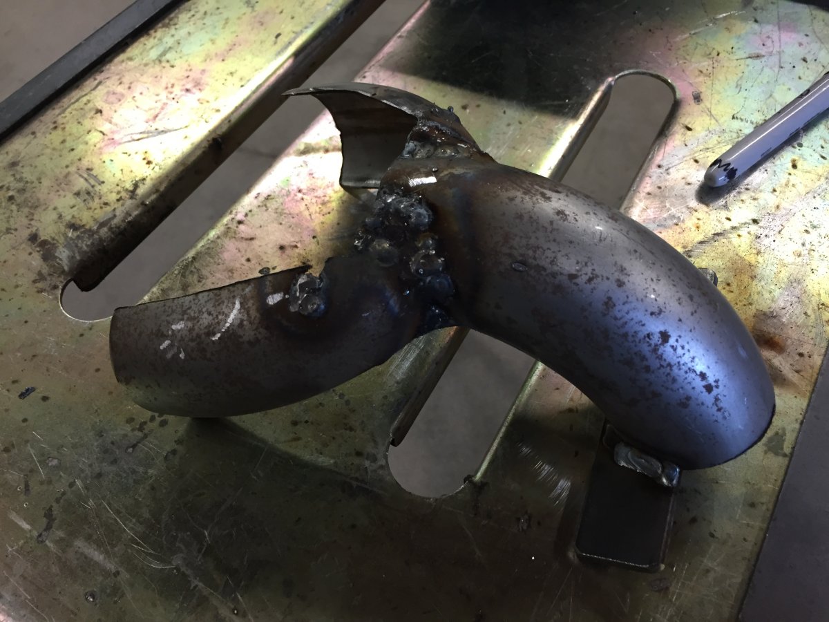

    Didn’t take a lot of pictures until I had the major pieces created, tacked together and the guts removed. Needed a place to hold my turn signal buttons, USB ports and power port. Also had to be easy to get to. Created a pedestal that bolts to the front of the seat base. Travels forward and back with the seat and still lets the shifter and emergency brake work as normal.
    Basically started with some 1-7/8” header tubing. Used 3 - 90° bends. Hell of a time getting them tacked and keeping things square. Worst looking tack welds I've ever made. Shouldn't even show them. Ended up getting a few good tacks and grinding all the garbage off back to clean tubing and starting over on them. Came out much better and not a lot of grinding needed to smooth things up. Didn't get a picture, but I cut the guts out between the outer tubes and plated the front and back (that ugliness in the bottom of a stub of tubing is all gone and the inside is finished with a burr so it's ice and smooth with nothing sharp to cut wires). Welded a threaded top flange on that accepts the aluminum top plate that holds all the switches and ports. Still a lot of finish work to do but it’s getting there.

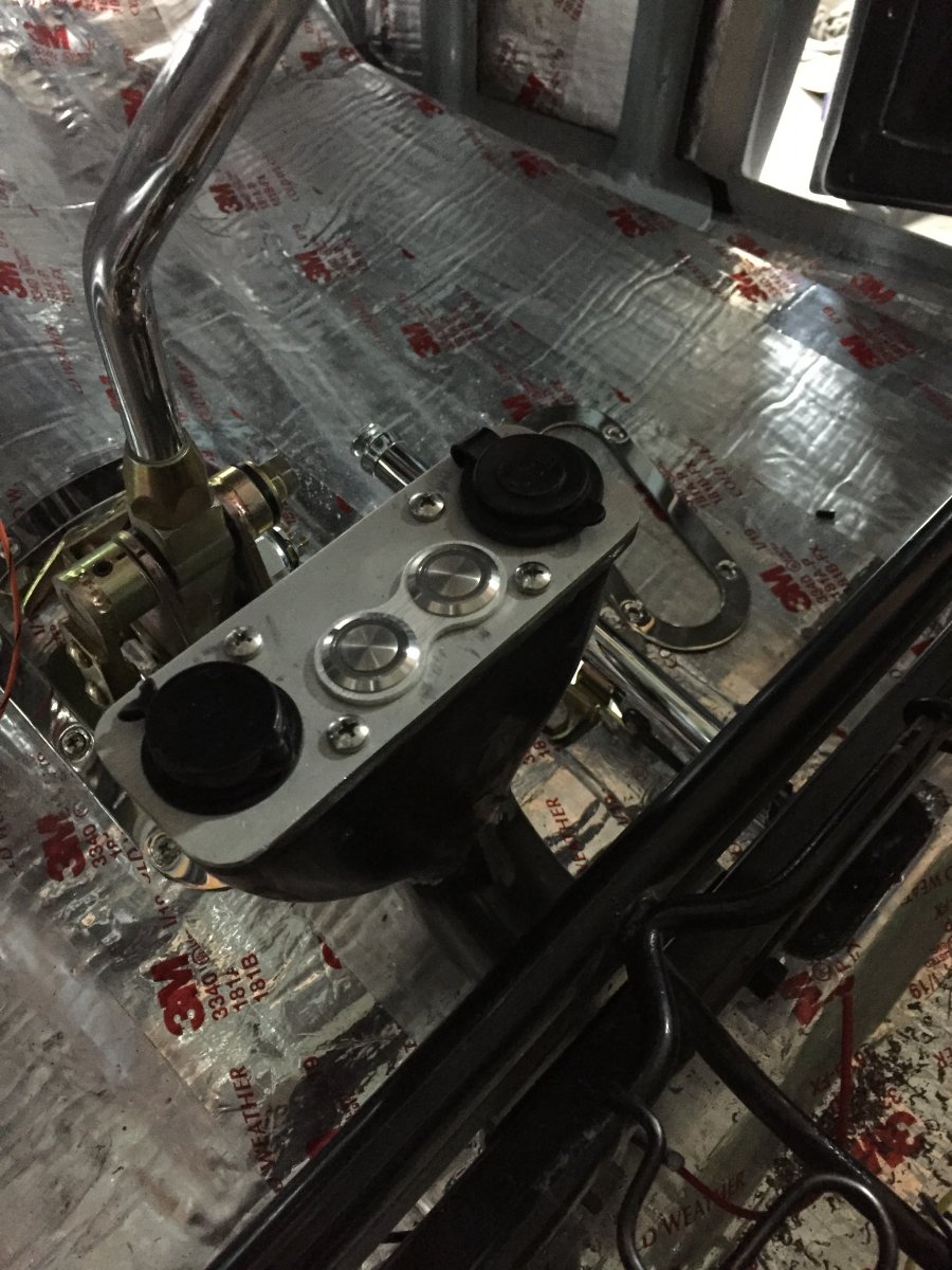

  6. I looked at photos before reading description. I thought it was cup holders until I got to the last photo.
    Project is coming along!
    Phil
  7. I have never used a power port in my cars. I charge overnight. Cup holder I use whenever I'm in the car for more than an hour.
    Phil

    My Garmon plugs into a power port. My phone charges with USB or power port. I charge in the car all the time, all my vehicles have them.

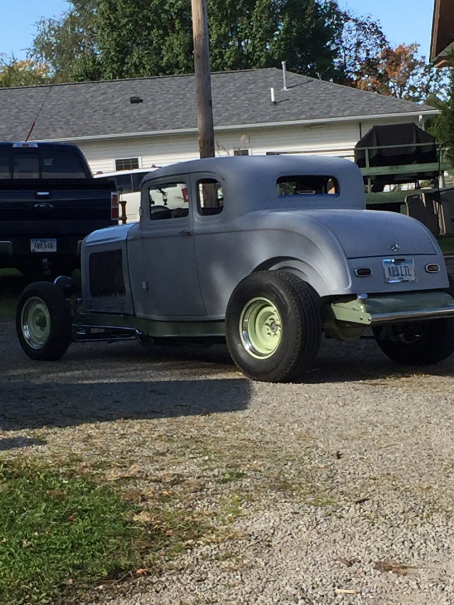

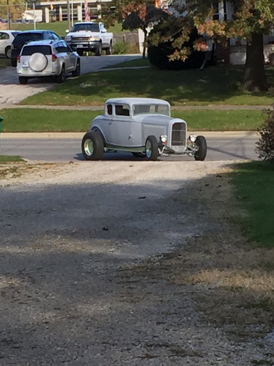

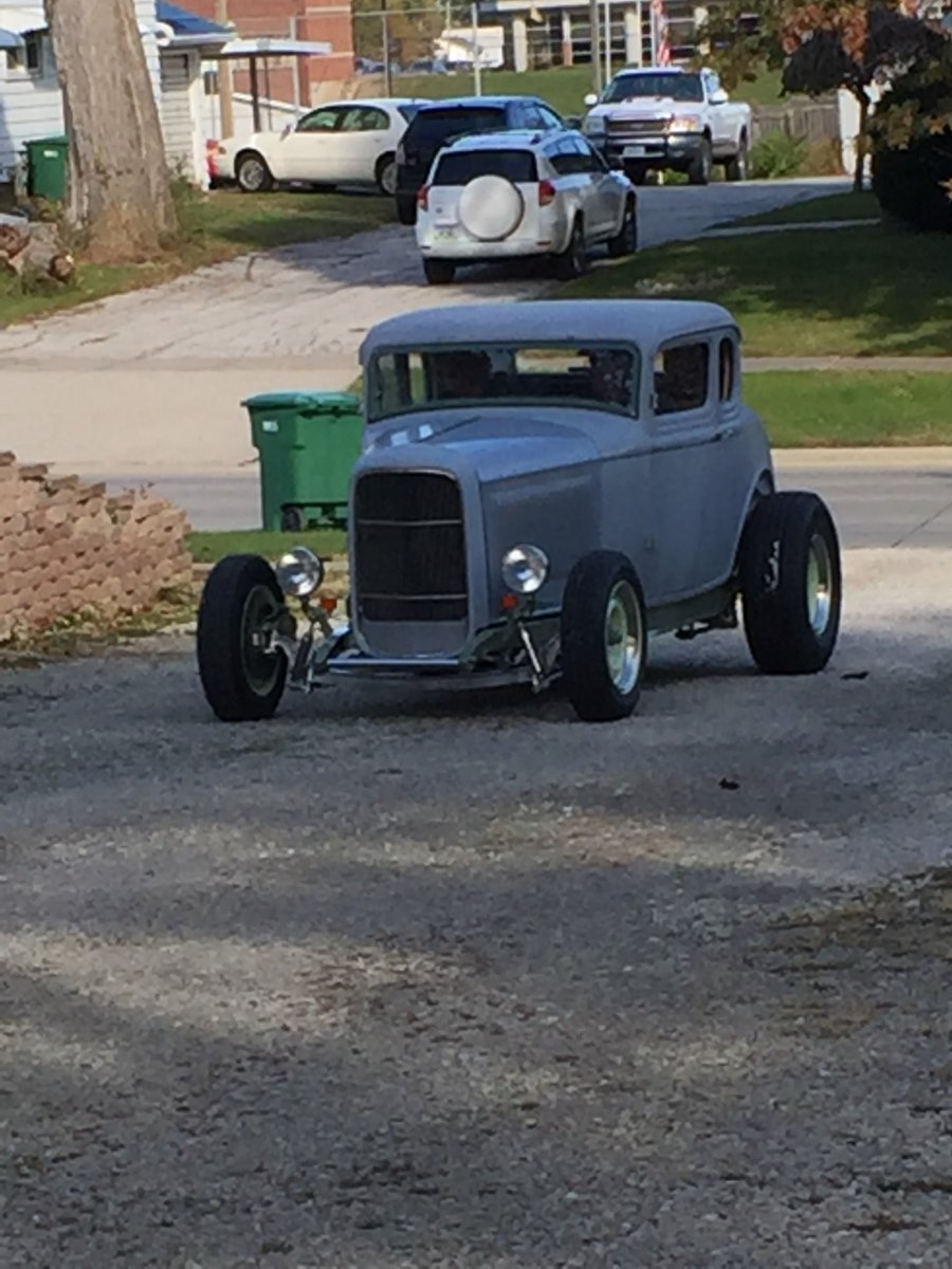

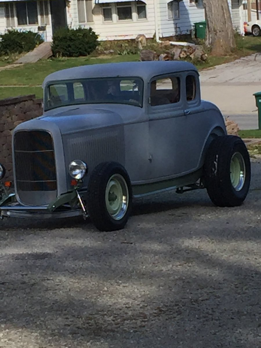

    The wife got a few pictures of the first drive.

  17. lake_harley
    Joined: Jun 4, 2017
    Posts: 2,367
    lake_harley
    Congrats! It looks even better on the road than it did in your shop when I stopped in last week......and it was looking great then!
    I don't think I ever said "Thanks" for letting me come by to look over a few things on your car for my own education, but I did appreciate the opportunity.
    Enjoy!
    Lynn
    loudbang and Stogy like this.

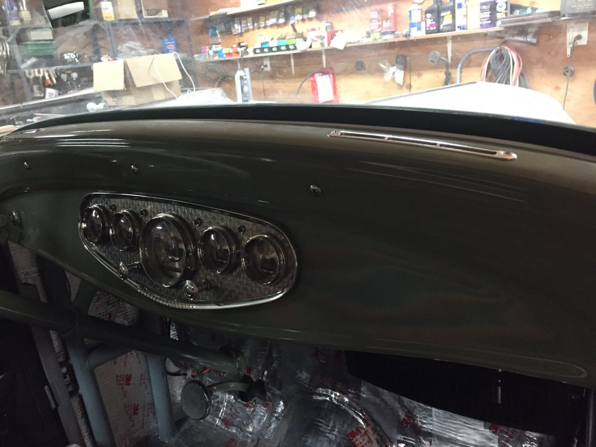

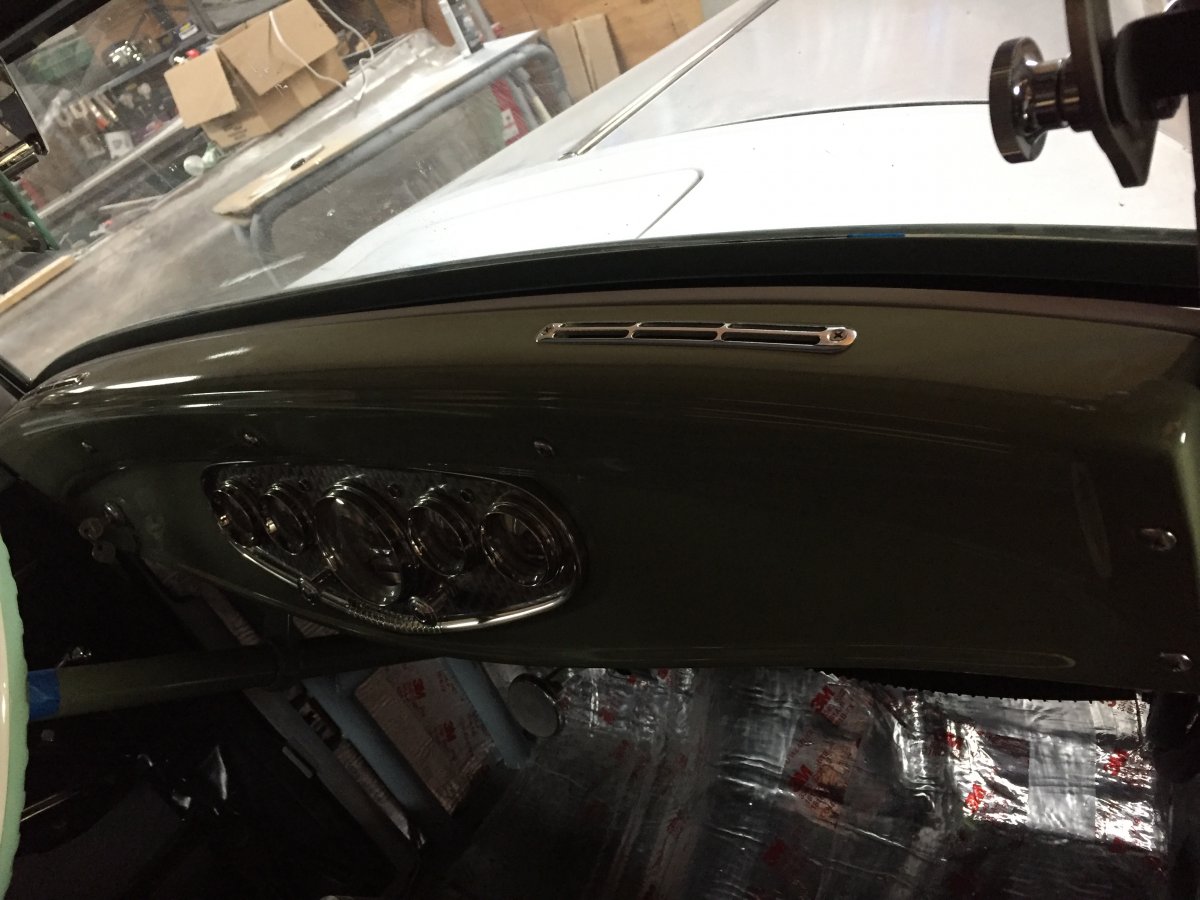

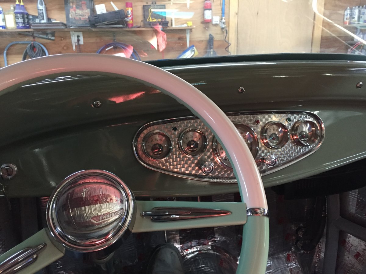

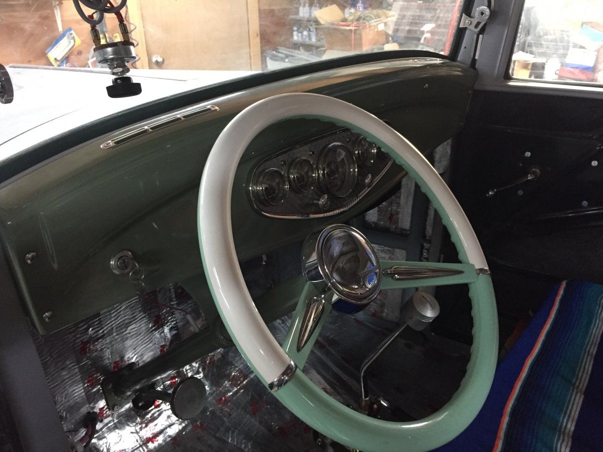

    Stuck the dash in today. All the dash lights and gauges work.....except the speedometer. It doesn’t move off zero. Will spend tomorrow afternoon tracking that down.

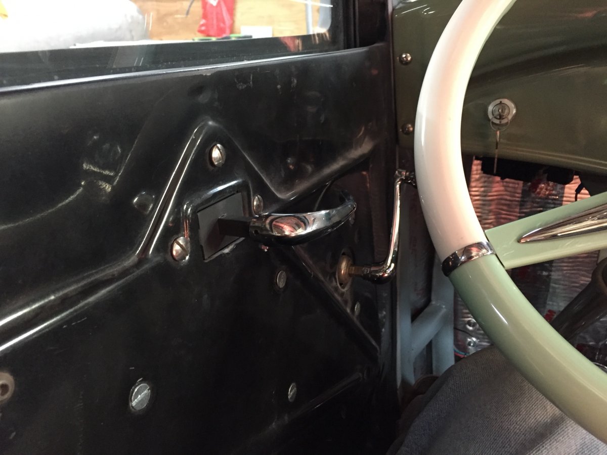

    Put the real steering wheel on and got it all centered correctly. Horn even works!
    All the glass back in and the inner door handles are on, so it’s a little more tolerable.
    Only issue other than the speedometer is the left front brake. The rotor has a little runout and it makes the outer pad move around a bit. Sounds like a rock in the tire. Click, click, click. Going to get that rotor turned and see if it fixes the issue.
    Probably around 100 miles on it this weekend. Very happy with the way it rides and drives.

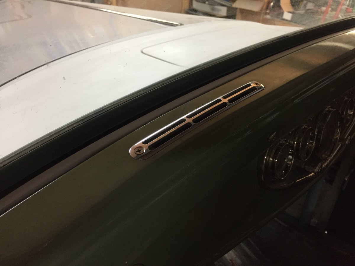

    With that working I finished up the defroster grates. Fit perfectly.

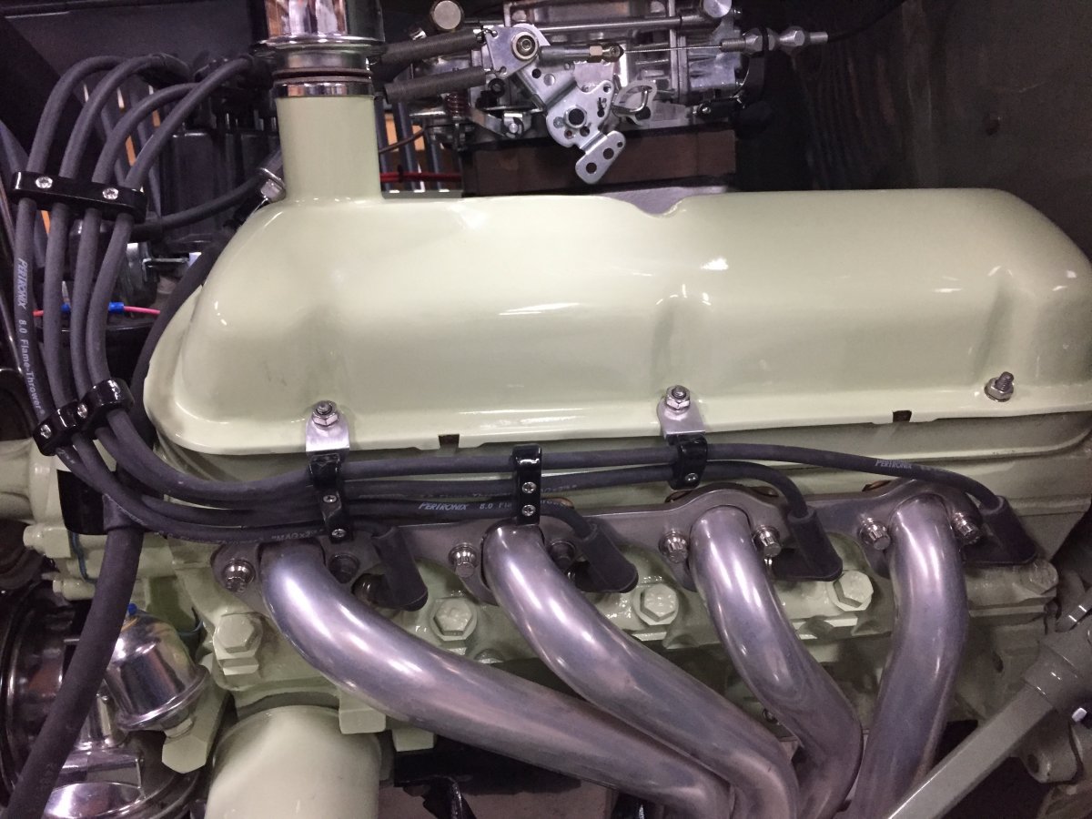

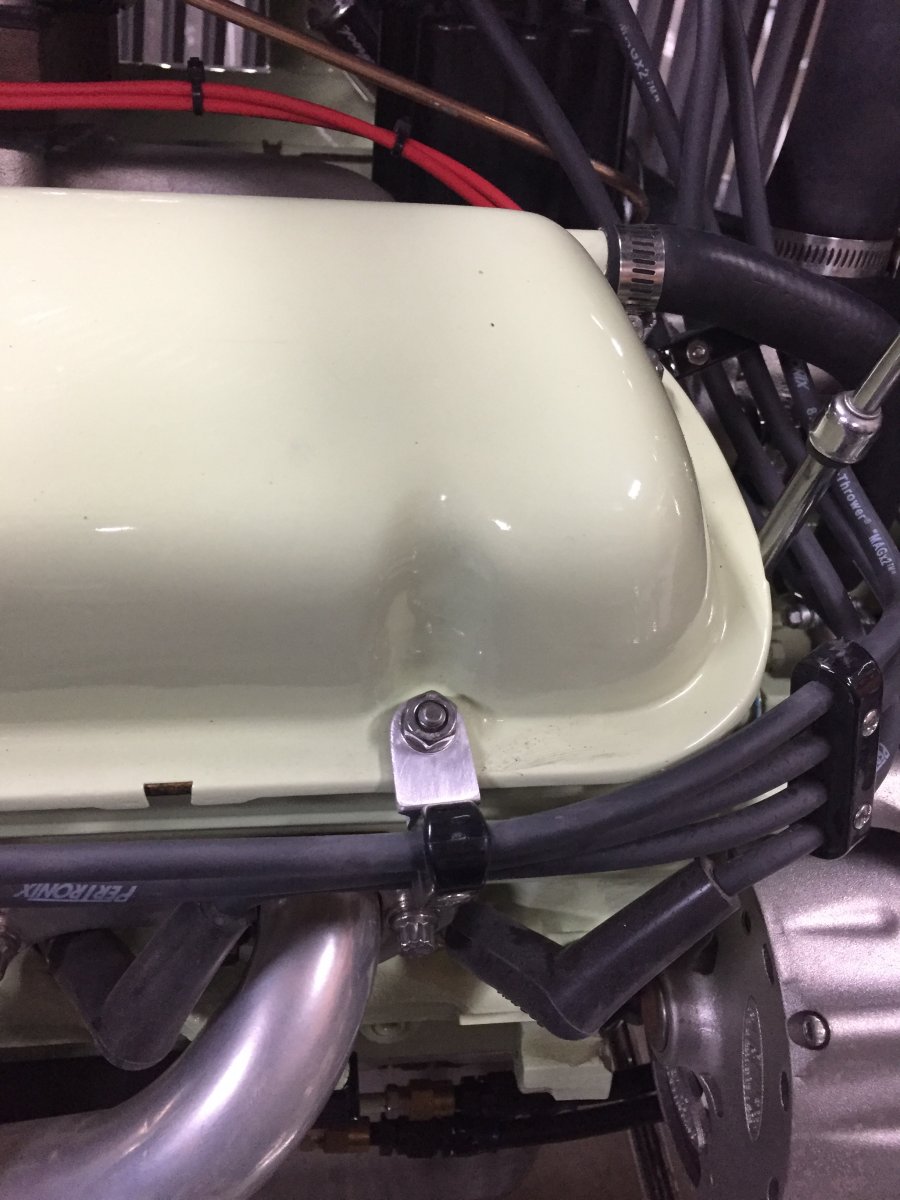

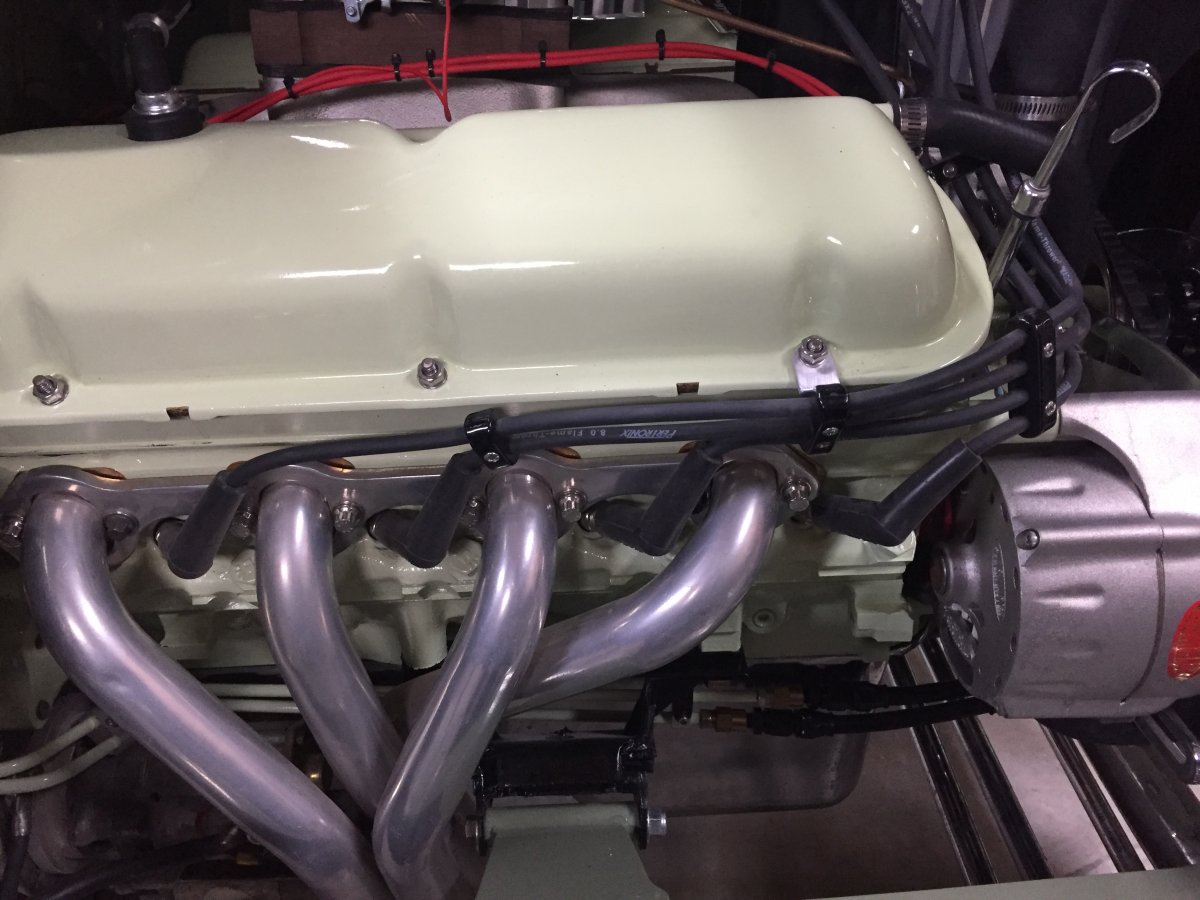

    Made some small tabs to bolt the plug wire separators to. That should keep them in place nicely.

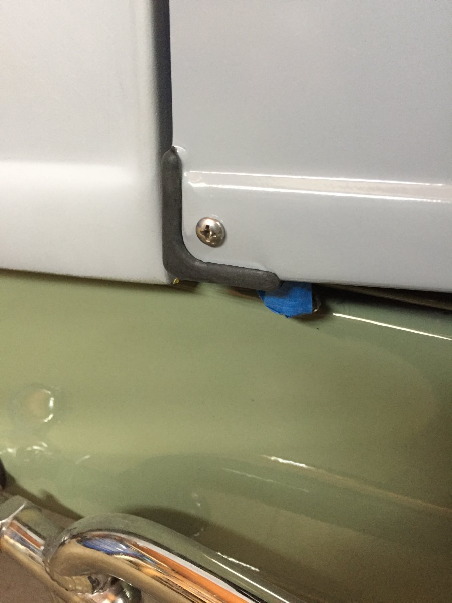

    Got the hood corner rubber bumpers on. Almost decided to skip them and smooth the area up but in the end it helps the “look” to have them there.

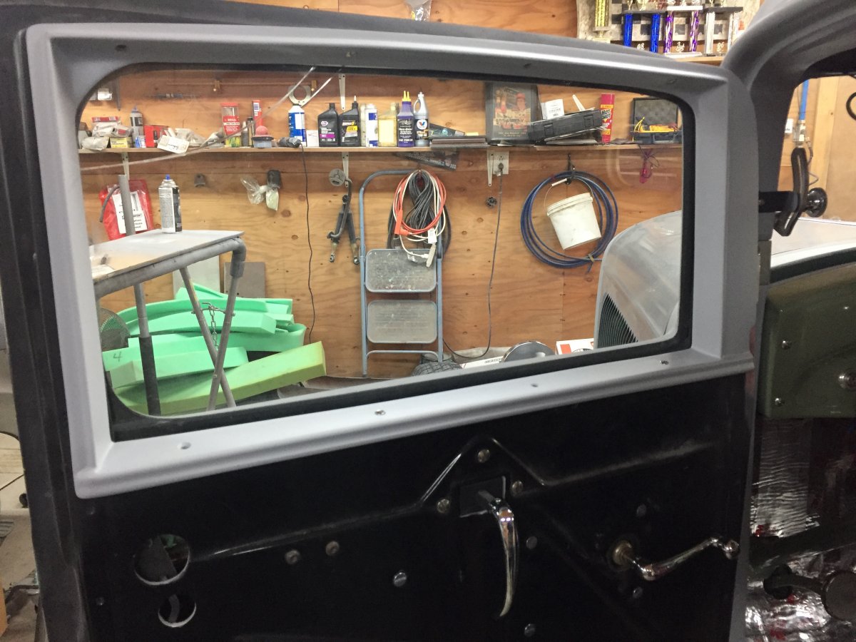

    Is all your glass and fuzzies coming out for paint? It would be WAY easier to do, and no taped edges to worry about.
    milwscruffy likes this.
  25. LM14
    Joined: Dec 18, 2009
    Posts: 1,936
    LM14
    from Iowa
    Everything but the back glass will be removed and there is plenty of room to cleanly tape that window without tape edge issues.
    Also looked into the fuzzies across the top of the door windows as you suggested since mine has none. Have an easy to execute plan for those now.

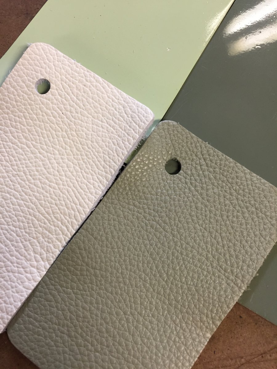

    My car came with all new glass from New Age Motorsports. Nothing is permanently mounted yet. Still have to get my windshield frame chromed this winter. Will report back on the guy that is cutting, installing and adjusting the door glass next week.

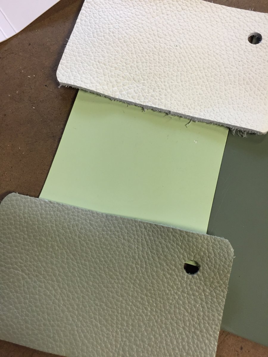

    Upholstery and carpet colors are decided!
