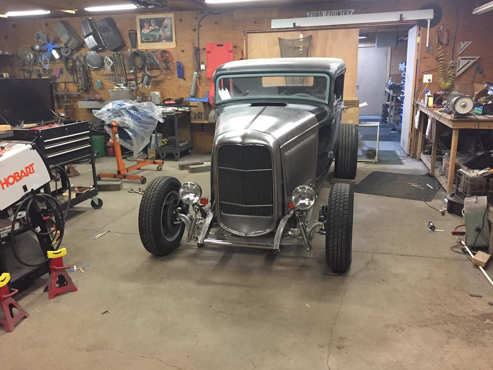

    Got the Rootlieb Henry hood mounted. No welting under it so still a little out of line in places. Now to decide on how to mount the rear latch. It's coming along.

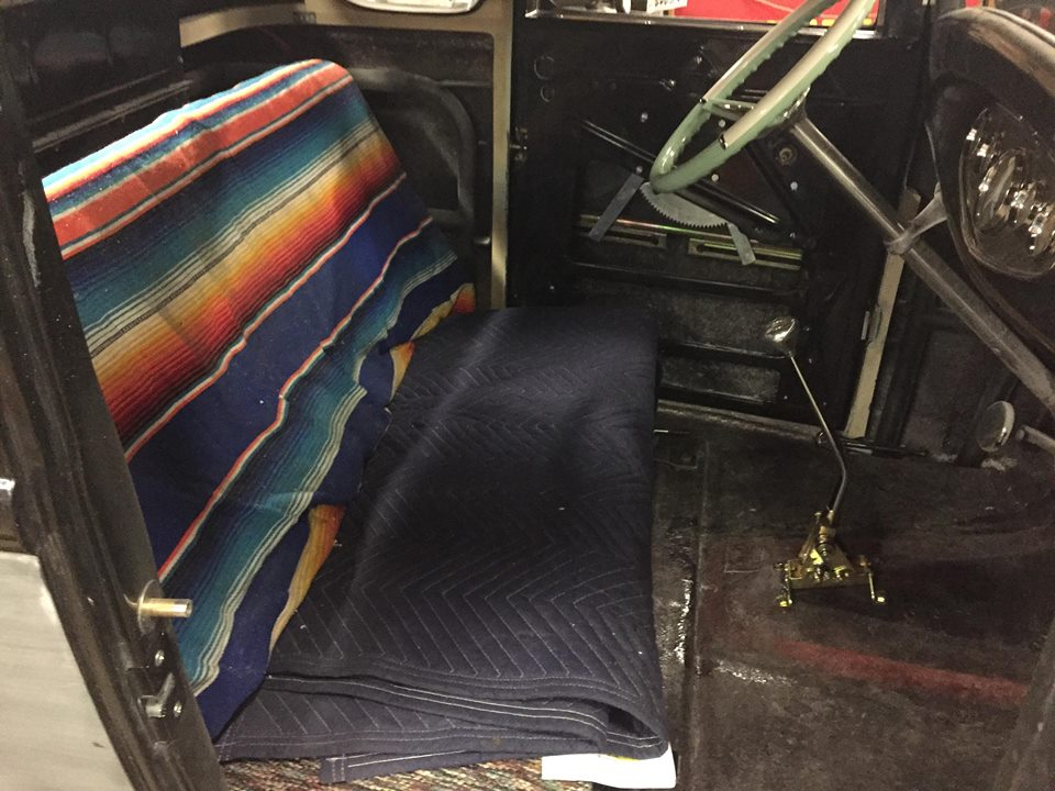

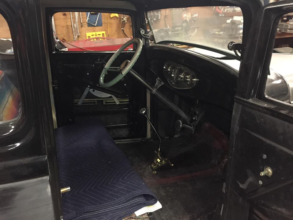

    Been feeling much better since they found out what was happening to me with the cancer drugs. Got me straightened out and back to work on things. Weara out fast but just make time to rest and cool off Making progress!

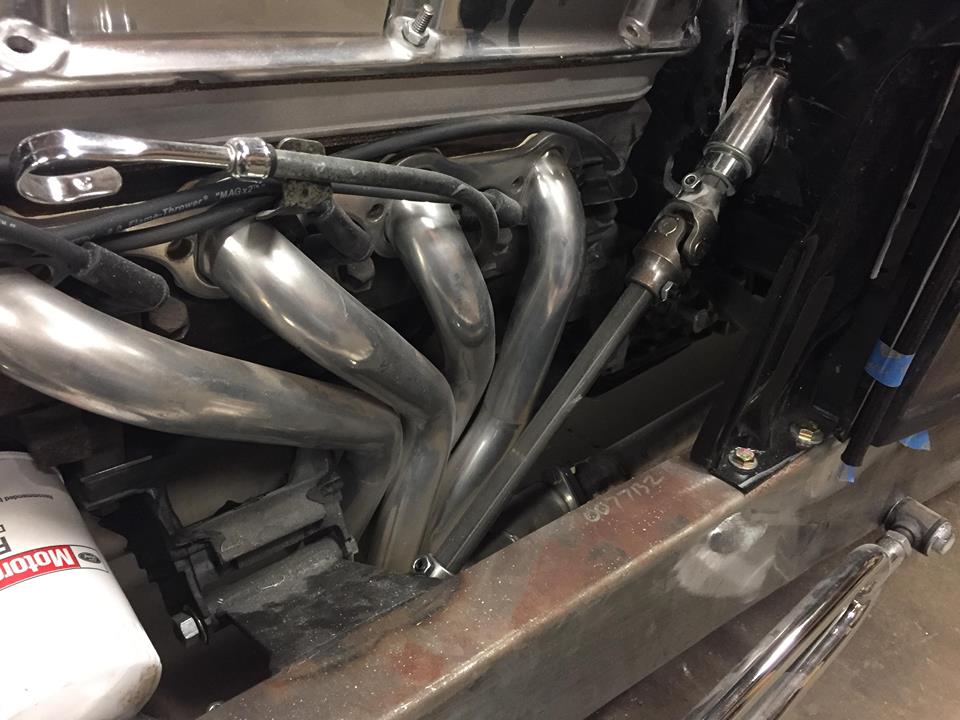

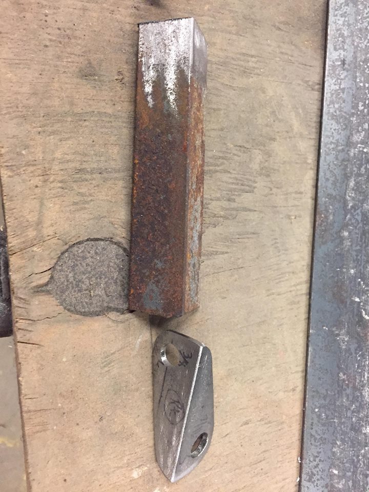

    Modified the seat feet to sit on the cross rails molded into the body. Mounted the seat and it fits great.
    Started playing with steering column angles. Think I pretty much have it where I want it with a couple of tiny changes. Started out with a shorter column drop and need to go longer. The longer one will actually give me a better mounting solution, too.
    With this roughed in, started playing with shifter locations. It's tight but I think it's where it needs to be. Drop it in low and put the seat all the way forward and it clears just fine (short wife). Put it in park and slide the seat all the way back (farther back than I would have it while I was driving) and can still reach everything easily and comfortably.
    Few good days of progress sure messes up the shop though! Time to clean. Parting shot is a view out the windshield, finally.

  23. kursplat
    Joined: Apr 22, 2013
    Posts: 295
    kursplat
    love that steering wheel. glad your feeling up to getting some work done. do you have any padding under the blanket to get you close upholstered seat height?

  25. LM14
    Joined: Dec 18, 2009
    Posts: 1,936
    LM14
    from Iowa
    Have several thick throw rugs and some moving blankets down. About 3" or so. Should be fairly close to the finished upholstery height from talking to the guy that's going to do the work on it. The wheel is a Con2R wheel and is a nice size. Actually bought it for my unibody project years ago and liked it better on this.

    After sitting in the car every chance I got the last 4 or 5 days (no I wasn't making Vroom, Vroom sounds....that was the shop cat) I decided the steering felt "right". Swapped in the correct column drop and welded a mount for it to the dash brace bar. Mounted the bottom and marked the column to cut down. Removed about 5-1/2" from the Ididit Old School column and the DD shaft inside it. Bolted it back down and got the steering u-joints in. Actually turns a lot easier than I thought it would. Great clearance and leverage, think this will work.
    I've been looking ever since I started this deal on what to do for front turn signals. When you're sick and have no energy to work but still want to sit there and think....you come up with ideas, sometimes. Since I don't sleep on the drugs they have me on, I'm usually up all the time (sleep 2 to 3 hours a day, maybe 5 once a week) and found some United Pacific LED dual filament marker/turn lights. Perfect! Ordered a pair. After a few minutes measuring I made a cardboard template. Then after fine tuning that a bit I made one out of tin. Bent it up and bolted it on the back of the shock bolt. Walked around it the last couple days and it doesn't annoy me. I didn't feel like I needed to rip it off and start over, that's always a good sign. Dug in the s**** pile and found a little chunk of 1x1x1/8 angle iron. Drew it all out with a couple little revisions (to better hide the nuts) and made a pair of reversed twins. This will eventually be welded to the back of the shock mount bolt hole on the headlight stand. Don't want to weld it until I have the radiator back out so I can clamp a straight edge side to side to get them exactly the same. You basically have to be lying behind the tire to see the nuts for the shock or light. Looked at them from several angles and I think they are keepers.
    Next up, more heater work, wipers, battery box (have to decide on battery for sure) and make covers for the MC under my feet and fuel pickup/sending unit area in the trunk.
