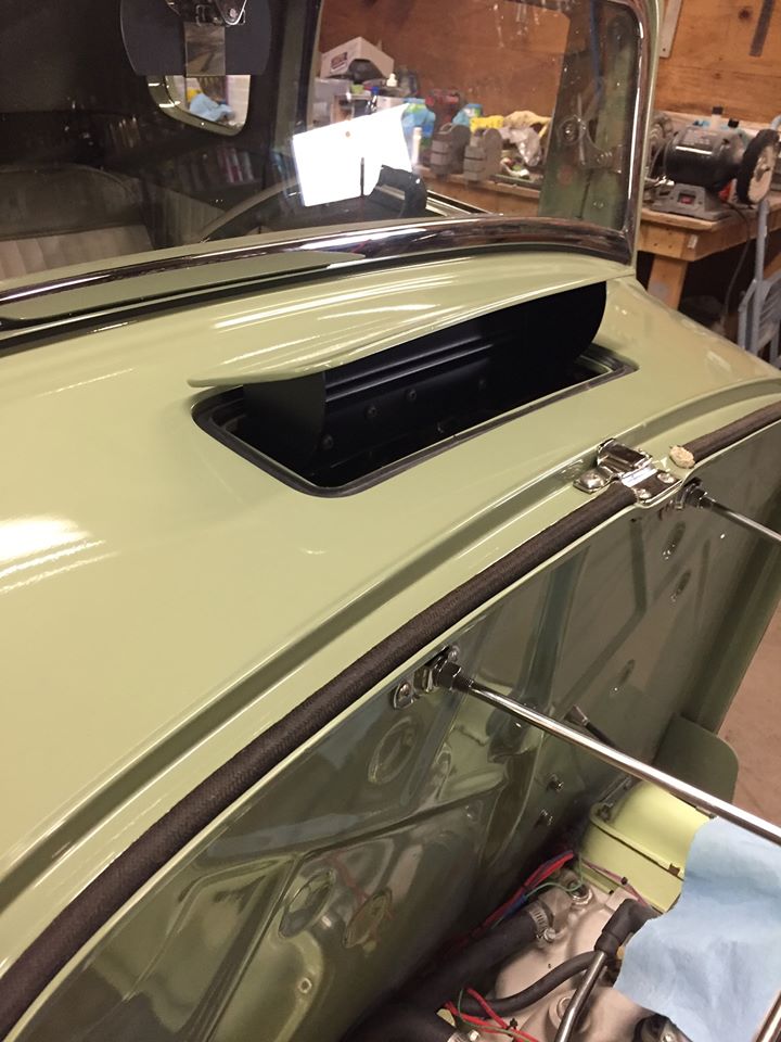

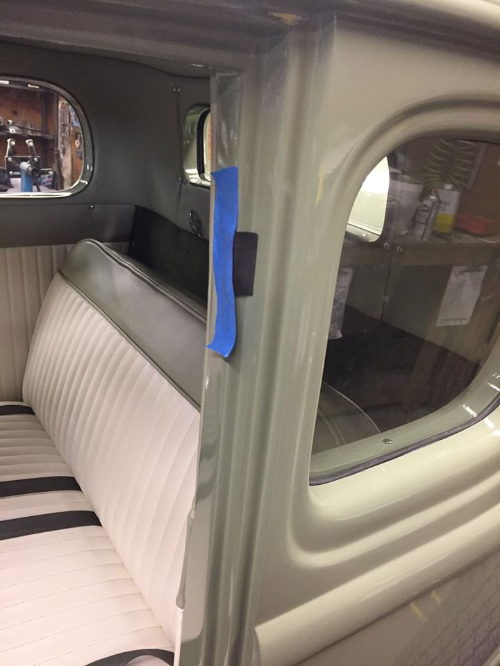

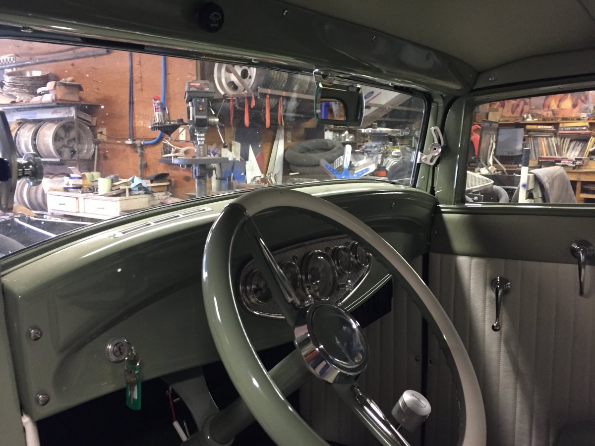

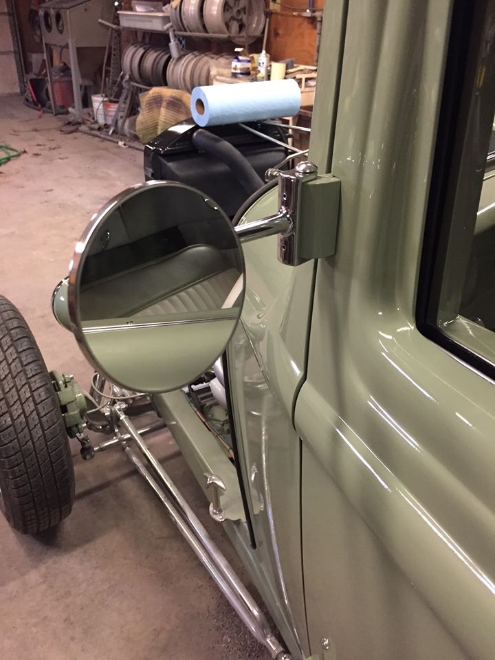

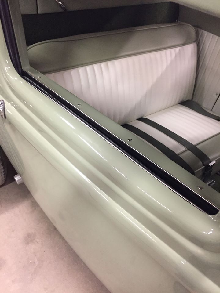

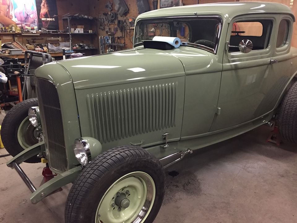

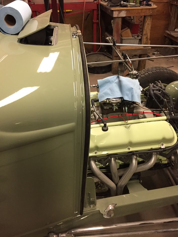

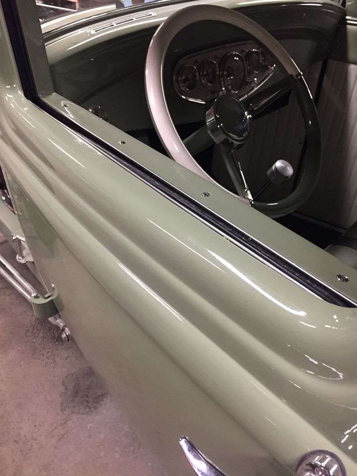

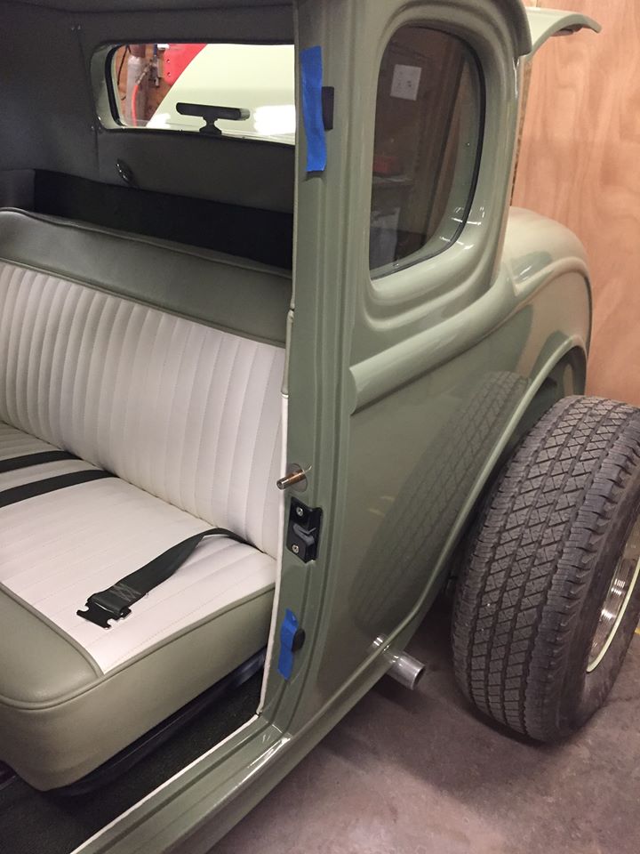

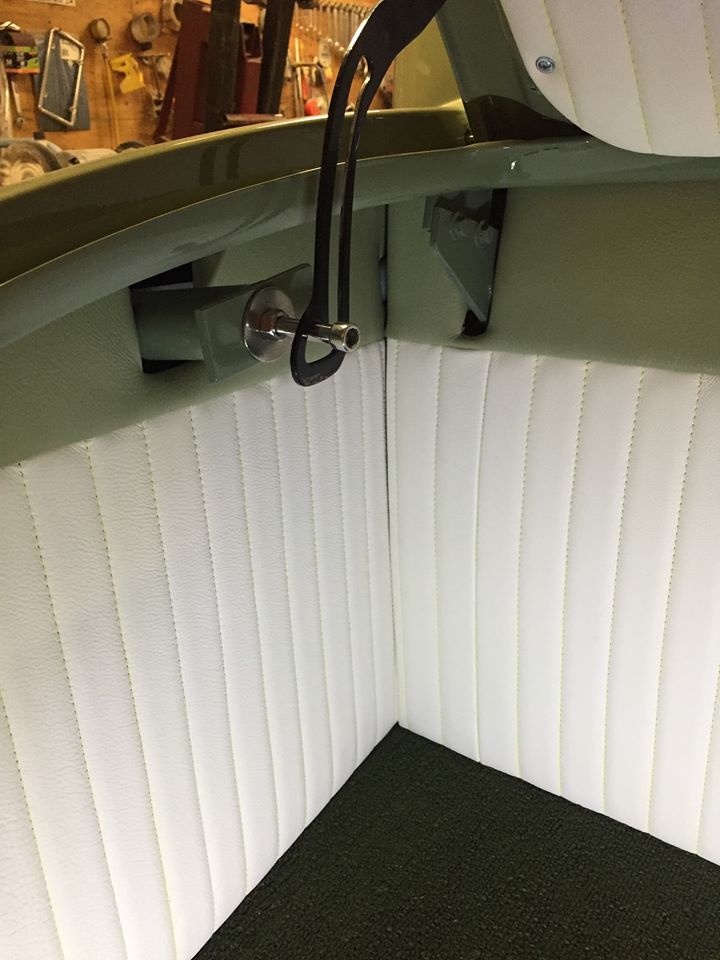

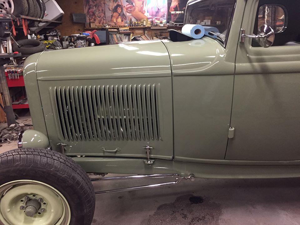

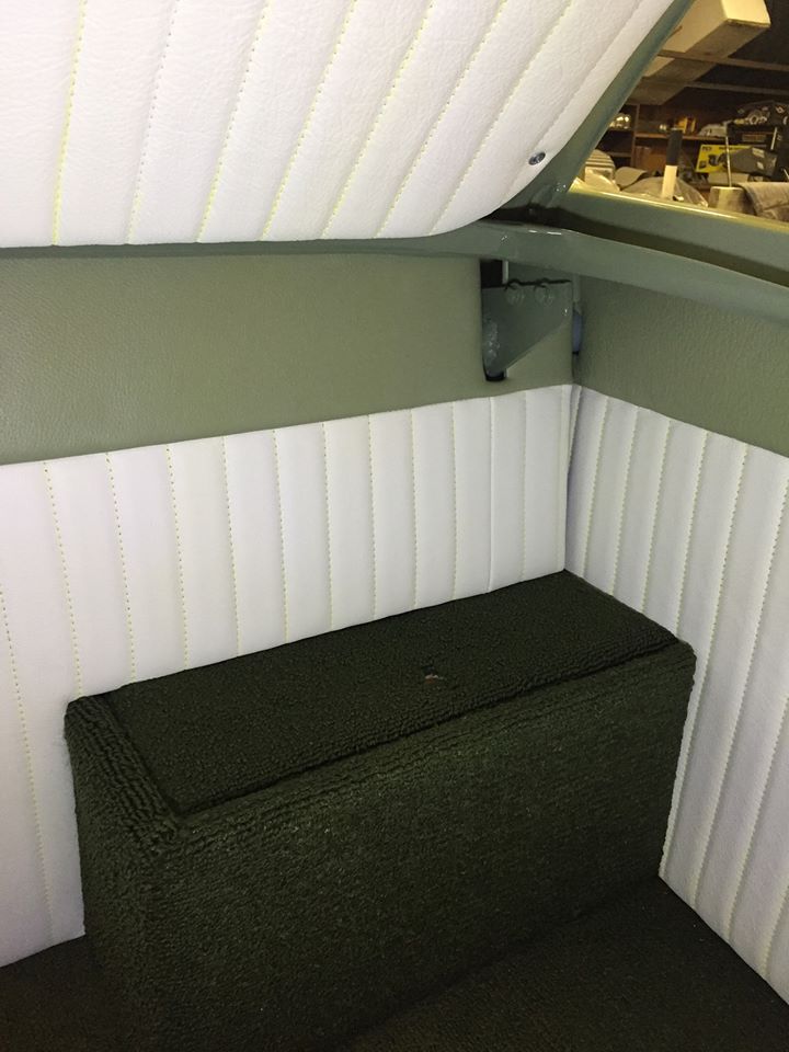

    Seat belts are in. They are a perfect match to the carpet. Rear view mirror is in, too. Interior is pretty much done.

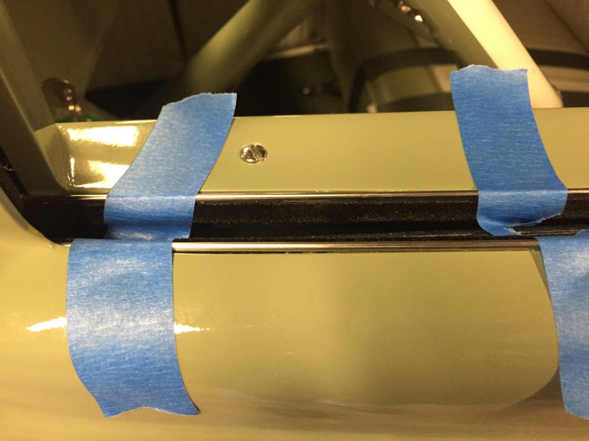

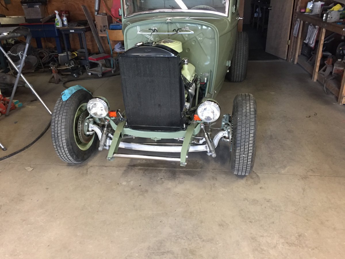

    Stuck the headlights back on and finished up the wiring. They will get adjusted after the grille shell is back on. Now to start getting the covering on the wire bundles.

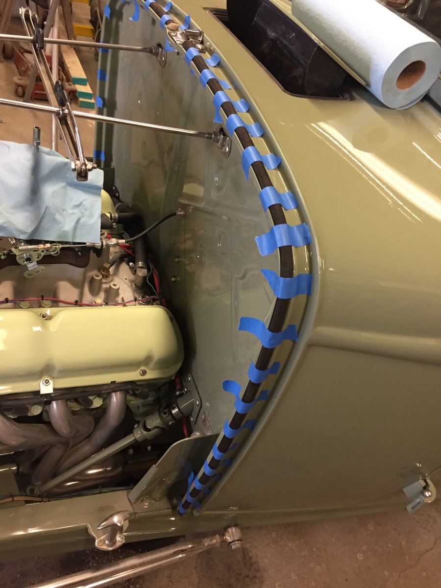

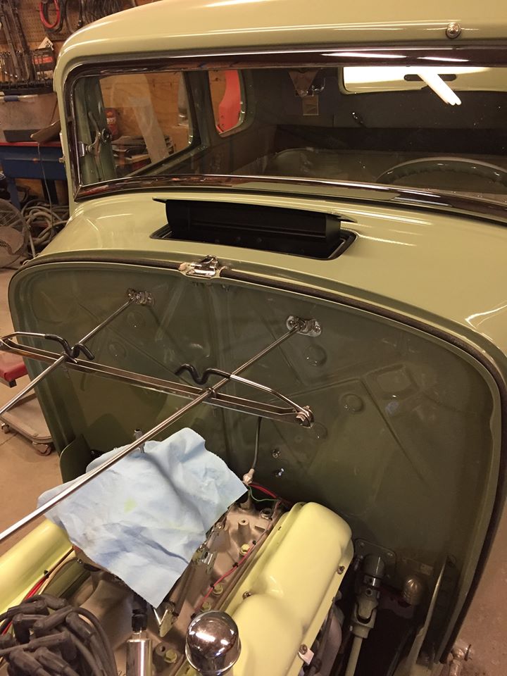

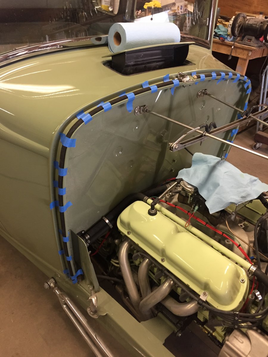

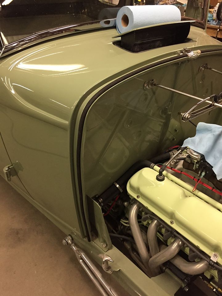

    Started on the cowl lacing. It’s all glued in place. Also got the fuzzies on the inside and outside of the door glass. Gives it a much more finished look.

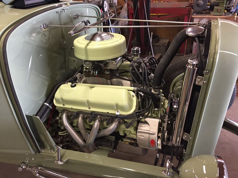

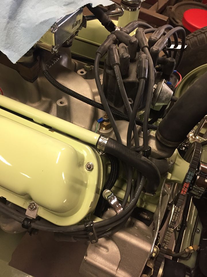

    Moved my temp sender from the left back corner of the intake to the more traditional right front corner to see if my temps would be more uniform there. Was always reading hotter than the temp gun said it was. Like 30° hotter.
    Jetted the carb down a couple more steps. It was still a bit rich.
    Waiting on a tranny seal to get rid of my leak at the tail shaft.
    SPark

  4. What kind of hood lace did you use? Couldn't get close enough in the photos for a good look. Thanks.
    Phil
  5. LM14
    Joined: Dec 18, 2009
    Posts: 1,936
    LM14
    from Iowa

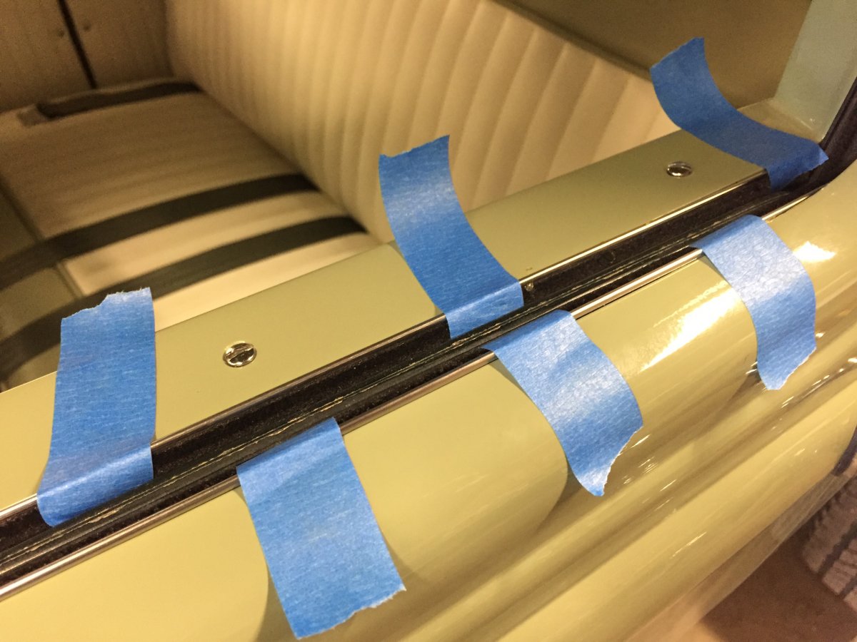

    https://www.yogisinc.com/rubber-sea...g-gaskets/b-16740-s-1932-ford-cowl-lacing-kit
    Ran it through my bead roller to flatten it out a bit. Put a flat roller on one side and the female part of the bead roller on the other side. Flattened it pretty nice on the hood side and still let the round side fit in the firewall bead.

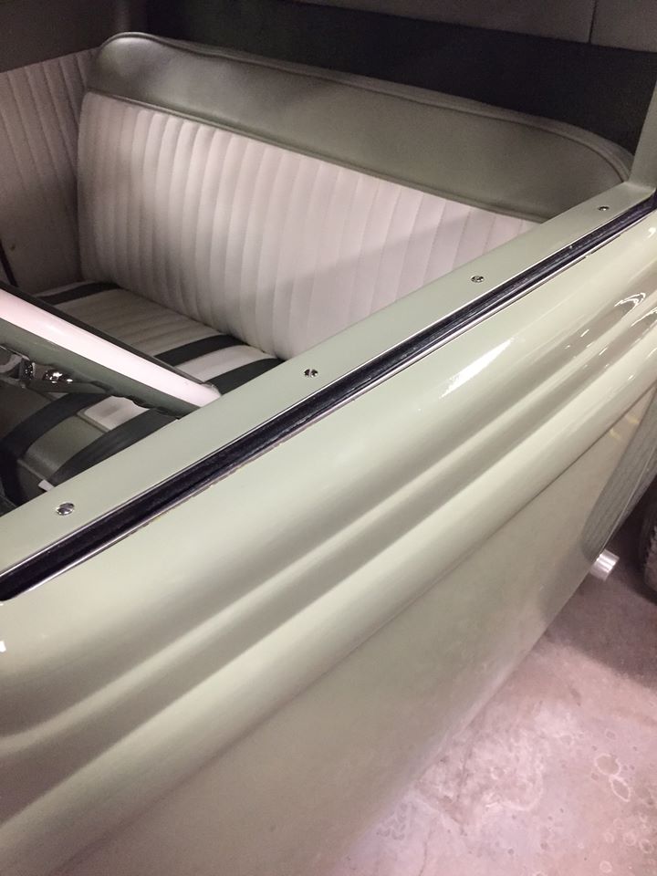

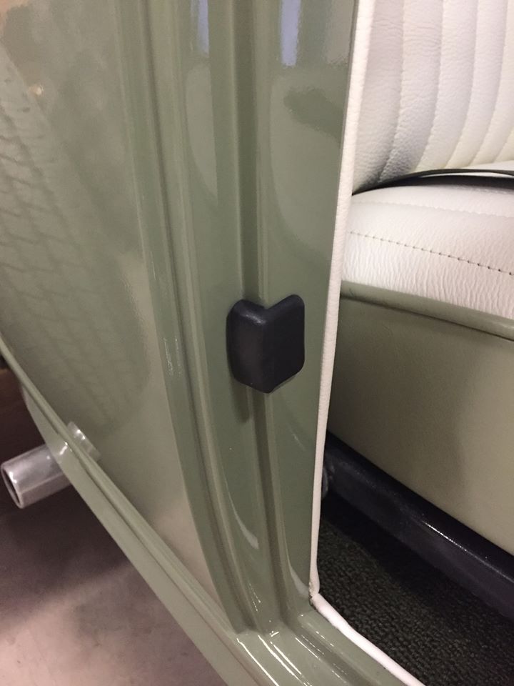

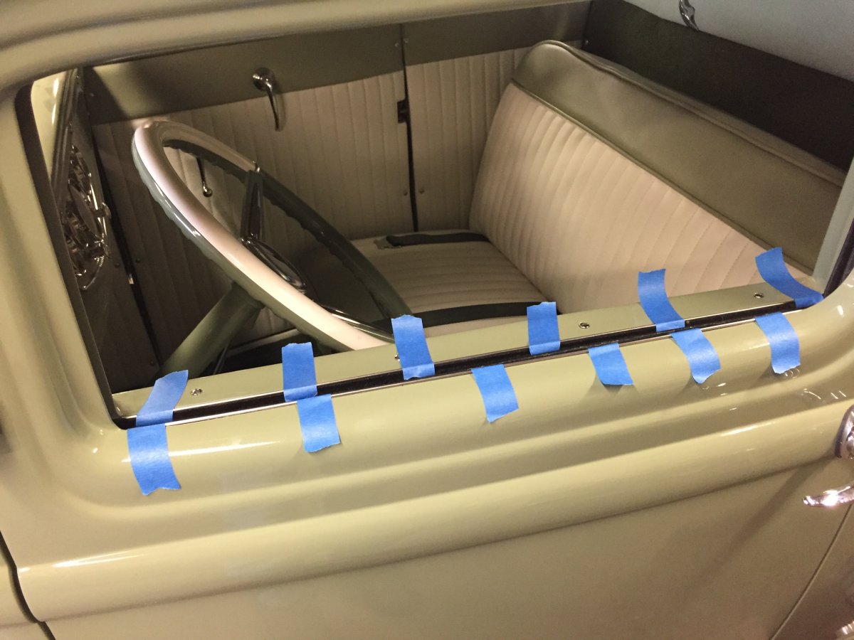

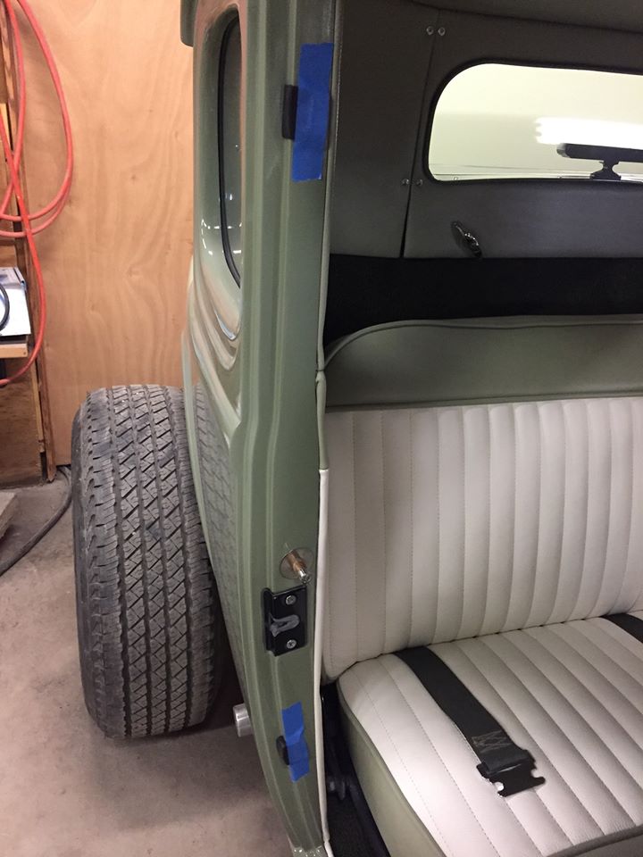

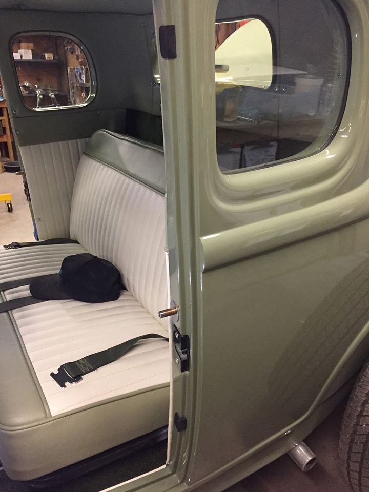

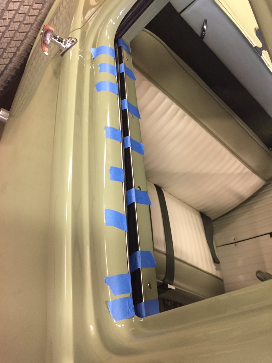

    Lots of little things got done today.

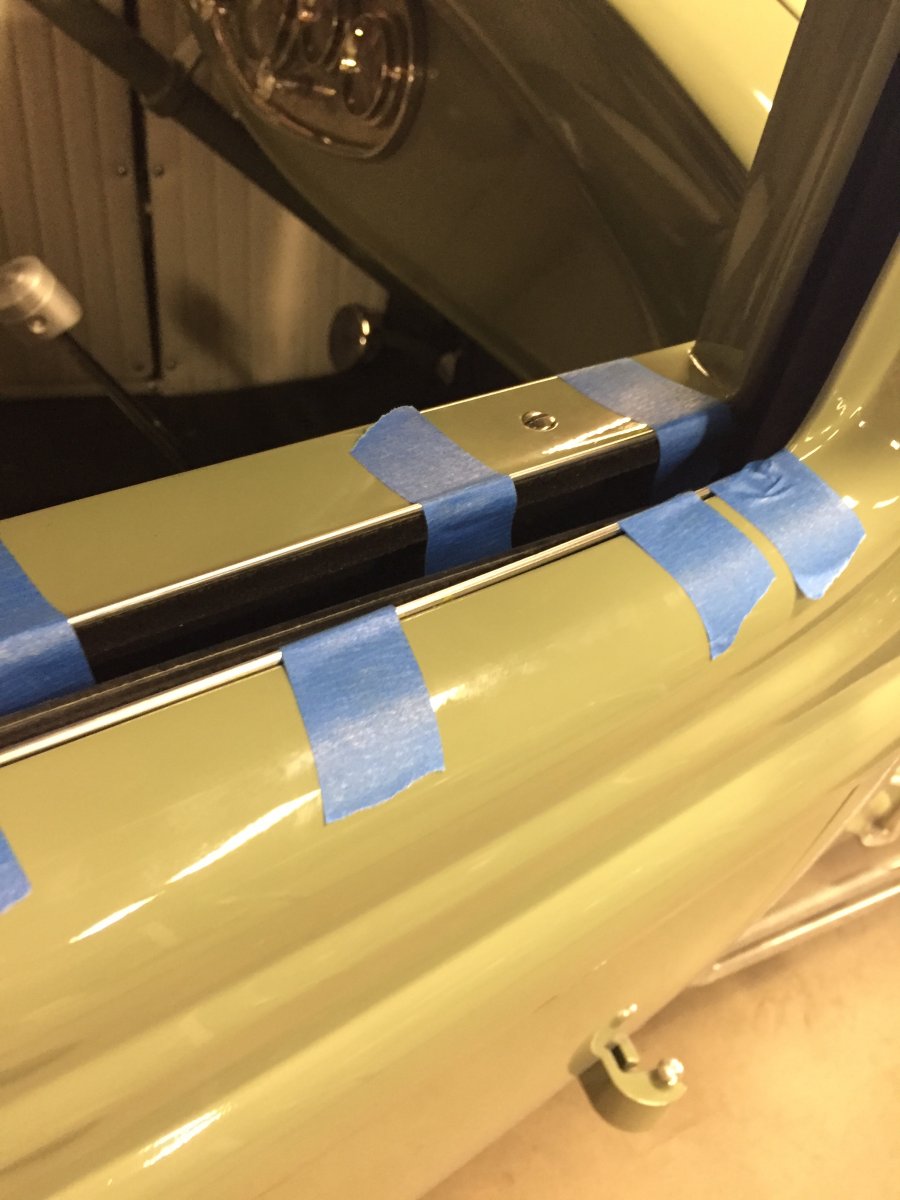

    Pulled all the tape off after letting it set last night and the new trim looks good. Cowl lacing dried nice and straight. Very happy with the way it looks.

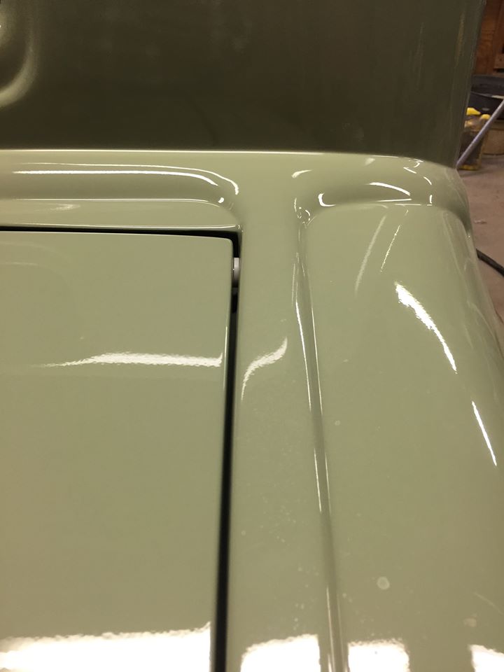

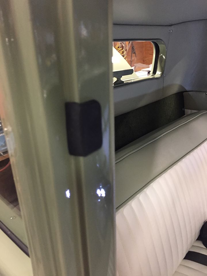

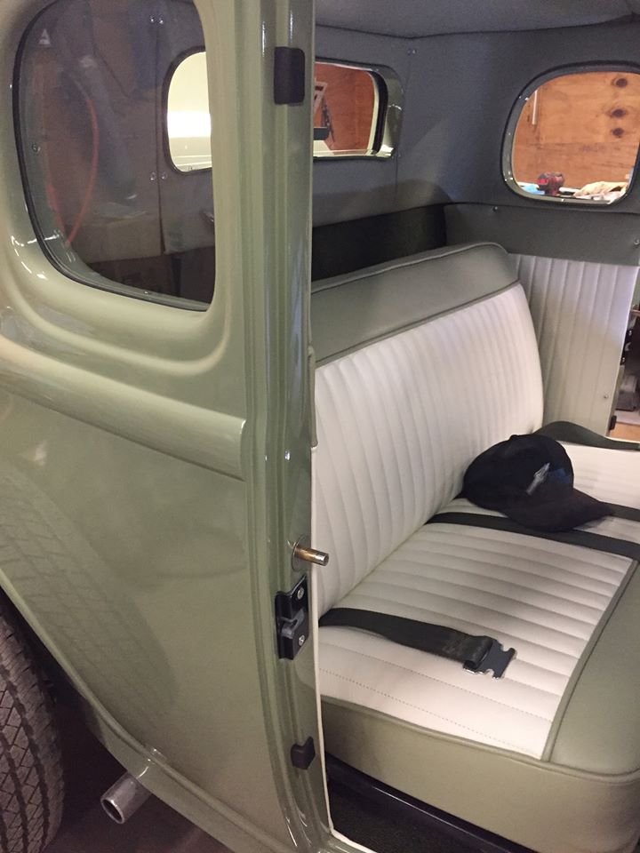

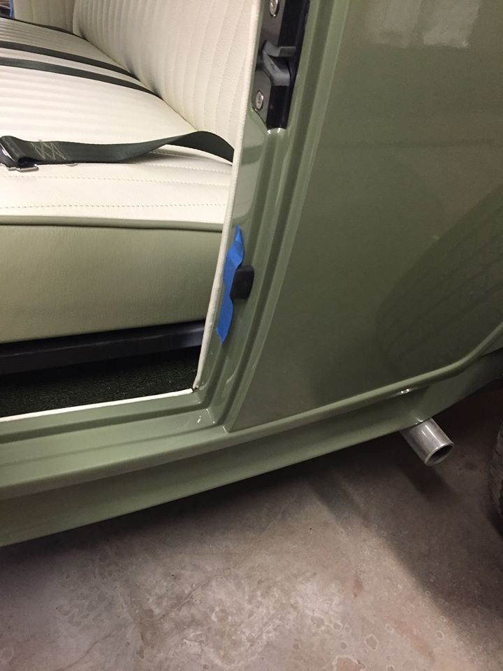

    Added the door bumpers today. Had to trim the faces of a couple after they dried to gain another 1/16” or so clearance on the upholstery as the door swung past the bumpers. Everything fits nice and tight still. Doors shut solid and tight.

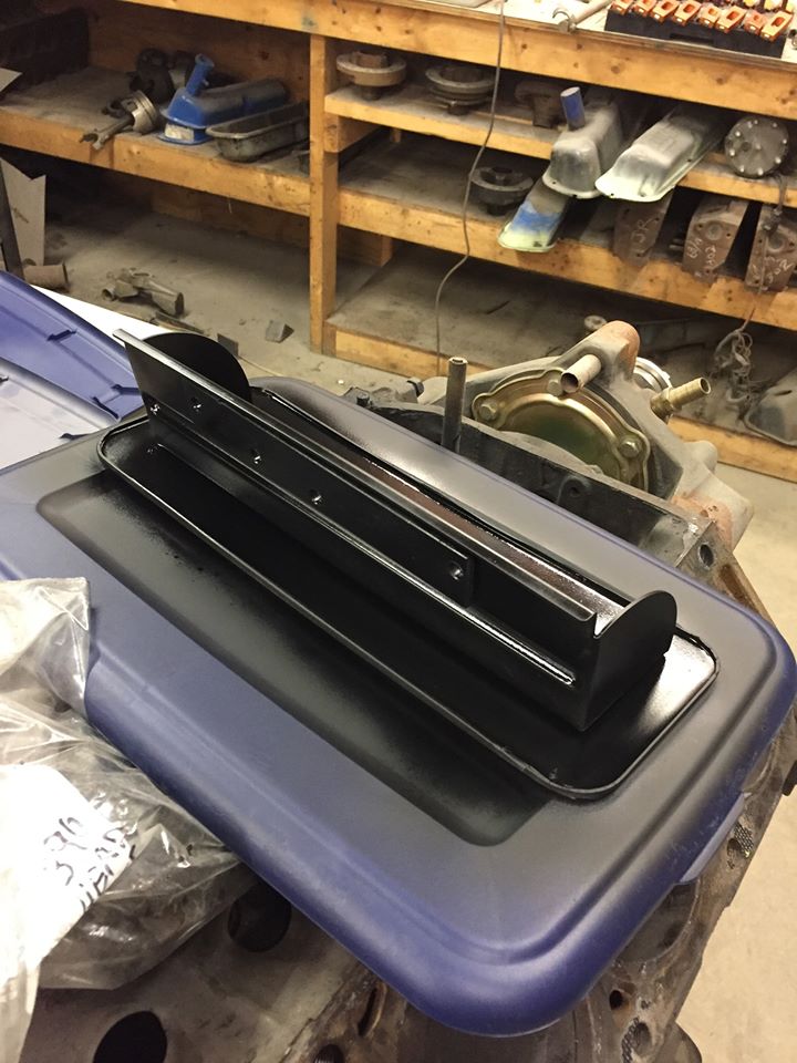

    Glued in the cowl vent gasket and painted the inside of the cowl vent.
    Painted a few bars in the trunk that show after upholstery was done.

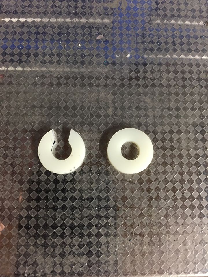

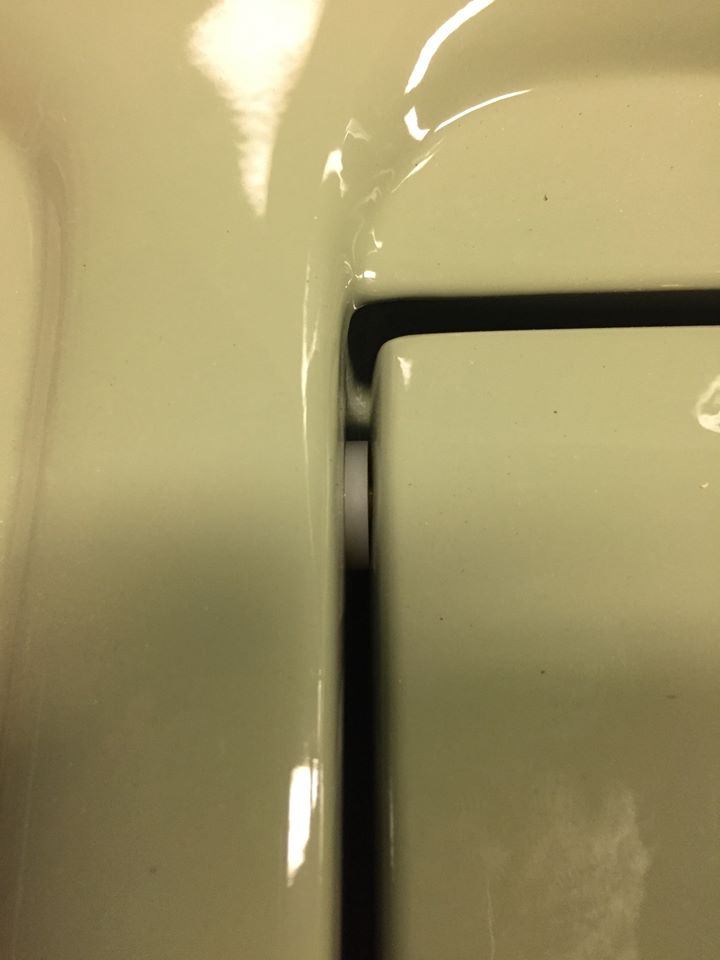

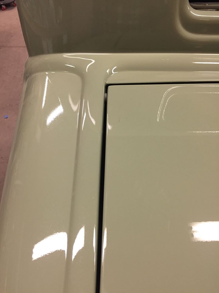

    Created a couple of nylon spacers to take up the side to side play out of the trunk lid. Worked well and keeps the trunk down to about 1/8” play side to side now. Won’t chip paint in the trunk that way.

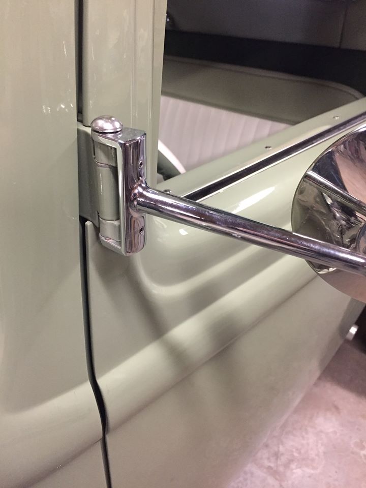

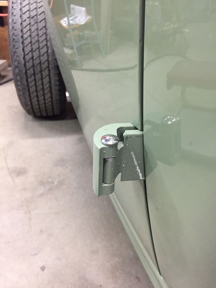

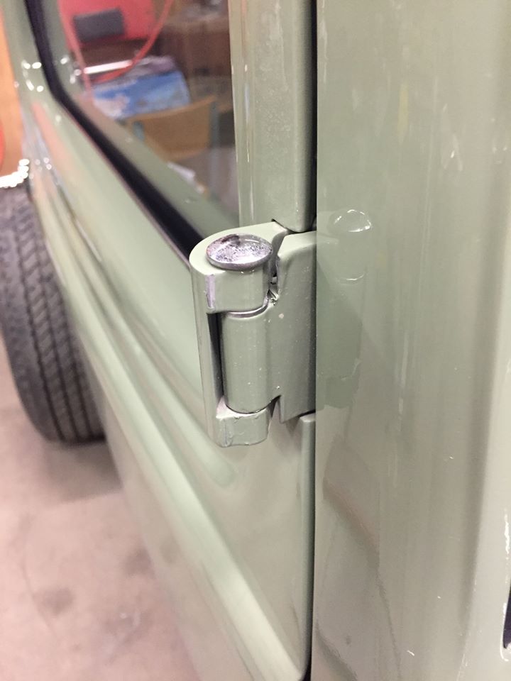

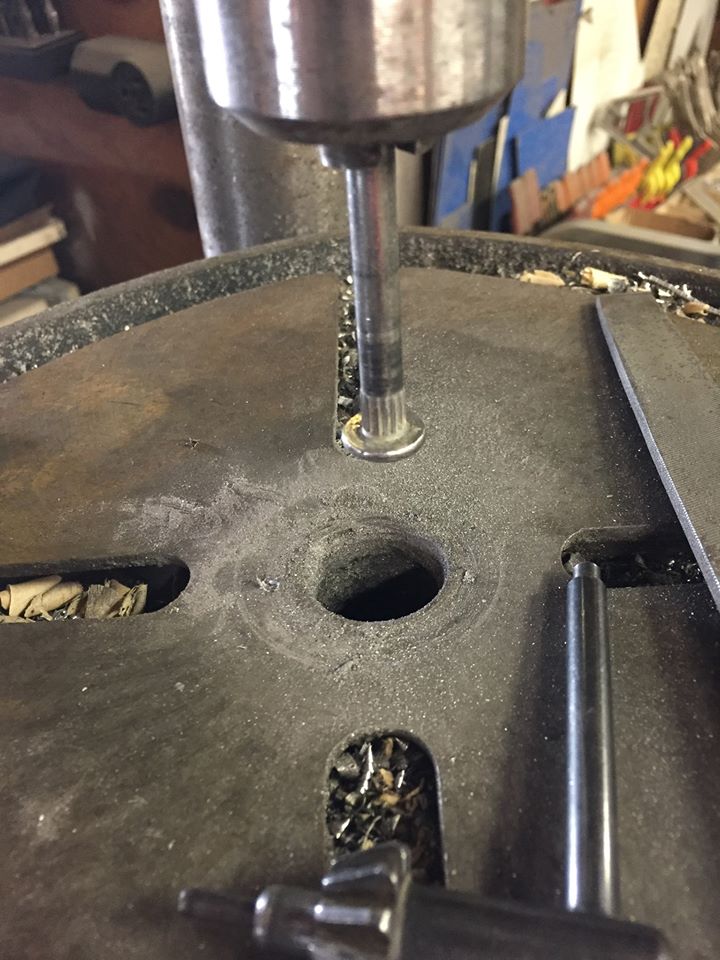

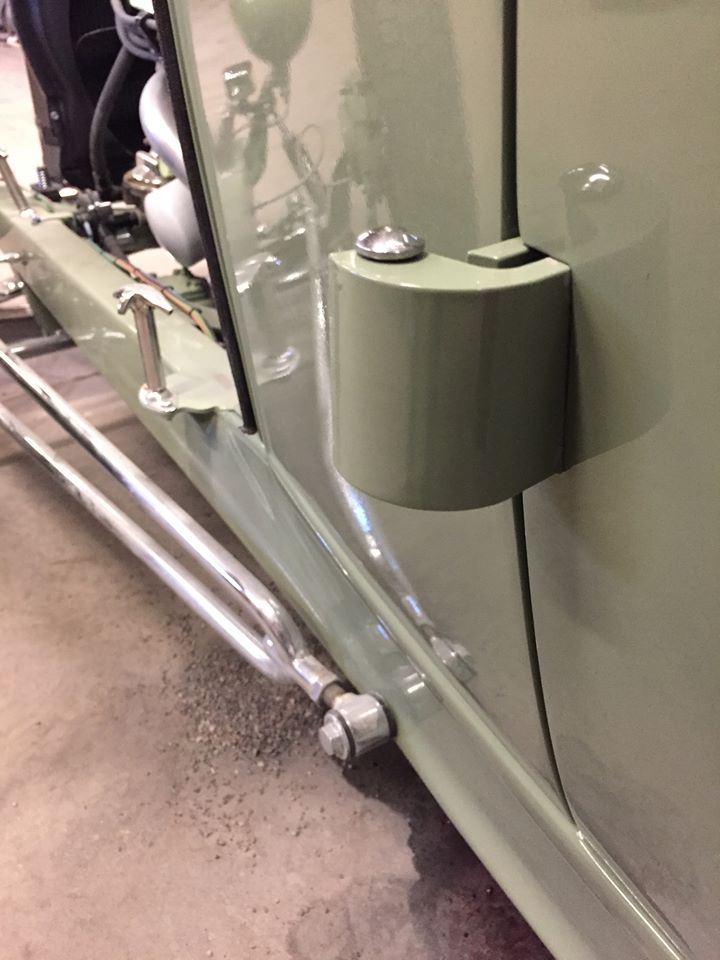

    What a pain in the butt! Spent today finishing the stainless steel door hinge pins. Cut them to the final length, bevel the end and reduce the depth of the serrations where they lock into the hinge. To reduce the serration diameter I chucked the pin in the drill press and filed them as they rotated. Then a test fit and back to remove more material. Go too far and the pin is junk. Didn’t ruin any of them. Glad that part is done and I didn’t ruin a pin or hinge. I think the problem is there is an odd number of serrations on the hinge so even using a caliper you get on a serration on one side and between 2 serrations on the opposite side. Never get to measure the total outside diameter of the serrated areas. It's done.
    Reinstalled the cowl vent.
    Bundled and tied up the last of the wiring under the dash. All that is left for wiring is putting the Painless protective sheathing over it.

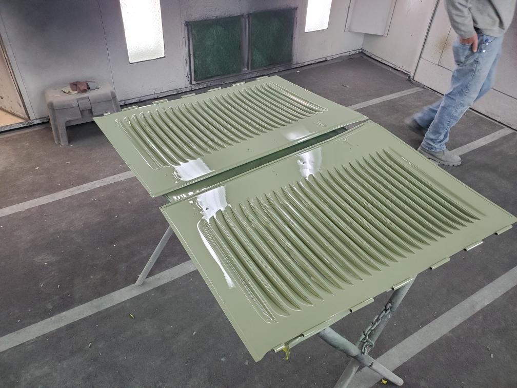

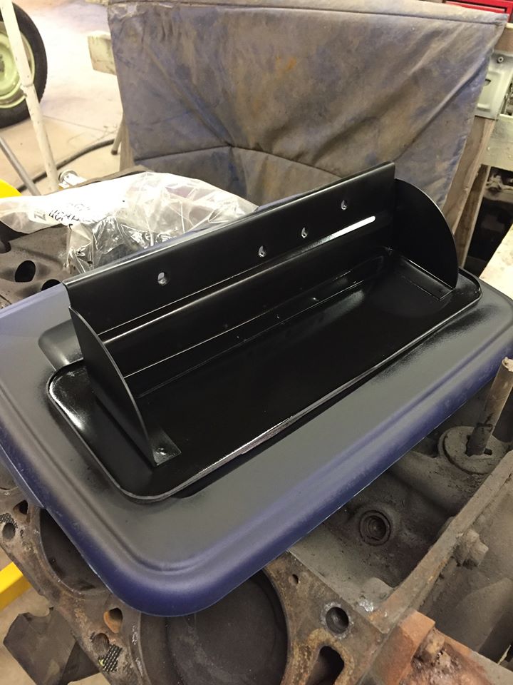

    Just got these from the painter. Needs to flip the side panels to paint them and it will be done! Now the day for getting them back depends on if I get my scheduled infusion Thursday or not.

  14. Hey Spark,
    How important are these bumpers? I've purchased them but not added them yet. Let me know how they are working out. tapatalk_1586731960300.jpeg tapatalk_1586731951604.jpeg

  16. LM14
    Posts: 1,936
    LM14
    from Iowa
    I think they are really important. Without them, just hauling the car a couple hundred miles on the trailer (body shop to home 35 miles, home to upholstery 75 miles, then back home another 75 miles) it put some pretty good scuffs in the door jambs and doors where the door had very slight movement. These bumpers seem to stop every bit of that. It was worth the time sanding, shaving and gluing them to get a good fit. Doors shut very solid sounding and don't move at all once closed. Time will tell but up front it looks like they are needed.

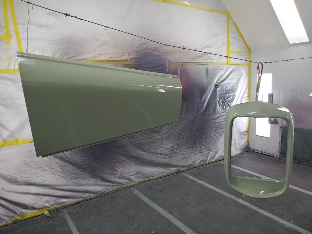

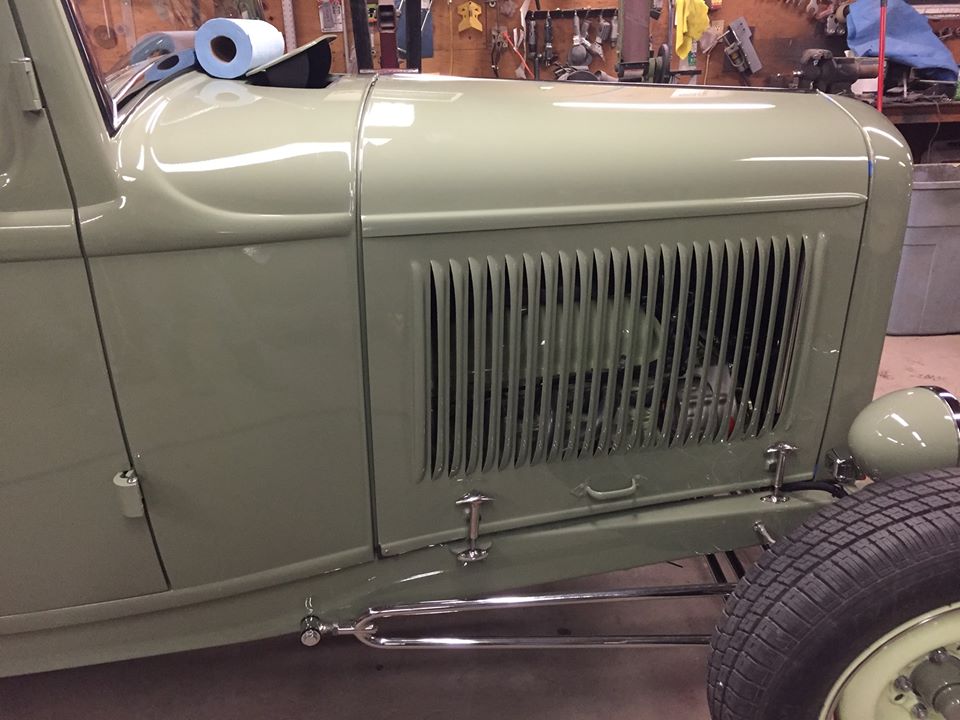

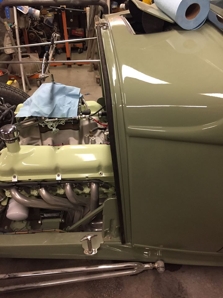

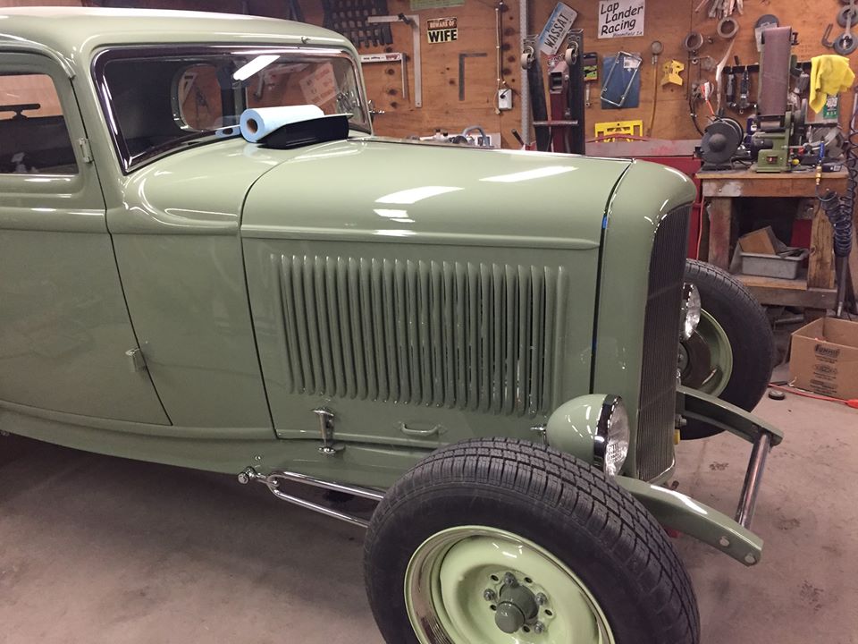

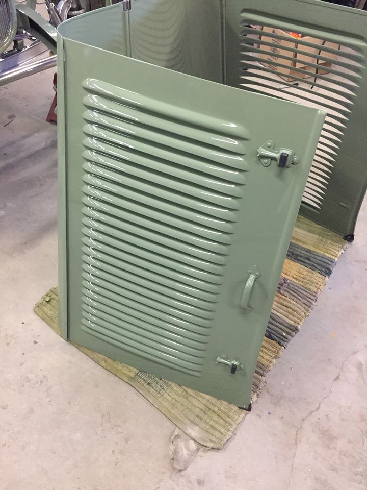

    Got the hood and grille shell back home this morning. Paint is done and paid for! Also got the insert back in the grille shell and got it back on the car loosely. Will finalize location after the hood is on.
    Next up is the hood. Put all the rubbers back on hood so it's ready to install. Takes at least 2 people and preferably 3 to put it on. Like wrestling with an octopus. With paint it will be even worse, more worries. Hard finding help with our current health concern situations going on.
    Got most of the wiring covered and tied down. Ran out of loom with 1 section left.
    Getting close to done!!!

    The last major piece went on tonight. Dianne learned how to put a hood on a ‘32 Ford. She did great. She's a little concerned that the only thing holding it in place is a couple little slip on brackets and a few screws but I convinced her it's worked for the last 88 years, so....
    All that’s left is fix the leaks on the transmission and a little fine tuning on the engine.
    It’s been a great project, lots of learning along the way.
