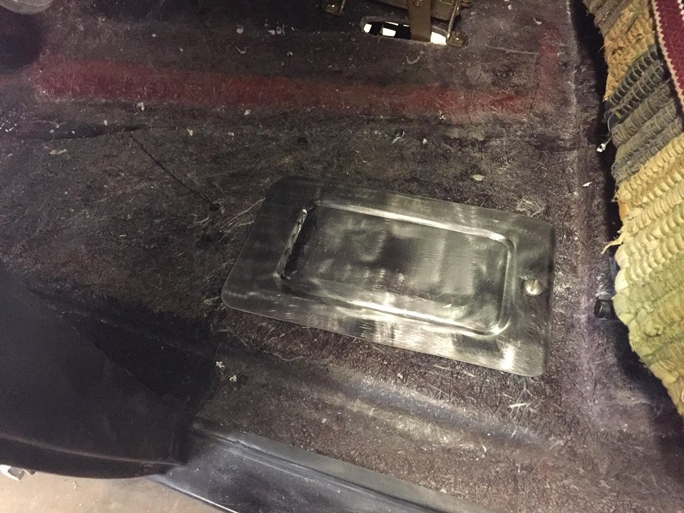

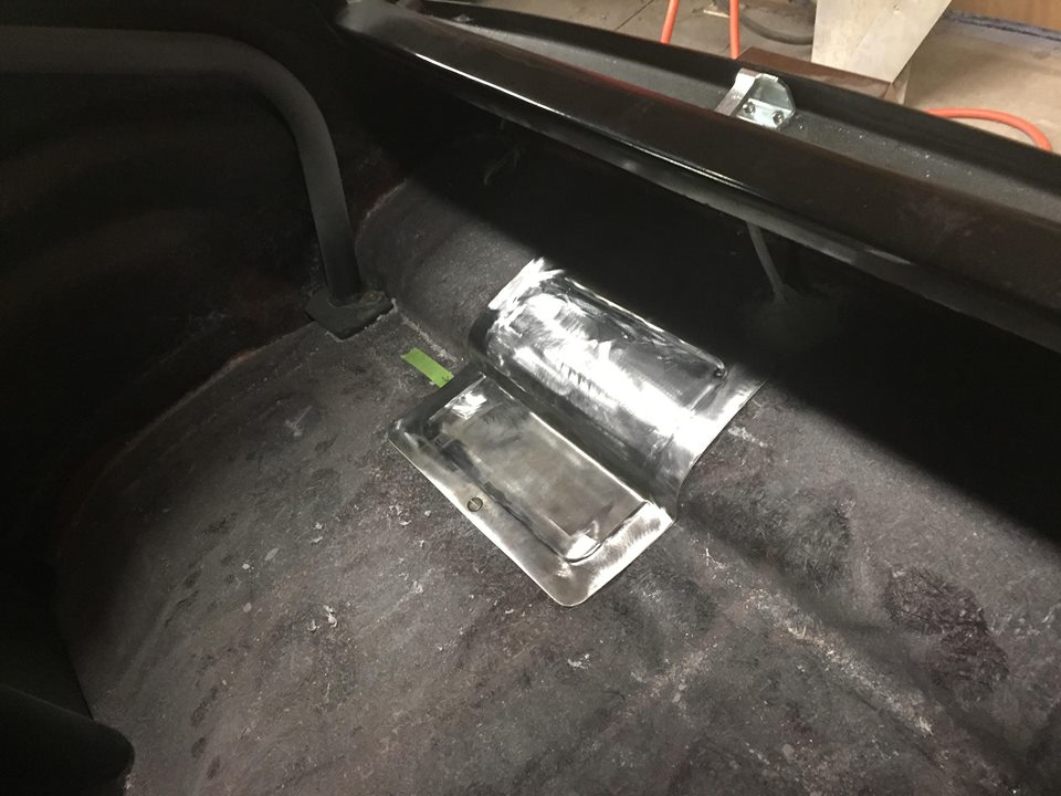

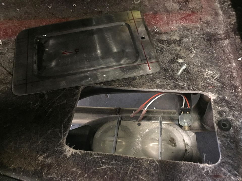

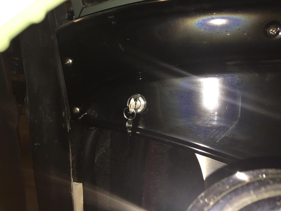

    Got the gas tank access hole cut in the trunk (need to do a lot of cleanup on it still) and the hole for the master cylinder access. Made a panel for each from steel. Trapped one end and lock it in place with a single machine screw. Trying to keep it simple and clean.

  2. kursplat
    Joined: Apr 22, 2013
    Posts: 295
    kursplat

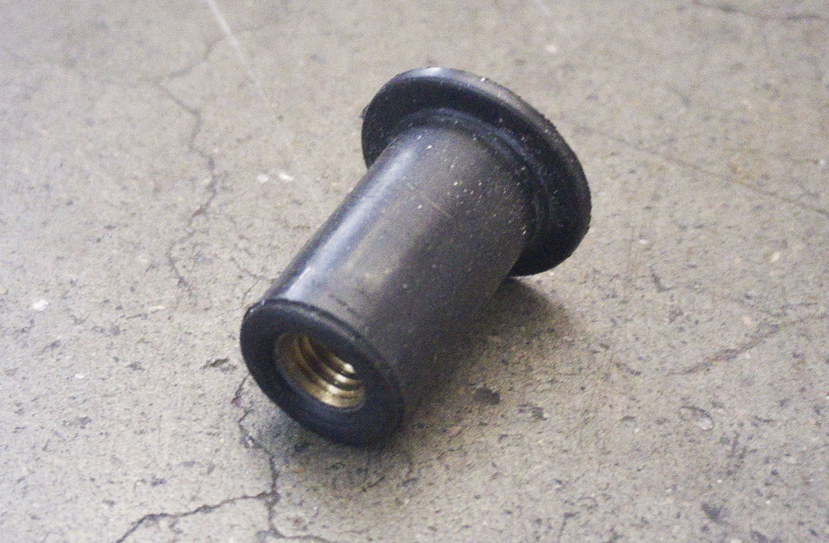

    nice work. did you epoxy a nut on the backside of the glass?
  3. LM14
    Joined: Dec 18, 2009
    Posts: 1,936
    LM14
    from Iowa
    For now I have expanding rubber 1/4" threaded plug on each bolt. Worth a try.

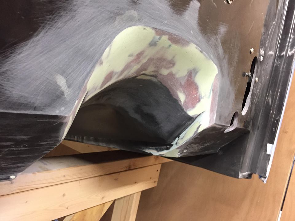

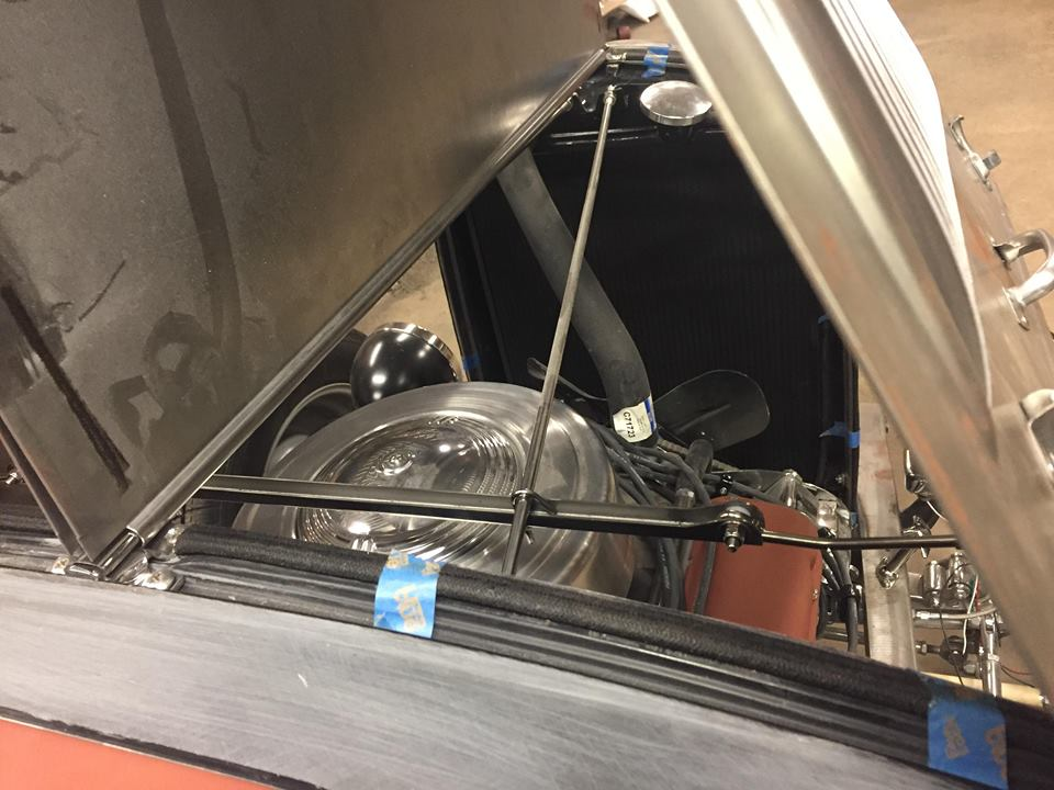

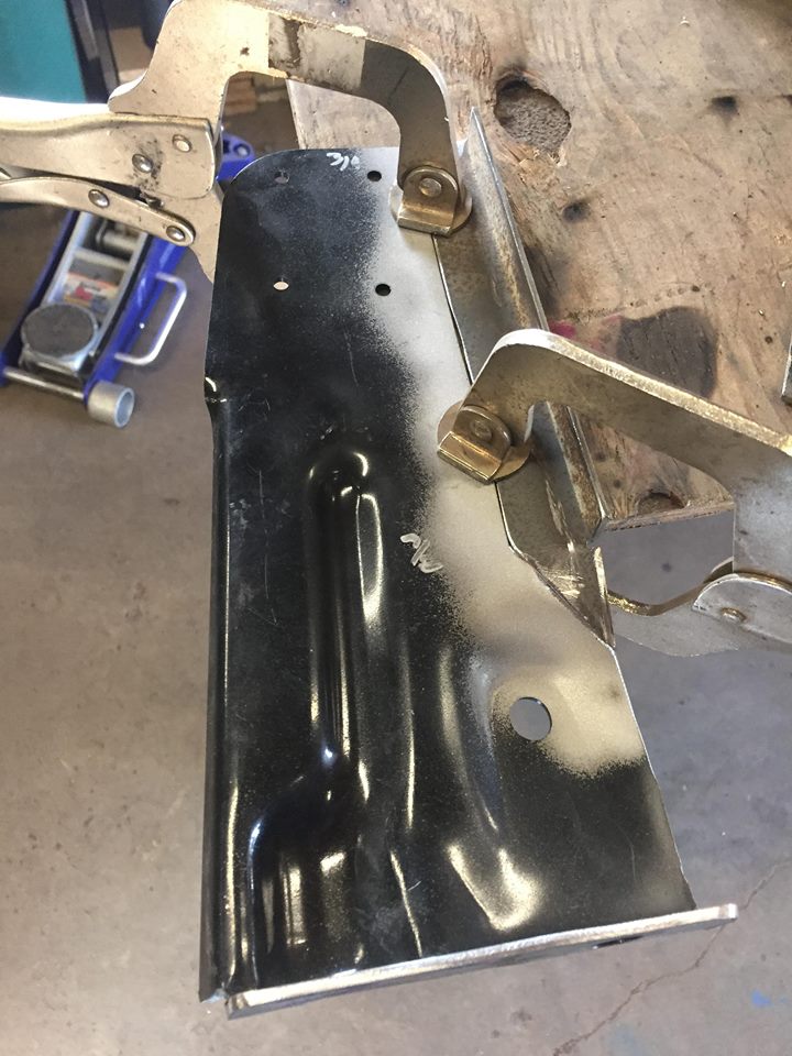

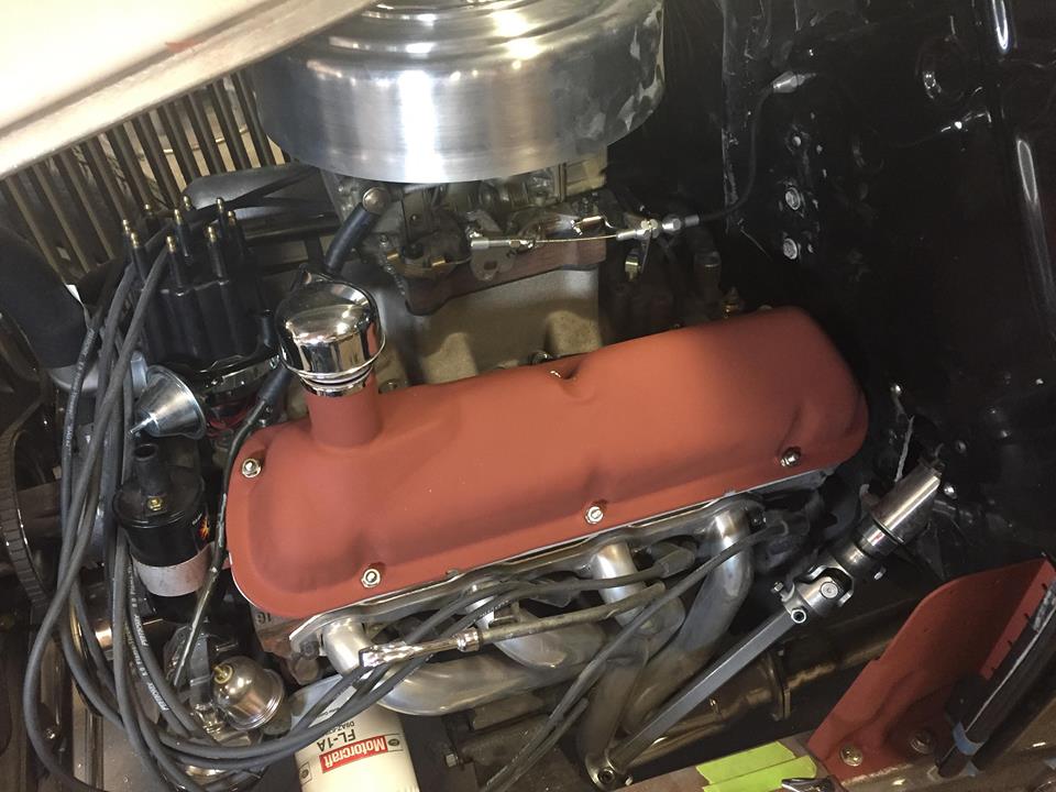

    Spent most of last night and part of today working on hood alignment. Since I had the new cowl/radiator lacing I could start to get more serious about it. Ran the lacing thru my bead roller with a female 3/8" roller on the bottom and a flat roller on top to flatten the too fat stuff they supply. Seemed to work out well doing that. Still need to go a bit further with it but it's getting close. Shimmed under the radiator mounts a bit and things worked out. Got a good line at the firewall bead all the way around, still need to do some work on the grille shell end.
    That allowed me to at least figure out where my hood latch brackets had to be. Got them created and tacked in place. Looks like that will work out fine.

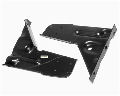

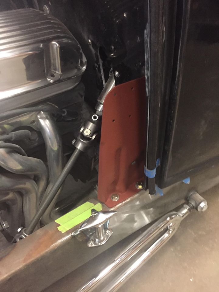

    Modified the firewall support braces/feet. Cut them off at the bend where they hit the firewall (mine sets about 1" behind the stock location apparently), added some material and a new attachment flange. Don't have a TIG but I have a MIG and some really good grinders! Making progress!

    Firewall feet finished.

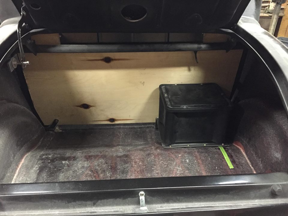

    Interior/trunk divider in.
    Battery location decided and created.

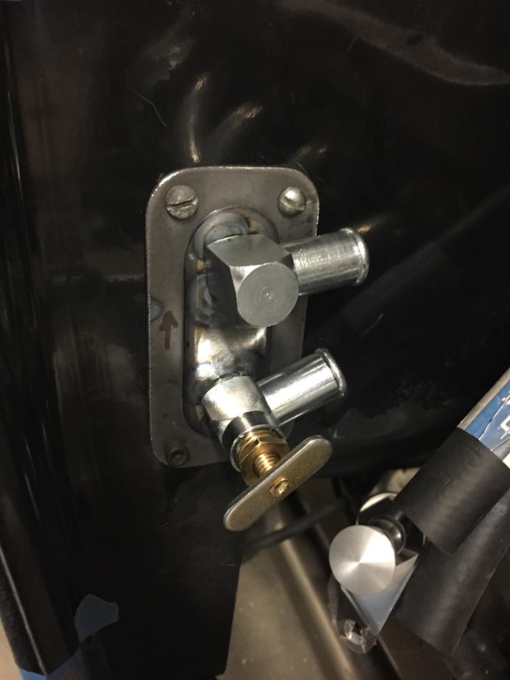

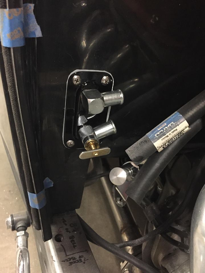

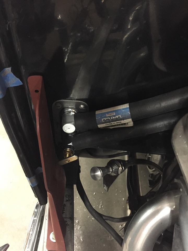

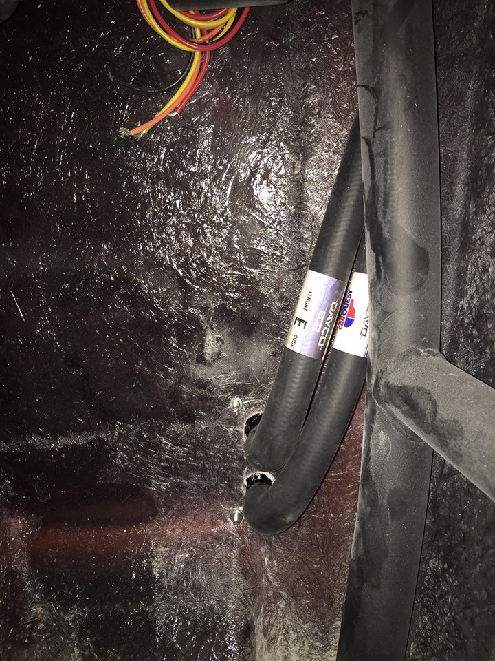

    Heater hoses set up complete with shutoff.
    MC access panel and gas tank access panels done.

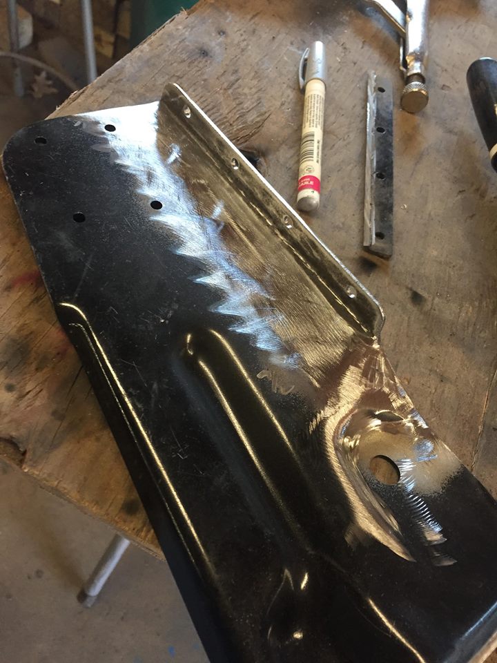

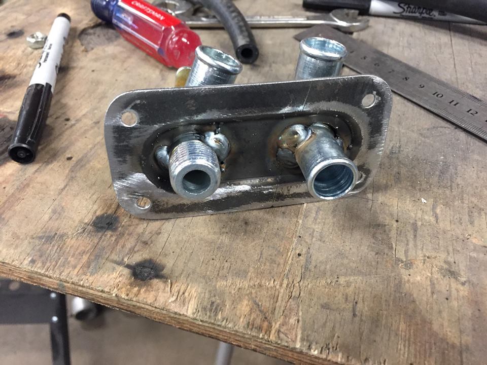

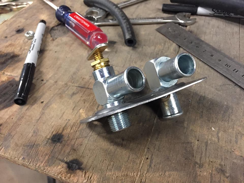

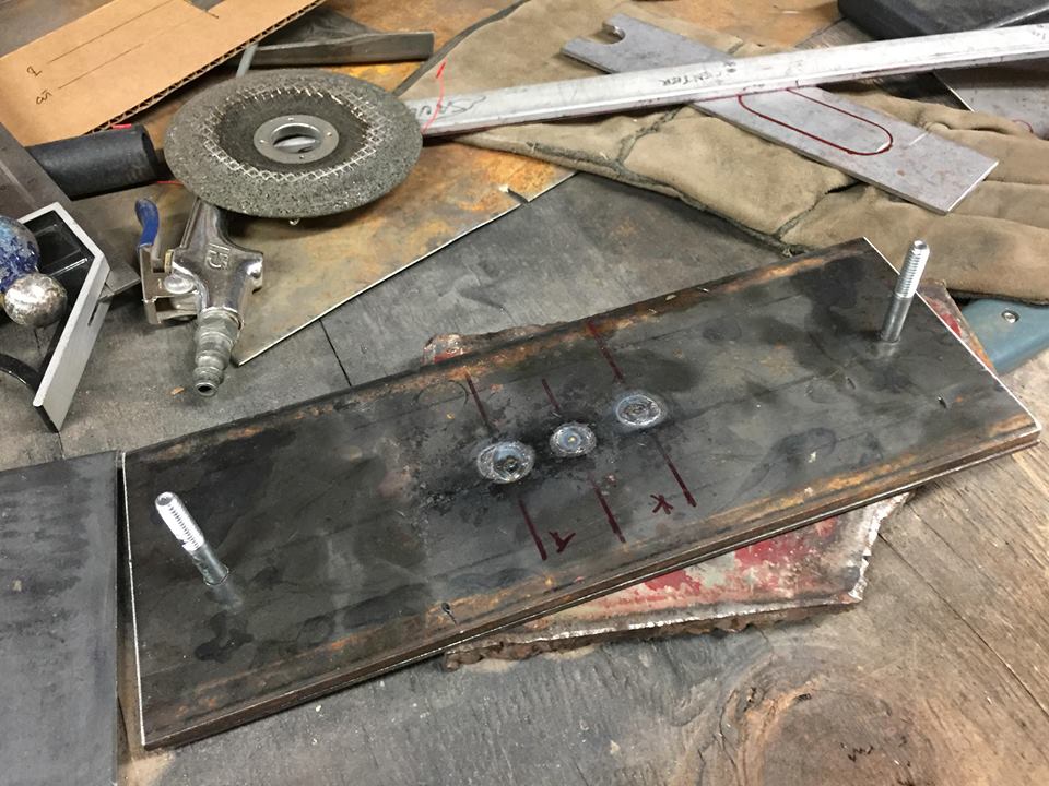

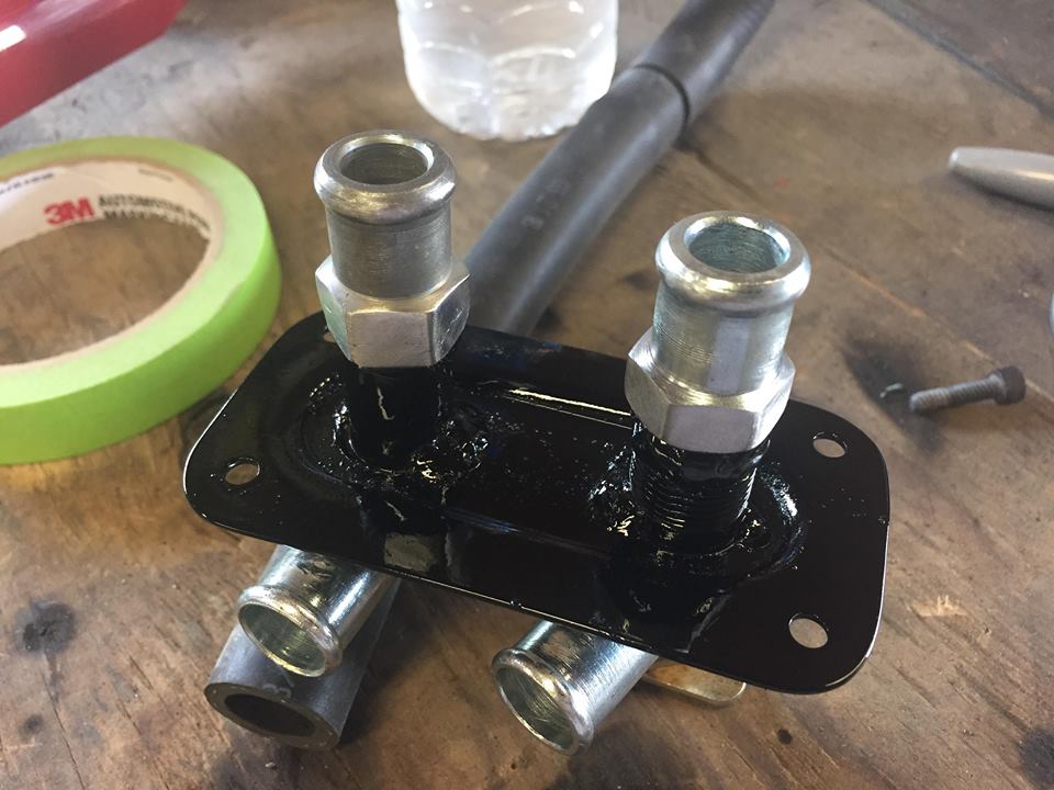

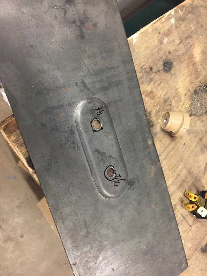

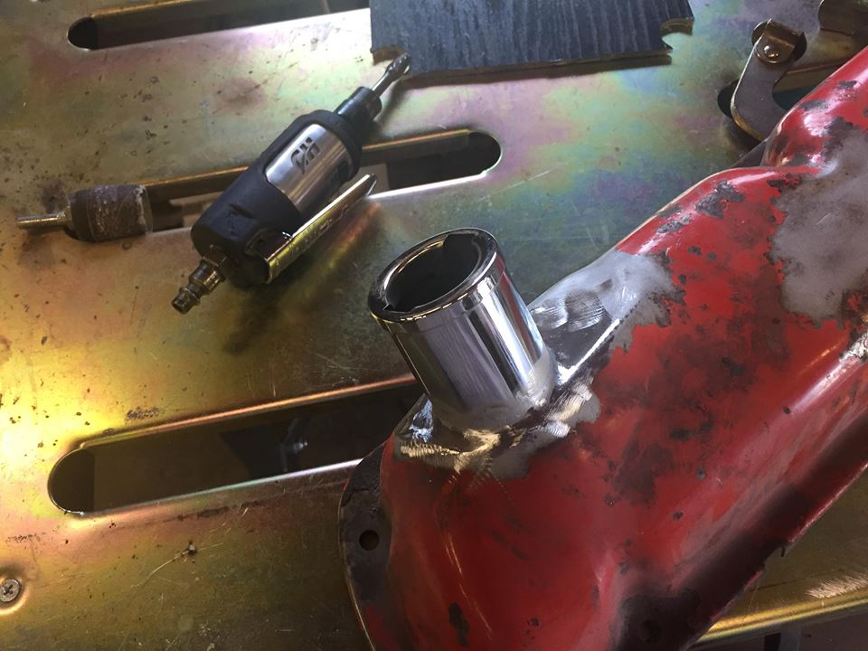

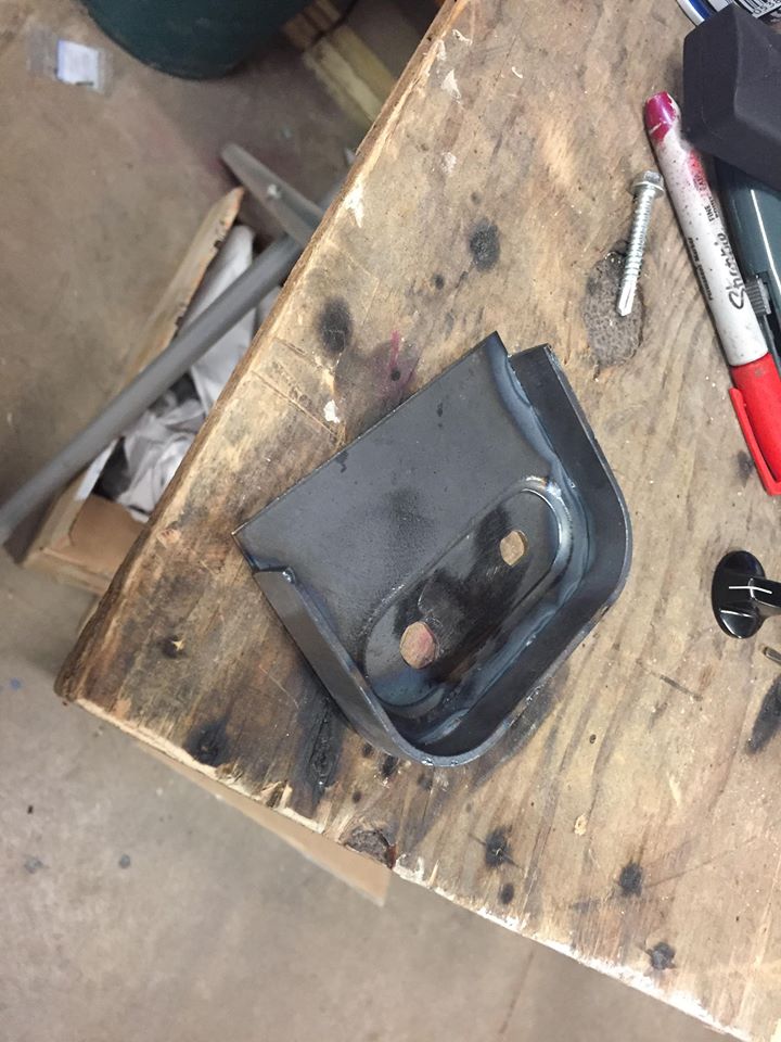

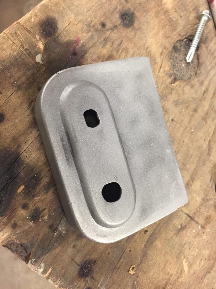

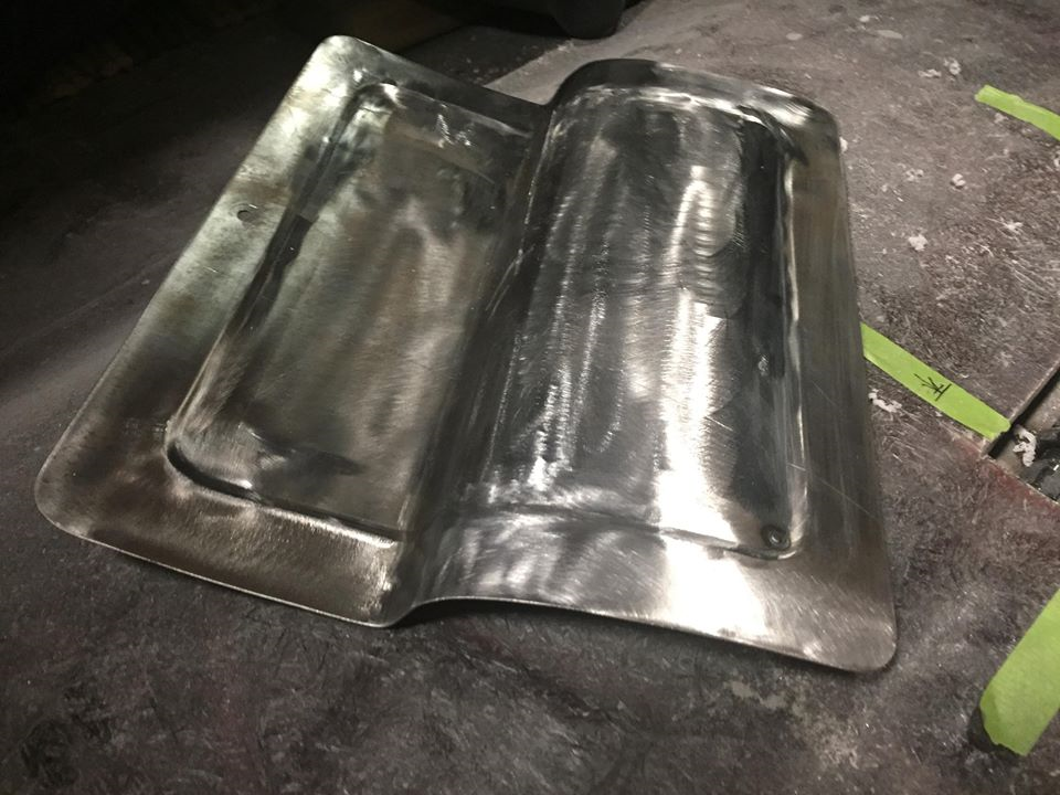

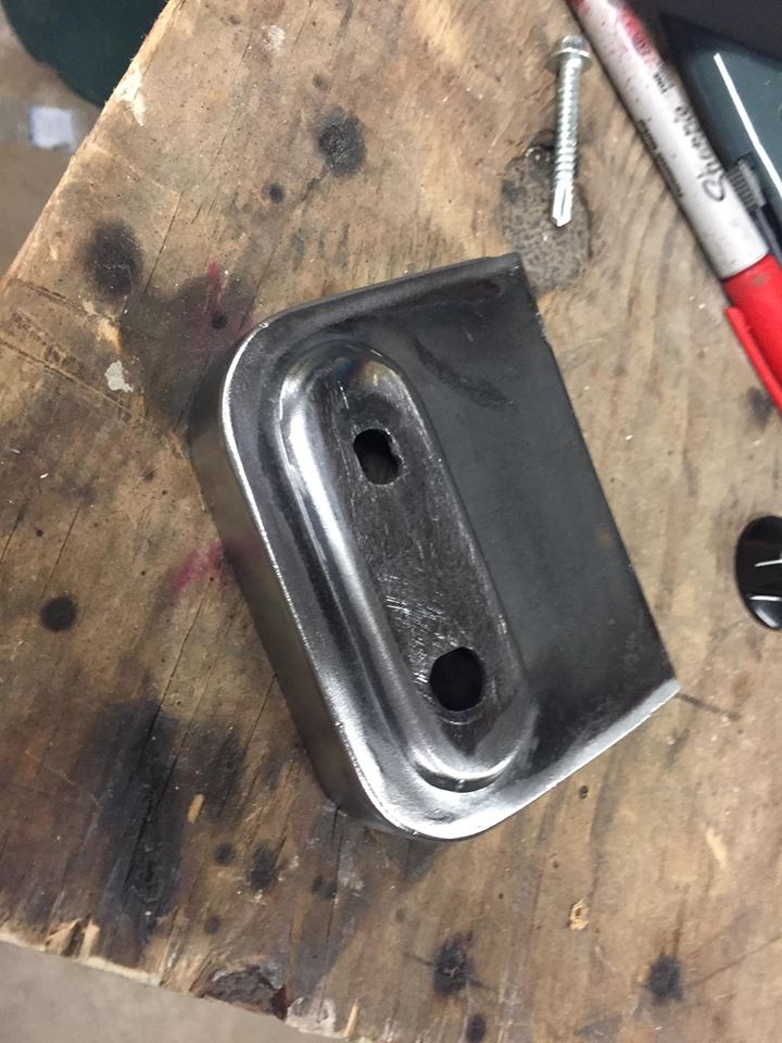

    Created a 2 piece die to press a raised section in a 2x4 plate to anchor the heater feed and return lines to the firewall. Pretty happy with my first press job. Took me most of the day but it turned out great. Oriented the shutoff and return bung, transferred it to the backside of the plate and tacked things together (valve was all apart so it didn't kill it). Got everything right on the first try! That never happens. I even pressed a 2nd plate just so I could mess the first one up. Going to weld more hose barb on the backside to add some length and have an attachment point on the interior. Well hidden behind the firewall foot brace yet easy to get to when it's needed.
    Doc keeps reducing my meds every 7 to 10 days. That's good. If we stay on this route I can have another cancer treatment on the 8th of August and that will be the half way for the powerful stuff. I can sure tell the steroids are no longer the massive dose and my thyroid is about gone....zero energy. This little plate and getting things tacked together and mounted took about 5 hours today. Time flys when you're sitting in front of the fan!

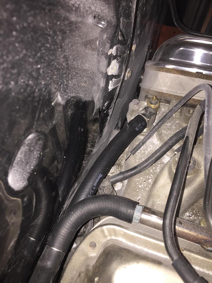

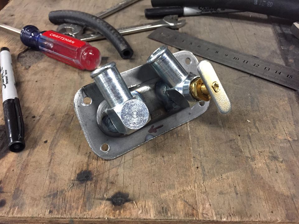

    Finished up the heater. Got it mounted and houses all routed.

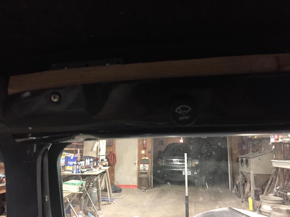

    Figured out the wipers and ordered a Mighty Wiper Motor. Don't think the wooden one I used to play with locations will pass state inspection.

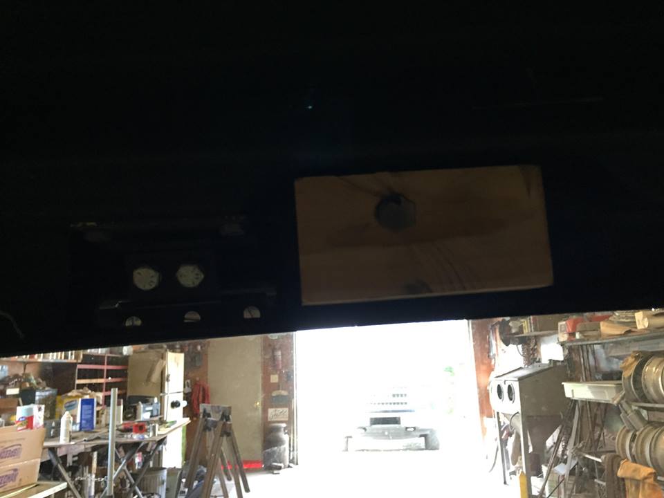

    Drilled the gauge panel for turn signal and hi beam indicator lights. Left is hi beam (blue), then Rt/Lt turn signal (green) and far right is emergency brake on (red, not in the hole yet).

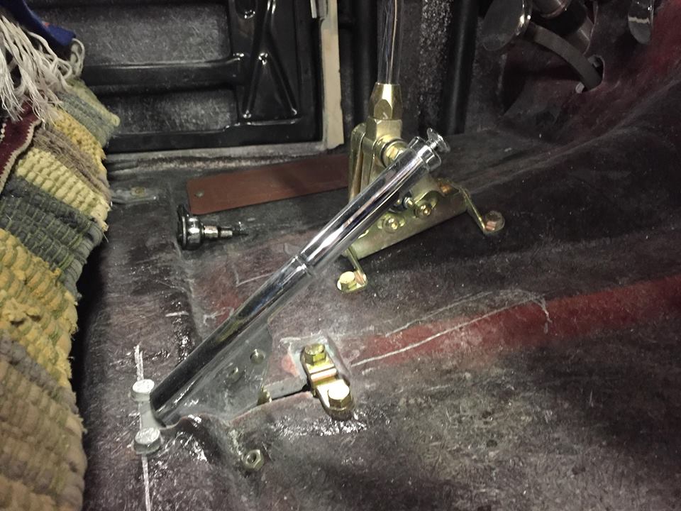

    Got the emergency brake mounted.

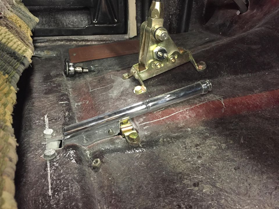

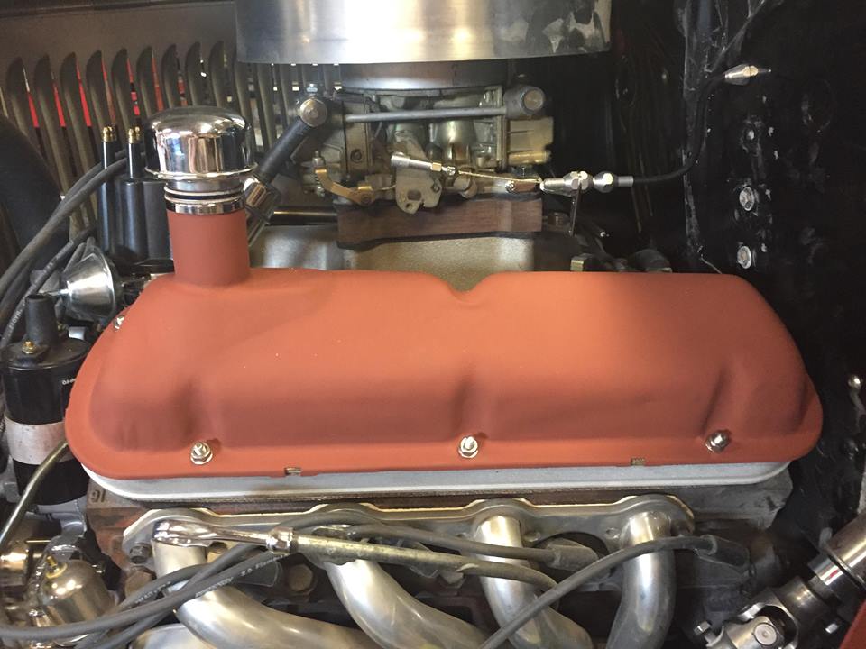

    Also welded the stand to the old valve covers. I'm a fair welder but a great grinder! Pretty happy with the way it turned out.
    Couple more little things to do, make sure the wiper is going to mount like I want it and I'll be ready to rip it all apart. Plan right now it to get all the metal in epoxy primer then put it together and try to get thru state inspection and get it titled. Then put some miles on it yet this fall. Blow it back apart over the winter and get it painted.

    heater23.jpg heater26.jpg heater27.jpg heater30.jpg heater28.jpg wipe1.jpg wipe2.jpg gauges11.jpg gauges13.jpg ebrake1.jpg ebrake2.jpg ebrake3.jpg ebrake4.jpg vc3.jpg vc4.jpg vc6.jpg vc7.jpg vc10.jpg vc8.jpg

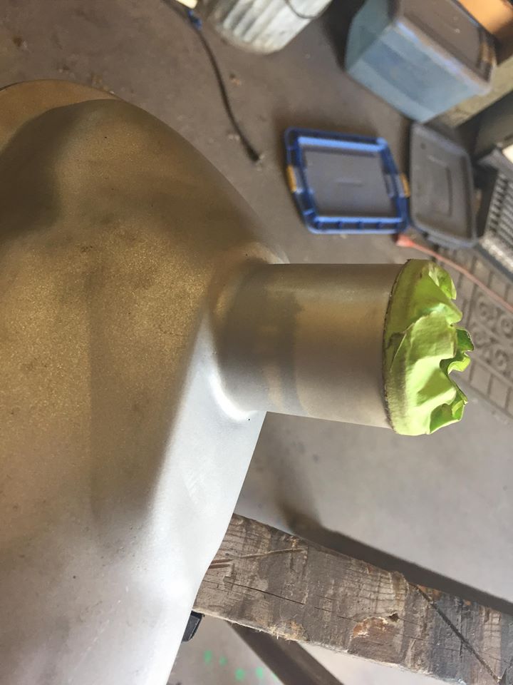

    Also ordered a tube style gas gauge sender instead of using the arm style in the shallow tank. Might work better, we'll see. Lots less crap to deal with.

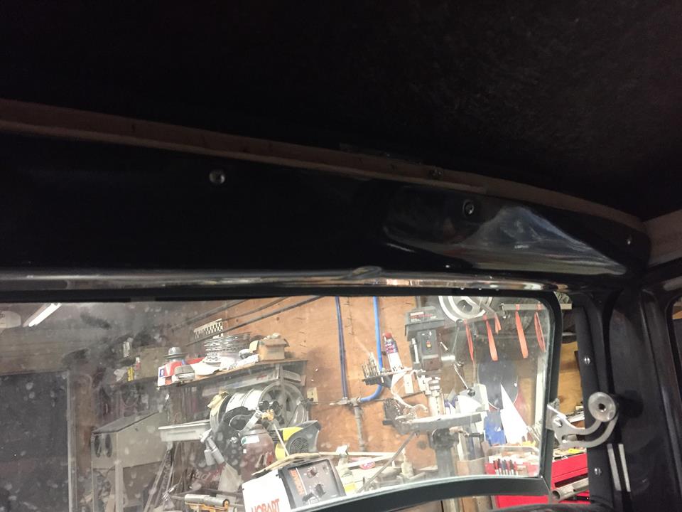

    Been working on creating a header panel mounting system. Car came with a header cover and it looks like it will clear the wiper setup just fine so forward we go! Part of the mounting blocks glued in place tonight (ran out of clamps, I'm no woodworker either!), should finish that deal up tomorrow.

    Header panel is in. Good mounting system and tack strip. Haven't bonded anything until I play with the actual wiper motor but it should clear fine. Once I confirm that I need to bond a couple pieces in place. Formed a 1" angle steel bar to align the lower edge with the windshield bulkhead. Everything lines up really nice. Hope the wiper fits!

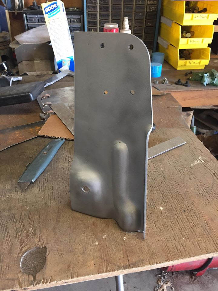

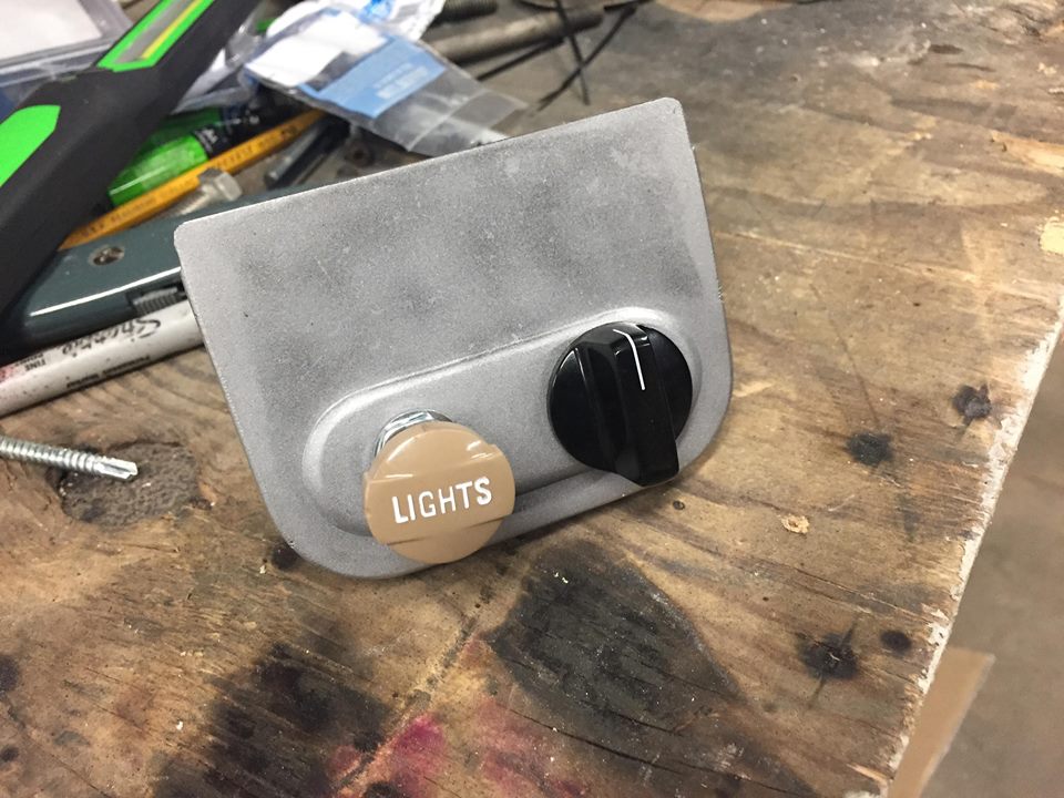

    Made this little panel out of my other plate I pressed a few nights ago. Had a basically new bar stock bender/former tool I had not played with much. Spent some time marking my first bend and paying attention to the radius it created with the die that best fit what I wanted to do. Was able to duplicate it a second time and even get it in the correct place! This crap NEVER happens to me. First piece I made from a little 9" scrap of 1/2x1/8 bar stock was perfect. Welded to the edge of the pressed plate and I have a switch panel to mount to the center of the dash that controls lights and heater. Looking for knobs that I can use for both that are more pleasing.

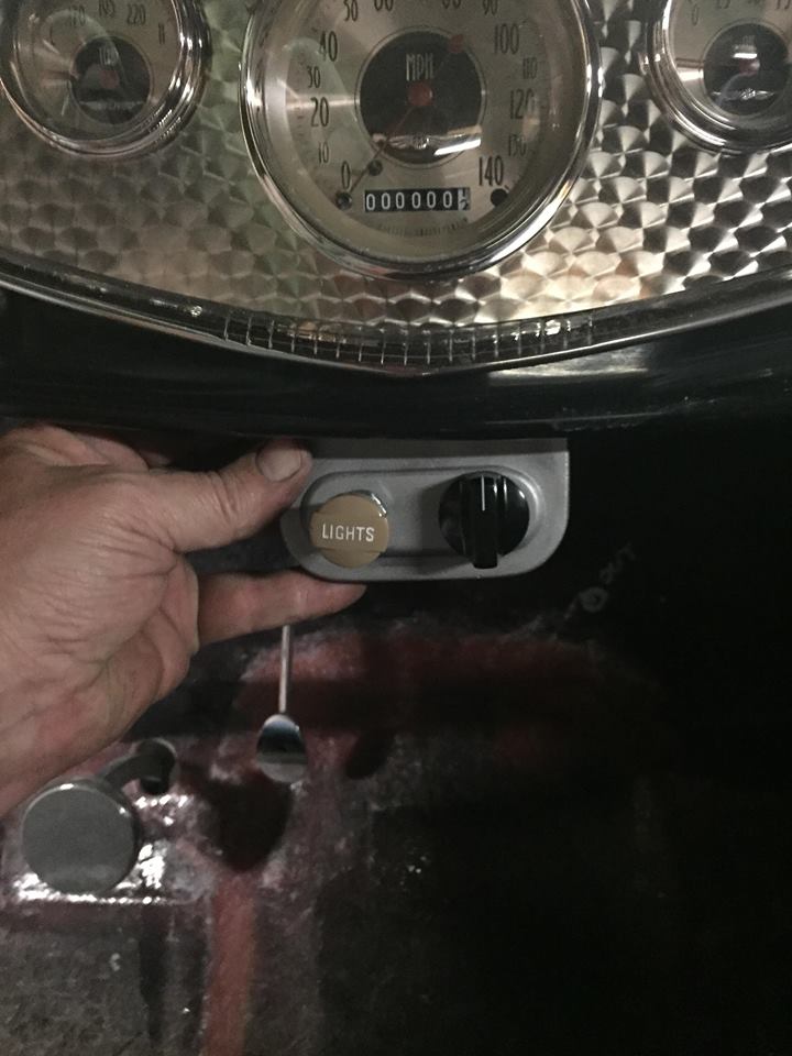

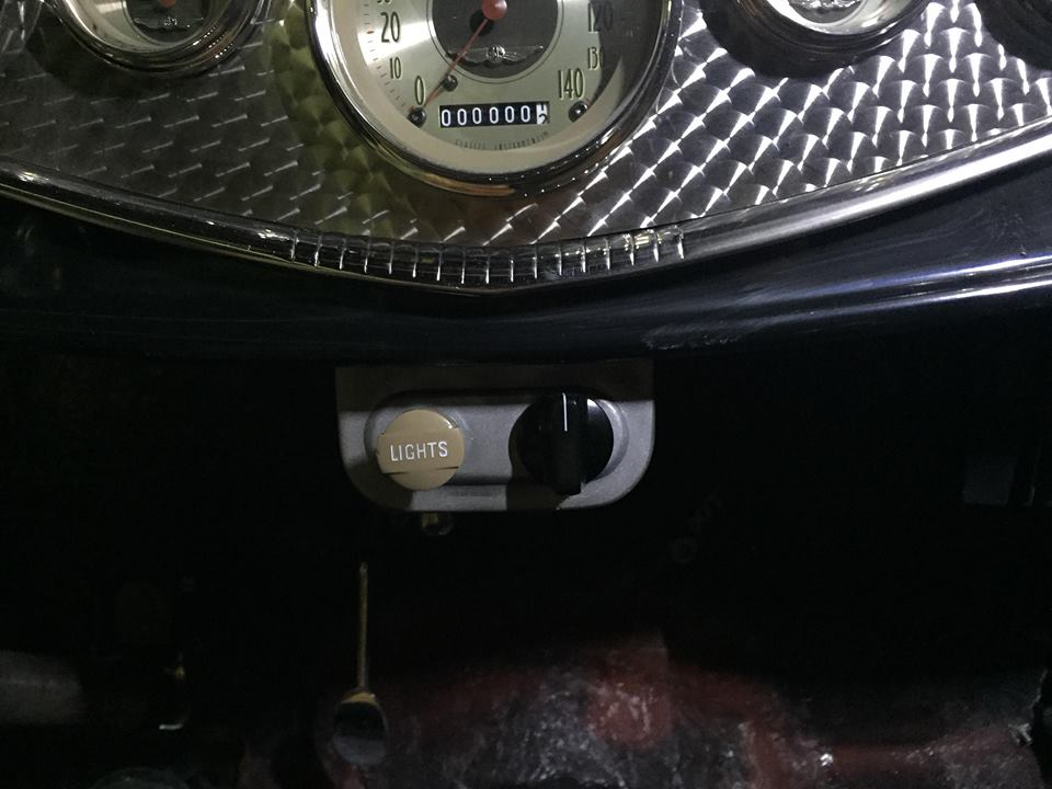

    Mounting the primary ignition switch on the left hand side of the dash, traditional Ford location. Nothing fancy there. Want to wait to drill that hole until I can check clearance behind the dash on the dash support bar. Think I have plenty of room there though.
    Put my wiper switch in the header panel just off to the side of the wiper motor. It's all starting to come together.

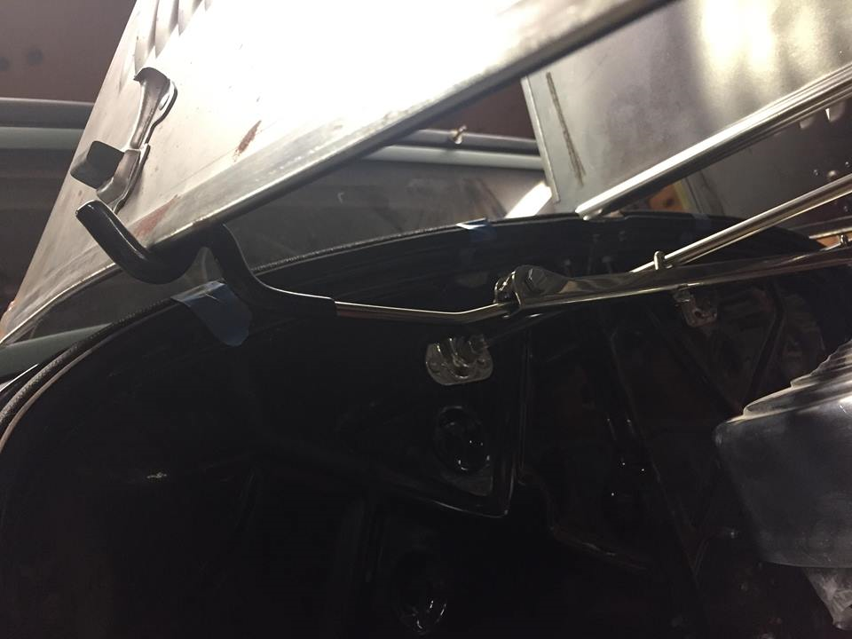

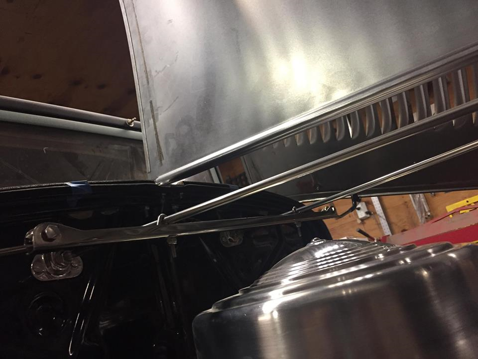

    We have a Ford Power car show in our little town on the 3rd Sunday in August every year for the last 35 years or so. I was the President of the club for 9 straight years. Got out a few years ago when life got crazy. She wants to take the coupe to the show and put it in the "Unfinished" class. A few of the club members have contributed to the project (some bought a bunch of parts when they found out I was selling some of my stash, one built the tranny for it) and she thought it would be a nice gesture to let them see what we were doing. SO, it gets ripped apart AFTER the show on Sunday instead.
    Bought the hood prop setup from Speedway so we could display it better. It actually works better than I expected. Don't think I would use it on a windy day. Also very close to touching in the center with both sides up but they do not touch, maybe 1/8" to 3/16" between the 2 hood tops. Might try a slight bend of the arms but not really a concern at this time, no paint to hurt!

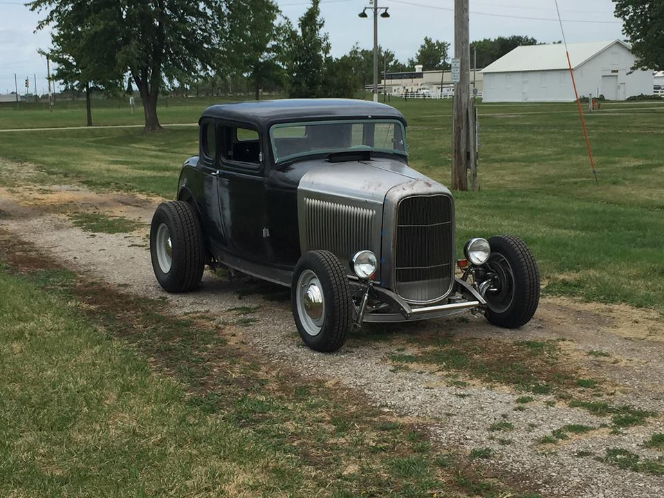

    Please remind me what the tires are. Brand and sizes. Thanks.

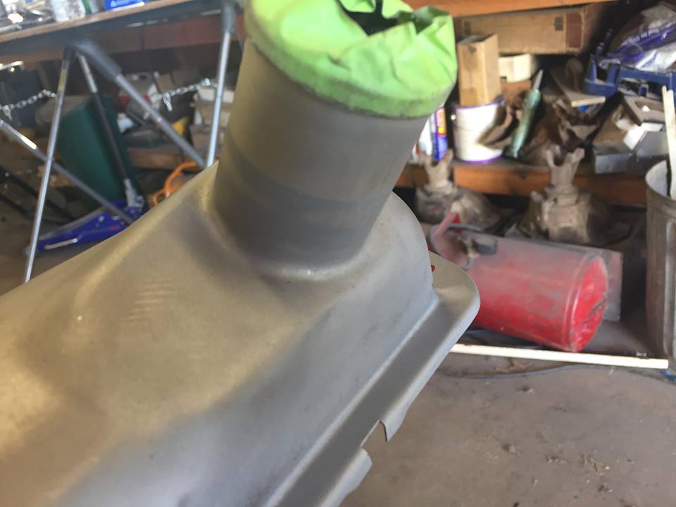

    Decided I still hadn't dealt with horn locations or the puke tank for the radiator. Got those taken care of this week. No pics, not that exciting.

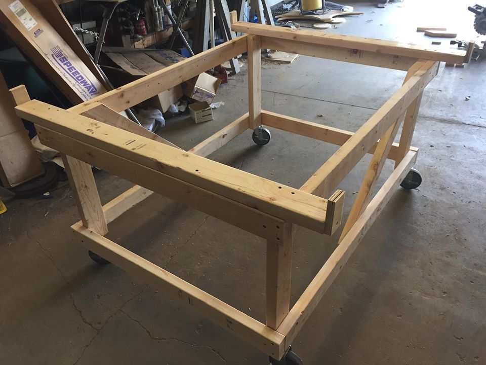

    Built a cart to set the body on when it comes off the frame. Should be able to get under it to do some work on the underside of the floor while the body is off the frame. Need to do a little clearance in a few places.
    Feel good to get back to things!

  26. LM14
    Posts: 1,936
    LM14
    from Iowa
    Mock-up completely done. Had a group of good friends drop everything tonight to lift the body back off the frame. Spent the last couple days getting thing ready. Went smooth as silk.
    Plenty of room to move the body and frame around. Dolly working great. Still have room to get my pickup in at night! Winter is here, that's important.

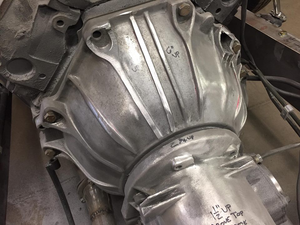

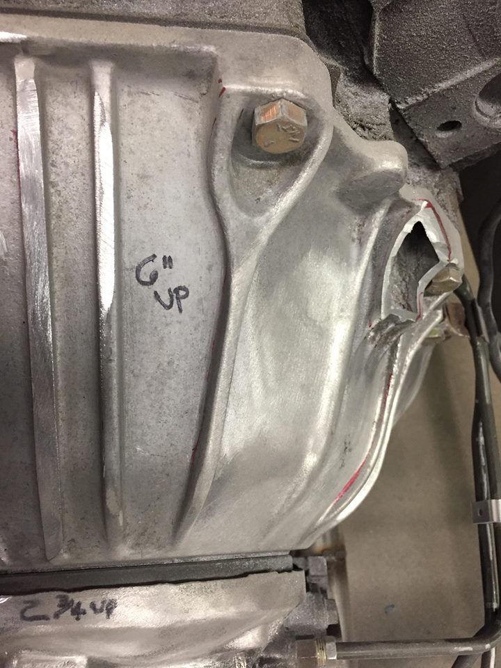

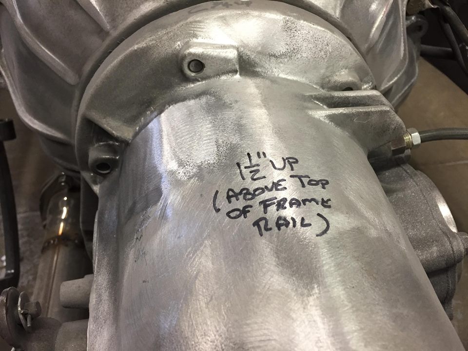

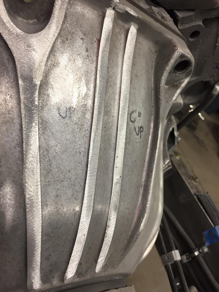

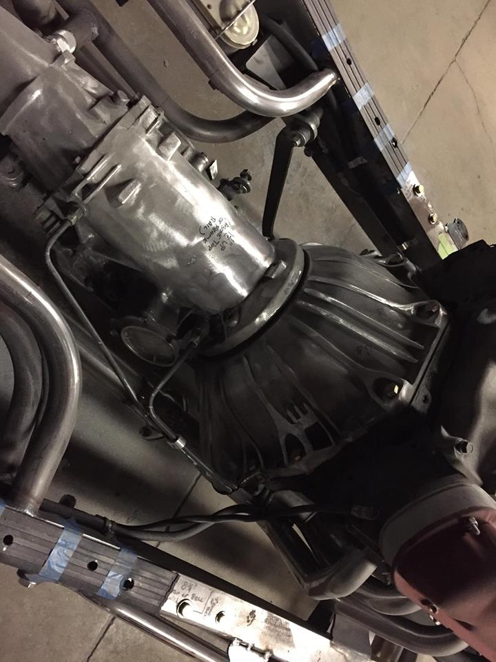

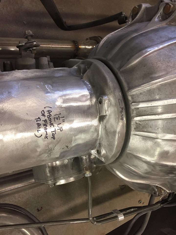

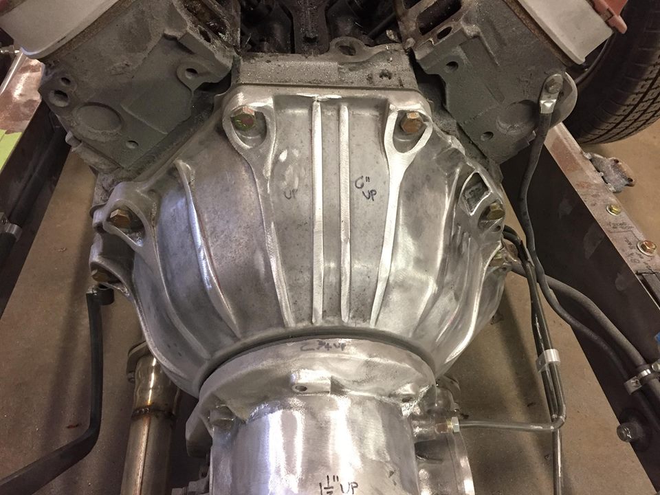

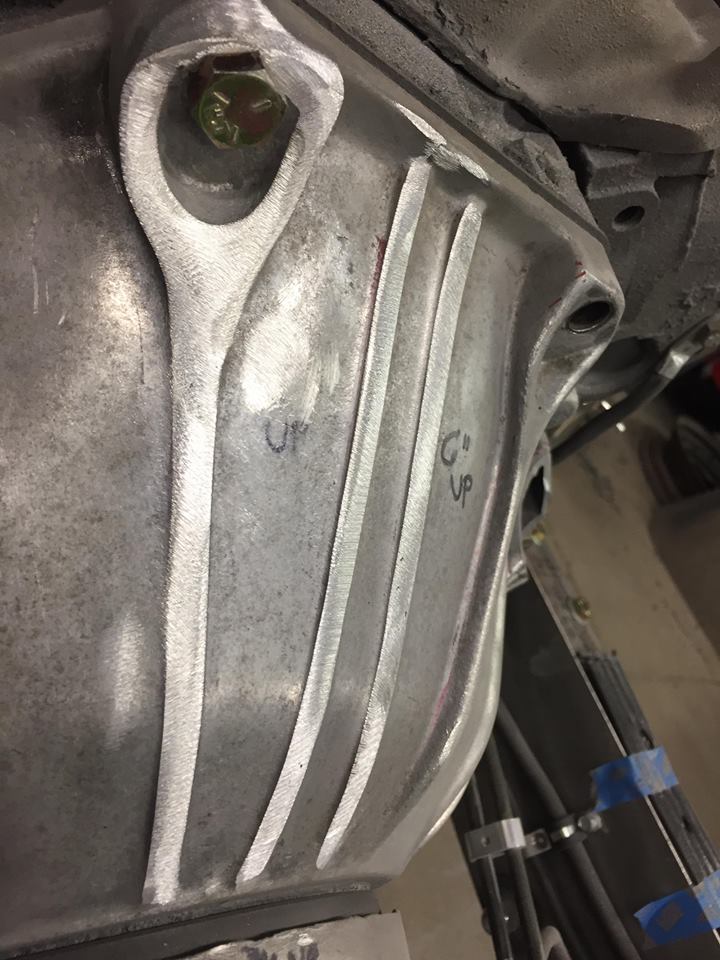

    Spent the day removing most of the ribs on the bellhousing and a couple bosses on the trans case. Also removed a couple bosses that serve no purpose in my application and reshaped the bolt bosses for more clearance. Should give plenty of clearance in a few tight spots. Little cleanup work left but 99% of it's done!
    Also started reworking the firewall/trans tunnel area for a bit more room, too. No pics of the trans tunnel yet.

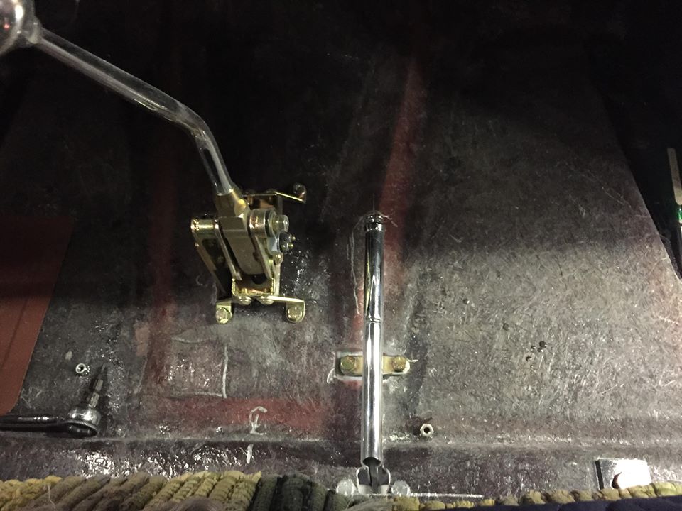

    Finished up the rib reductions and removed a bunch or bumps and blocks to gain some room.
    Reshaped the junction of the firewall and trans tunnel to gain a bit more room around the bolts.

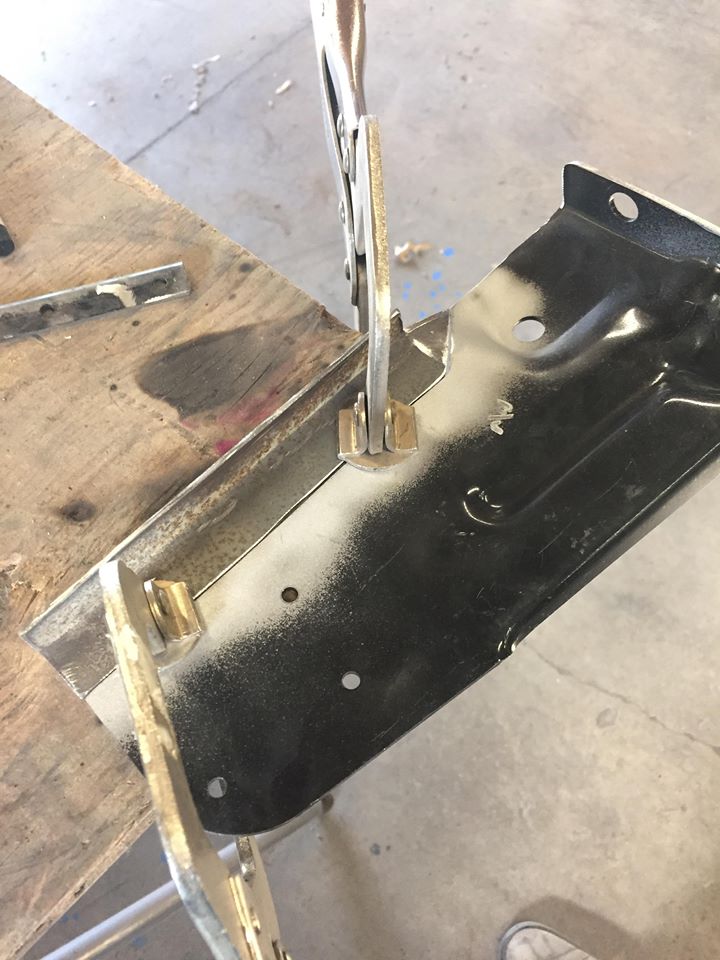

    Started working the gas tank braces into shape to get them attached. Thoughts on solder VS TIG vs silicone bronze?

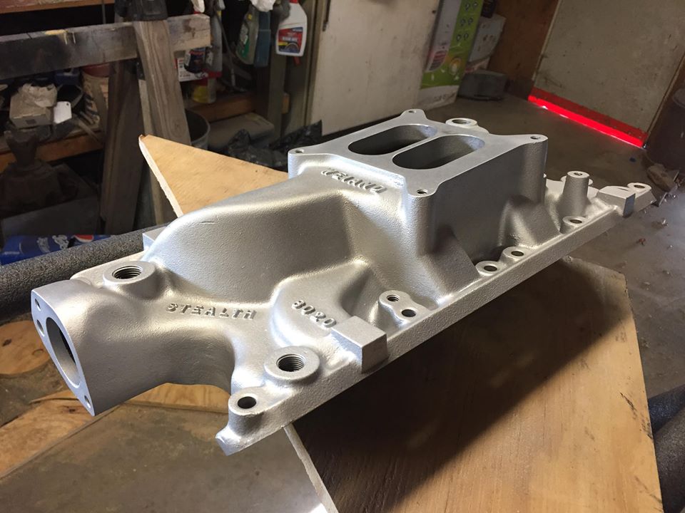

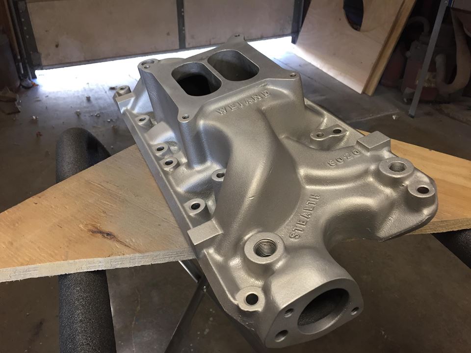

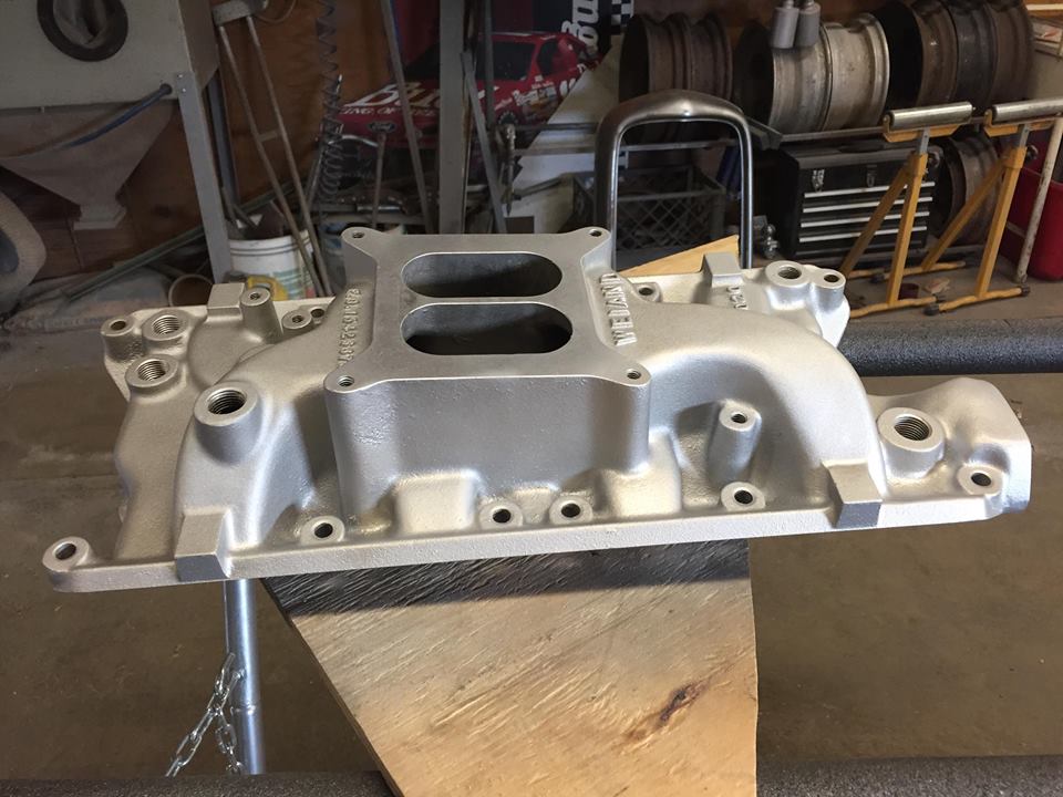

    Intake cleaned up and ready to go! Been working on the engine off and on, time to finish it up now.
