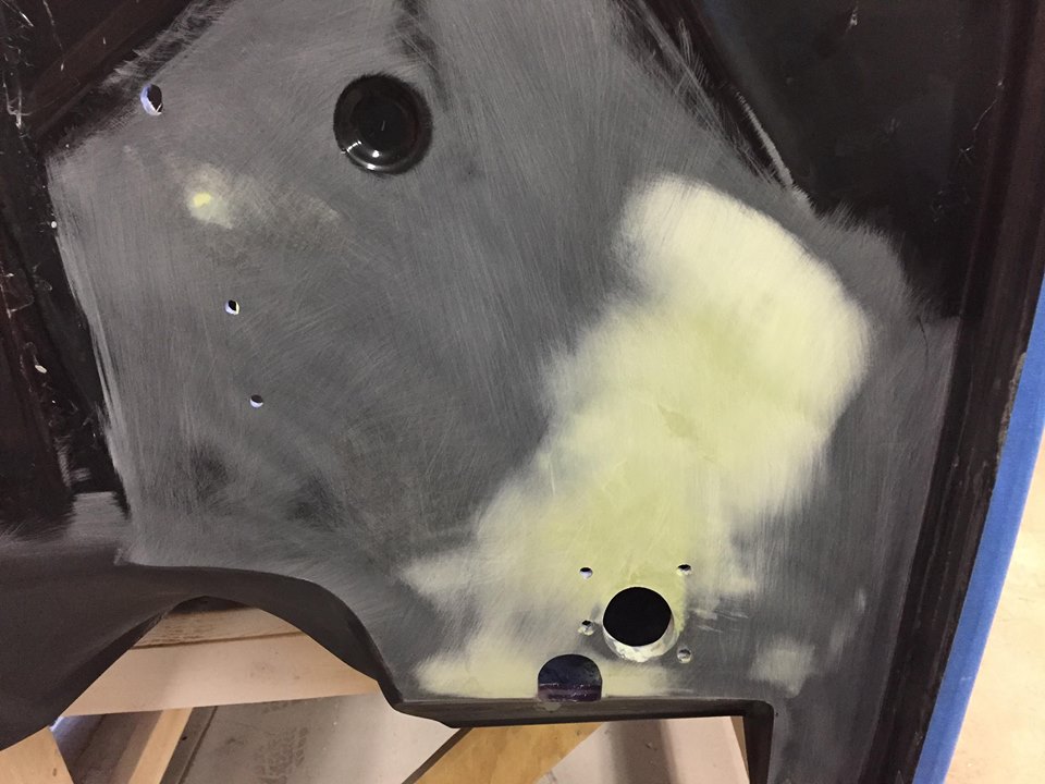

    Started cleaning up the firewall yesterday. Couple layers of fibergl*** mat and cloth alternated to fill in the big area on the back side of the firewall. I started way high on my hole and it was huge! After that cured I added more mat to the front inside the hole to build it up. When that was cured I filled the majority of the remaining hole with kitty hair and left it to set overnight.

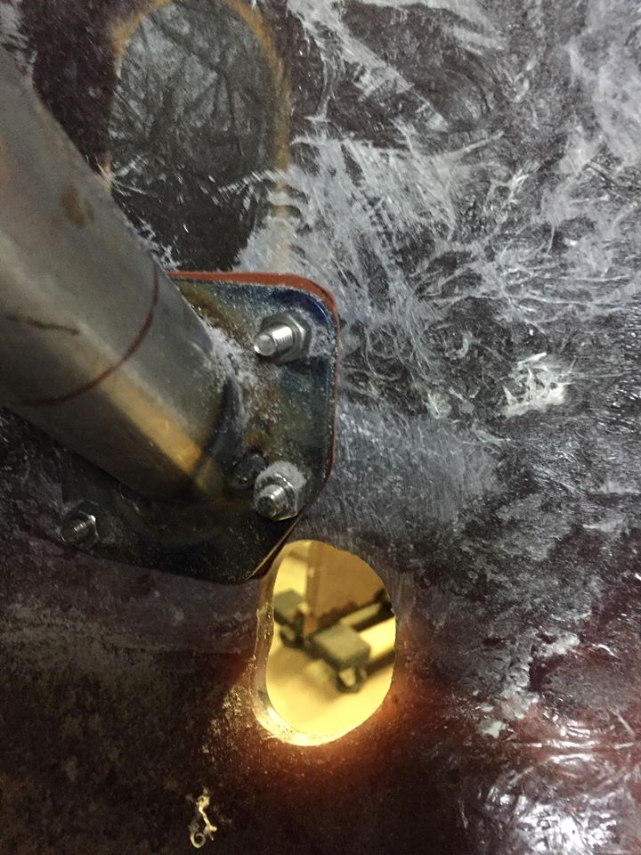

    Worked today at closing up the gap around the steering column where it comes thru the firewall. Wrapped the lower few inches of the column with masking tape and stuck it in the hole in the firewall, held in place by the upper mount. Add a bit more kitty hair to fill the sides and top then twisted and pulled the column out when it was almost dry. Left a nice hole. Regular body putty will finish it off from here.
    Finally finished up the steering column mounts today! Created a flat plate for the bottom mount with a 1.5" diameter hole drilled thru it at 51* from the surface of the firewall. Then made a rubber gasket to go between the mount and firewall to seal everything. 4 stainless ****on head Allen bolts will hold it to the firewall. Also welded the upper mount to the column on the back side of the drop where it won't show (it was suppose to use a 1/8" set screw as designed to lock the drop to the column). This made it really solid. The top mount is all behind the dash so none of it shows except the drop section. Not a single welded area of the mounting system will show when done.
    Need to spend more time with body putty to blend the firewall back in but it's getting there!

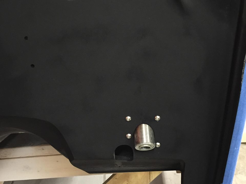

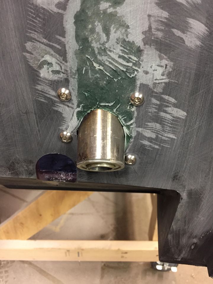

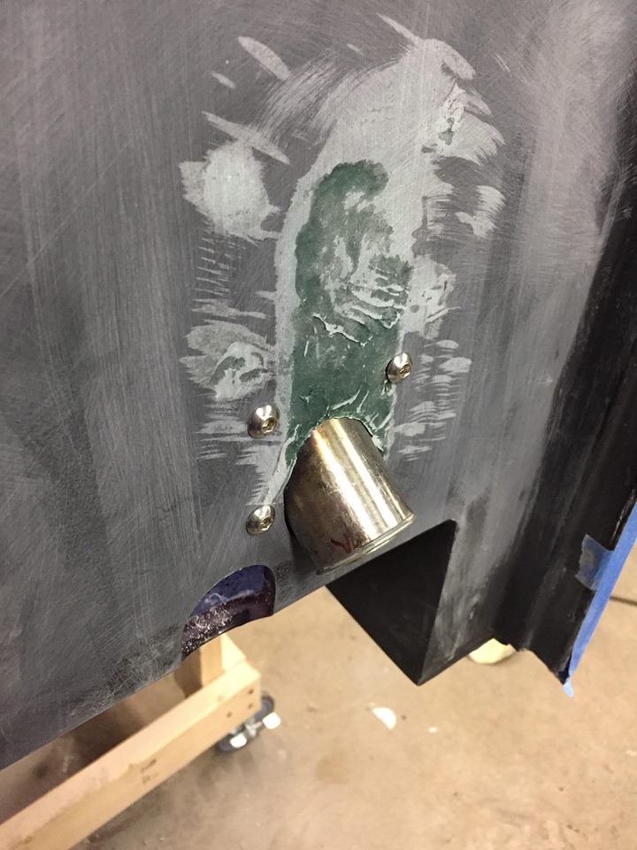

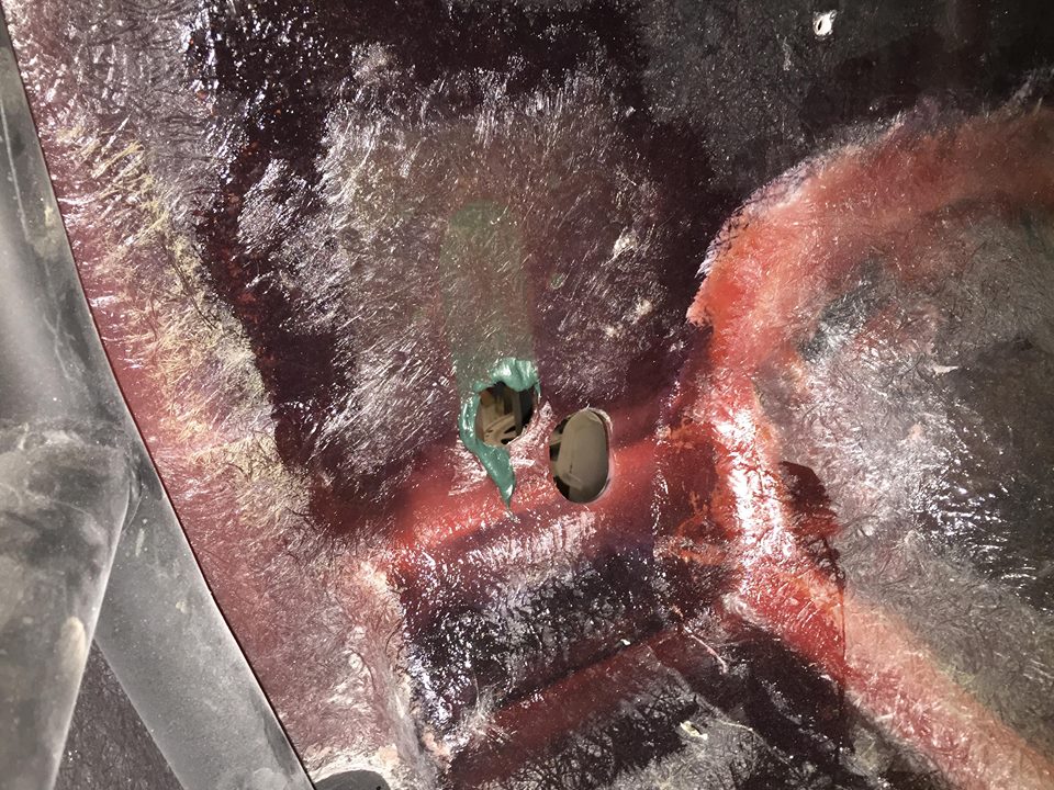

    Finished up the steering column hole thru the firewall today. Really happy with the fit and finish there now. Good enough till it gets turned over to the body shop for paint. It's smooth and flat. Just a few sand scratches left.
    Now to deal with the brake pedal hole.

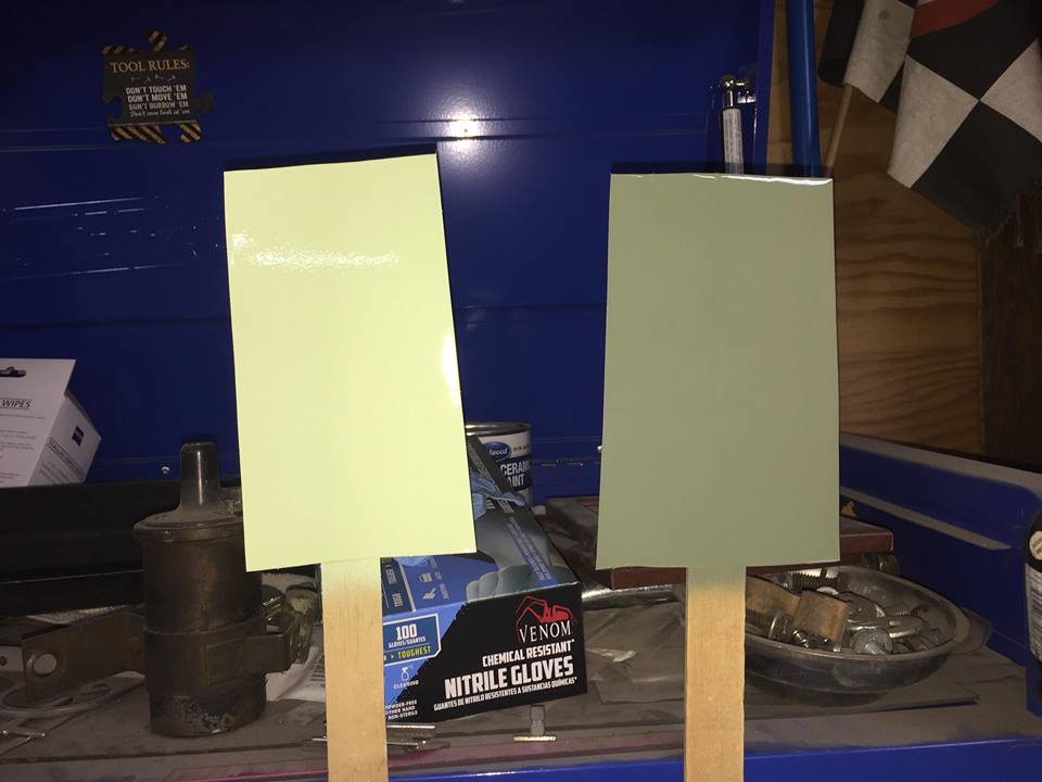

    Spent some time with the painter yesterday. After the first of the year we take all the metal to him. Going to go ahead and do all the work and paint the frame, rear end, gas tank, steering column, driveshaft, engine/trans, dash, header panel in final color. Didn't want to put everything in primer, drive it, then try to deal with brake fluid, gas and trans fluid and paint those parts later. Still just primer on the hood and grille shell for now so I can work seams and body alignment issues. Plans change but we did mix what I think are the final colors. Sage green for the body/frame and celery green for the engine/trans, driveshaft, rear end and interior.

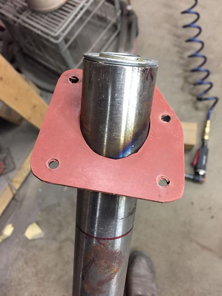

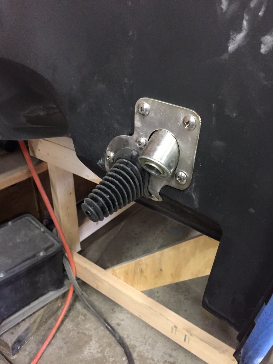

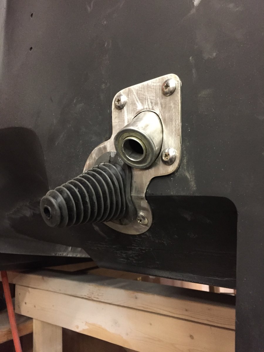

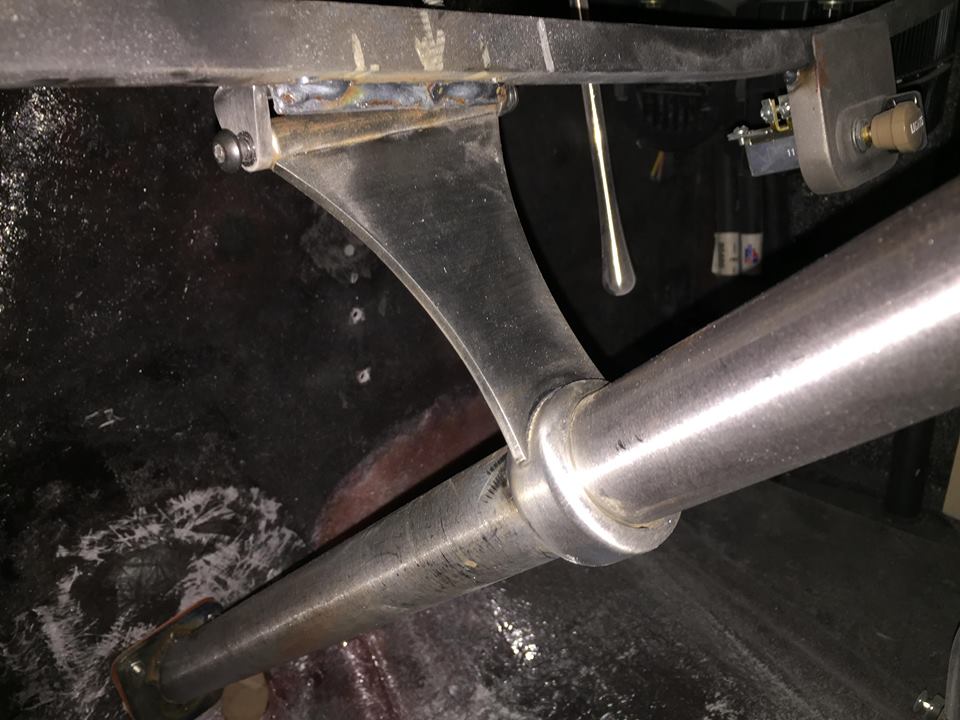

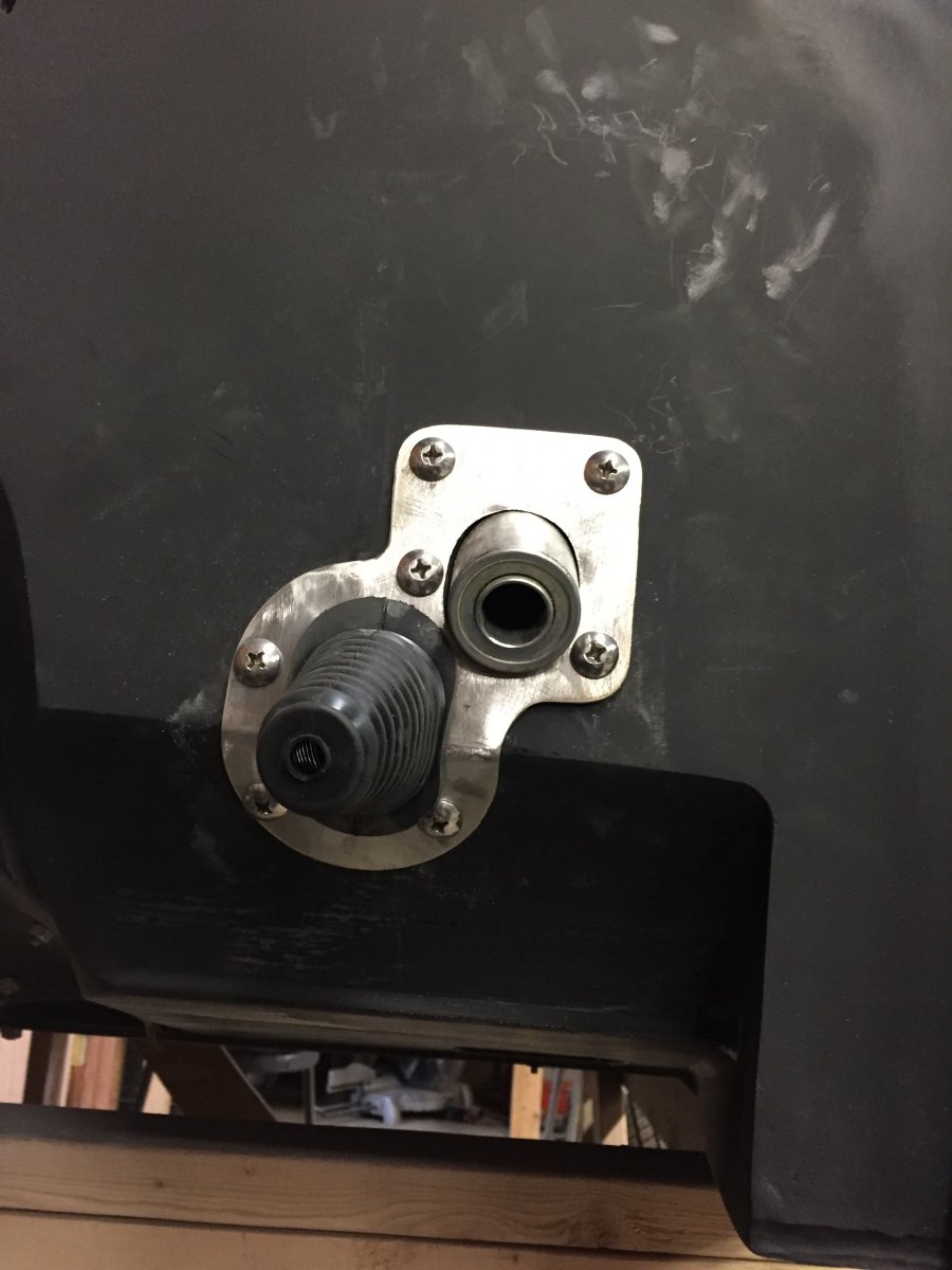

    Since it's part of a safety-critical system, it'd be advisable to add a doubler plate (or larger washers) on the engine-side of the firewall at the lower column mount. As-is, you're just relying on the heads of those ****on head screws to distribute stress to a small area of fibergl***, even though you have that thick plate on the interior side.
    Otherwise, nice clean job on the upper and lower mounts.
    loudbang, brEad and LM14 like this.

    It's in the works. Waiting on the bellows for the brake pedal and there will be a common plate around the steering column and brake pedal boot when it all goes together. Should spread the load even further.

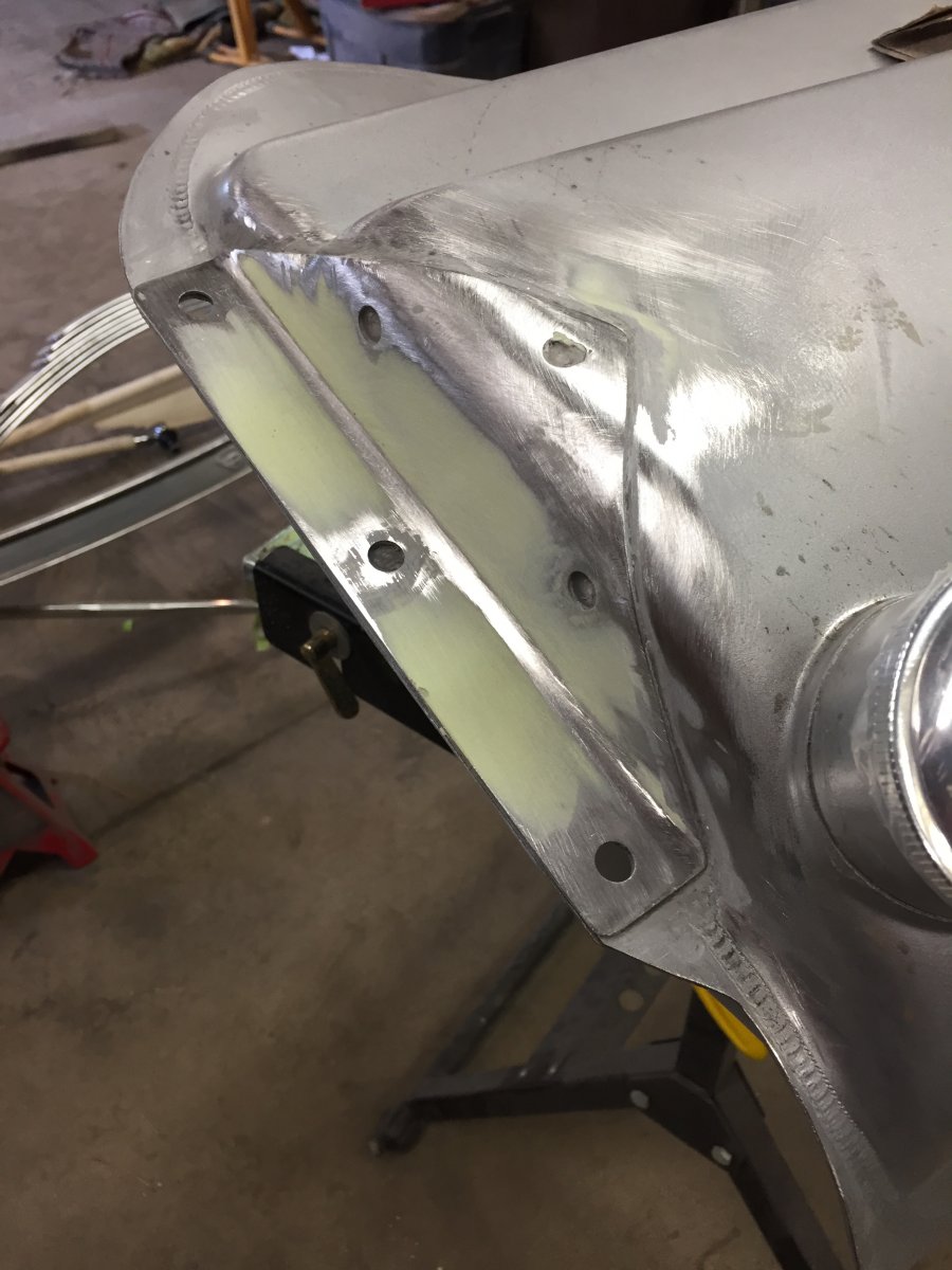

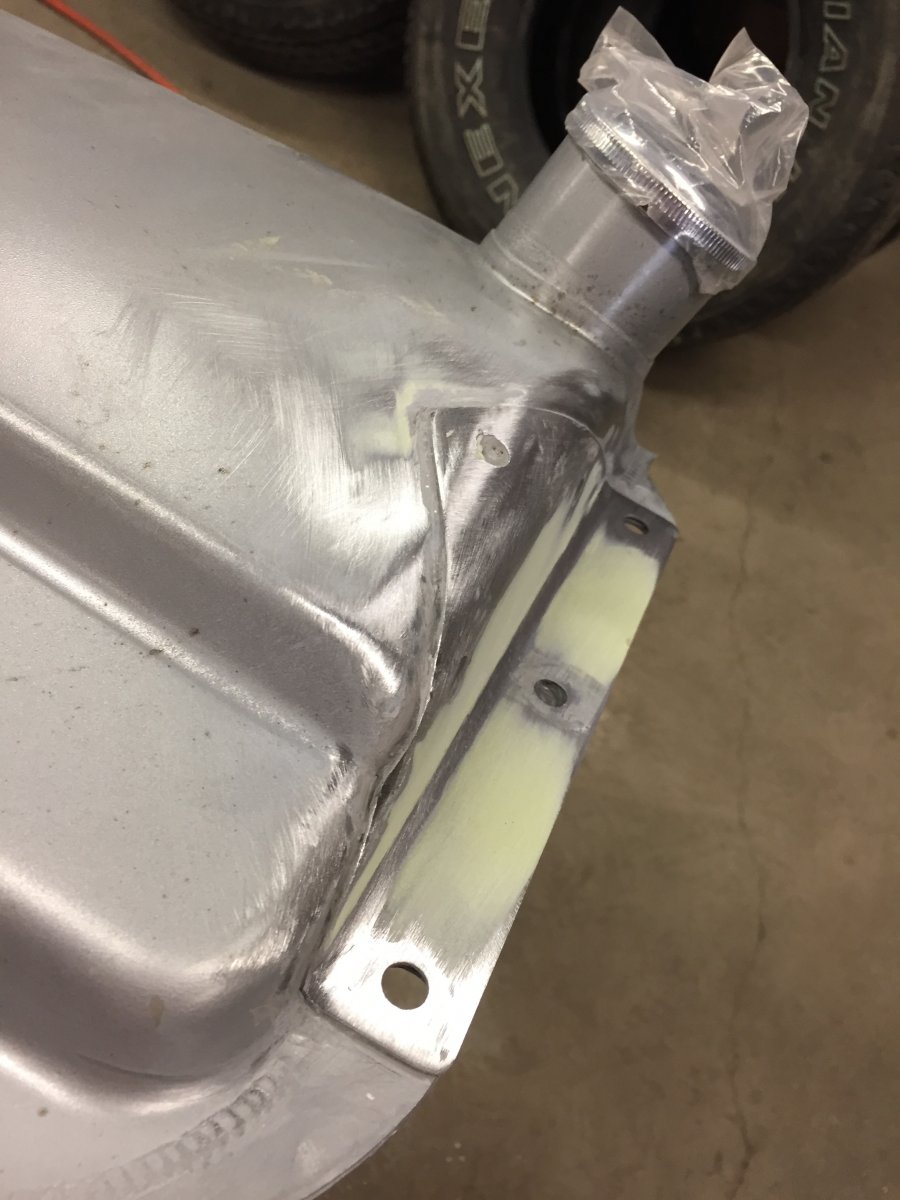

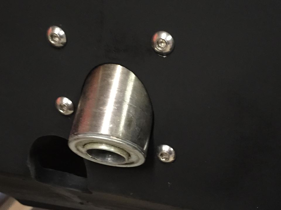

    Created the doubler plate for mounting the bottom of the steering column. Incorporated a boot in the same plate for the brake pedal. It’s a JJ Hot Rod Parts boot, slightly modified.

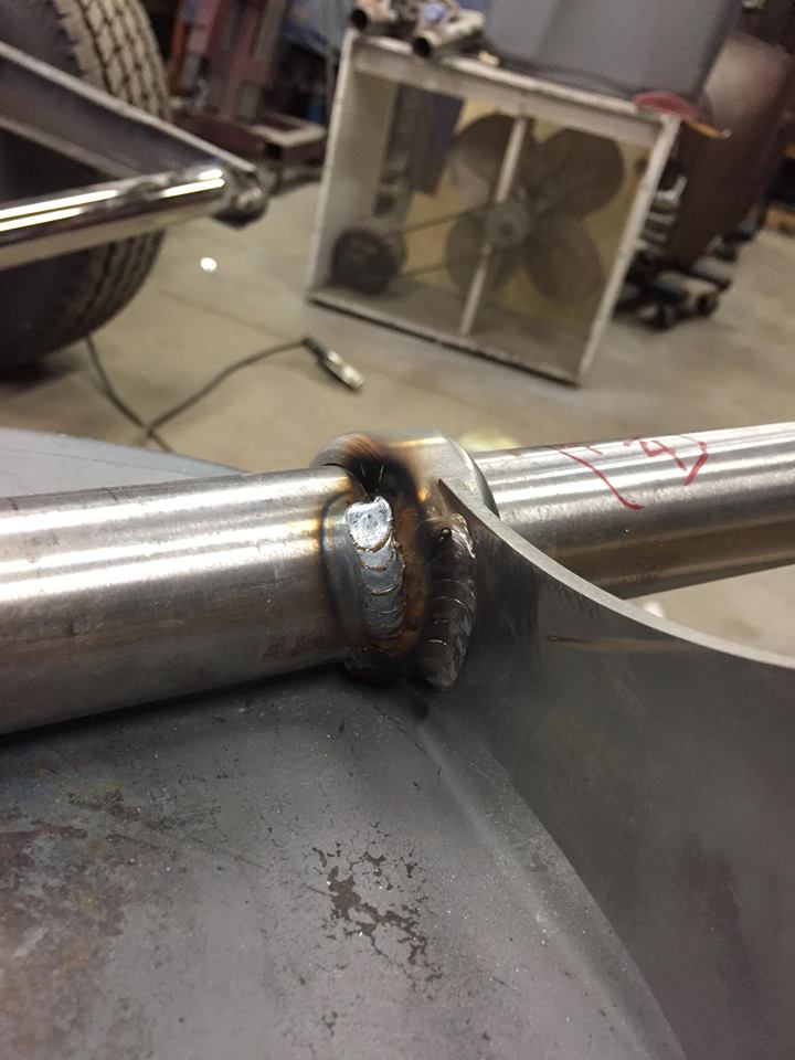

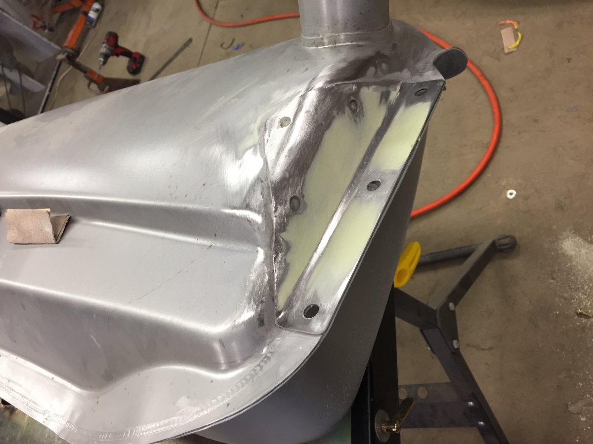

    Also got the gas tank gussets on the tank. Actually plug welded them on thru other holes I drilled in the gussets then went around the original holes and plate edges with a steel based filler so they look soldered in place. Nobody I talked to was comfortable with soldering them on except one guy I don’t trust.
    This should make everything for the first round of paint ready to go. Drop these pieces off tomorrow.

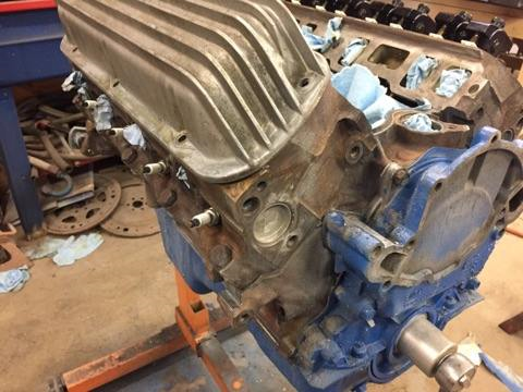

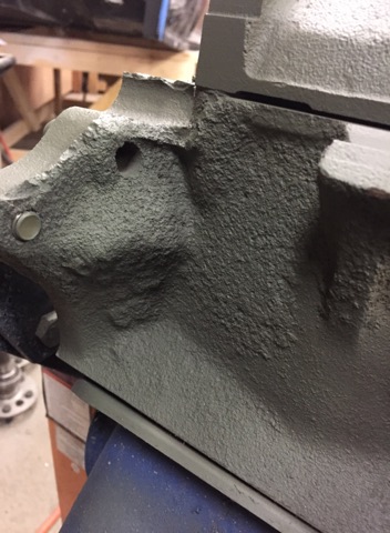

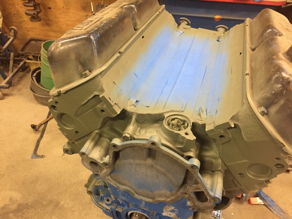

    Couldn't leave well enough alone. After priming the block/heads I stood there looking at all the casting flash, trapped core material and rough areas. The primer really brought out all the problems and shiny paint will just make it look worse.
    Couple hours with a small cone shaped burr in a die grinder and re-prime. Was pretty rough on both sides, probably the WORST SBF block I have ever seen. Much better now.

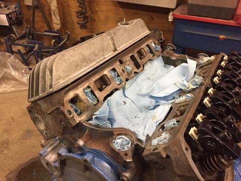

    Everything for the engine on the '32 is now ready for paint! Hoping to get my custom mixed light green paint later this week so it can all turn one color and I can ***emble the rest of the engine. Cars that are taken 100% apart take up a LOT of room.

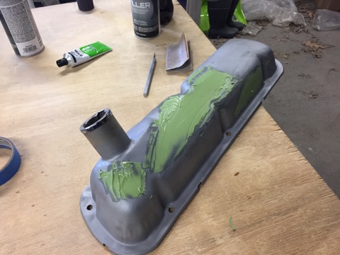

    Probably should have shopped around for a better set of valve covers to start with. These were full of dents. 1964 Fairlane valve covers don't grow on trees anymore. The left one (with the stand pipe) was pretty decent but the right one was full of little dents and hundreds of rust pits. Spent a lot of time in the blasting cabinet getting rid of all the rust. Took a lot of hammer/dolly work, some putty and a lot of time to get them straight. I still find little issues every time I look at them but enough is enough. Time for paint!
