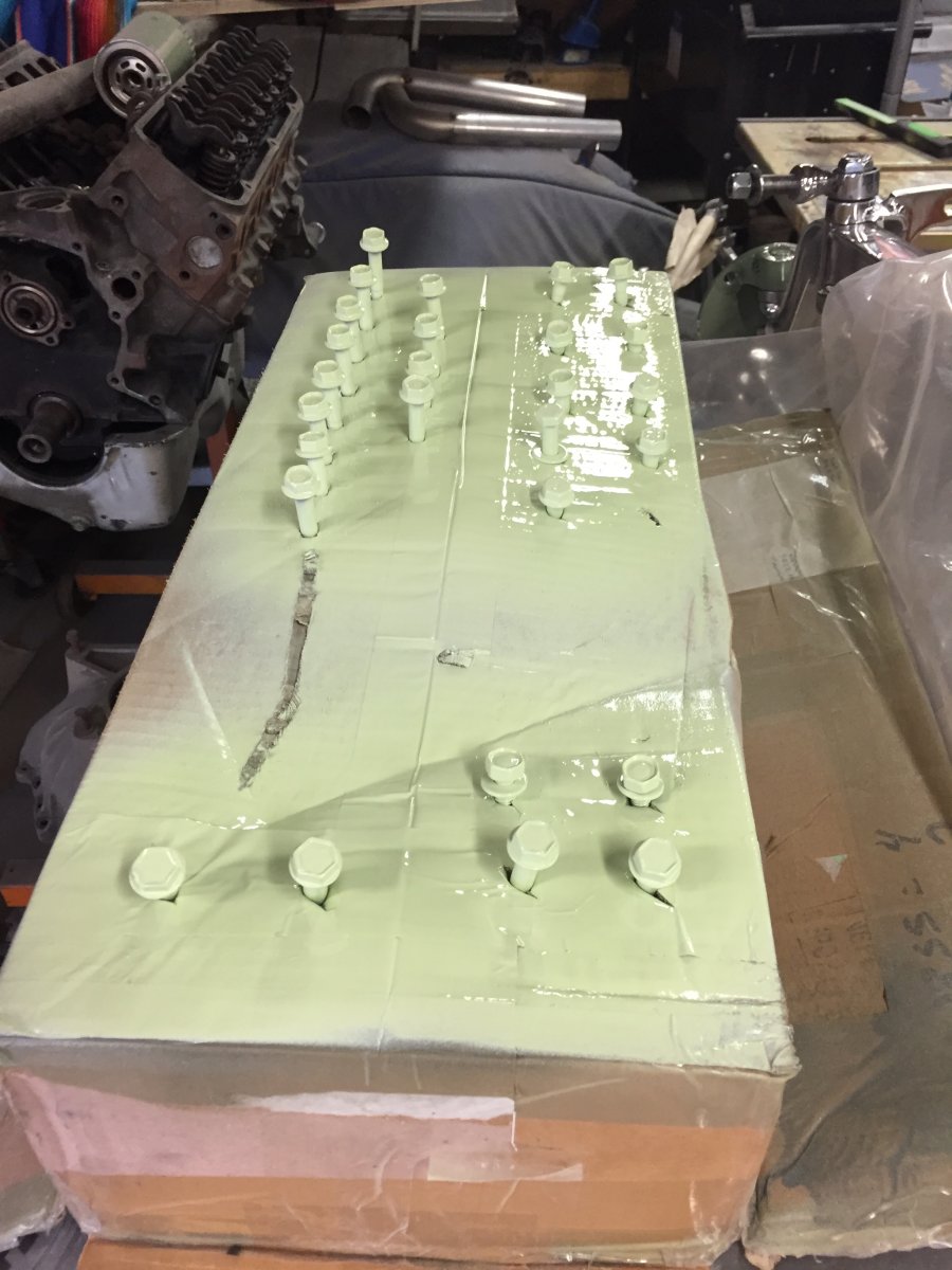

    Actually shot a tiny bit of paint today. Spindles are done! And so it begins. Hoping to get my hands on the light green tomorrow for the engine, trans and a few of the other small pieces. Pretty excited.

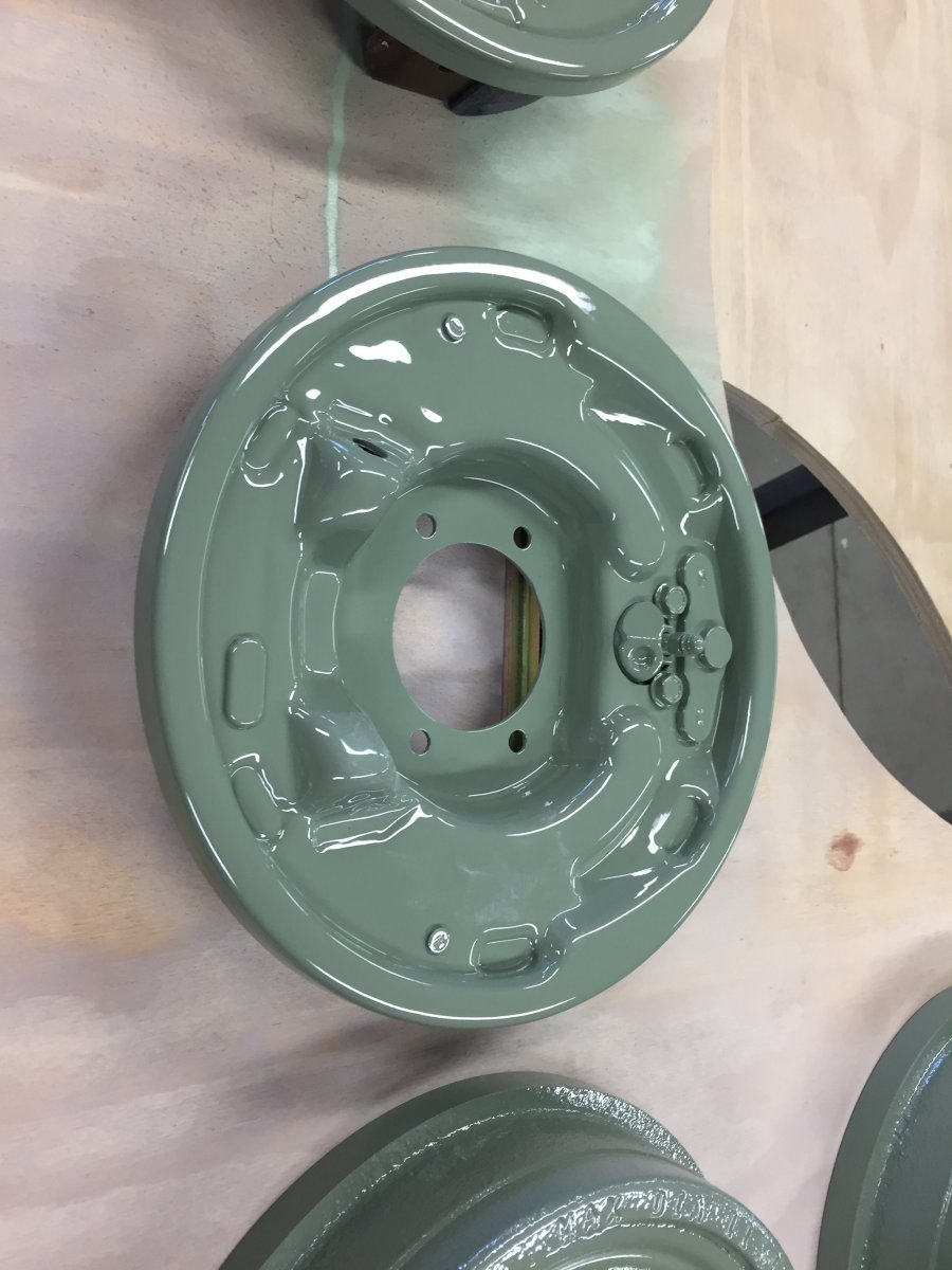

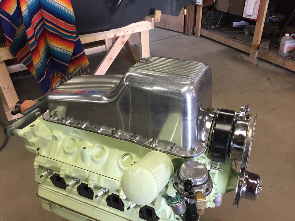

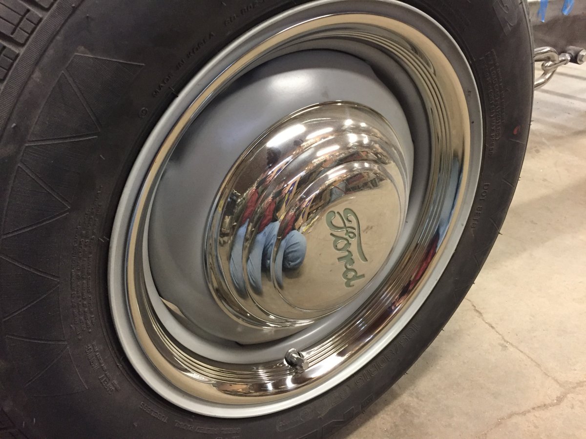

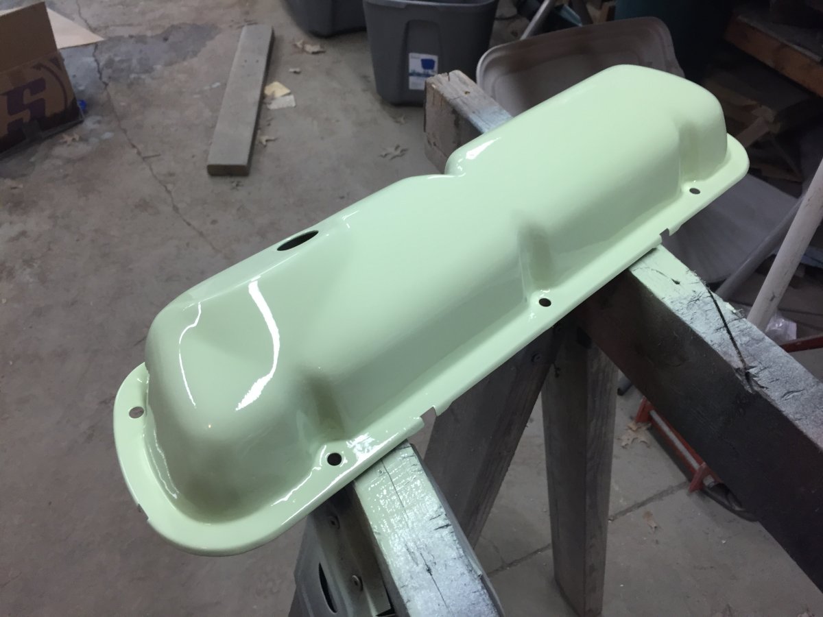

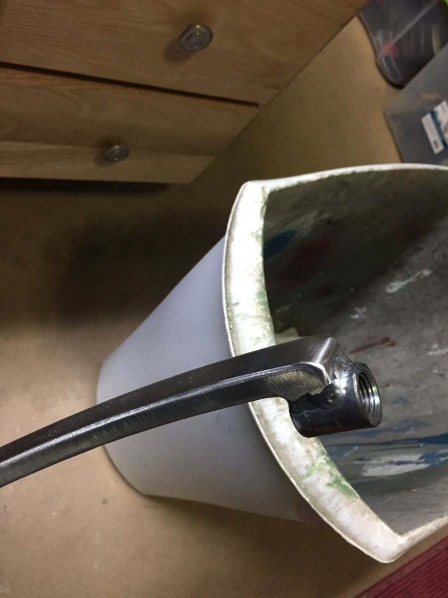

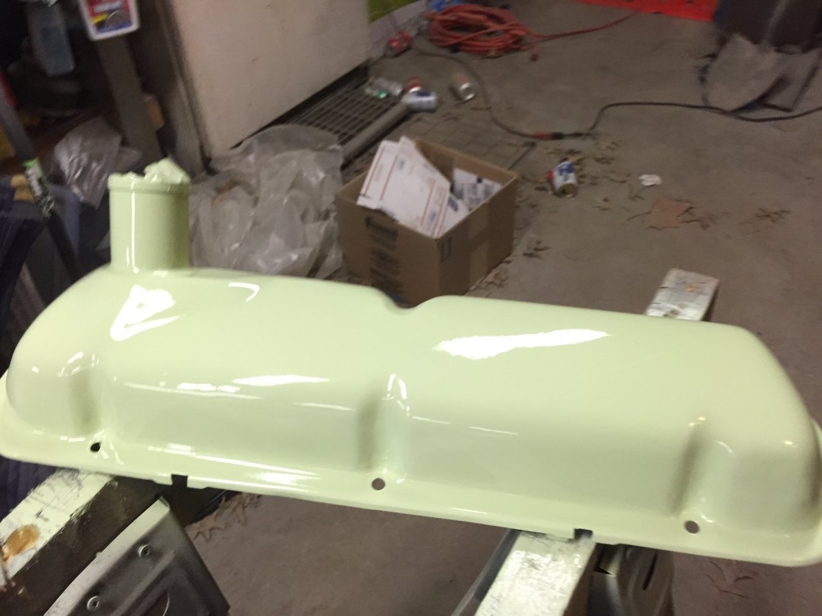

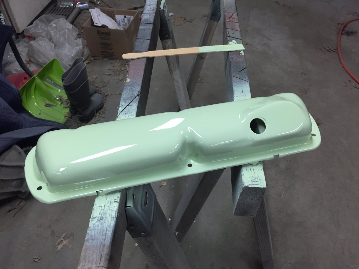

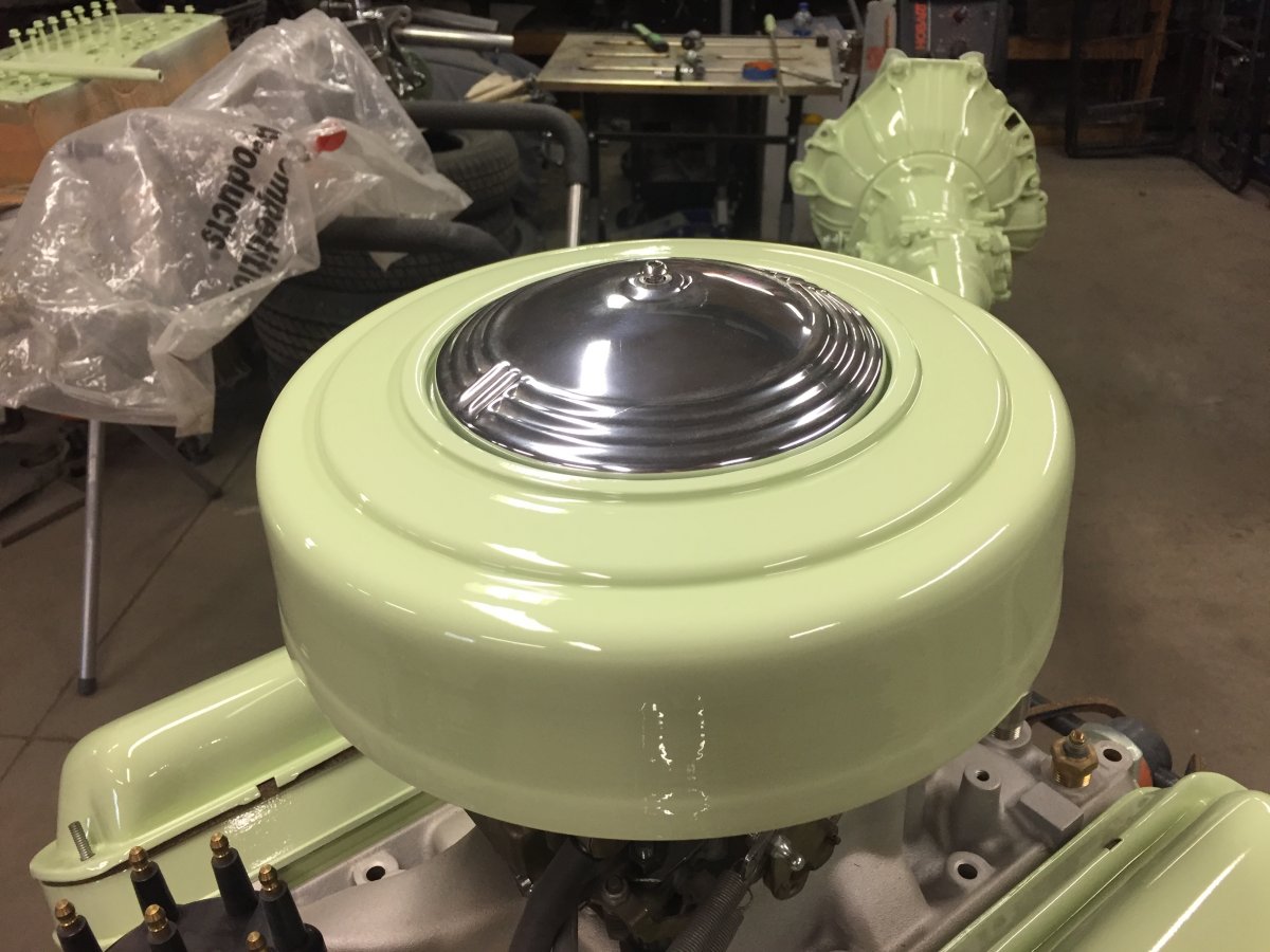

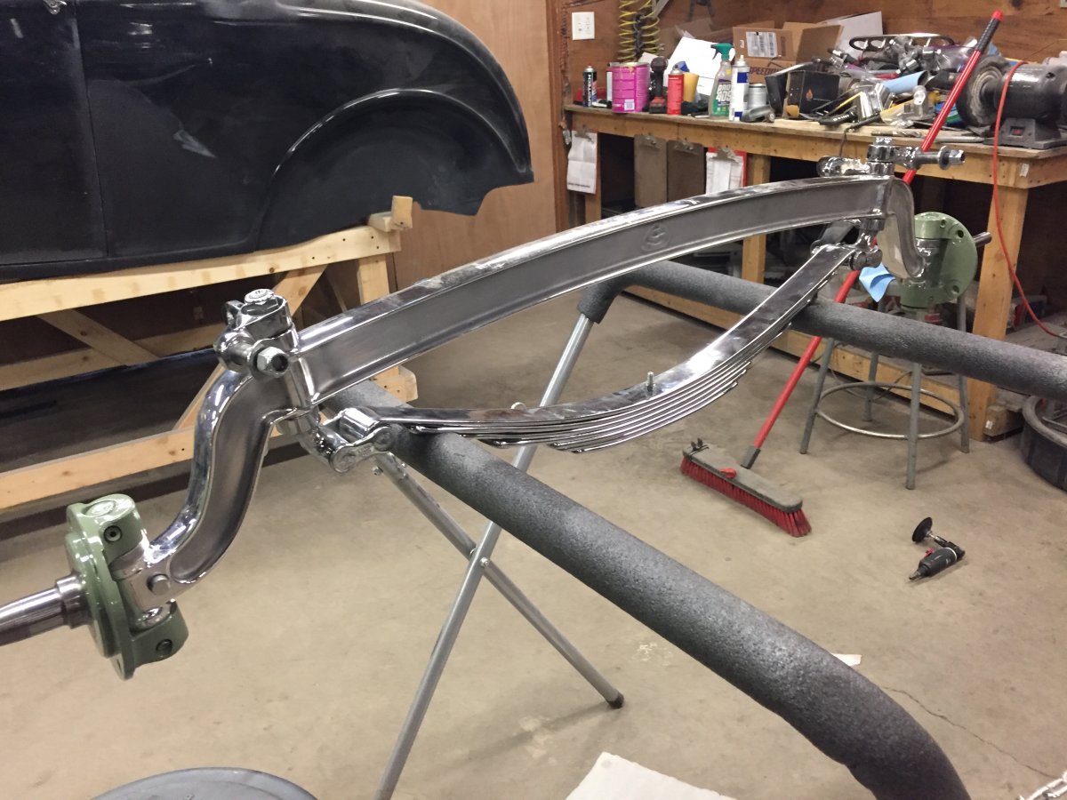

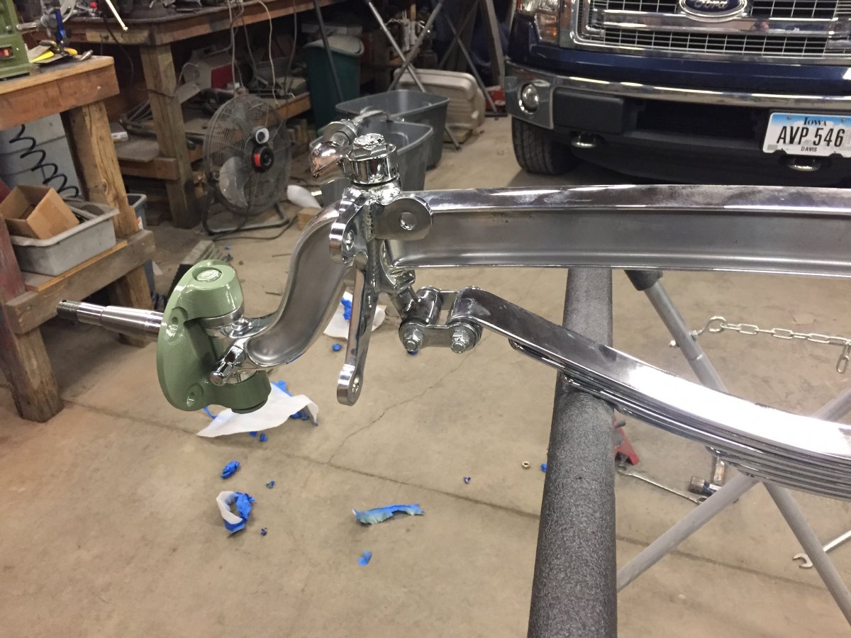

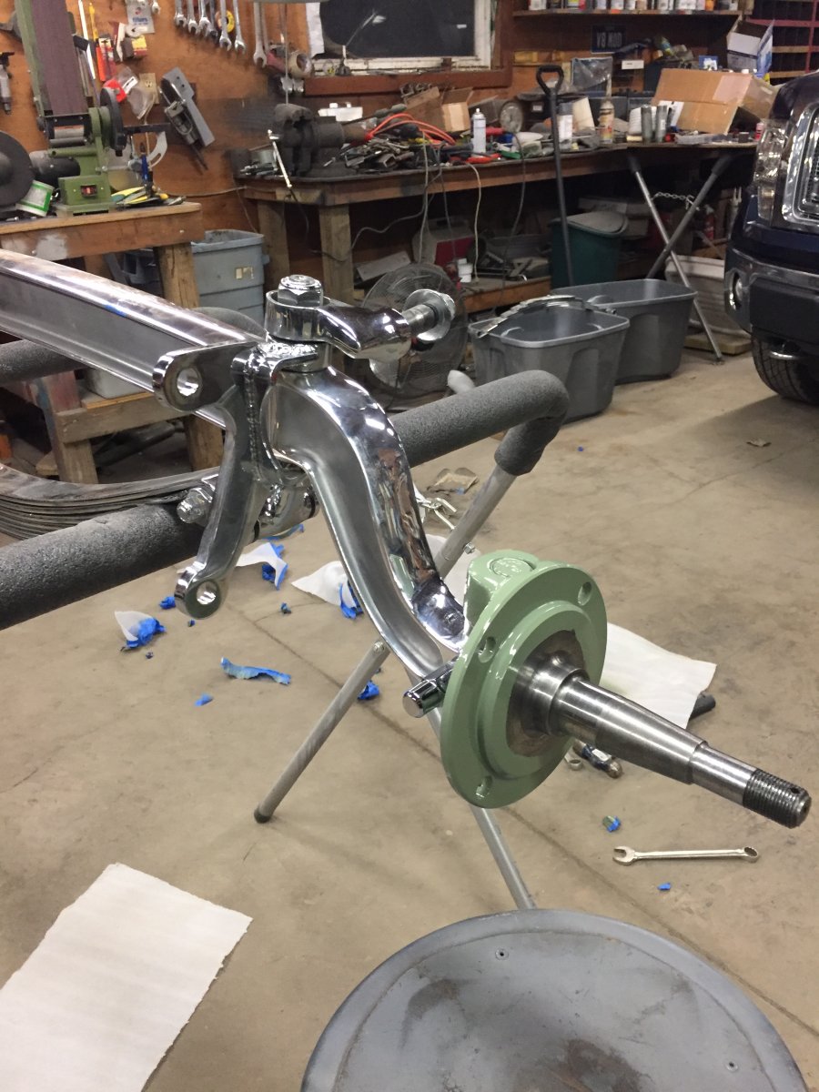

    Made some parts shiny today.
    SPark
    4AD82E36-6DDD-4FDA-B57A-4E5D89C8452D.jpeg 03232DC1-3C71-4B4B-9DCB-8042CF276D28.jpeg 174720DD-3191-4D7A-9AF0-788CE2C1CC3F.jpeg 4BC01015-0A30-4D18-9398-D9021635FC62.jpeg 9E5C6D34-D13C-4036-8AA6-570E6A69FFF8.jpeg 56AD0A35-25CA-41F4-986E-7BD6F21E80AE.jpeg A04419B8-16D8-4774-925B-2FD62B84B9BA.jpeg B9851AB1-4D50-4122-B7A6-E0497D811B31.jpeg FFFE0C21-CB86-4E97-8A49-67F1D4F429DA.jpeg 4FDB3F16-60A9-47D4-B70B-3D3EEDE2DF19.jpeg 70C8476B-7A56-4801-8516-7890BFADE1FB.jpeg 677AEC2A-0D61-420B-92E1-B919FC360726.jpeg 7DE7E286-652C-4B3F-92AC-BEC4025E50C4.jpeg 8949F75B-E75C-4CBE-A01F-79333AD79624.jpeg

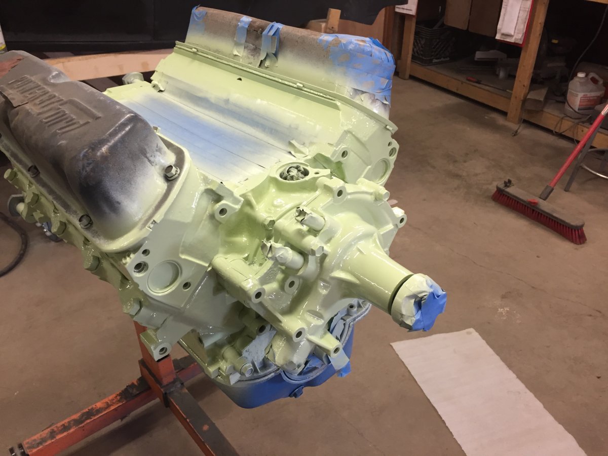

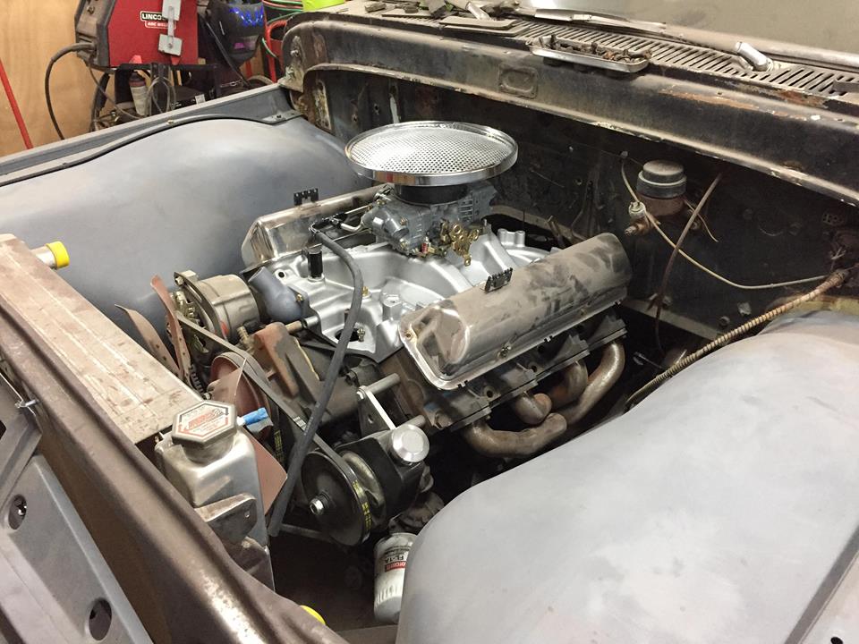

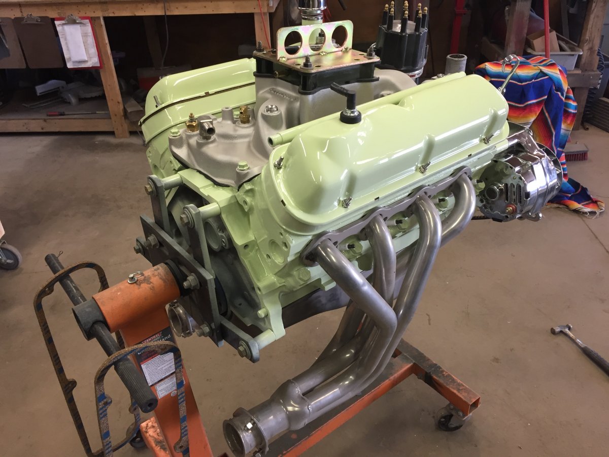

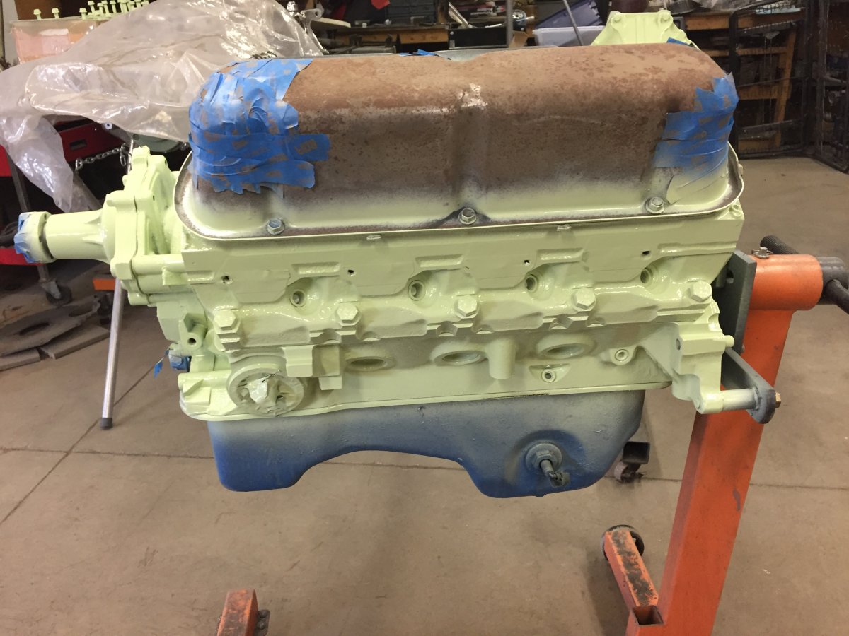

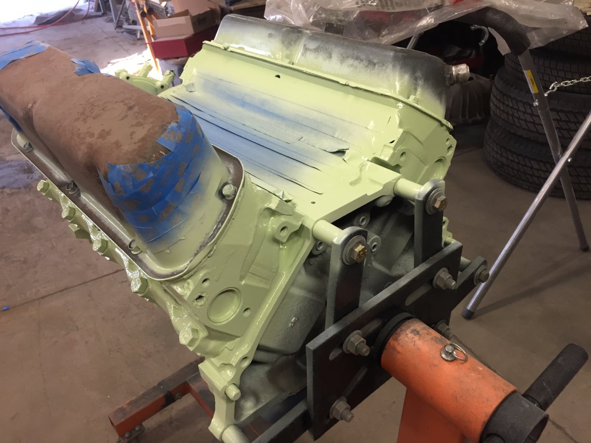

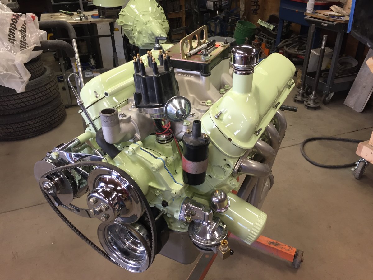

    Engine is ***embled! Have to touch up a few bolt heads and forgot to paint the coil bracket but other than that it’s ready to drop into the ch***is when I get it back.
    Headed to another cancer treatment Wednesday and wanted it together before then. Never know what shape I’ll be in when I get done with one of those. So far, so good with this treatment.
    SPark
    22E7B179-7106-41D6-B347-CA6F0F0DA0C9.jpeg BB196C71-0A66-4231-A75E-BF6DFCAD3C54.jpeg 780D9081-D181-40C4-8272-919D66BD3F0B.jpeg 153A4819-E47D-41DA-B295-BA28AB1F9929.jpeg 69169237-A12A-4ED4-B3A9-46D4D18CFC3C.jpeg E85AF830-938D-4B57-AE59-C19CDBF11787.jpeg DB91D292-460E-41B8-B949-B3E7FF5EBA6F.jpeg
  5. brEad
    Joined: Dec 23, 2016
    Posts: 2,039
    brEad
    Paint looks great! Glad your treatments are going well, too!

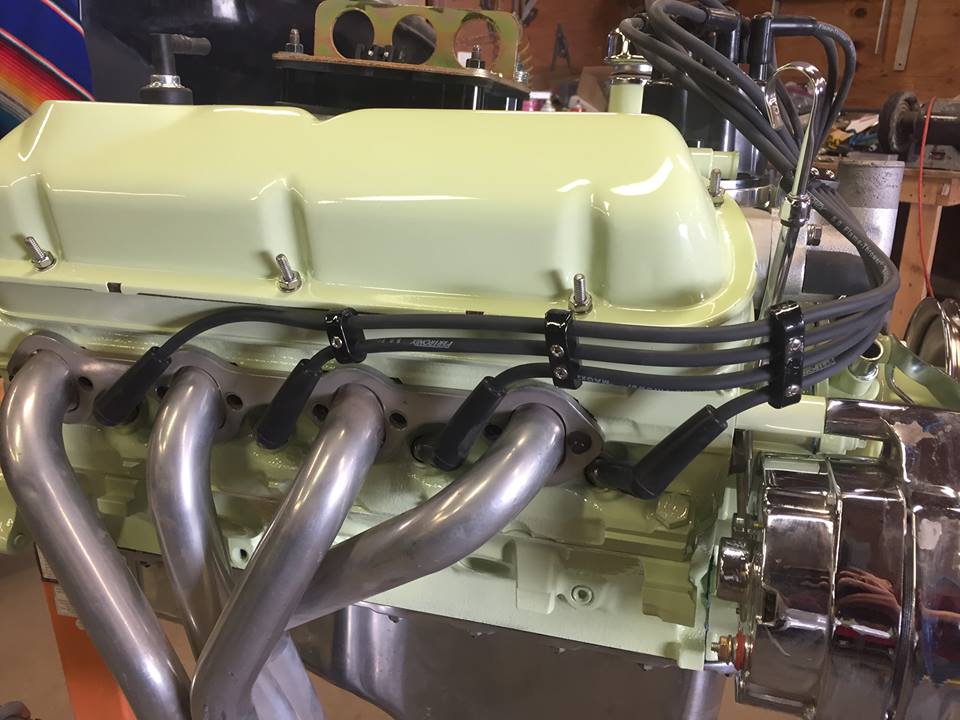

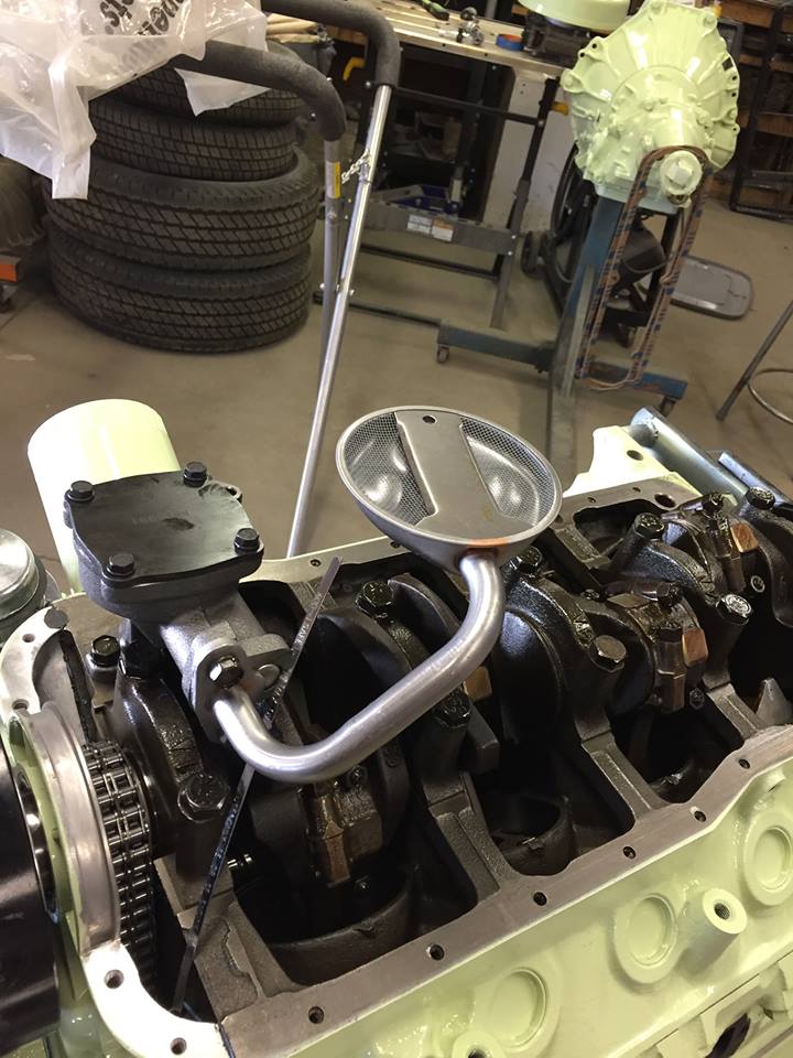

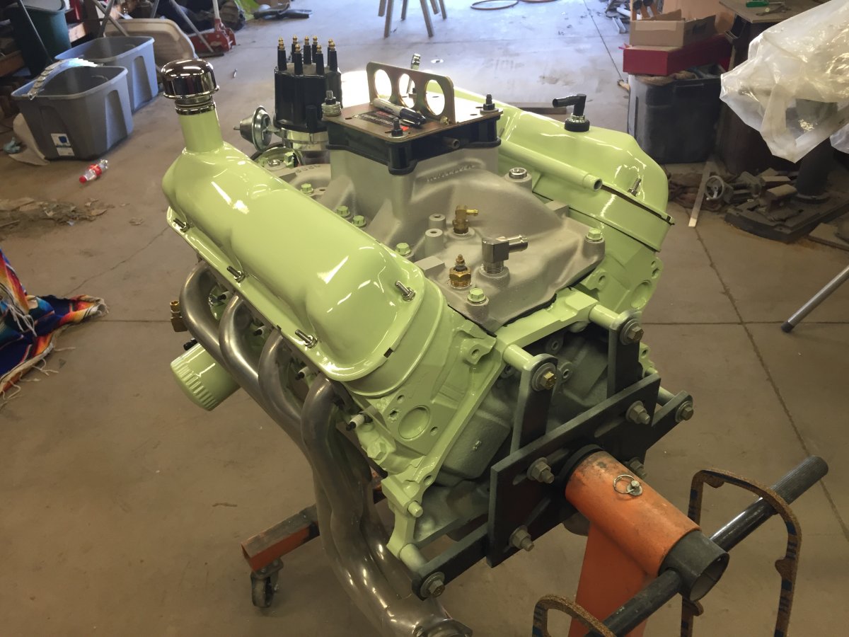

    Had a new ARP oil pump driveshaft (compare to the stocker on the right), new Melling oil pump, new pickup tube (to fit the front sump pan) and an ARP oil pan stud kit so decided to put them to use on this one.
    Also started building plug wires. Took 90* boots on the left side and 135* boots on the right side to get the wires headed the right direction and still clear the headers. Need to stare at them a while before I make the final length cuts and terminate them. Want to make sure it's what I want before I cut them too short!
    SPark
    engine10.jpg engine11.jpg engine12.jpg engine13.jpg engine14.jpg engine15.jpg engine16.jpg engine17.jpg engine18.jpg

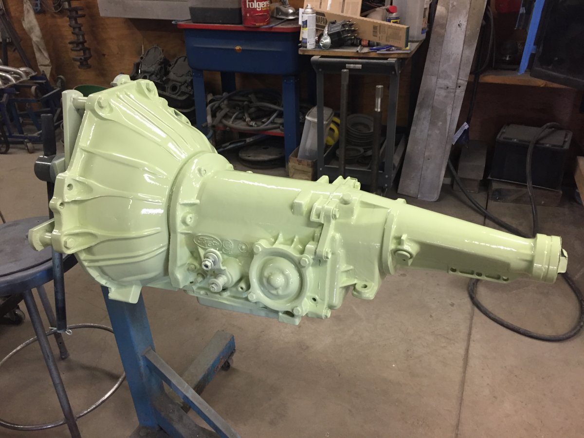

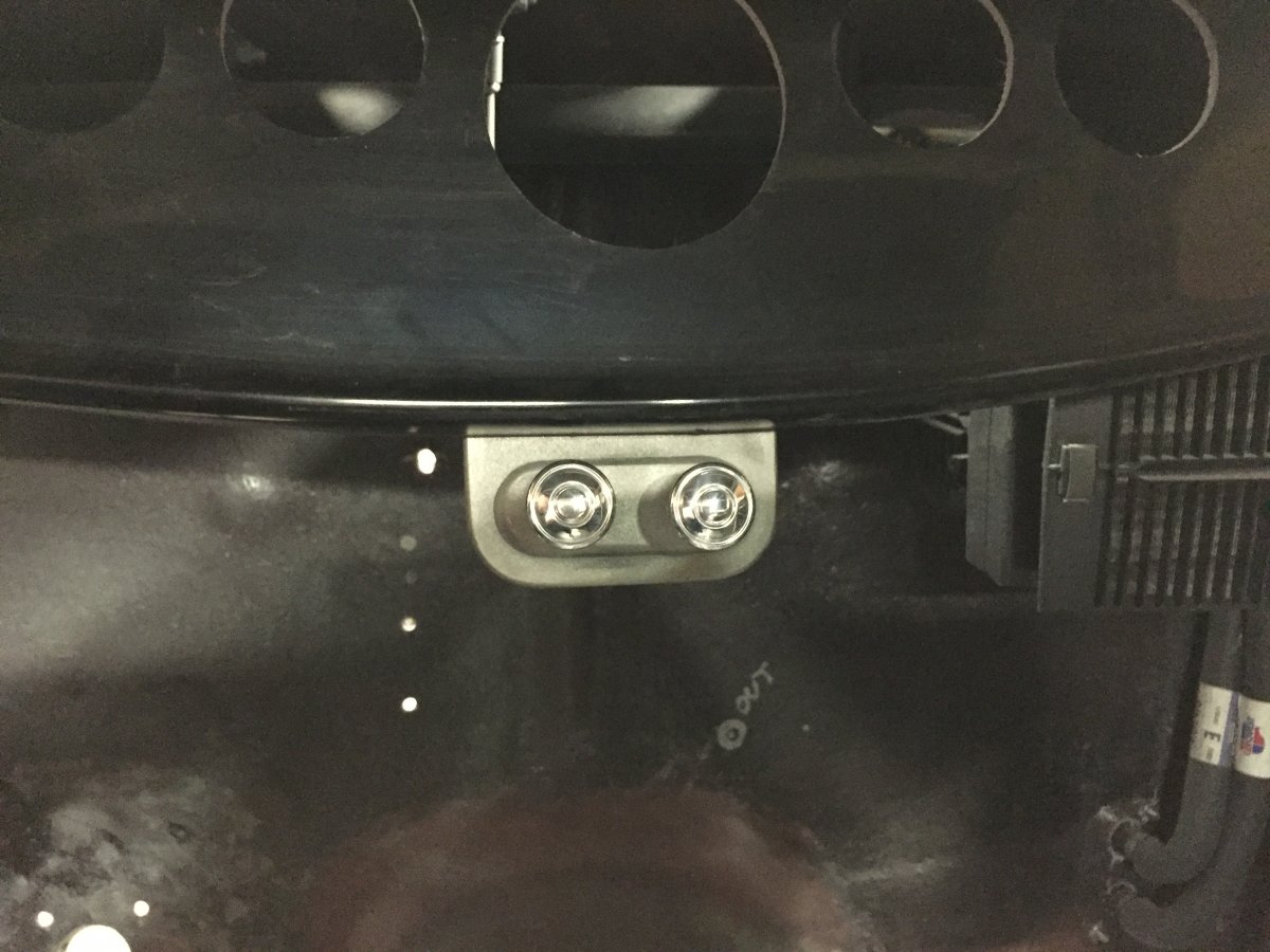

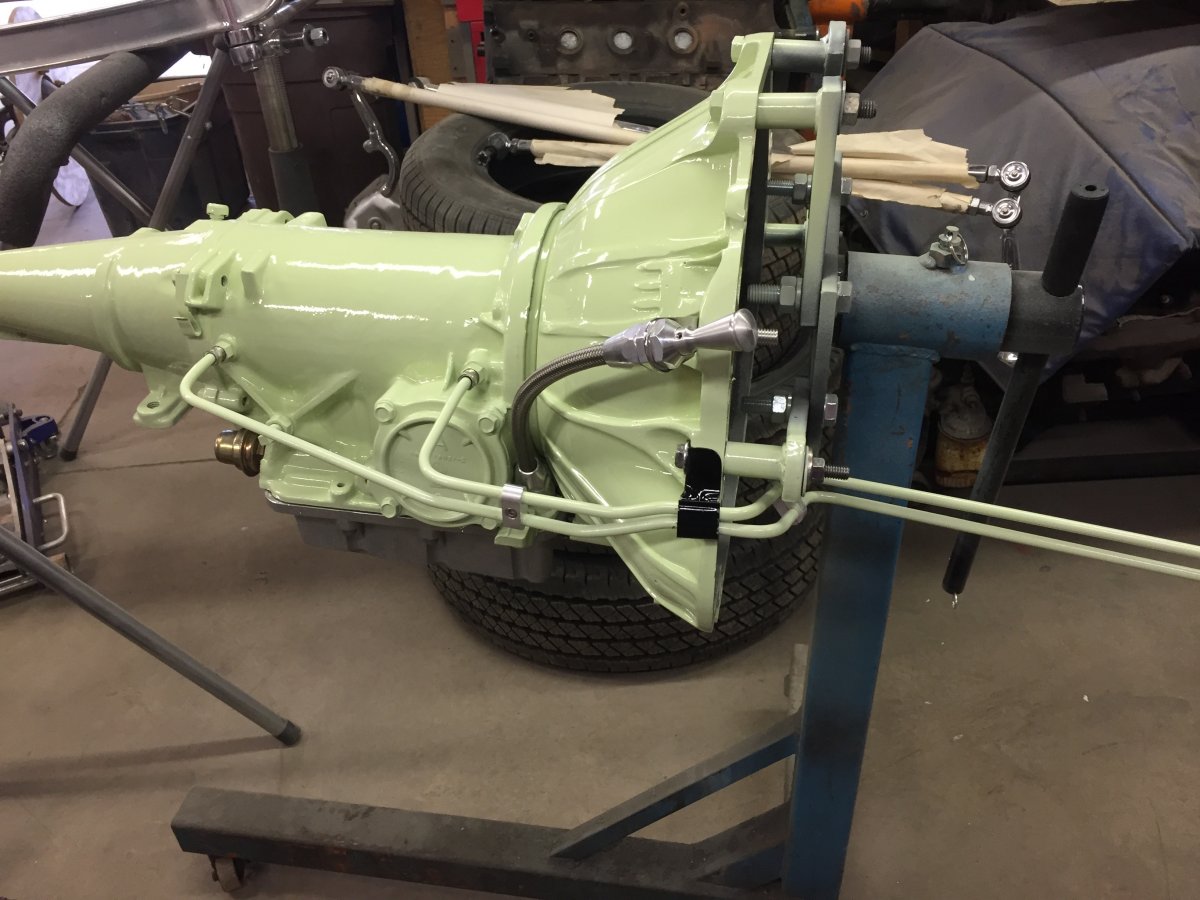

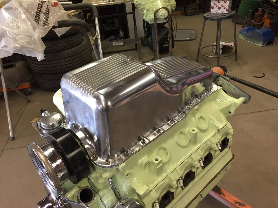

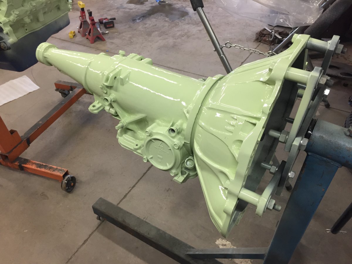

    Spent the rest of the afternoon getting the ****** ready. Installed the deep TCI aluminum pan and extended sump, got the brackets on to make the Lokar shifter work and added a Lokar dip stick tube. Have the special flex plate that adapts the 50oz imbalance 5.0 engine to the earlier C4 converter and a set of ARP flex plate bolts ready to go, too. Getting closer all the time!
    SPark

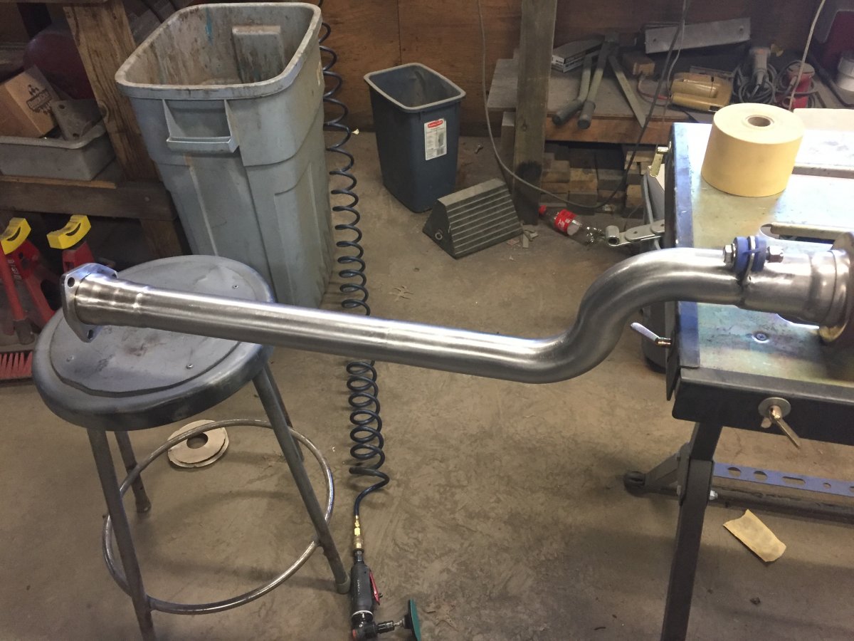

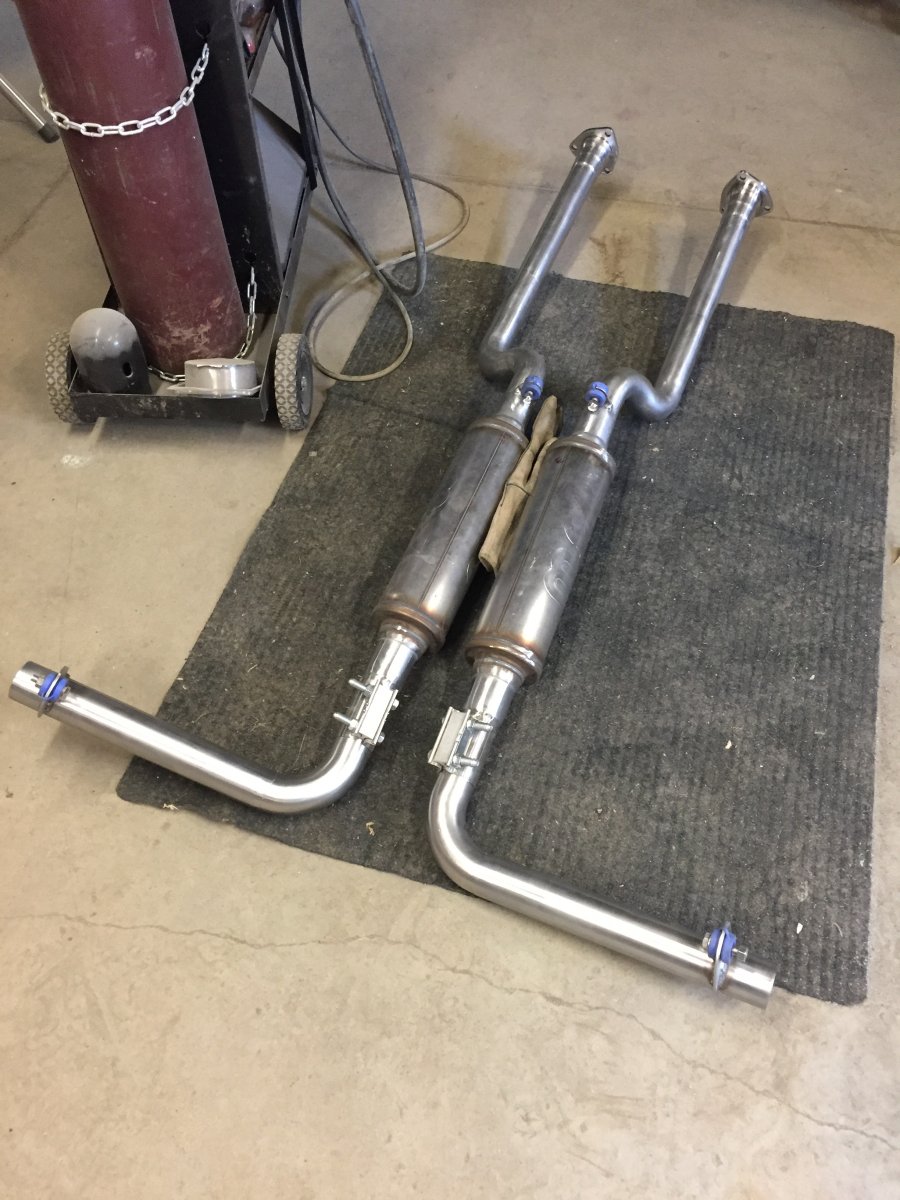

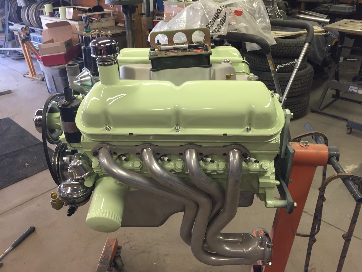

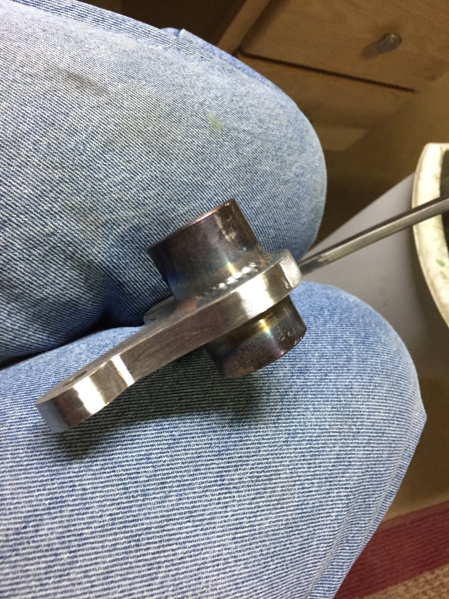

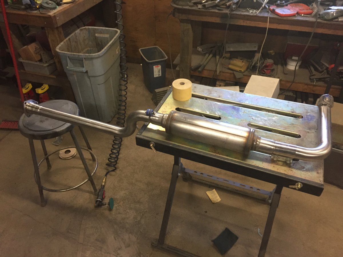

    Spent the last couple days welding the exhaust. Had it tacked, just needed to finish it up. Used stainless wire and it welded pretty nice. Ground the welds, sanded and finished with Scotch Brite for a satin finish.
    Had my 2nd Avastin infusion Wednesday. Little tired but otherwise doing good it seems. At least able to work a few hours at a time then take a little rest before going back to work on the car. Eating/drinking good again, things tasting almost normal. Even drank a Pepsi again! Been doing more running around and getting out a lot more compared to previously.

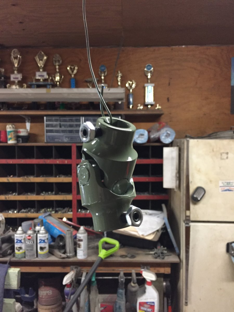

    It’s the little things that take time.

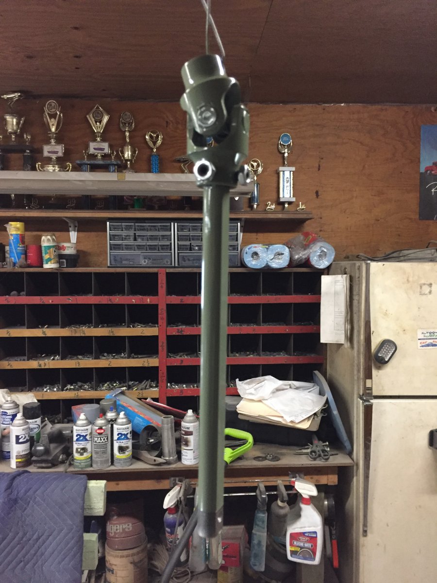

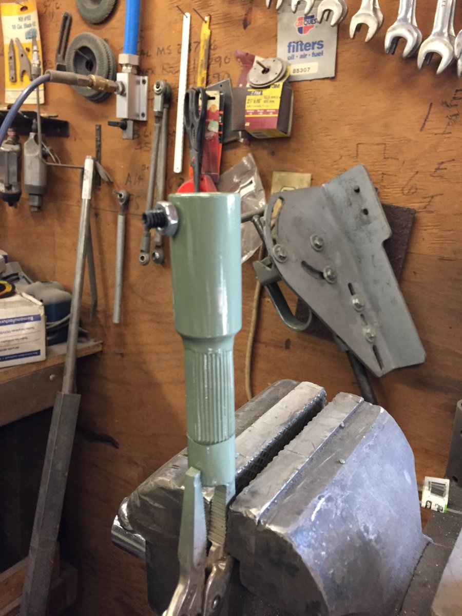

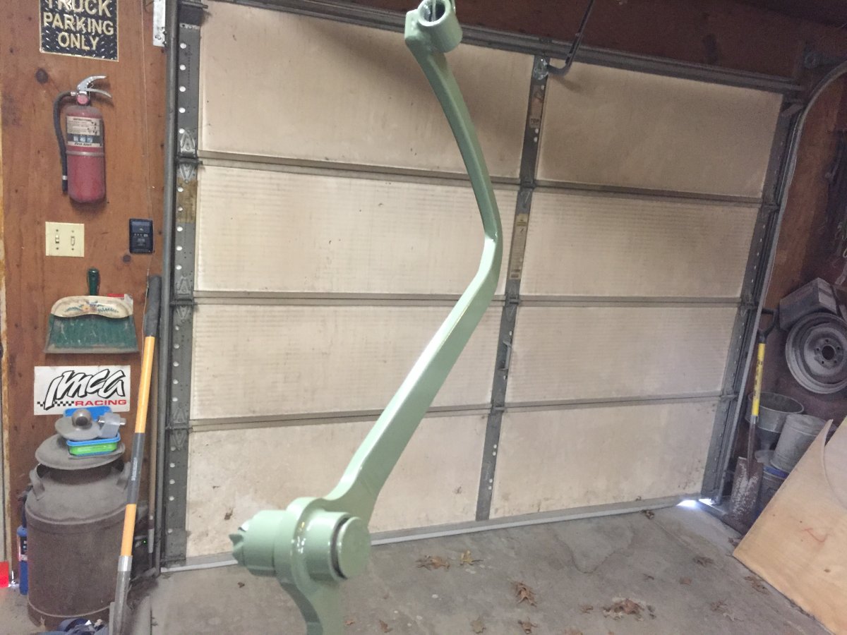

    Drilled all the set screw dimples in the steering shaft, cleaned everything up, primer and paint is on!
    Reworked a set of Billet Specifically dash knobs to fit my headlight and heater controls. Headlight fits straight out of the package. Heater knob took some time with the Dremel to make a 3/16 hole into a 1/4” -2/3 round hole. Took my time and snuck up on a nice tight fit. These kind of mimic the ‘41 Ford hubcaps and the air cleaner to keep the theme going.

    More of the little things. Got the steering shaft put together. Done!

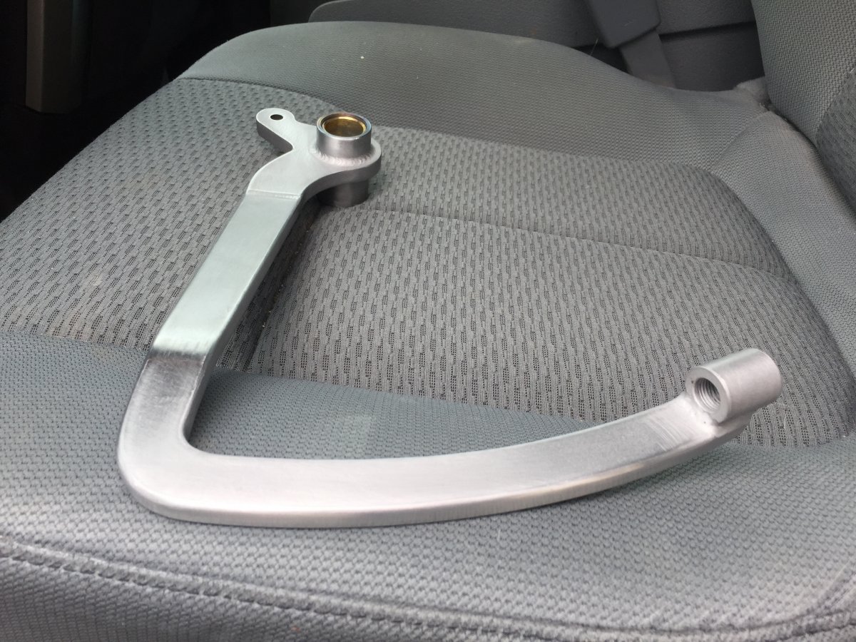

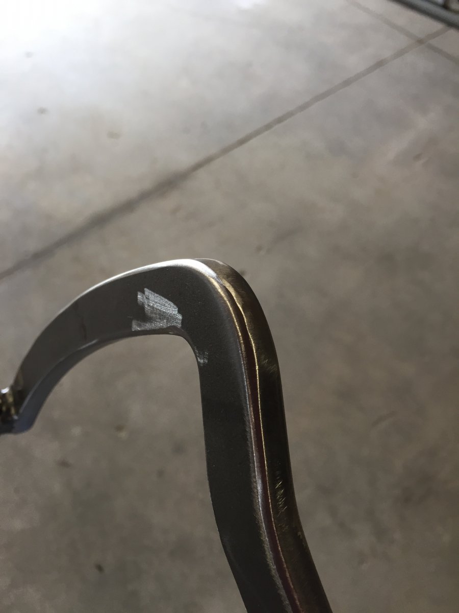

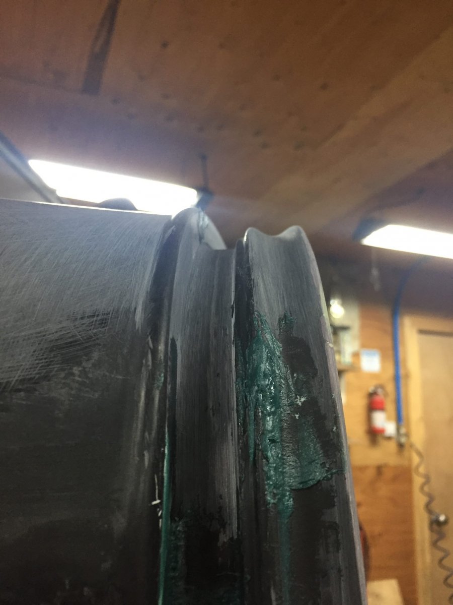

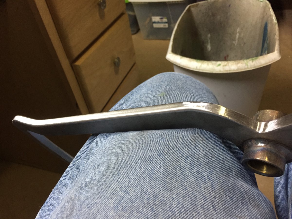

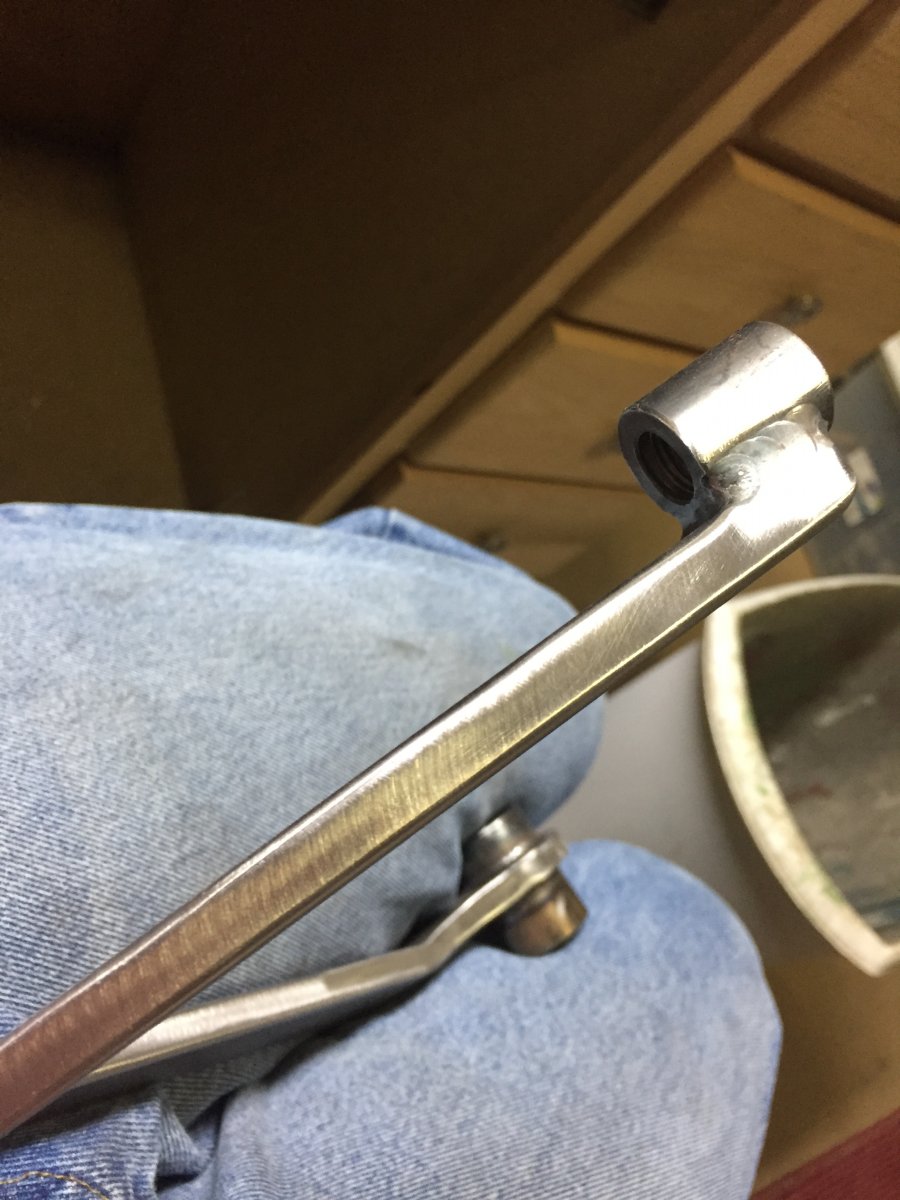

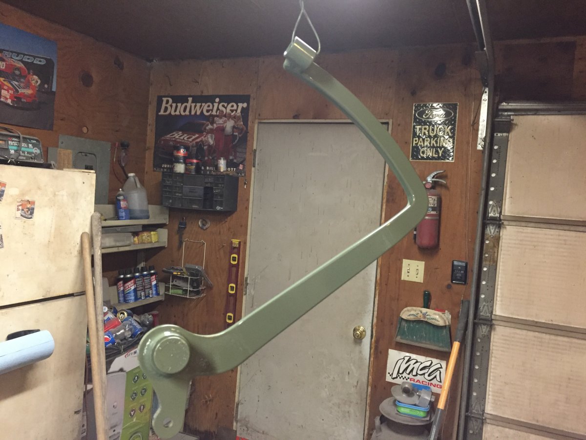

    Spent all morning grinding, sanding and shaping the brake pedal. Pretty rough to start with (forgot to take a “before” picture). Rounded all the sharp edges with a nice radius, sanded all 4 sides of the beam down, bead blasted, sanded, sanded some more, primed and painted. Done!
    Put all the ****** cooler lines back together after paint. The part between the flex line and radiator connections will have to wait until the engine and radiator are in their final locations. May still need to shorten and re-flare the hard lines on those 2.

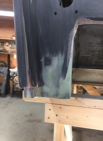

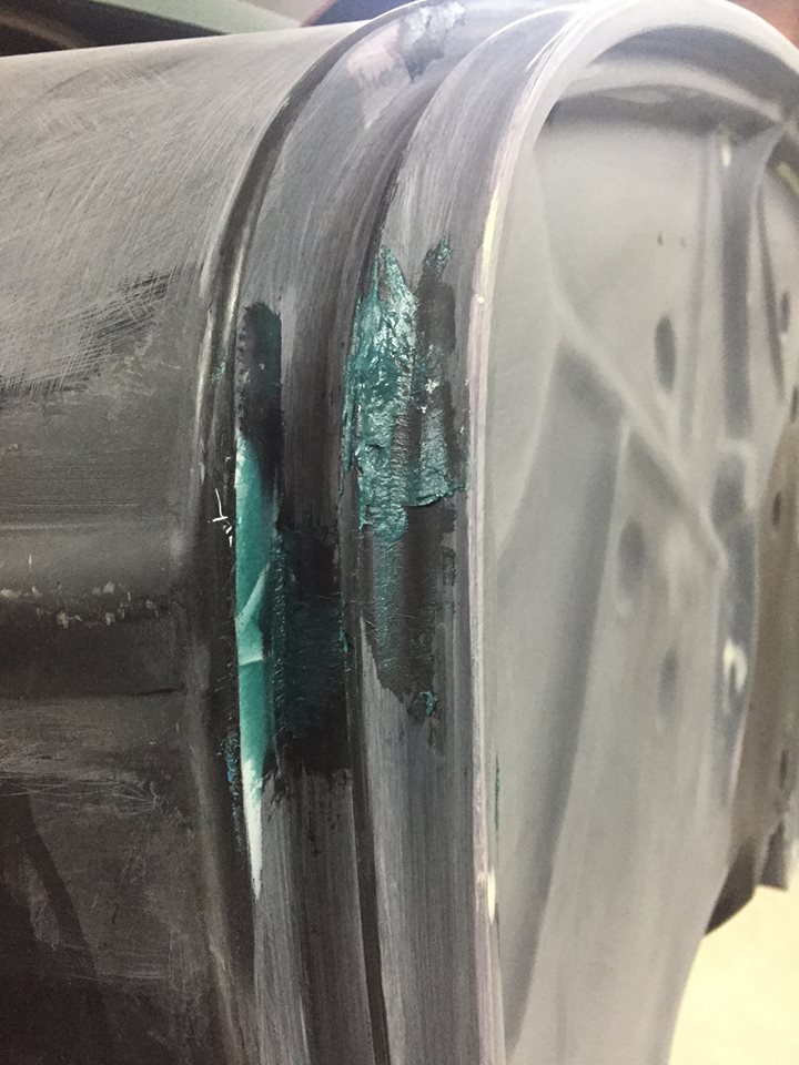

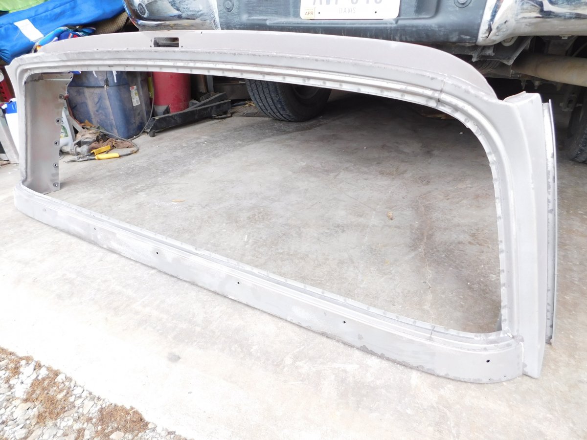

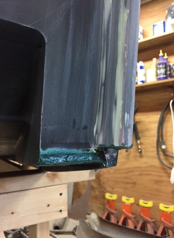

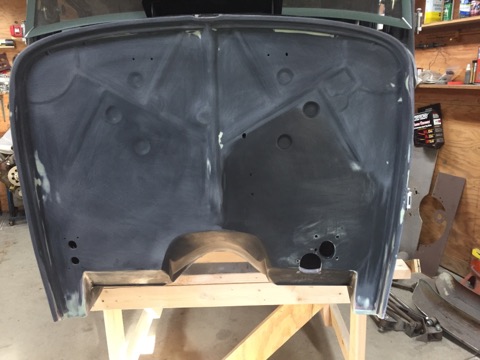

    Couple days working on the firewall. Filled all the voids in the fibergl***, fixed a few low spots and trued up all the edges. My damned AFIB is back as of last night so it's sand 10 minutes, breath and get blood back into my muscles and joints for an hour or so. This will be 2 months of fun getting that reset! Firewall came out good though.
    Sent the "T" project to it's new home so I have more room now.
    SPark
    firewall12.jpg firewall13.jpg firewall14.jpg firewall15.jpg firewall18.jpg firewall25.jpg firewall26.jpg firewall27.jpg firewall28.jpg firewall29.jpg firewall30.jpg firewall31.jpg firewall32.jpg

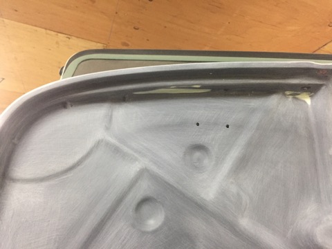

    More firewall work, mostly the hood lace area and the rain gutter behind it. Drilling out pin holes and filling with kitty hair. Hopefully the last day of this operation. Lack of oxygen to the muscles really slows a guy down!
    On the other front, primer is flying on parts getting ready for color.

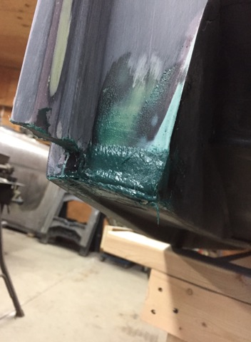

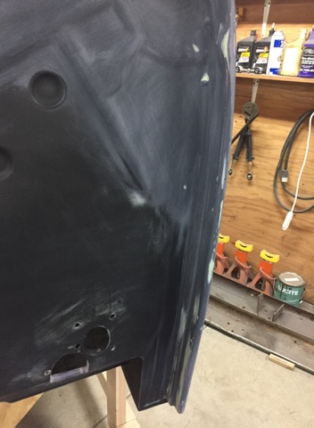

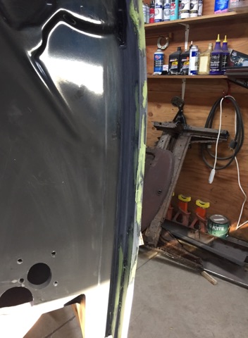

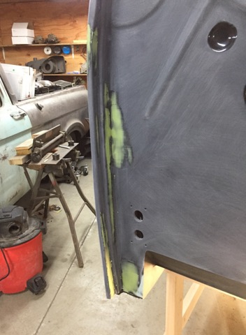

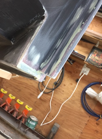

    Got the firewall and cowl area immediately behind it all ready for paint. Filled a lot of air bubbles, straightened some seams and joints, got a nice looking firewall out of the deal. All in all spent about 5 days on it. Well worth the effort.

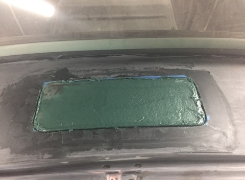

    When I replaced the New Age Motorsports fibergl*** cowl vent with a steel United Pacific one, it didn't fit the hole quite as nice. Ended up creating a thin, tapered shim to place between the cowl lid and the hinge mechanism to better center and square the vent lid on the opening. Also had to slot a couple holes to raise it up a touch. Got everything put together tonight and started mud work on that area. Little kitty hair to build it up and then we'll start with the Rage Gold. Won't take much to make it look really good.
    Last bit of Good News? Paint is flying at the paint shop! Started with the dark green stuff today. Got the brakes all painted and a few other smaller parts. Should have a load to pick up and bring home yet this week I'm hoping at this rate. Want to put the rear end back together and with the brakes I can also put the front end all back together. We're actually making progress now!

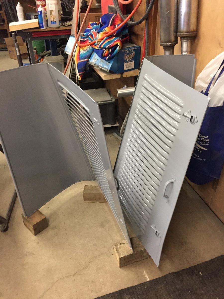

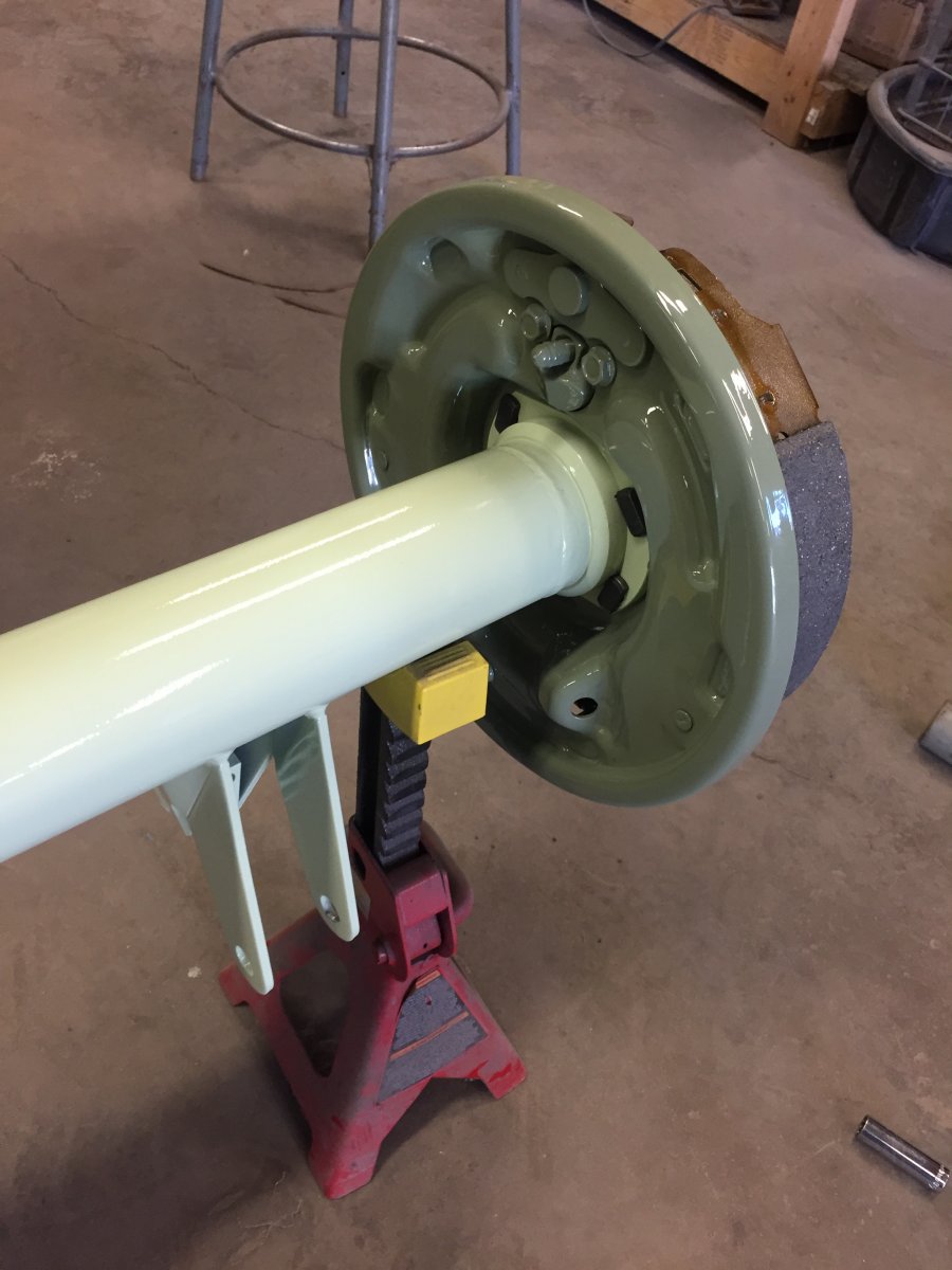

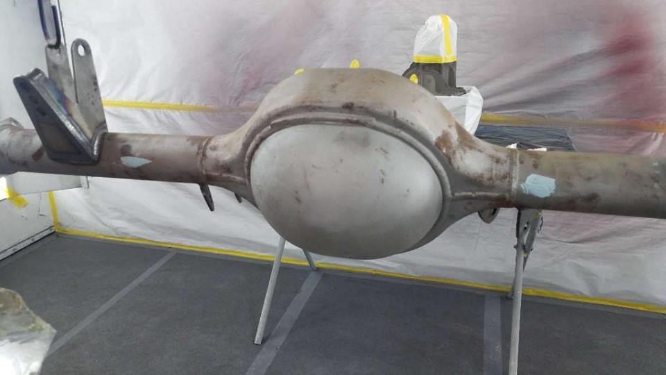

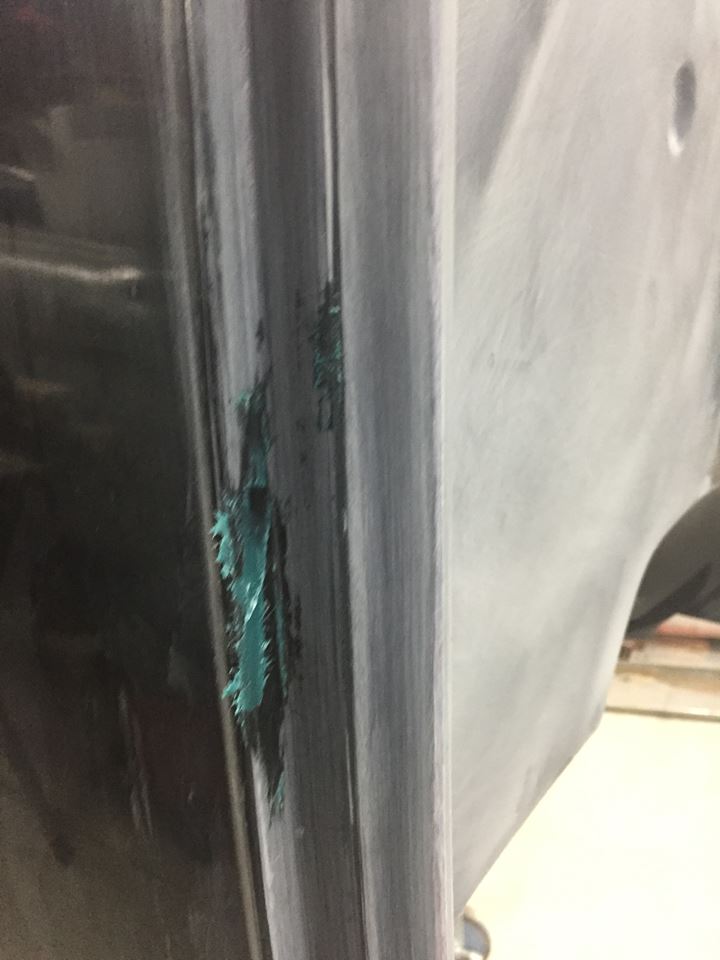

    Stopped at the painter’s today. Brought home some shiny stuff! Frame and hood are sealed with epoxy, everything else is in final color. Getting ready to start body work on the frame and make things smooth. Can re***emble the rear and get all the front back together except the rotors.
    Got my infusion yesterday. Also got clearance to get my heart reset next Wednesday. Will go good to have oxygen in my body again.
    After the infusion we stopped at a fabric store and picked up the burlap for the spring wrap and some hi density foam for the seat.
    I’m usually a bit cranked up after an infusion and with my heart out of rhythm I wasn’t going to sleep last night. Got on Summit’s site and ordered a Pertronix distributor, coil and wires, Edelbrock fuel pump and a couple Borla mufflers for my ‘62 unibody build. Time to get back on that build, too.
    We’ll take progress anywhere we can find it!

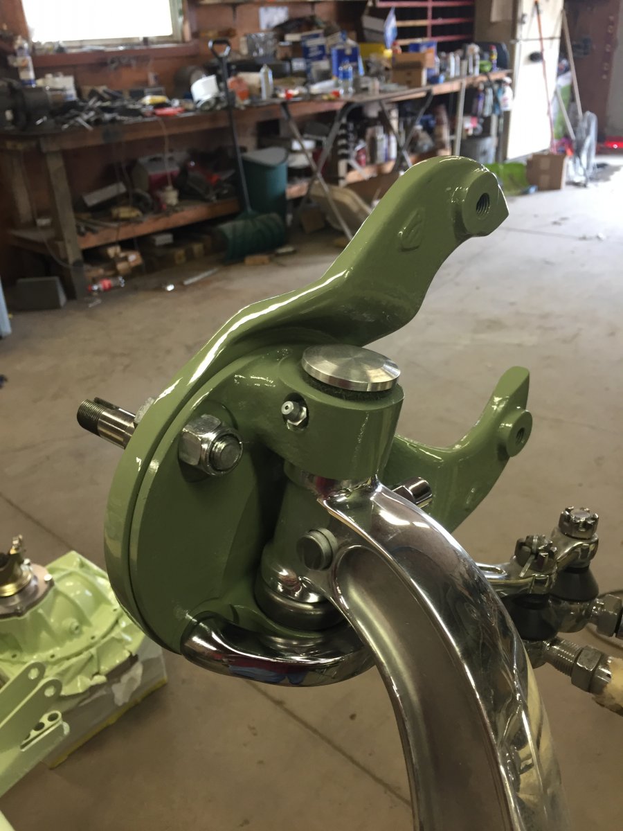

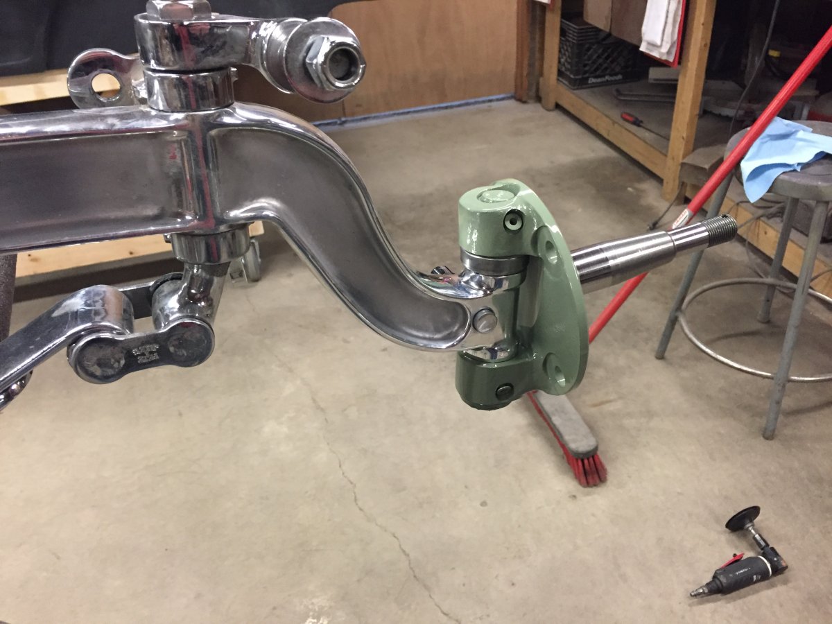

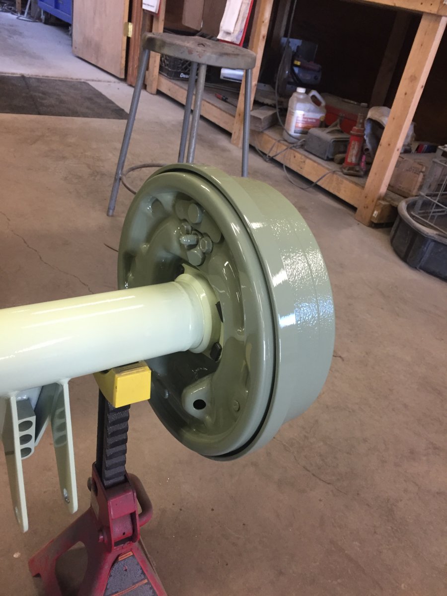

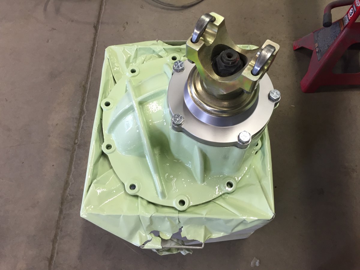

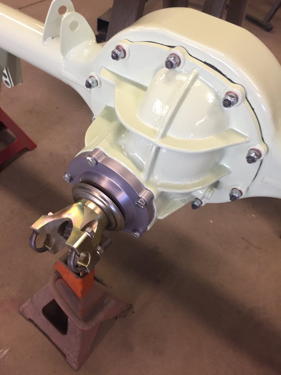

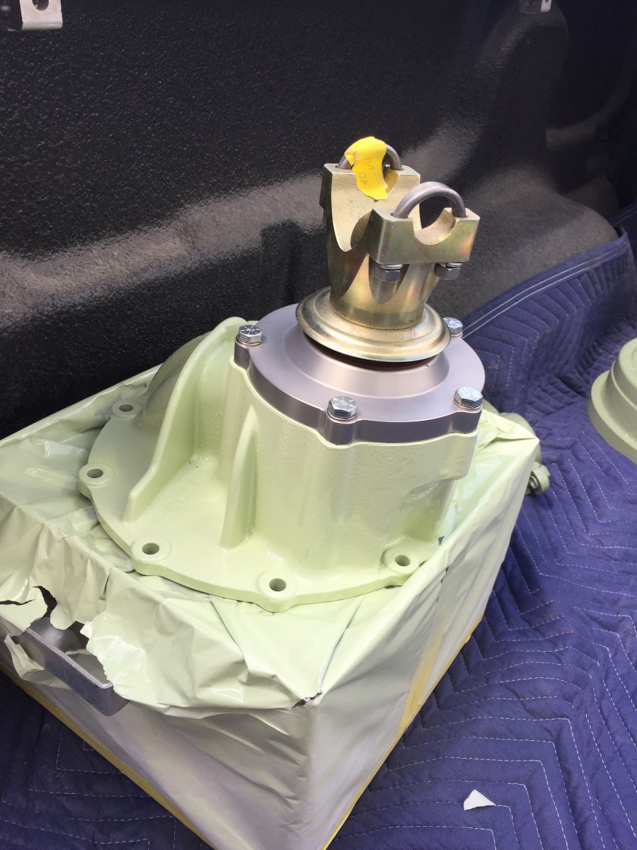

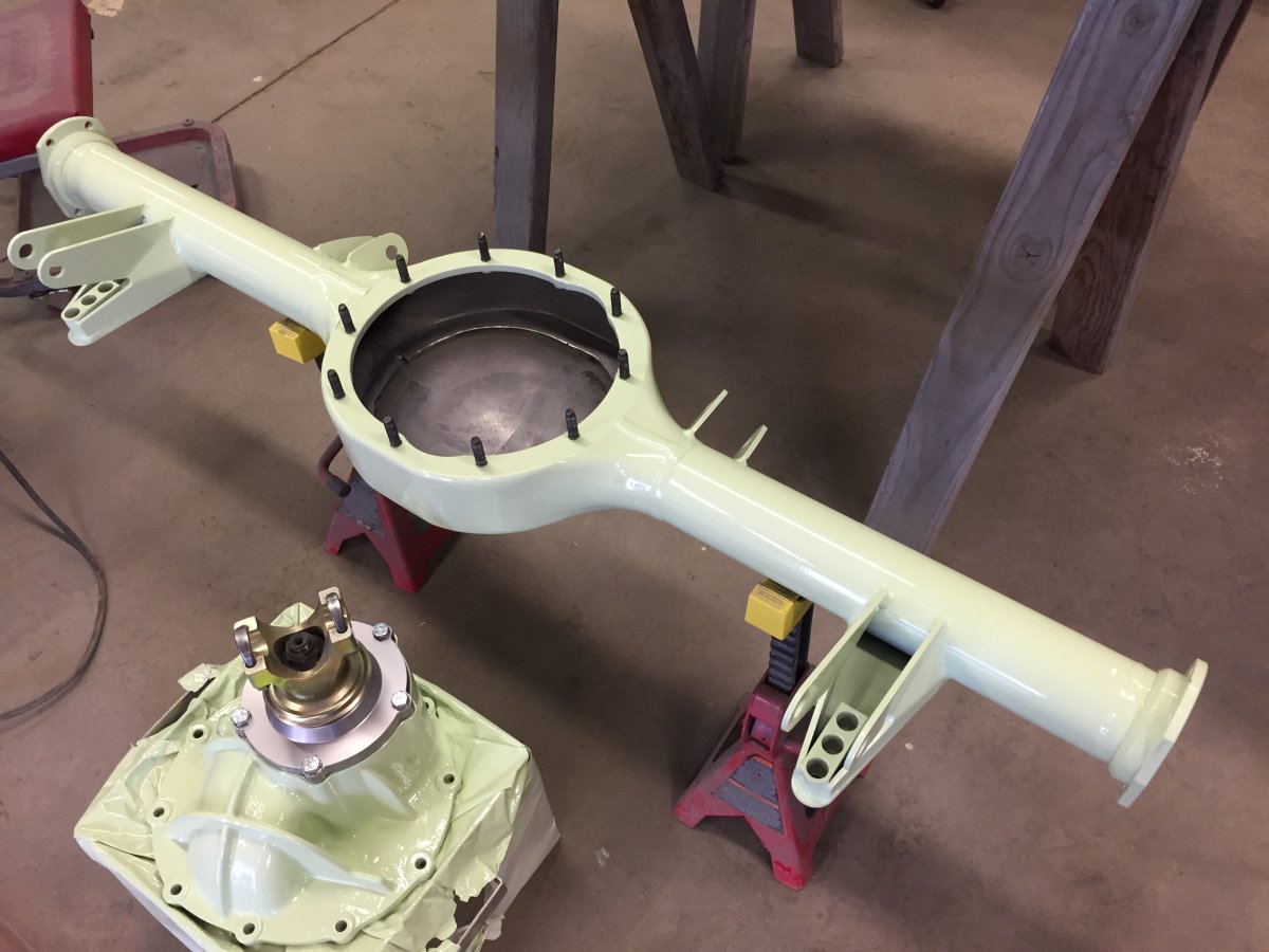

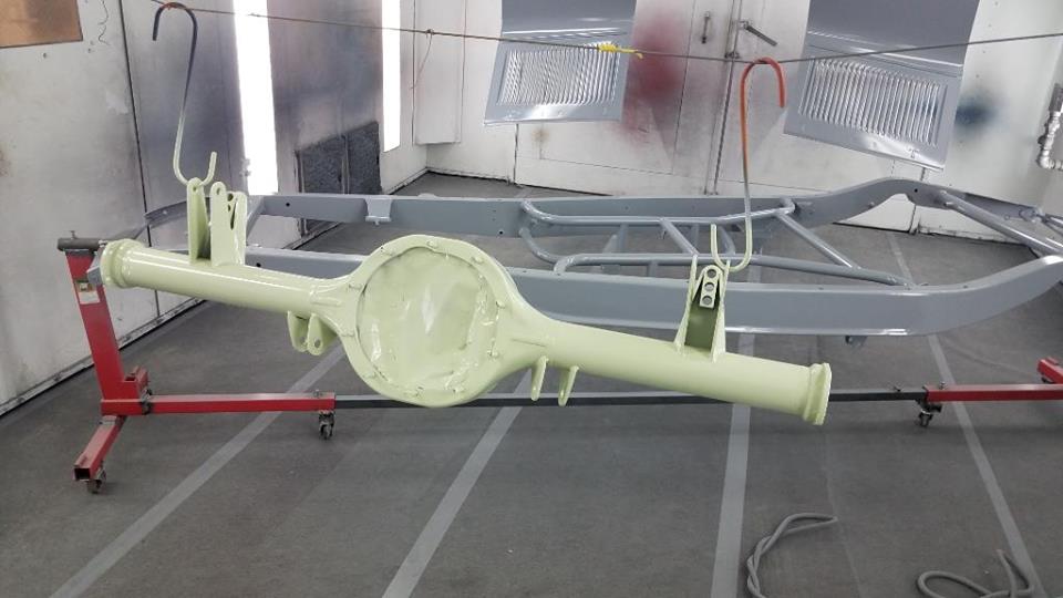

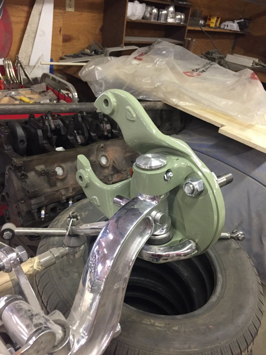

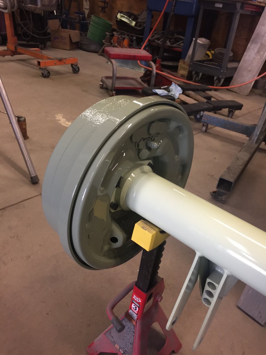

    Got the brake brackets and steering arms back on the spindles. Waiting for the rotors to get some paint. Then I can ****on up the front end.
    Also got the rearend put together. Sure is nice working with new, clean, painted parts. Not something I have much experience with. I’ve always been a “primer is plenty good” type guy. The wife wanted paint and interior on this one, a real finished car. She doesn’t even squirm when I tell her what these things cost compared to my usual way of doing things.

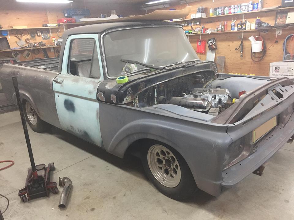

    I had the worlds best Shop Teacher in Jr. and Sr High School. Those first 2 pictures were taken 53 years apart! We had a foundry, welding/cutting, mills and lathes, engines and electronics as parts of those cl***es. I just got together with my old shop teacher last week. He was a sprint car racer and we are restoring one of the cars he drove (Bob Trostle's 2nd personal sprit car/modified that was in Hot Rod Magazine in 1966).
    I have owned IMCA Stock Cars (2 years), dirt late models (13 years) and IMCA modifieds (5 years) plus 5 years as crew chief on another person's car. It was all fun. Was just getting into USacSilver Crown cars the last few years. Had an old high school friend that owned a team and I was asked to come along and help. Jack Hewitt was his team manager and Jeff Swindell was his driver. Lots of fun but that team no longer exists since my friend p***ed away this past winter
