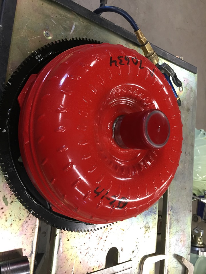

    Got a few shipments of parts yesterday. Got the converter for the ‘32. Looks like it will work just fine (if I picked the right stall speed).

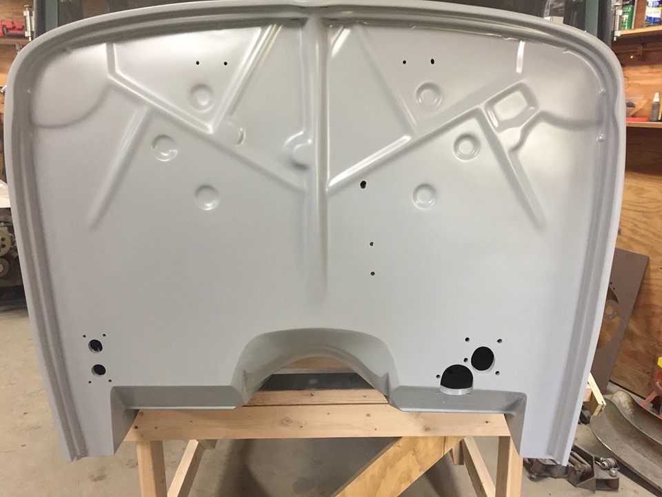

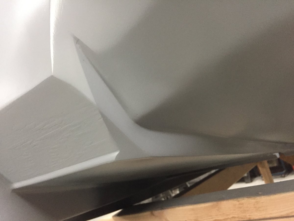

    Firewall is ready for paint! This is how it will go to the painter's shop. My fingertips are gone. My phone won't open anymore without using my p***word. Fingerprint recognition is useless now.
    Do have a couple little areas to finish up in the ****** tunnel. Only 1 will need filler, the others are some rough spots that should sand out.
    Have 5 areas to do some clearance work on the bottom of the floor then it's ready for color. Getting closer every day!
    Will also probably drill my holes for the wiring and battery cables to p*** thru the floor before it gets paint.
    Got a call yesterday afternoon and he was painting more parts. Front rotors, firewall feet, wheels and a bunch of smaller parts should be green by now! Progress!

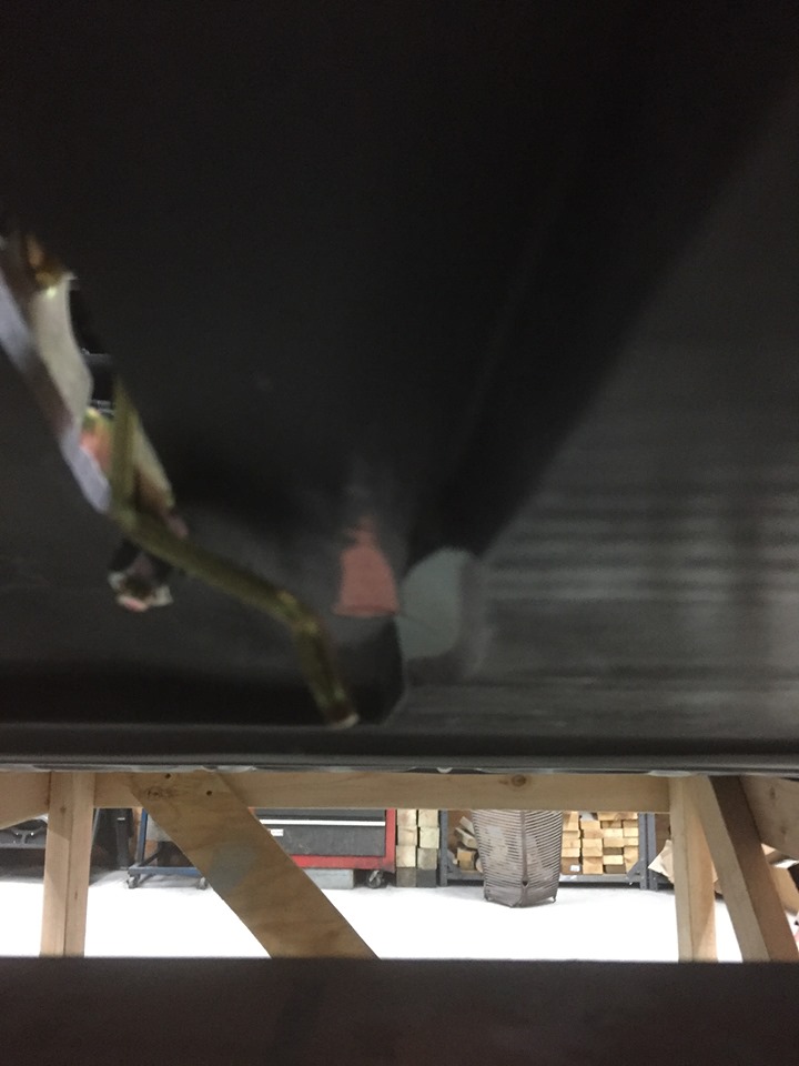

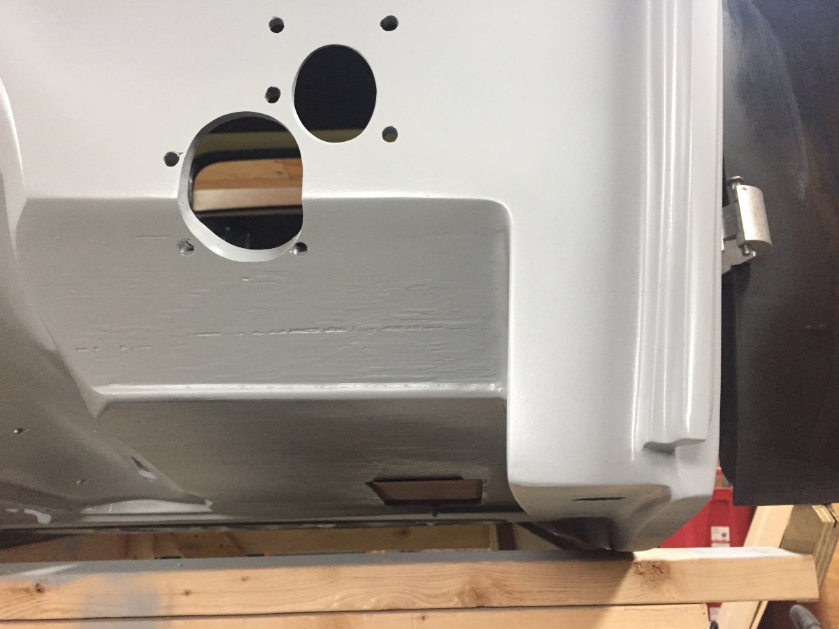

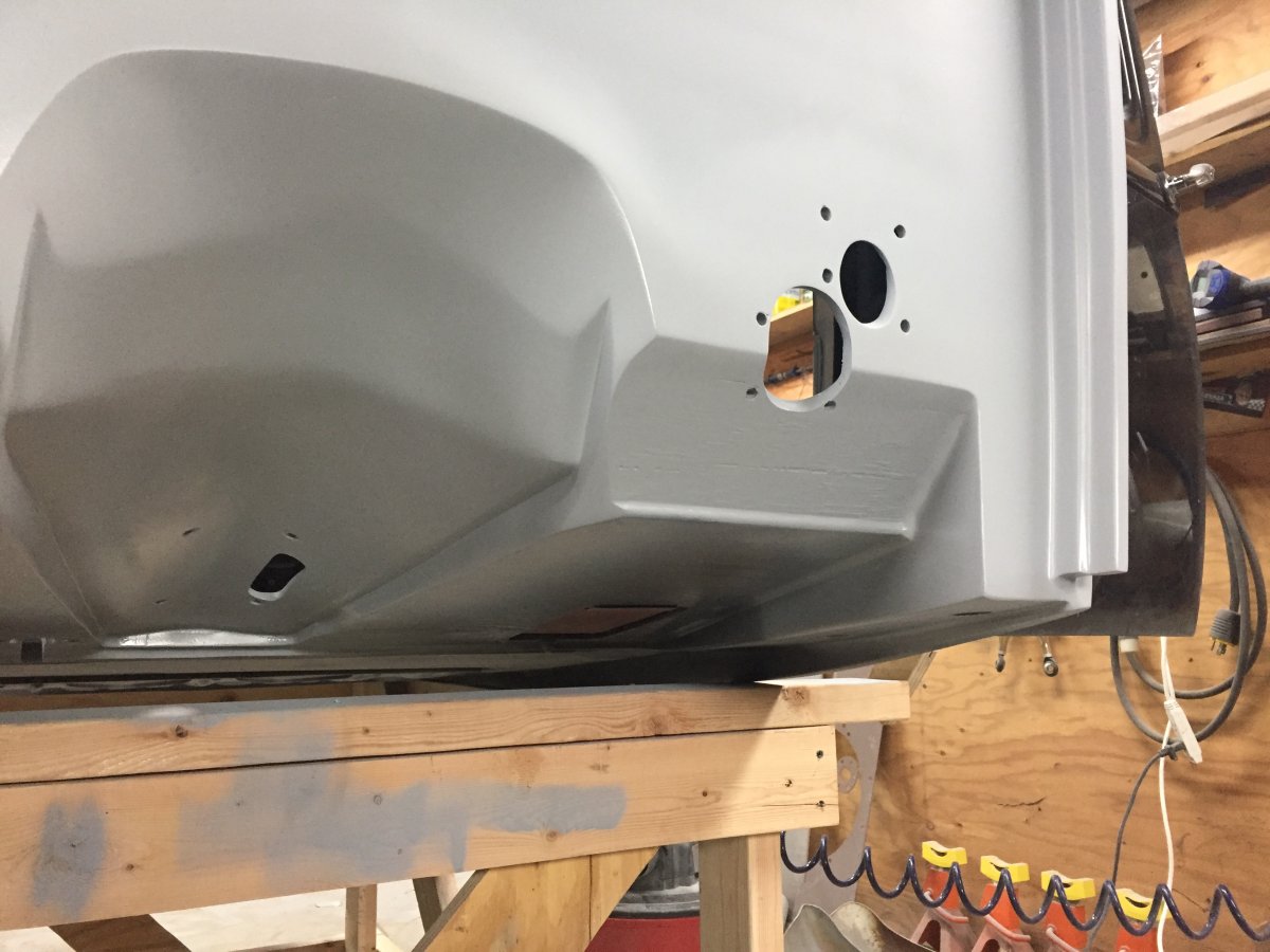

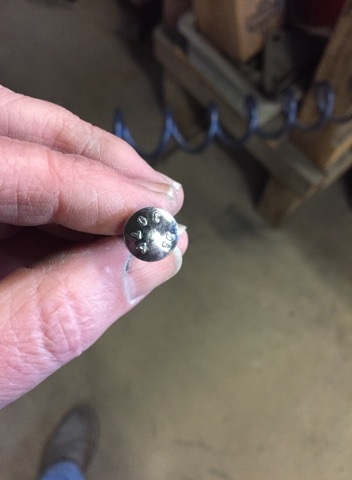

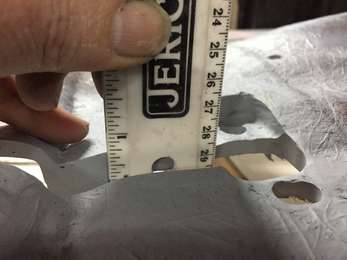

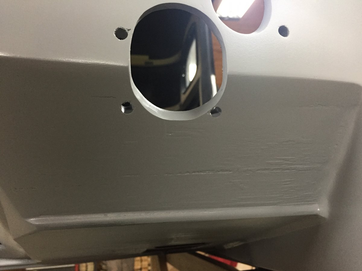

    Finally made myself crawl under the body and work on the bottom of the floors this evening. Had a couple issues to deal with I've been putting off.
    First, had one 1-1/2" tubular crossmember that hit a few of the stiffening ribs on the bottom side of the floor. Decided the cleanest thing was to make a straight notch across the bottom of the floor and remove some of the height of the ribs. Quick p*** with a 1-1/2" sanding drum followed by a 15" length of 1-5/8" tubing with sticky back sandpaper to true things up. Worked well, but if you are in AFIB like I am, it wears you out fast. Don't keep up with oxygen and my muscles start to bun really fast, especially working overhead.
    The other thing I needed to deal with is the 4 mounting holes for my battery box. They landed right on another rib. I took a cone shaped grinding stone, fed it up from the bottom (cone point down, shaft up thru my mounting hole) and used the flat backside of the stone to grind a flat spot centered on the mounting holes. Worked pretty well, now I have a nice flat spot on the rib for each bolt to tighten down on. Just the right size for a washer and nut. Little cleanup work there tomorrow and that job will be done. Need to fill the topside of that rib in the interior for a solid base for the battery box.
    Next is finish the ****** tunnel. Couple gouges to fix and some clearance work for the shifter cable to take care of. Hope to get that all done before my next infusion on Wednesday. Get those items taken care of and the floor and firewall are ready to go to the paint shop for some color!
    SPark

    The quality and quan***y of your work is really nice. Thanks for the carriage bolt tip, it will come in handy soon. I have been wondering about the Trostle car thread, is it still active?

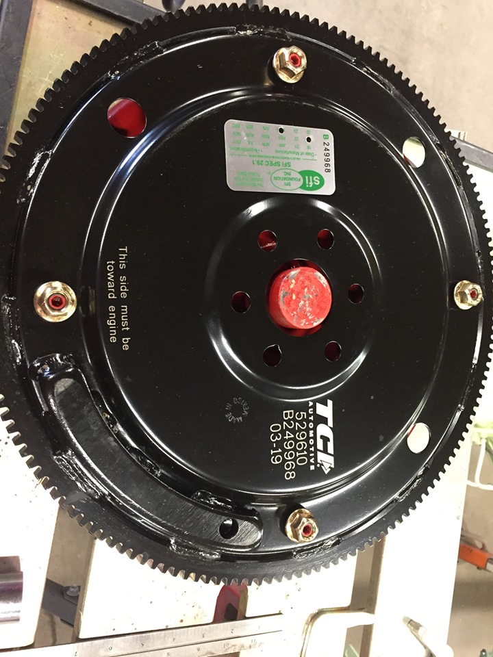

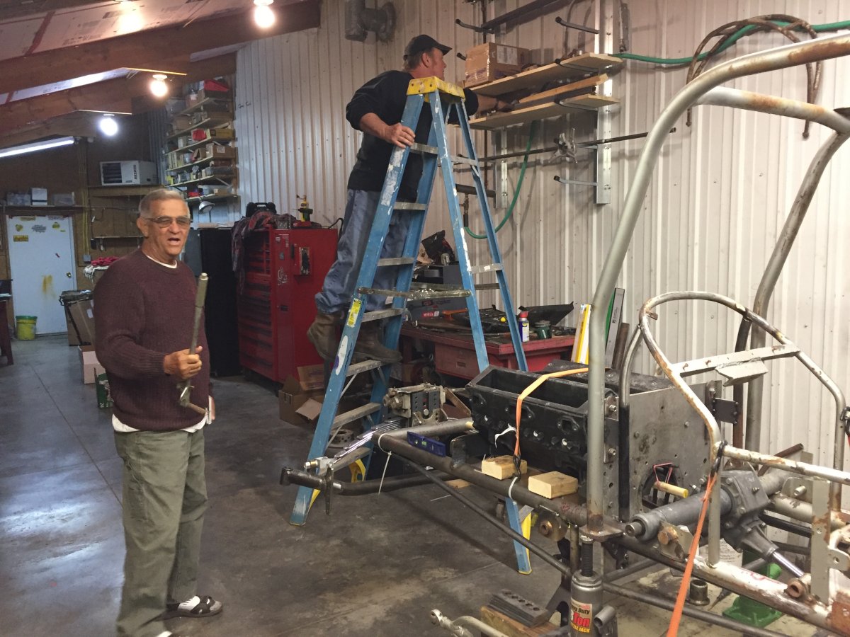

    We’re still plugging along on the Trostle car. Frame is repaired, engine placed and one of the original drivers stopped by to check it out the other day. Waiting on a steering box to show up.
    By the way, that old driver is my school shop teacher that learned me all this great car stuff!

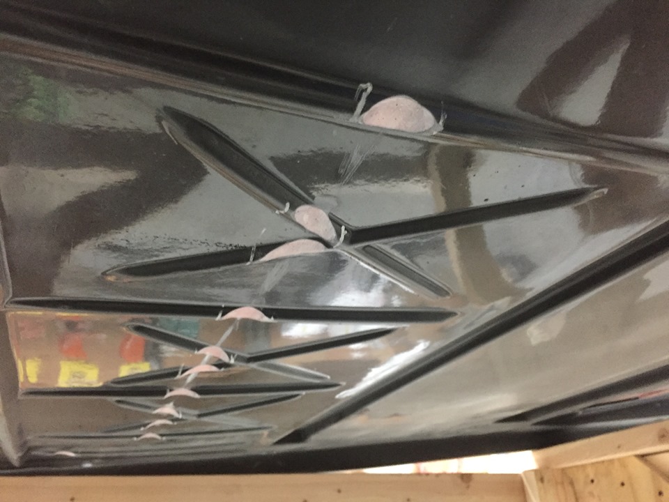

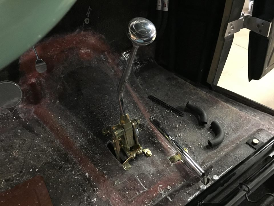

    Can’t sleep? No problem. Get to work on things you’ve been putting off. Hate sanding overhead, especially while in AFIB. Muscles start burning after 2 or 3 minutes like you've worked them for an hour straight.
    Filled the last of the “blemishes” in the ****** tunnel.
    Did a little clearance work for the shifter cable.
    Fill primed the notch across the bottom of the floor.
    Filled an indentation on the top of the floor so the battery box will sit flat on the floor.
    That can all cure and be ready for sanding later today.

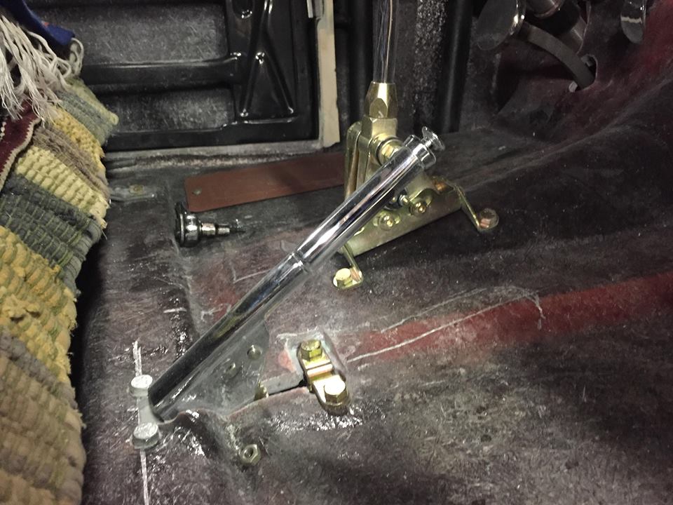

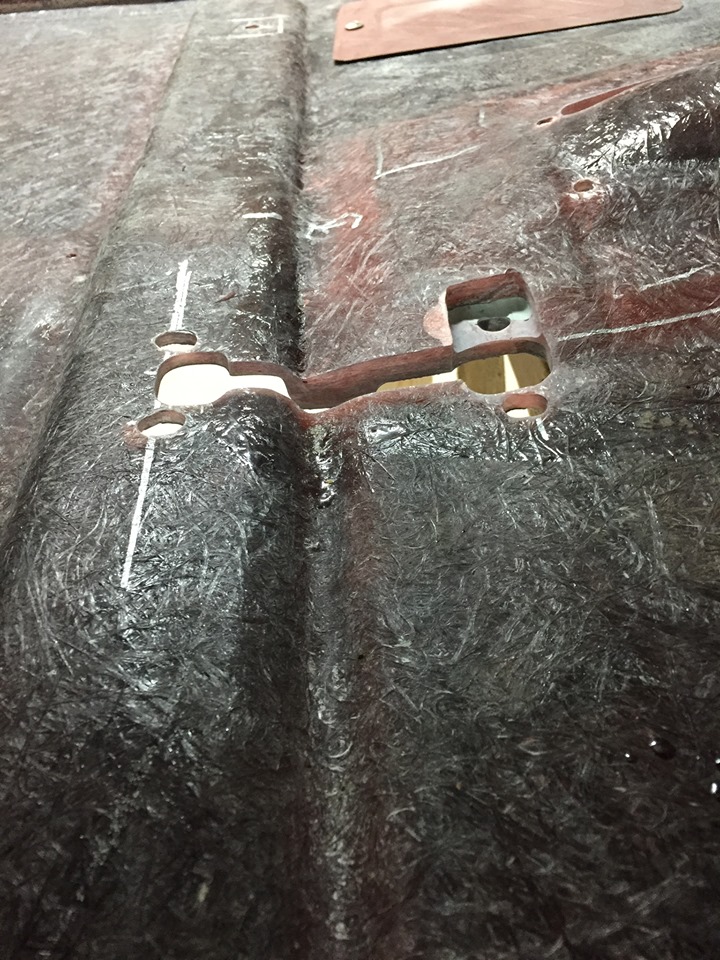

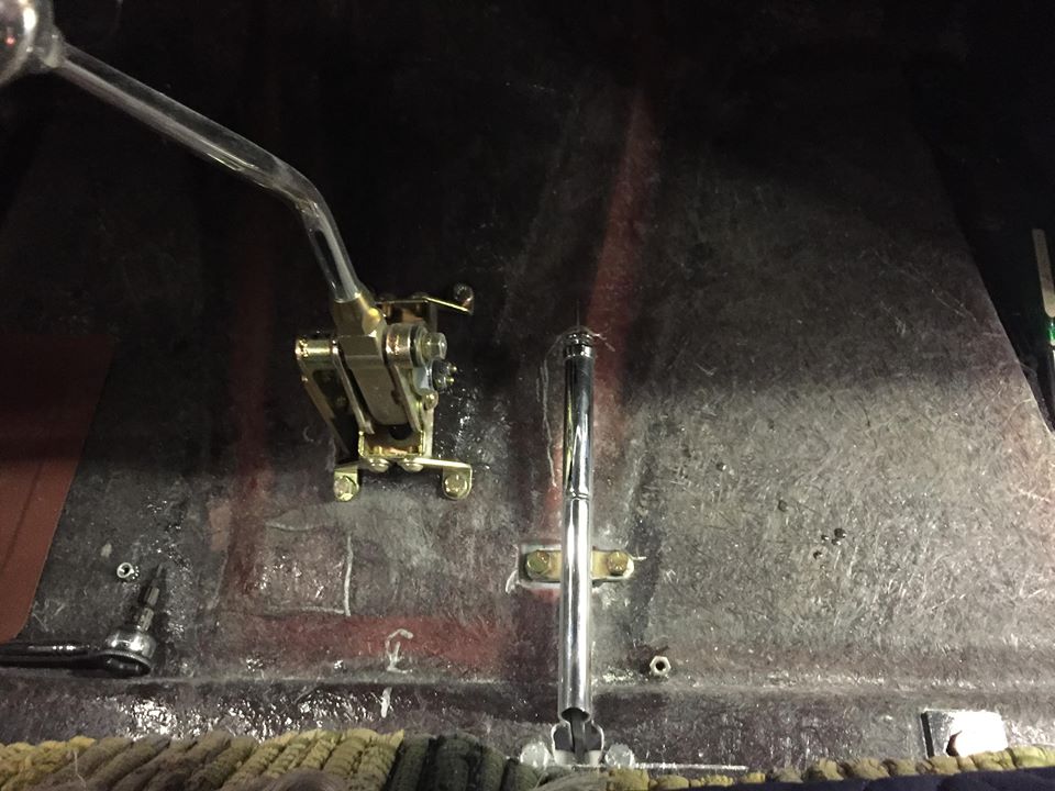

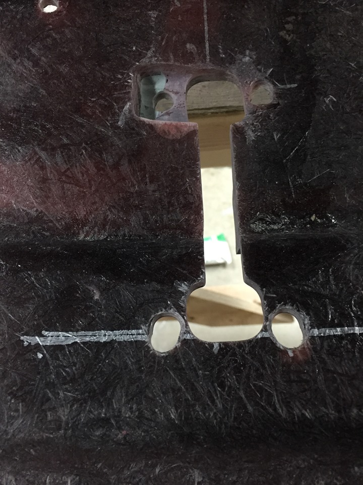

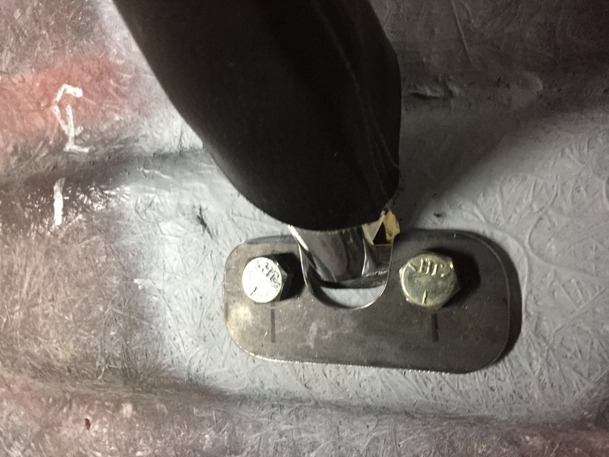

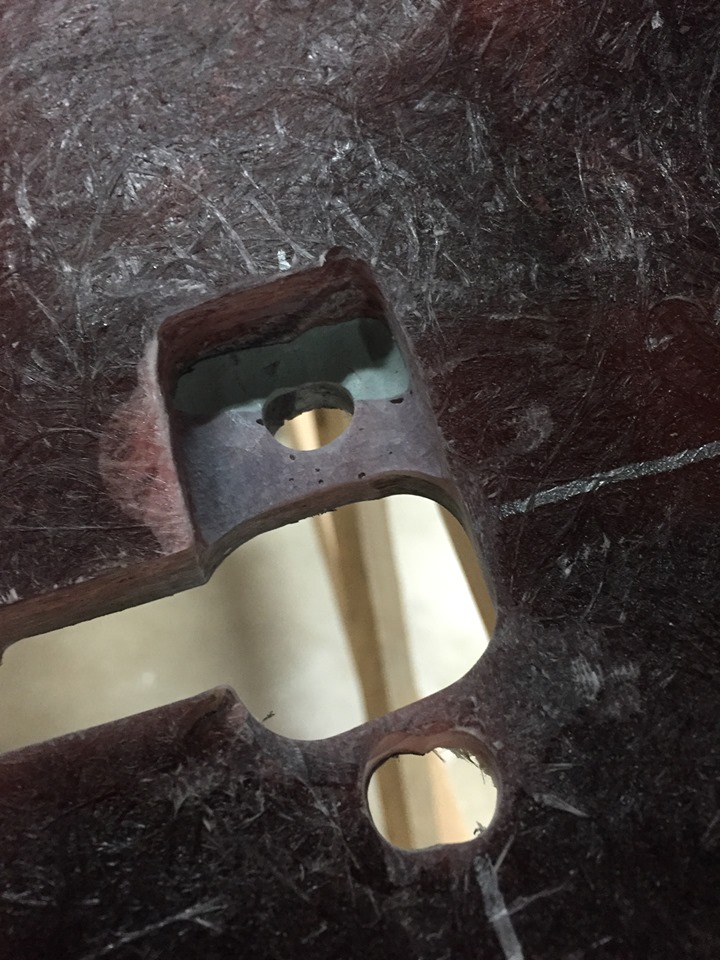

    Felt artistic this morning. Completed "carving" out the holes for the emergency brake lever and the shifter. Now to build the spacer needed to keep the brake lever level, the rear feet sit under the seat rail and the front feet sit partially on the trans tunnel. Had to get creative and I think this will work.
    SPark
    ebrake1.jpg ebrake2.jpg ebrake3.jpg ebrake4.jpg ebrake5.jpg ebrake6.jpg ebrake7.jpg ebrake8.jpg ebrake9.jpg
    loudbang, brEad and Stogy like this.

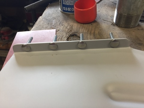

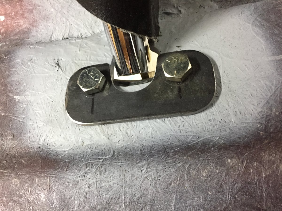

    So the parking brake is just mounted in the fibergl***? Don't you think it should be mounted in steel?
    Stogy likes this.
  13. LM14
    Joined: Dec 18, 2009
    Posts: 1,936
    LM14
    from Iowa
    Pictures added.
    It's sandwiched in steel above and below. Just not shown here. Where the washers are shown on the rear mount, that is now a common steel plate that ties both bolts together going left/right. More pics to come later tonight! There is not any real load against the lever, it's just a ratchet that pulls on the cable. With the steel above and below, it's extremely stiff with no unwanted movement when pulling it. I think it also helps that it is at the area where there is some extra thick 'gl*** (anywhere from 1/4” to 3/4” thick there, see pictures) and ribbing in the floor/seat riser for additional stiffness in that area.
    To be totally honest, I never use the emergency brake in any vehicle I have ever owned. Never needed it. This is here for state inspection then it will probably never move again as long as I own it.
    SPark
    CD3143EA-AFAD-48A0-8C65-CA46E68ACDAA.jpeg 09E69B0D-D78C-4FCC-84A2-ACC73466192F.jpeg 7D7FD7CD-EC71-4B8B-B29D-9C47A13D1C40.jpeg A604BF61-0C5E-415A-BF05-1ADDC1B6716B.jpeg 9BCE2D04-0292-42C6-97D2-F6AA6DA344F0.jpeg C092E284-1AAE-4DFC-B43F-B9ED13FB1743.jpeg

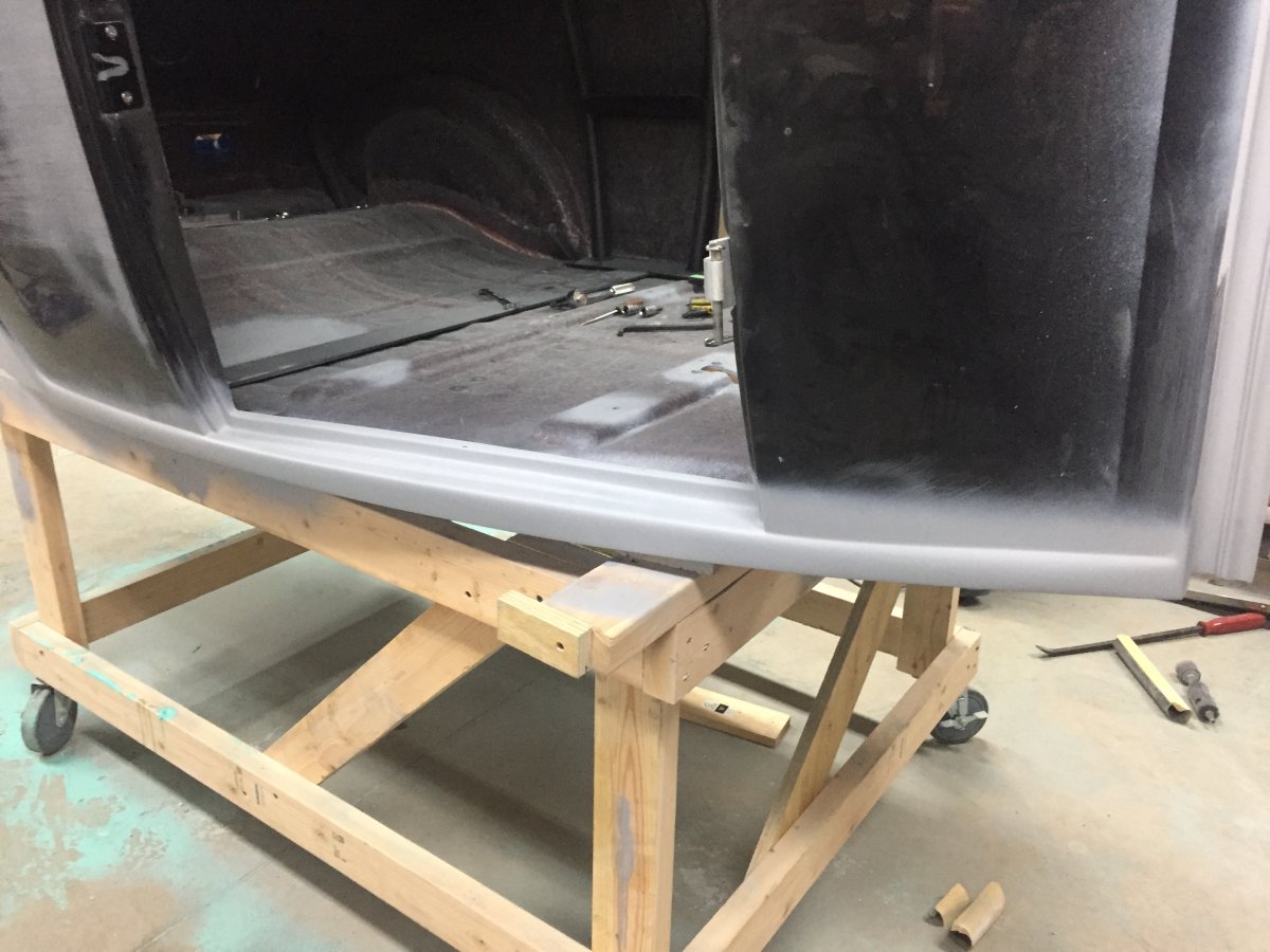

    Toe board and transmission tunnel area is done! Too much odd/upside down sanding for an oxygen depleted fat guy.
    The last 4 pictures show an area that is still rough. That is the wood floor and toe boards that the molds put a wood grain in. That’s right, the wooden floor is molded into the fibergl***. Attention to detail that makes the New Age Motorsports body one of the best available. One of many reasons I chose to wait 9 months to get one of these bodies.

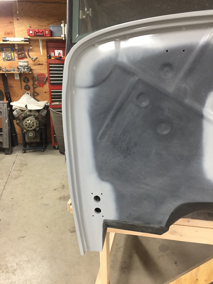

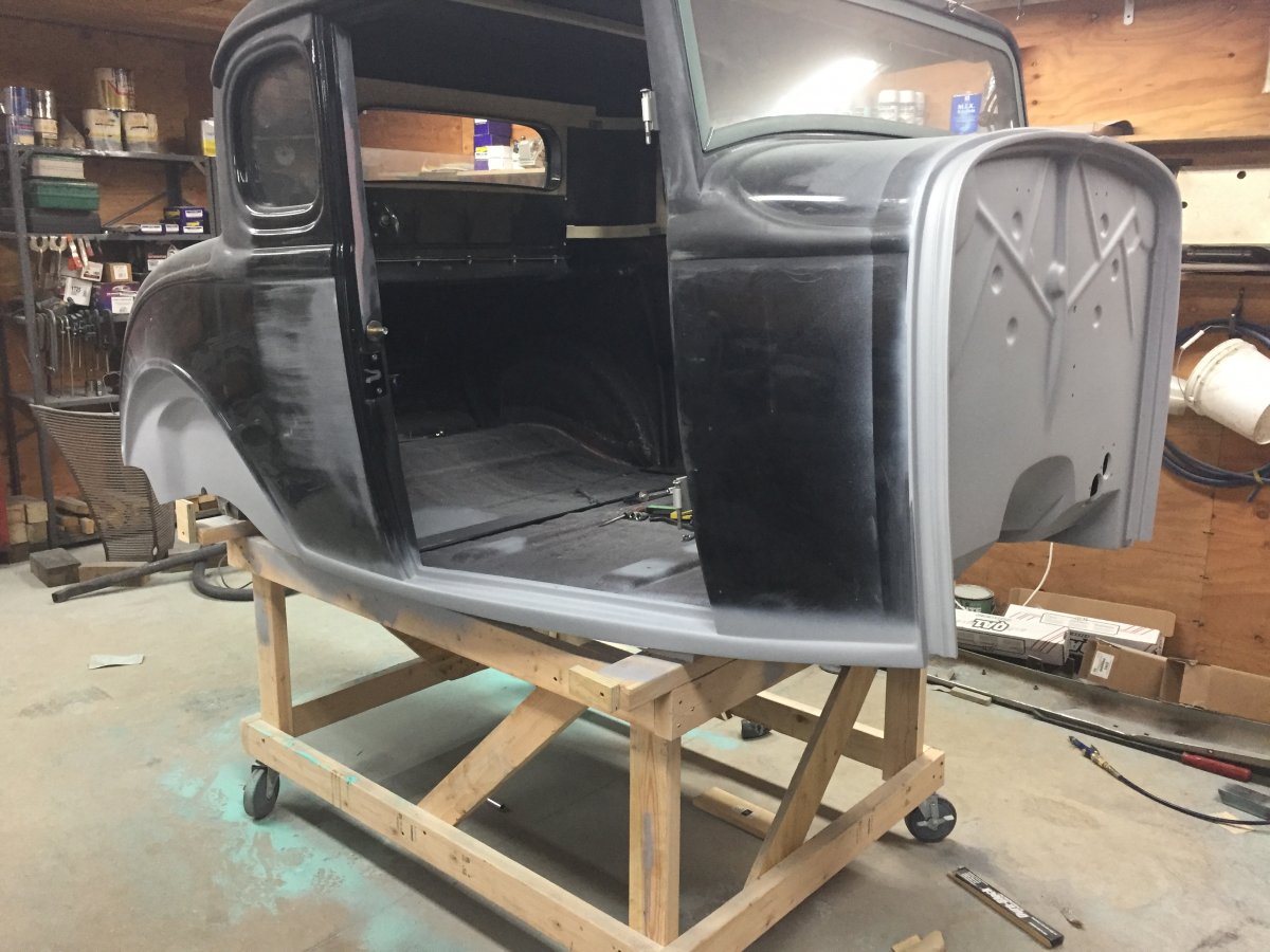

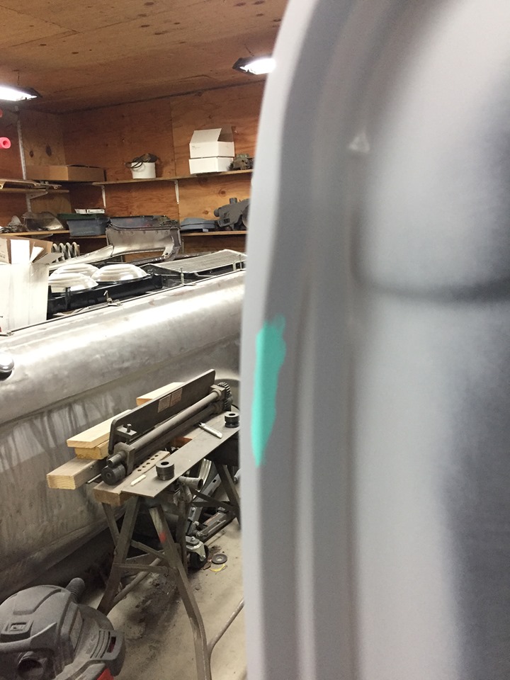

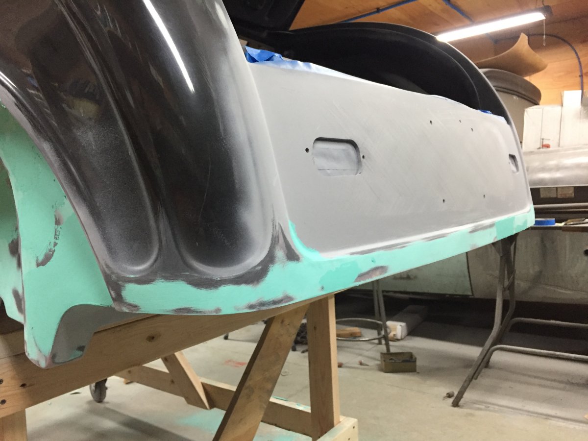

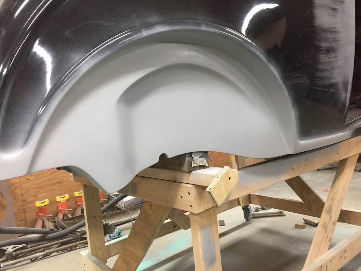

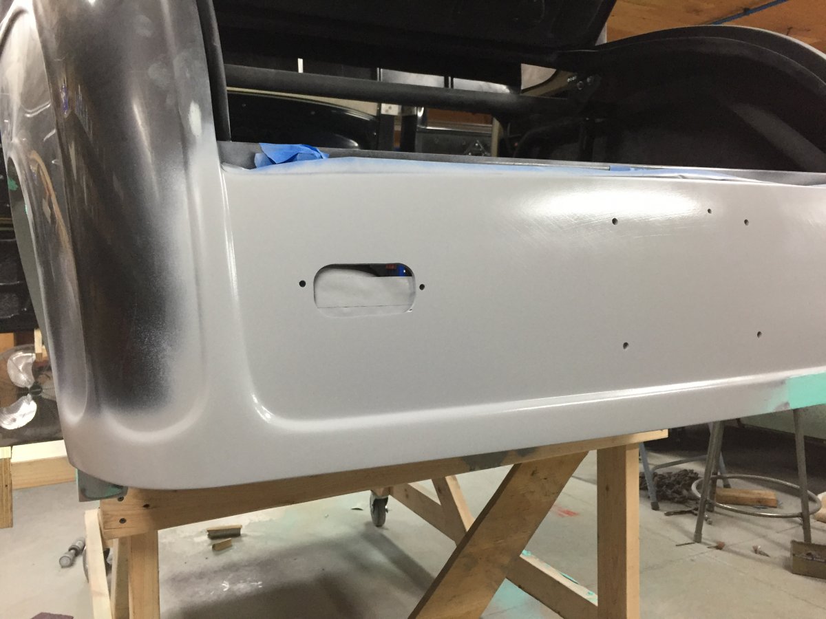

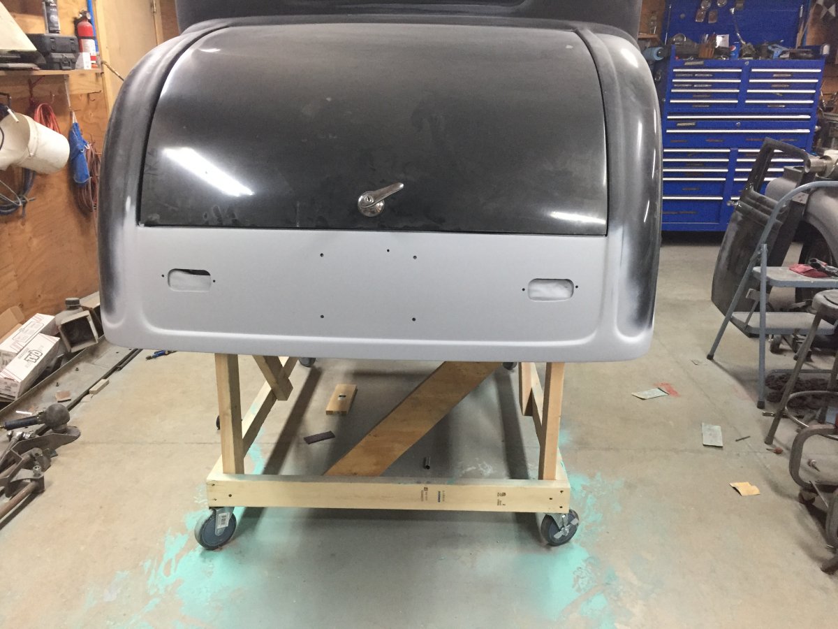

    Tired of staring at the front. Moved to the tail. Sanded, filled pin holes, sanded, leveled, primed, repeat. Easier to work on bigger areas. Working on getting the last of the waves out now. Trying to get everything around the bottom edge done so he can paint underneath and we can mount the body for the last time.
    SPark
    0CF77B95-6A97-4A42-B9B7-8E8645DF3E9F.jpeg 9BBD529D-0DC0-47AA-A7AD-47B35D224A04.jpeg 9C1DC391-3B7E-4B15-A333-5707545DAAFF.jpeg 166855C5-9C1D-4F45-9523-9EB70D02AC2C.jpeg F3B98802-4A8E-498A-AC66-D6AD502949B6.jpeg DCCEB4E5-8643-4BF5-9B7E-07303B13D011.jpeg 27B34034-928A-4095-BA76-A11AECF8BEE4.jpeg 0840A613-0A8B-4E9F-9C20-AF70A1886C1C.jpeg 55D8B1CA-E456-4F42-8B3D-F1B189AD7B21.jpeg D0E91517-4A42-46AD-A9B8-E5AC78FB8EE0.jpeg 4397BBCC-5C50-43EF-9F3B-925933523984.jpeg 43CD0B1A-E7CF-4F39-BFD9-6370E0CD5DB6.jpeg

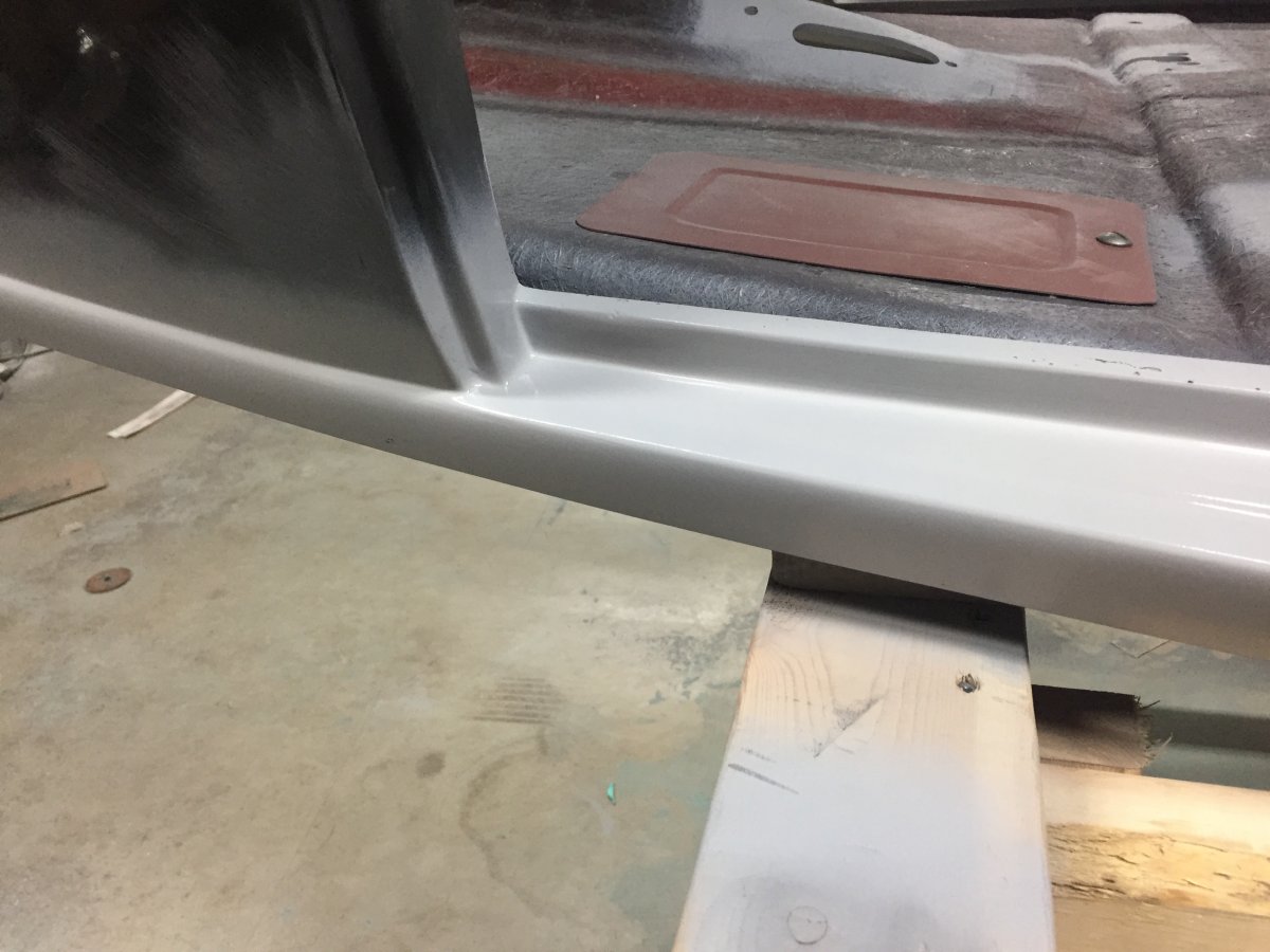

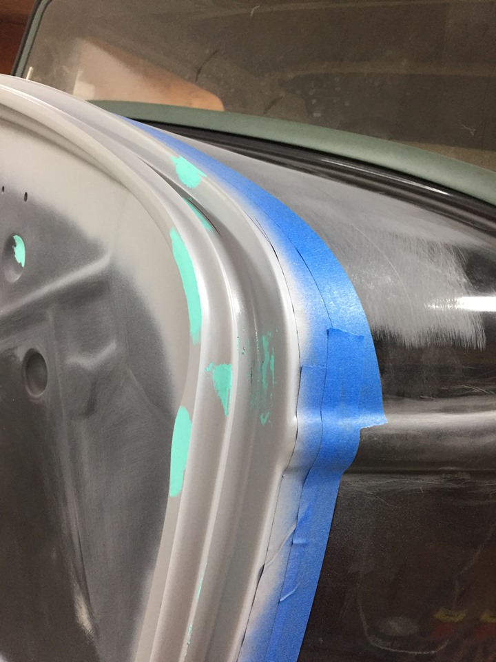

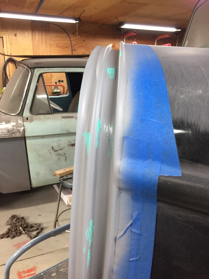

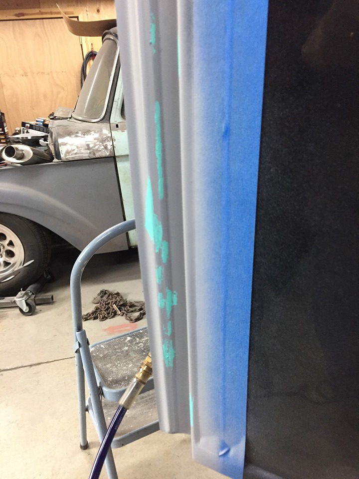

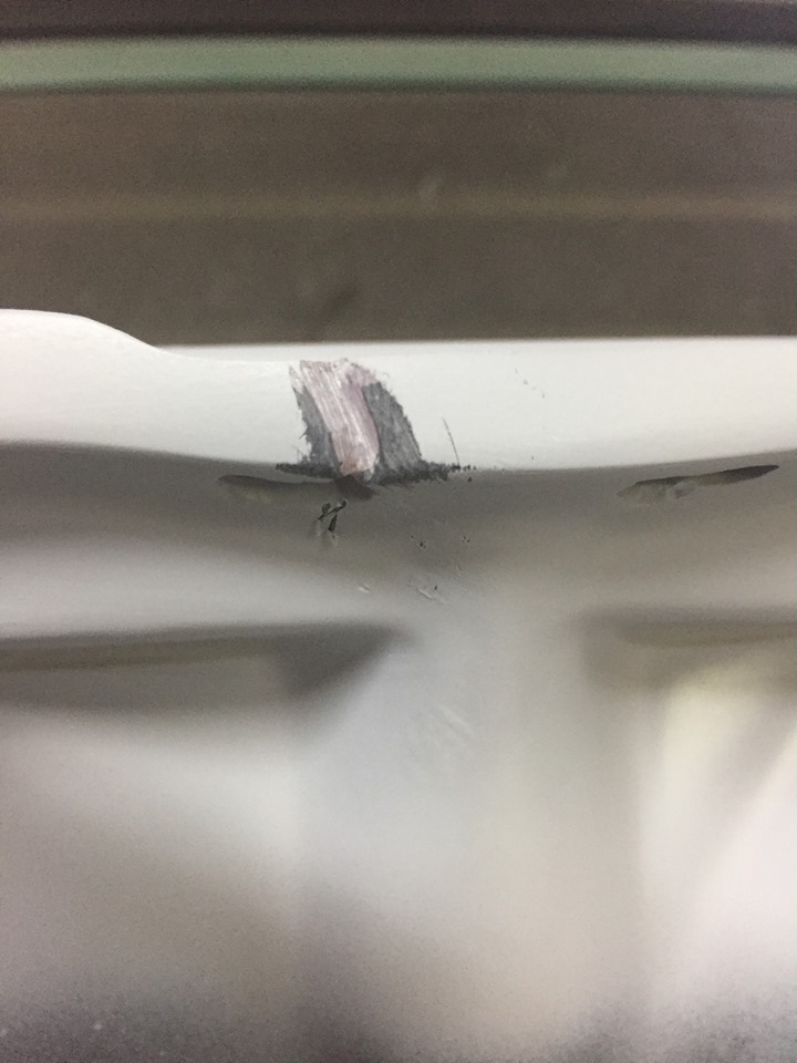

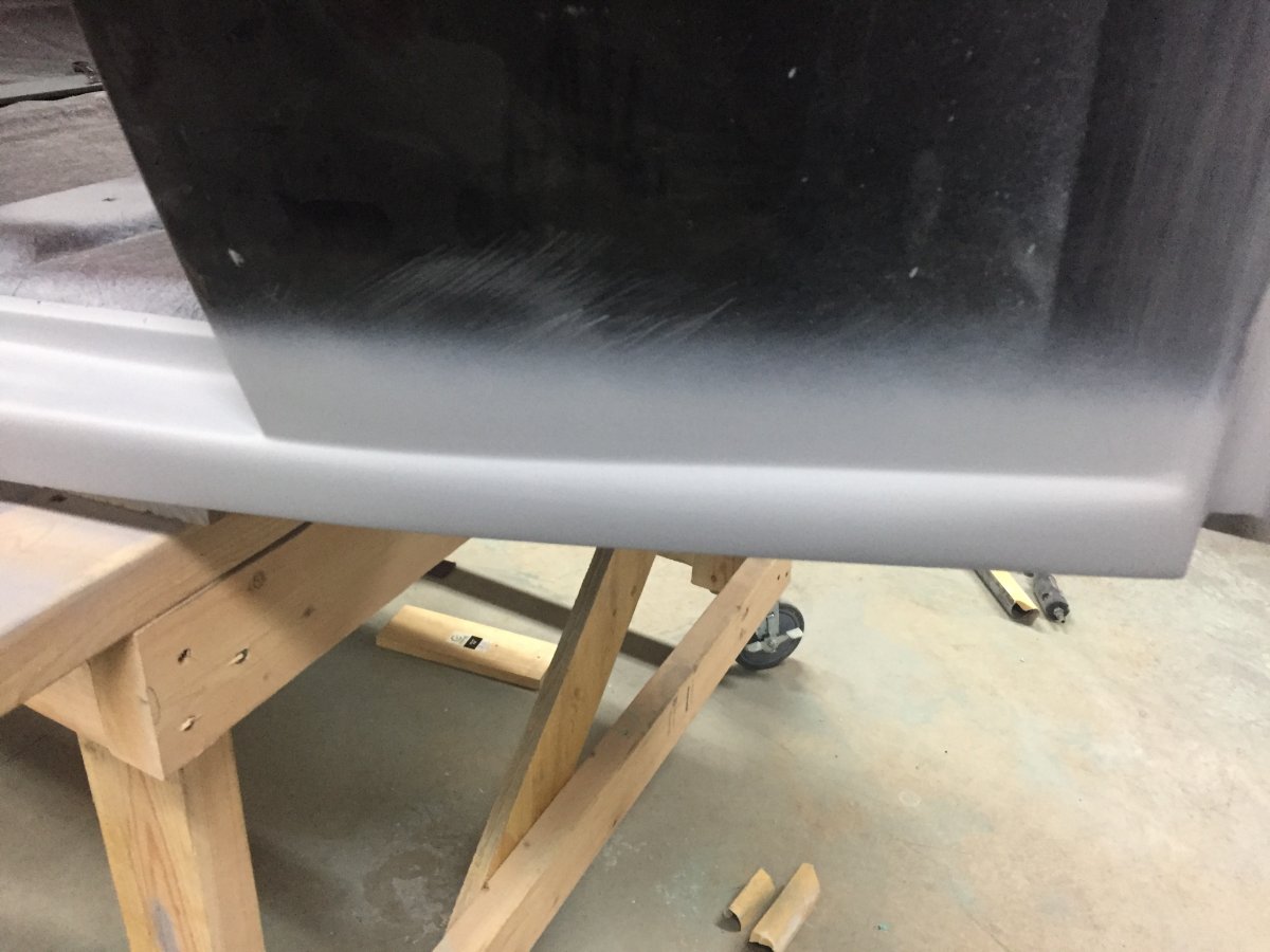

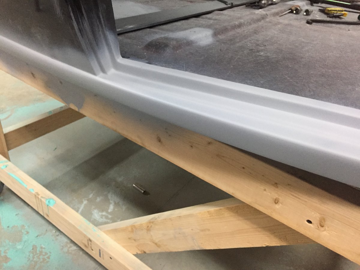

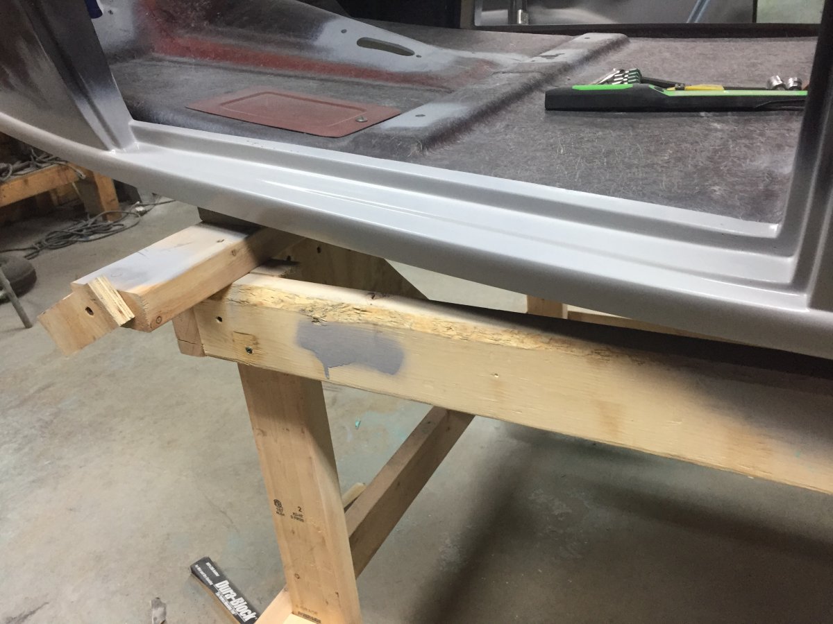

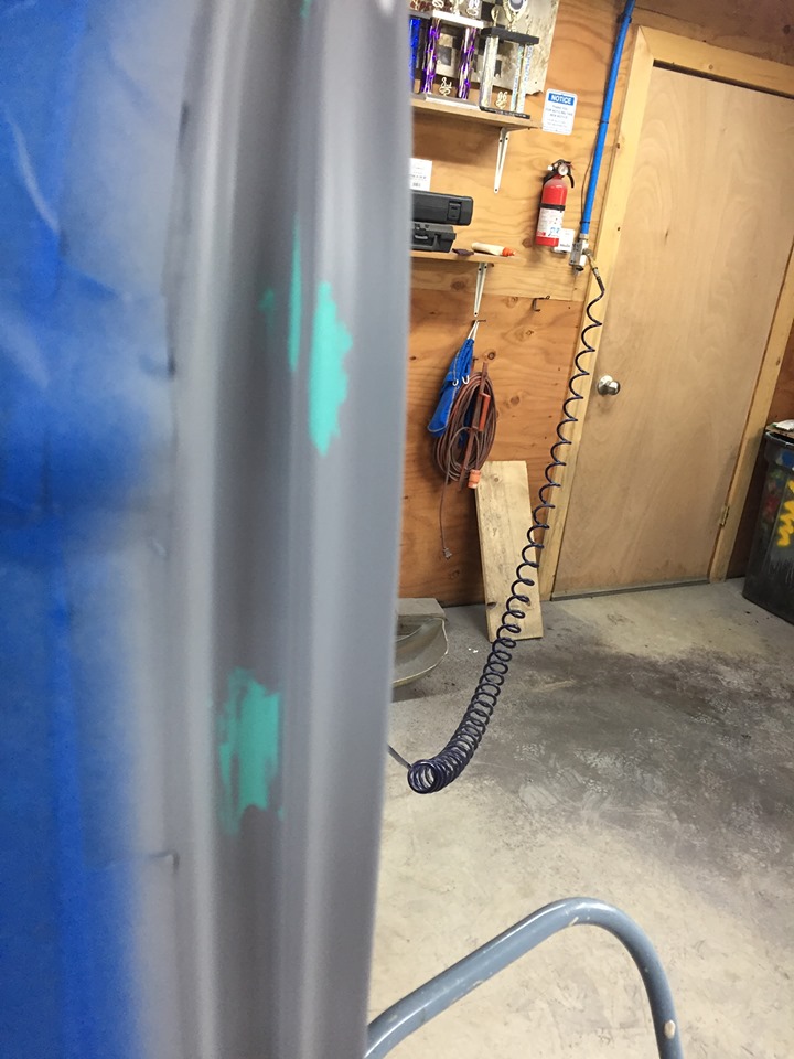

    Another sleepless night. Back to the garage. Started on the rockers, door sills and lower cowl areas. Lot of work needed in the sills. They were pretty wavy and took a lot of sanding. The rocker area is completely filled with fibergl***. It’s solid and about 2” thick. Outer rockers will also need several holes filled and a couple low spots brought up. Gaining ground every day. At least it looks like I’ve been doing something!
    SPark
    FA650592-9EB2-449B-BD4D-8A5A4E08E369.jpeg BF6BC580-6389-49D2-8990-6665827D34F8.jpeg A4EE7967-865C-4C16-990B-857D61F3B6D3.jpeg 74C6C35E-543C-43DD-BA81-9725FC624721.jpeg BA8AE0A7-F9D0-486A-8616-C7401EDF5425.jpeg 08218721-168A-4EC3-A8A6-16DC1240A85B.jpeg 7E63DB68-8AFF-467E-946D-AA693F48DA51.jpeg A23F7B64-A378-45B8-97D3-AE0D16E31D45.jpeg 76D1BBD4-65B1-4A8C-80DE-1383A2033F69.jpeg 93A2C324-DB38-4189-9D01-D33D5A90F0D1.jpeg 52B1B6A8-4B41-4E28-9199-54FC69589818.jpeg C3B3E8E7-C680-4FFF-99E8-E6854FECCACB.jpeg 8532687D-8585-49B2-AEB4-C31B8981FB14.jpeg A84D1E12-2D6C-48A5-B913-249715353C4F.jpeg 58868CE7-B94C-4596-977F-8624C16B5F19.jpeg

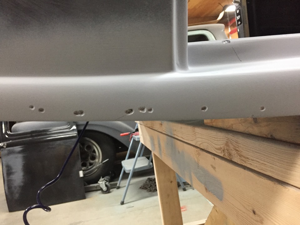

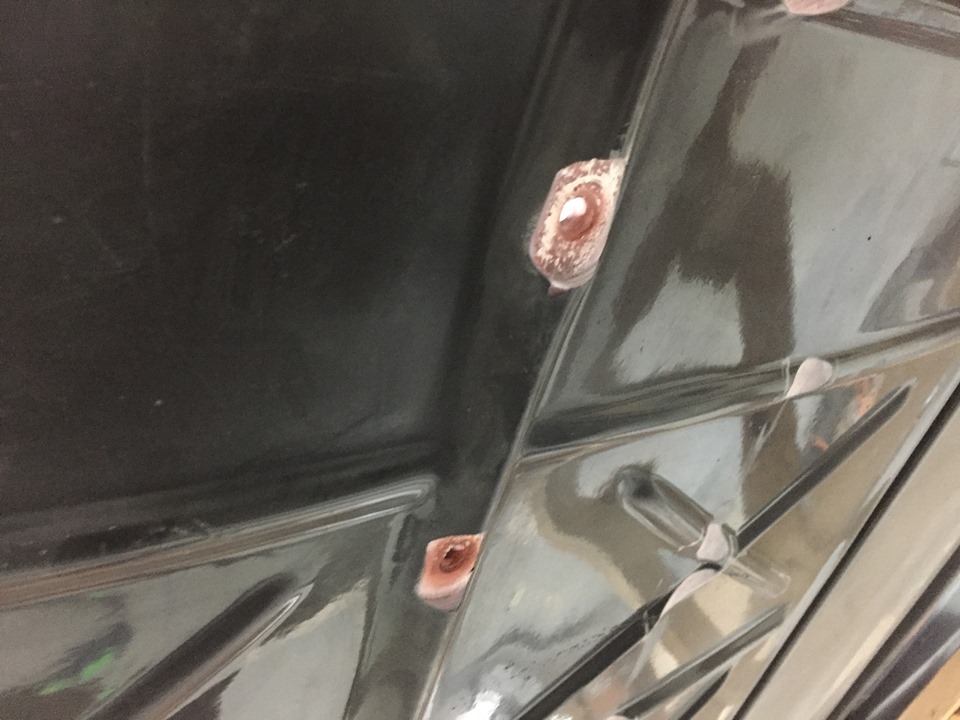

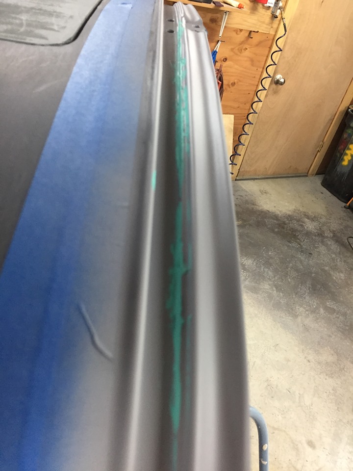

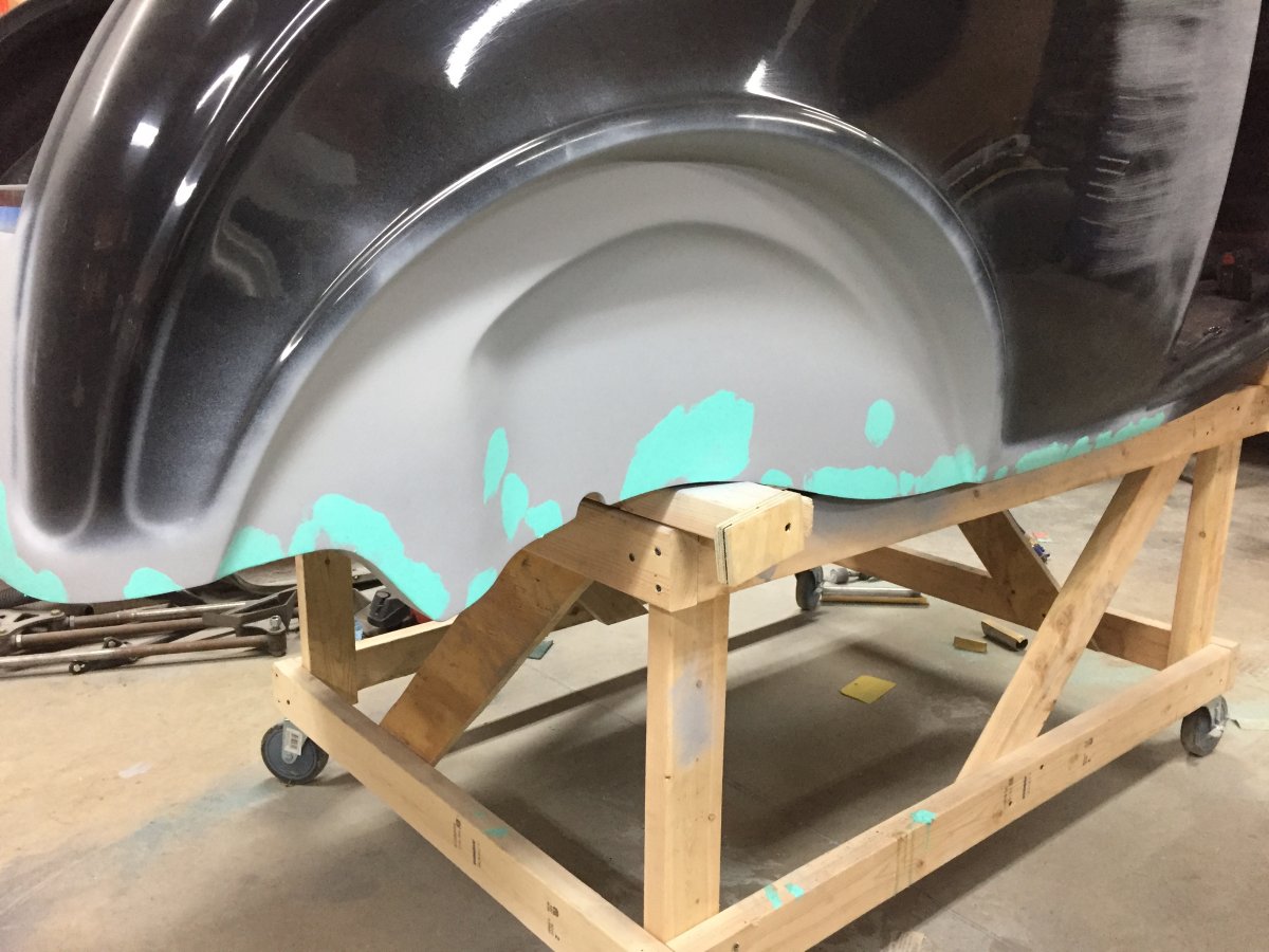

    You can cover a lot of ground if you don't sleep anymore. It's starting to catch up to me. With the AFIB still going on I lack oxygen to my muscles (and most likely my brain at this point) so I tire quickly. Sometimes just have to sit down for a while and catch my breath and let my muscles catch up on blood flow. I'm doing all the panel work, gaps, etc. He will give it the final once over and fix anything he is concerned about showing before shooting the color. We figured if we are both extremely critical of it, it will get a nice finish. I can take it as far as I want and he'll take it from there. The more I do (the more I control) the less his time costs me in his shop. I can save money by doing the majority of the grunt work and I've done it a lot before so I have the tools (and some of the skills) to do it. My cars always seem to have about 90% of the body work done and primer then I sell them and start the whole process again. The deal with the wife on this car was if we were going to spend this kind of money, she wanted paint and upholstery on it. To her credit she hasn't batted an eye when she sees what some of this stuff costs. Now she knows why my cars were always primer, I'm cheap when it comes to finishes!
    Shooting a light color primer over all that black sure shows the issues that are still there. Then you break thru the jell coat and it gets interesting at times. Spent the morning working on pinholes and voids. Will spend the afternoon sanding....again....still....
    SPark
    rocker13.jpg rocker14.jpg rocker15.jpg rocker16.jpg rocker17.jpg rocker18.jpg rocker19.jpg rocker20.jpg rocker21.jpg rocker22.jpg

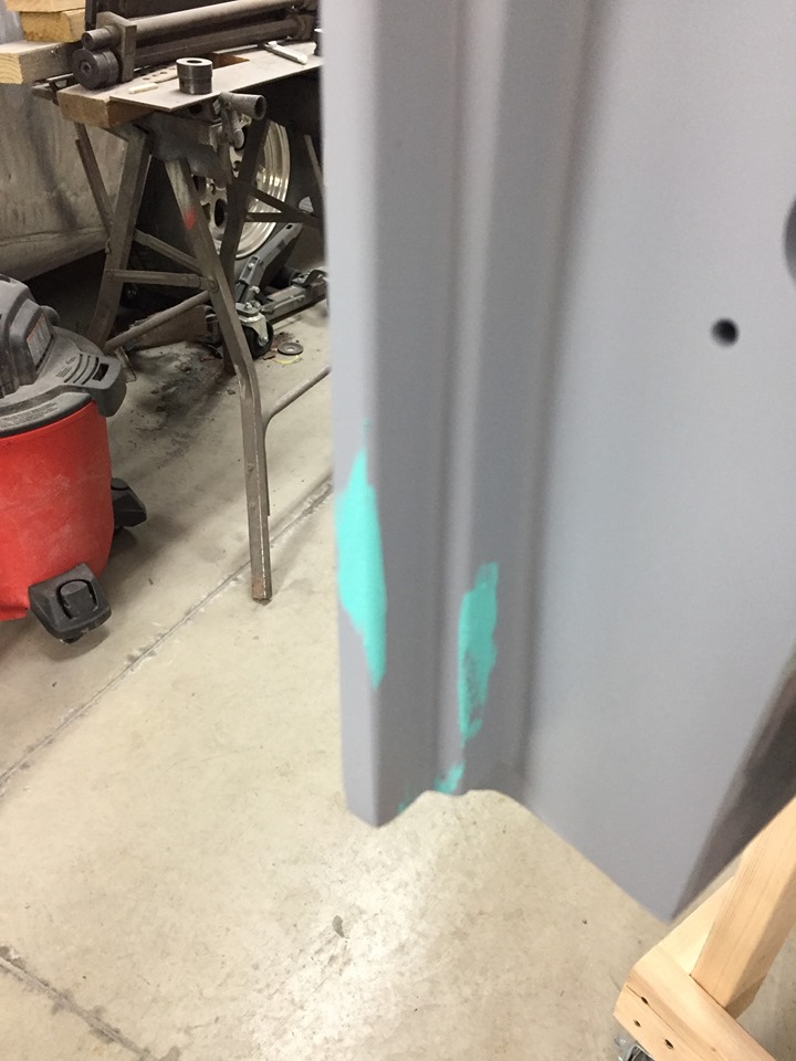

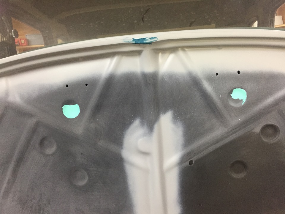

    Why are you using Duragl*** instead of regular filler? The holes are just tiny. Did the manufacturers of the body recommend it?
    Stogy likes this.

    I'm weird. Something I did in the past on cheap gl*** bodies/parts and it seems to stay better. Always used it for the first filler (stuffed into the holes with a tiny screwdriver I modified years ago) then use Rage Gold to finish it with. I like thin filler and the kitty hair seems to work better for me in these situations. If I'm out of kitty hair I'll actually chop up chopped gl*** mat and make my own. Old habits die hard. Here's a track T I started many years ago and it was on an old MAS body. Pure junk product, took a ton of work to make it even close to right.
    SPark

    If you want a filler to use on pinholes instead of the gl*** reinforced stuff, try something like USC's Icing. Way less body than Rage Gold, and won't want to tear and seperate at the edges as easily.
    loudbang and LM14 like this.

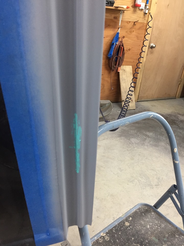

    Some of the pictures show a turquoise colored acrylic glaze. It works well in tiny holes or thin areas. I've heard it called icing by others. When I started doing this **** Martin Senour called it "glazing compound" and it was basically a thick lacquer primer in a tube. I'm more comfortable with thicker fills being kitty hair and if you get the short strand it's very easy to work with. I'm not a fan of the longer strand stuff unless you are working a really large area, like a hood scoop that is bonded to a hood and has a lot of area needing filled and worked. Just what I was taught from day 1, back 45 years ago.

  28. s55mercury66
    Joined: Jul 6, 2009
    Posts: 4,367
    s55mercury66
    from SW Wyoming
    3M made a similar laquer based product in red and also the green/turquoise that we called "red lead" way back when.

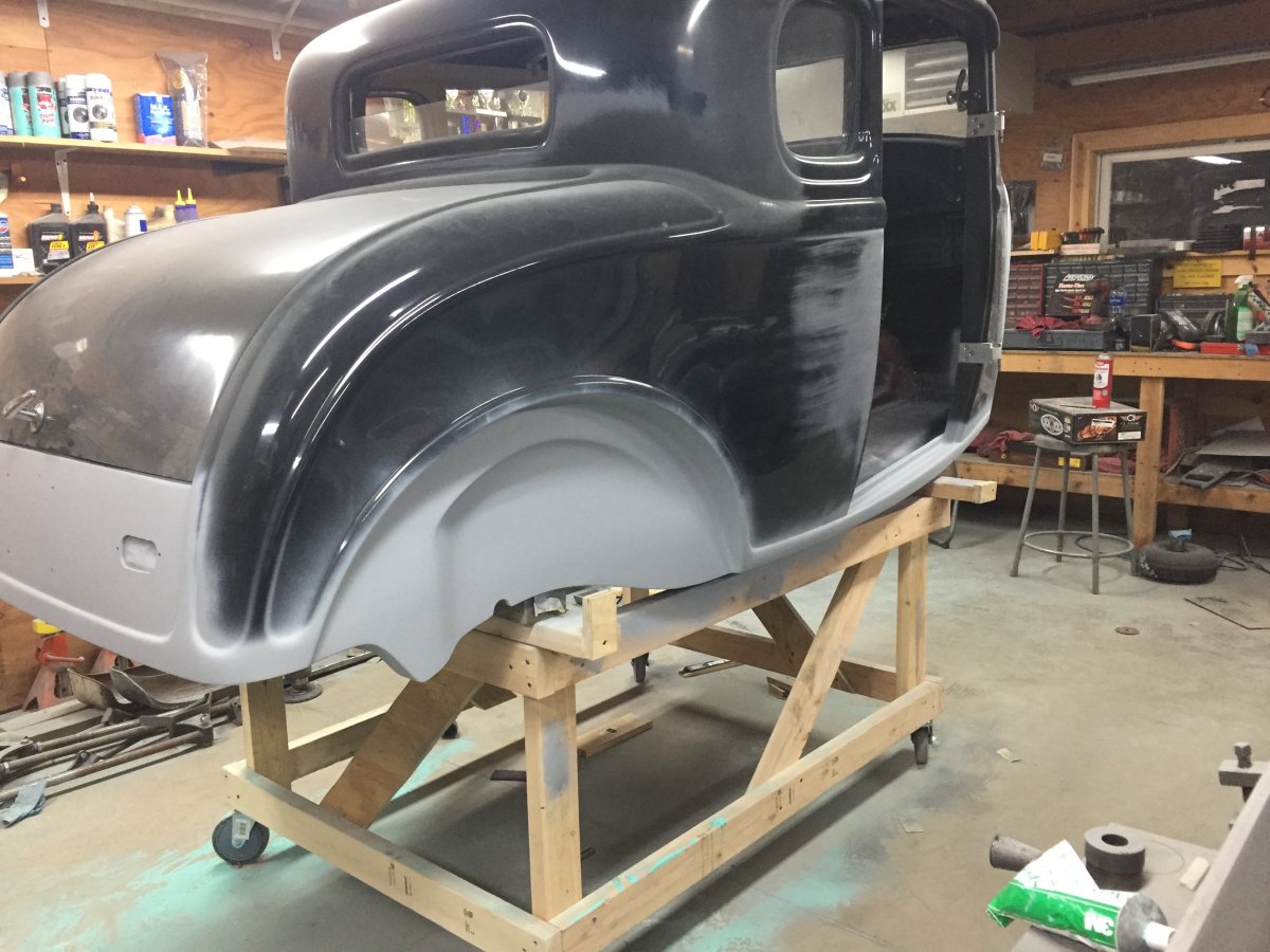

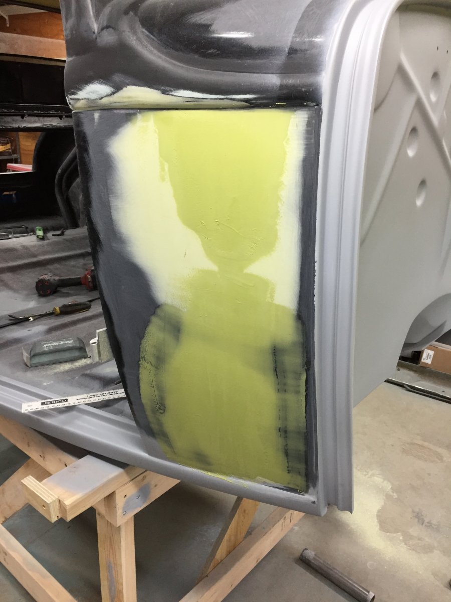

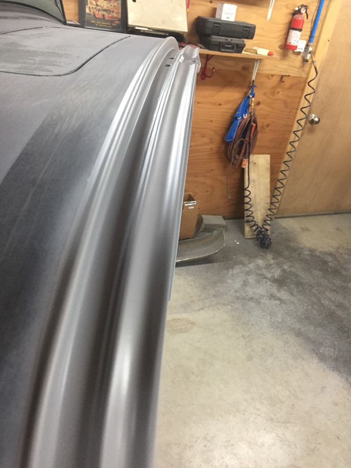

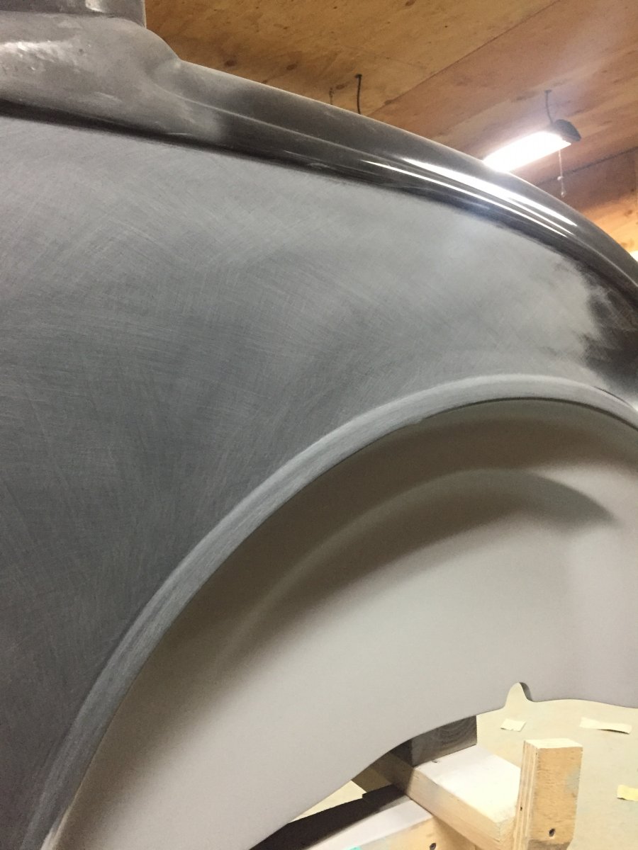

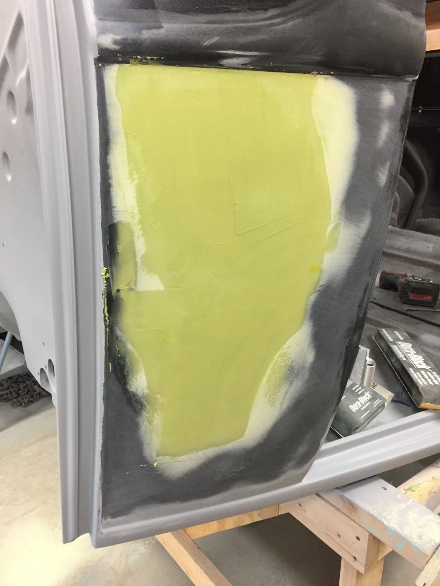

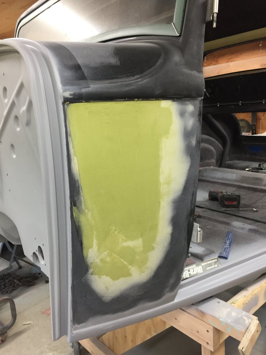

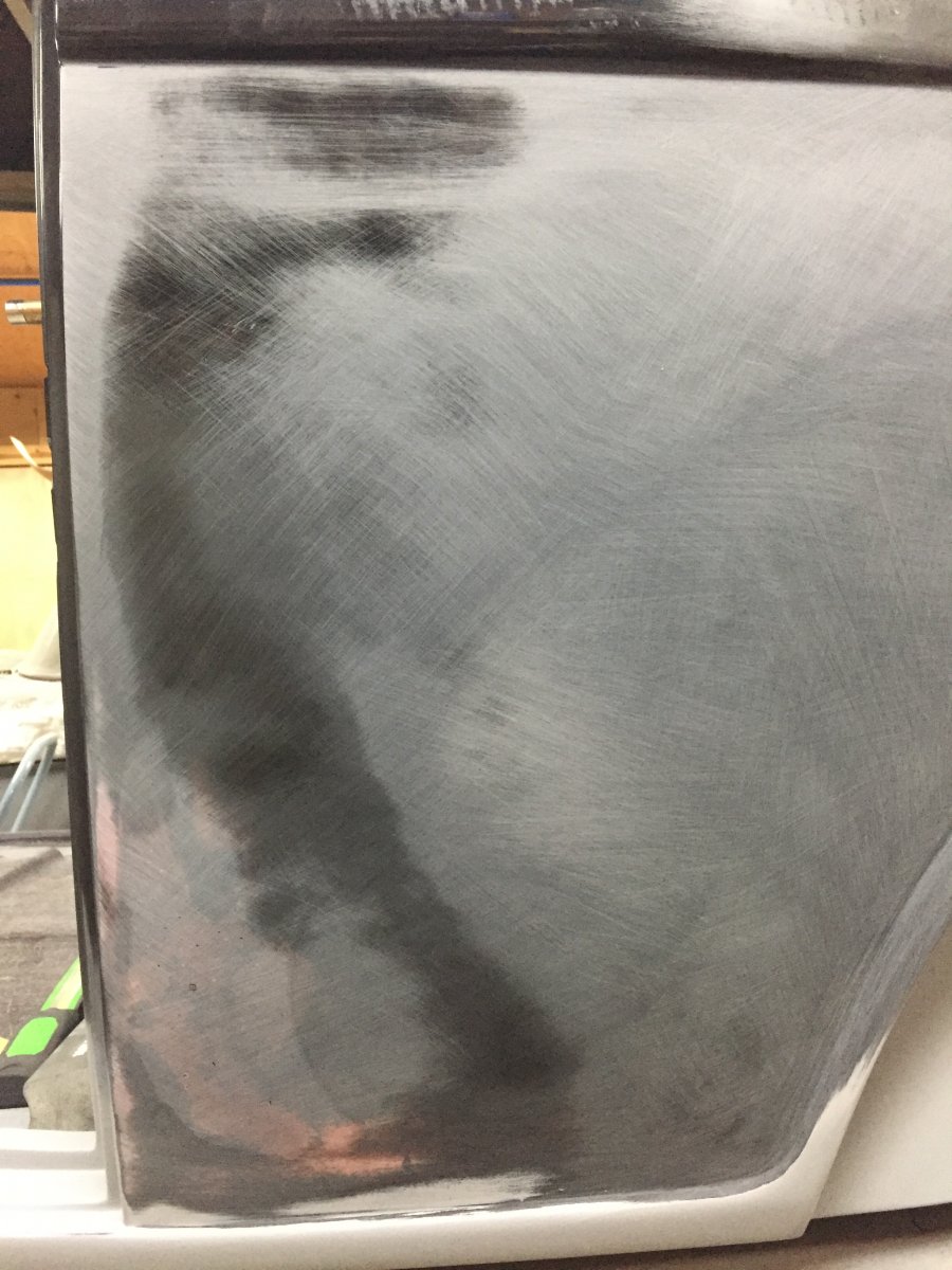

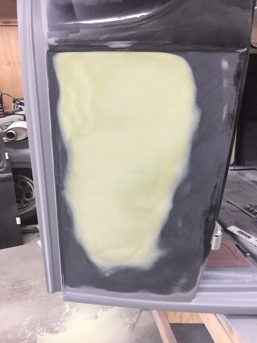

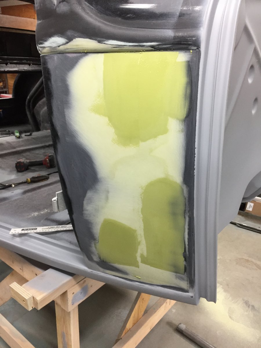

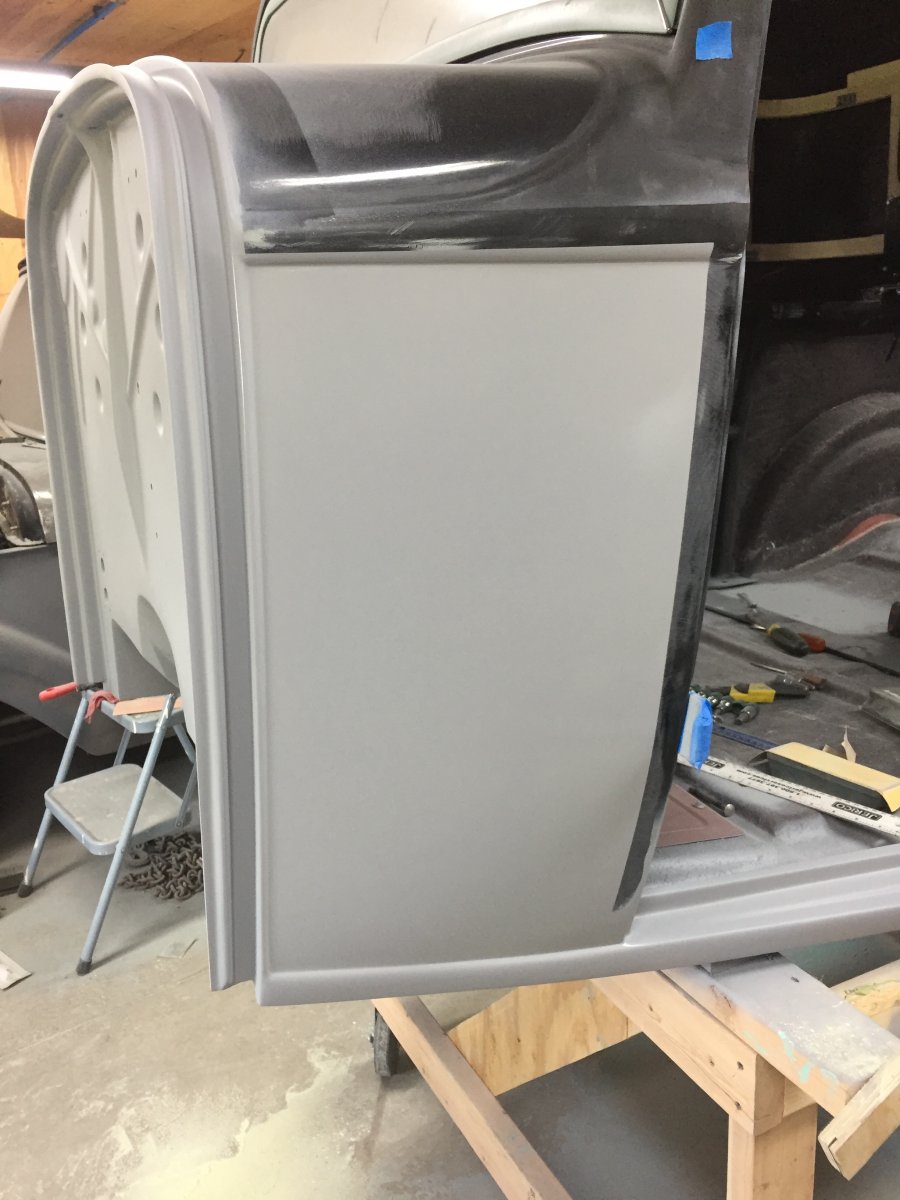

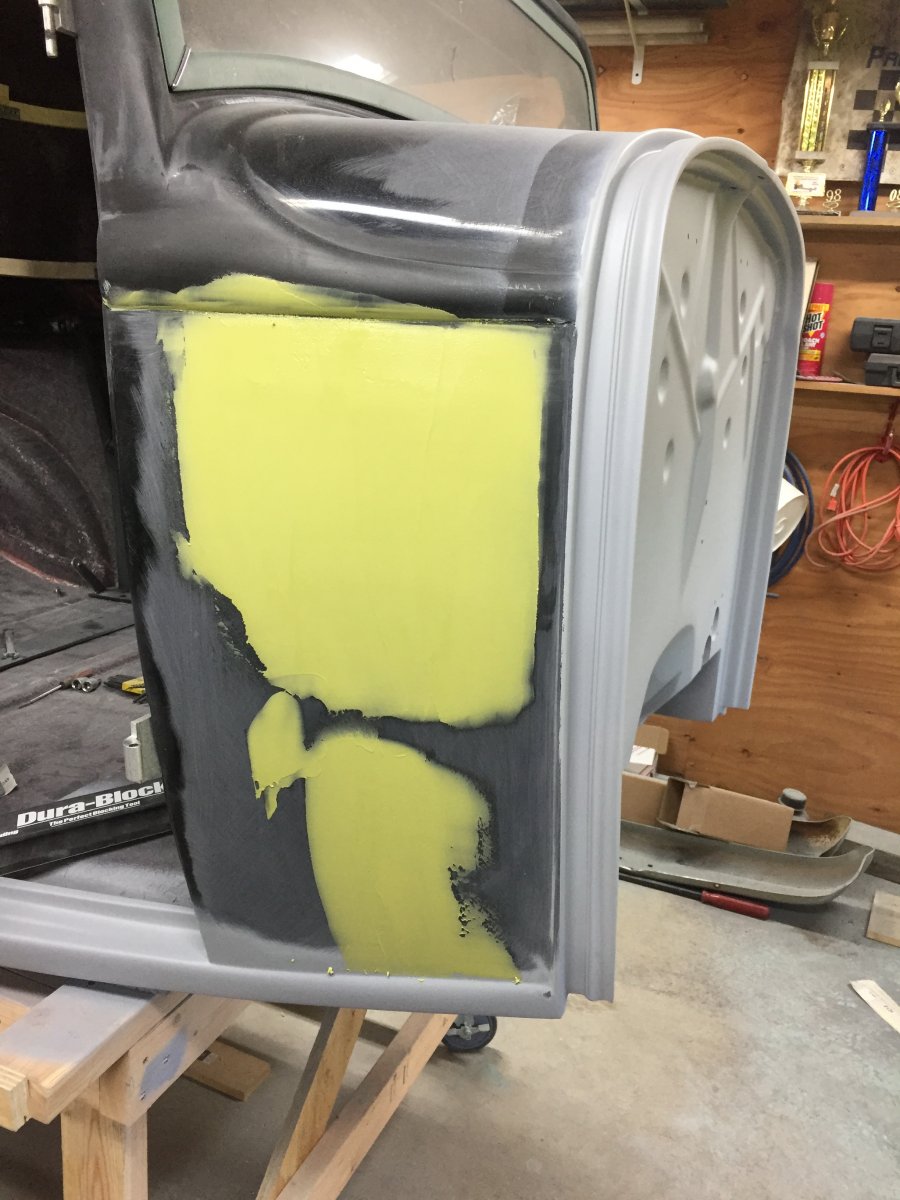

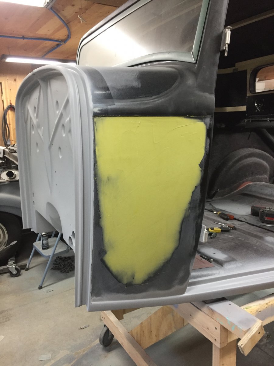

    Started cleaning up the cowl sides today. They were a little flat. Little filler and a long sanding board working all angles and it looks a lot better. On to the cowl top!
    SPark
    B094EE6B-A9A9-4F01-9E8D-B311552576E4.jpeg 41CD7AC2-C6F9-43A7-AEA7-ED84954A8E51.jpeg 6B2B34A6-8F4D-463F-8749-42A5847BA239.jpeg 68DD5E46-F85A-49C0-9C55-36B7F2876356.jpeg F03E9014-7F34-41DC-AE15-519579CF76B4.jpeg 741028DA-114C-48C4-9242-D7096D7331FE.jpeg B919D6F5-B6FD-4E77-94BB-397F1B6F22E3.jpeg 675B4CF2-EF87-4681-95D8-9AA9BAA86552.jpeg E1A10AE5-C73D-42A9-8C04-84B747C2D637.jpeg

    10 hours of sanding, filling and sanding again. That’s enough fun for today. In addition to getting both cowl sides ready for glaze, got most of the left quarter blocked and ready to fill the low area just behind the door. Also sanded the rockers, wheelwells and tail with 320 grit and put down what should be the final filler primer in those areas.
