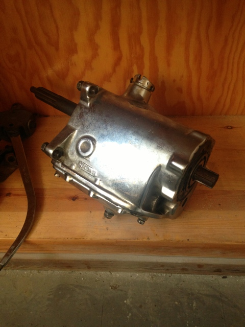

    Nice build, what is the story on the chrome lasalle case, is it newly plated or old? Neat piece. Are the wheels 15's or 16's?
