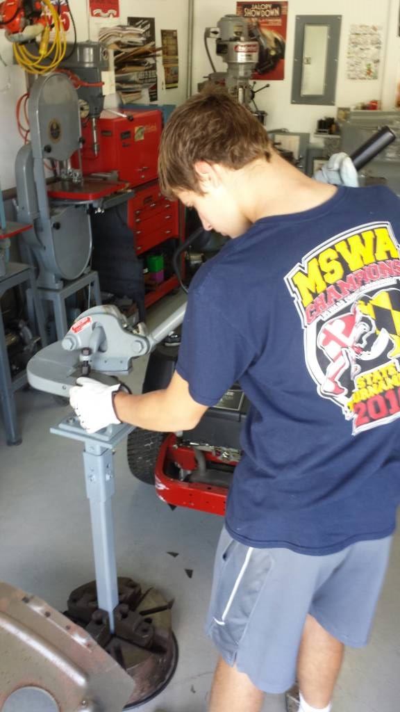

    Today I had my son Kyle cut out some circular pieces of sheet metal to use to fill the holes in the inner skin of the trunk. 1470348460107.jpg 1470348470592.jpg 1470348484022.jpg 1470348492970.jpg 1470348498162.jpg 1470348503366.jpg

    It was hurting my neck looking at it before.:D;) 1470348484022.jpg

    Good to see your son getting in on the action. And by the way, that 4 jaw chuck sure is a unique stand base for the shear. Lol.

    Awesome craftsmanship, it's great to see your son is learning skills. Today most kids would rather waste time with computers games. It one hope that there will be skilled people in the future.
