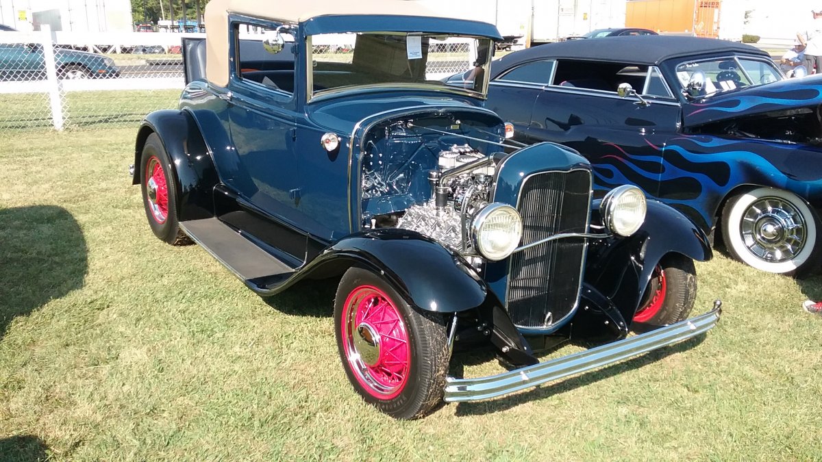

    509garyd and kidcampbell71 like this.
  20. Hutch built
    Joined: May 15, 2016
    Posts: 138
    Hutch built
    The "A" and Mercury belong to my brother and sister in law. My father was there too in his 36 delivery.
    Sent from my SPH-L720T using The H.A.M.B. mobile app

  21. lothiandon1940
    Joined: May 24, 2007
    Posts: 32,482
    lothiandon1940
    That "A' is incredible. The level of detail made me think it might be yours........and of course the name on the windshield entry form.:D
