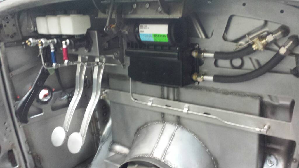

    I was planning on using some thru frame brake fittings but really didn't have enough room on the inside rail for the nut due to the motor mount and cross member. I figured I would use a tab type fitting but wanted to give the tab a little style so I made some dies on the mill to put a tight kink in the roll bar type bracket that happened to be a good starting point. After that I cleaned it up and shaped it a little and did the rivet look to it.[​IMG][​IMG][​IMG][​IMG][​IMG][​IMG][​IMG][​IMG][​IMG][​IMG][​IMG][​IMG][​IMG][​IMG][​IMG][​IMG]

    I've replied before, but I must reply again. Very tidy craftsmanship. Some guys don't know when to say when, but you have just the right amount of details and have kept it all uncluttered. Now carry on.

    Posts: 2,925
    lothianwilly71

    May I ask what heater box this is, please? Beautiful Craftsmanship, keep up the good work.
  28. Hutch built
    Joined: May 15, 2016
    Posts: 138
    Hutch built
    The heater is a Vintage Air product. A couple of guys I know are using it and say they really work great.
