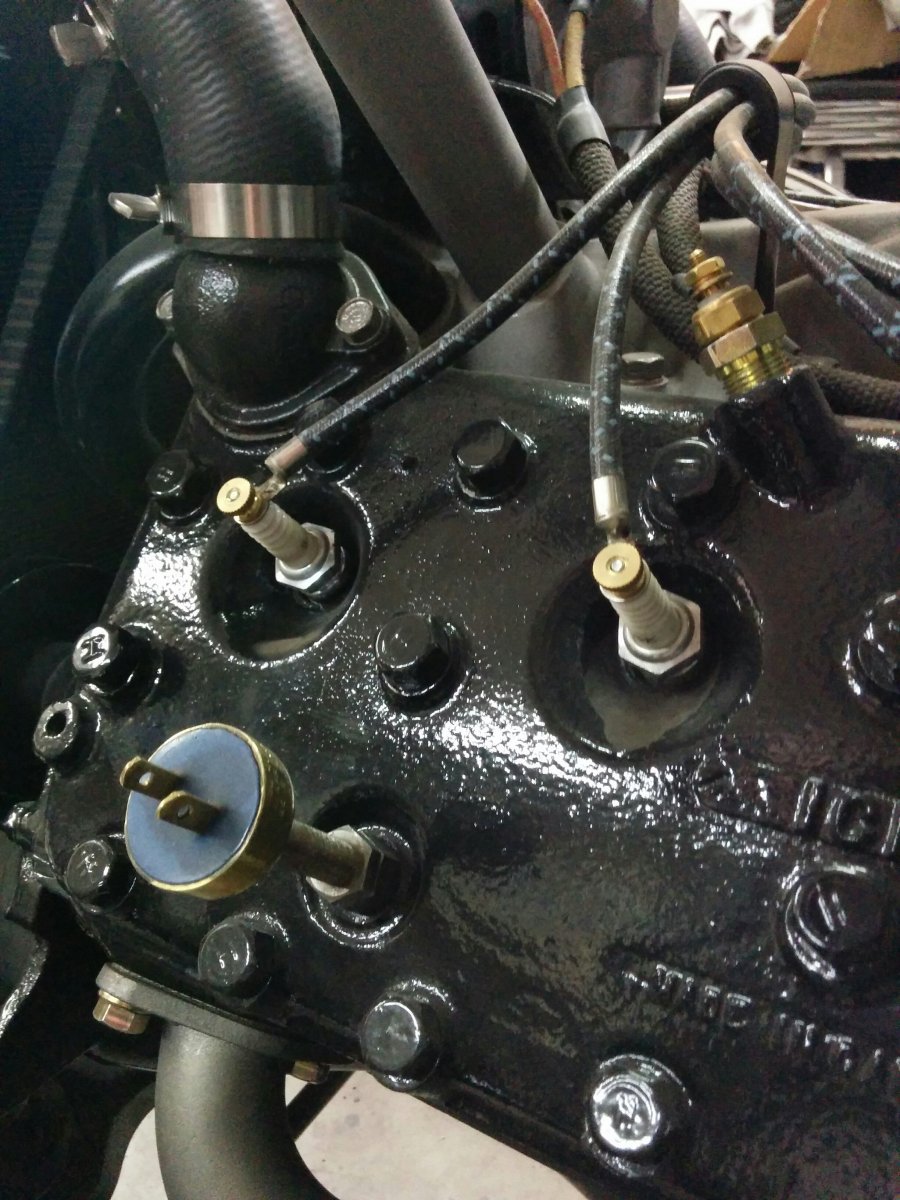

    I bought the ignition wire kit from Hot Rod Company, I used the crimp/solder Rajah
    ends and also got the groovy br*** knurled spark plug ends. The kit came with 90 degree ends for the distributor cap, but I wasn't liking how bulky that was going to look, so I salvaged all the straight boots from the old wire set and modified the crimp on ends to be straight.
    Once all that was done, it was time to hookup a gas line up and light it up!

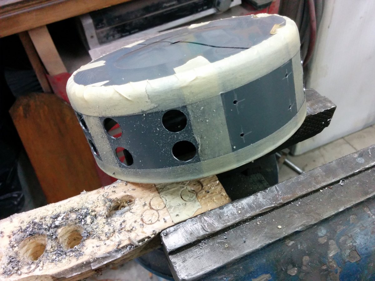

    The air cleaner is built out of an old oil bath base and a air compressor air cleaner top,
    I had a vision of how I wanted it to look. Pretty happy with the result.
    At the same time, I built the vent for the banjo,since now it was open drive.
    I had this in mind for quite a while. I drilled and tapped one of the side bell bolts and cut and threaded a piece of a thrashed hydrostatic fuel gauge br*** hex tube I had. There is a tiny hole facing down at the end and I stuffed a little chunk of filter material inside to hold any oil back.
    I'll see how it works. I like the look of it.
