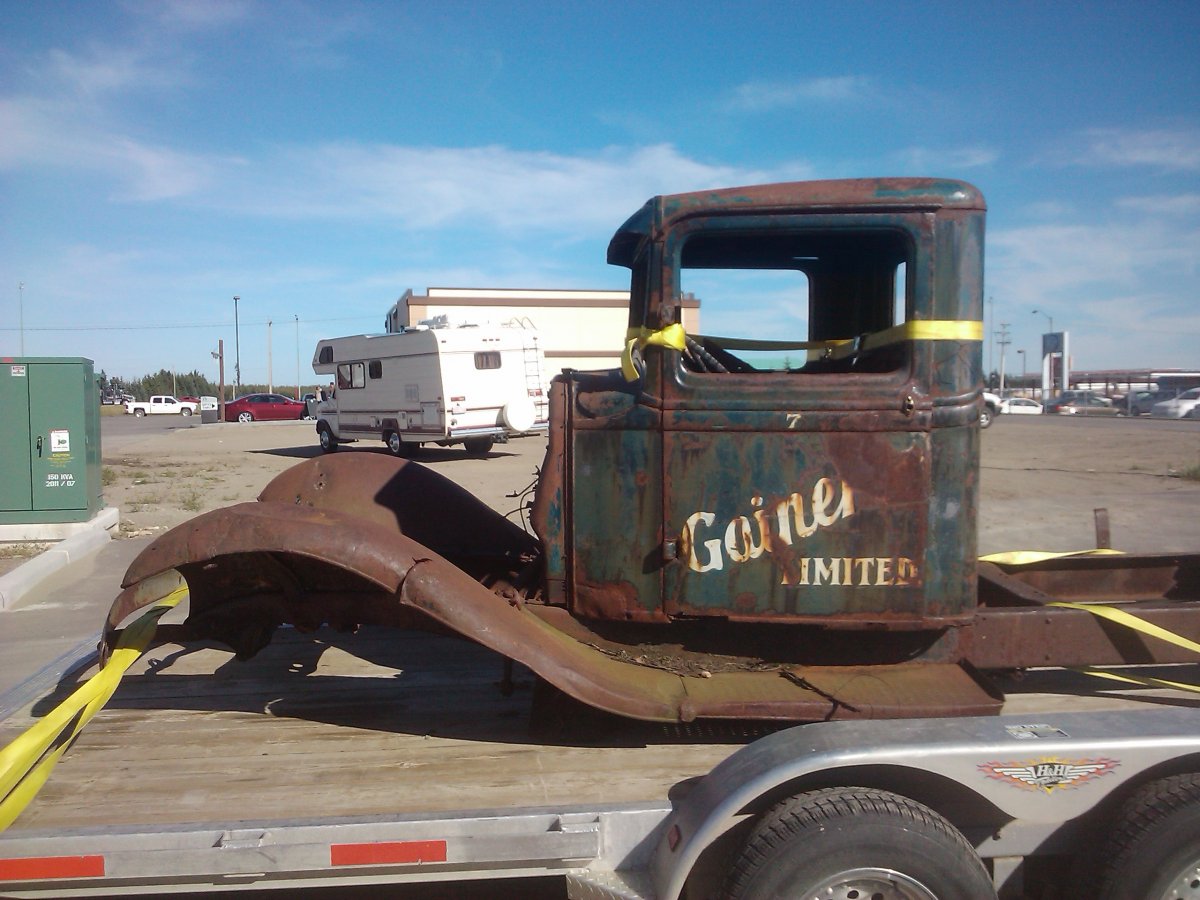

    I also discovered this name brush painter over. I wrote an email to that town and sent this picture hoping to find some information. They had nothing in the town records, but told me that only meant he didn't own property there. No big deal.

    When we lived in Manitoba in 1970 p/u had to be licensed as commercial vehicles so you had to put your name on the doors. My Dads said Jack Simmons and Son then when my brother was born he added 's.
    I was watching your videos and when you backed out of your garage I though. Hey those garbage cans look familiar. I'm from Calgary as well. Good to see the post neighbour.
  27. @dumprat I got them from Princess auto, forget how much, but cheap when on sale.
    @54monarch Thanks!, That explains the name on the door. Hope to see you on the road sometime.
