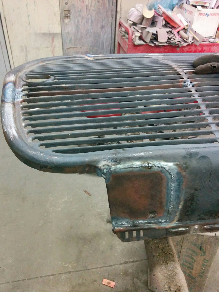

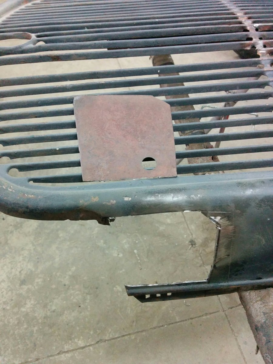

    Yes, December 19th already. This year flew.
    Nothing really substantial for updates, I have been working on the doors, hood and grille.
    Trying to finalize everything on them so they are on and bolted for good.
    The grille with this truck was rough, a few tears along the outer lower edge, it was missing the inner chin shield, and one lower bar.
    The grille I bought when I was gathering parts for the meat truck, was salvageable, but had bottom rust issues. I had removed the inner shield and sandblasted it quite a while ago.
    So now, I am fixing rust on it and it will get welded in this one.
    This one also had brackets brazed onto the lower sides for some reason, and the bottoms were mangled pretty bad,so I decided the best repair was to cut out sections from the other, as well as the bar and weld them in.
    A friend of mine also has a '33 truck grill that needs the top fixed, so although I hate to sacrifice an old
    truck part, it is going to make two other grilles really nice.
    Here are a few pictures of that. 928466_604125546332975_1026174255_n.jpg 1941177_651400961592922_1571330874_n.jpg Grille side.jpg IMG_20151213_163657.jpg IMG_20151213_163705.jpg IMG_20151213_163713.jpg
