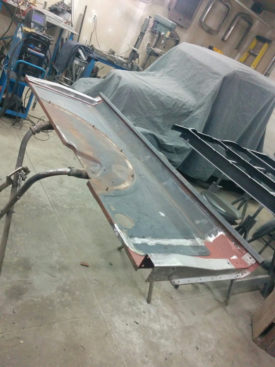

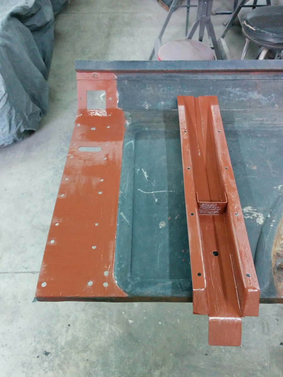

    I attacked the box next. Started with the under structure, which consists of two
    side rails and 5 cross pieces including the rear most that ties the box sides together
    at the stake pockets.
    I had straightened the rear piece quite a while ago. It was fairly mangled, and the best way to fix it was to cut it, straighten each piece and weld it back together. Kind of a "if your tools don't fit the work, make the work fit your tools" mentality.
    The next parts up were the side rails, pretty much the front foot of both sides, on the top surface was rusted either heavily, or completely, so that was cut out and some 1/8th X 1" steel was welded on.
    The front cross brace was the same situation, so I just cut the top off and made a new one.
    I made little down step areas for the nutserts, as the original had.
    The second brace just needed the outer foot replaced.
    All of the braces were bent/ bowed badly, so they needed to be straightened as well.
    Perhaps there were one too many cows in the box at one time.
    Once all that was done, brushed some Tremclad with hardener on all the mating surfaces and riveted it all together the next day.
    Then brushed Tremclad on the whole thing. 11311945_1521337904757787_1556831593_n.jpg

  6. I always thought that I would shorten the box on this truck, but when it came time to do it, I hummed and hah'd about it a thousand times. I looked at the million pictures of 33/34's that I have in my computer, probably a million times. I finally grabbed the death wheel and got on it.
    I shortened it 4 5/8th"s cause, really 4 3/4" just seemed too much.
    So I cut and welded the box sides, and also shortened the side rails, that was done before the
    picture above.
    There was bad rust under the front stake pockets, so a piece was cut out, and I used the piece that I had cut out to shorten the box side as my patch panel.
    Then all the holes were drilled in the new front stake pockets for the rivets, and I welded the little shelf bracket thing in from the old ones.. Brushed some primer on all the inner parts and spot welded and riveted them back onto the box sides.
    Next will be the front panel, which is bent badly and bottom is rusted out as well. IMG_20160210_142326.jpg IMG_20160213_110833.jpg IMG_20160301_164958.jpg IMG_20160304_161003.jpg IMG_20160304_164519.jpg IMG_20160305_104411.jpg

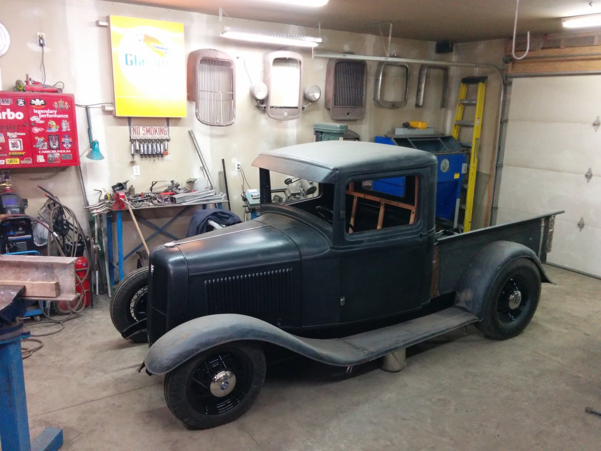

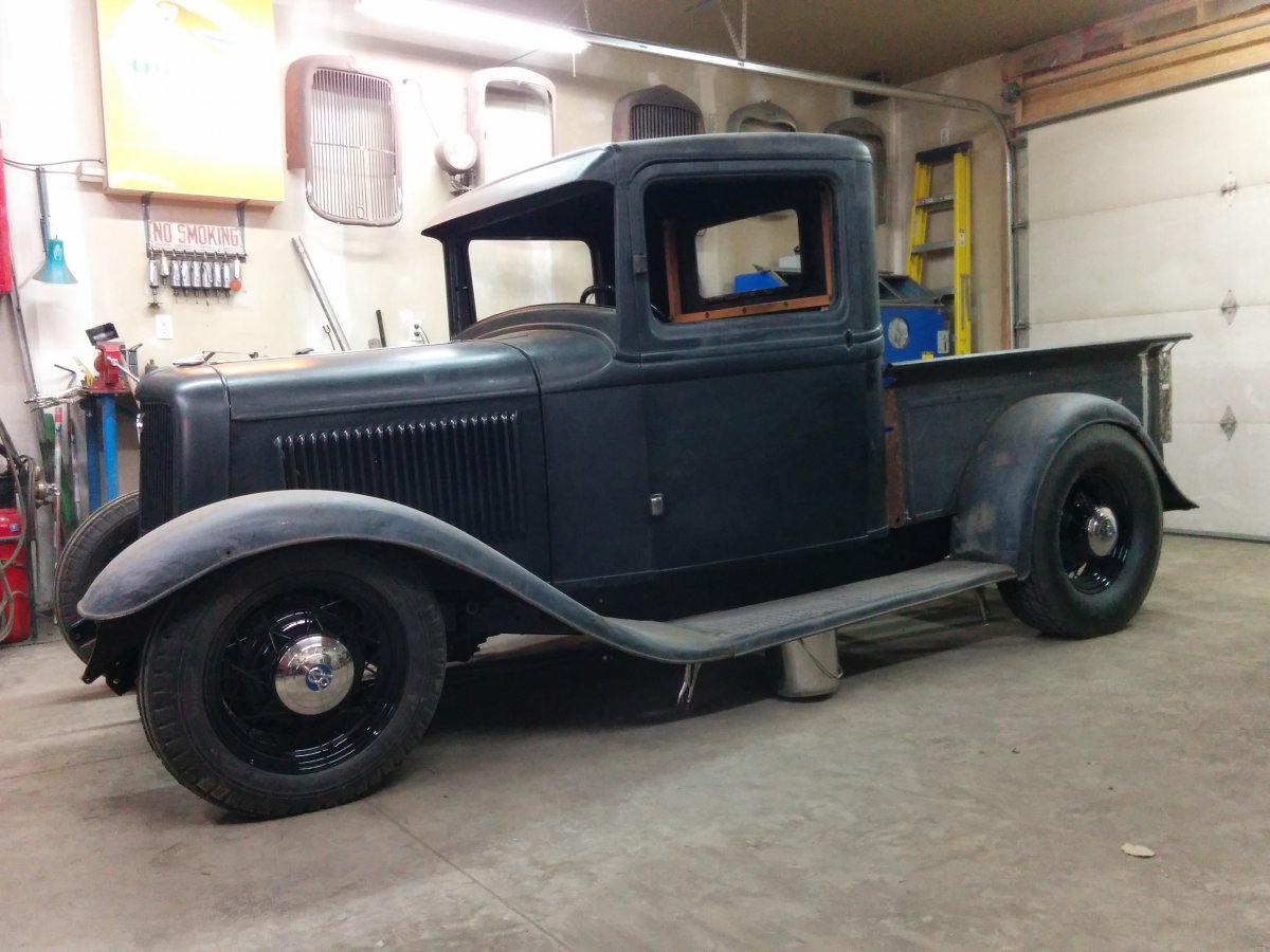

  7. Once the structure was all together and the box sides shortened,
    my friend Jordy and I did a little mock up.
    My original intent was to run as a highboy for the first year, then get my fenders
    pounded into better shape and probably put them on.
    After doing the mock up, well... IMG_20160215_122346.jpg IMG_20160215_132911.jpg

  9. Looks great with and without fenders.
    I have a hard time making my mind up.

    Those dirt track rear tires sure fill up those fenders!
    The amount you took out of the bed looks perfect. Subtle, but it's there. It's good that you left the rear portion behind the fender still slightly longer than the front portion forward of the fenders so it still looks balanced. Sometimes guys take way too much out of the back and it makes the whole truck look like weird.
    Since you've decided not to go to Texas this year keep going with the fenders and drive it there next year.
    :cool:
    brad2v, Flowmeister and Jeff34 like this.
  22. @oldrelics I just use a urethane primer hardener, since I always seem to have some of that
    in my cabinet. I usually go 4 to 1. Paint to hardener.
    @Dennis Lacy , Thanks. That was exactly my thinking when I shortened the box.
    It had to be longer at the back, I didn't want the fender back edge to go past the front of the stake pocket. I'm pleased, and glad I did it.
    I'm hoping when he rear fenders are actually straigtened out and bolted on,
    I gain a bit more clearance to the tires.
    The rear spring/ suspension may require some test and tune anyways, but I was quite happy with how
    the dirt trackers filled the fenders during the vice grip mock up.
