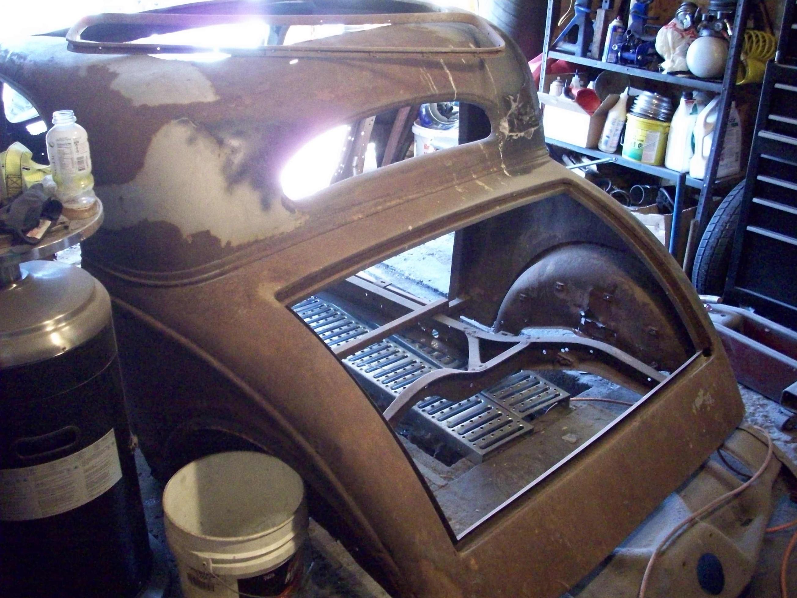

    I thought I'd go about posting up some pictures and info on my new project. I was told it was a 34 but I cant say for sure as it doesn't have any markings or tags left on it. Also I'm unsure if its a standard or master, I know one way to tell was by the dash but thats gone. Anyway I didn't get too much info from the previous owner as it changed hands a few times. It does have the #44 painted on the doors and the name "Bud Grove" on the driver side so it could have been raced at one time? I basically got the body and chassis but not much else in the purchase. All the wood was removed from the body and it looks to be partially reinforced with steel in a backyard hillbilly kinda way. The top was chopped 3" in the same fashion and may take a bit to sort out. My plans are for a nice low original styled rod for cruising around and taking to some shows and the jalopy drags. I have a mildly built 327 lined up for the power plant and I plan to slap a 4 speed behind it. I would like some suggestions for the front and rear suspension and what I may be able to use with the stock chassis(it will be boxed). I'll quit yappin and get to the pictures, comments and suggestions are appreciated!

    Check out this build thread for your steel structure.
    Steel structuring a 34 chevy 3 window.
    If you have the trunk lid, and its wood structured, it's a standard.
    If steel structured it's a master. I believe it to be a standard 34. Nice find.

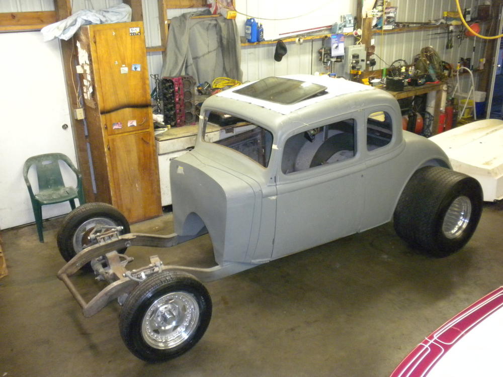

    Looks good! As far as the suspension goes when we built my 34 chevy we used the ford style front suspension and I beam trailing arms with coil overs in the rear. That car handled and drove nice! It also had a small block with a 4 speed. Good luck with your build:D

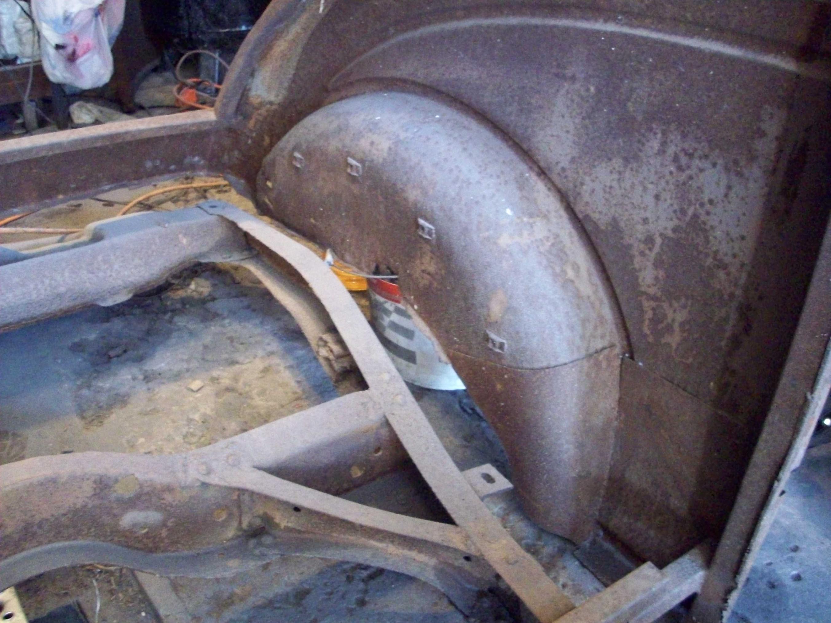

  16. Your body is a 34 Standard. I can say that by looking at the Cage Nuts for the rear fenders. Were it a Master the Cage Nuts would be around the body reviele not on the inside of the wheel house. Also a 35 does not use a gas tank cover, it's part of the body. The Master is a taller body most noticable by the Grill. Master and Standard doors do not interchange. You got some work ahead of ya buddy. So did I when I started. Oh, and Master fenders, front or rear do not interchange either.
