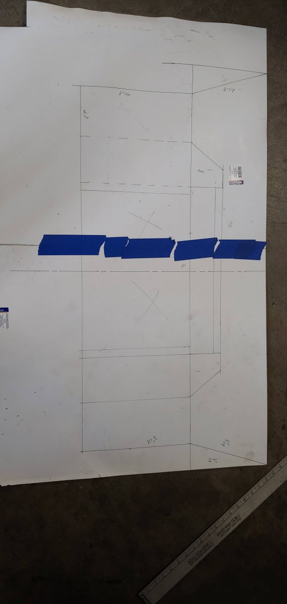

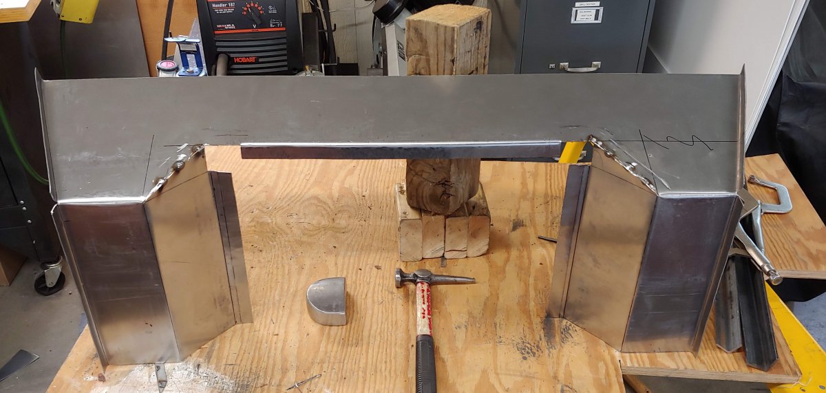

    First, I made a pattern from poster board. Then, I clipped it into place on the firewall to test the fit. It looked good, so I traced it out on the sheet metal and cut it out with a saber saw. It would not have been easy to use shears for this. Then, I laid out all the break lines, looked at it and decided I could not use my press brake for this project. Nope, this was going to call for good old blacksmithing. So, I located two suitable pieces of angle iron, some clamps and a hammer and started to work. So far, it's looking pretty good. I just hope it fits! :D
    I will cut out the two X panels on the portion of the firewall that is being removed and use them to fill the open portion of the recess. Also, the W pattern will remain in place, so I don't have to cut the entire firewall out. Stay tuned.

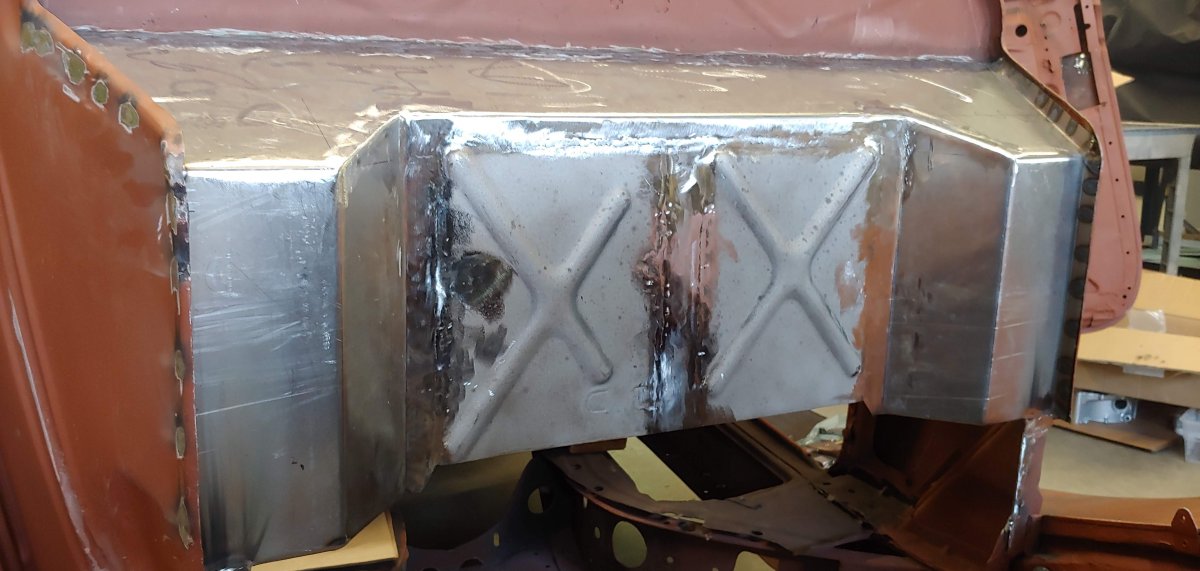

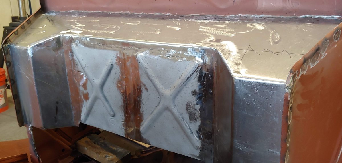

    The saga of the firewall continued today. I cut the OE firewall out, test fitted the recessed firewall, cut the two X's out of the OE firewall and tacked them into the center of the recessed firewall. Unfortunately, the two X's aren't identical but the short side will be obscured by the engine plus with a hood on it, you will never see both sides at once. Lots of welding and grinding to be done tomorrow before plug welding it in place.
    I think it looks better than a smoothed firewall and it sure was cheaper.

    I finished the welding and grinding. I swear the firewall is smooth and looks better than the pictures. It will take a minimal skim coat of filler to finish it. I tried a couple of different angles and just couldn't get the pictures to look good. I'm happy with it. All that is left to do is cut the recess in the middle for the transmission. I don't have an engine and transmission to do that mockup just yet.

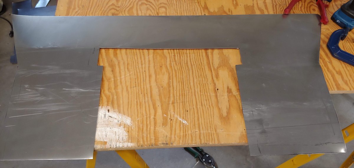

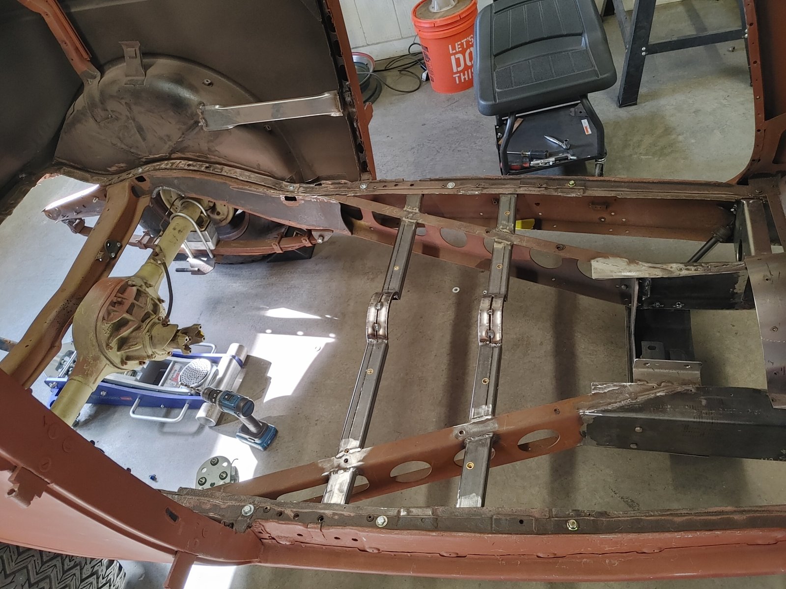

    I cut out the original floor, which was going to have to be modified for the rear axle housing, regardless and, as I stated at the start of this thread, I wanted some cargo room. So, I built a frame of 1" square tubing, constructed a couple of boxes. (One will hold the battery and the other is for storage and they will have lids.) After that, I cut and bead rolled the remainder of the floor. I have one piece that connects the rear floor to the frint floor left to do. I'm liking this.

    Mostly done with the floor.

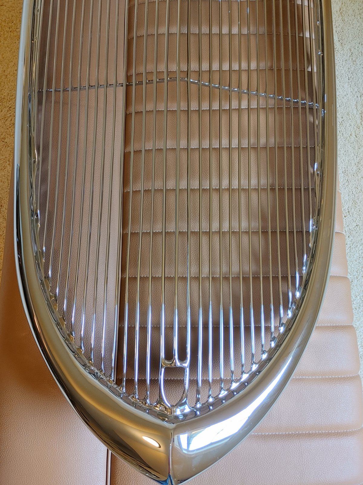

    I got my grille back from my plater last week. Wow! I may just hang this above my fireplace and call it good!

    Got back on the Tudor last week and finished up the floors today. I need a rest to recuperate now.
