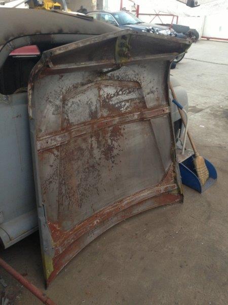

    Got the headliner out and I guess micky mouse was living up there , I found a rat's ness upthere, I quess he crawled through were the dome light was, he also chewed up the back of the rear seat. the good news is that the roof is'nt too rusty and the rain gutters are fine, we did repair some rust on the pilar post and the two rear roof posts, got to it just in time, I'll post some more pictures later.
  13. magoozi
    Joined: May 20, 2009
    Posts: 1,800
    magoozi
    from san diego
    Tono our metal guy had a really hard time heat shrinking the back panel of the cab and roof , the drivers door was a mess, aparently the door had flung open and had ripped the lower front door jam. Another problem he faced was warpage, guys, when welding patch panels on large areas , take your time and weld a small section at a time to avoid warpage. Tono had to cut some of the welds to relive the stress , heat shrink and them reweld again. large areas are always hard to weld because they tend to oil can even when you heat shrink. In both cases , it was not an easy job for Ian or Tono. Another item that eats up a lot of time is getting the bead lines straight, 34 trucks have that extra bead in the back of the cab that makes it tougher yet.

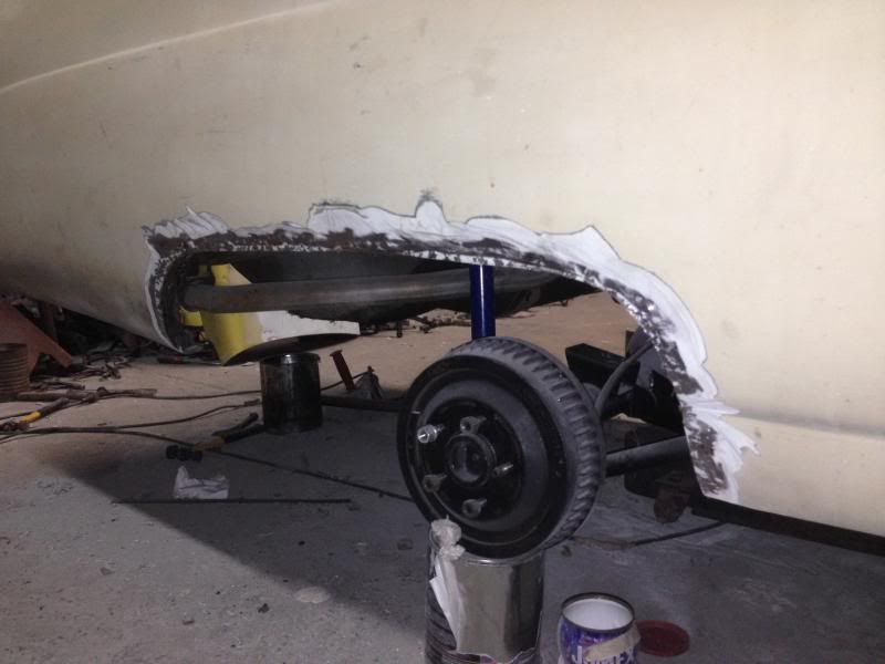

    Not to bag on the guy that built the car, but I guess he figuered the owner of the merc would never leave town, The first problem was they welded the skirts on the quater panels, they figuered the owner would never have to change a tire, so we carefully cut out the welds and all the bondo they had sweared on.Next we jack up the car and still could'ent get the rear wheels off, we then unbolted the bags and shocks and still could'ent get the wheels off. Next we unbolted the triangulated rear sway bars and were finaly able to get the rear end low enough to remove the rear tires, "imagine if you were stuck on the freeway!" the problem is the guy used the wide 8 inch rear end instead of a narrow early mustang one
    The right rear air line has leaks and wirring and air lines are just held on with tie straps instead of clamps. With all the fly by night air bag places that have opened in the last ten years, it's a wonder how they stay in business. I am going to try some wheels with a differ'ent offset, but if the problem persist's , we are going to have to change out the rear end , it took us a half a day and a lot of jack stands to remove the rear wheels, imagine if you were on a road in the middle of the night in the desert. Half the fun of owning an old car is being able to drive it.

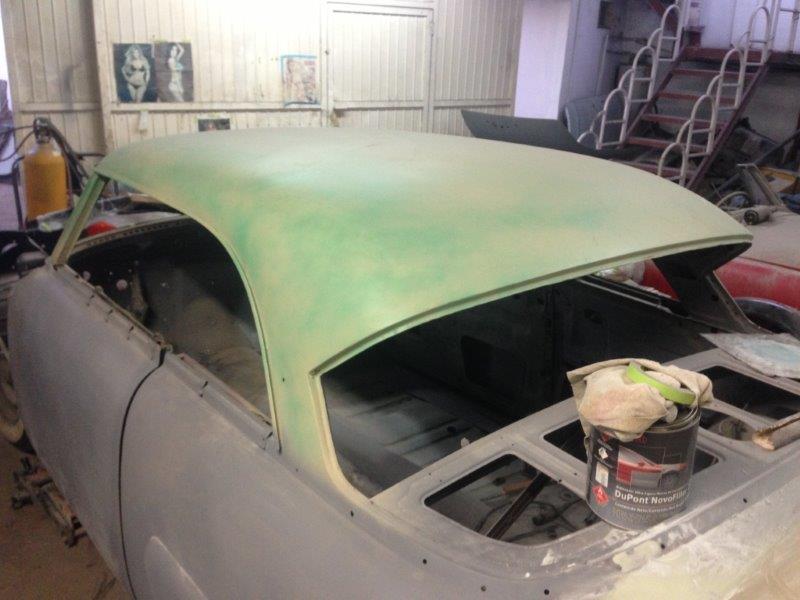

  19. NewGuy1953
    Joined: Nov 20, 2012
    Posts: 29
    NewGuy1953

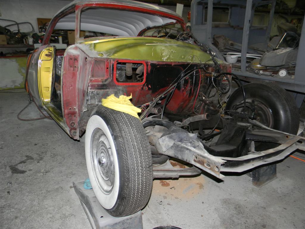

    After an epic 6 week trip in Asia with Ian and a few other friends, I've returned eager to get back to TJ and take a look at the progress on my Merc...
    Wow is all I can say. Miguel is really getting after it and doing an absolutely fantastic job! What started as a simple paint job turned into an almost entire frame off rebuild. Whoever built the car before just did a cracker jack job. Loads of bondo, rust and fibergl*** was what car was made of. But this wont be the case anymore. After pulling off the front clip, we decided there were enough issues with the car that it wouldn't be terribly more work to pull the body off the frame and basically start over from scratch. While this wasn't in the original plan or budget, I think its the right call. That and Miguel has been more than understanding of the budget and has slowed the work down to make it the project affordable to me. Very cool!
    Below are a few photos of all the progress as of a few days ago...

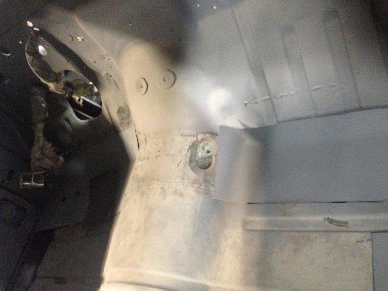

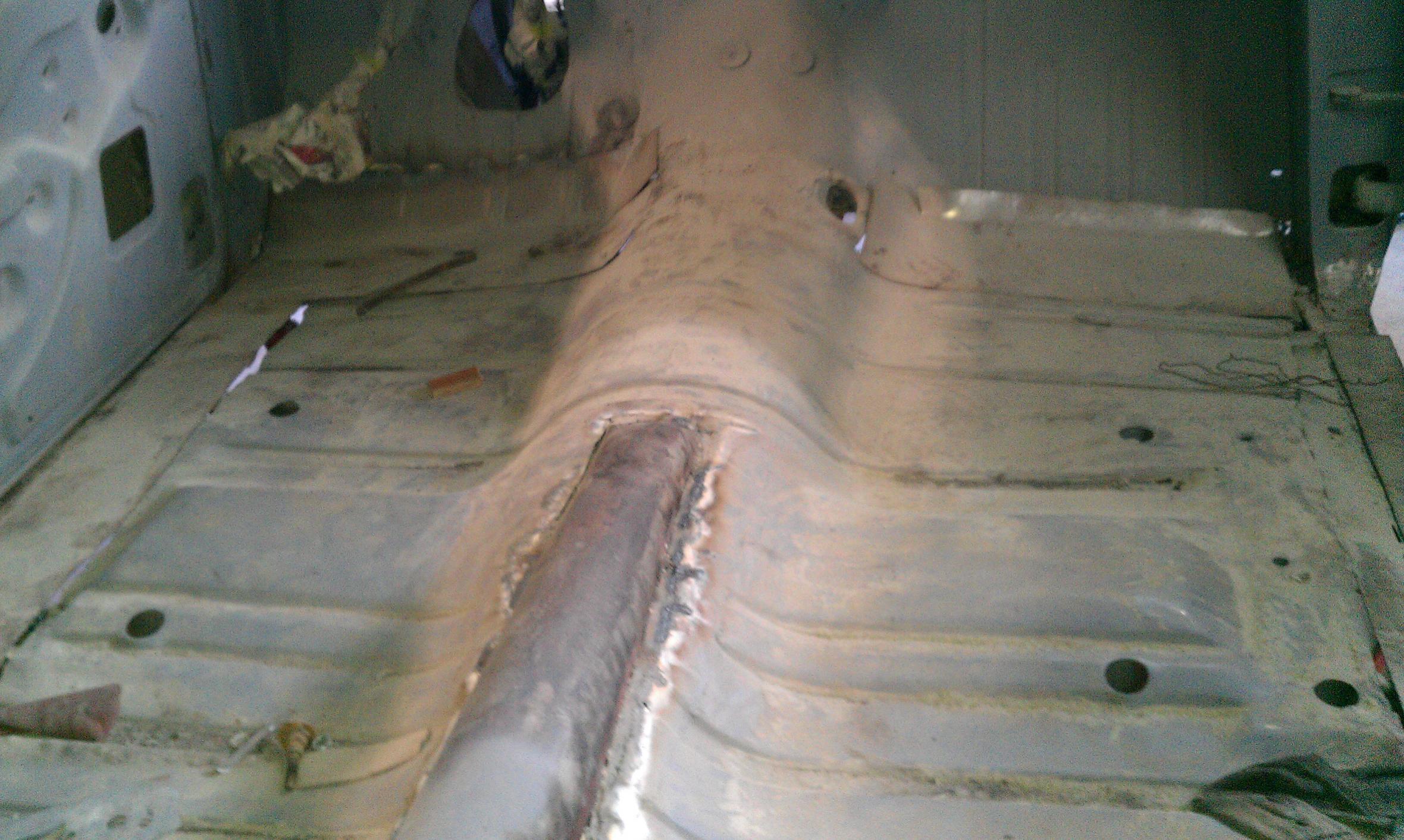

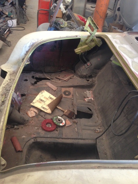

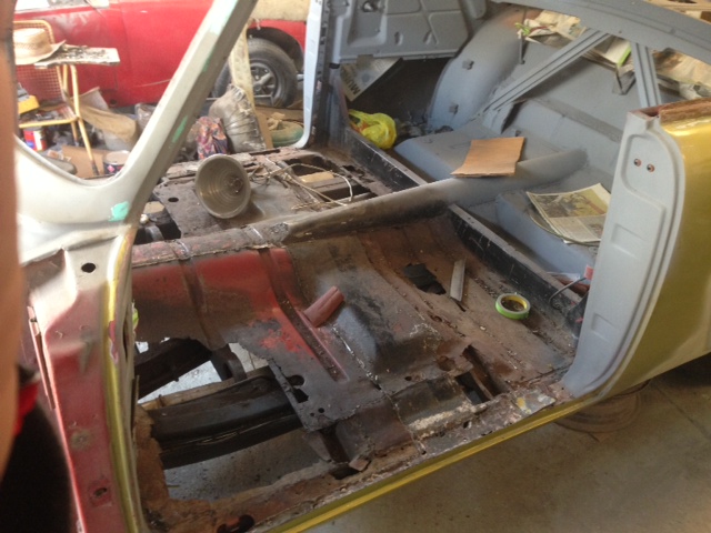

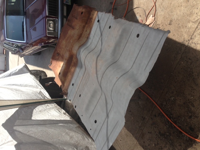

    Just went down to TJ a few days ago to check the progress of the Merc. While its still in pieces, there's a lot of progress going on. Miguel has ripped out the floors. It seems whoever built the car used street signs for floor pans. Gotta give the guy some credit for originality. Wow. I was lucky enough that Miguel happened to have a solid floor pan and trunk from a 54 Merc that he offered to me. SWEET! Additionally, almost ALL of my stainless has been polished and all engine bay pieces painted black. His guys do amazing work! And for the price, you just can't beat it. I believe he will be pulling the body from the frame this week to start clean the frame up. Im so stoked and can't wait to get the final product!
  22. magoozi
    Posts: 1,800
    magoozi
    from san diego
    The previous guy who work on the car had tack welded some pieces of a street sign on top of the old rusty floor and hid the sins with fibergl*** and bondo, the body support braces were rusted out too making the body sag and another reason the car did'nt have proper door alignment and aldo could'ent install the door scuff plates because the tops of the rockers were full of fibergl***, twenty years ago I had a 54 vicky I parted out and I saved the floors because they were in really good shape, I had forgoten I still had them and tripp on them last month when I went to sell a 40 ply coupe at my storage yard , talk aboat luck and destiny, you can buy repo floors but they come in small sections and don't have the body support braces . We will be changing out the floor before we pull the body off the frame.

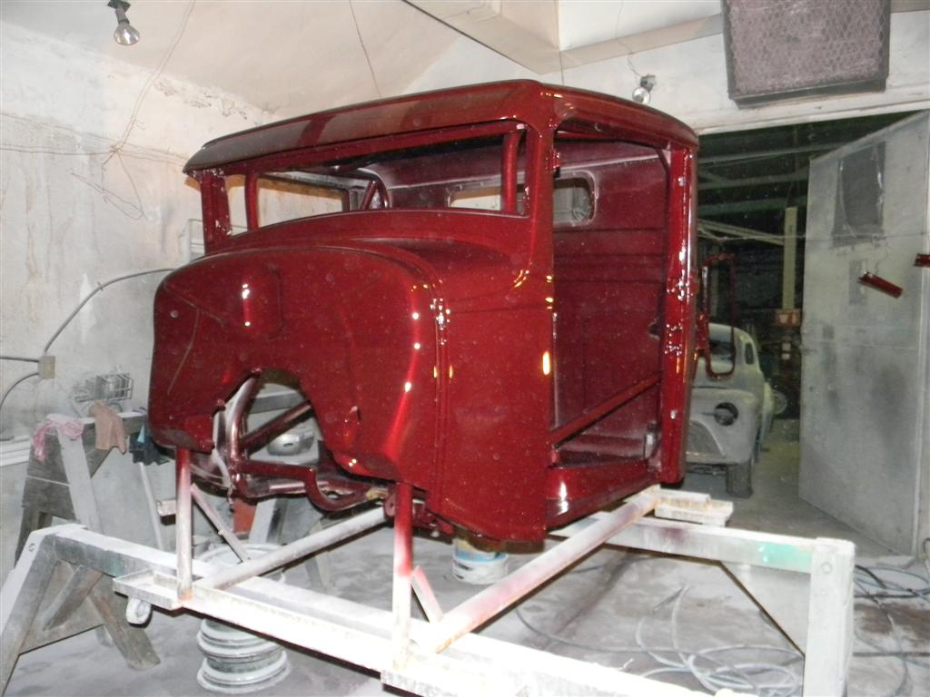

    Just wanted to follow up on Miguel's finished job. He actually finished a few months back but I was out of the country and WOW! I couldn't be happier! I tried to get good pictures, but it's a kandy with a micro-flake that really sparkles in the sun, and my camera phone just won't pick it up. Miguel did a great job though. As straight as a mirror and he made all the door gaps and what-not line up perfectly before shooting it. THANKS MIGUEL!

    The truck looks great Ian, can't wait to see it ***embled, I really dig the front chrome frame rails you made.

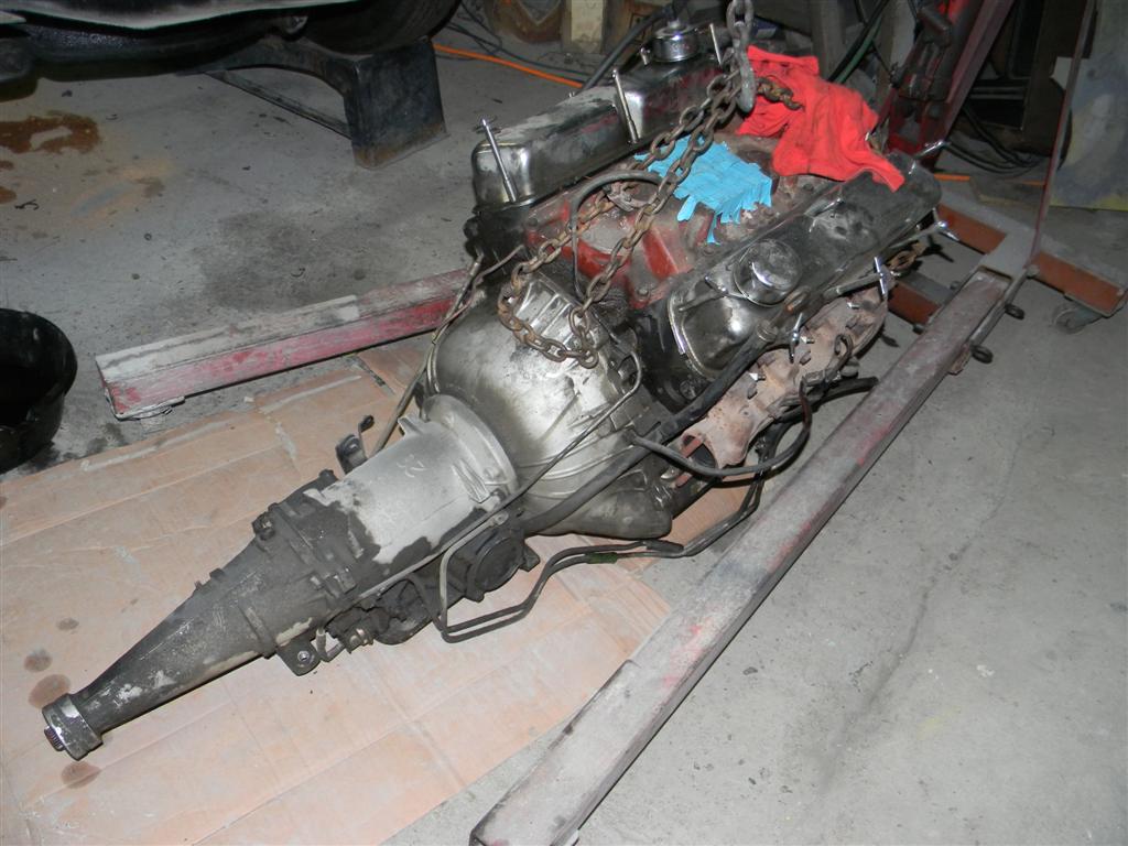

    Just went down to TJ last night for the first time in a LONG time. SO MUCH PROGRESS. I'm starting to get really excited. The gold CANDY Miguel went with is amazing. WAY BETTER THAN I COULD HAVE HOPED FOR. Almost all cancer has been cut out and replaced. Rear quarters are almost done. Floor pan is looking GOOD! All structure boxes were made from scratch but Miguels awesome metal workers. Miguel found some cool 54 Chevy tail lights he's going to be Frenching in in the next couple weeks. The motor turned out UNREAL. Polished water pump, all new gaskets, new polished valve covers, polished edelbrock intake. Epoxied the roof. All gaps between doors and hood are perfect. Everything lines up just as it should.
    Miguel showed me where the C4 transmission has a bunch of leaks. He's gonna be taking that to a friend to have it freshened up. With a little luck, Miguel will be pulling the body off the frame in the next couple weeks. He's gonna have to rebuild my upper link on the rear end. I believe he is also going to blow apart my front suspension and see if anything needs to get done there as well.
