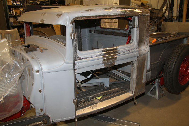

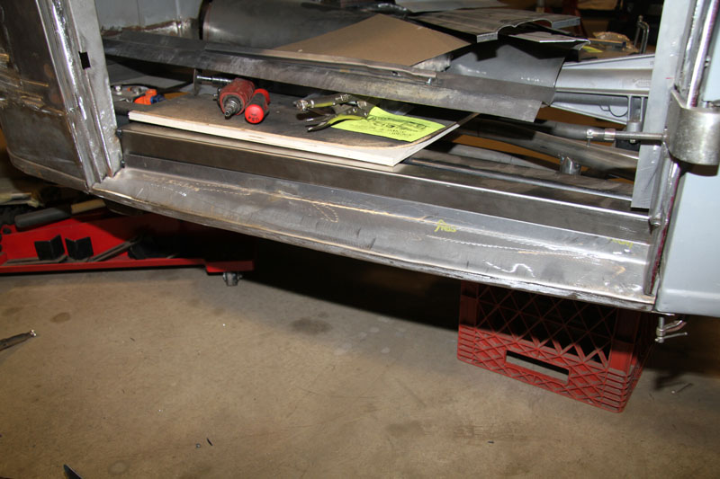

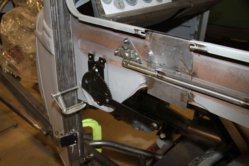

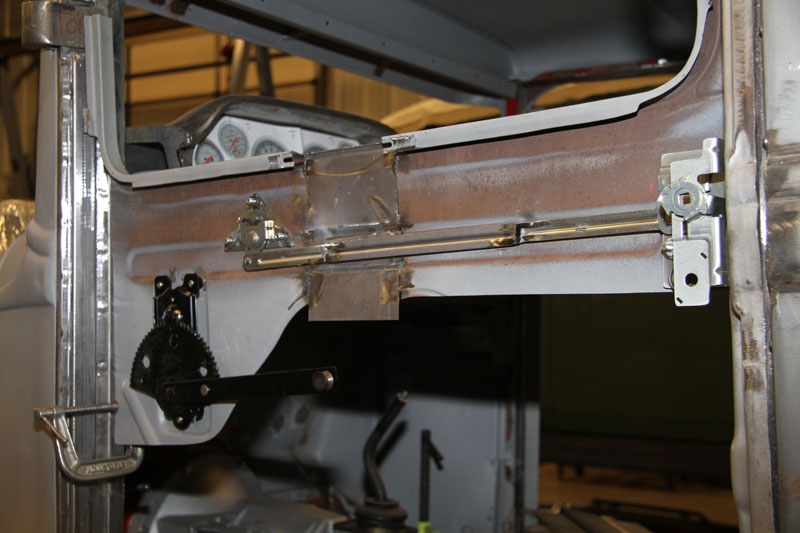

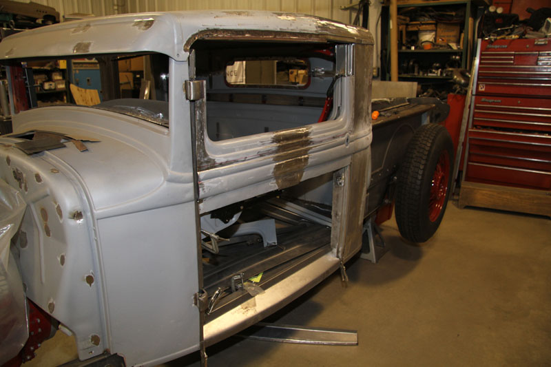

    On to some exciting news, the doors are underway! In this photo you can see the left, right and bottom door jams in position and the inner window jam. The window crank and door latch mechanisms are in place. The door latch has been temporally extended. Once the door get closer to being finished the bracket will me remade to the correct length.
    One more thing you can see here is the cab and door extensions.

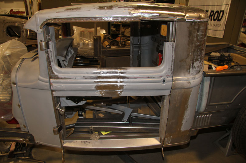

    A few more photos

    The first photo below shows the door bottom. The remaining two photos show the bottom door jam.

    looking good..lots of work on the doors,that should be way stonger than stock..

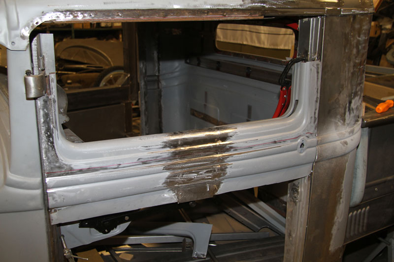

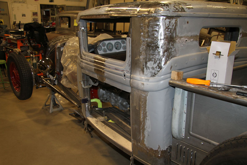

    A few long shots with the initial door/window frame for perspective of what its going to look like.

    Thanks, yes lots of work and should be stronger. This is the time you start asking yourself was adding 6 inches of the 10 inch stretch into the doors a good idea or not but, I know it was the right decision!

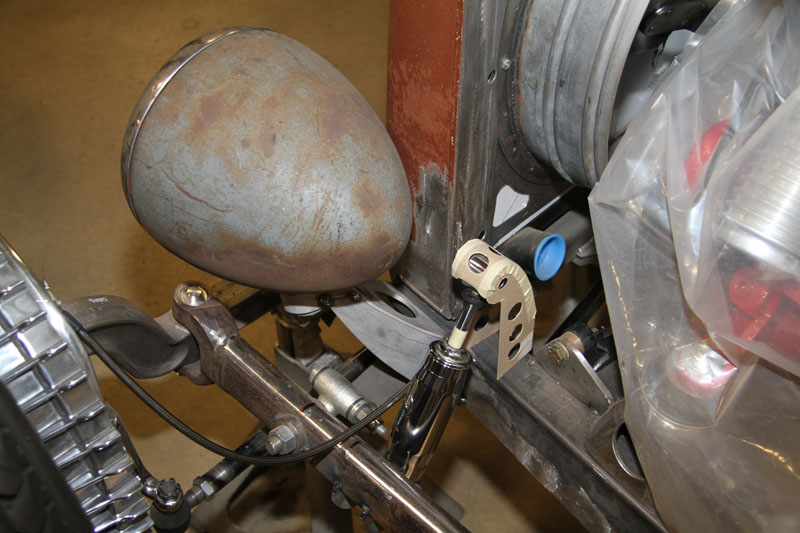

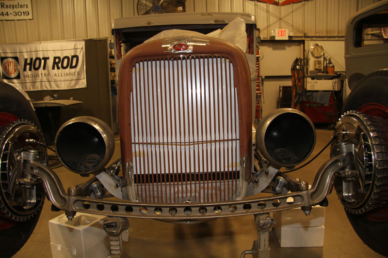

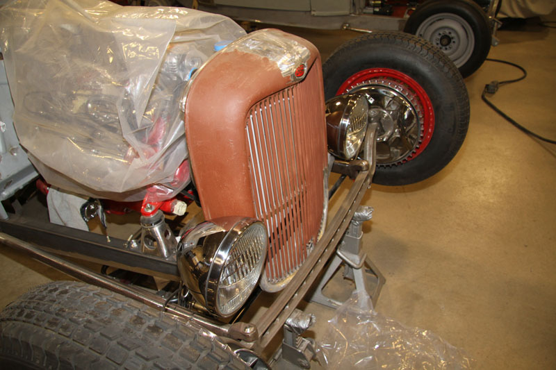

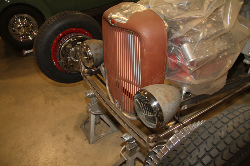

    from Western PA

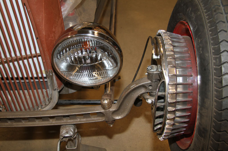

    Hey fellow HAMB'ers
    Before I ask for everybody's "O"pinion let me say I've made my choice, I just want to hear what other's think.
    I little background info first, you will see two types of headlights in the following photos, 33/34 & 35/36. The 33/34 light has 9" gl*** with polished bezel & bucket and the 35/36 has 7" gl*** with polished bezel & painted (rusty) buckets.
    I have two questions;
    1) 33/34 OR 35/36?
    2) Painted buckets or polished buckets?
    Again I know what light I will use but I'm on the fence with polished or painted buckets.
      115.5 KB

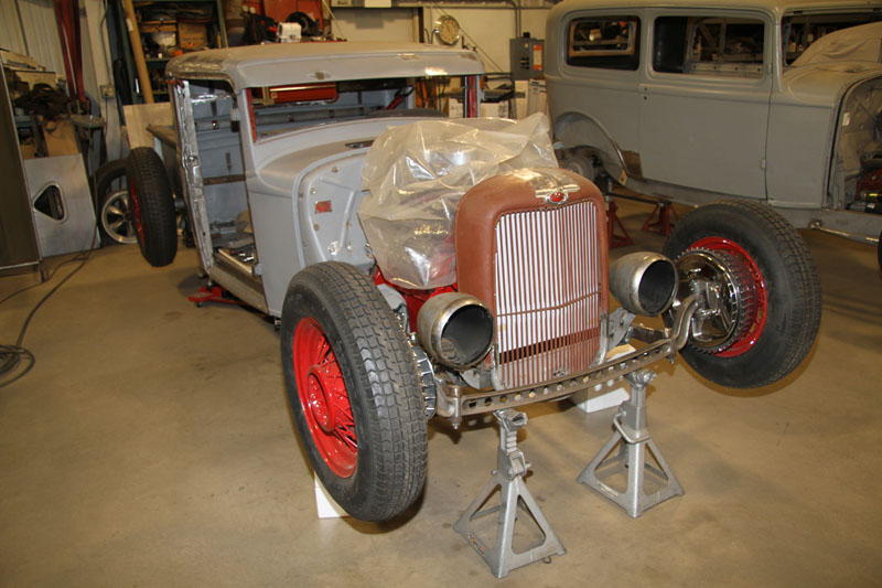

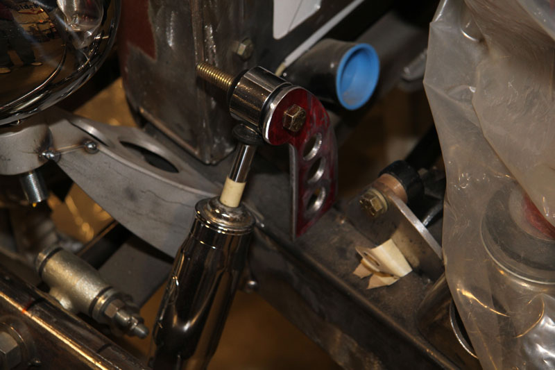

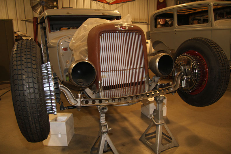

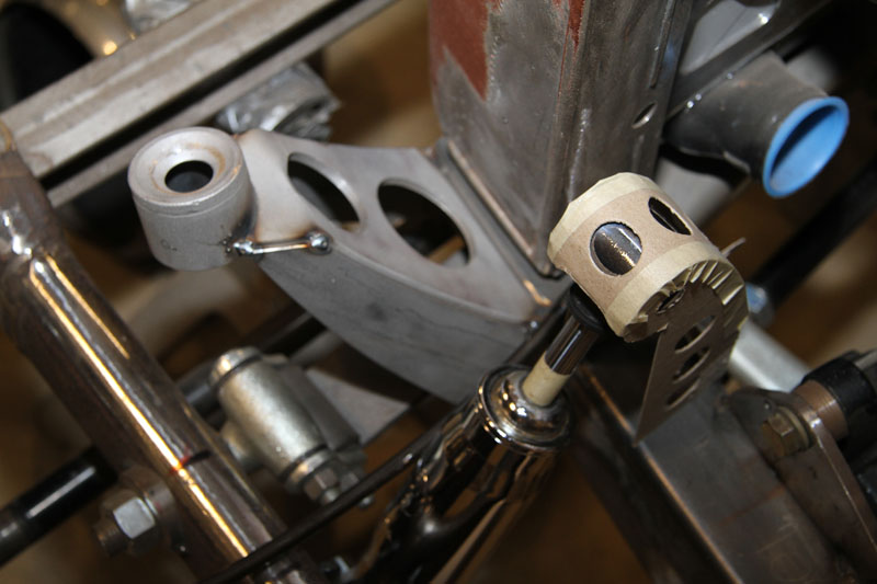

    You can see in the various photos the shock & headlight towers have holes cut to the engine mount.

    I see a trend building for painted and I can get both styles in painted or polished but the real question is what year buckets look cooler?
    33/34 with 9" Gl*** lens (its the polished version in the photos)
    35/36 with 7" Gl*** lens (its the painted/rusty version in the photos)
    Definitely like to hear your feed back.
    Thanks

    i like the 33/34 headlights
    Jen
  20. Speedy Canuck
    Joined: Jun 3, 2010
    Posts: 3,912
    Speedy Canuck
    My vote is for the 35/36 headlights.
  21. IowaMercMan
    Joined: Sep 22, 2008
    Posts: 535
    IowaMercMan
    One vote for 33/34. Painted.
  22. Master of None
    Joined: Dec 18, 2009
    Posts: 2,279
    Master of None
    35/36 painted, but I'm bias, they look like BLC's. I'm running 682-j's so I'm a little bias.
  23. dvs
    Joined: Nov 19, 2008
    Posts: 62
    dvs
    I gotta go with the 33/34's. I like the bigger lens.
  24. thunderbirdesq
    Joined: Feb 15, 2006
    Posts: 7,091
    thunderbirdesq
    Chris, I like the smaller 33-34 buckets on there, the 35-36 are a bit HEAVY for that nimble front end, but I prefer a painted bucket so... If you can get ahold of a pair of 35-39 pickup buckets, they're a bit smaller than the p***enger car units but you can use the cool 35-36 p***enger lenses and rings on them. Lookin good man!!
  25. Retribution
    Joined: Aug 11, 2009
    Posts: 662
    Retribution
    from Western PA

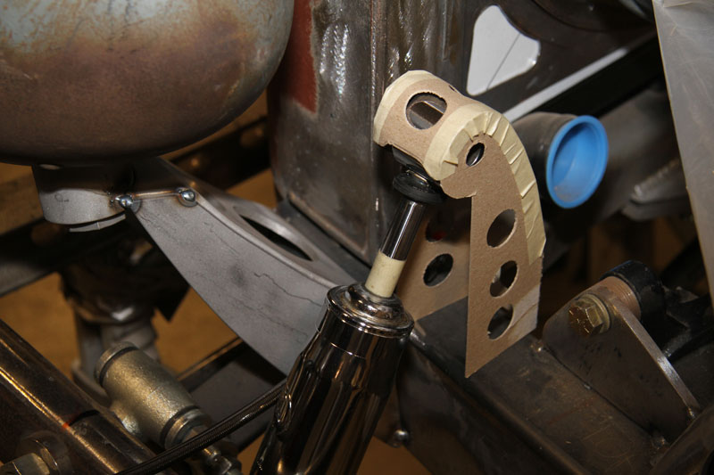

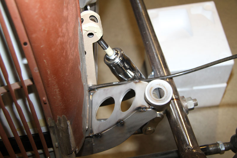

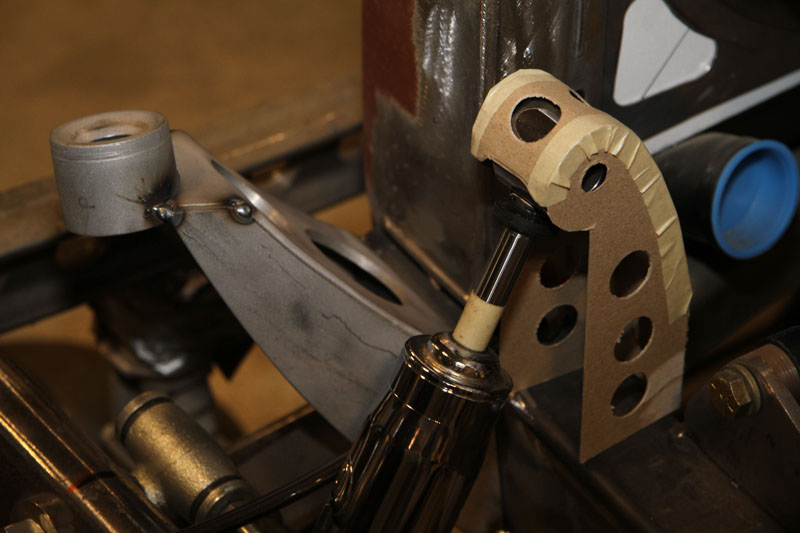

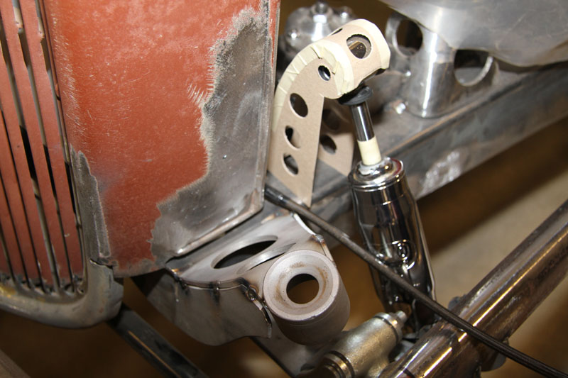

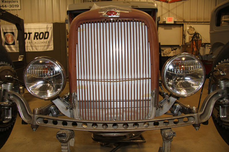

    Well folks I've decided to go with the 33/34 headlights. I learned they don't come in paintable version so, the buckets will get sand blasted and painted later. If you look you can see the beginnings of the shock mount too.

    Progress is being made on the door too.
