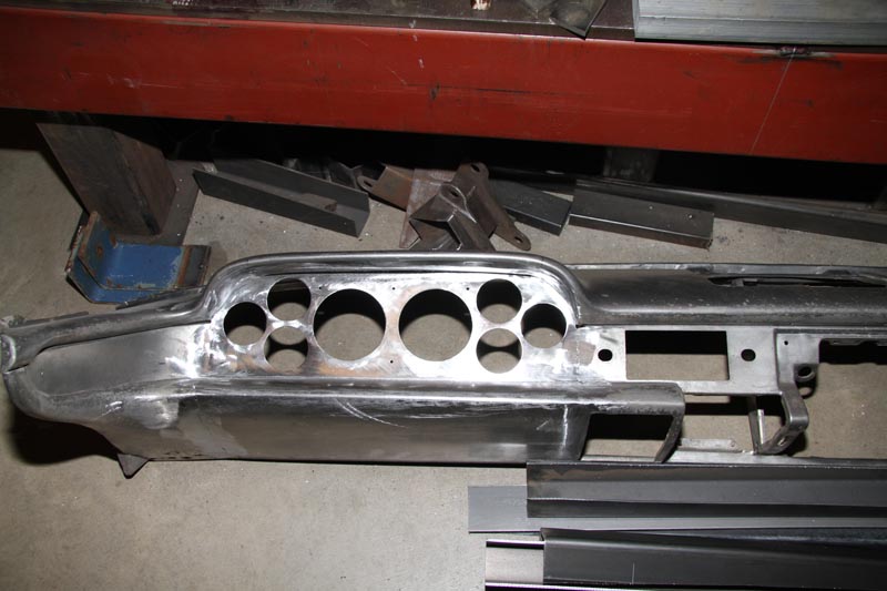

    Here you can see a plate mounted where normally the dash panel would be. It’s going to be a backer plate for a custom dash so it will be removable. The idea is to graph in a completely customized dash from a 58 impala. The 58 dash in these photos show the original dash with the instrument cluster backer welded in. Also, the area where the steering column was has been patched.
